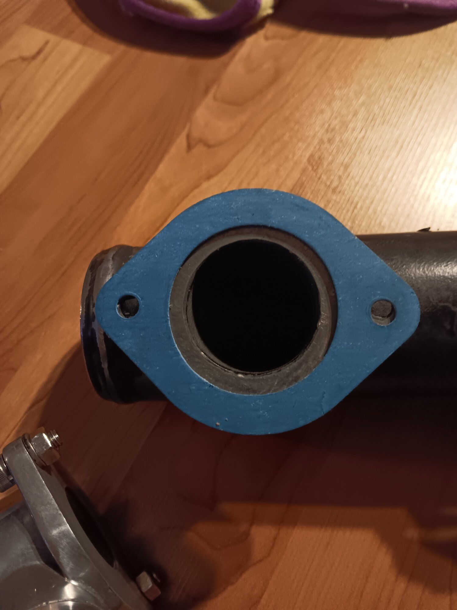

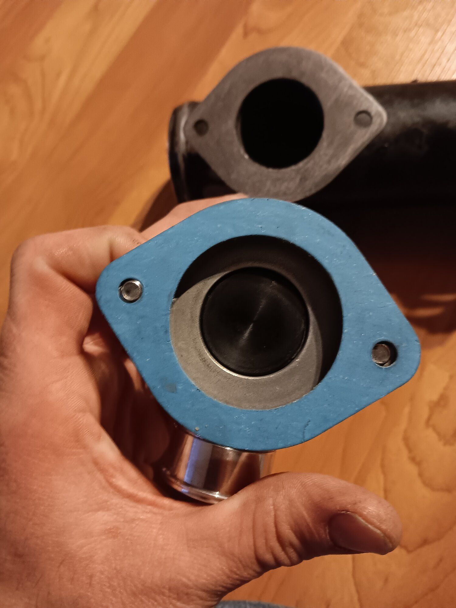

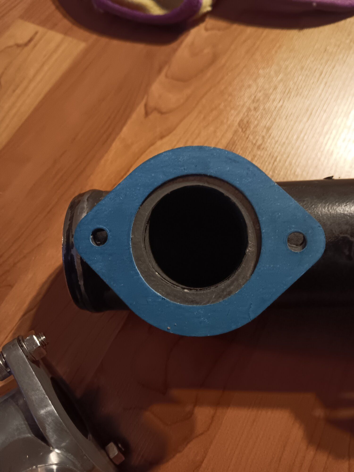

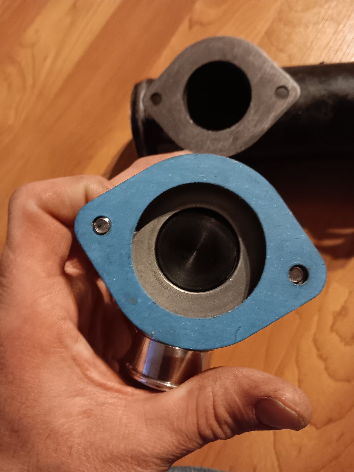

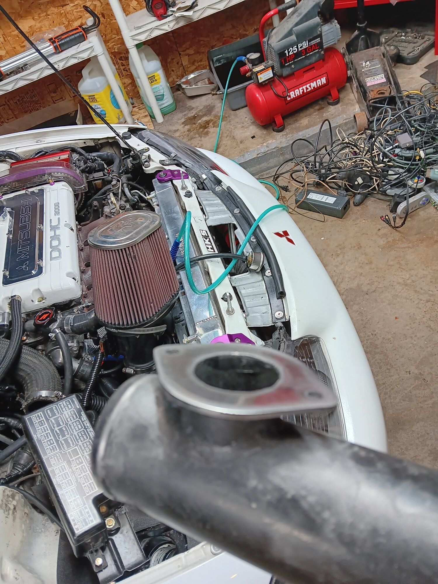

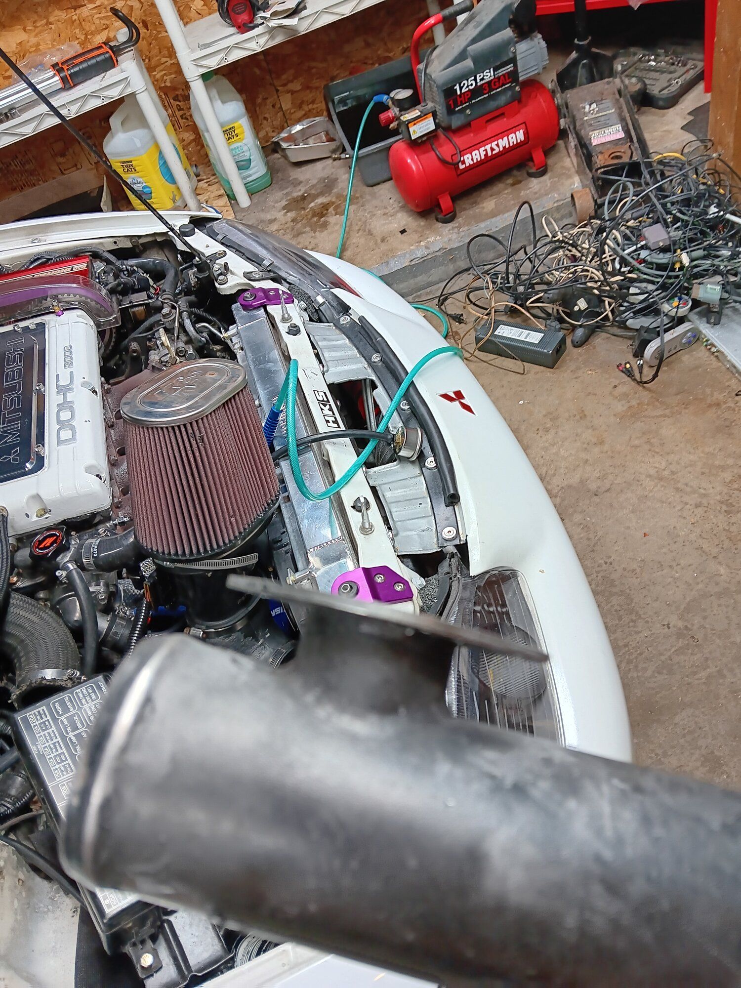

So I bought a genuine greddy gasket. Put it in and still a nasty leak... here's some pics of the flange to gasket and bov to gasket. Should it be this way? 🤔
Not really sure what to make of the size difference.
That is weird. They make the gasket smaller? Have u tryed getting the sheet of gasket material and cutting one your self?
