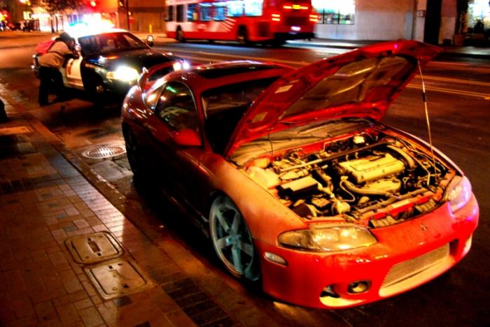

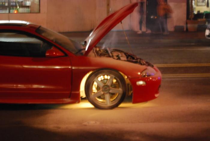

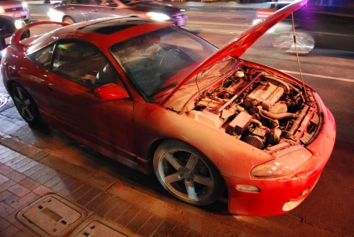

I was driving through downtown San Diego on Christmas Eve when my headights started to flicker and a cop passing the other direction yelled at me to "PULL OVER!" As he was flipping a u-turn in traffic I'm trying to figure out why my car just shut-off in the middle of the road and smokes rolling out from under the hood when my coolant temp gauge is normal. The car shuts off and the lights go out, I attempt to put on my hazards but nothing... shit. I pop the hood and run out to asses the situation, the instant I lift it I get hit in the face with smoke that damn near chokes me and burns my eyes. W.T.F is going on!!! Once I get my bearing back and the smoke clears I see a small flame across the entire length of throttle cable from the CC box, down the fuel rail, and around the back of the IM to the throttle body. Realizing I have fuel lines right there from the AFPR install my pathetic attempt to "blow out the fire" failed miserably and about that time the SDPD ran up with his bottle of CO2. After 3 or 4 cop cars arrive and just as many CO2 bottles are sprayed all over my engine bay I realize, this fire is electrical. Unfortunately, the SDPD is keeping me on the sidewalk and won't let me go near the engine bay as I explain to him its the battery that needs cut from ground. He just tells me the fire dept. will take care of it once they arrive, then goes on to mention that if there's anything important in the car I should start pulling it out. OMG
Funny or not, I run to the trunk and grab two things, a 3/8" DR ratchet and a 14mm socket, then proceed to the front of the car and start pulling my black leather seats! Once I get the passenger seat out and on the sidewalk the cop realizes what I'm doing and says, "I said pull anything important, not start stripping the car!" Disappointed, I run back and toss the tools in the hatch and grab my digital camera to snap a few pictures of my car up in flames.
What seemed like an eternity, the SDFD showed up and snipped ground from the battery and put the fire out with a small bottle of water. Here are the photos I took of the fire, then a few of the aftermath. Only after I pulled the strut tower brace did I realize, the brace had completely rubbed through the wire loom and insulation on the cable going to the (+) terminal on the battery.
To say the least, I had a GREAT Christmas 2008. :mad:

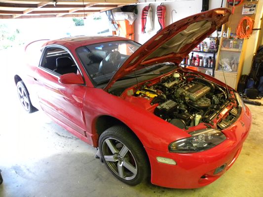

18JAN2009 - Finally Got My Car Back!
Lucky for me I had fire coverage on my car insurance so after a $250 deductible and a few weeks at the Mitsu dealership everything damaged in the fire was fixed. What a relief too, since State Farm was threatening to total the car since the extent of the damage was over $2000. :coy:
To say the least, I was happy as hell to have my DSM back. The dealership replaced the throttle cable from the CC box to the TB, engine wiring harness, passenger side brake line (which was SS), and starter to battery wiring harness too.

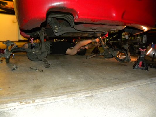

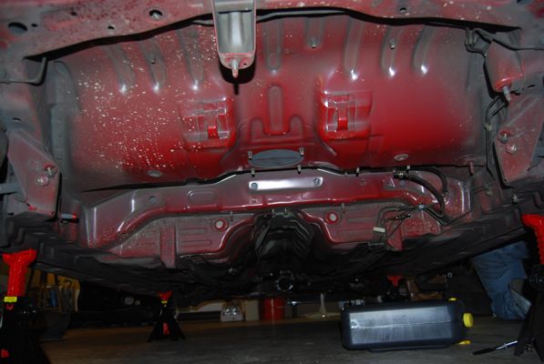

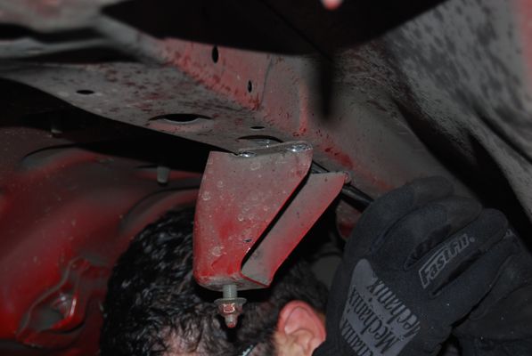

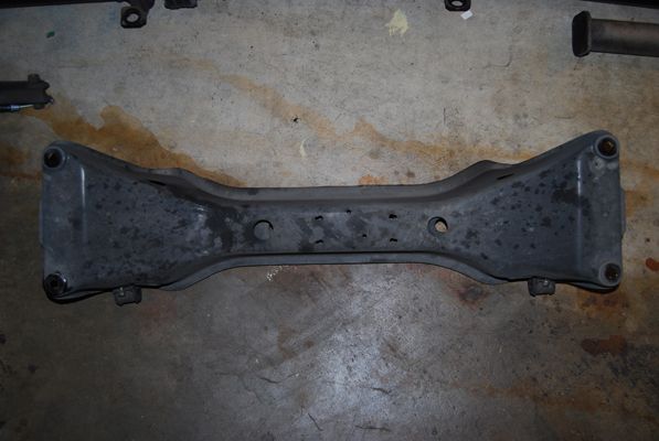

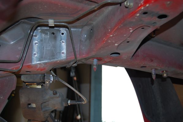

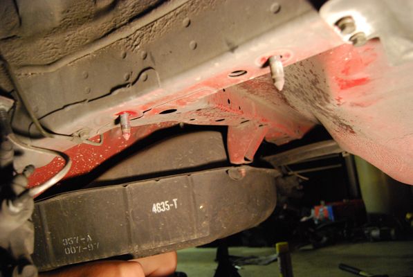

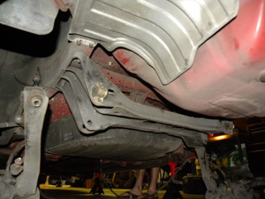

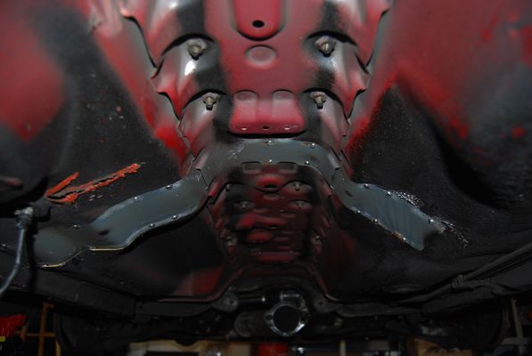

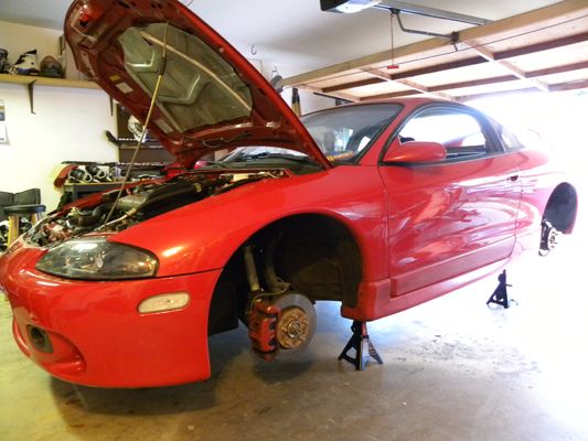

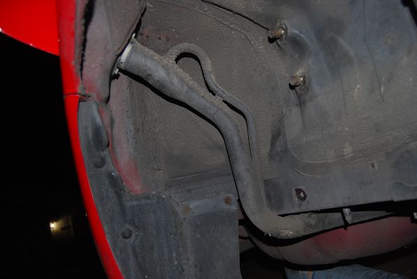

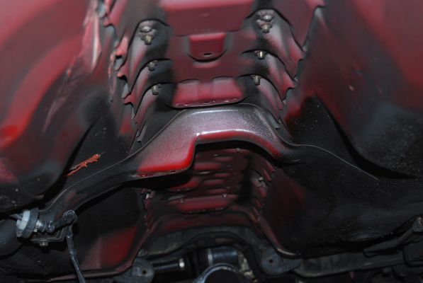

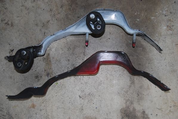

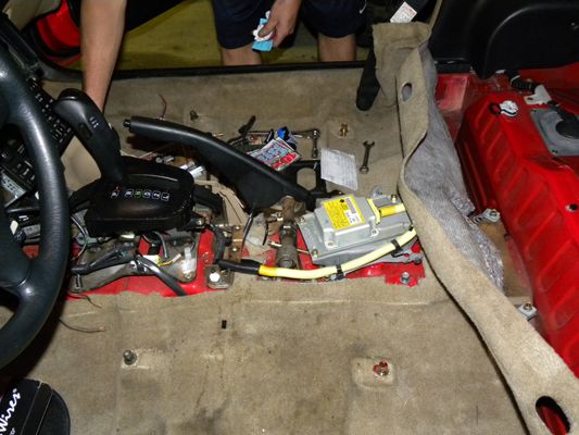

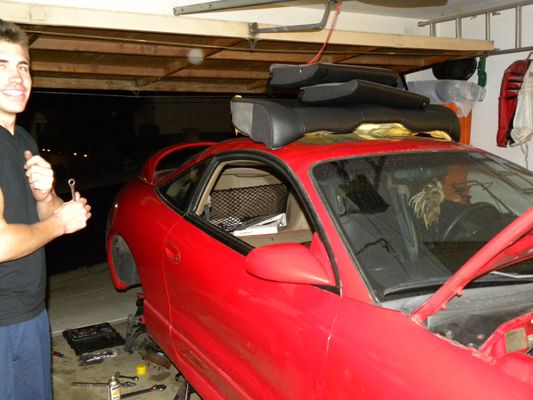

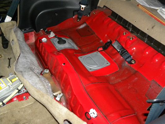

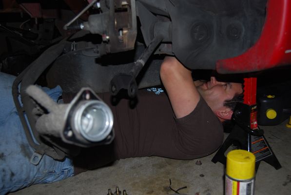

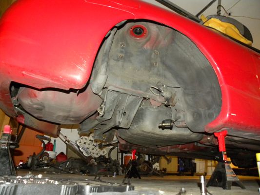

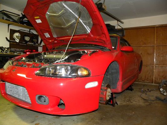

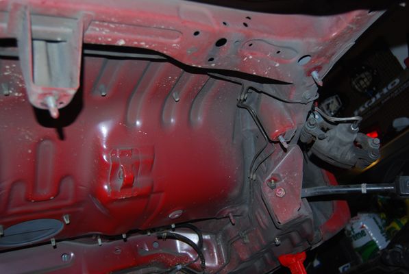

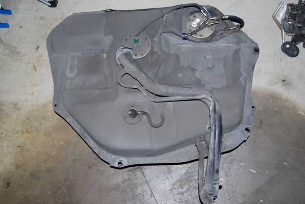

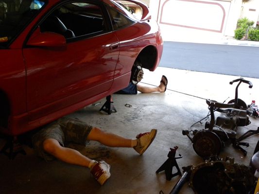

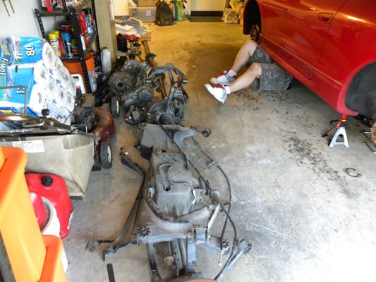

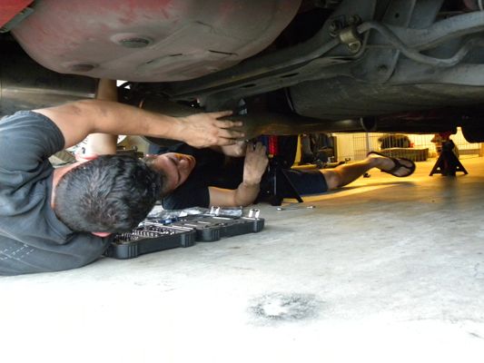

08APR2009 - Drivetrain Swap Day 1: Pulling the FWD Rear Suspension & Interior
After a few weeks of gathering parts and researching how to do a 5-speed AWD swap (from an A/T FWD) I was confident enough that my friend Dan and I could do it successfully. To be completely honest though, neither of us had any idea what we were getting ourselves into and were a bit nervous about it to say the least. We took the swap one bolt at a time and learned as we went and, with a little luck and hard work, the car dropped off the jackstands as a 5-speed GSX. I learned A TON about my car and enjoyed every minute of doing the swap, although there were a few snags along the way. WORTH IT! :hellyeah:
