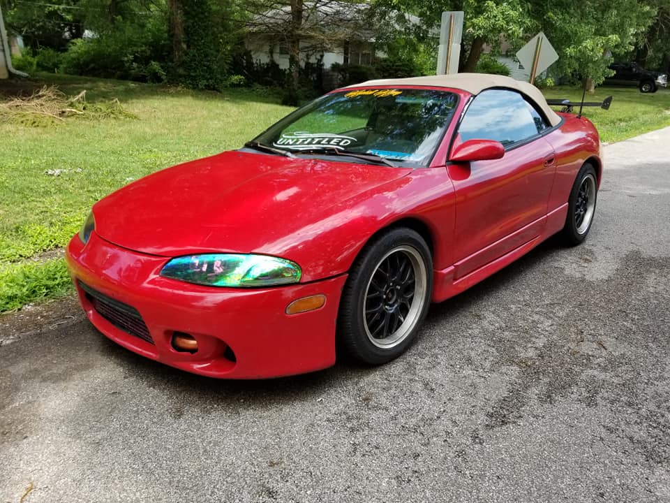

97 Eclipse Spyder GS-T
As if anyone really cares, this will be my first "build post".

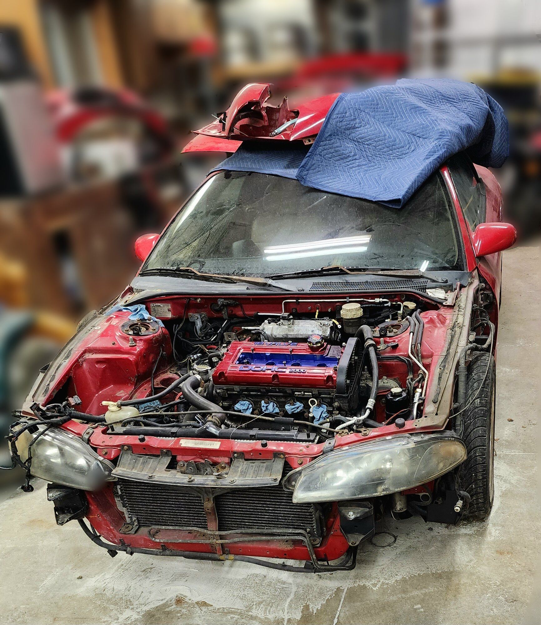

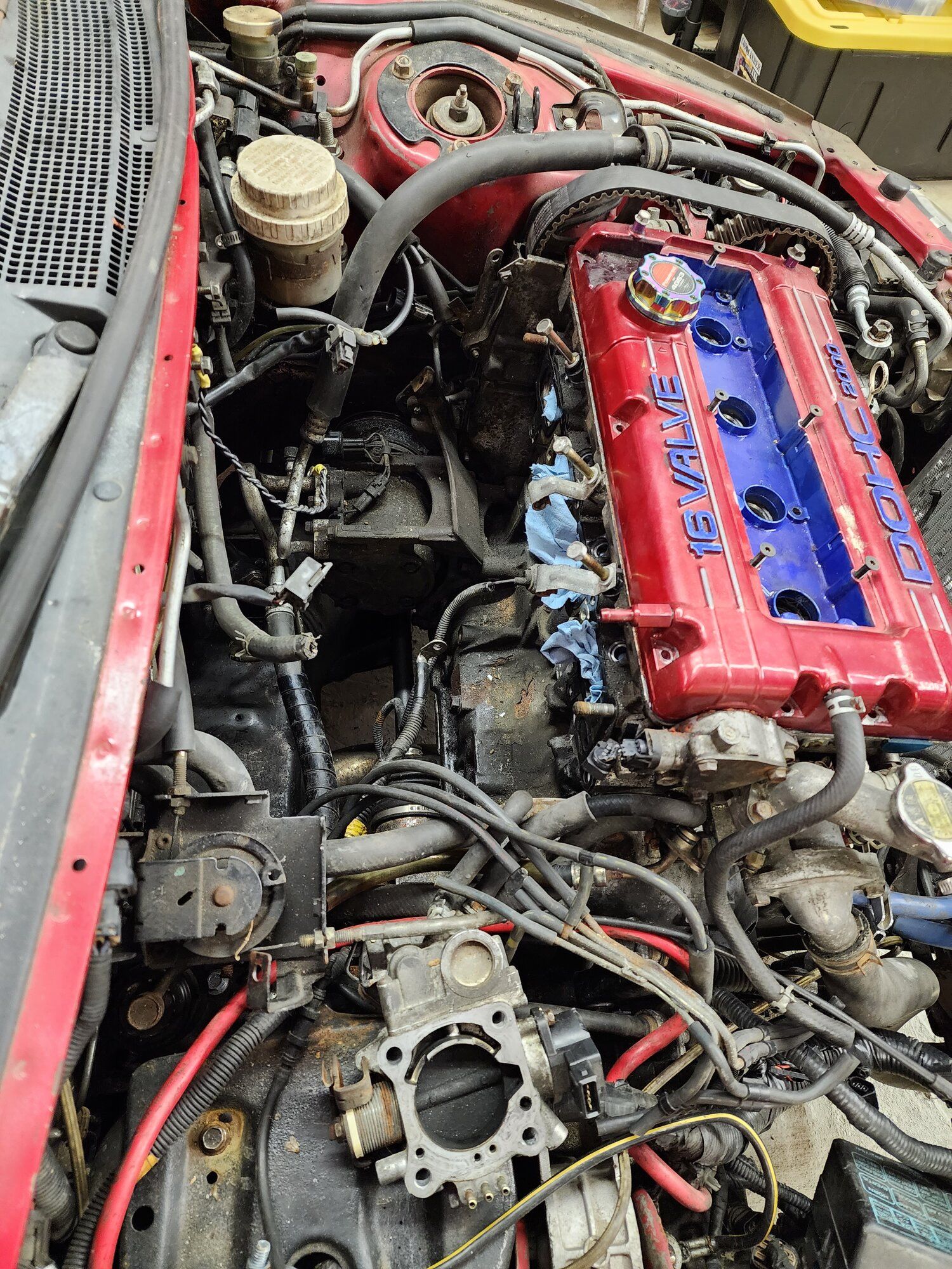

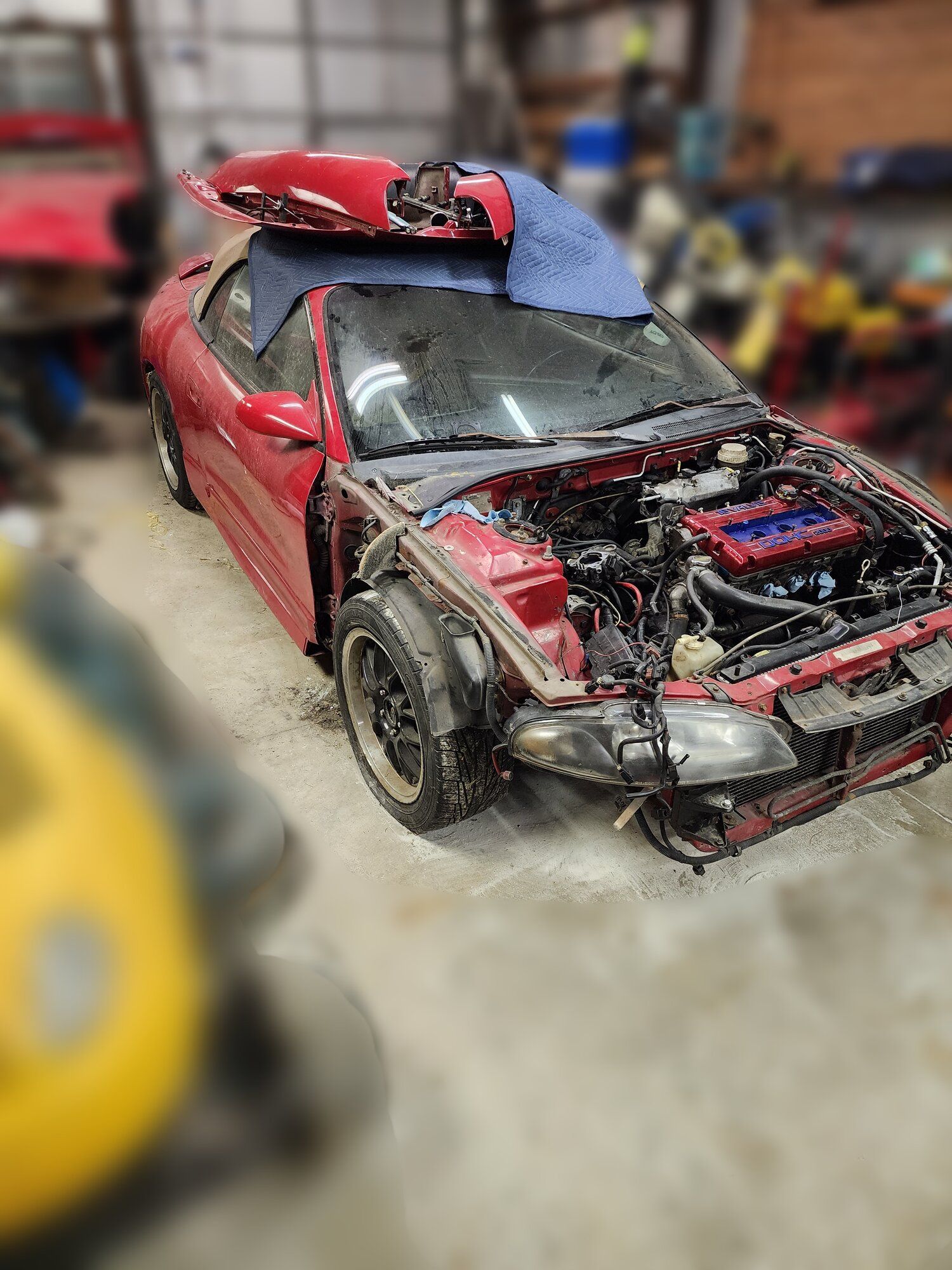

It's been a while since I've posted. Not much has changed with the status of the spyder since the last time I posted. A few weeks ago I decided to go out and mess with it a bit. I removed the crappy 'tint' film from the headlights, and removed both front fenders and hood (have better condition replacements chilling). Started to remove things to be able to remove the head for ARP stud installation and deck flatness check. Pretty well got everything removed other than the front cover, timing components, and the intake manifold. Stopped there because It appears that the hard coolant piping needs to come off to be able to access removing the intake, and I didn't really want to mess with draining coolant at like 4am LOL. Other than that, this week I've started purchasing some more parts that I need.
So its been awhile, figured id post some updated pics. This is where we got so far (like 3 weeks ago LOL). In the process of tearing down to take the head off, flatness check, and install ARP studs.
