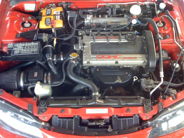

What caused the fire the RRE strut bar hitting the battery?
Something like that. ;)

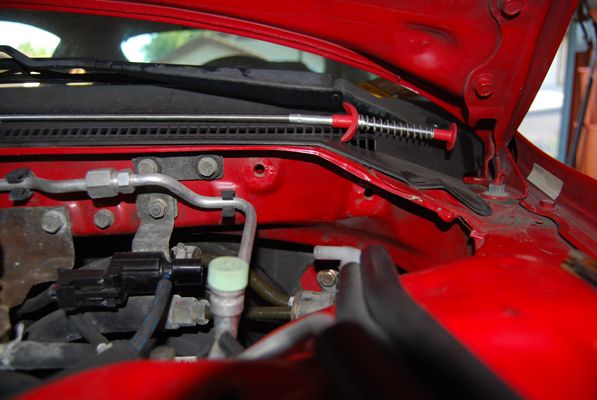

gofer said:
Only after I pulled the strut tower brace did I realize, the brace had completely rubbed through the wire loom and insulation on the cable going to the (+) terminal on the battery.

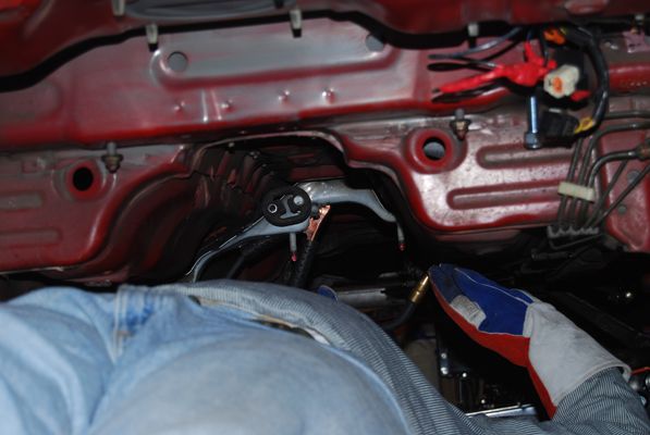

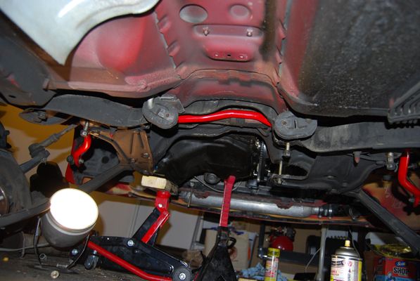

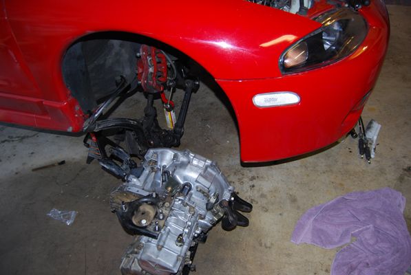

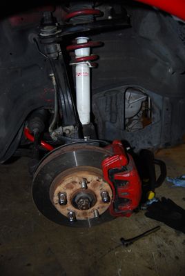

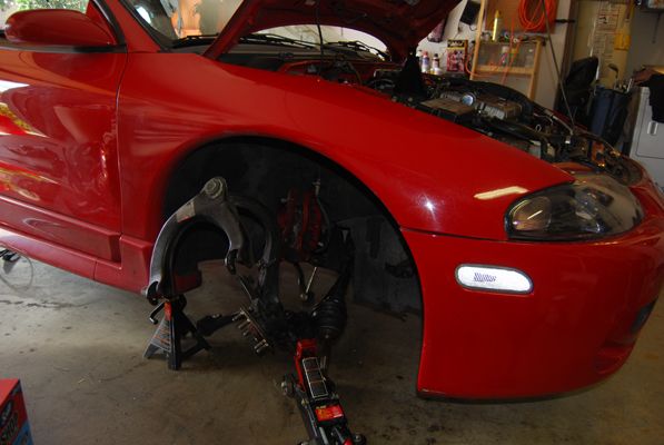

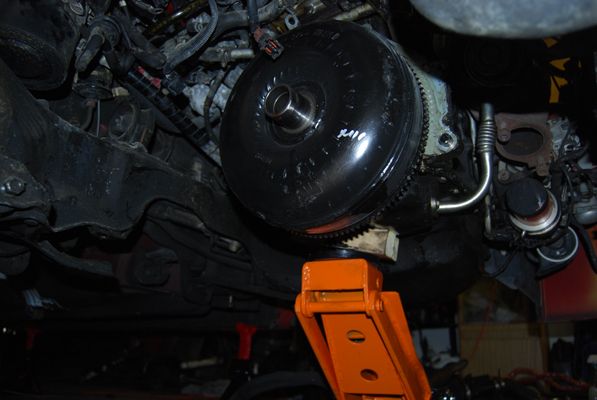

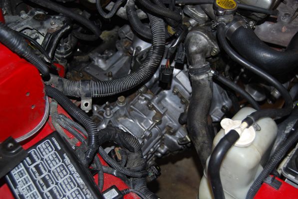

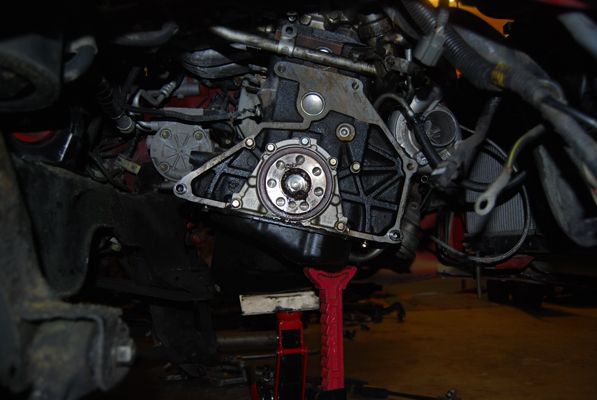

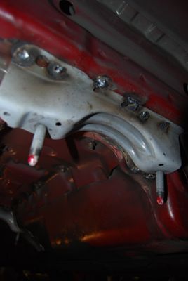

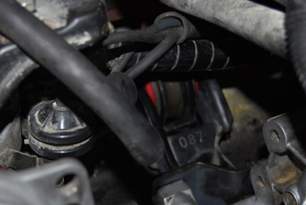

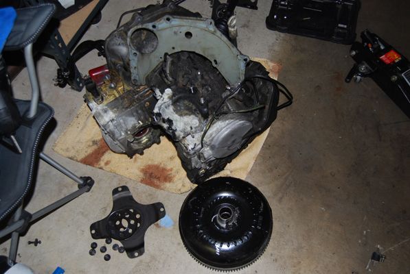

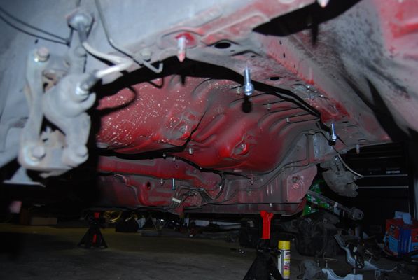

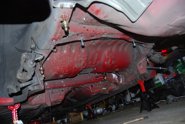

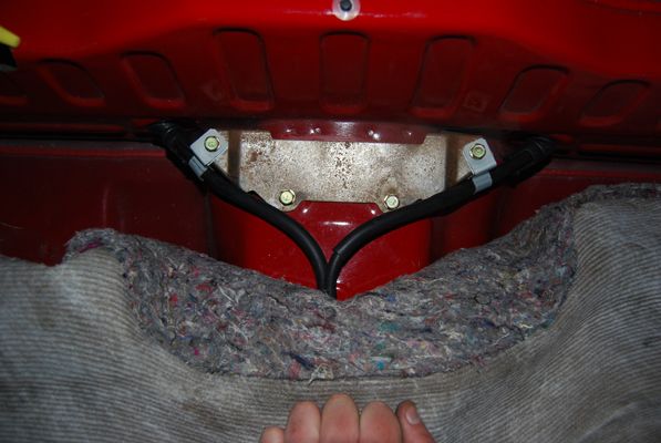

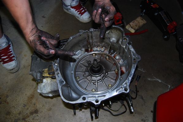

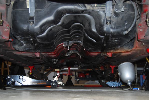

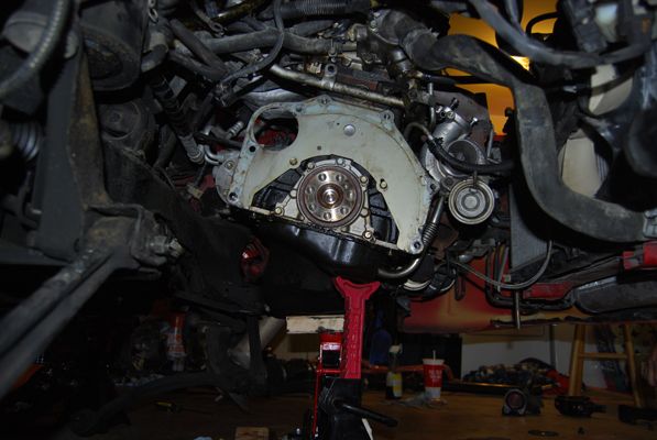

13APR2009 - Drivetrain Swap Day 5: Dropping A/T Transmission, Replacing Motor Mounts, & Strapping Up AWD Gas Tank​

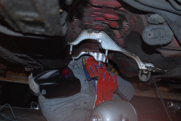

If you can't tell by the pictures below, dropping a FWD A/T is a pain in the ass. Once we finally got it off it was time to loosen up the bolts holding the flexplate to the crank and, in doing so, I broke my ring finger. Unfortunately for me, I was pushing as hard as I could on the breaker bar when the socket rolled off the head of the bolt and my finger went into the radiator. :cry:

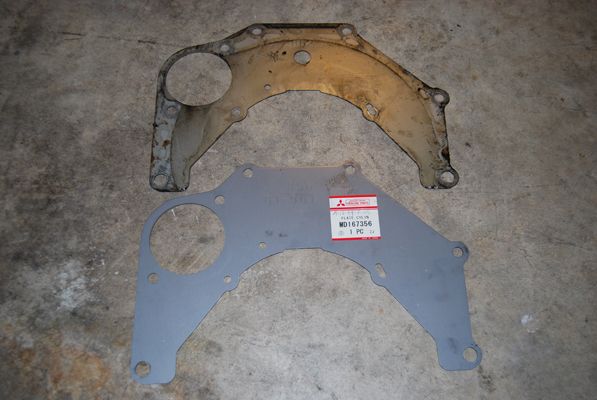

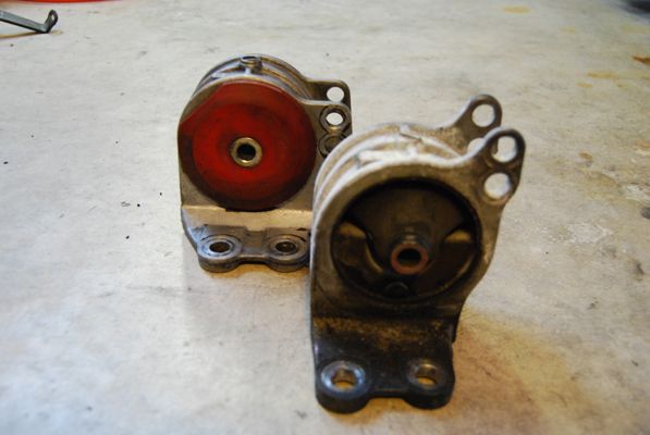

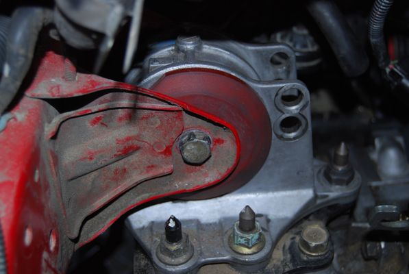

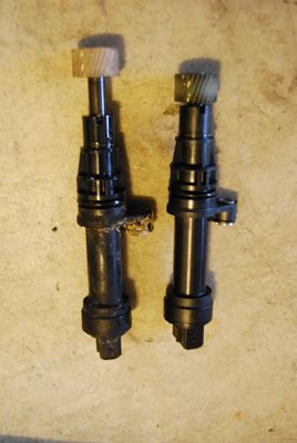

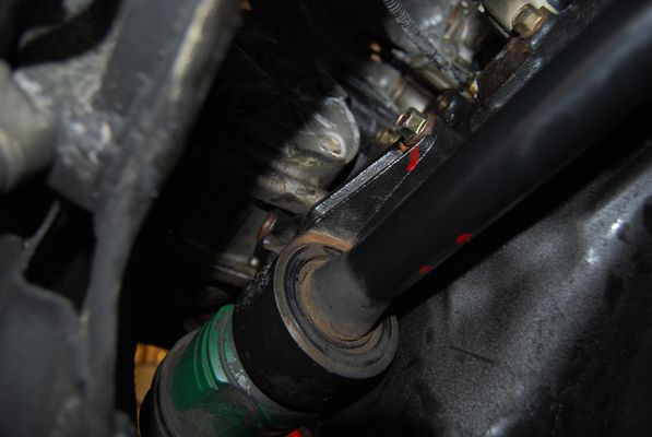

A few of the photo I took were comparing the A/T VSS gear to the M/T VSS gear and the A/T motor mount to the M/T motor mount.
Enjoy. :)

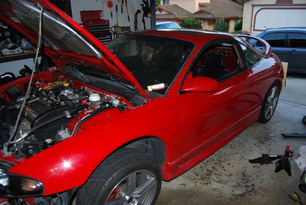

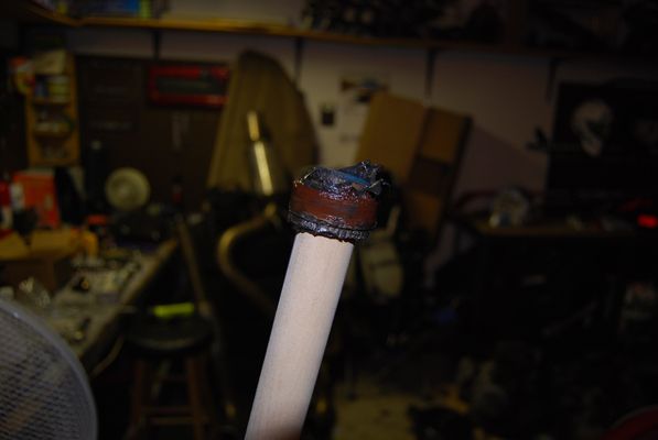

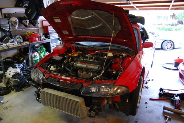

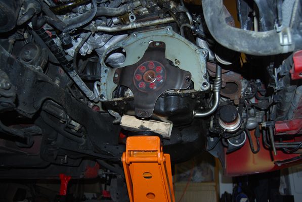

19APR2009 - Drivetrain Swap Day 7: Clutch Fluid Reservoir and SS Clutch Line Install. Removed A/T Flexplate Spacer! ​

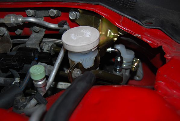

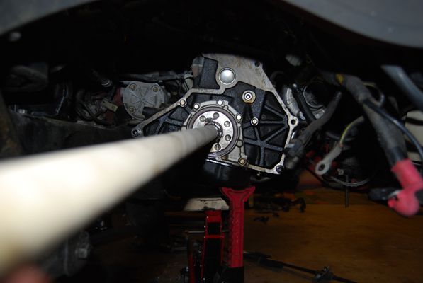

The clutch fluid reservoir and SS line are pretty self explanatory however, for those of you who've ever had to remove that flexplate spacer should know how big of a PITA it is to pull. I can tell you that it took us nearly 6.5 hours of none stop abuse to it and we still had to get creative. Believe me when I say that we tried EVERYTHING and in the end we measured the I.D. of the spacer with a caliper and then took a trip to Home Depot and bought a wooden dowel with a matching O.D. I packed inside of the spacer with axle grease (from a torn CV boot on my FWD A/T axle) and hammered the wooden dowel into the spacer. The dowel was about 6' long so one crack on the dowel to the side and the spacer popped out like it was barely even in there. :hellyeah: F.uck'n right!

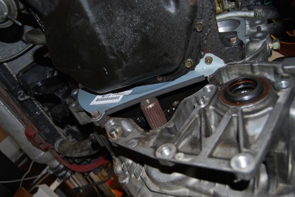

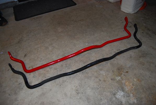

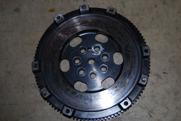

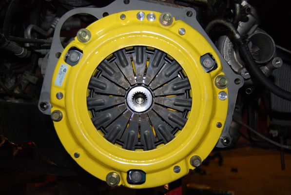

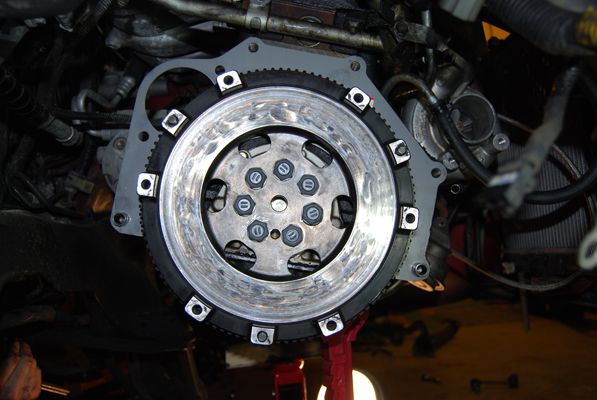

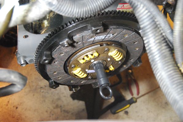

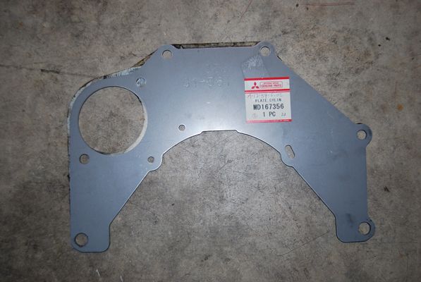

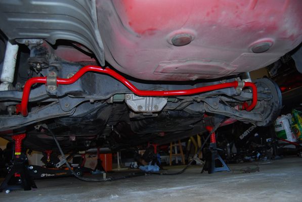

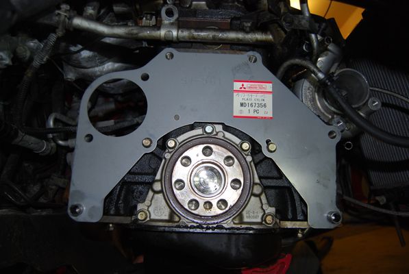

21APR2009 - Drivetrain Swap Day 8: M/T Plate, RMDSM Front Sway Bar, ACT Chromoly Flywheel, and ACT 2600 PP/Street Disk Install ​
Don't judge me, I know those aren't the right PP bolts holding it to the flywheel. OMG

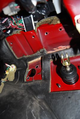

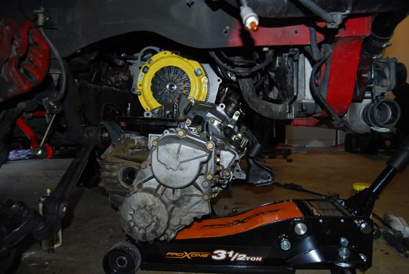

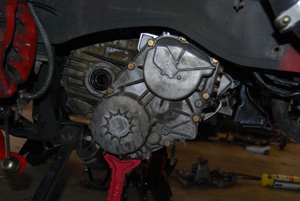

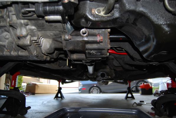

22APR2009 - Drivetrain Swap Day 9: AWD Transmission Install​
Not a whole lot to see here, Dan got the transmission bolted to the block and wrapped things up until I got back from a 5 day underway on the aircraft carrier I was attached to.

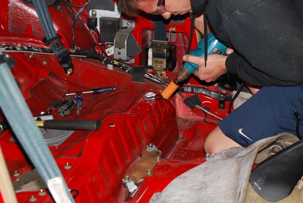

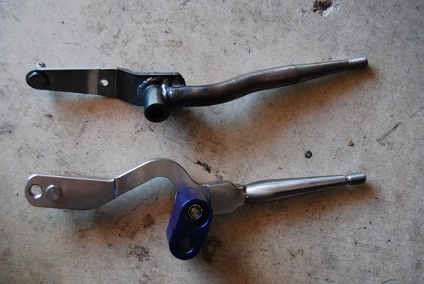

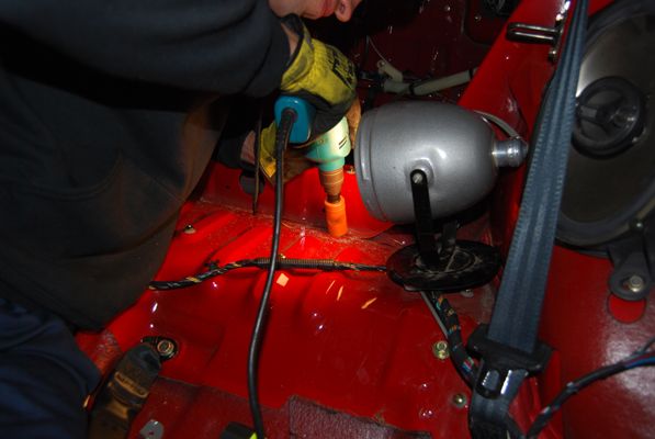

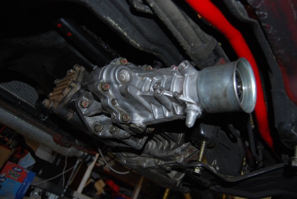

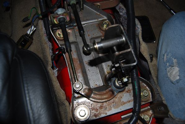

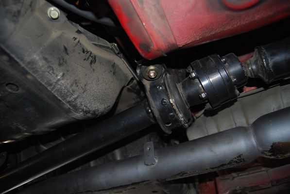

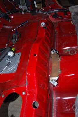

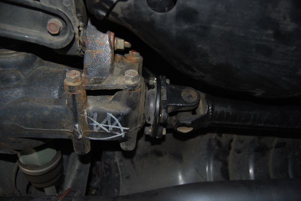

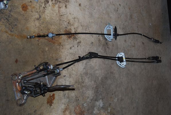

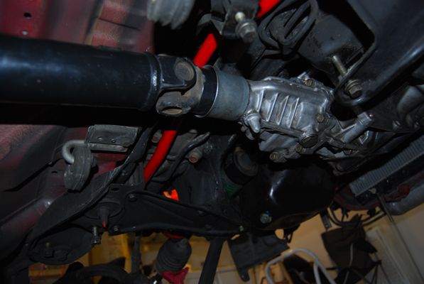

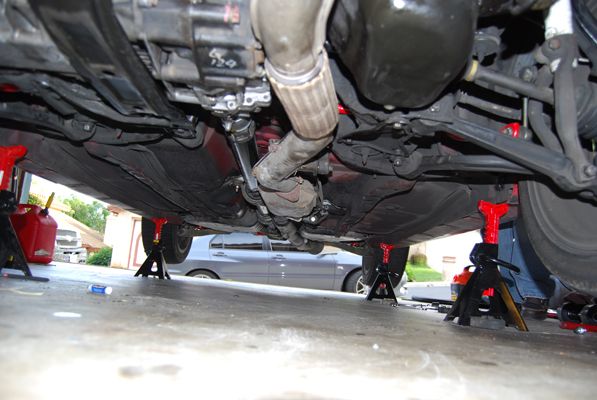

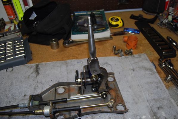

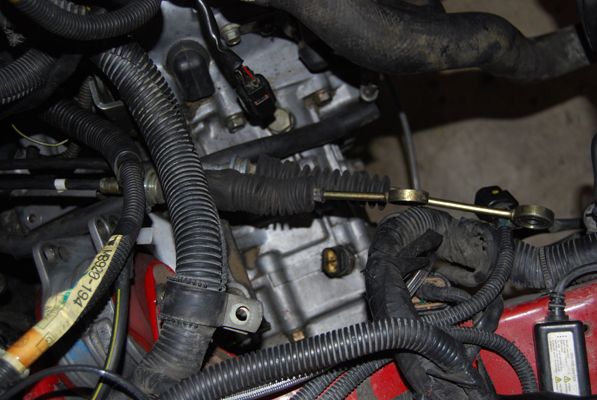

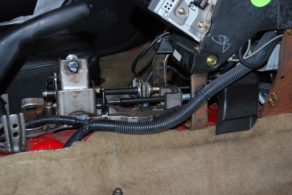

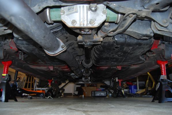

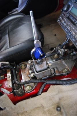

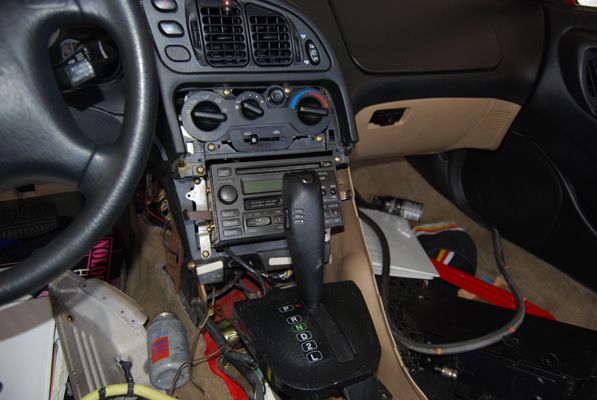

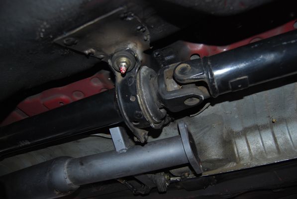

29APR2009 - Drivetrain Swap Day 10: Routed Shifter Cables and Installed My Symborski Shifter Base Bushings, Axles, Driveshaft, and Transfer Case then filled the Transmission with Fluid​
I had just gotten home from a LONG week out at sea so I was motivated to get my car finished. I got off work a few hours earlier than Dan so I got to work on the easy stuff, saving the hard stuff for him to do. Everything was coming to an end, what a great feeling...

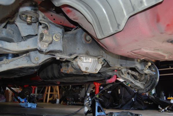

30APR2009 - Drivetrain Swap Day 11: FINISHED! The AWD Swap. ​
It felt good to be taking the car off the jack stands and back onto its own tires, definitely a little nerve racking though. Dan and I had never done anything like this before so we were in for the unknown and hoping we didn't skip a crucial step in the swap because it seemed too easy.
Found another shot of the car backing out of the driveway after the swap, its iPhone quality but a classic none the less. :thumb:

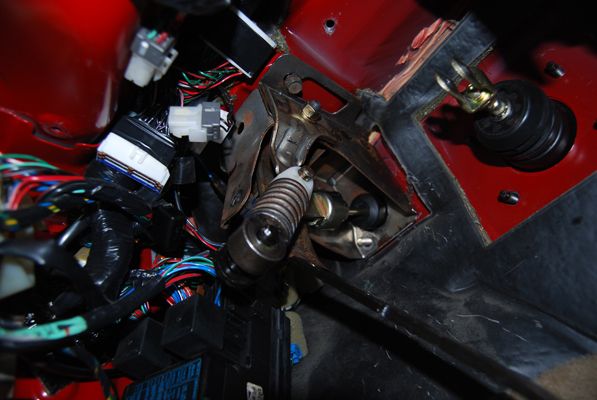

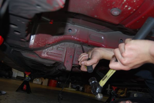

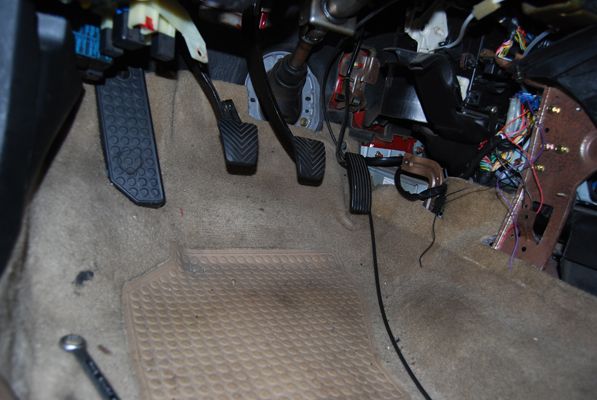

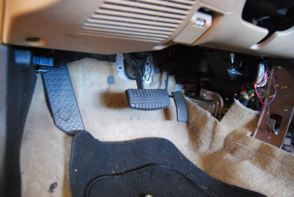

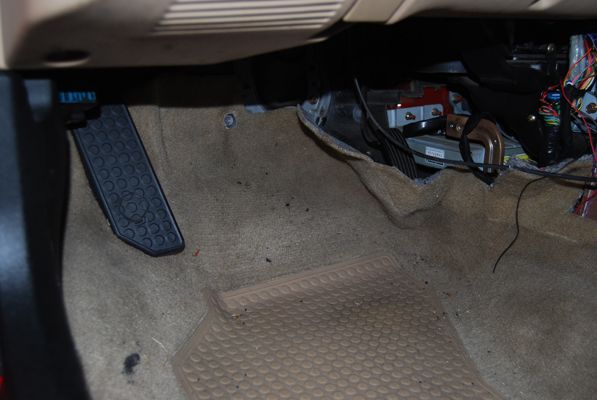

Besides the reverse lights not working, which is a downside of swapping in a M/T and still using the A/T wiring harness, the only thing that needed adjusted was the clutch pedal. You can see Dan under there (in the last picture) trying to get a wrench on it while I was snapping a photo, I was so excited. :sneaky:

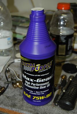

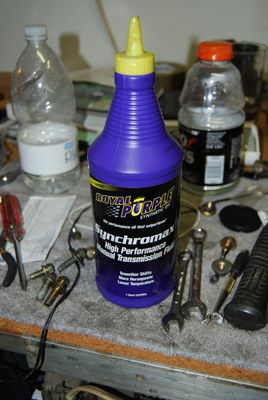

Did you use the royal purple in the trans too or just the t-case and diff? I currently have Gl-5 (wrong stuff) inmy trans cause it's all i could get and i'm debating wether to go with synchromesh or something like the shock proof oil.. i like the results i hear about the synchromesh but it does seem like a rather thin fluid, and i don't "shock" my trans with hard shifts, but am making a good bit of power.., hell from whati've read though even going back to a GL4 would be a workd better than what i've got.. buti really can't complain about this shifting since i fixed the worn pedla in my 2g assembly, it's just that faster/easier is always better :D.. I used a trick some one passed onto me that builds their own DSM trannies and put about 3/4th's a quart of ATF Dex III w/ mercron into the trans before adding the GL-5 to supposedly help shifing and like i said i can't complain.. I hope to finish mybuild thread with some pics of my swap and other things i've done lately

The Royal Purple SyncroMax was used in the trans and the Max Gear was used in ONLY the transfer case, we never pulled the axles out of the rear diff and it already had a fresh quart of Redline Heavy Weight in it. I don't recommend either of these fluids though, looking back I wish I would have done more research on the subject. Now, I run only Redline fluids and this is the breakdown for each...
  • Transmission - 50/50 mix of Redline MT90 and Lightweight Gear Oil
  • Transfer Case - Redline Heavy Weight
  • Rear Diff - Redline Heavy Weight
This is what Shep recommended and, for whatever reason, I trust that guy. LOL

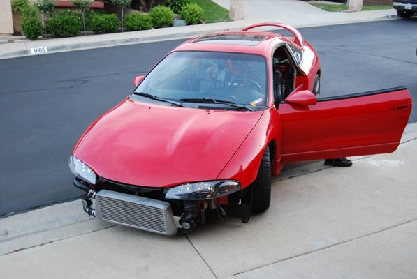

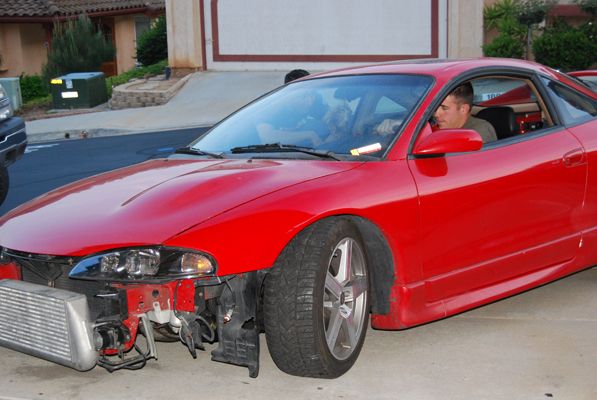

10MAY2009 - First Long Drive AWD and Out To Sea For 3 Weeks​
The AWD swap was done about 40 minutes away from my home (no garage) and the Navy wanted us to go back out to sea for 3 weeks. I had to get the car home eventually so, after going over everything to make sure it was good, I started my 40 miles drive. I was a bit nervous so my buddy Dan (who helped with the AWD swap) followed me in his Evo until I made it all the way back. To both our surprise nothing serious was acting up after the swap, just a partially working fuel gauge and no speedometer.
Here's the first shots I took of the car after the first long drive in the newly AWD swapped DSM.

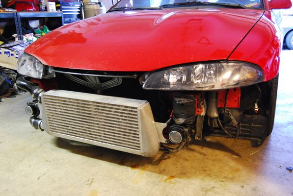

It was fun having my turbo DSM back again, especially after all the work making it M/T AWD, but I had to park it and go out at sea. I took advantage of my time away though, I gave everything I wanted powder coated to a buddy to get coated matte black so it would be done once I returned.
Leaving my cars behind in long term parking...
Returned 3 weeks later and installed all my matte black pieces... :hellyeah:
(IC piping, HKS bov, front bumper brackets, heat shield, clutch master bracket, fusebox bracket, and hood post)
