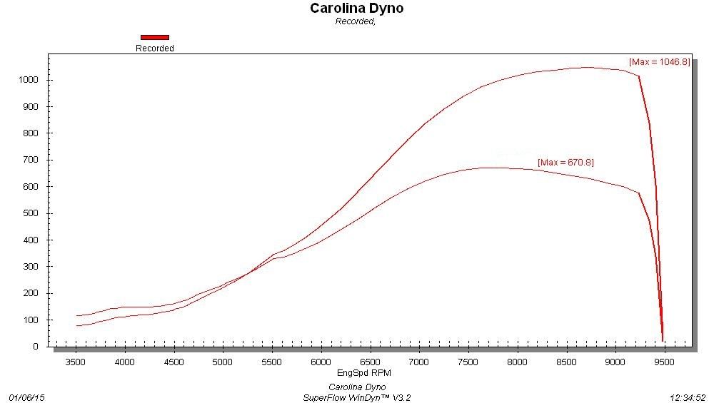

And its back in business, 3 psi less than when it made 1033 before. We will turn it up more at the track.

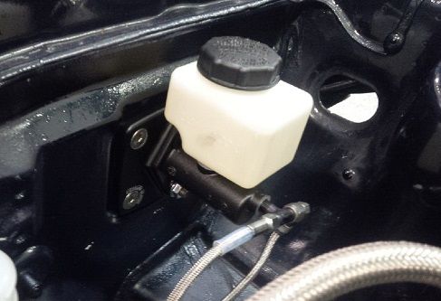

Motec going back in now, and swapped in a new master since car pulls almost no vac save some weight and clean things up.

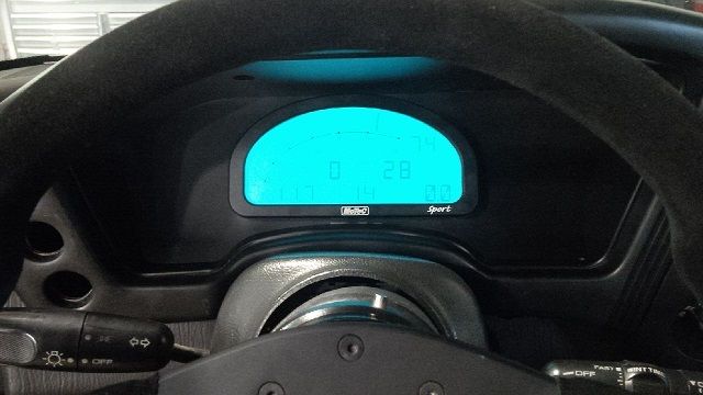

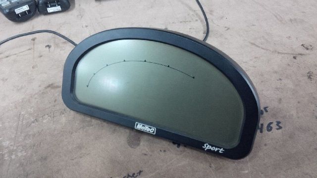

I'm assuming your dyno session was with the Motec ecu? Any insite on the chang over over experience. How easy was it to configure to the sensors, injectors, etc....Did you dial in the 2step, I've heard cars on Motech and the 2 step holds a very tight rpm. Awesome dash too!
Last dyno on the new motor was still on link as I wanted to see what the changes netted without adding the ecu as a factor.

Dash is in!
