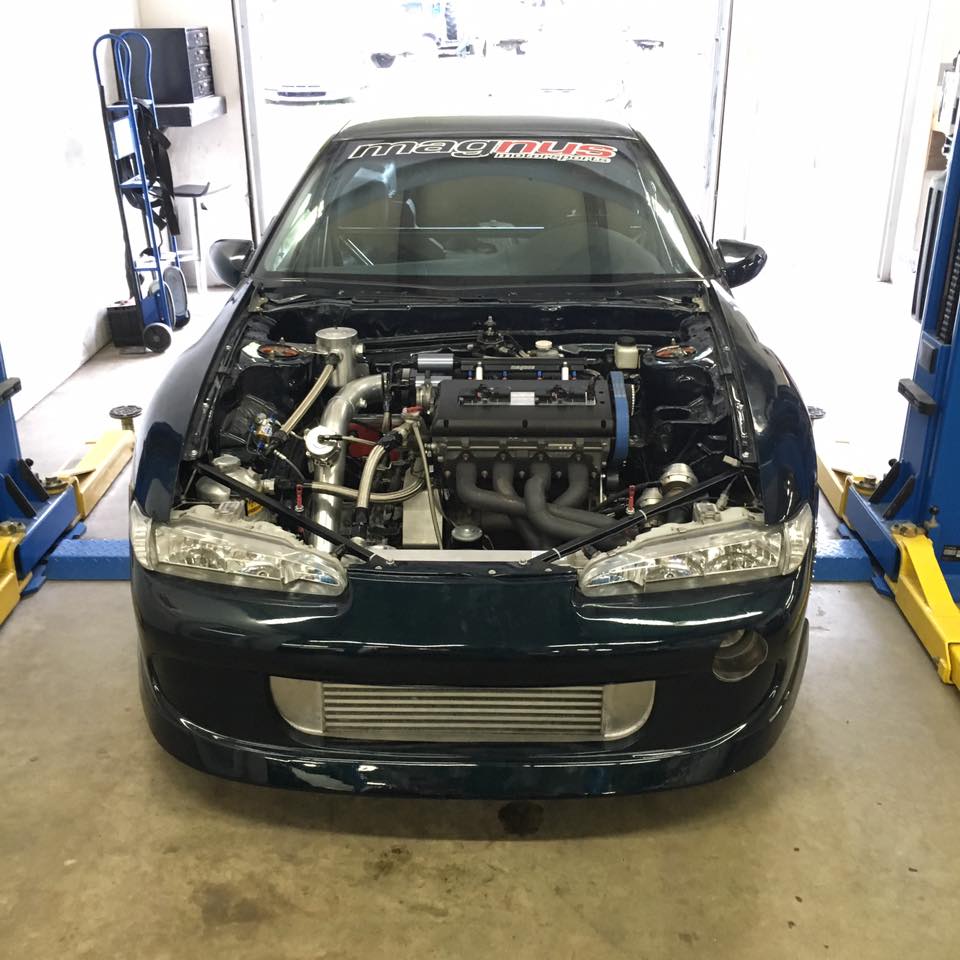

Sending the turbo off to Robert for a HTA wheel and then just a few small things. Wedding in May has put a damper on car spending for right now.
Still in wedding mode? Good luck with everything.
Haha, slowly recovering from it. 4505 is on the car, new three piece front end supposed to ship today. Need to dyno with the new turbo to confirm everything but it's over 100* right now and miserable. Hope to be done and at the track in two weeks.

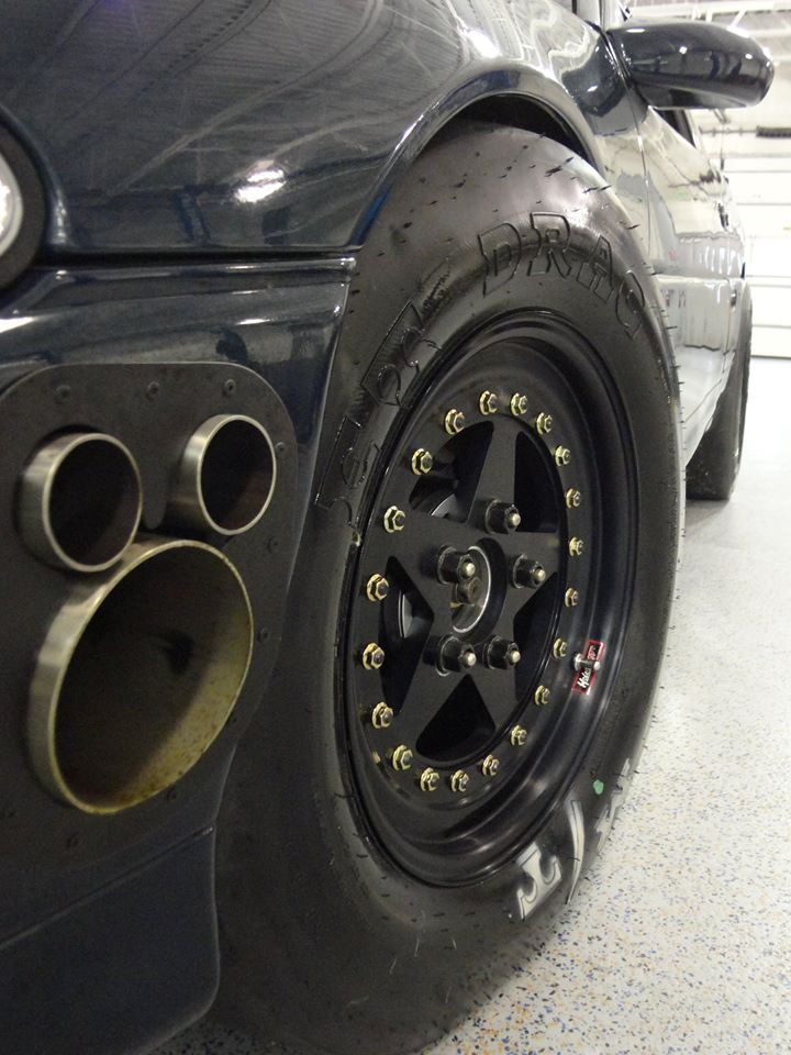

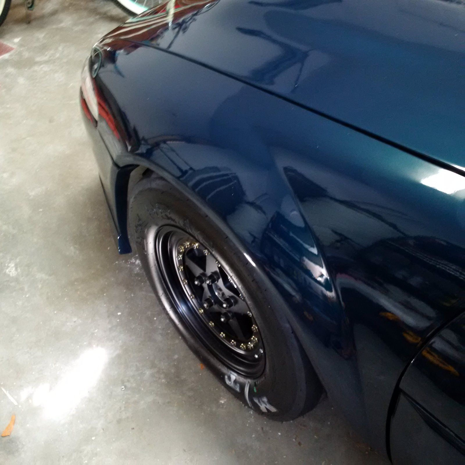

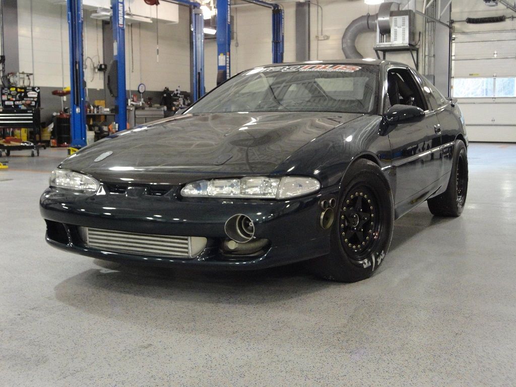

If you don't mind me asking, what brand/model are those wheels?
Thanks for the kind words, car was filthy inside and out because we rushed to get it there.
Wheels are holeshot holestars anodized black.

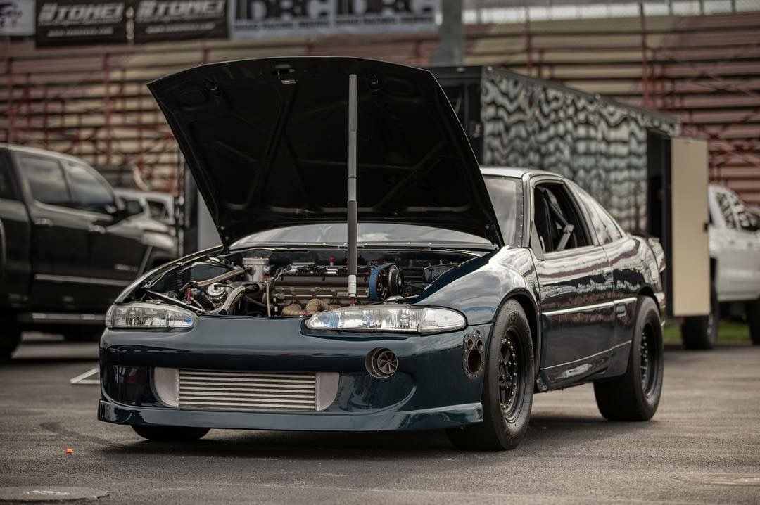

Unfortunately things didn't go as planned at the shootout but should be sorting it out in a few weeks. Car has me very excited after the one half pass we made.

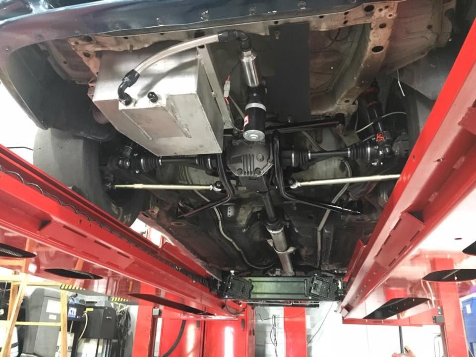

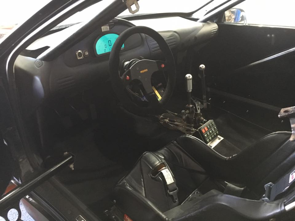

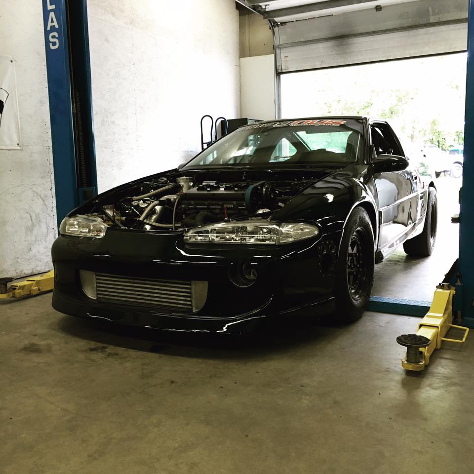

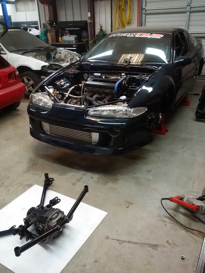

So at the end of last year and the beginning of this year I attempted to take the car out, on both occasions it broke the spider gears in the rear end. I let it sit for a while and decided the best course of action was to take weight out of the car and to upgrade to a larger rear end, the natural choice was the 3kgt rear end, slightly smaller than a ford 8.8 but proven in other cars running them. I also decided I wanted to go ahead and have a new harness built for the entire car and add a PDM/Keypad as well as a strain gauge shifter to help increase shift speed even more.

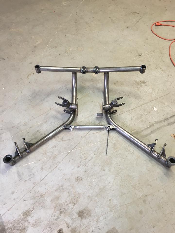

First Bruce at Carolina Dyno fabbed a subframe to hold the 3kGT diff, and Frank at DSS made some custom axles to accommodate it.

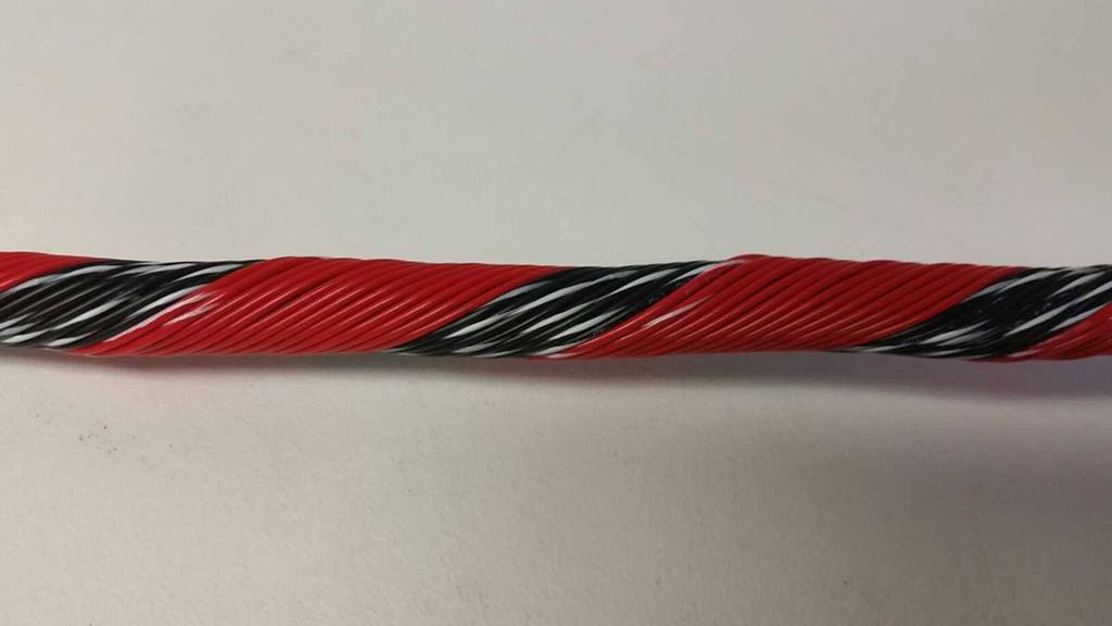

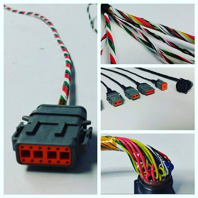

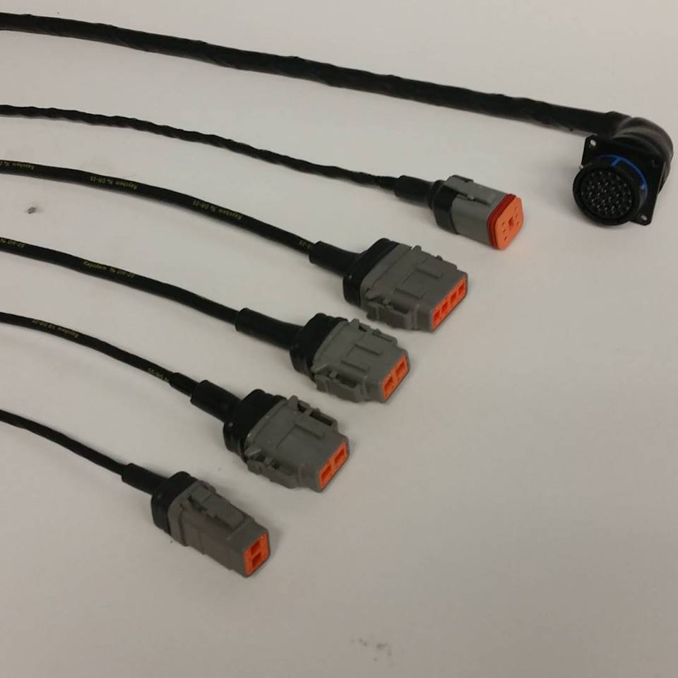

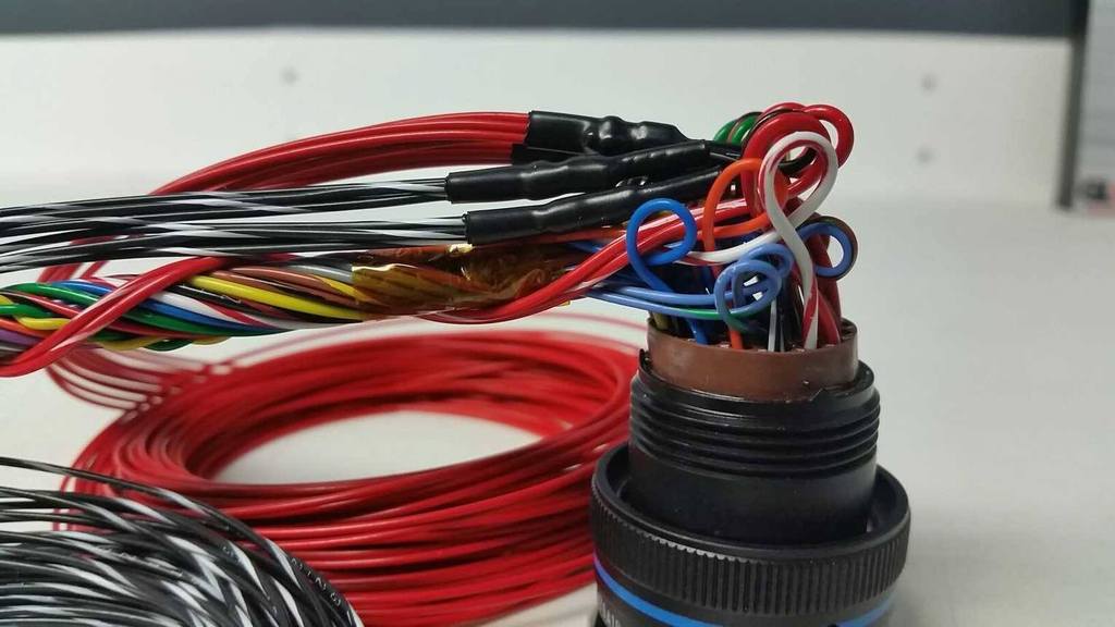

Once the rear was done we decided to take on the electronics, Ben Salasko of Salasko Racing fabricated an entire harness, including the PDM, Key pad and Shifter as well as the programing to make it all work together.

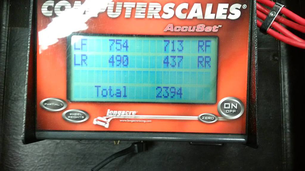

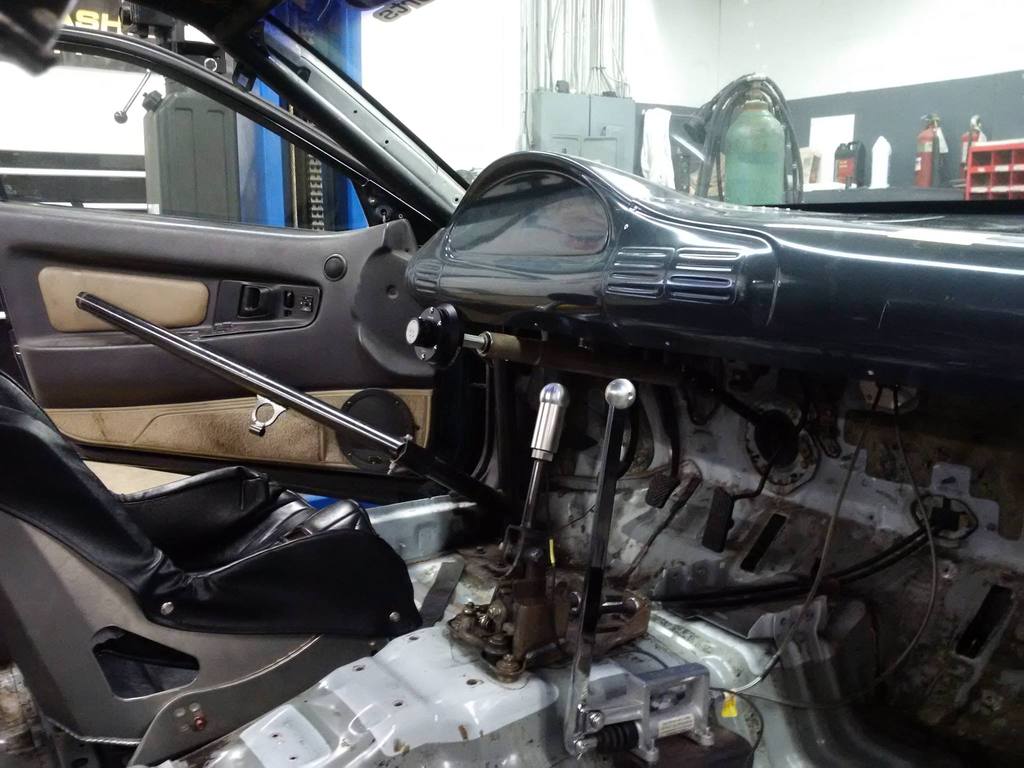

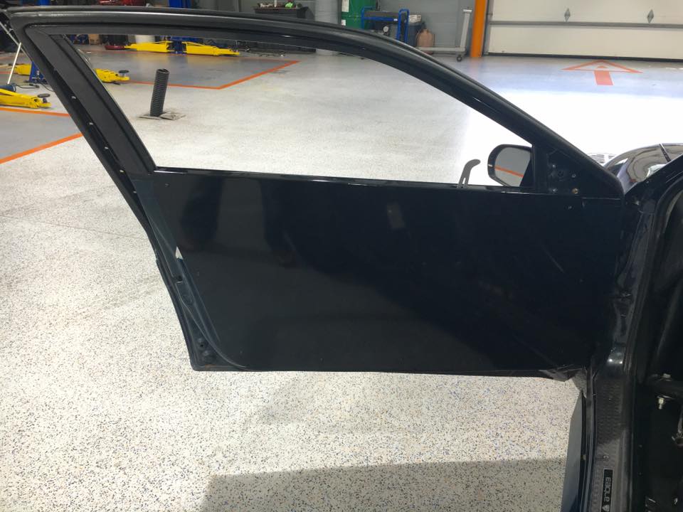

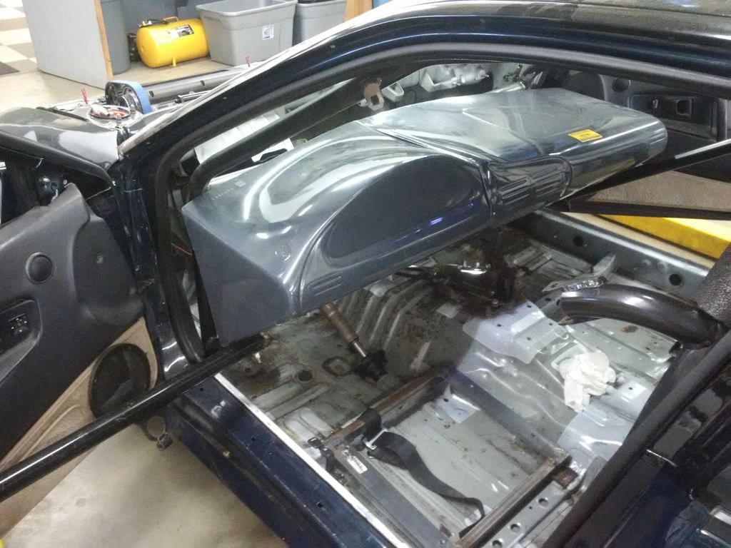

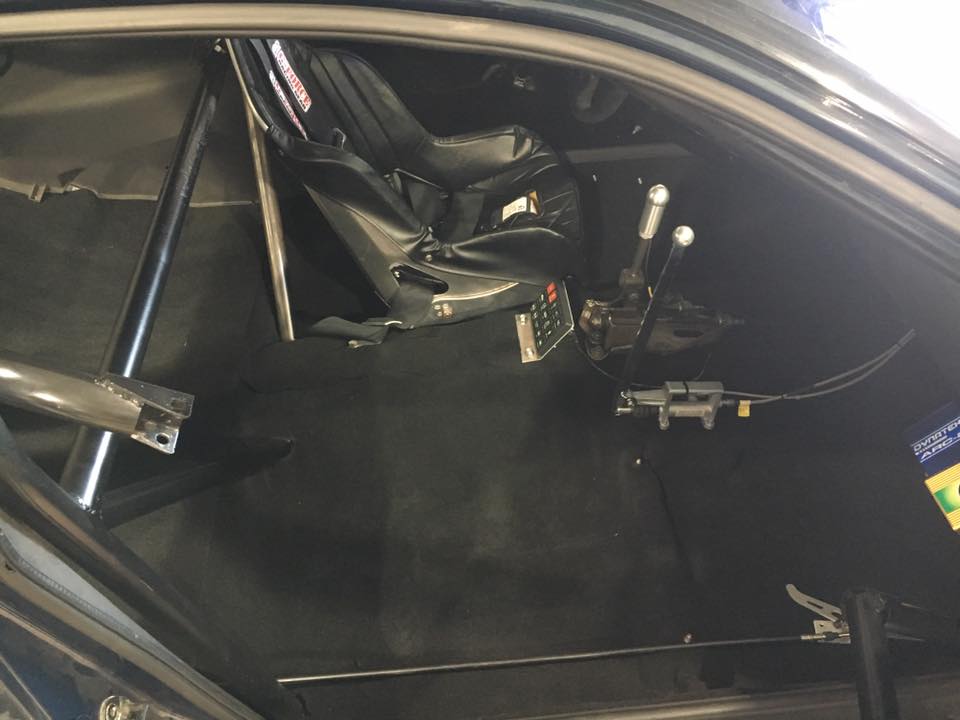

Next we continued to work on the weight of the car starting at 2560 without driver we lost some weight with the rear subframe but next we replaced the stock dash, door panels, stock dash bar, multiple other behind the scenes items and installed new carpet.
Then reassembled we loaded it onto the scales for the result.

That's a lot of progress, wow! I changed to the 3kgt rear-end and have not had any issues. I like the tube rearend sub frame. I wonder the weight difference between the factory vs the tube. Thanks for sharing and good luck at your next track session.
