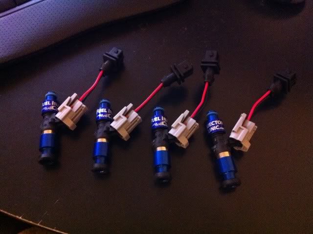

Nothing major. Long story short there is a known issue with the FIC/ID 1680 High Impedance injectors while running gasoline, apparently they heat the fuel a lot and cause flow pattern issues and cause the car to lean out. I was dealing with this issue on my car, and even though I bought these injectors used from someone on the forums FIC went above and beyond and allowed me to exchange them for 1 of 2 options.
Option 1: Get NEW 1100cc High Impedance injectors for FREE
Option 2: Pay $200 and get NEW 2150cc High Impedance injectors
1100's wouldn't be big enough so I of course opted for the 2150s, and I had them add the PnP adapters from the Bosch style plug to the factory DSM plug that are normally $60, they gave them to me for $50, AND they didn't charge me shipping! Talk about stand up guys! I recommend FIC to anyone looking for injectors, their prices and customer service are top notch!
And this is what it feels like to own $800 injectors Never in a million years would I think I would need 2150cc injectors!
you will enjoy them! i started my car for the first time last year on the old setup and she ran under her own power with a poor baseline. The linearity of these injectors is sooooo smooth.

Hey EclipseOwner95,
Glad you're excited about your new injector set! They should be great for your setup on E85 and I'm glad we were able to help you out with everything.
I just wanted to clarify that the injectors aren’t heating the fuel and causing an issue – the fuel (particularly gasoline) being heat soaked by ambient engine heat in the head and manifold is where the true issue lies. It is also compounded by double-pump setups, surge tanks, and fuel returned directly to the pickup area (cycling through the pump continuously.)
During testing conducted by an independent petro-chemical engineer it was discovered that at high fuel temperatures (above 140F) the injector experiences a reduction of flow that is not linear and therefore there is no way to tune around it. This issue does not seem to present itself very often on E85 cars, presumably because the cars run cooler on E85 and that the amount of fluid flowing through the injector is greater and therefore keeps the rail cooler.) Many folks are happily using the 1680 injectors still but we haven’t had any new stock in awhile so have pulled the listing from the website.
In fact at the DSM / Evo Shootout we actually had a chance to race and ride along in Tom Dorris' DSM (running E85 on our 2150cc injectors) where we logged fuel temperatures through his 6 heat auto-x session and fuel temps never went above 100 degrees out there.
Sorry for the long post, just wanted to clarify the situation with the 1680s for you and anyone else reading... keep up the great work with your car and we'll look forward to seeing you out at The Shootout again next year.

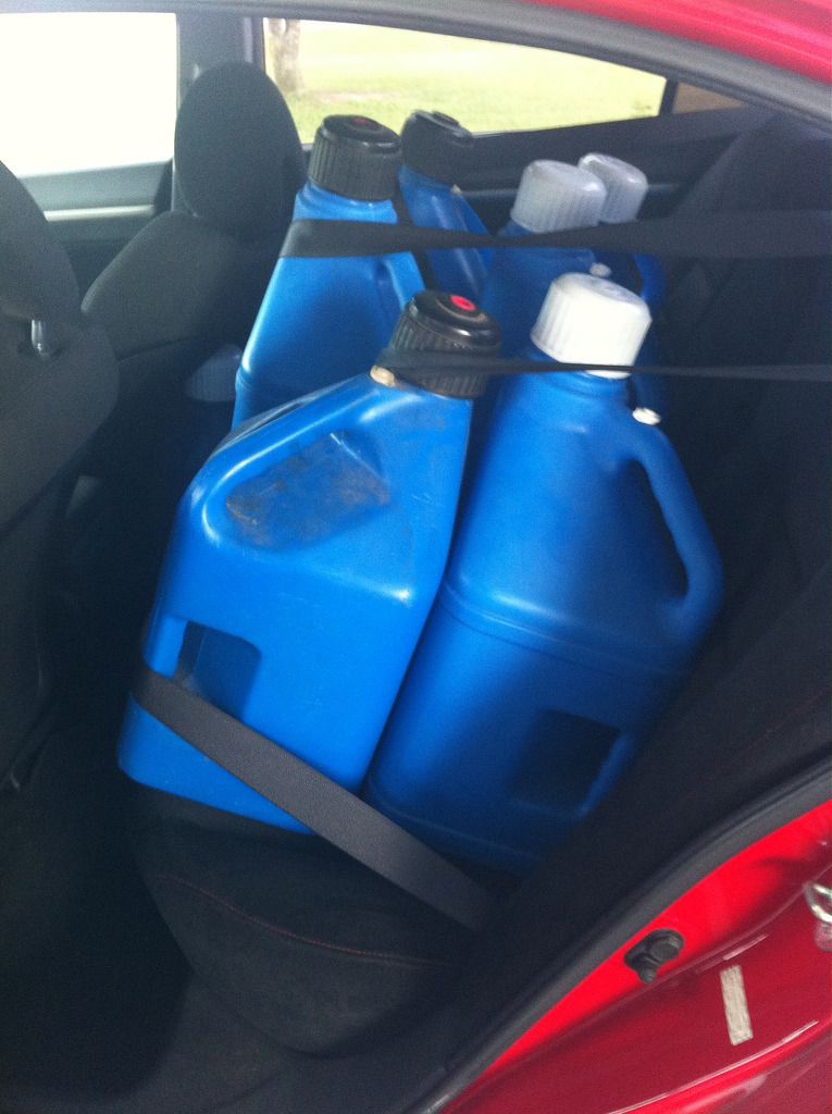

I went to the closest E85 station and stocked up for a few weeks, closest pump is about 45 minutes away and man the car really woke up. Car is on a rough tune running 32psi and 12* of timing.

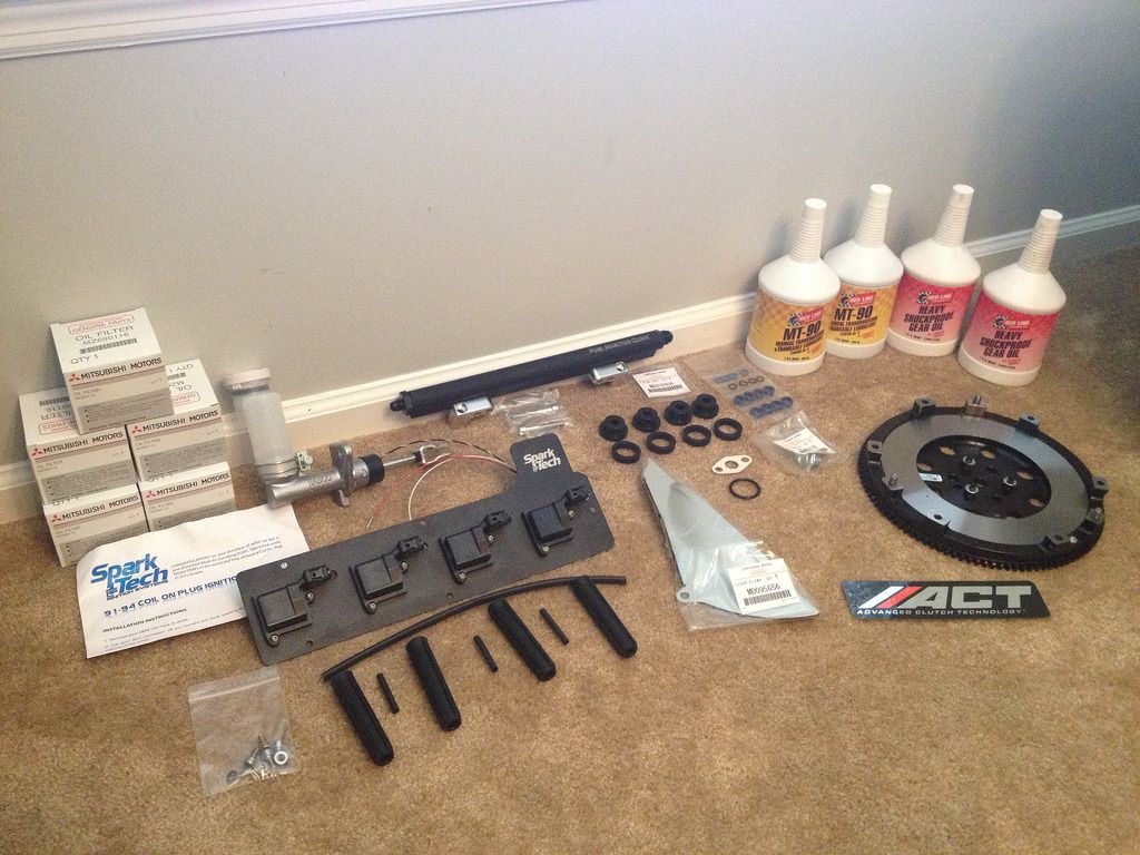

More parts! Big thanks to my favorite vendor ExtremePSI, One stop shopping for OEM and Performance parts alike at great prices! Glad to give my business to you all!
