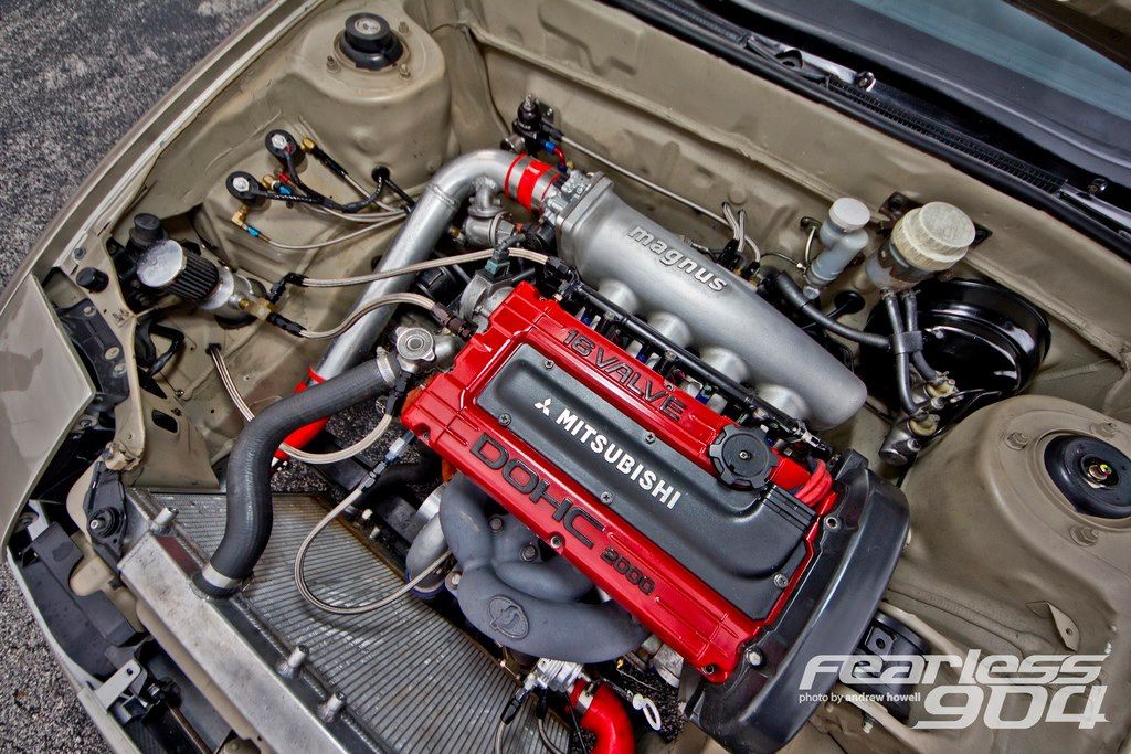

im sure home-boy is runnin a pir of "pusher" style fans on the other side of the radiator that you just cant see in the pics.
Haha - You are correct sir. I have 2 12" SPAL fans in front of the radiator in a Push configuration.
Between the Fluidyne and a bypass valve instead of a thermostat the car stays plenty cool even with them pushing.
