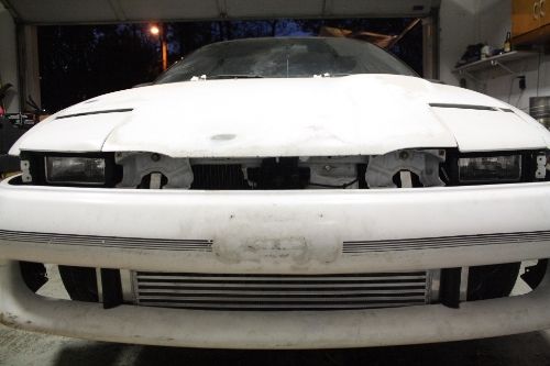

Mounted the front bumper and everything looks good. Need to figure out how to get the foglights to fit though. Don't like having those huge empty spaces. Anyone have some tips?

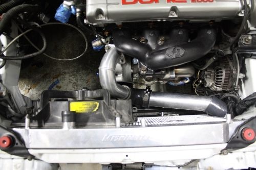

Radiator was a bit thicker than the stock one and would come in contact with the intercooler pipe. So I just used a spare coupler to protect the pipe. Hopefully it holds up.

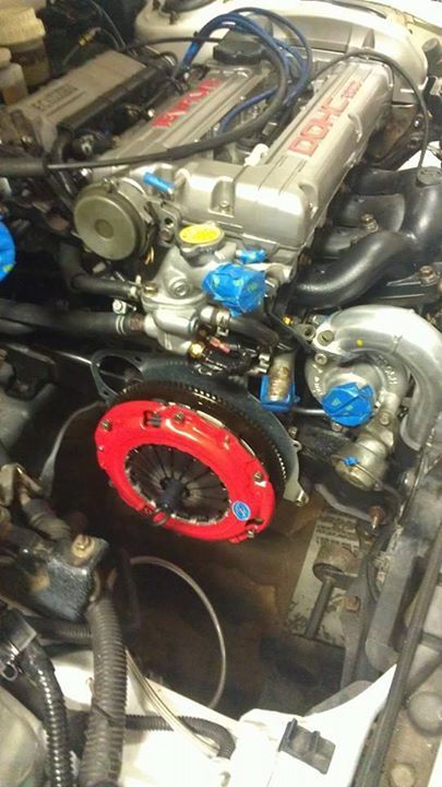

With working 6 days a week I haven't had the time to work on the car much. But I was able to install the ACT streetlite flywheel and Southbend clutch last Sunday. Hopefully this Sunday I can install the transmission, tcase, axles etc.

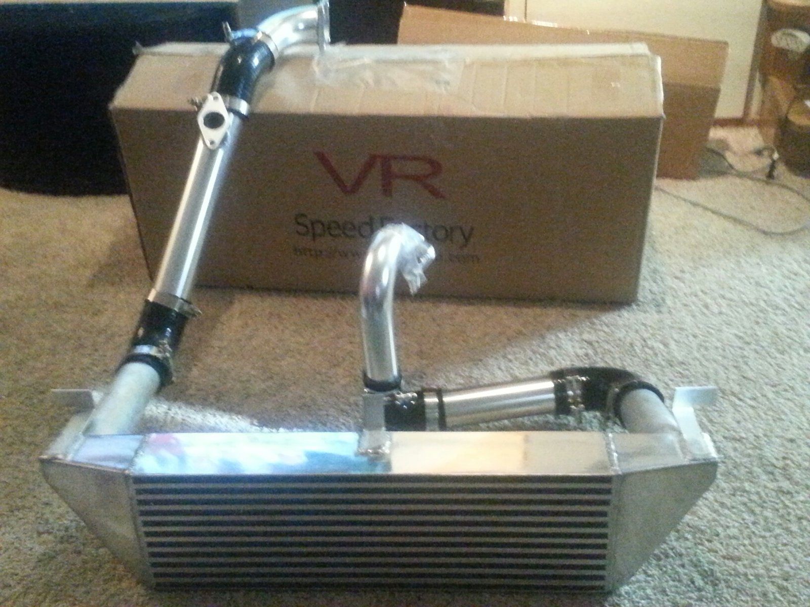

Sure looks familiar....same VRSF kit (but no problems with mine, I did a write up when I installed mine and I have the Mitsumoto radiator too), same clutch and flywheel too. You are making me anxious to get mine going again also. Nice build, keep us posted! :thumb:

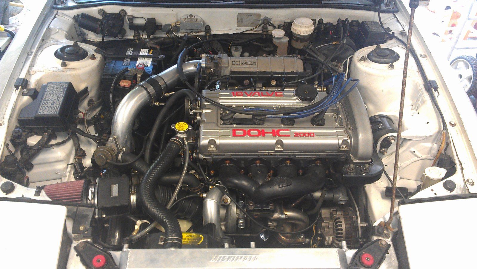

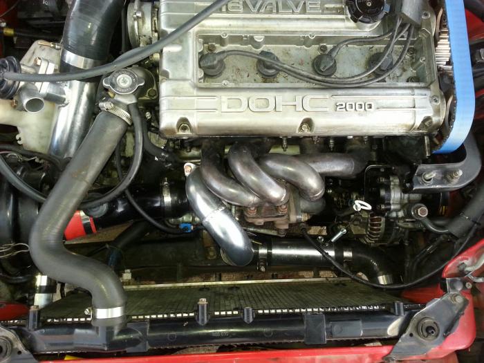

Picture of my engine bay with the intercooler installed:
http://www.dsmtuners.com/attachments/engine-bay-2-jpg.165157/
See this for the little things that I ran into with my '90 and I kept the factory fogs:
http://www.dsmtuners.com/forums/art...all-keeping-ps-cooler-factory-oil-cooler.html
It's actually the Punishment Racing FMIC, so its routed a little different. It's a great combo and can't wait to drive the thing. Thanks!

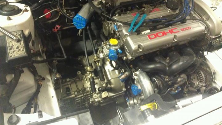

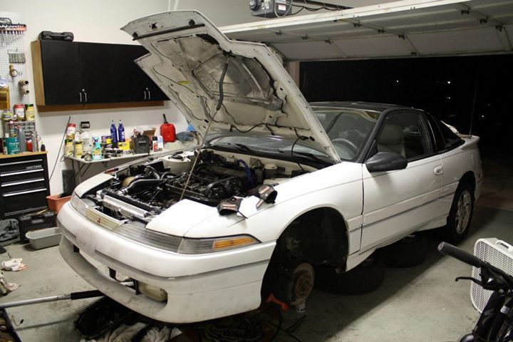

Been in the garage all day sweating my ass off with this humidity. Replaced the driveshaft yoke with a new one so the tcase won't leak. Did it while the driveshaft was still on the car so that was fun..... Also installed the transfer case. I'm gonna be sore tomorrow.
Spent another day in the garage. Adjusted the clutch master and what a pain that was by myself. Also installed a new radiator fan switch, reverse switch, filled the tcase with lightweight shockproof, and added coolant. Of course one of the old hoses (thermostat housing to turbo) had to leak so I will need to order another one.

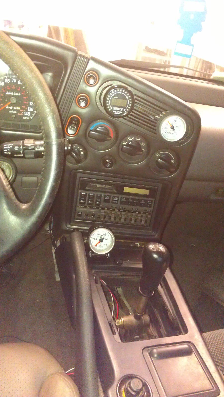

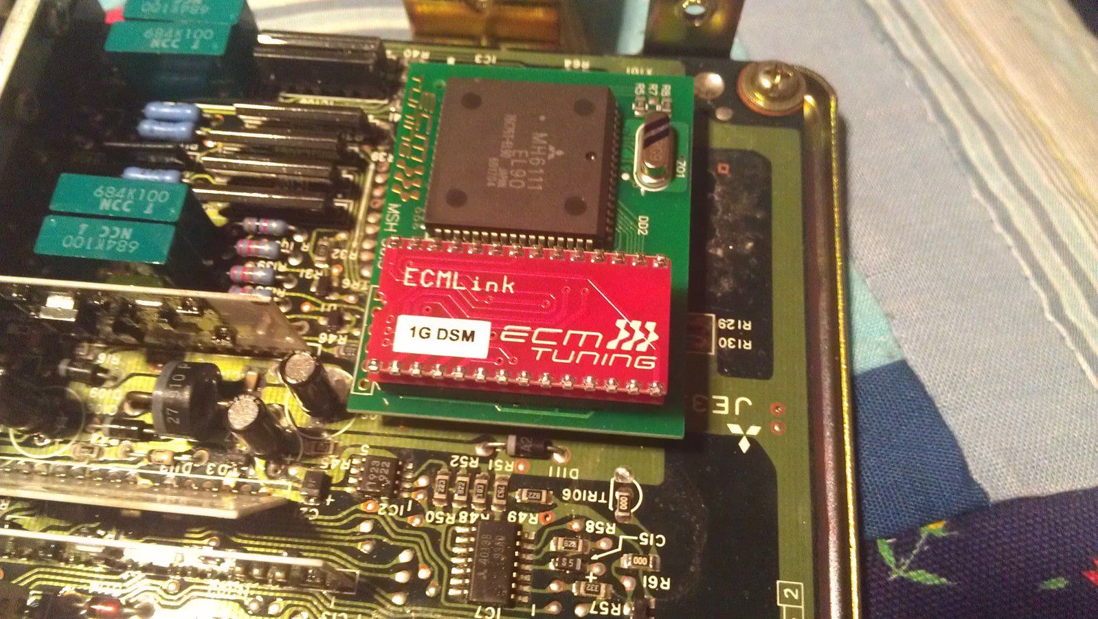

Spent a bunch of money on the car recently and did a few things.
Ecmlink v3
Evo8 maf
Evo8 to 1g maf harness adapter
Autometer oil pressure gauge
And installed the oil pressure gauge in place of the useless coin holder.

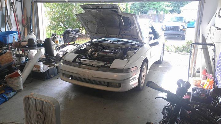

Haven't updated this in awhile. But I started her up on Sunday. Had it run at 2000rpm until it got to operating temp then I turned her off. Need to fix some leaks and start it back up and let it idle to adjust the ignition timing and whatnot. Was running open downpipe and surprisingly no neighbors complained.
Car is now 100% legal after dealing with miles of red tape with the dmv. Tomorrow I'm getting some new tires and I can finally drive it on the road. Although with an open downpipe exhaust I will probably get pulled over as soon as I pull out my driveway.
