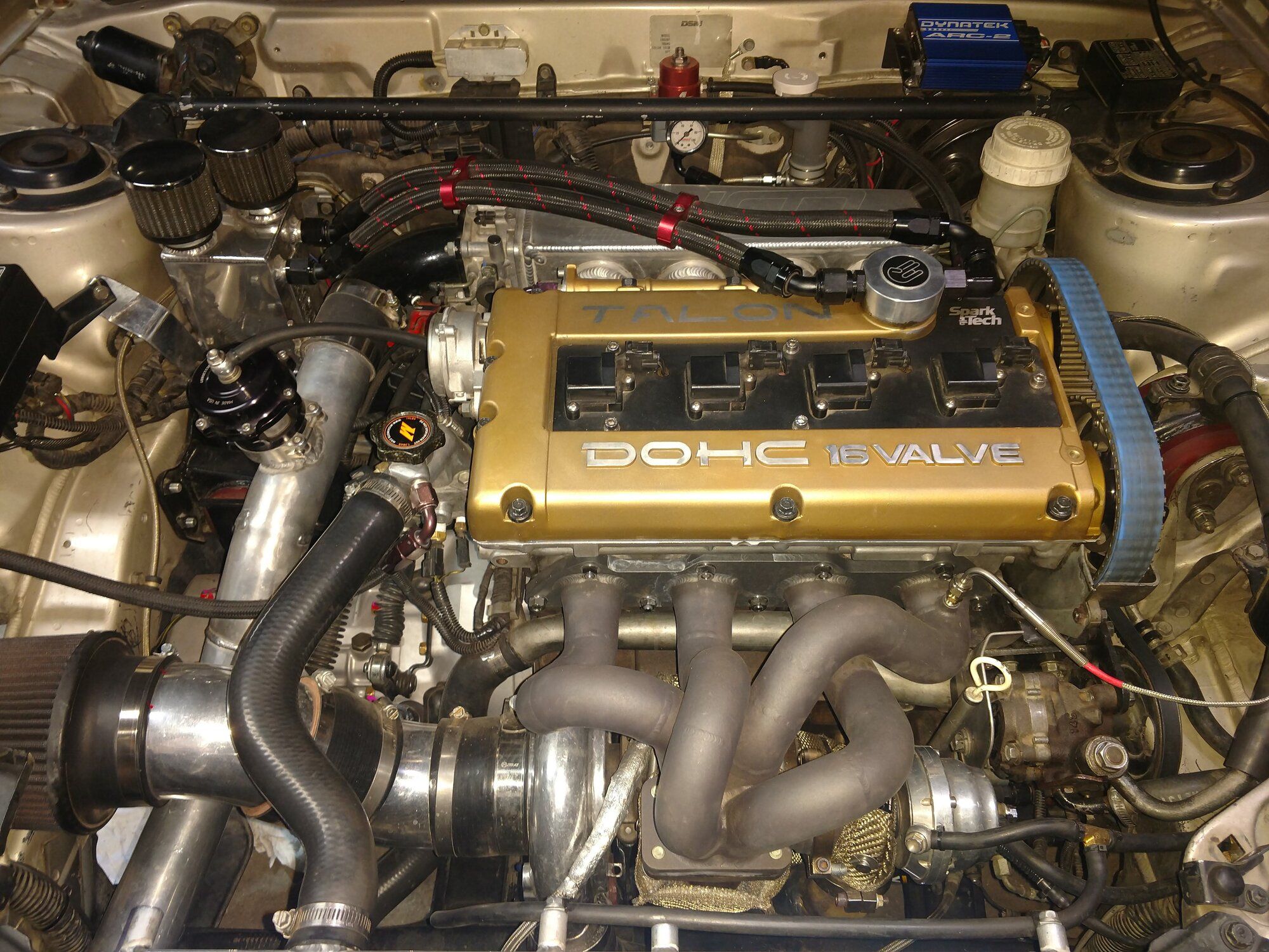

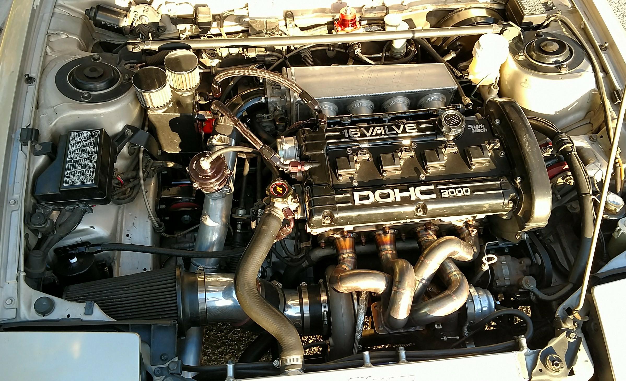

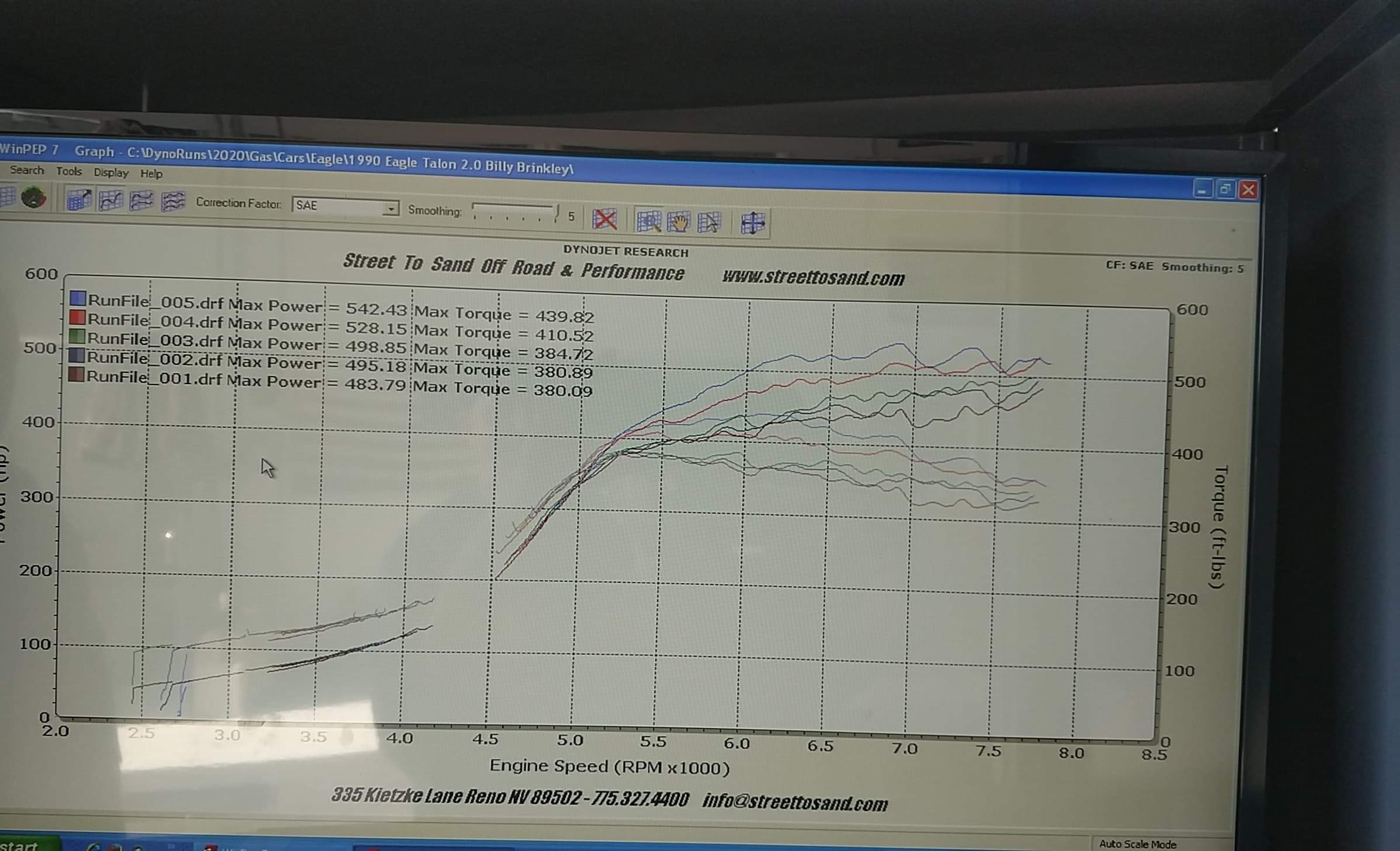

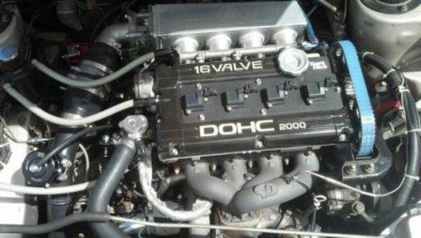

Well, the H1E finally died again. Decided to go with the HX40 this time. 60mm 7 blade with upgraded 67mm turbine. Milled out the .70 BEP housing for it to fit. Hoping this will keep the lag down.
