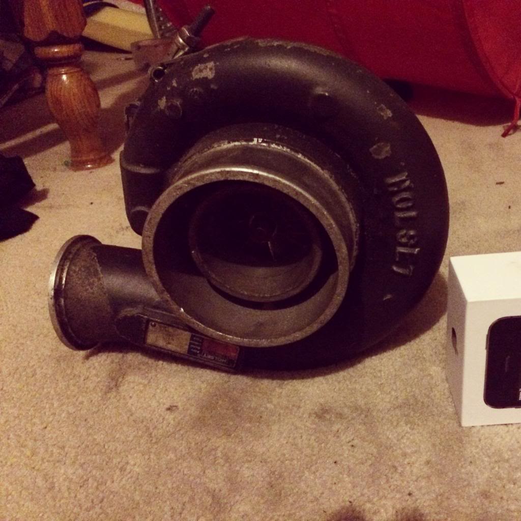

here is how she currently sits, with a blown up evo III 16g. not quite sure how it blew up, i just started it one cold morning and it was smoking like crazy. always let the turbo spool down and the engine idle for about 30 seconds before turning it off. parts from FP are on order to rebuild the 16g, and in the mean time...my holset h1c is at the diesel turbo shop getting inspected and rebuilt as well. which will soon replace the 16g.
