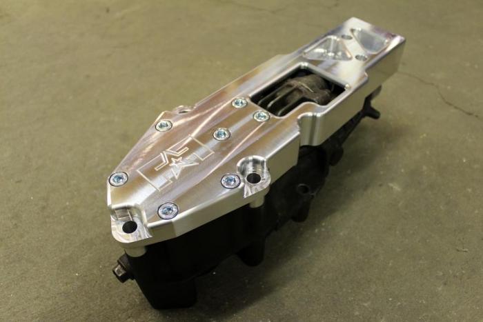

Yeah, i've been looking in to the T-case brace and rear diff cover. I actually just got a PM back from Frontline about them.. Transfer case braces are $475 and rear diff covers are $415.
as for right now, i'm just going to focus on getting that tcase brace i think. i've heard great things about that unit. i clears everything nicely, and obviously works too. i forgot about the two other things i need to look into getting for the car. i'd like a set of 272 cams... either from kelford or dks (both seem to have good reviews). also, i need to go speed density most likely. my 2g maf has nothing left.

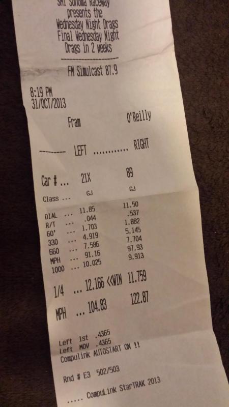

Well I went back to Sonoma raceway tonight and ran a new personal best of 11.759 @ 122. This time around I just tried a couple suspension tweaks to get the front wheels to hook better. My launching is definitely improving, the best 60' I was able to pull on my street tires was a 1.777 sec. I missed 4th gear 2 of the 4 passes and I ran between 12.1 and 12.3 until the final run.
I basically just changed the settings on my rear agx struts all the way stiff to 8 to keep the weight transfer from the front to the rear to a minimum. Basically at 11.5 or faster im going to have to add more safety stuff. So I have a feeling I should be doing some research on what exactly I need to do pretty soon. I was also told by the tech that if I trap 135mph or more I think I need a roll bar. Luckily for me, I dont think ill be trapping that quite yet.

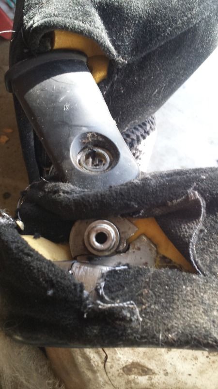

thanks for the kind words dude. here's a little update… so last time i was at the drag strip i did manage to break something on the talon, the seat. LOL. i'm not sure why this happened, maybe it was already broken and the launching is kinda what did it in. but since the seats are the color they are, and there not being many wreckers in the immediate area, i just opted to weld it… here's a pic of the broken part, its the part where the back hinges on the bottom where you would sit on.

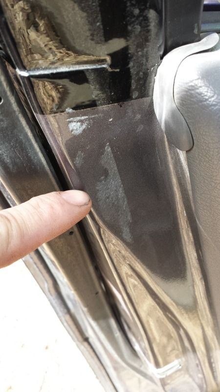

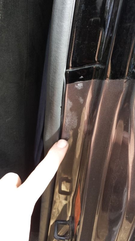

and then there was another odd thing happening. the door jamb started to rub, and this was only after i started really launching it. so, i'm guessing its chassis flex from that. so, my fix of that problem for now will just to add some kind of cushioning to that to keep that slightly under control… below are pics of that, maybe someone else has had or heard of someone who had this problem.
here's the door

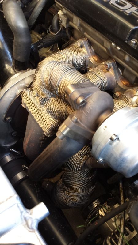

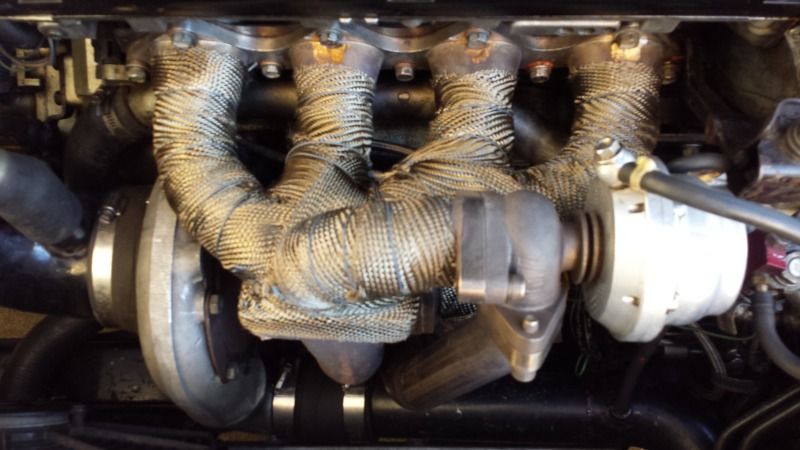

and last but not least, my most current timeslip and most current mod, the titanium wrapped exhaust manifold, and downpipe.

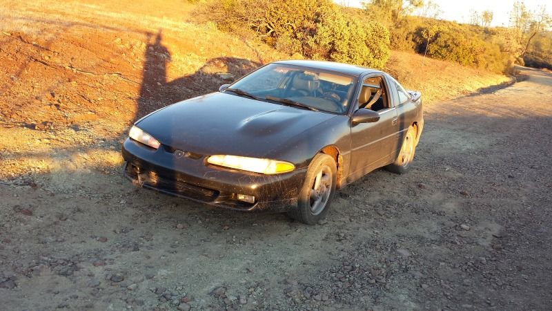

here's a little bit of an update from whats going on with the ongoing build. so, i went and bought another dsm... which i think is probably a very common thing for a dsm owner to say. LOL. this one is basically stock. all it has in it are the ipt clutches, and maybe a shift kit. its a 93 talon tsi awd auto. it only has 125k on the clock, so, it should make a great donor for my 91. the only reason i bought it was for its transmission. and it had all the parts i would need to swap over. since its all stock and not fast or super nice in any particular way i decided to take it off road to see how it would do...
aside from the ground clearance being a little issue it did pretty damn well, i wish i had some more mud to blast it through. but it definitely made it up some stuff that it didnt look like it would be able to climb.

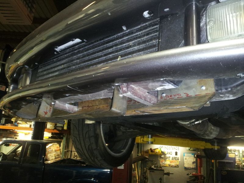

the scoop did the trick, and its working quite well. coolant temps are down pretty much under every kind of driving, and now the car doesnt run warm at all. once i'm comfortable with the ground clearance, and confident that i wont have to adjust things anymore. the scoop will be painted flat black..
Can I get some more pics of the scoop? I'd love to see how it was done, I want to do the same thing to my car.
Thanks!
erik, now that i have the car up and running again, i'll try to do that for you. sorry for the late as hell reply, but i'm gonna be posting more updates in here now.
