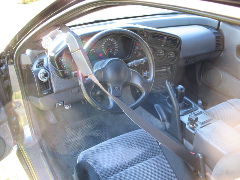

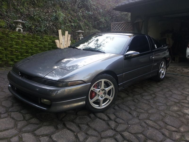

hello, i figured i'd start one of these threads to kinda document the process of building up my 91 talon tsi into a fun daily driver... here are a couple of pics of what i'm starting off with.
you can see my car's mod list under my profile... its kind of long to type it all out. but basically the goal of this car is to have all of the creature comforts and still be able to make a reliable 500-550awhp whenever i want to run e85. since its going to be a daily driver i plan to run it on 91octane. i also want this thing to be as reliable as possible, and able to be at home on a race track too. so, here's what i have planned.

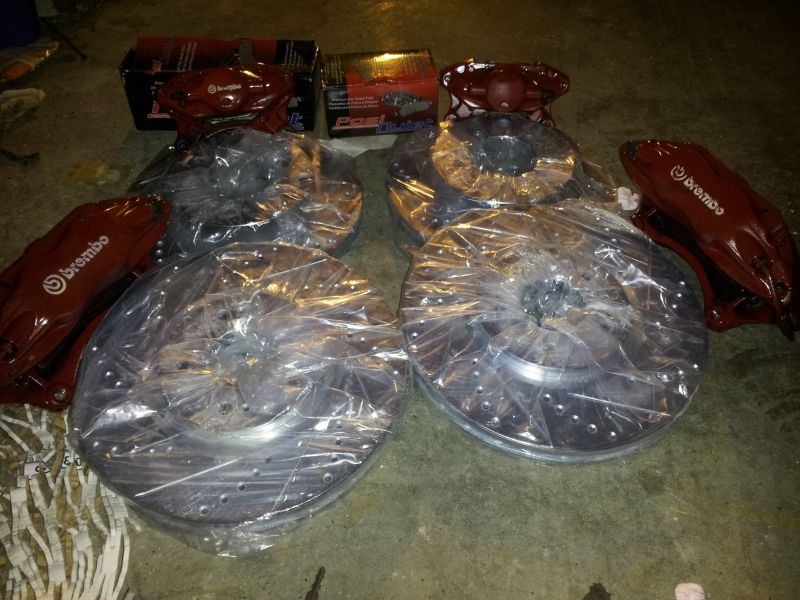

brakes, i'm picking up some evo brembo calipers and the brackets from a member on here. and then i'll probably pick up some stock evo blanks from napa since i've heard good things about them, and they're well priced. i should have all of this within the next few days i hope.

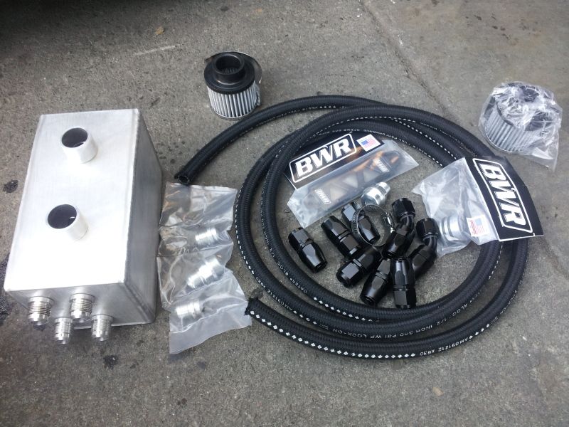

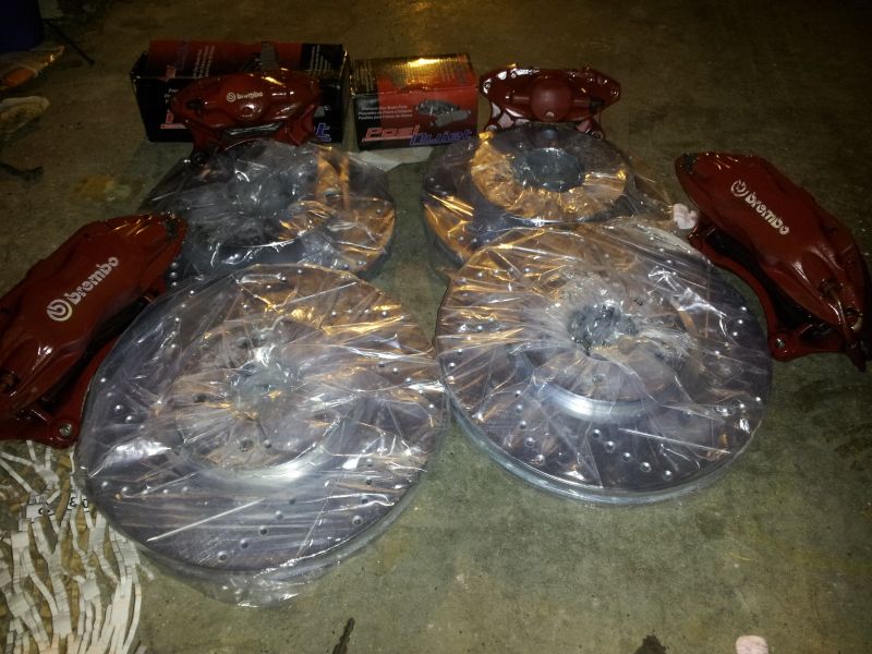

so i've decided to post a few pics up of the parts that have been slowly coming in... so far i got a fancy catch can that came with nice -10 fittings and reinforced braided hoses. then i have all of the evo brakes, minus the 1g conversion brackets (still in the mail).

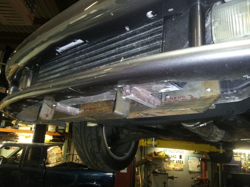

also while driving the car up my local stretch of twisty roads i noticed that my car would start to run warm after a few miles of hard driving. i determined that the cause of this was from the large front mount intercooler blocking the airflow from the radiator. so, i made a scoop from sheet metal.
the scoop did the trick, and its working quite well. coolant temps are down pretty much under every kind of driving, and now the car doesnt run warm at all. once i'm comfortable with the ground clearance, and confident that i wont have to adjust things anymore. the scoop will be painted flat black. jacks transmissions are still building my transmission, so, that's not here yet. i'm guessing it'll probably be another week or so before i get it. but its about time i go buy a twin disc clutch. i'm thinking of going with the act kit now. then i'll have to source some 3000gt rear trailing arms so that i can run the evo brakes out back. oh well, so far, so good.

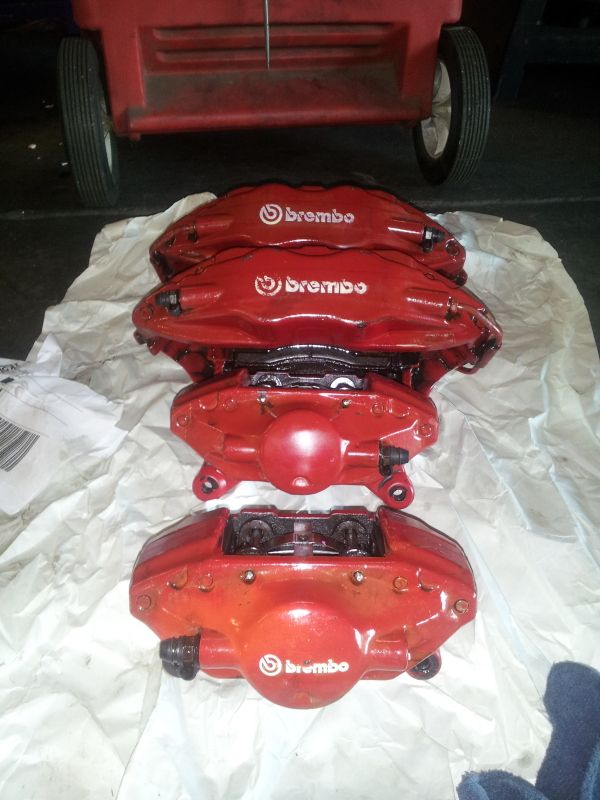

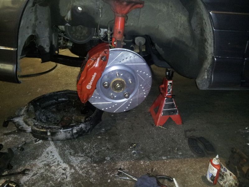

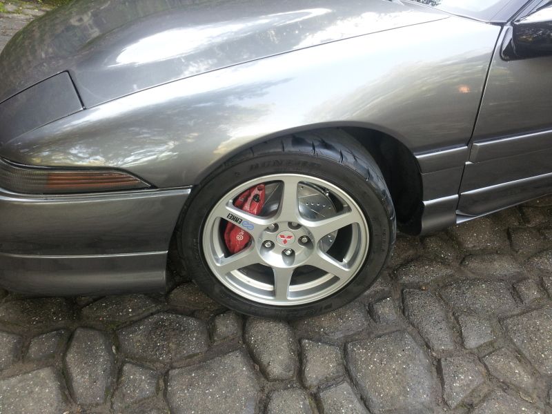

thanks again for the kind words! the bov is pretty damn quiet... it barely even makes the woosh sound. the most obvious sound that my car makes is the typical borg warner sound when the turbo begins to spool. today, i installed the front evo brakes. i ordered the brackets from kmv (i think that's his name) on here. well, i had to do quite a bit of grinding to make things fit... the brackets themselves needed to be notched and then the calipers needed a large bit notched out. it took me a few hours of steady grinding to get things to clear. doing the calipers was the crappy part. you can kinda see all the shavings on the ground in the pic. i'll take pics of the brakes with the rims installed tomorrow probably after i get the car all washed up. and then next are the rear brakes after i get my 3000gt trailing arms. but for now this will do. here's a pic of the install... oh yeah, i found out my jacks transmissions unit is on its way in the mail. i also purchased a quarter master twin disc clutch.
here are a couple more pics showing how it looks on the car.

Just a heads up. Having that scoop routed like you do is probably going to affect the performance of your front mount because any air that's forced behind the intercooler is going to make it difficult for air to pass through the intercooler. The thing is it might not be a problem now, but if you're looking to push your turbo to the limit it will cause you problems. The last thing you want is your core to heatsoak while the motor is at the edge.
The best way to keep your coolant and intake temps down would be to duct the intercooler to the radiator. There are some good thread on here with instructions, and it can be done fairly easily and cheaply. Just search for fmic ducting or radiator ducting and you should find what you need.
Good luck with your build, and have some fun.
that's kinda what we were thinking of doing with that problem. the scoop i guess sounded easier to do at the time. it does work great, but i would like to have the ground clearance back in the front. the rest of the car pretty much clears the worst speed bumps i can find otherwise. and the evo front brakes are working awesome, the car stops very nicely. even on the stock booster/master cylinder combo the pedal feel is very nice. my jacks transmissions unit arrived the other day, so, i'm just waiting for my twin disc... after that i may pull the whole engine/transmission so i can fix the oil leaks with the engine, and replace my steering rack too.

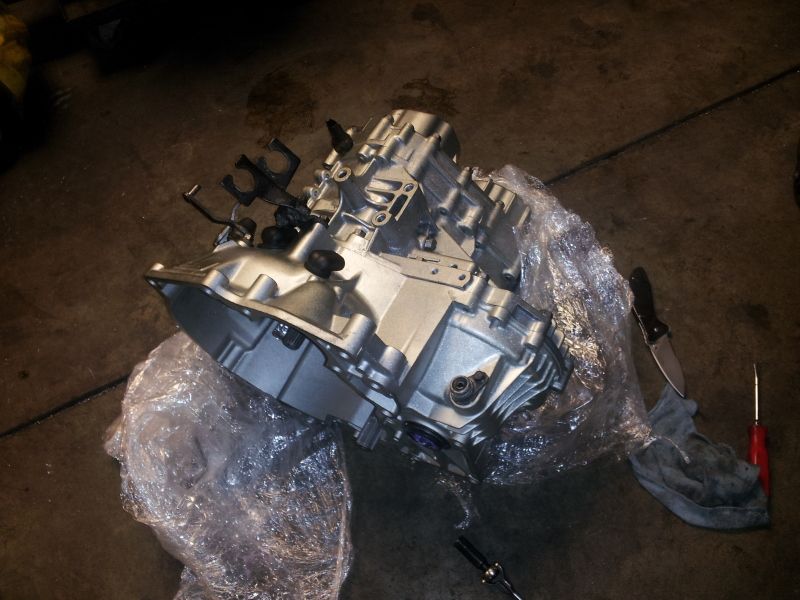

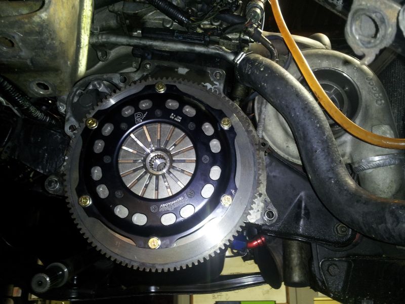

time for a real update... well, i got the transmission and the twin disc installed. the car shifts much better than it did. i still wouldnt call it silky by any means, but a vast improvement. i only managed to snap 2 pics since i was in a major rush getting this thing done since we were working after hours at my buddys shop.
here's the jacks transmissions "ultimate ratio" stage 4 unit with all of the stuff swapped over from my old transmission.
and here's the twin disc all torqued down and ready for its new home inside the bellhousing.

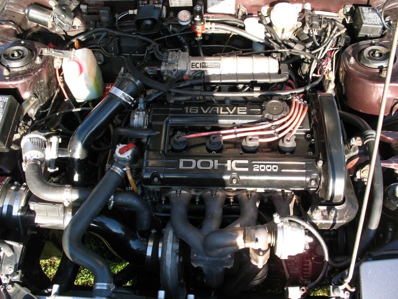

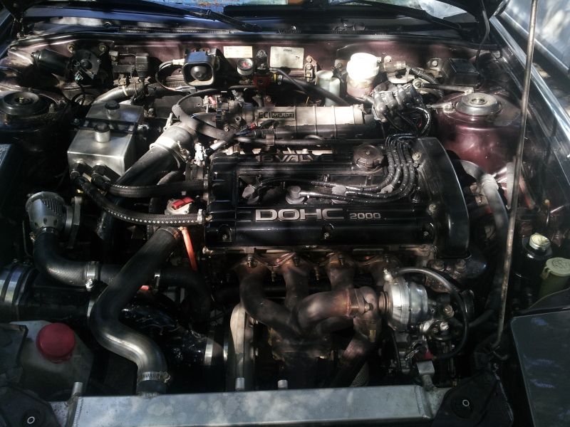

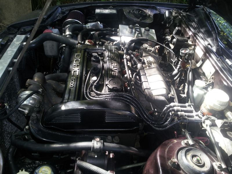

recent underhood pics, there are still things i want to address... but one thing at a time.
New plug wires are you friend... Moving the coil pack may bandaid the problem but in the end the problem will still be there. A lot of people use NGK wires. They are relatively cheap and OEM quality. I went with Accel on mine. COP is a good choice but a much much larger investment.
