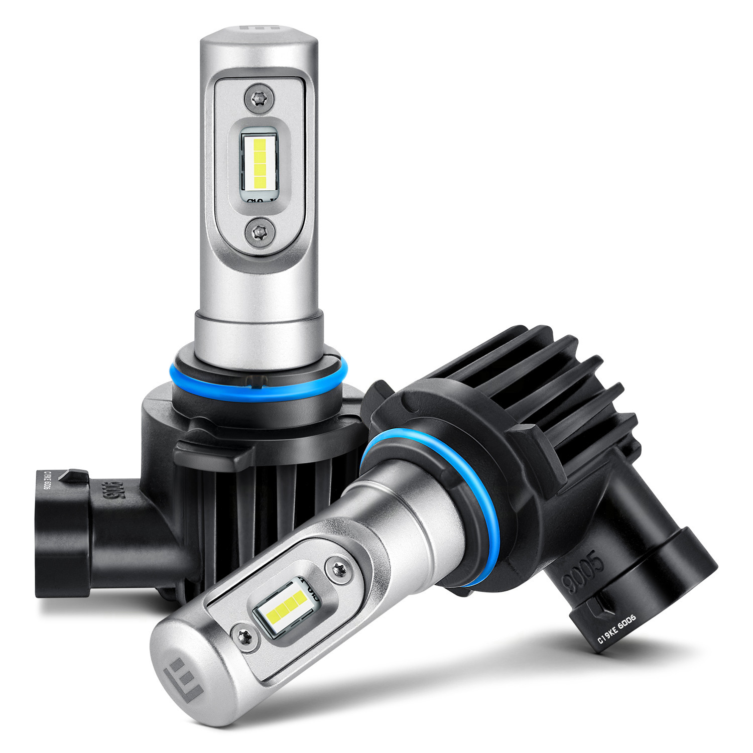

This is what I installed in my 2gb, and I can see absolutely everything. The factory headlight optics are actually pretty good, but you won't really improve it unless you replace it with a projector of some kind. This kit would be easier to install, is slightly cheaper, and is nearly as good.
You can install 9005 high beam bulbs into the 9006 low beam slot with some trimming. High quality halogen bulbs are as good as you can get in the factory housing. If you're not able to spend the money or aren't willing to put in the work to retrofit your headlights, my recommendation is a quality 9005. It really is the best you can get in the factory housings. Trimming instructions:
The factory optics are pretty good when used with halogen bulbs. You can install PnP HID kits and LEDs which are brighter, but the housing is not designed for the way that HIDs produce light from a single point and the way LEDs produce light from several individual points. They stop distributing light where it needs to go. Output is overall brighter, but it is actually harder to see because the light distribution is uneven. At first glance it looks better because you get a blob generally in the middle that is brighter than everything else, but everything else is dimmer.
The factory headlight color is 4000-4300k. Going higher than this would be a downgrade in terms of visibility, as the human eye prefers warmer color temperatures in dark environments to be able to comprehend shapes. 5000k is generally accepted as the highest that you can go for a functional, bright bulb. The 6500k bulbs you linked would be a poor color selection if your goal is visibility. And I don't for a second believe their 4000lm claim for a fanless 9006 LED. That much heat would kill a diode in seconds.
The LEDs that you've linked are interesting in that they try to emulate the 9006 filament pattern which is definitely a good thing. But you're still held back by the factory housings and that price is more than halfway to a low end projector kit, which would be a massive upgrade over even those bulbs.

Going thru the same process on my 99 Spyder GST. For me it seems like the replacement halogens is the right option. So to complete the process, does one replace both the low and high beam lights at the same time? 9005 and 9006? And does one mess with the red lights as well? Does replacing that bulb have an impact on the look? no right? And in addition to new bulbs, I assume one polishes the outside surface (per kits like 3m highlight refurbishment ultra)? Is there something else that people do?
You can do 9005 high beam and 9006 low beam, or 9005 in both and trim the low beam according to the instructions above. You might as well do both at the same time.
