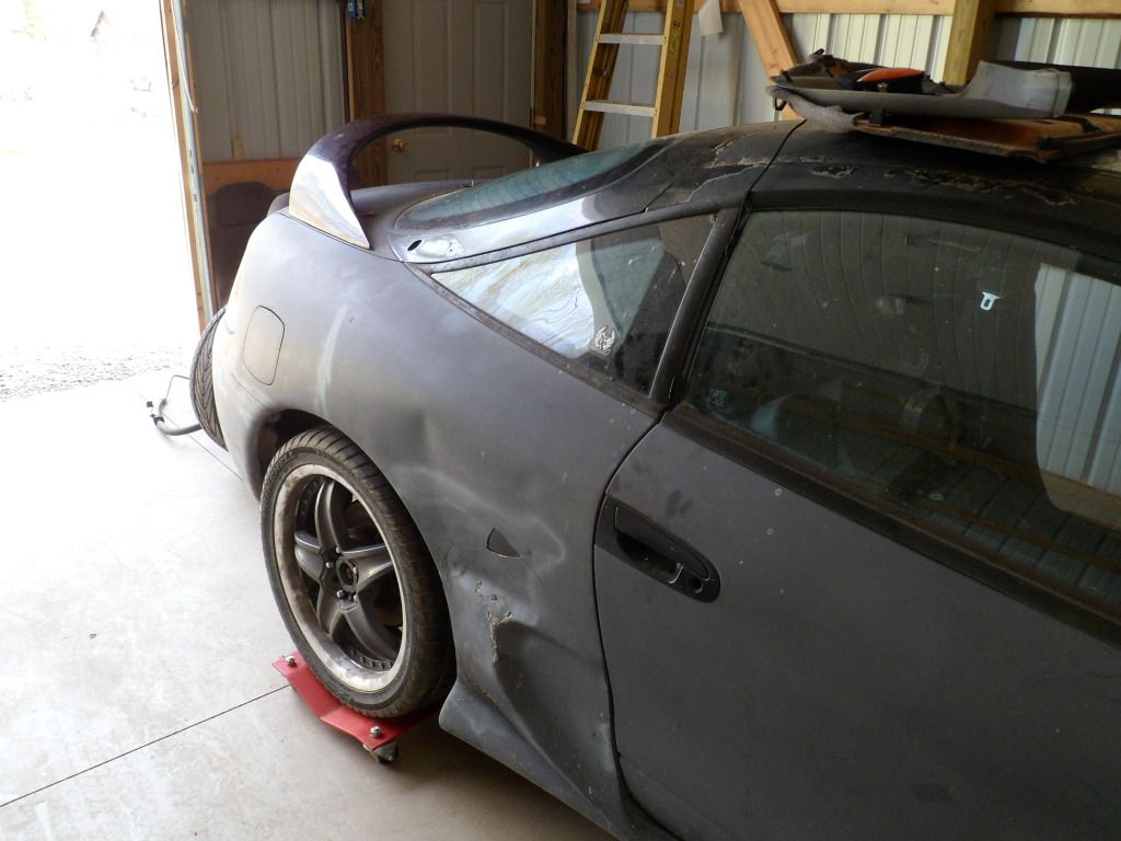

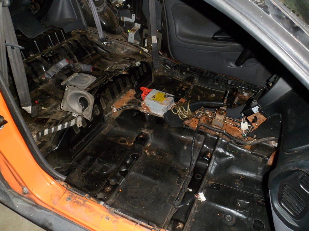

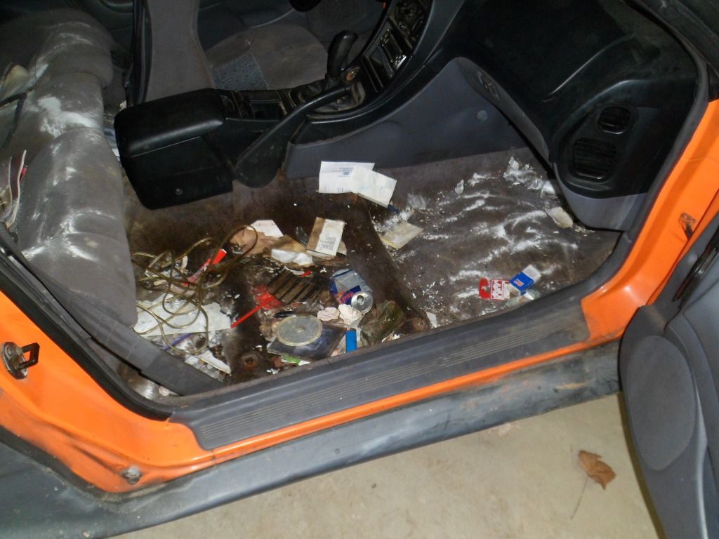

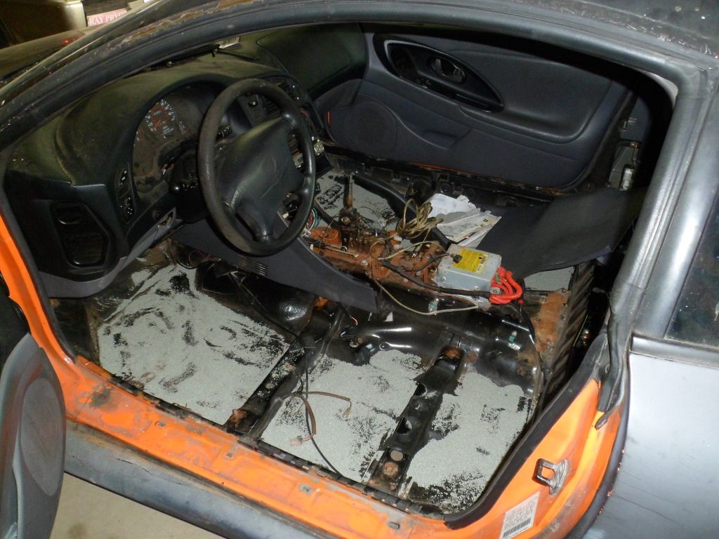

disgusting interior... found 2 rats nests and smells of piss....

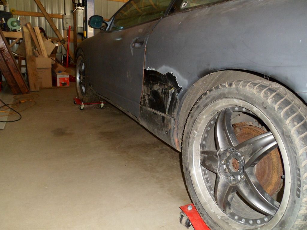

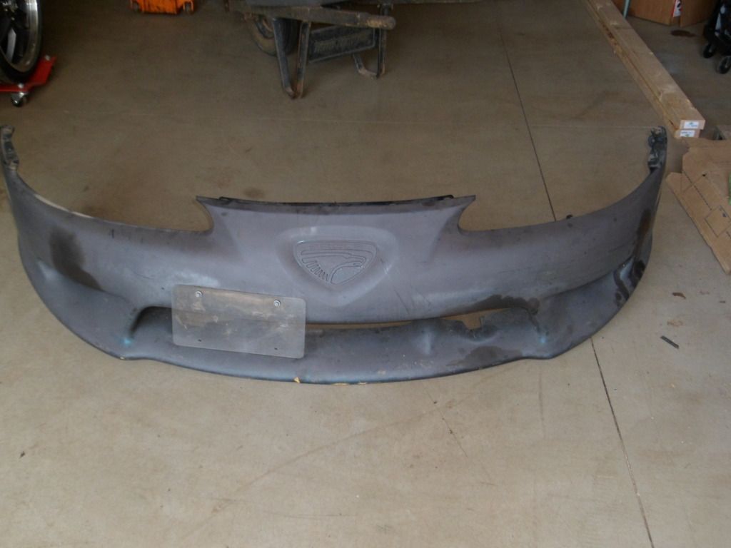

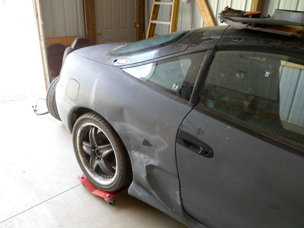

Tore off the nasty aftermarket fiberglass sideskirts that came on the car....was held on with multiple drywall screws with shit ton of bondo....

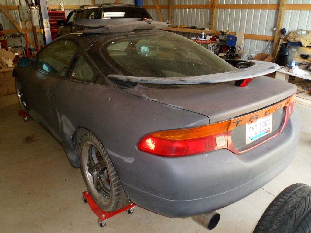

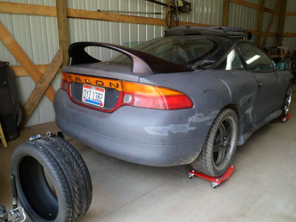

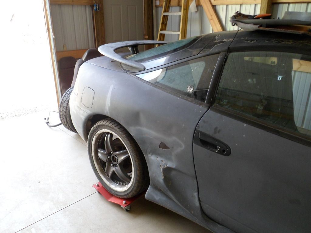

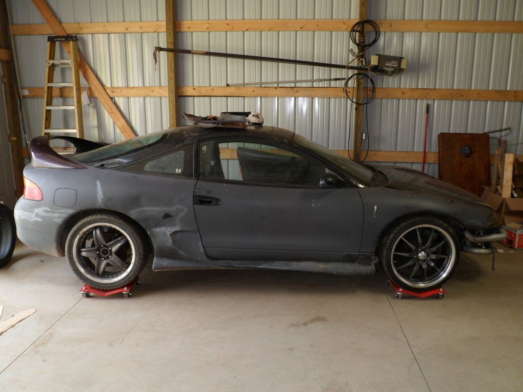

owner threw in a high rise wing for free..but I think im gonna do wing-less.
brand new HKS 264/264 cams for free! might sell these for delta 272's
That last pic kinda makes it look like a supra with the kit still on :p however I put my vote as wingless if stocker skirts are going back on. Lots of work cut out for this project. Good luck :thumb:
yes stocker skirts are going on. Ive already ripped(literally) the fiberglass skirts off. they hung wayyy to low and were damaged bad. And also held on with drywall screws.
I really like the wingless look, but that high rise looks so sexy. I will more than likely keep it wingless since I refuse to change the rear bumper/lights...and probably front bumper as well.

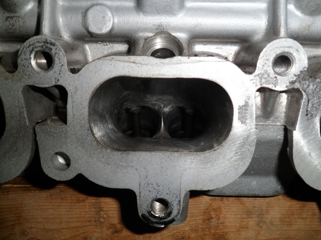

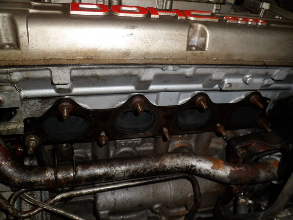

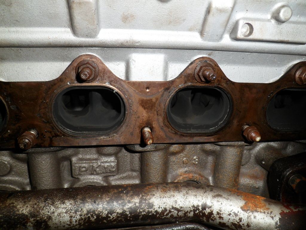

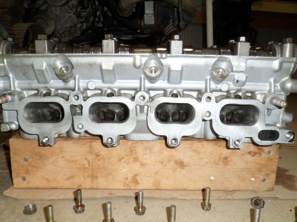

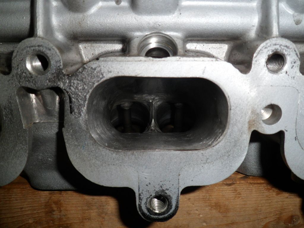

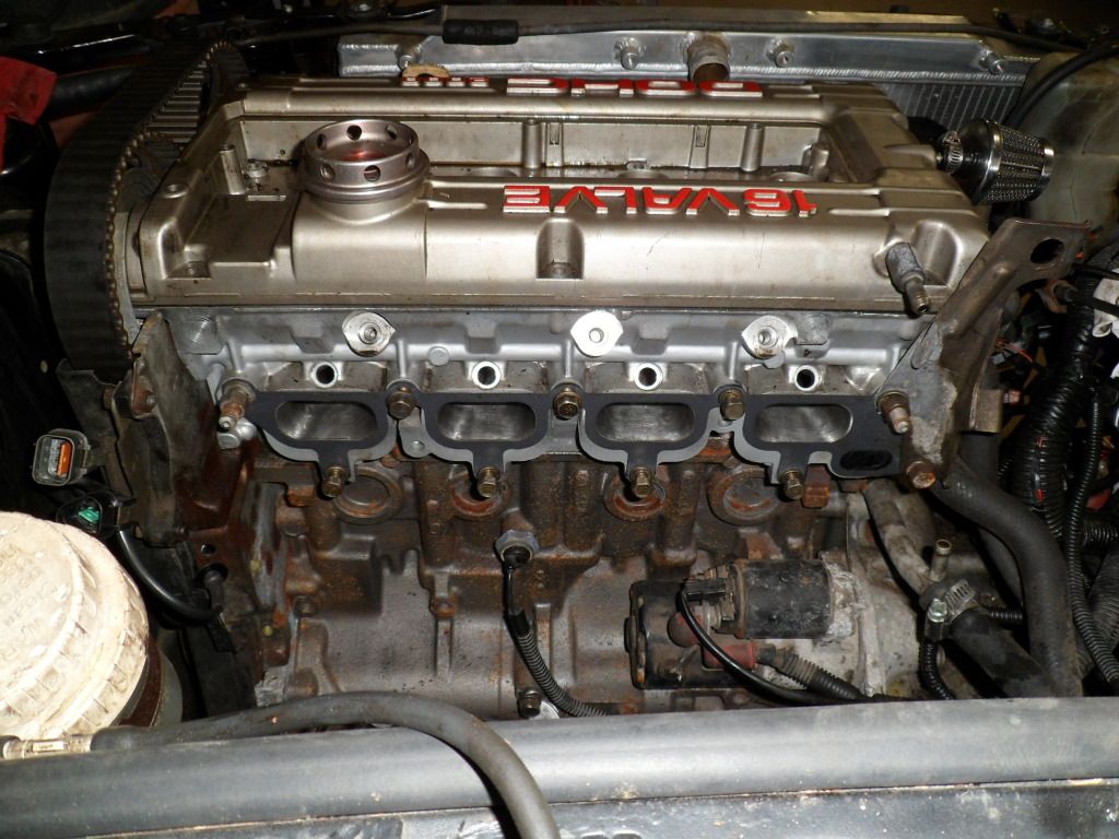

Got some more done today even though I was on limited time. Exhaust and intake manifold are pulled, the wiring is a mess on this car so I will be deleting alot of it. The previous owner said the head was ported, but damn I did not know it was this ported.
Im hoping to have the head off sometime next week on my next day off, after that its saving for DSM link, manley pistons, bearings, machine work, and more goodies!

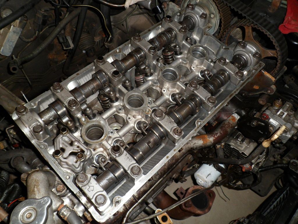

Cool fact, this head was built just 1500 miles ago when the megan coilovers were put on. I think ill stick my HKS 264 cams in here and see how they work on a ported head :)
for some reason the camera keeps tinting everything with a bronze color. The head is actually perfect, no brown/rust coloration or residue.

nice man, your right she is in rough shape body wise, as for the wing I vote the 2gb eclipse wing! wingless does look good but the eclipse wing takes the cake for me. good luck!! :D

Im actually going wingless LOL. In the process of rebuilding the 16G to get rid of and start tearing everything apart.

I have been toying around with the wing, I love the wingless look but that high rise has me bitten bad LOL. I am gonna hang onto both wings and decide which one I like once I can get the car out and rolling around with a running motor. Ill just tape it on and park it a few places around the yard and street to see how it looks.
Ive got thursday off, hoping to hear from the machine shop about my 6bolt block. After that Im gonna try and get the head off and make sure its good. Then BODYWORK!
Lol there are a lot of people that want that wing. But Im going to try it on tomorrow and see.

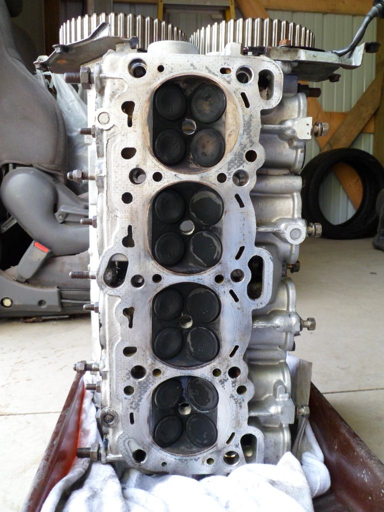

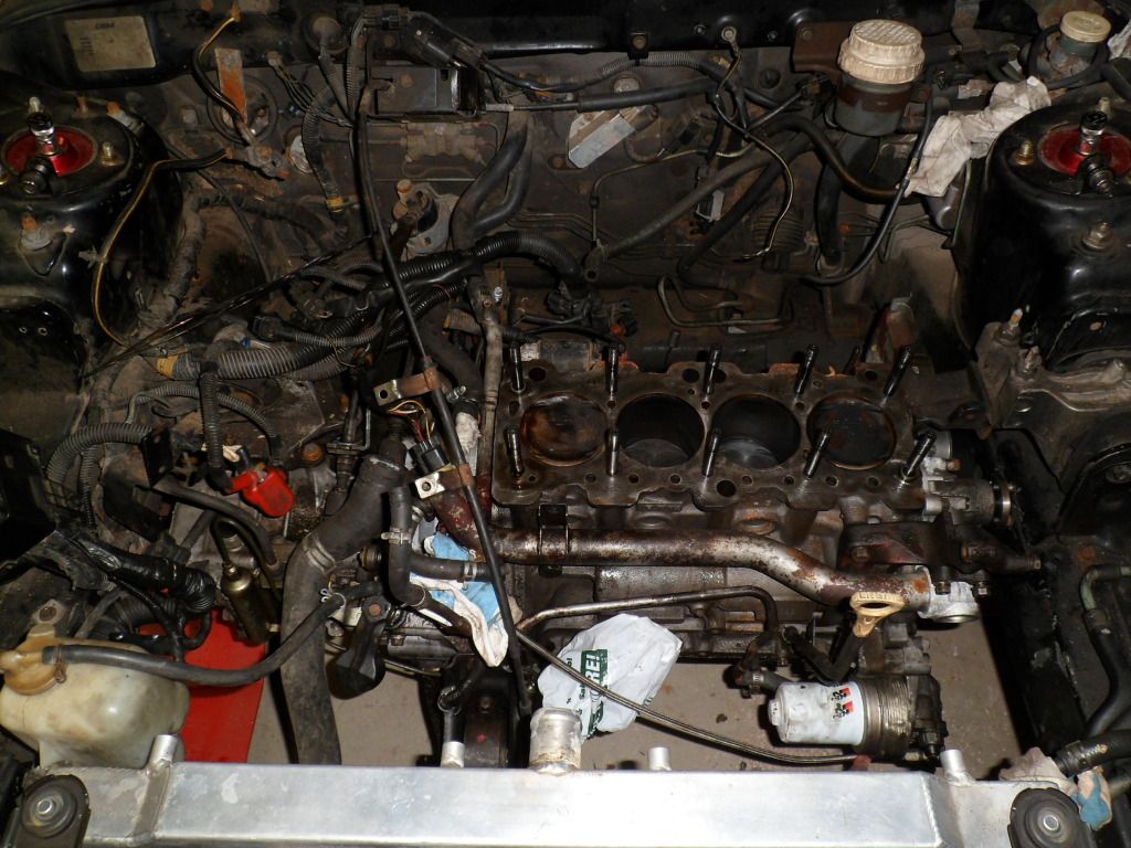

Got some more done today, alternator removed, harmonic balancer off(was a breeze), timing covers off...in pieces. They were trashed so I tossed them, gonna get some new ones off a junk car or the dealer.

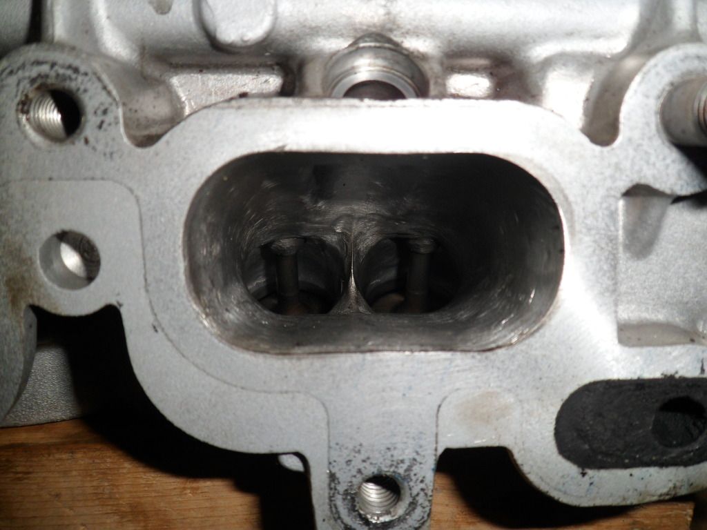

The head is completely free! ARP's came loose just fine with no issues. Discovered why there is low compression in 3/4 cylinders....cylinder walls are like Glass, I almost guarantee the rings quit sealing XD
its getting there, next to come is pulling the trans/transfer case.
*** if anyone has tips for this please let me know, Ive pulled them on trucks before but not a car.
cars owner before last(old friend of mine) had the 2g head ported pretty good.
and the tiny exhaust ports to match!
I also got the high rise wing taped onto the trunk today and just stood around a looked at it from various angles, its growing on me so I may keep it and run it on the talon bodystyle. I have yet to see one like this so Im pretty excited to do it.
