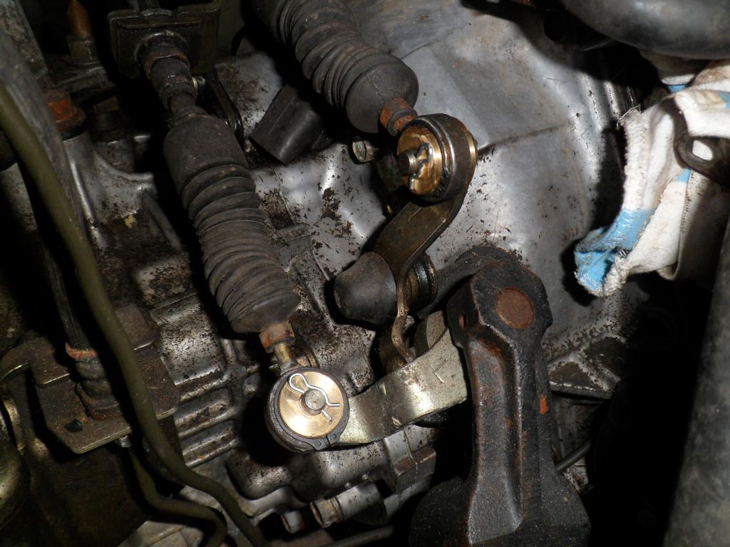

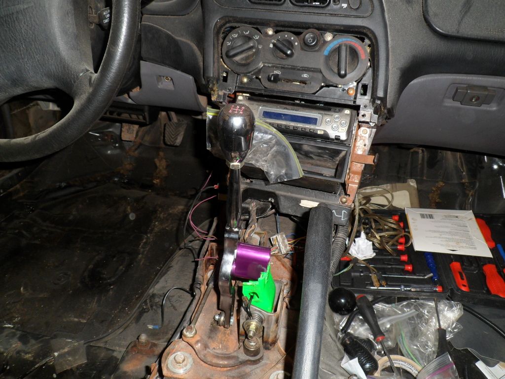

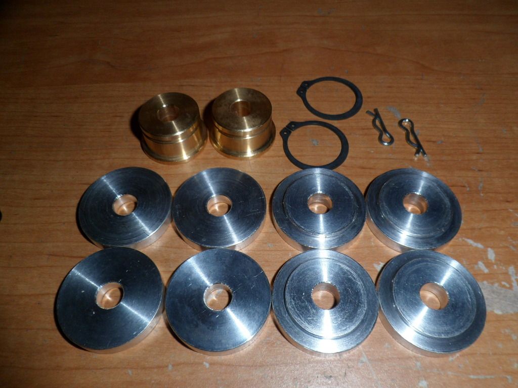

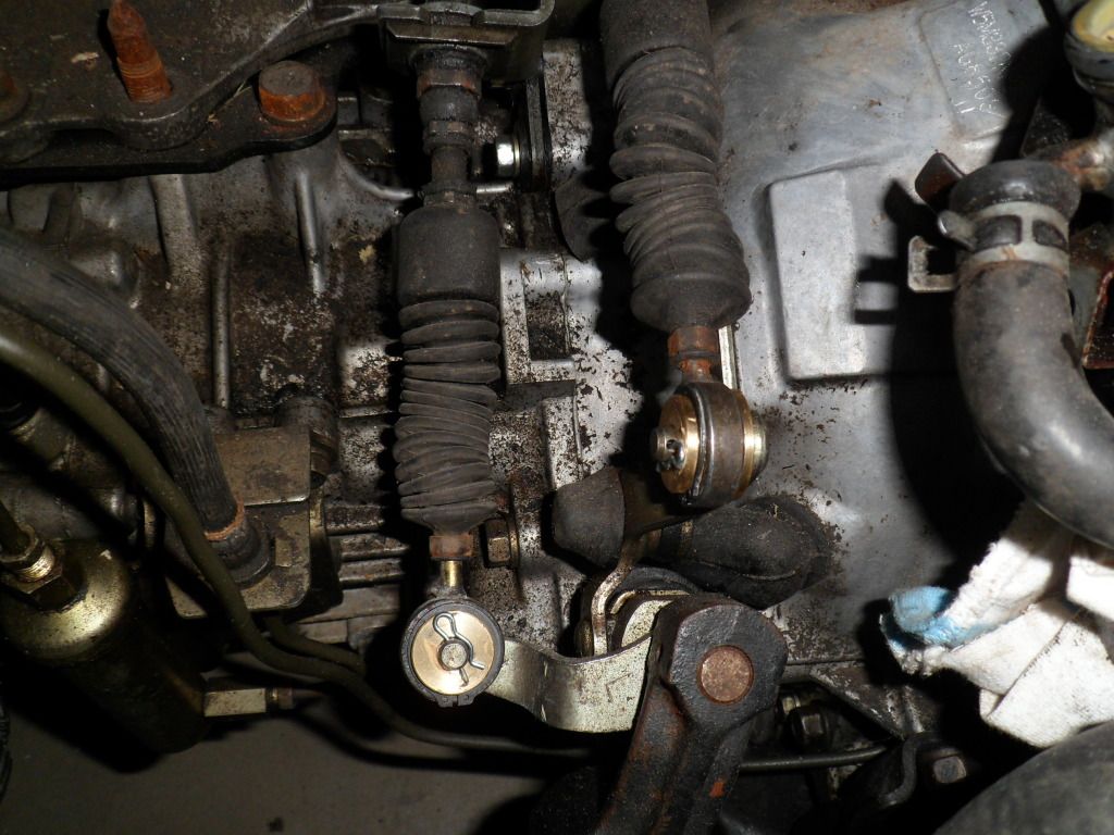

More done once again, This time it was brass shifter cable bushings and aluminum shifter base bushings for my shep trans!

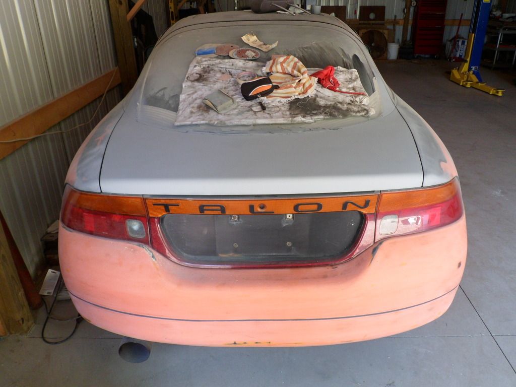

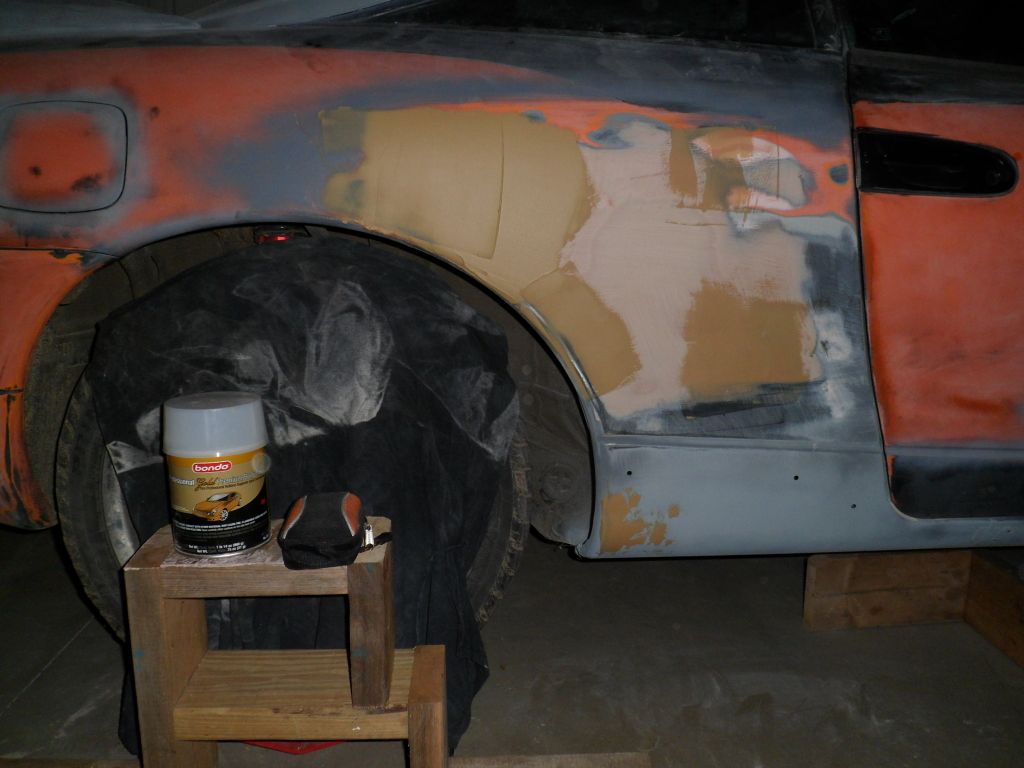

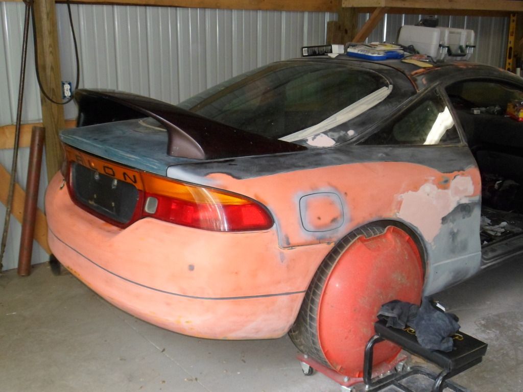

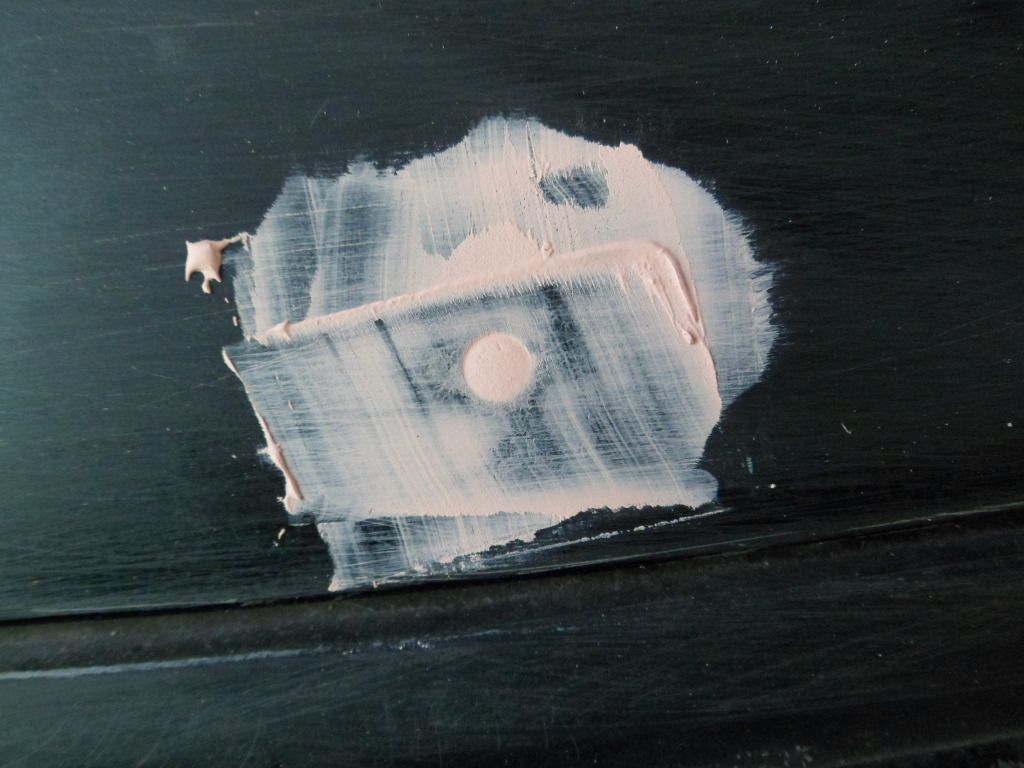

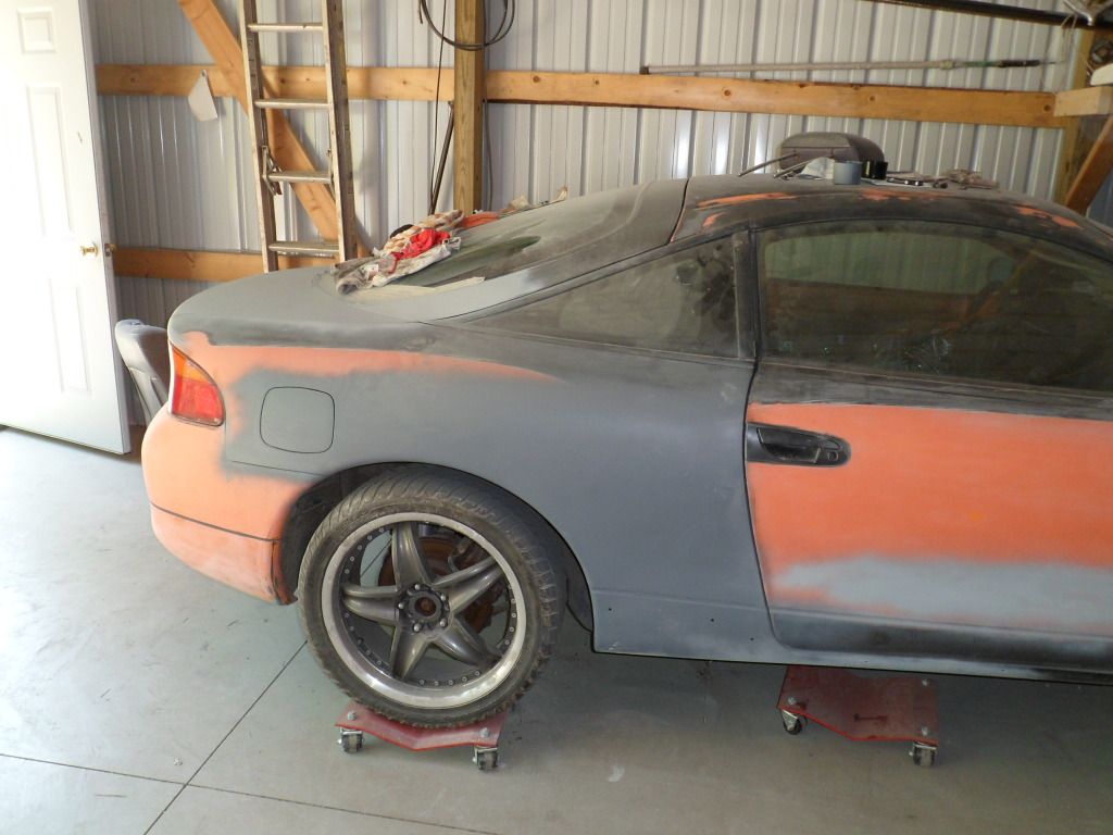

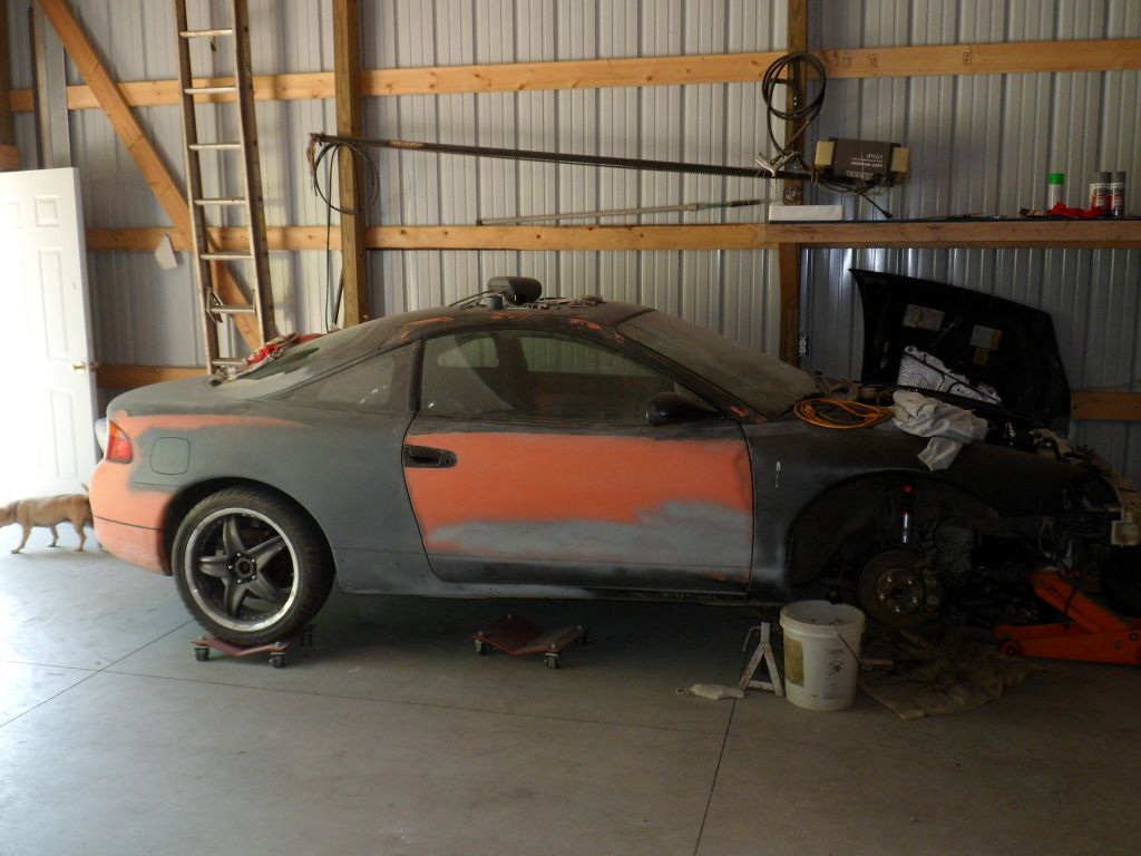

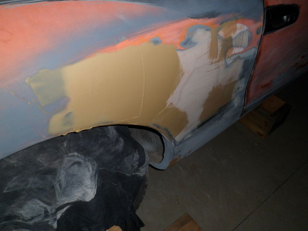

Body work is nearly done. I ran out of galzing putty and have one spot left on the quarter panel. I need to finish the 3rd brake light smoothing and sand down the hood/fenders.
Still on the hunt for those pesky Twistie style side skirts.
got the trunk all fiberglassed over and undercoated XD
Between the brass and aluminum shifter bushings there is ZERO play in the shifting. It feels so scary and direct through the stage 4 trans

More updates again!!! Had today(Sunday) off work so i went and got more body putty since i ran out :( Went with the premium bondo this time...and MY GOD what a difference. I wish i would have went with the green slime sooner.

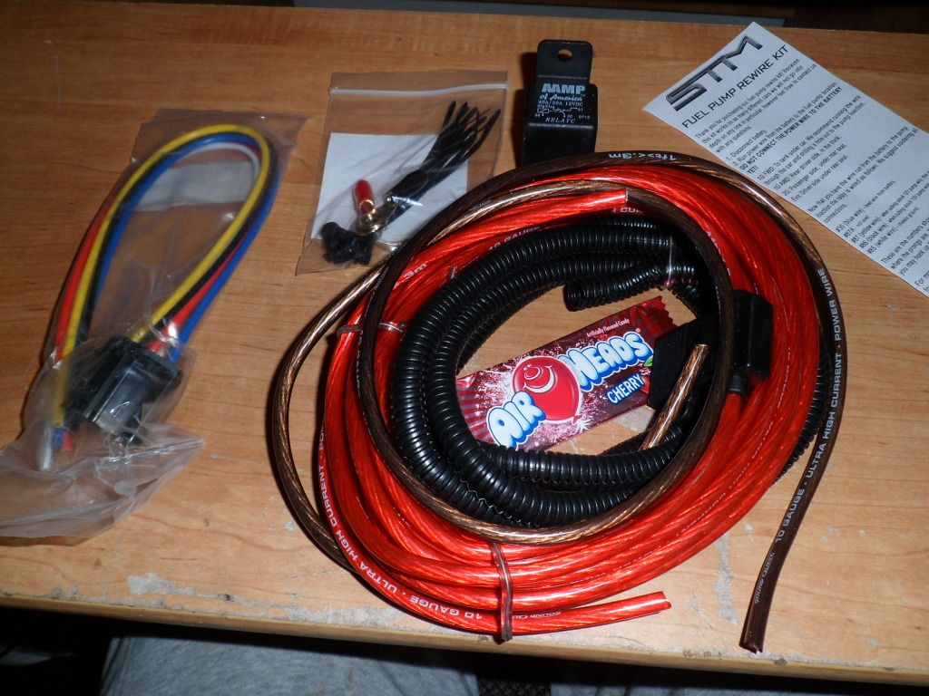

STM Fuel pump rewire kit came in, very nice quality piece.

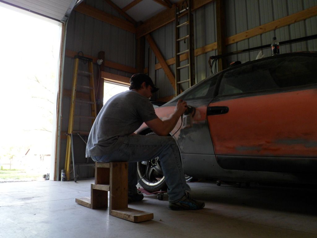

Me doing some rough sanding(had ALOT of extra LOL)

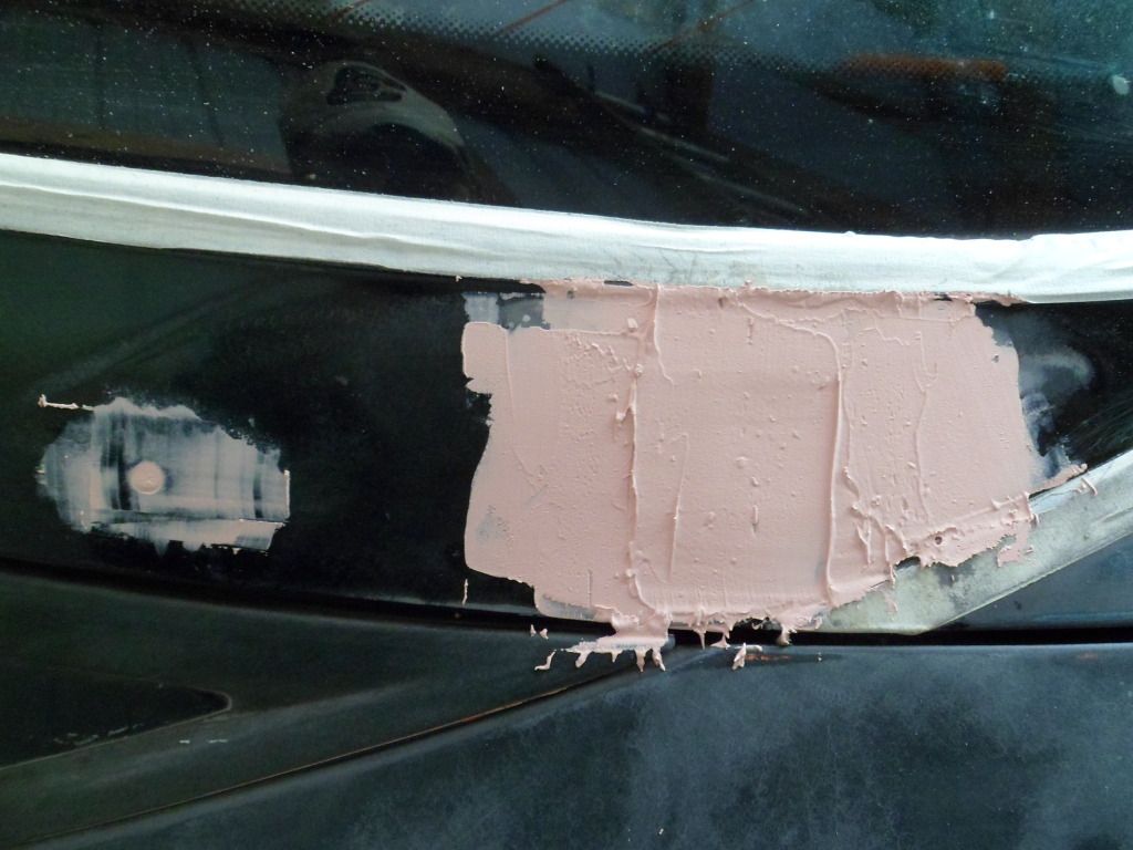

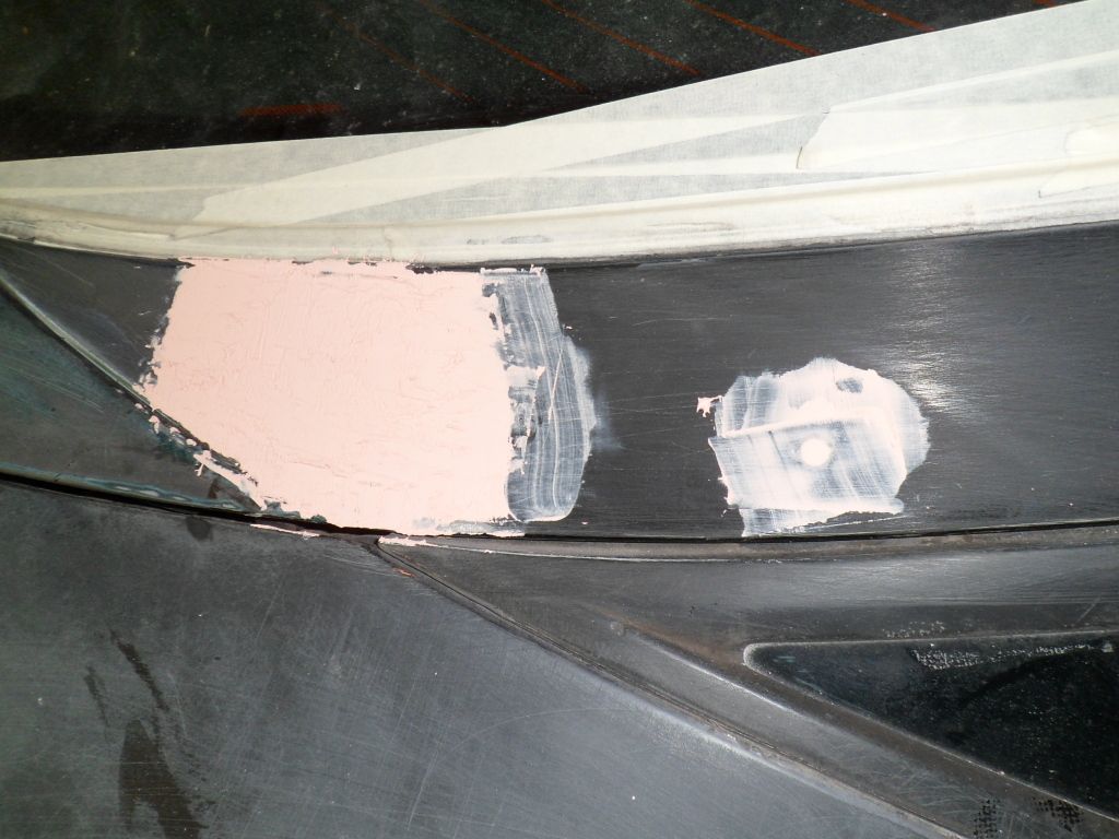

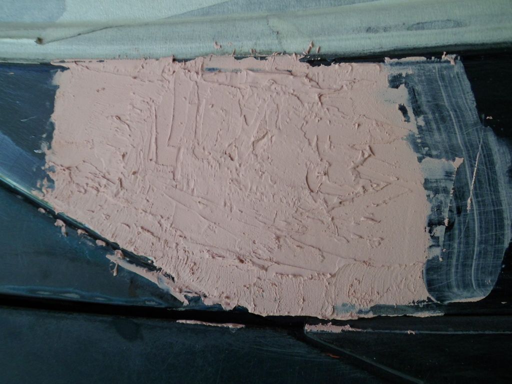

Its getting there, and a new body filler!!! this stuff is awesome!

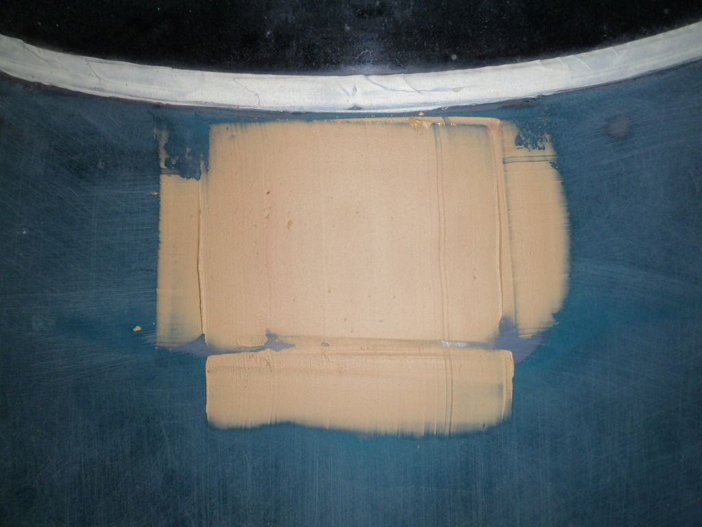

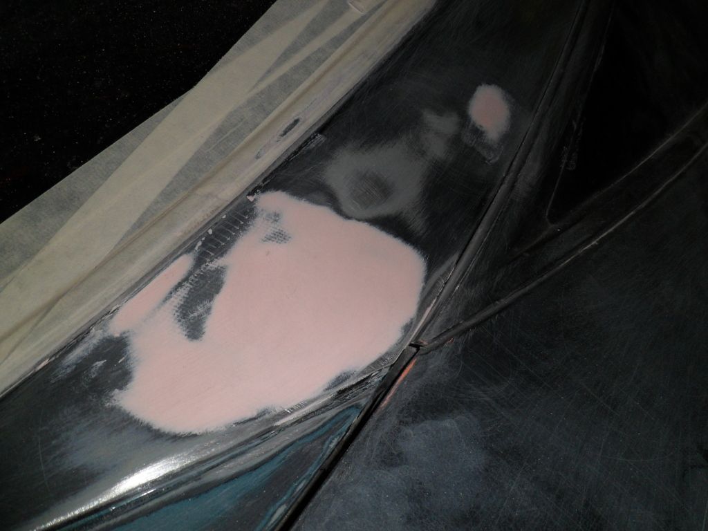

3rd Brake light body filler, it was not hard enough for me to start sanding so I left it overnight. Ill get it tomorrow!

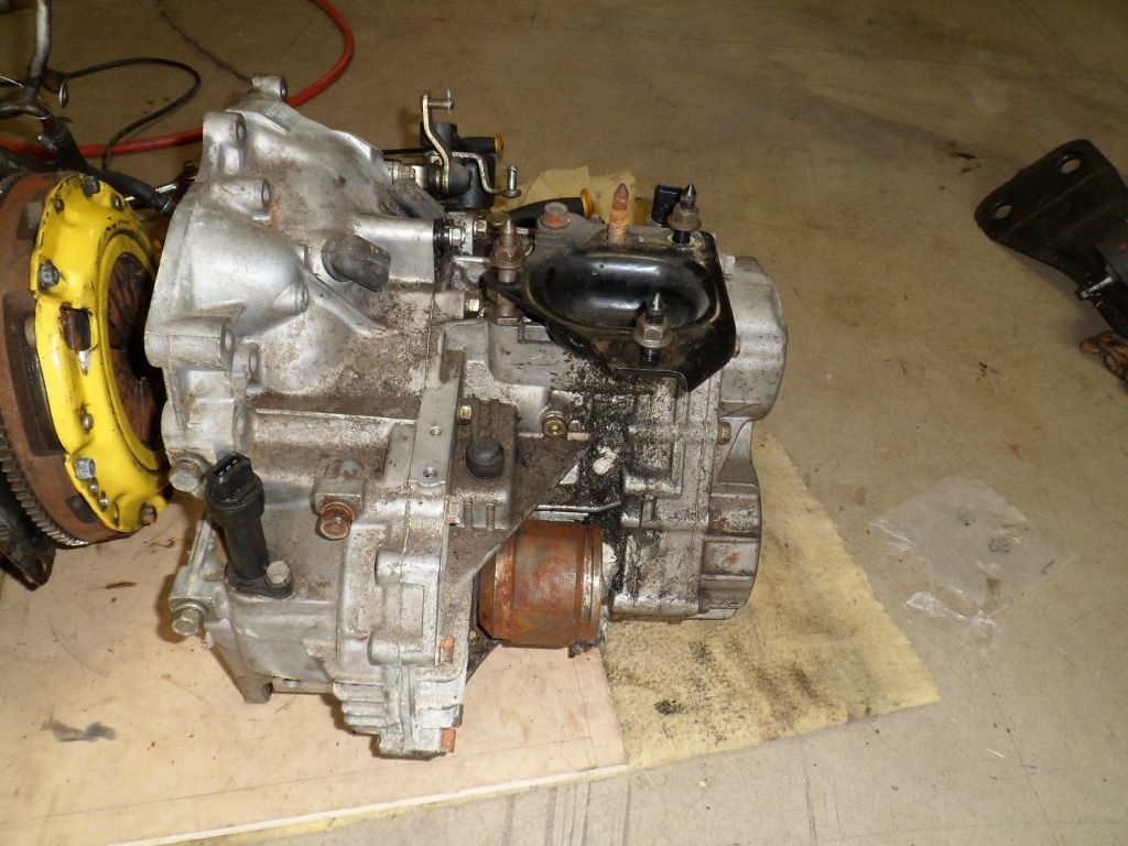

So anyways about the trans....I was told it was shep stage 4, then stage 3, stock with double synchros, etc., but at the time i did not know about the stamps that they do for what stage it is....So after months of being dragged around by friends and previous owners of the car, I finally managed to get through to Shep Racing. They informed me that they did not keep records of serial numbers but they do stamp the trans case...So after hunting for 2 days(not a whole 2 days), and 6 cans of brake parts cleaner and purple power...I found it. Stamped 3742. Come to find out the transmission is a stage 3 with SOME components of a stage 4. Such as doubled welded synchros, upgraded shaft bearings, and supposed gearing work( I would assume Evo 3 first and fifth, but cannot be certain).
Im hoping to get the trans pulled tomorrow but it looks grim, got a ton of errands to run including machine shop. Ill be seeing if taking my 6 bolt block .030 over will get rid of the scores in the cylinder wall.
As always, comments, concerns, suggestions, SUGGESTIONS are welcome. :thumb:
So I gave shep transmissions a call today with my 4 digit stamp(3742) and asked if by chance I could get some info...Well here goes:
After being told it was a stage 4 for the longest time, I can finally call everyone one of those people lairs.
The trans consists of:
Stage 3 shep transmission
4 Spider Center Diff
REM ISF Process on the gears
New Bearings
New synchronizers
New input shaft.
The trans DOES NOT have a full spline shaft like everyone said
So a big tip-of-the hat to Shep Transmissions for being more than willing to fill me in :thumb:

But I picked up a Tial 50mm BOV(old school tial), the body work is finished, it just needs paint.

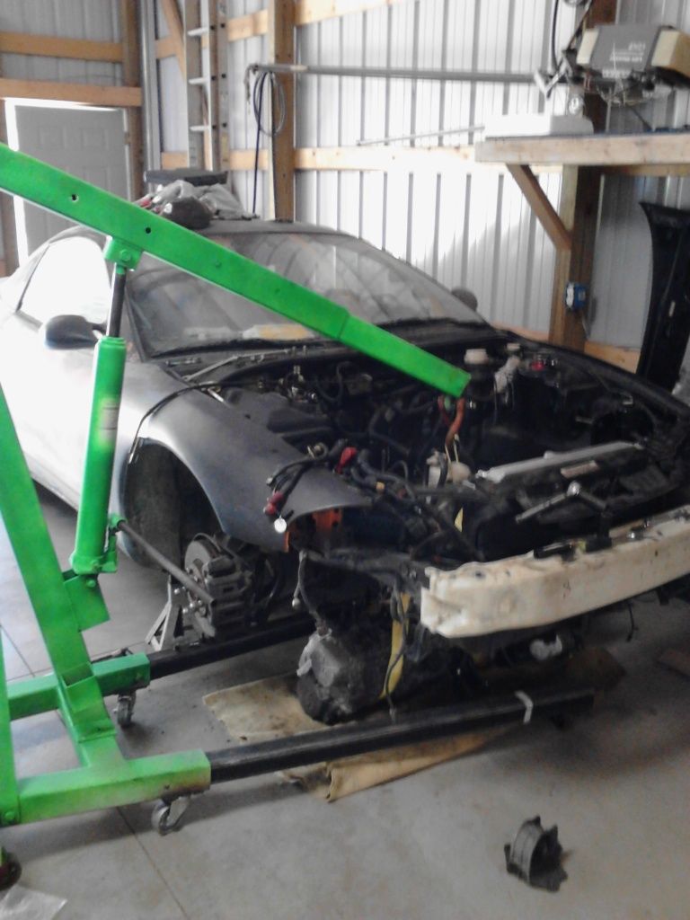

Im working on getting the engine/trans out of the car now.
My huge concerns are the motor and the 6bolt bottom end I got from a friend.
From my understanding a 6bolt motor uses the thrust washers, well mine has thrust bearings....all one piece. So I cancelled the manley pistons(well delayed them) and Ill be getting my block back tomorrow and running the serial # to find out just what year it is.

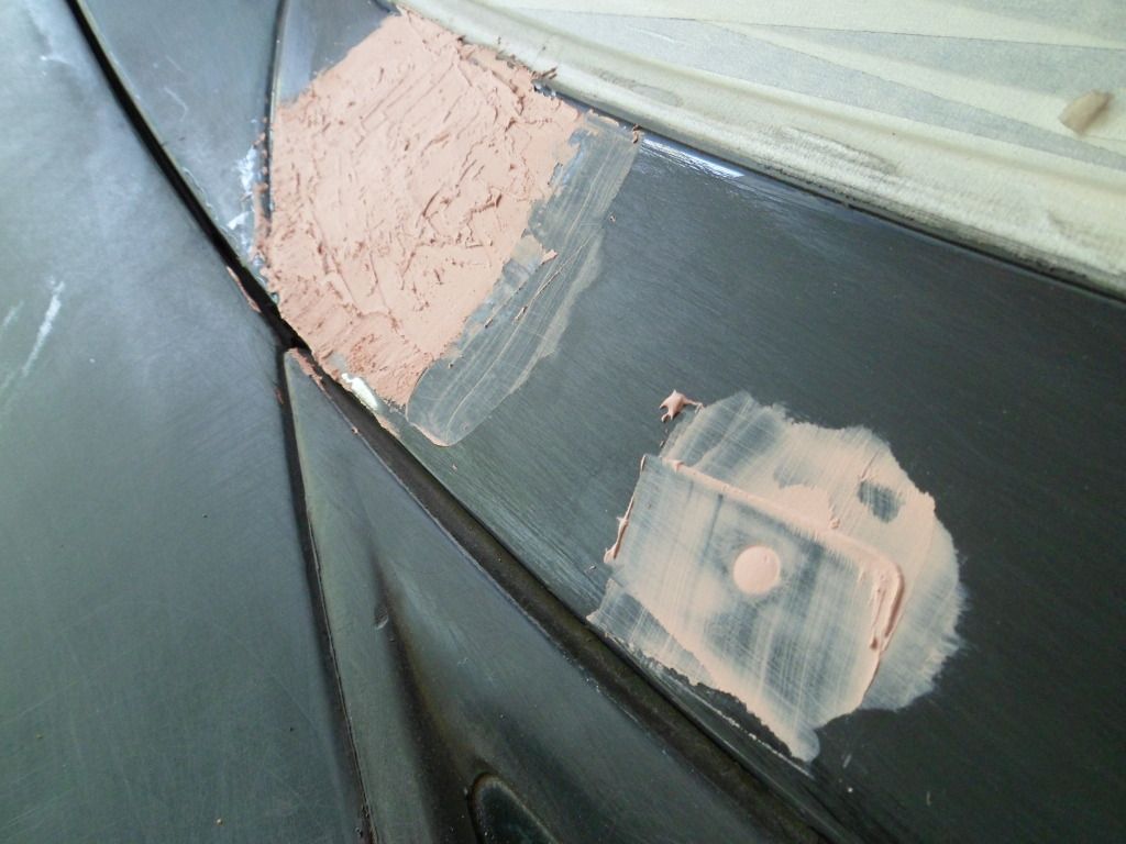

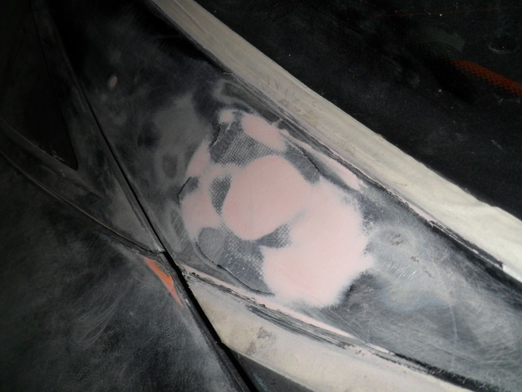

Go wingless! Looking good so far... but on a side note, be careful just filling holes with mud... the filler may shrink and make them appear later on... you may be able to see them in the sun on a hot day, oddly enough. Mud and metal do funny things sometime. I would have welded them, or found someone that could...
I love that GTR style wing, but im still deciding. I love the look of the Panda 2G when its wingless, so its gonna be a last second decision before paint haha.
Yeah I cant find a manifold for less than 800 and to me, its just not worth it ATM. I have sooo much to do with this car that a manifold can wait for a while LOL.

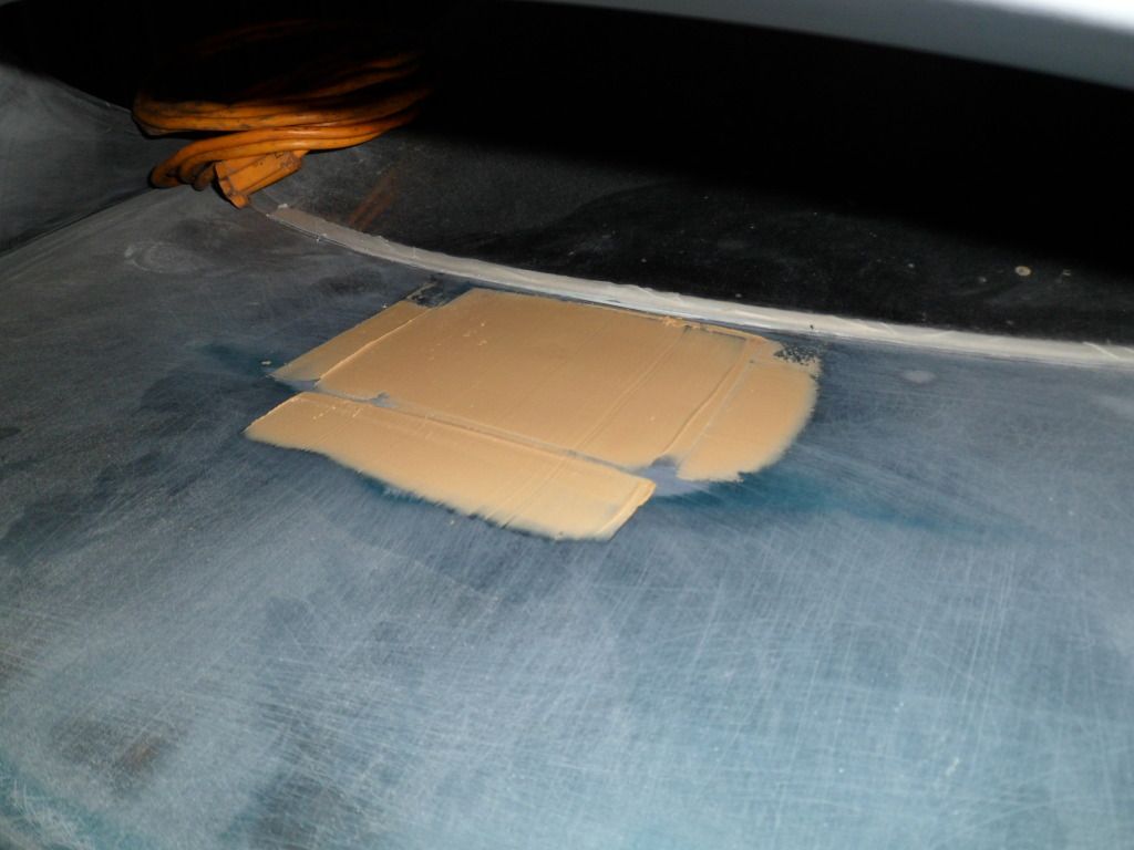

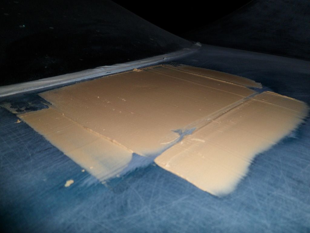

I backed the bondo with fiberglass patches and let them get completely hardened before spreading the mud. Ill also be applying a thin layer of resin on top of the bondo holes just to reinforce it.
Got some more stuff tidied up. Decided to go wingless after all LOL.

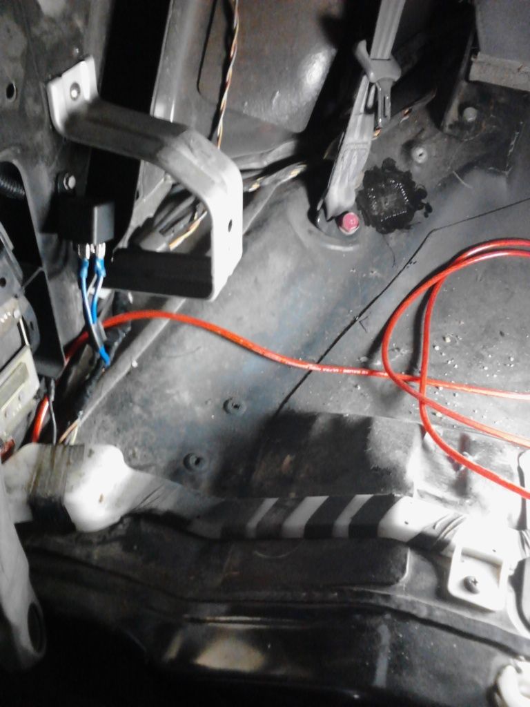

My progress is slow, I only get about 4-6 hours a week to work on it. Im hoping to have the fuel pump rewired this week. Hopefully Next week I can get the old crankwalked 7bolt out of there along with the shep trans and clean/degrease the engine bay. After that its really just ordering parts.

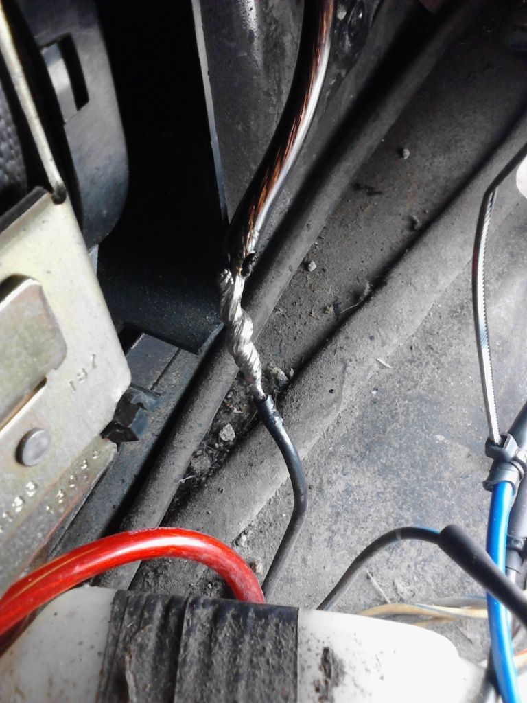

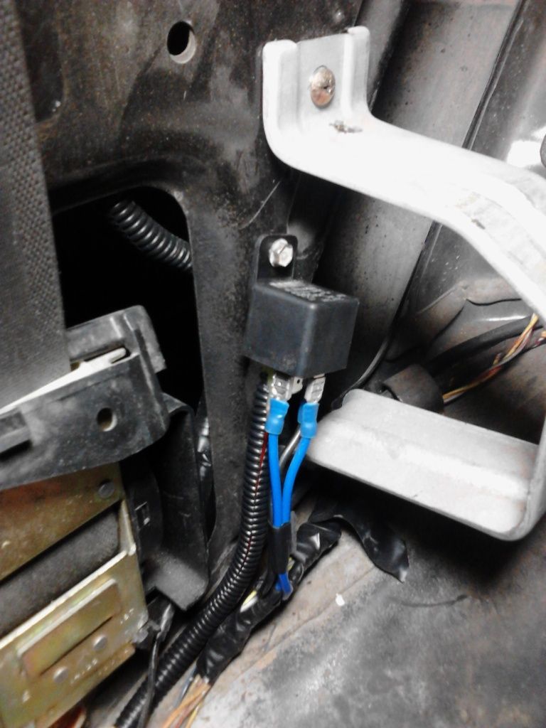

Got the fuel pump rewired tuesday, was actually easy once I figured out what wire to cut and where to connect it.
I wound up cutting the wires closer to the door rather than underneath the rear seats. I did this because:
1: that is open to the elements. if you look, you can actually see the outside. I didnt want rain/snow getting into the relay or electrical connections.
2: its a pain in the ass and not enough wire left if you tend to **** up electrical things like I do.
3: its closer to the ground and there are no wires running under the seat that were not already there.
Its still the same basic fuel pump rewire, just in a different location. Same wires were cut and connected like STM and several others have directed.

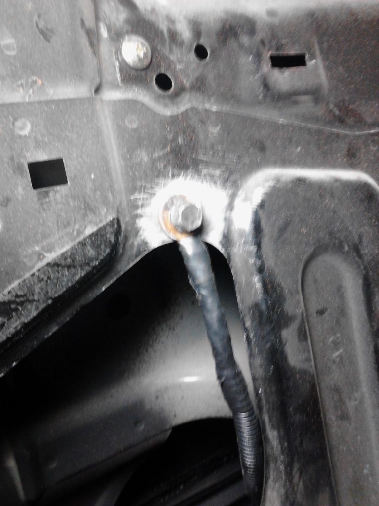

sanded down a spot behind the passenger seat belt. I used a copper penny and bolt/nut to guarantee it was grounded good and stayed there and not vibrate loose.
Final result. Complete and out of the way. No pesky wires under the silver shield. everything is sealed inside the car.
Please feel free to give me some feedback on my soldering work. Ive not soldered anything since 2008, aside from converting a honda ecu last year.

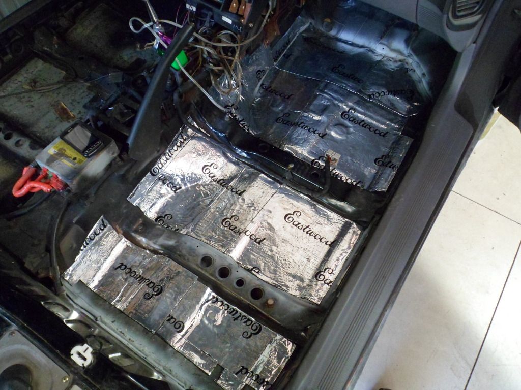

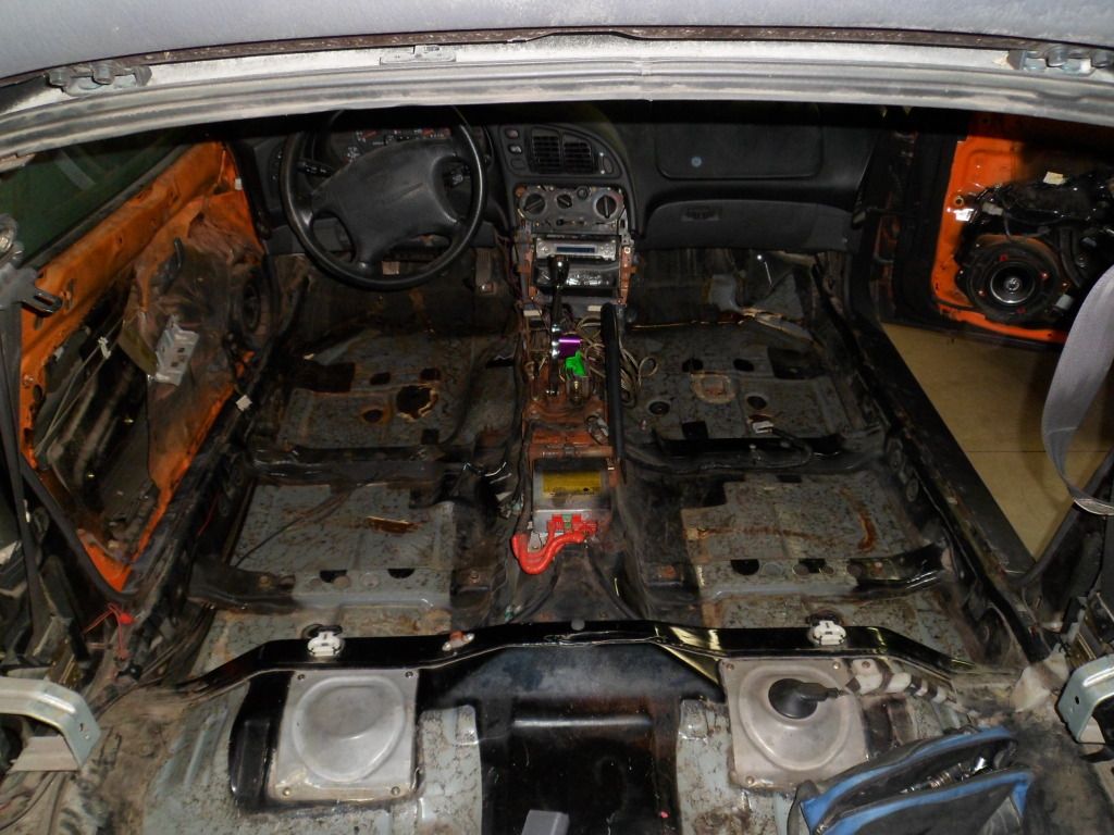

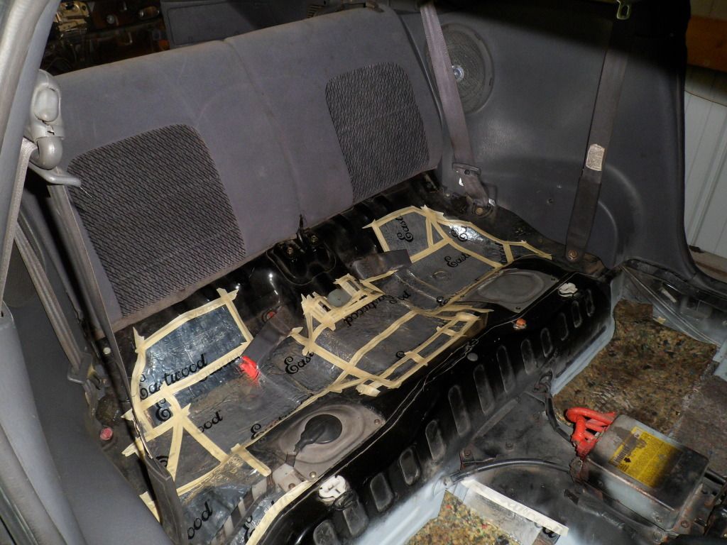

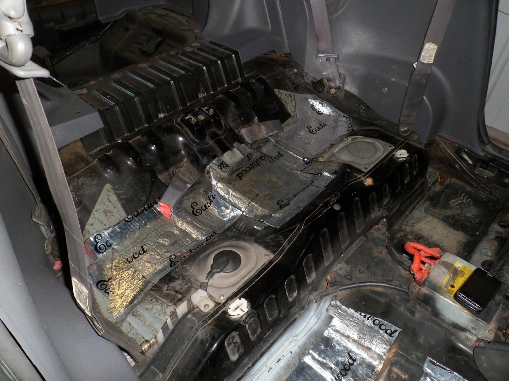

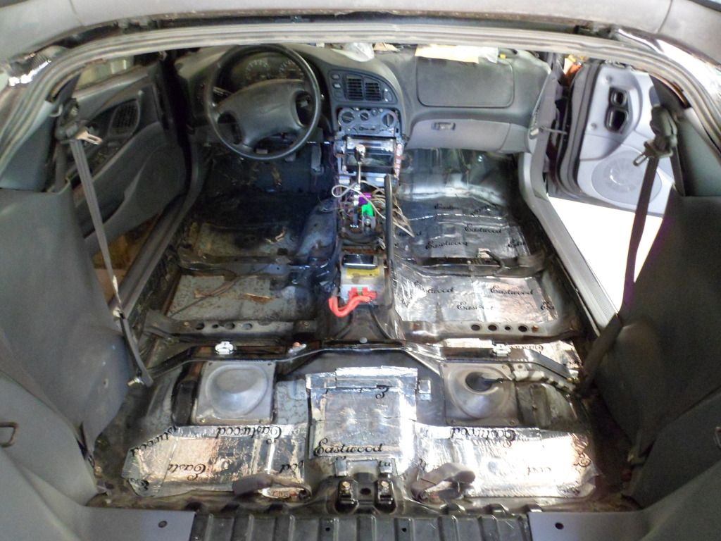

Getting a bit more done each day, got the old sound deadener ripped out and the new eastwood stuff installed(ran out so the drivers side is not finished.

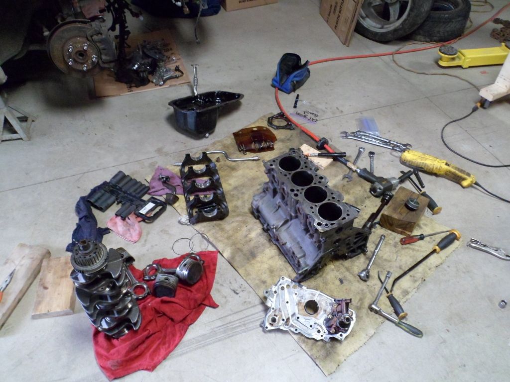

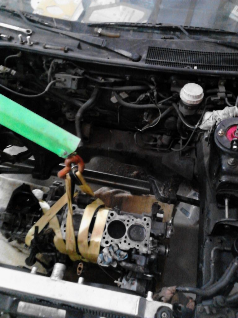

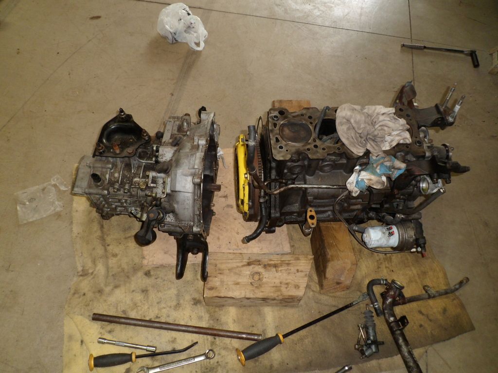

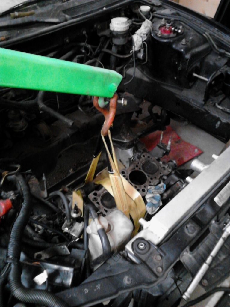

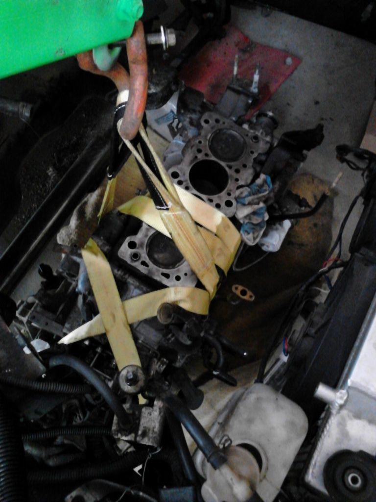

Finally got the old 7bolt garbage motor out. Check out some of the surprises I
found upon dis-assembly.
CHECKMATE!!!
Pulled out from under the car and separated
Shep Stage 3 along with a blown axle cup.

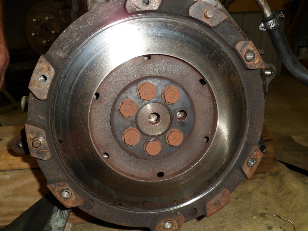

FIRST AMAZEMENT.
Someone wanted their 7bolt to be a 6 bolt so badly....they only put 6 bolts in the flywheel.....
After 15 minutes..
These were the rings I found on one of the pistons, they had gotten folded over and were not even in their seat. Scored the living hell out of the cylinder wall. Pistons were ok though

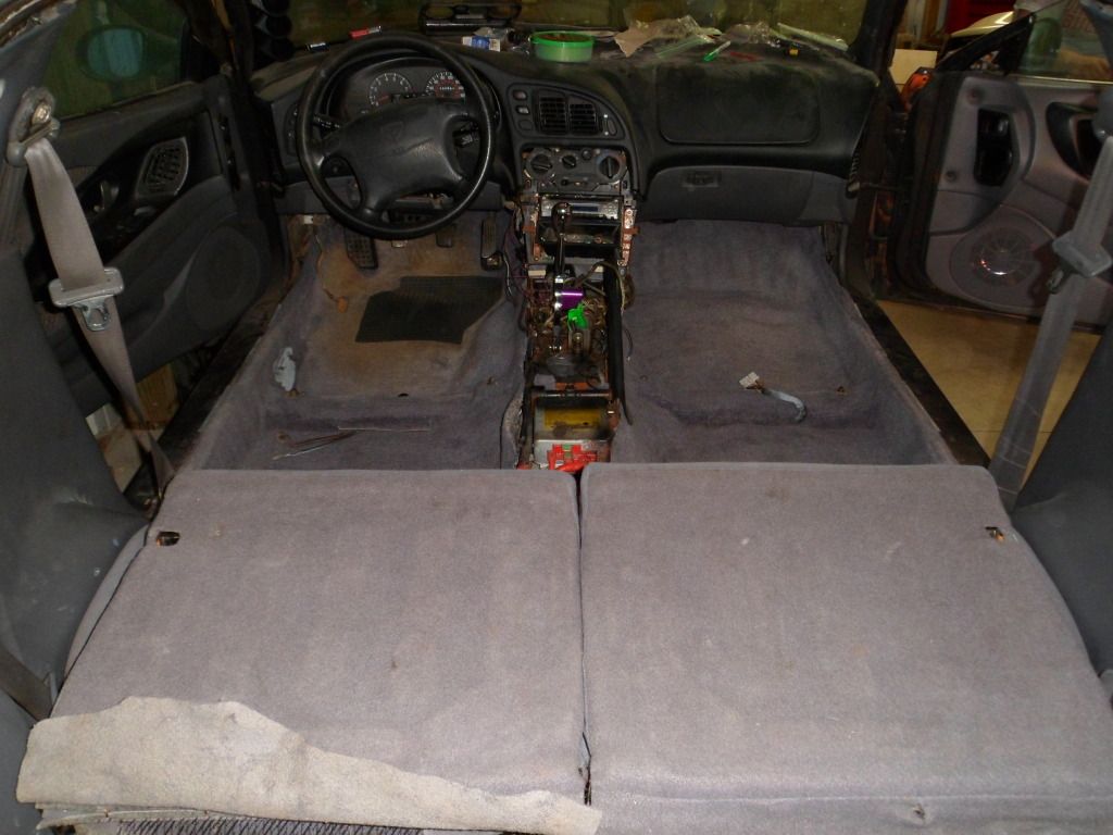

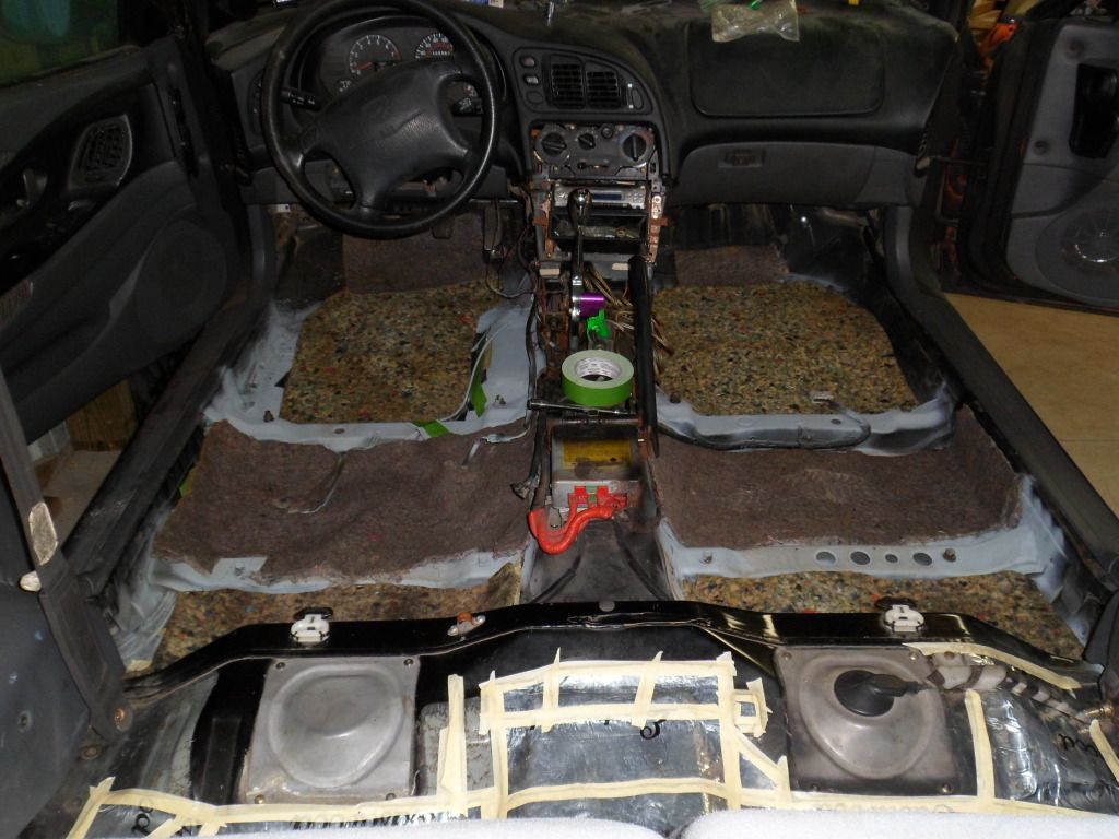

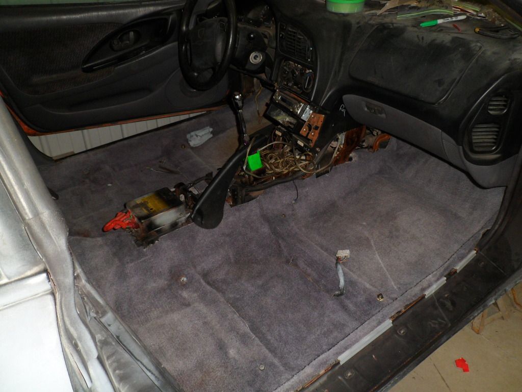

INTERIOR. Car is actually starting to look like a car again.

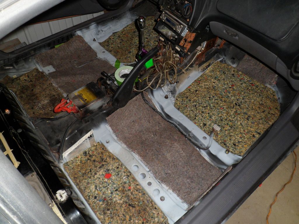

Taped up all of my seams so it would not stick to carpet/rear seats
Put in plenty of padding on top of the eastwood style dynamat

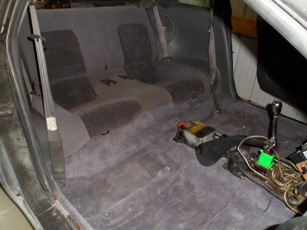

Carpet and rear seats installed!
Got alot accomplished in two days of work. Now that the motor and trans are out I can finally pull the car outside and start sandblasting and cleaning the engine bay.
Just for giggles, this is how bad the motor walked. Not horrendous, but still crappy
