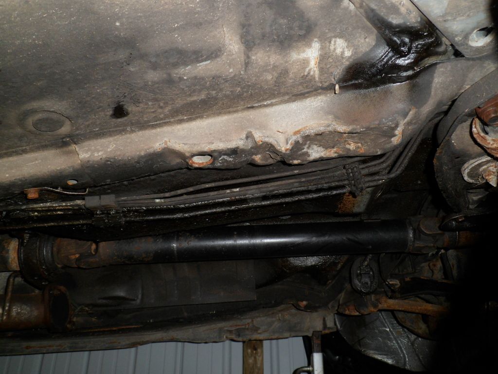

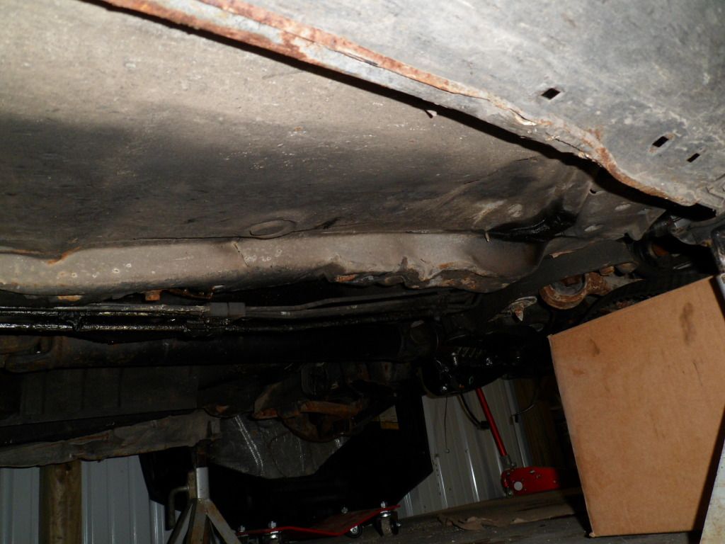

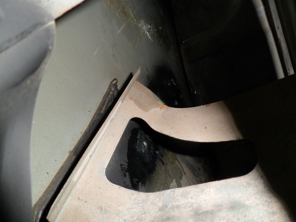

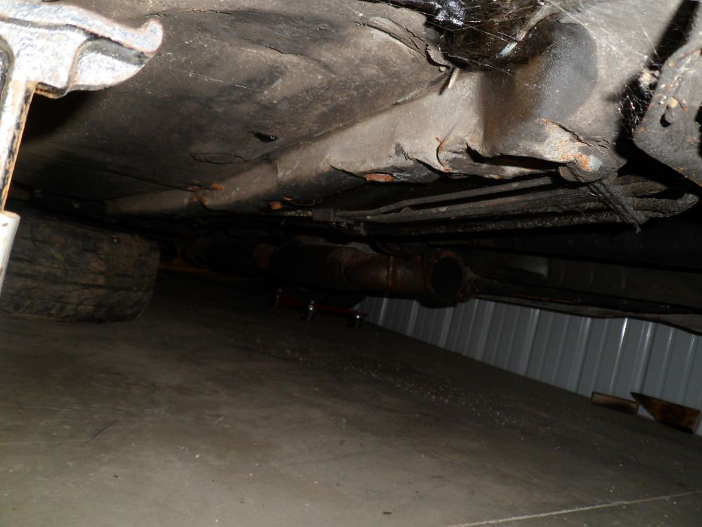

Oh and I found this today...crawled under the car to pull the downpipe off....and saw the wonderful cause of raised floorboards.....
fantastic.
All of the fuel lines are even bent....So now I have to wonder if this car has ever been wrecked.....looks like I have no choice but to upgrade to -6 AN line now
Yeah Im up in Ohio, it shouldnt honestly be that hard for me to get one around here...TONS of farm boys trying to upgrade from the HX turbos to 70trims for truck pulls....and its a farming area where I live.
I got some free time after work this afternoon so I looked some more at the wing situation and decided to give the high rise a try. So on my day off monday I will be drilling and mounting the high rise wing and fiberglassing the holes up for the pre-existing solar wing.
fantastic.
The car could of been improperly lifted. They put the jack under the soft metal and keep jacking up the car causing the floor to lift.
Yeah now Im puzzled as to how I can get the floorboards back down so that the underbody can be re-welded

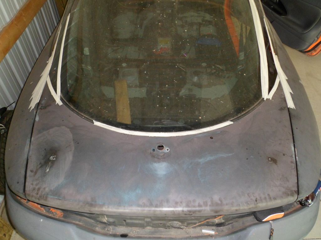

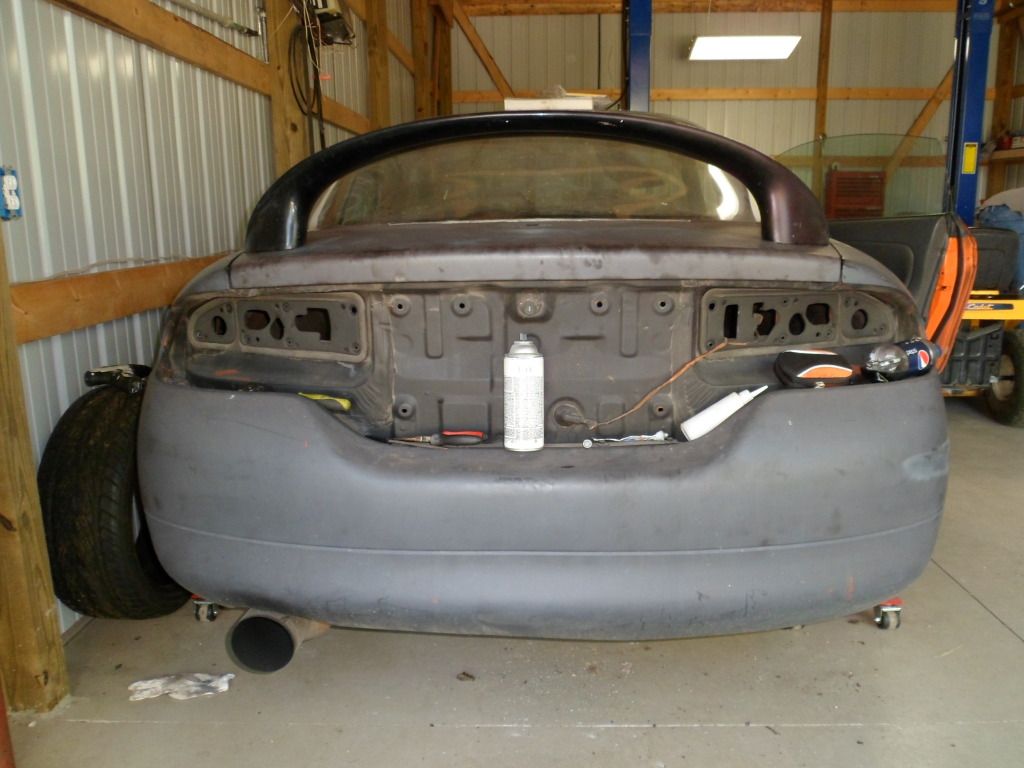

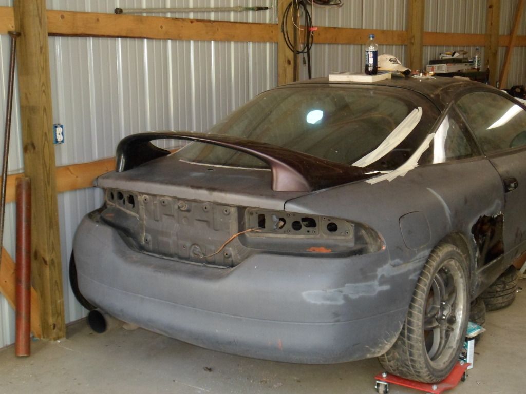

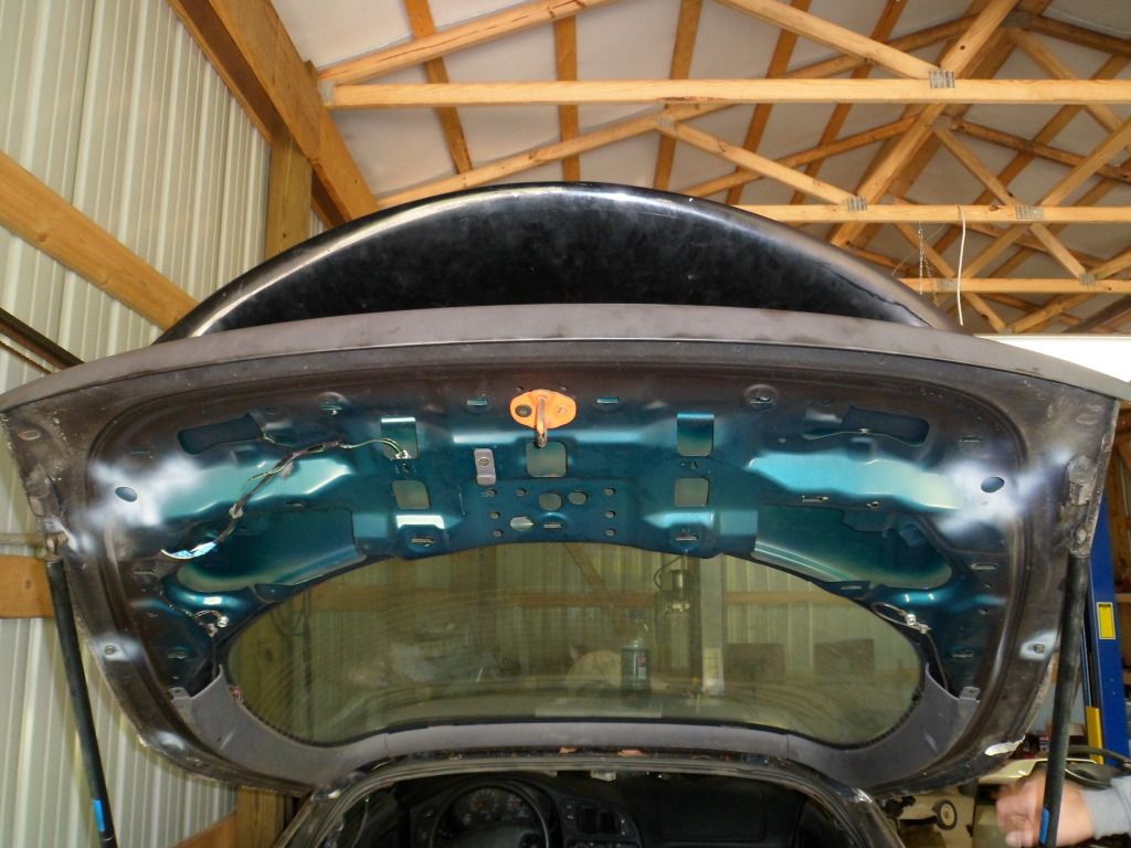

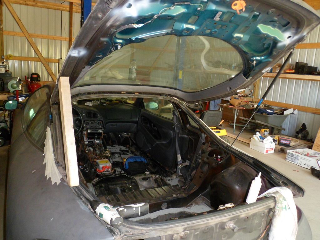

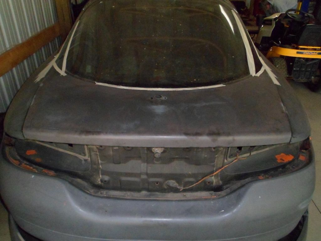

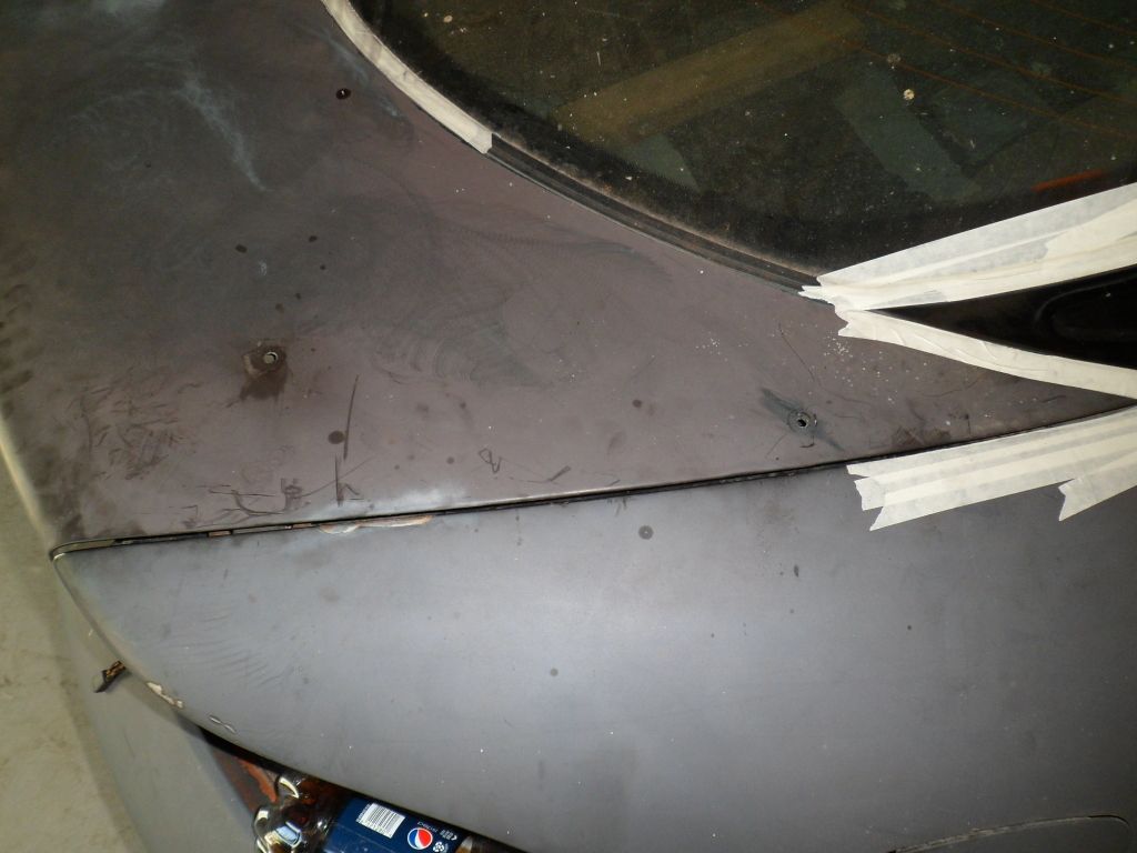

got some more done today, mounted the high rise wing, and started the body work....pumpkin XD

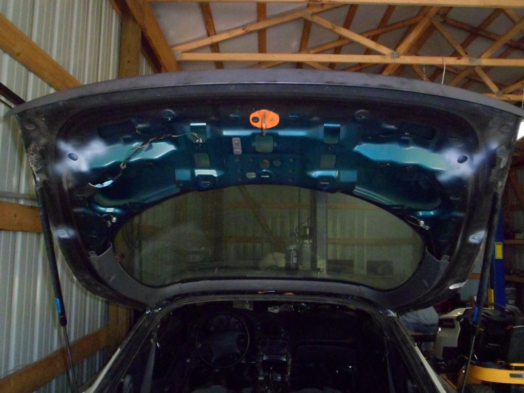

dont forget to prop that gate open!!! cant drill the holes if the struts are still installed :thumb:

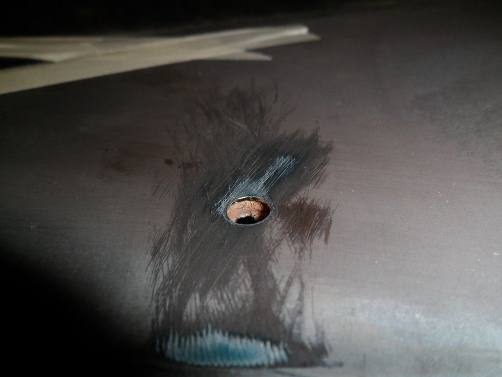

of course some burrs....
but they make files to fix that XD

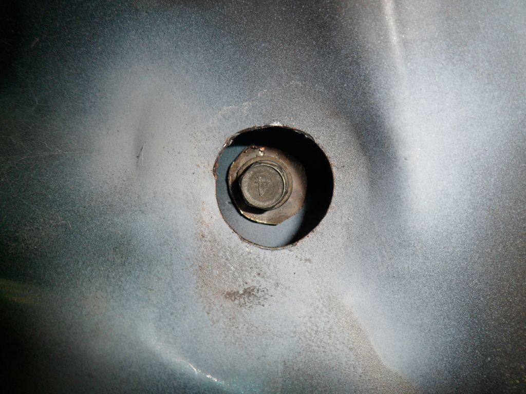

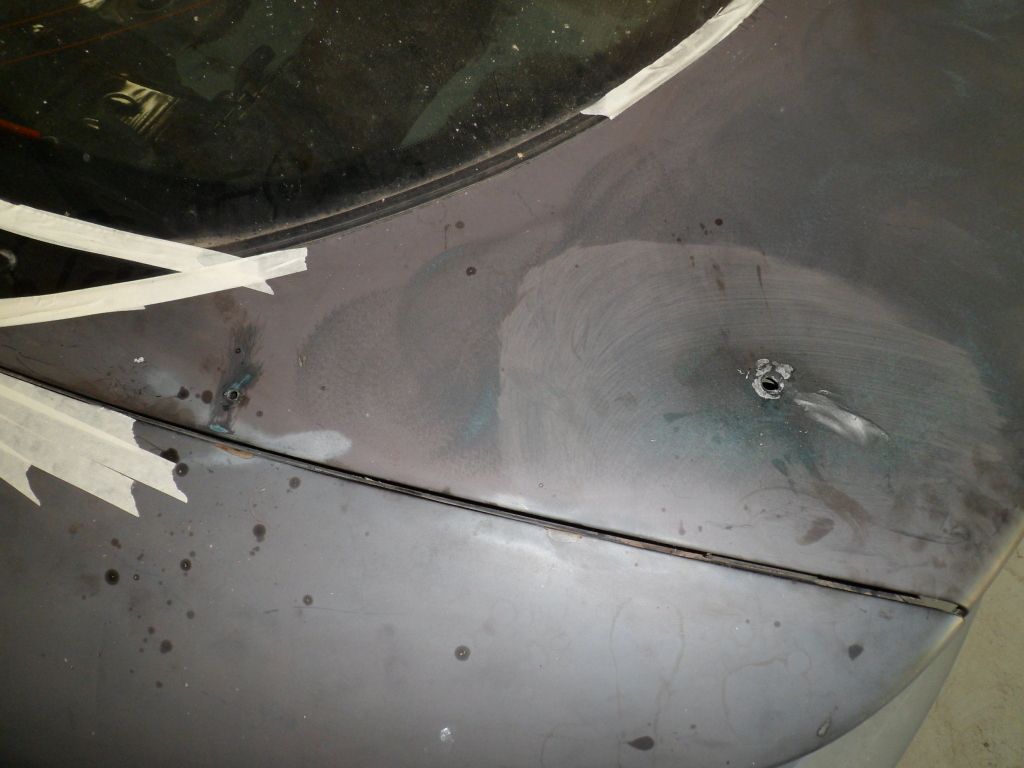

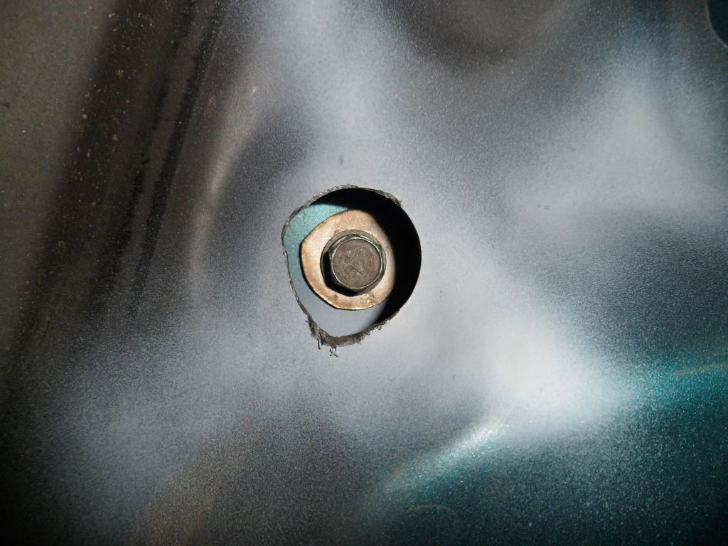

mounted the wing via front bolts and used putty to find the exact spot for the rear bolt hole to be drilled
i added nice thick home made washers since the wing was just on one piece of metal.
MOUNTED!!!
started the sanding for new paint! and found a nice pinstripe type tribal
Comments/Concerns welcome as always!!!

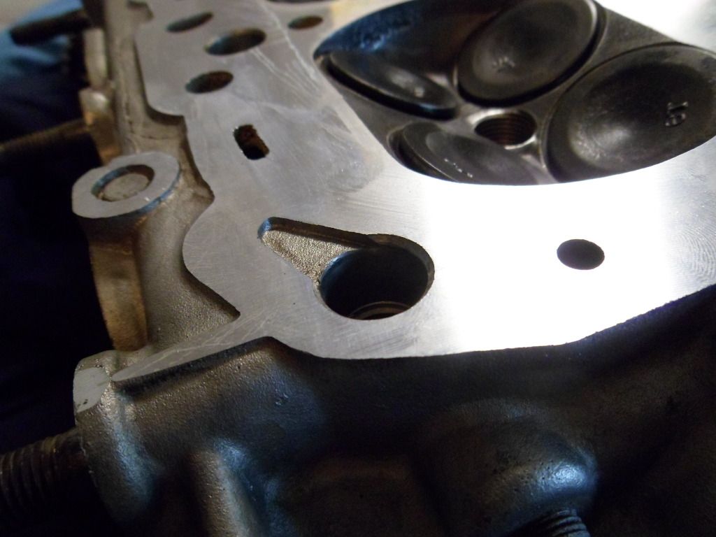

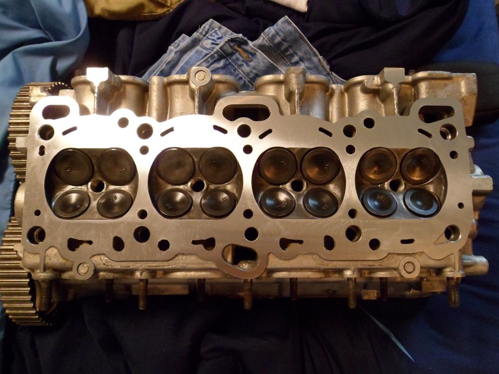

Got the head back from the machine shop today, it looks so perrrty.
And the back doesnt smell like rat piss anymore....now the car reeks of fiberglass resin XD
forgot to do the oil port mod before i took the head into the shop, but it has revised lifters so I may not need it afterall, does not look like its been resurfaced too many times

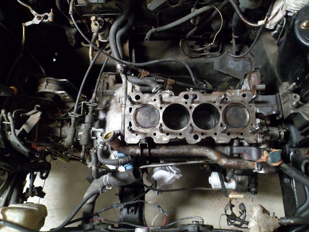

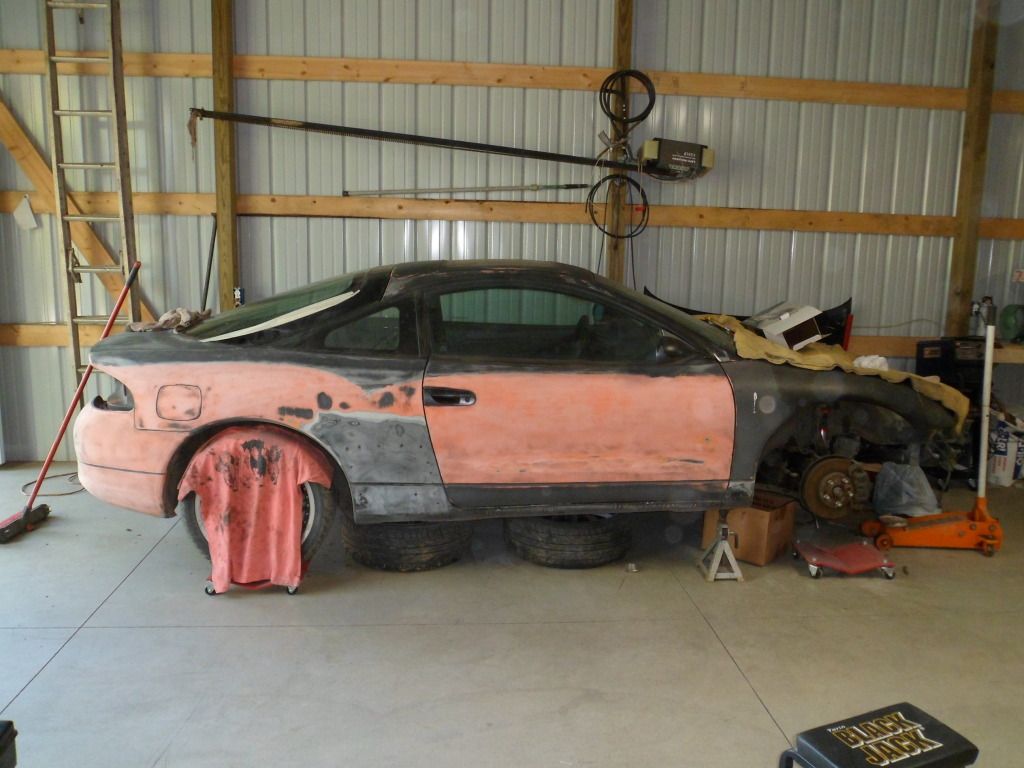

Once again got some more done today, moved the wiring harness around, and started getting things ready to pull the transfer case/transmission/motor (dont have a engine hoist :( )

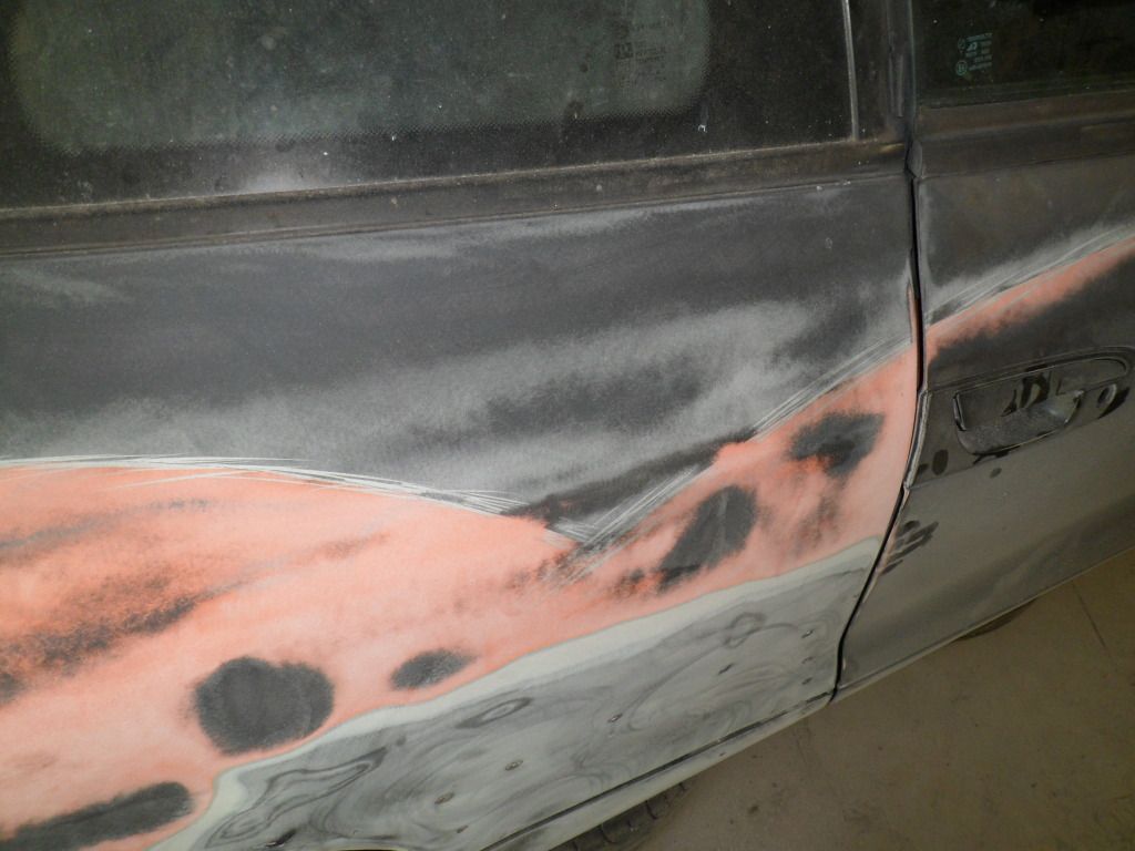

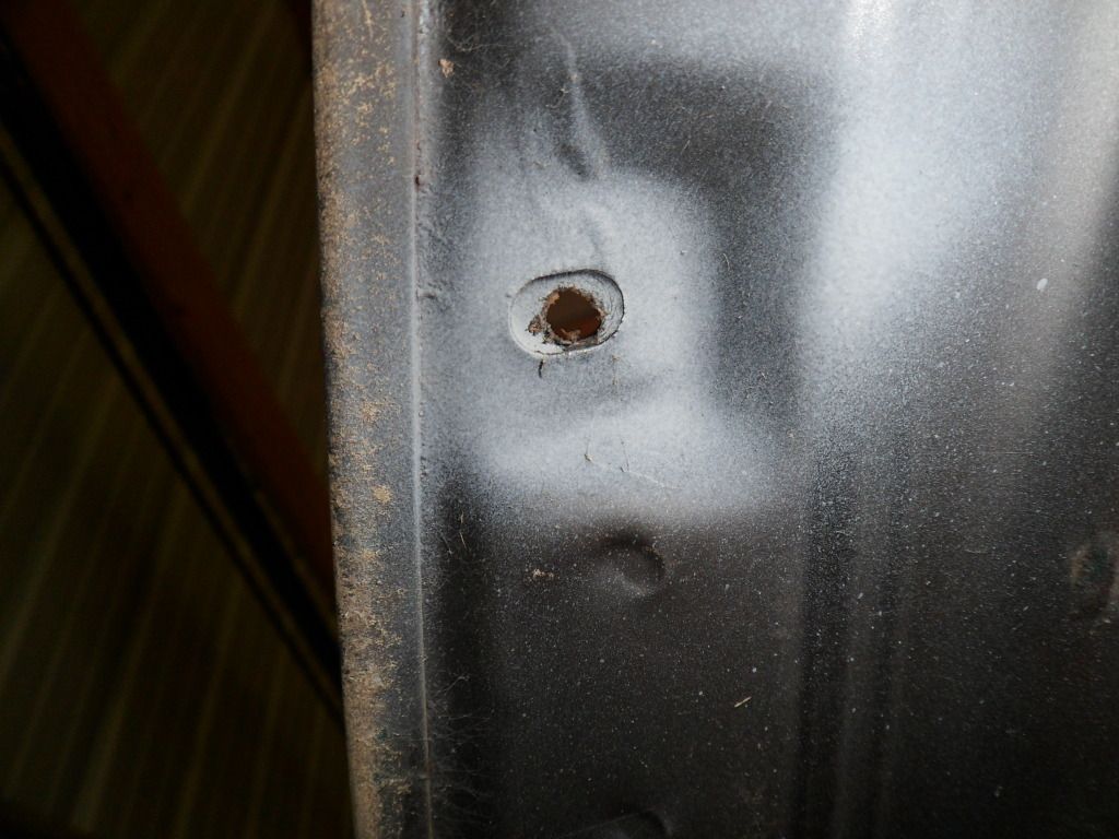

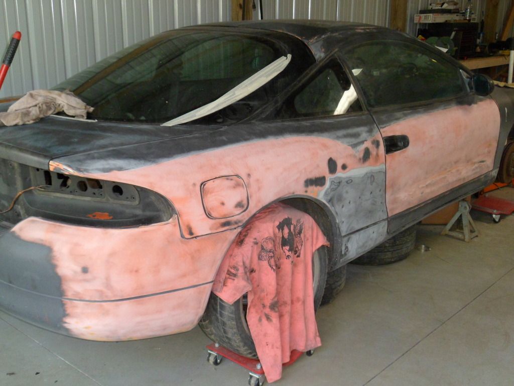

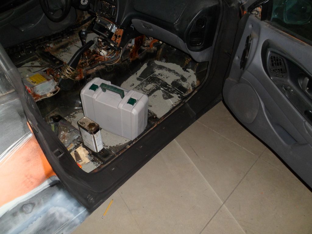

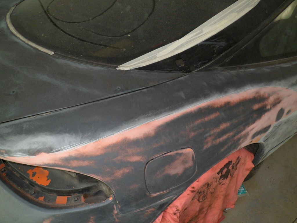

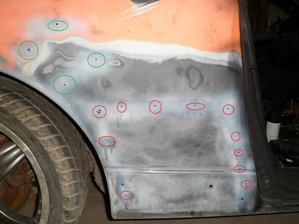

Almost all of the fiberglass bodywork is done, I had to cover the holes that were left over from the previous owner mounting the fiberglass sideskirts with drywall screws...sigh

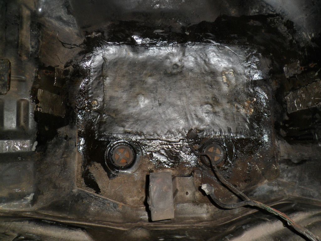

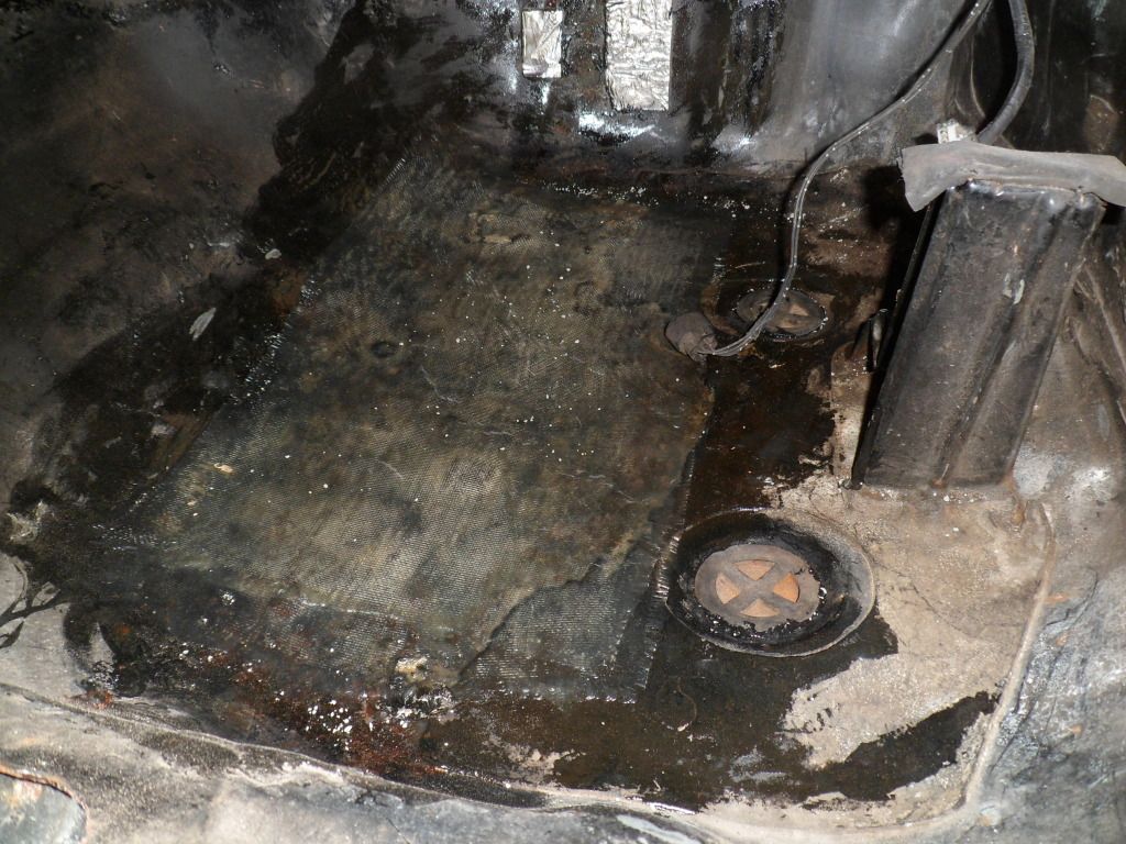

I also laid two big sheets in the back where there was the mouse nest(and reeked of piss). most of the metal had rotted away and i needed to reinforce it.....
Goodbye to the nasty bright orange door jams. IDC if it is spray on header paint, just glad that pumpkin orange is gone haha
got the layers of fiberglass set in the back, still in drying process
fiberglass hard as a rock :)

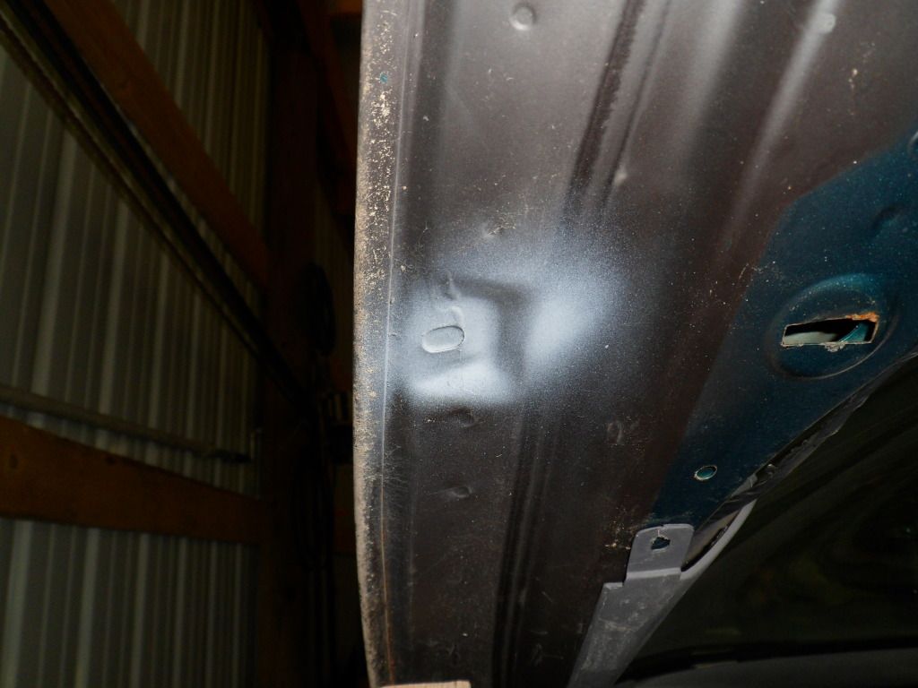

when my friend had the car a few years back someone backed into him in the parking lot, it permanently bent the support inside the car WTF!! LOL

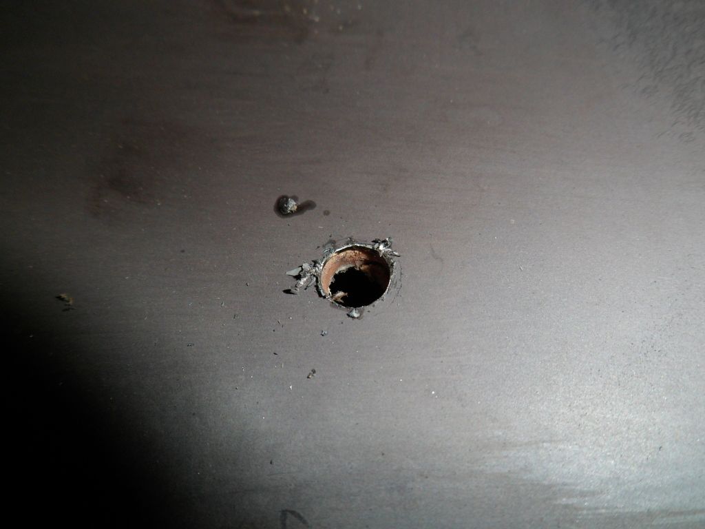

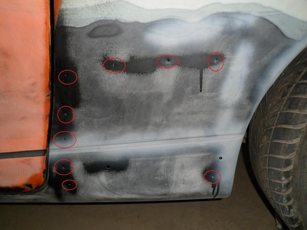

this is the passenger side where they ran drywall screws into the body to mount the side skirts. all the red holes are from the drywall screws, the green holes up top is where i drilled to pull the massive dents
and the drivers side.....
this is how the motor sits now, all ready for disassembly....just need an engine hoist :(
I put small patches of fiberglass behind each hole where they mounted the side skirts, that way i can just smear bondo into the hole and let it set up, instead of having to sand down an entire quarter panel.

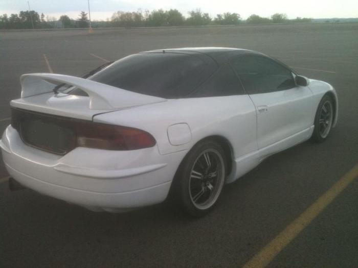

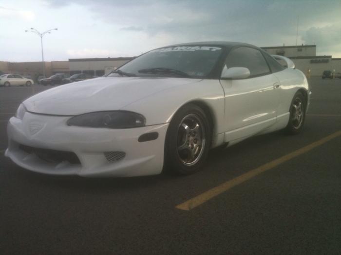

Anyway, here is a pic of my friends car...2GB Talon with Highrise wing. Looks like another one will be on the road soon!
OOOOOOO Thats one of the first I have seen with a stock ish body. I love it. I am playing hell finding the twisty skirts though
OOOOOOO Thats one of the first I have seen with a stock ish body. I love it. I am playing hell finding the twisty skirts though, and I must ask, where did he get the ridge on the back bumper?
Yea, the twisties are hard to find, they were only on the 95. The 'ridges' are just part of the bumper cover, not an add on. I believe this is a standard 2GB front and rear (2GA's do not have the ridge).
