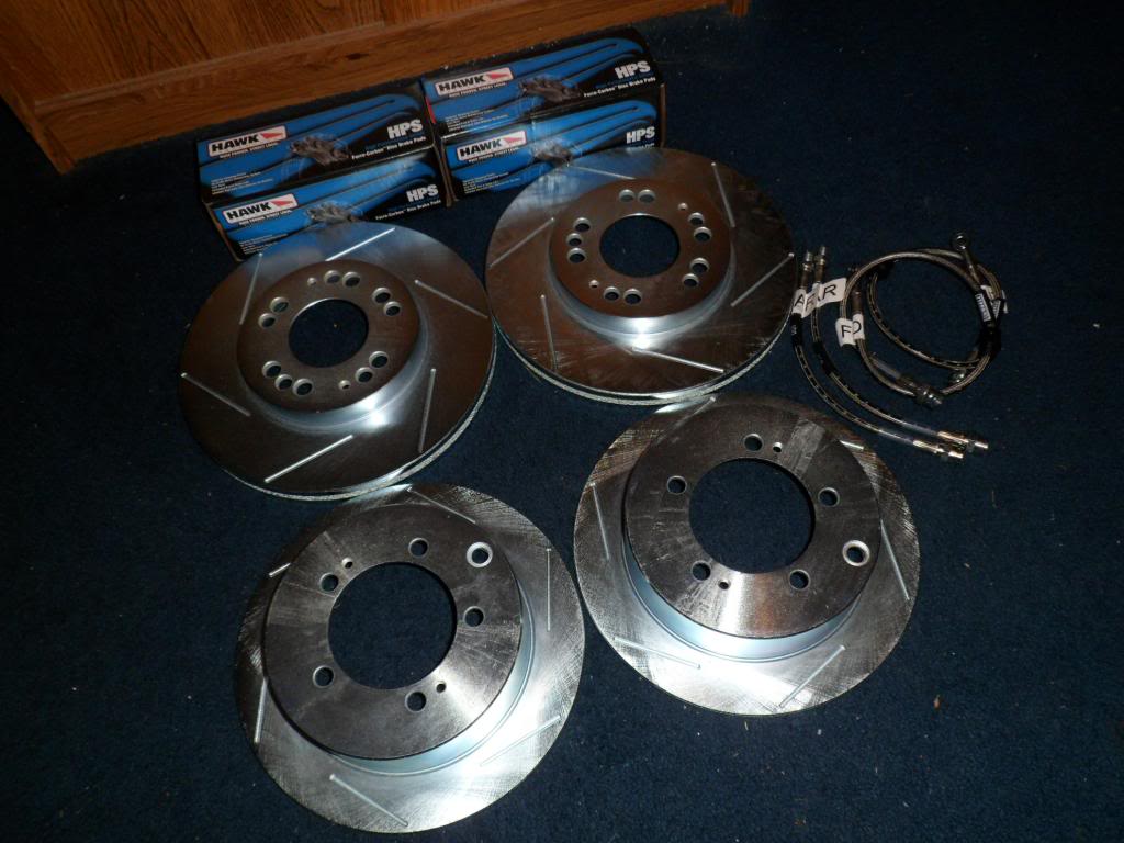

Finally gave in and bought all of my brake items at once from Revworks. Seemed to be a great deal for the product offered, and boy I was not disappointed.
Slotted front and rears
Hawk HPS pads
Russel SS lines
All of it is very high quality items. I was surprised with the russel lines due to their individual price. I was surprised of their quality. If I ever decide to upgrade to a larger or more aggressive (4000 series) rotor I know where to go.

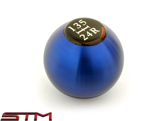

I cant tell how that shifter looks without the center console on. I'm debating buying the same one, just wondering the quality/feel of it. If u can, shoot a picture up when u get the center console on, and let me know how its feels. The build looks great man keep up the good work!
If you give me a day or so I can throw the center console back in and snap a few pics. I love the feel though, feels very solid, fitment was spot on and all the parts were nice.
If I were to have a complaint it would be the shift knob itself. I know its going to get hot as hell in the summer and the overall size is not big at all. Its weird because your hand almost wraps around itself. I may order this knob though:
Yea i was a little concerned about the Jam nut that goes under the knob. Does the knob itself thread on??? Because i wanted to look into getting a different knob that would thread onto the shifter. Thats refreshing that you say it feels solid, was worried about the overall quality of it. Does the throw feel shorter?
I like that shift knob too =D
Yes the knob itself threads on. The jam nut is just there to stop it from threading all the way down(which makes the letters crooked). I love the feel of it. I have it set to 50% and the throw is very short and solid.

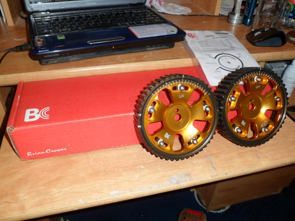

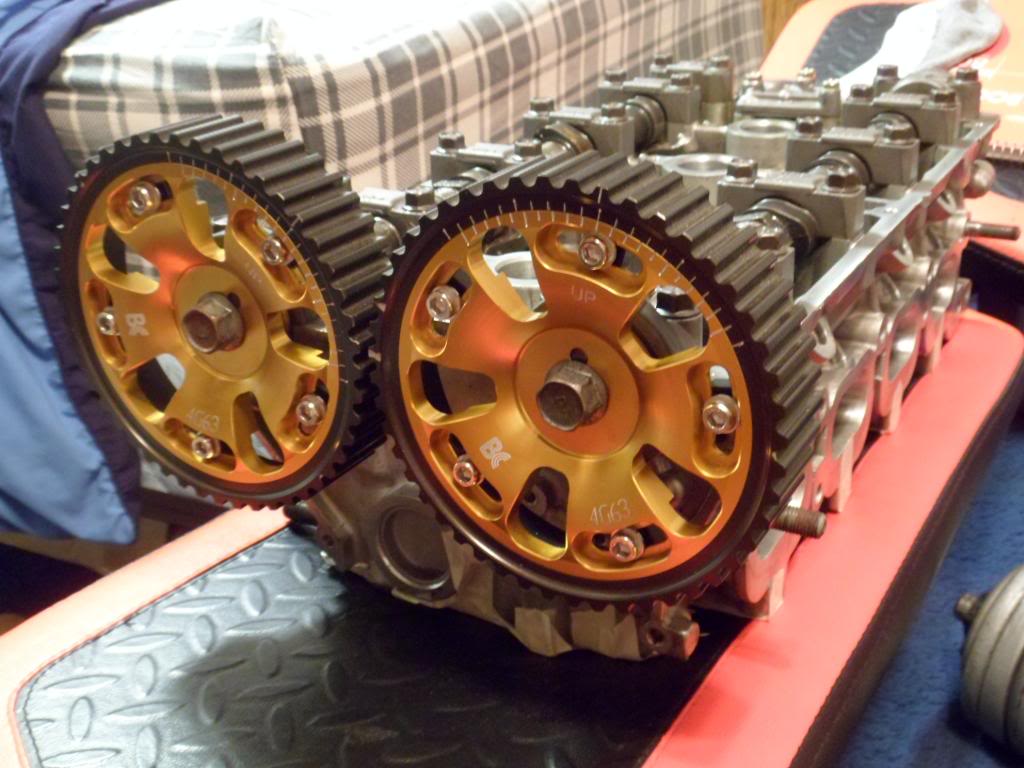

BC adjustable cam gears and cams(got the cam gears for half price and only been fitted!!!!)

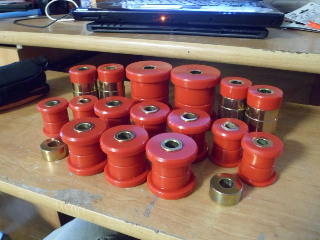

And my rear lower control arm bushings came in today from Energy Suspension!

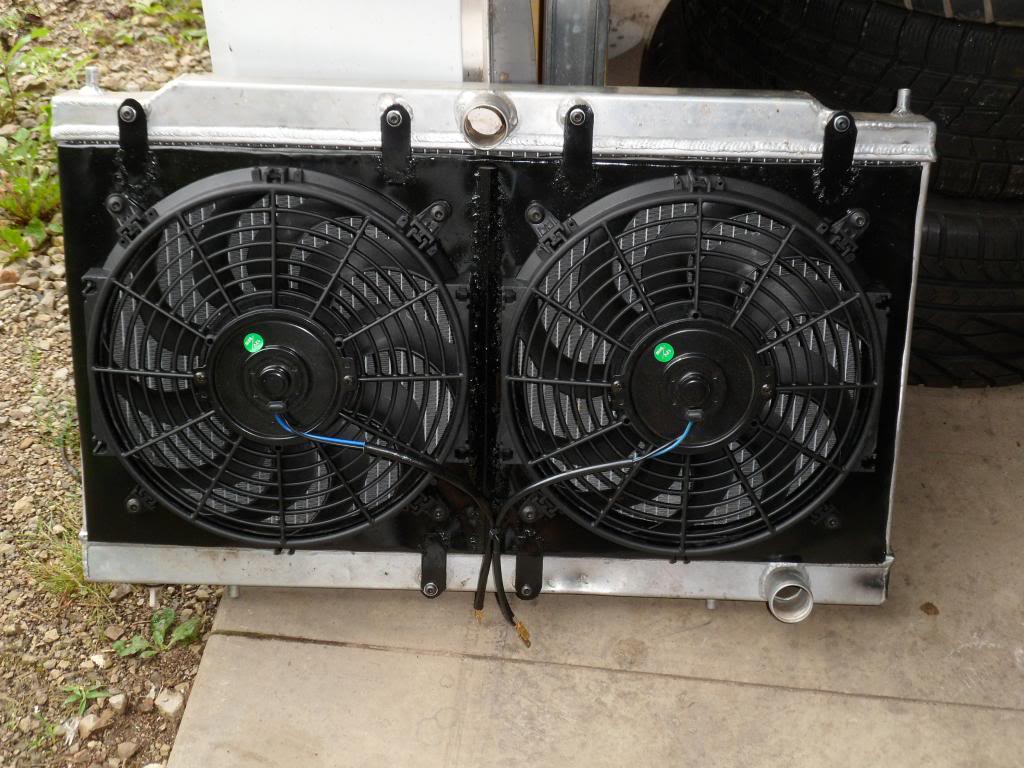

Snagged up some slim fans. They flow 1550 cfm each. Actually found them on a honda parts site that I got my slim fan for my honda from. Universal fit and still high flow.

Got a few more parts in and even made my own radiator shroud for $20

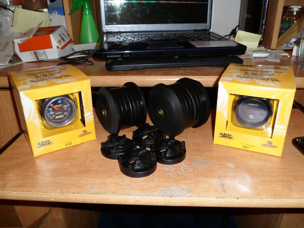

Prothanes, digital oil pressure gauge, and cobalt boost gauge to match my blue LC1
Not bad for $20. Ugly as a mofo but fully functional

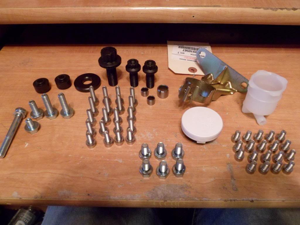

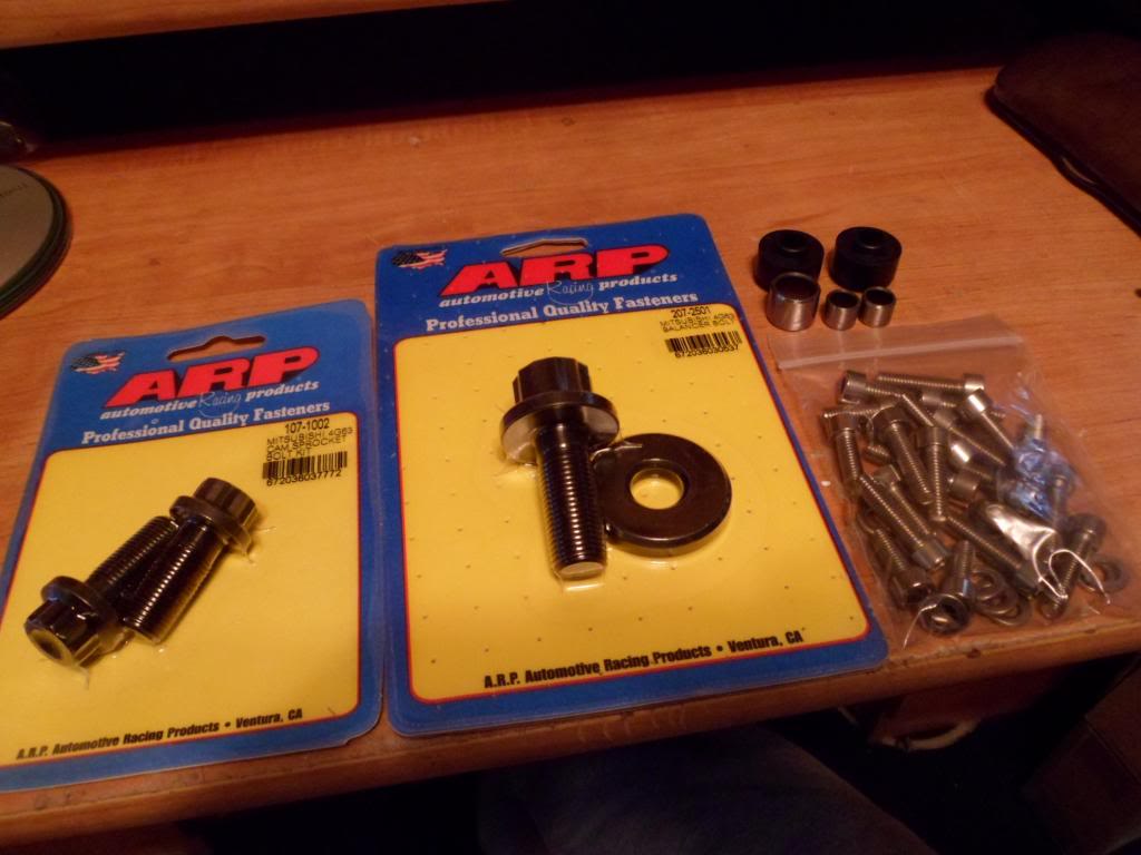

Picked up some more goods from ExtremePsi:
BSPT Plug
OEM Flywheel Bolts

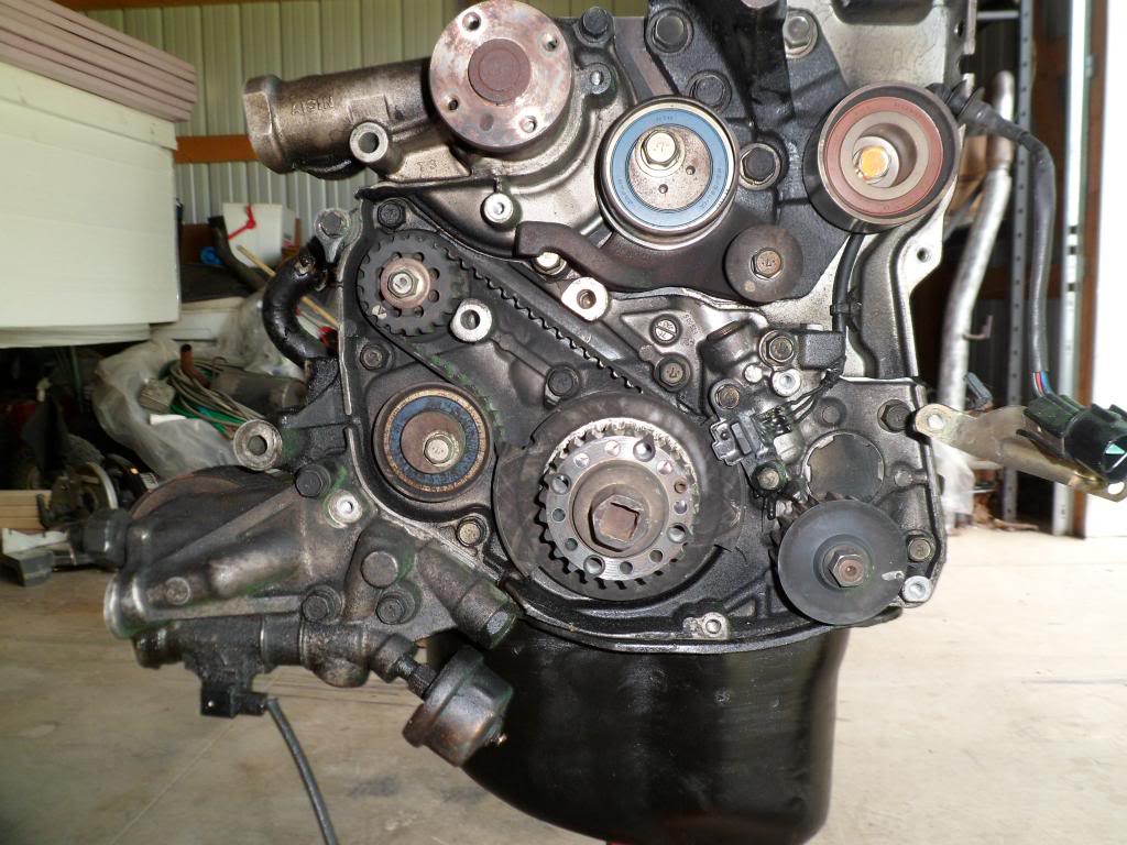

Balance Shaft elimination spacer and plug.(gonna make my own shaft).
More -an fittings to get the fuel system ran.

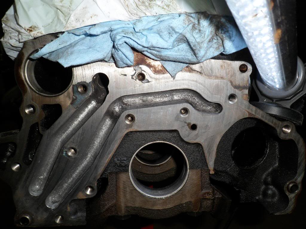

Did a little bit of work last night when I got home. Got the intake manifold painted as well as the throttle body elbow. Nobody likes rust, but oxidizing aluminum is just as bad and ugly LOL.

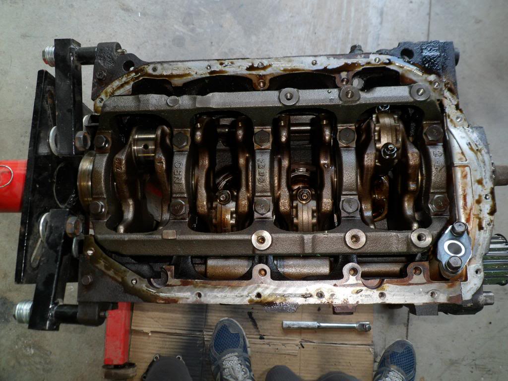

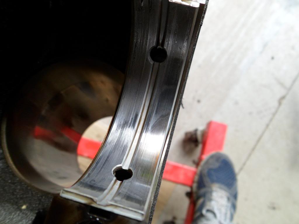

I also ported the oil galleys on the block per Bogus SVO's instruction.
Rough cut
Final pass with a dremel smooth stone(dont have any smaller tips to get into the corners).
The passages look rough but they are smooth to the touch.

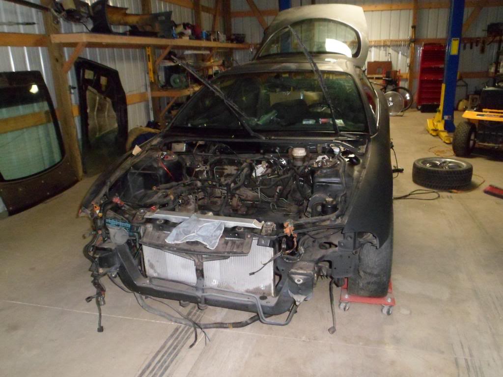

Here soon I am going to be dry fitting everything in the engine bay(without crank or internals). Just so I can get all of my wiring taken care of. Most of my plugs are broken and the wire is brittle. Really wish I had the $$$ for a milspec harness. Along with that Ill find a place to mount my AFPR, fuel filter, run my new battery lines, overflow tank. And possibly start building a downpipe.

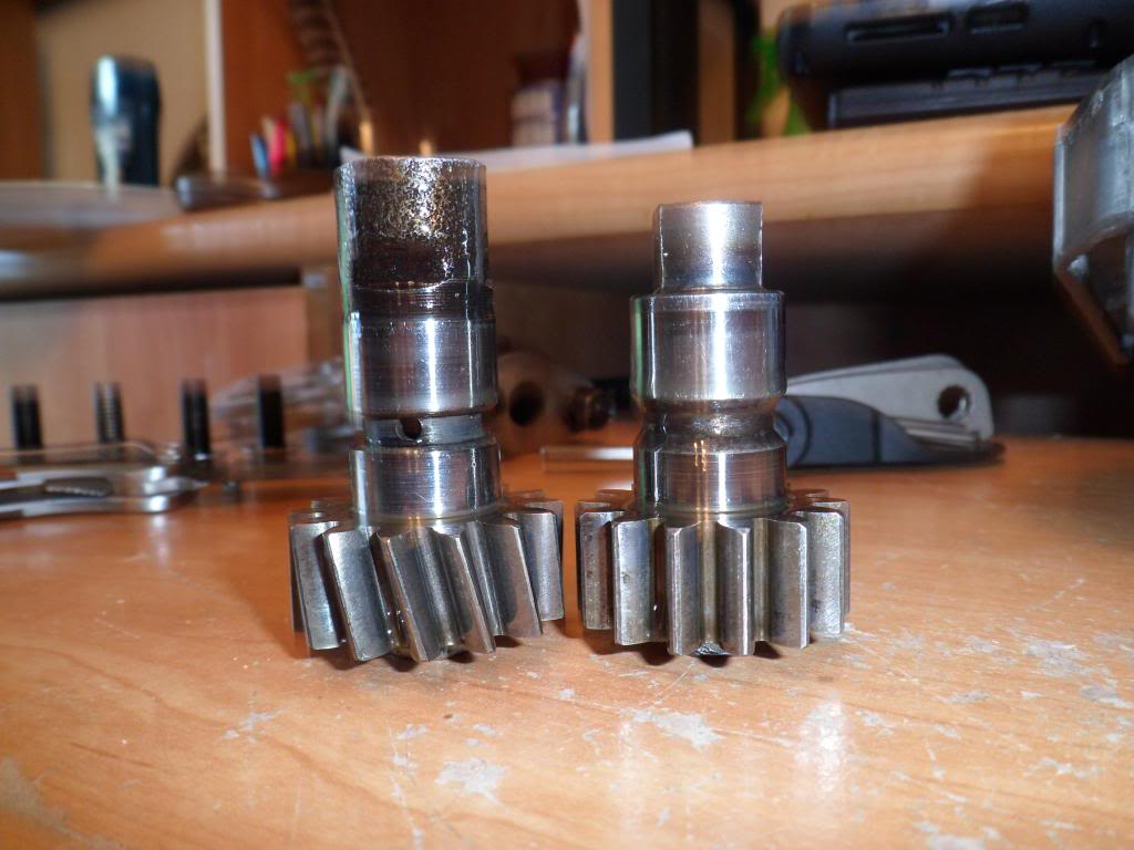

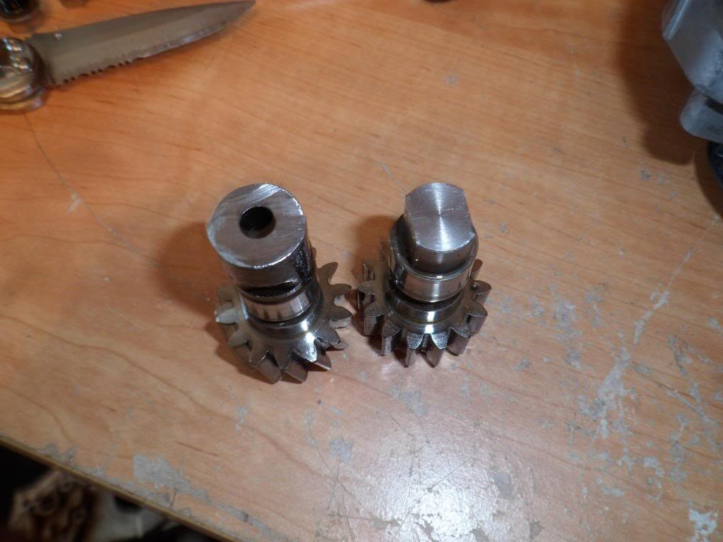

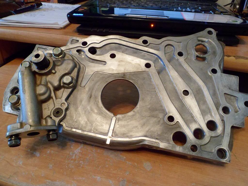

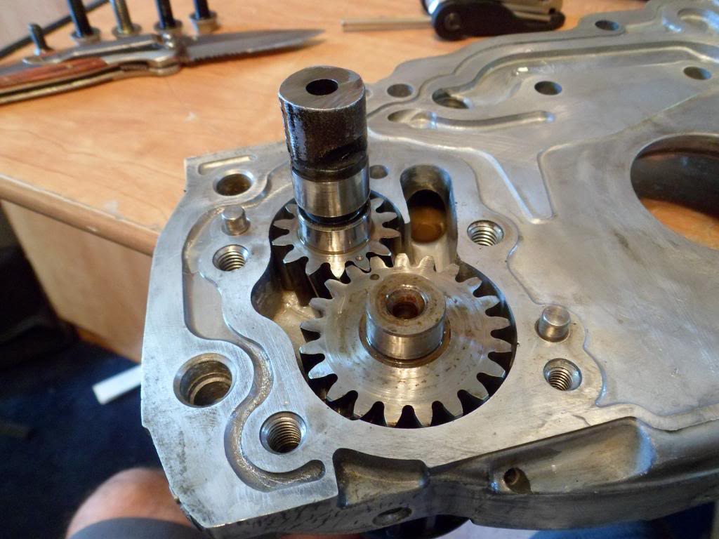

Finally got a day off to get some work done...and I slept half of the day away XD. Still managed to get the rest of the gasket off of my front cover and get my stubby shaft made. I would up cutting it down from the OEM shaft. Let me know what you think!
Homemade shaft on the left, old stubby shaft on the right. I will no be using the stubby shaft. It has no oiling hole.
