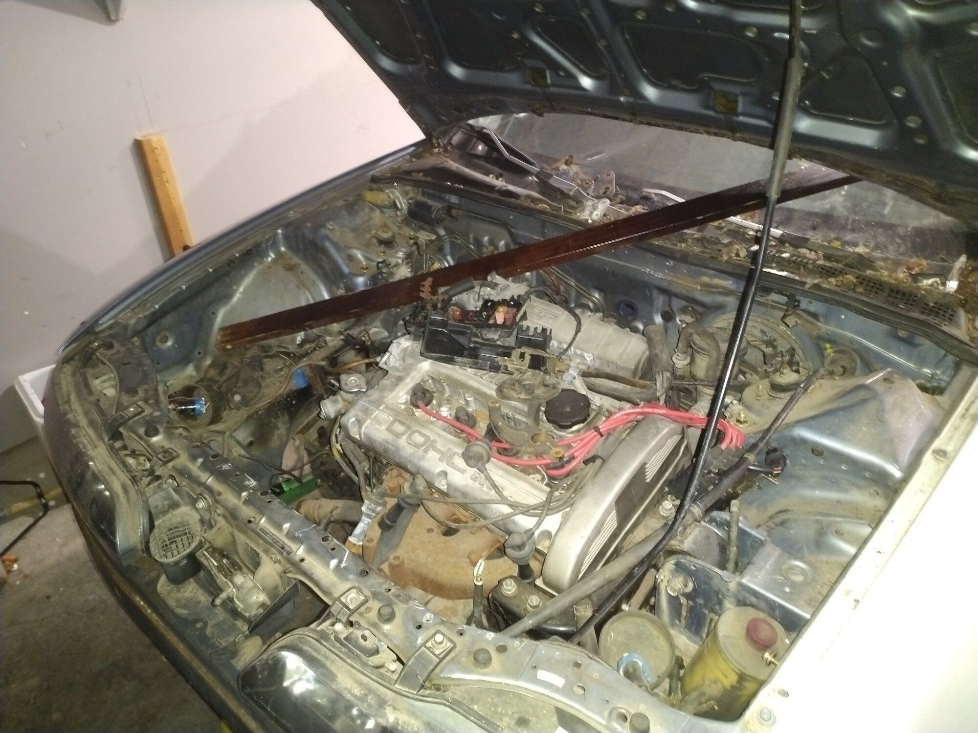

Not new to cars but new to DSMs. I will probably get flamed but am working on a 92 Acura and am swapping a 4g63 in it. I know they are kswap and other swaps am just not a big K fan so that's why I decided to go this route.

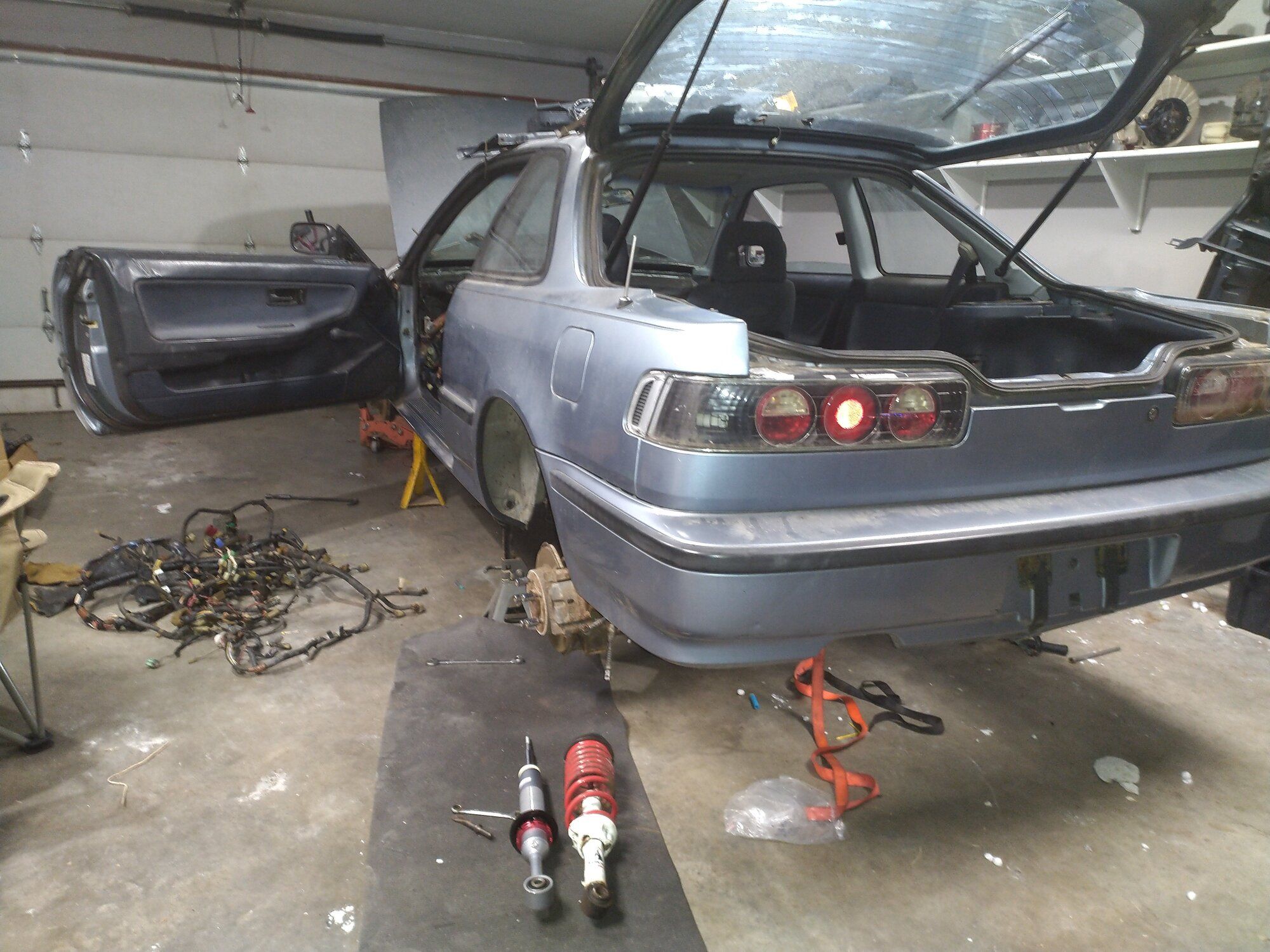

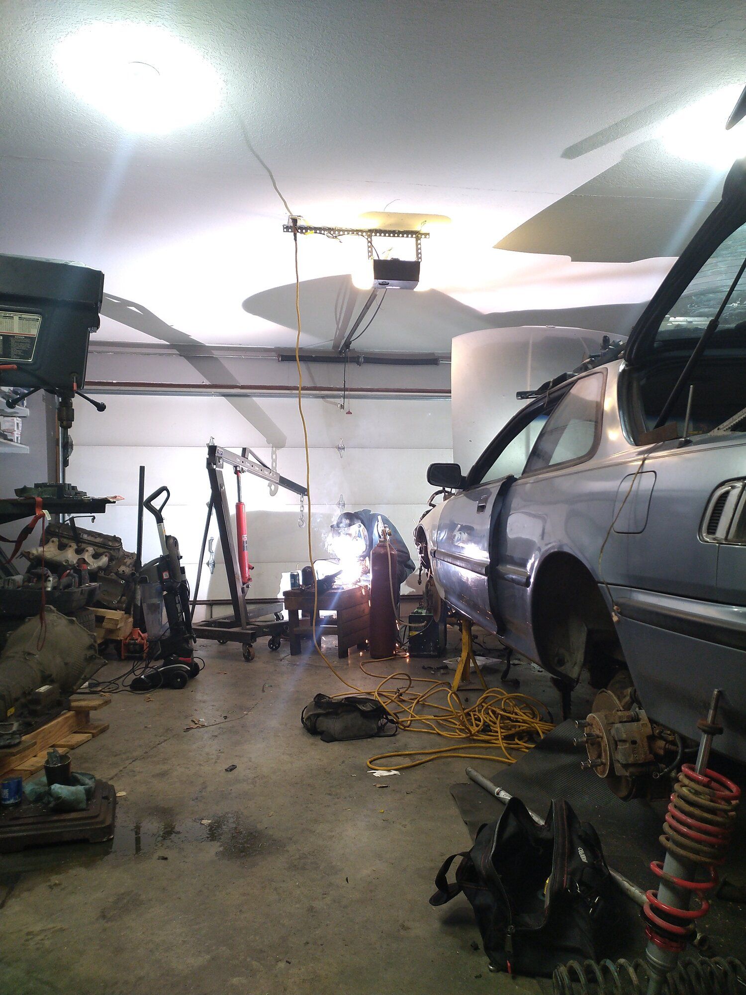

Car should hopefully be running in a few months since I barely get to put any time in. This mess started as a joke, I wanted to do an AWD Honda and I just happened to have this shell around and a buddy had a 4g63 laying in his garage from a car he wrecked years ago so I decided to make it fit.
The layout of the 4g is pretty close with the original b series, one mount fell right in and the other 3 just needed a little modification.
Motor is in.

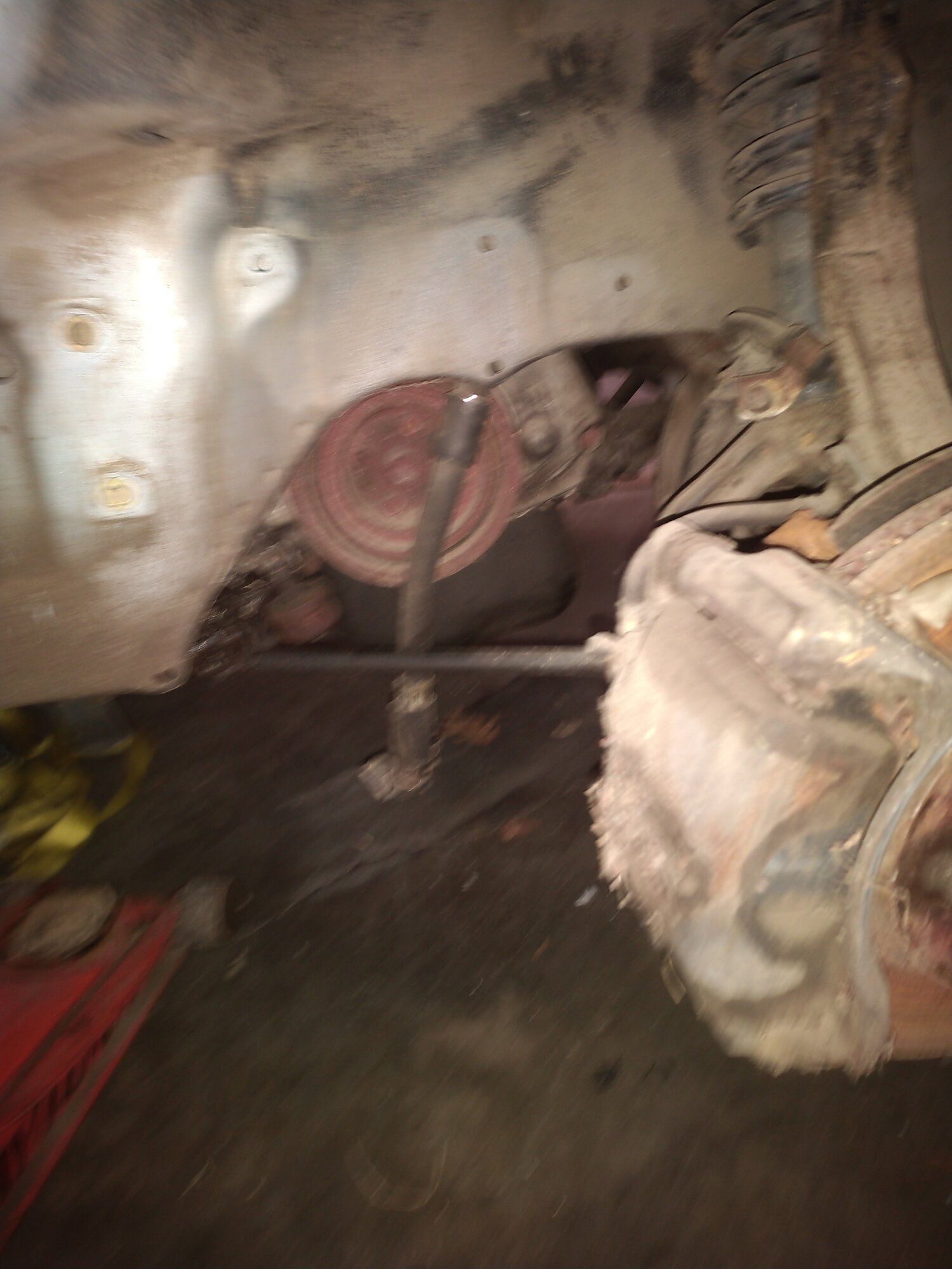

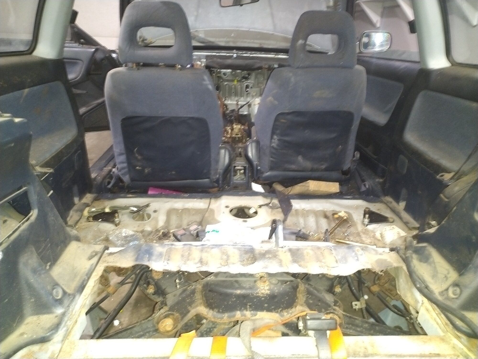

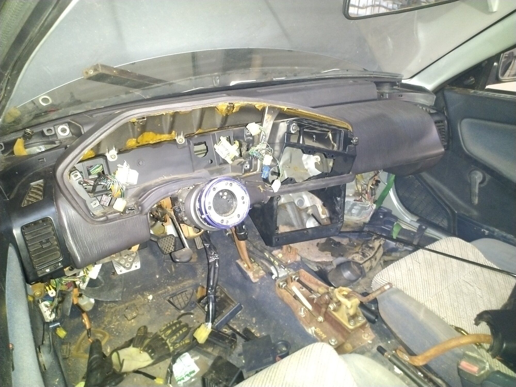

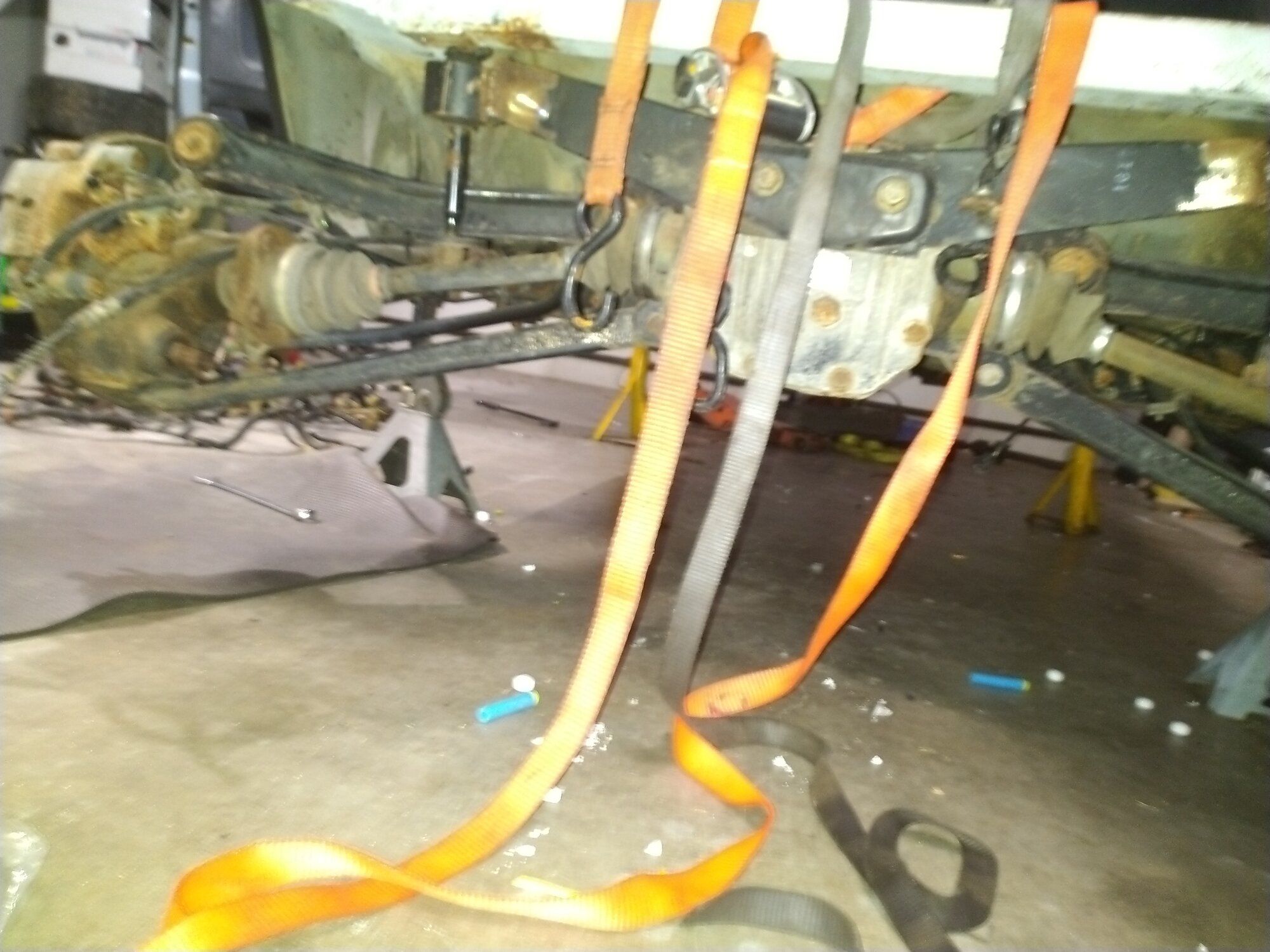

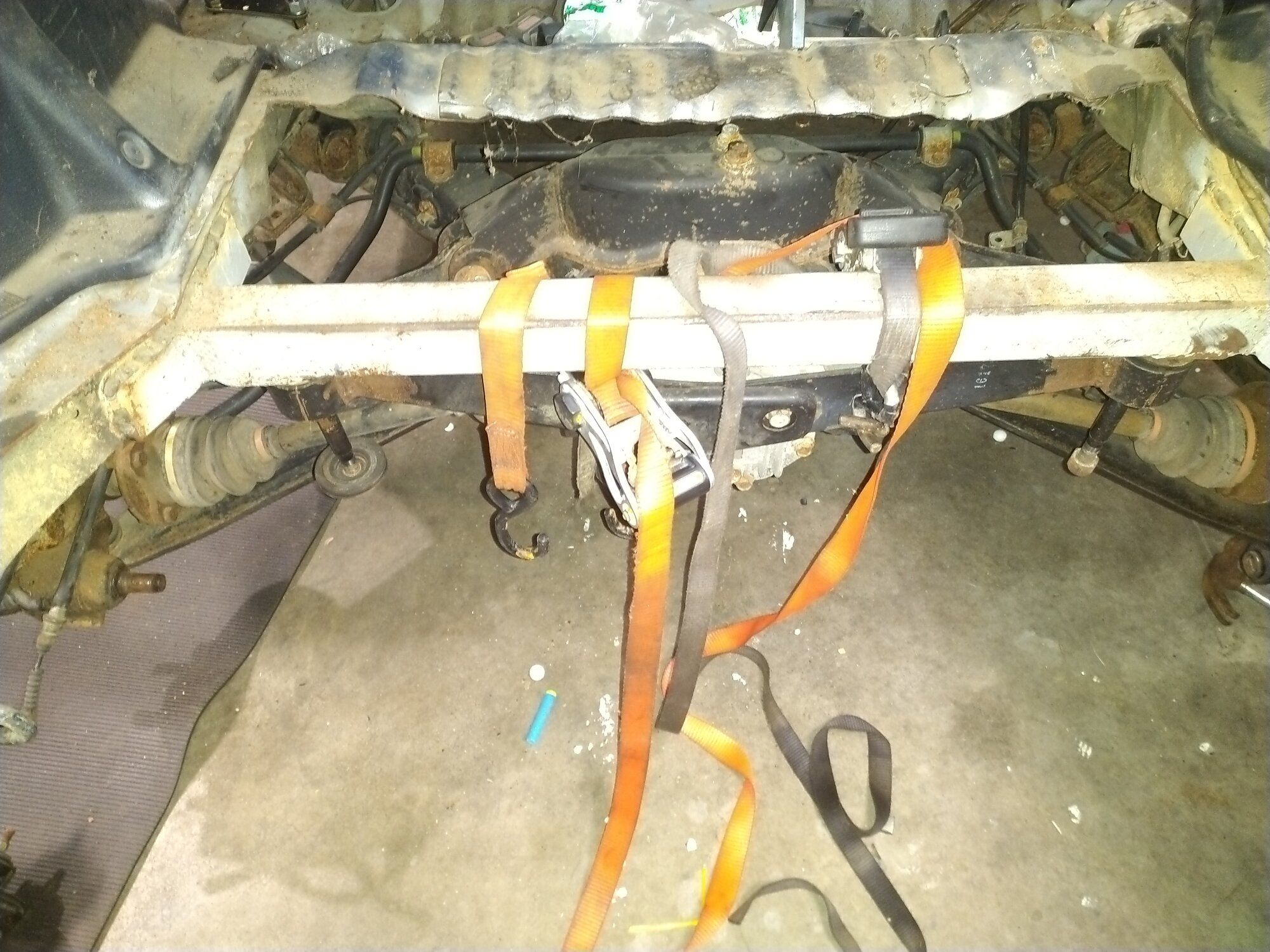

Rear subframe is in, currently modifying the struts. Wiring is in. Dash is been fabbed to fit.
Working on drive shaft mounts.

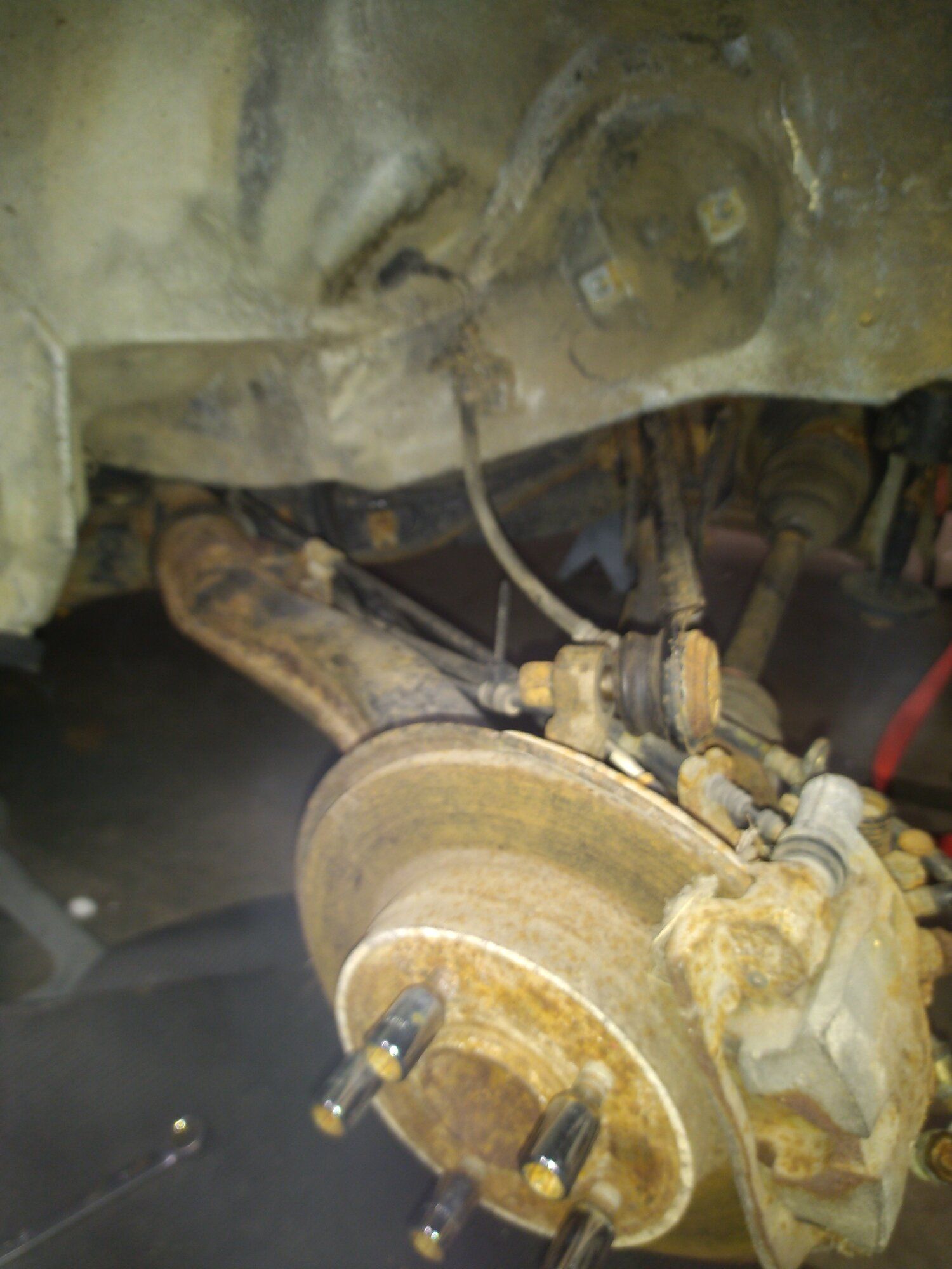

So finally got the axles sorted out lots of trial and error. 2yrs later didnt want welded axles in case I broke one and also vibration concerns.
Part number in the Pic is what worked on the passenger side axle
Hubs are 99 crv gives me bigger brakes, axles and 5 lug conversion
Passenger side axle is outer 28spline, 25 inner about 21in long
2006 mist evo gsr inner cup is 1g dsm
Driver side 28 spline outer 25-2 inner i think
99 prelude axle 3000 gt inner 21in I think
