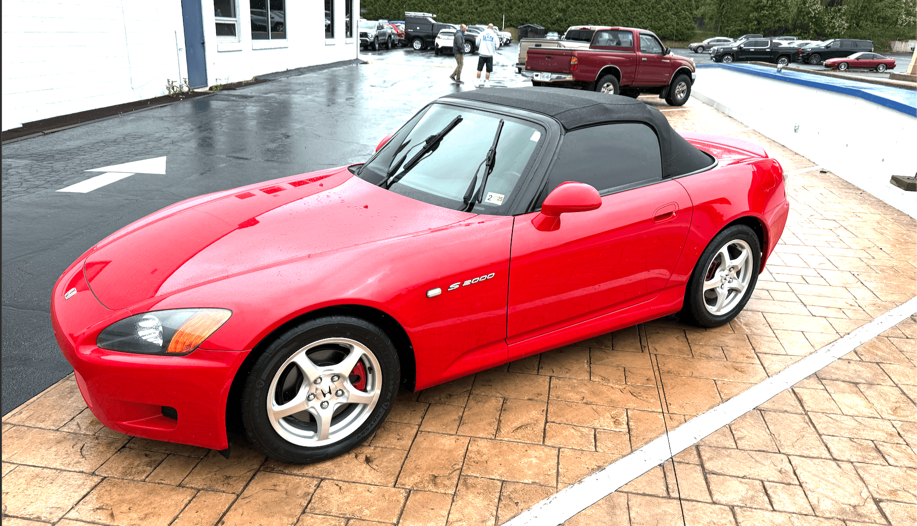

I've been debating making a profile for this car for a while because a Honda on a Mitsubishi site is sacrilege. It turns out, I just love cars and drivers cars like this are becoming rare. I was originally in the market for a black C5 corvette and I saw this Honda S2000 show up. It was sitting on a lot for MONTHS and they kept dropping the price. As you may or may not know, these cars have become a bit desirable as of late. I decided that if I don't pick this one up, I will never get to experience a car like this. It also checks a couple boxes for me that I've never had in a car. At it turns out, the price kept dropping because people were trying to get a loan on the car and lenders would not approve a 25 year old car. I am fortunate enough to have the ability to save the money needed to pay for it without a loan. So I got a fair price on a really neat car.

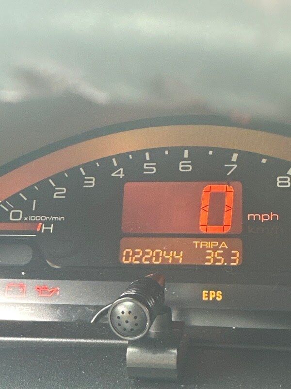

Miles: 22,049 at purchase (22, 6XX now)

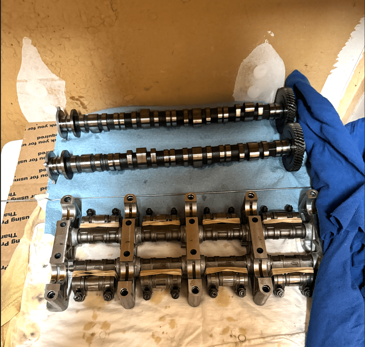

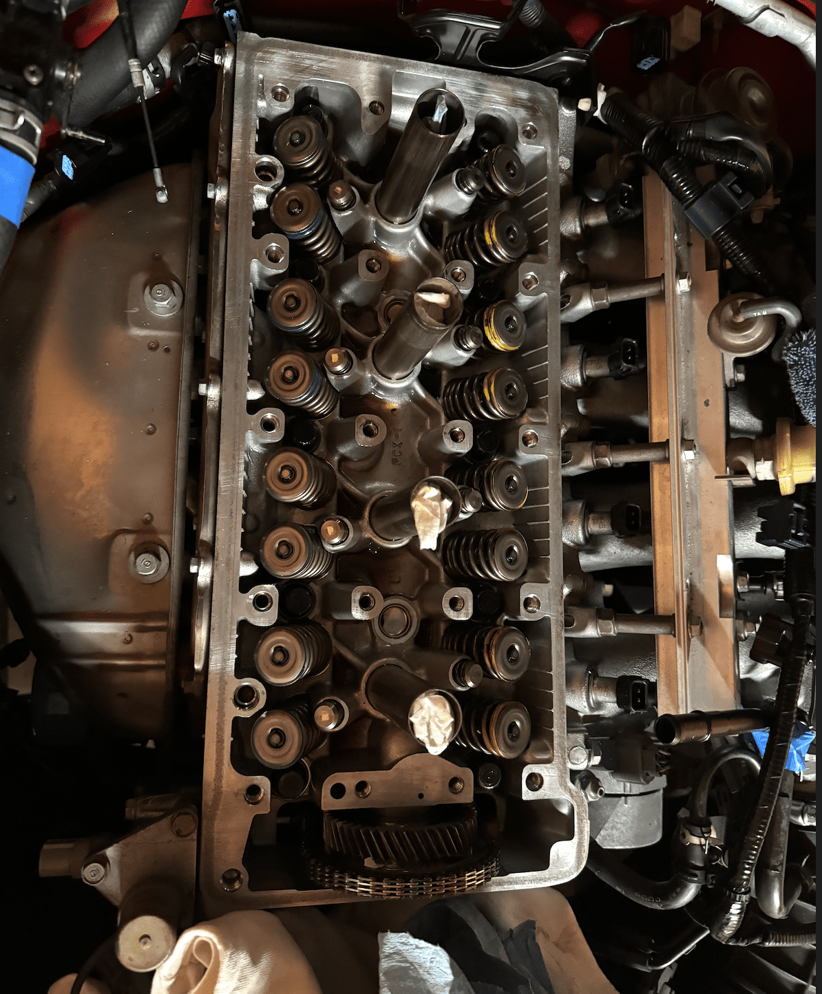

I had do drive through some light rain on the way home which was unfortunate, but the underside didn't really get too wet. I got it home safely and immediately put it on ramps and ordered the stronger AP2 valve keepers and retainers. The earlier ones will crack if you experience a mechanical over rev. Not knowing the history of the car and not wanting to drop a valve on an engine that is extremely difficult to rebuild and no longer available new, I decided to replace them before enjoying the 8900 rpm redline.

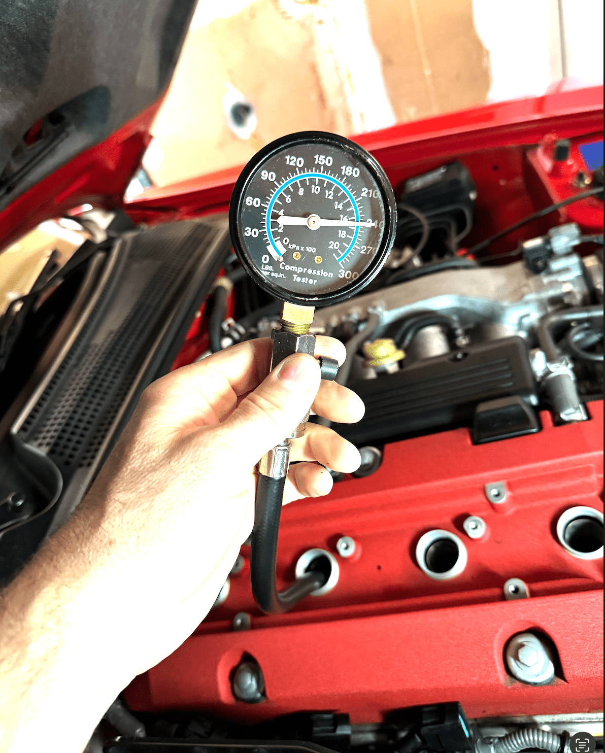

These things are REALLY easy to work on. I took my time and did a valve lash adjustment as required when finishing it up. It was such a joy to work on if I'm being honest.
Compression test on just 1 of the cylinders. This is a cold test and I didn't open the throttle plate because i forgot. All 4 holes were the same.

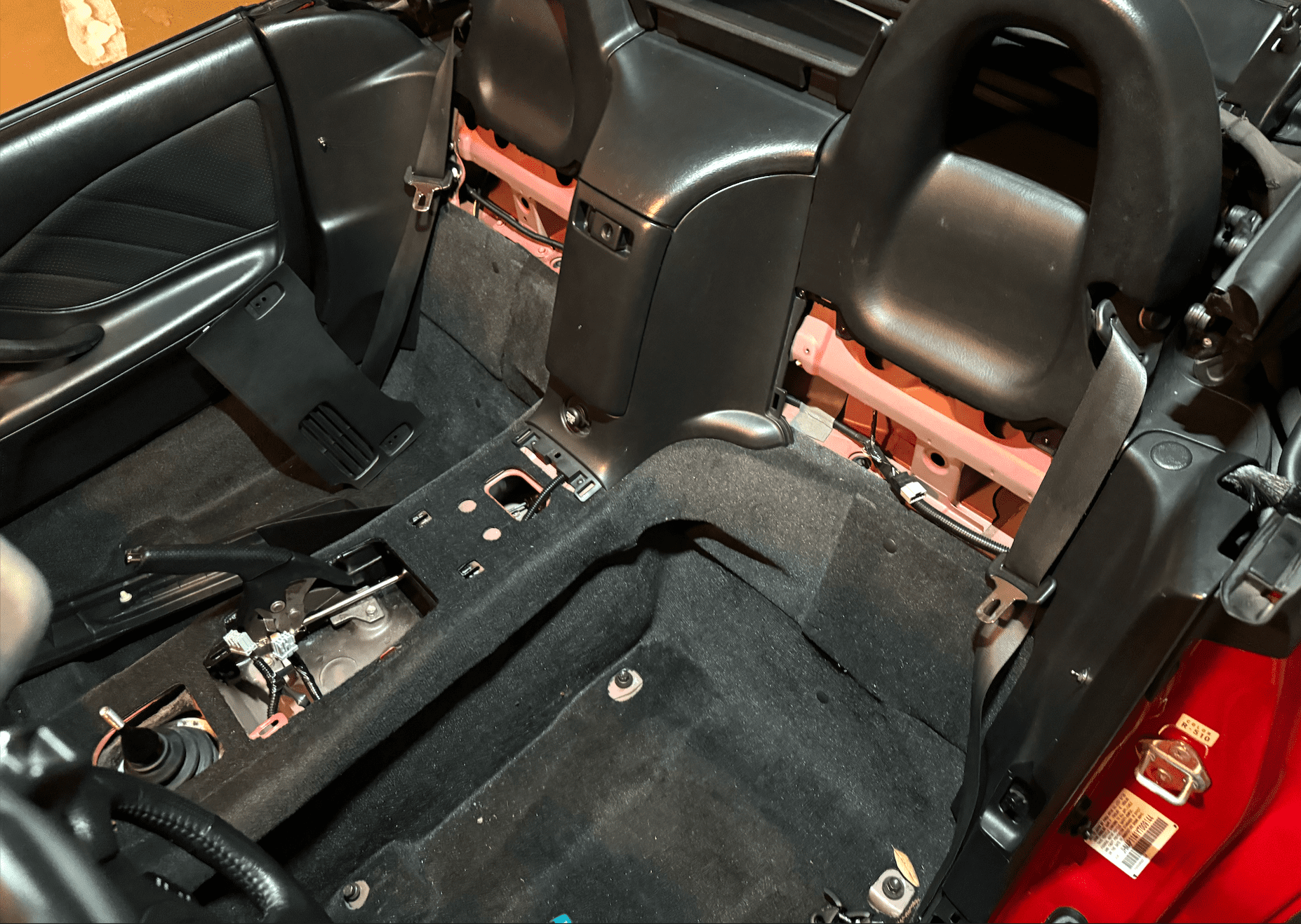

So, it turns out I got a good one. Lots of these now are oil burners because they can score the cylinder walls, lose compression, and burn oil. This winter I may do the oil squirter banjo bolt upgrade to give the cylinder walls more oil at high rpm. Next up was a deep clean of the interior as I do on all new to me cars.

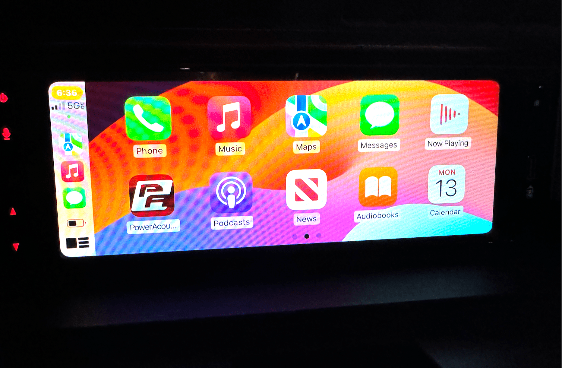

Finally finishing it up with a single DIN head unit upgrade that supports apple CarPlay and Android Auto.
