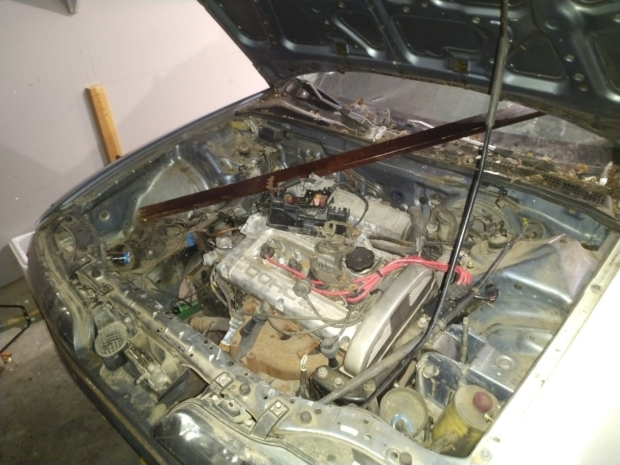

The layout of the 4g is pretty close with the original b series, one mount fell right in and the other 3 just needed a little modification.
Motor is in.

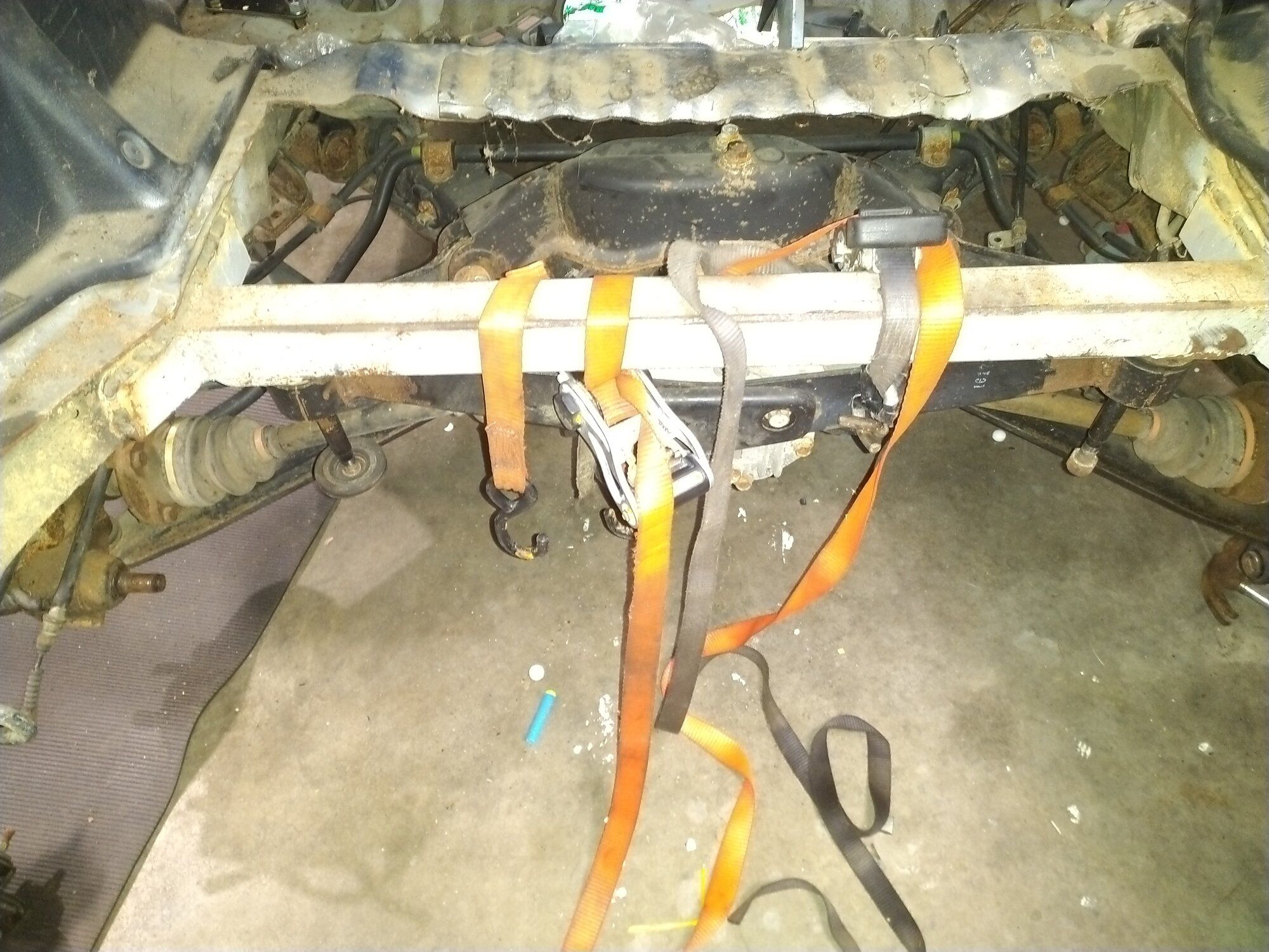

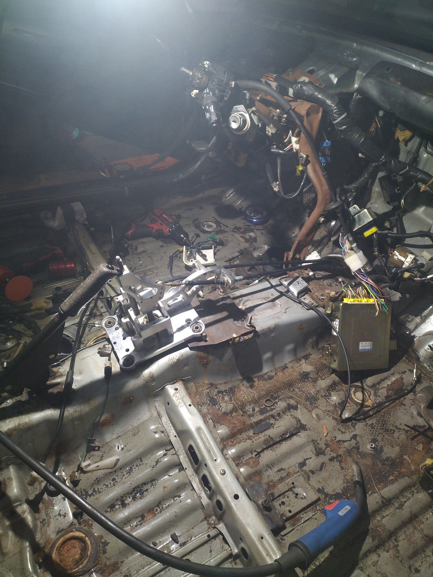

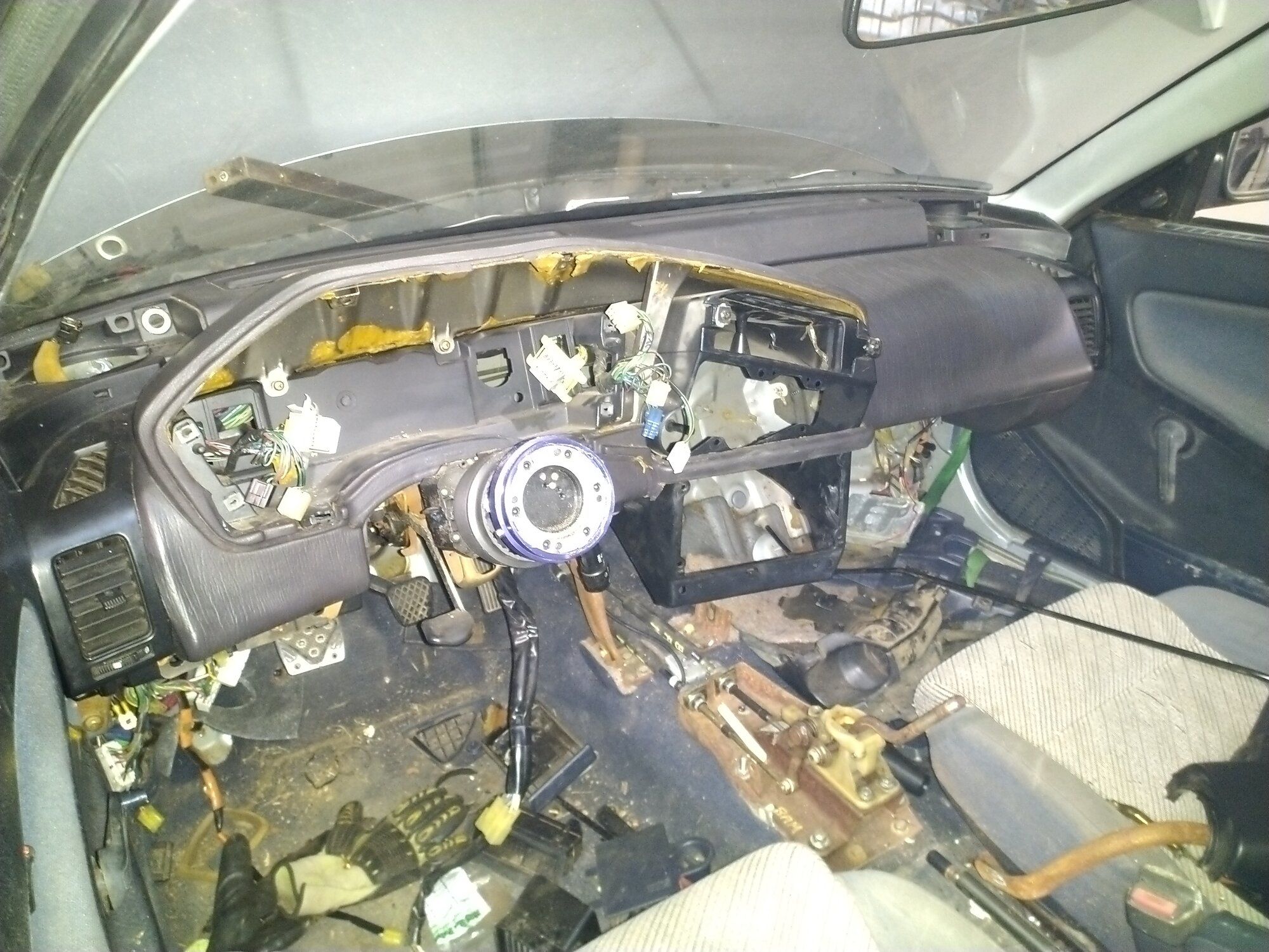

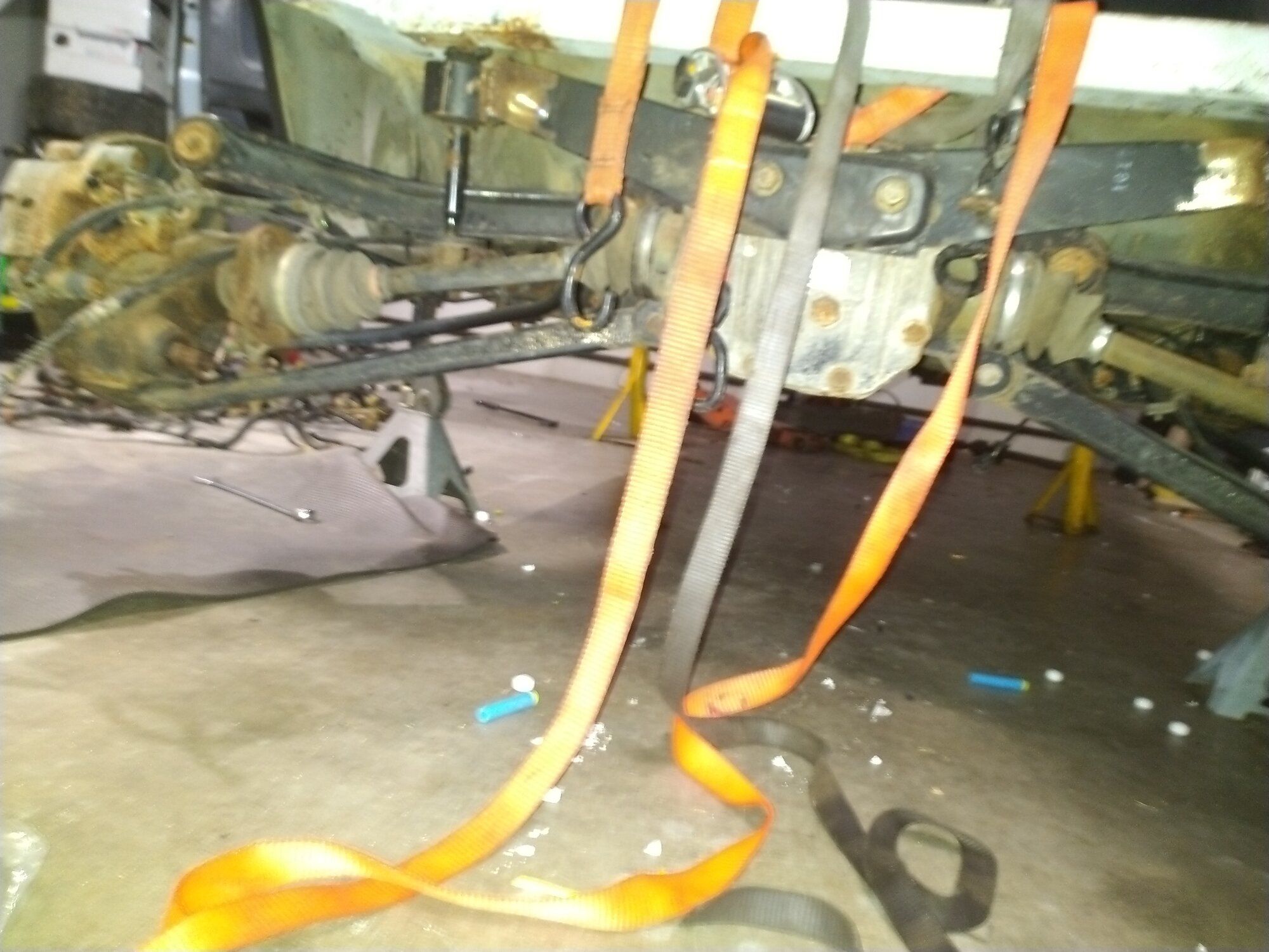

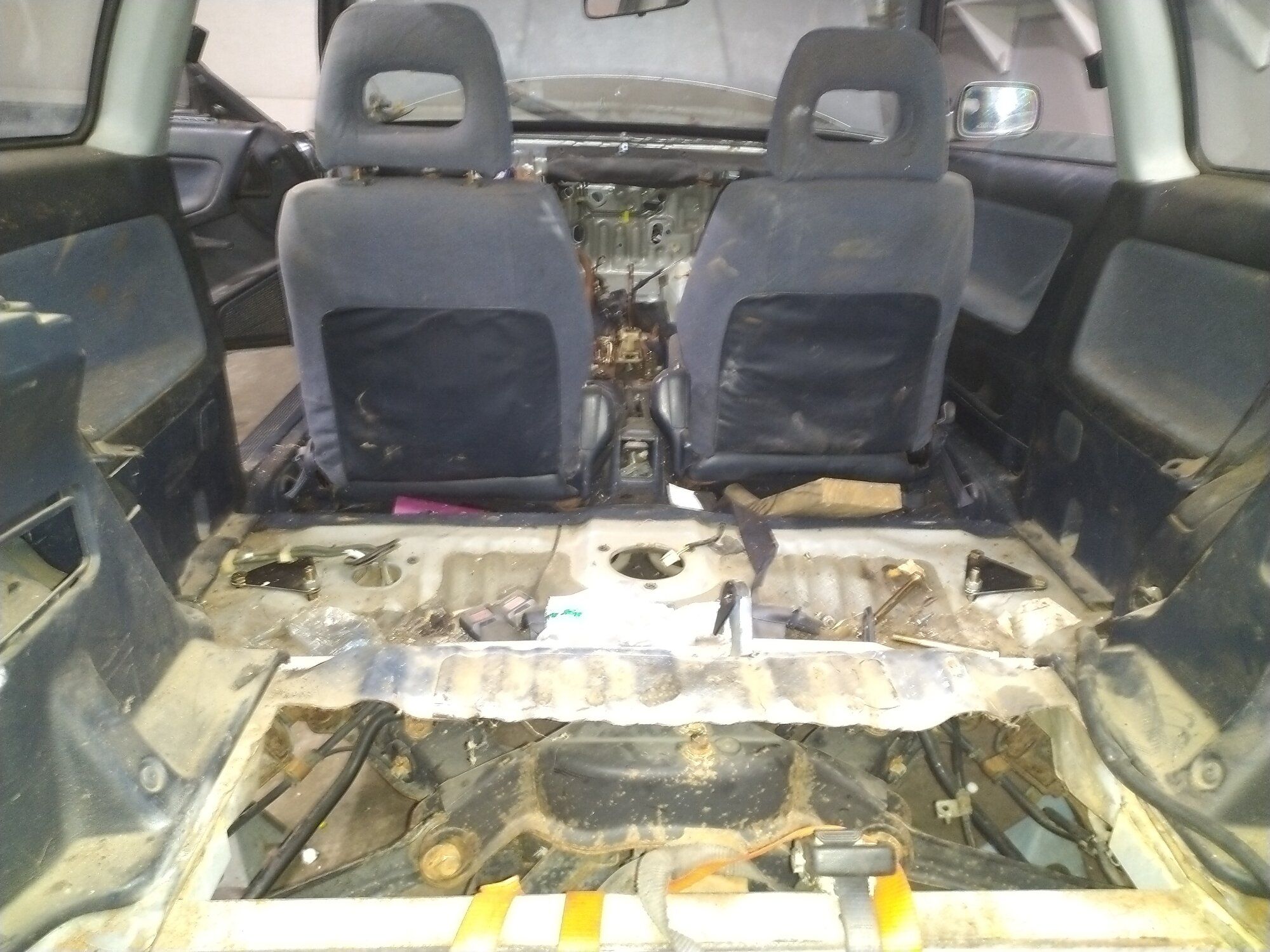

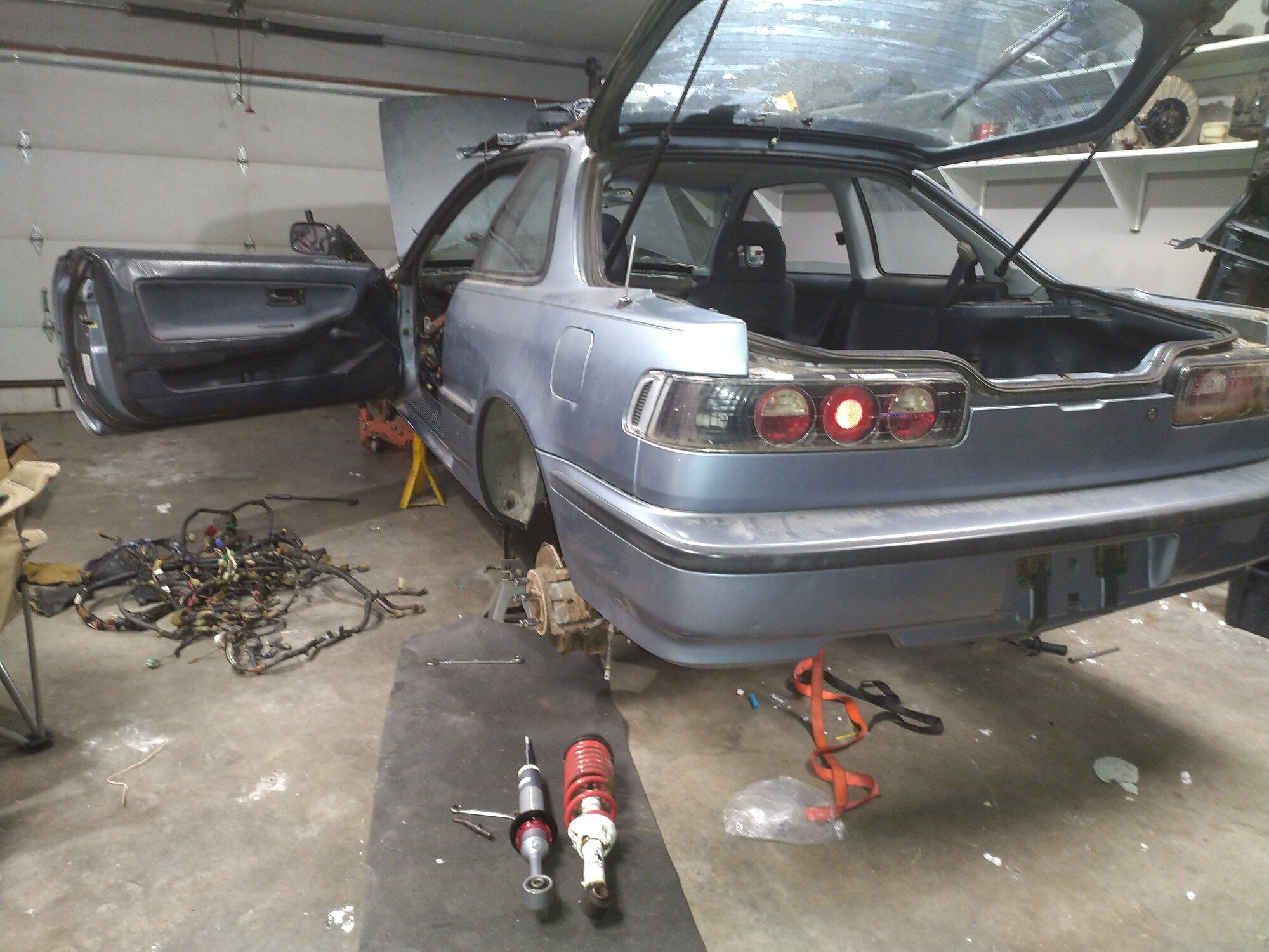

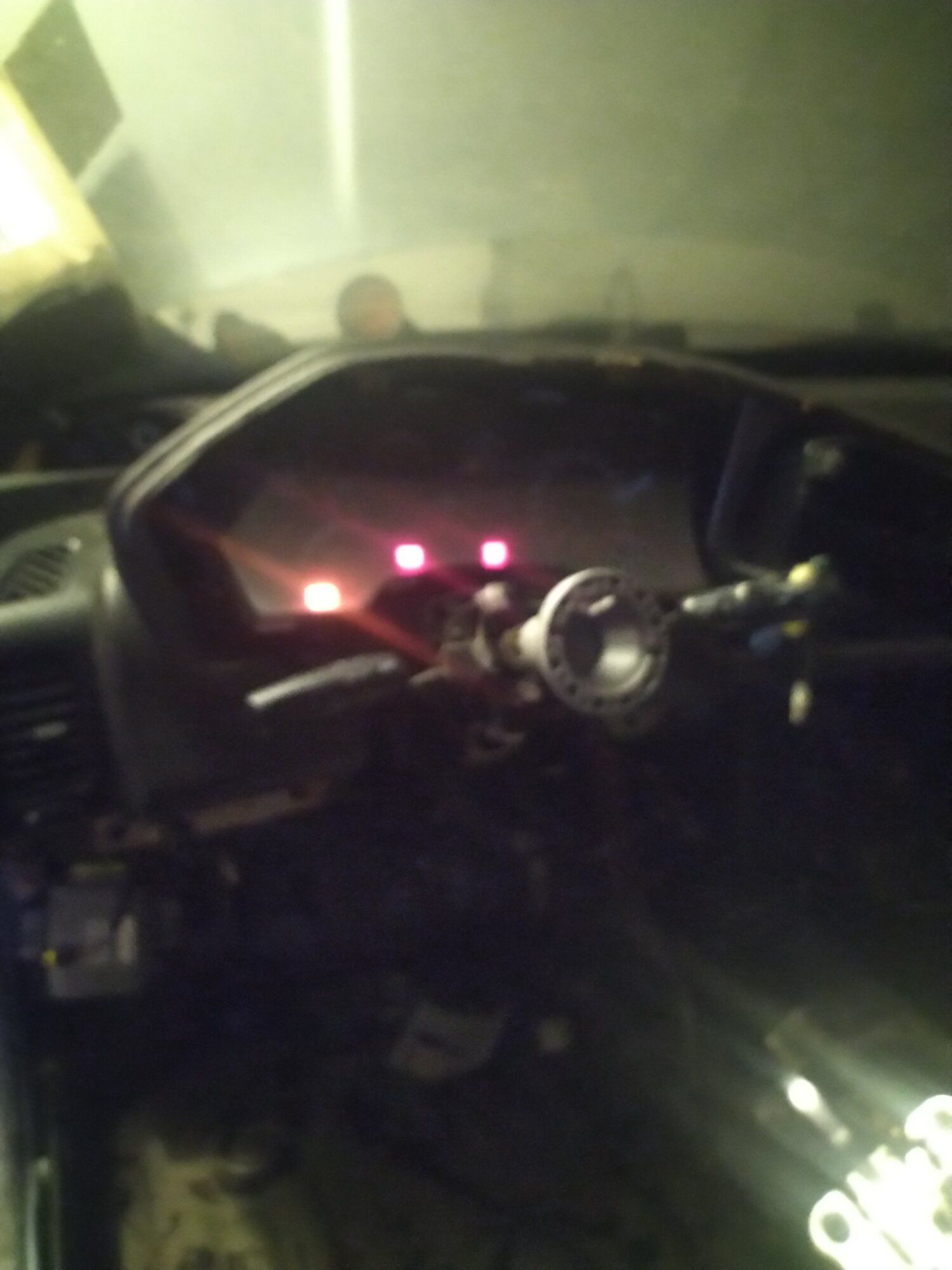

Rear subframe is in, currently modifying the struts. Wiring is in. Dash is been fabbed to fit.

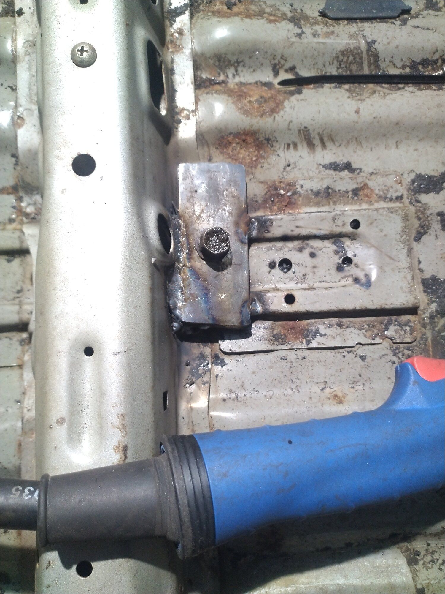

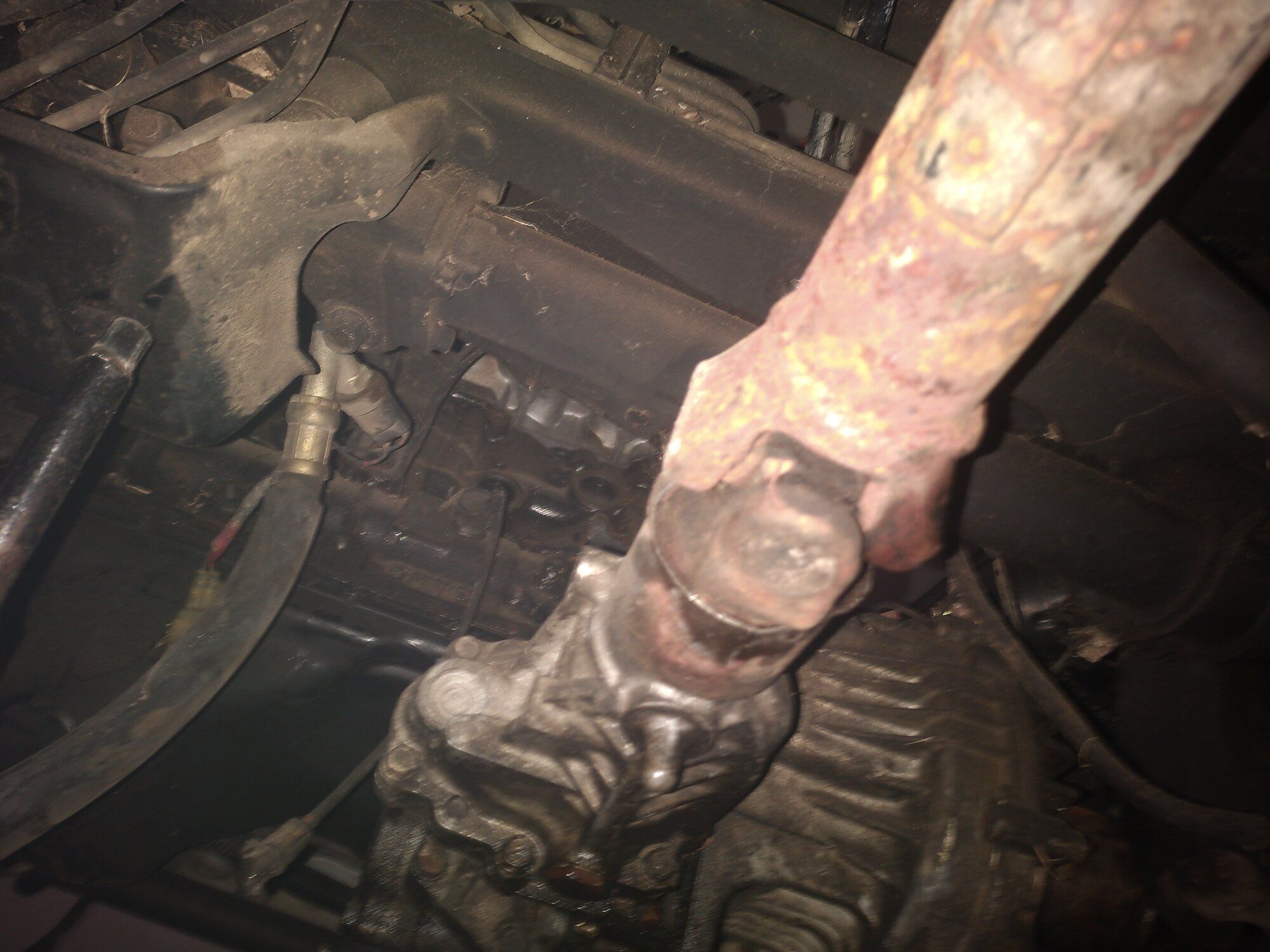

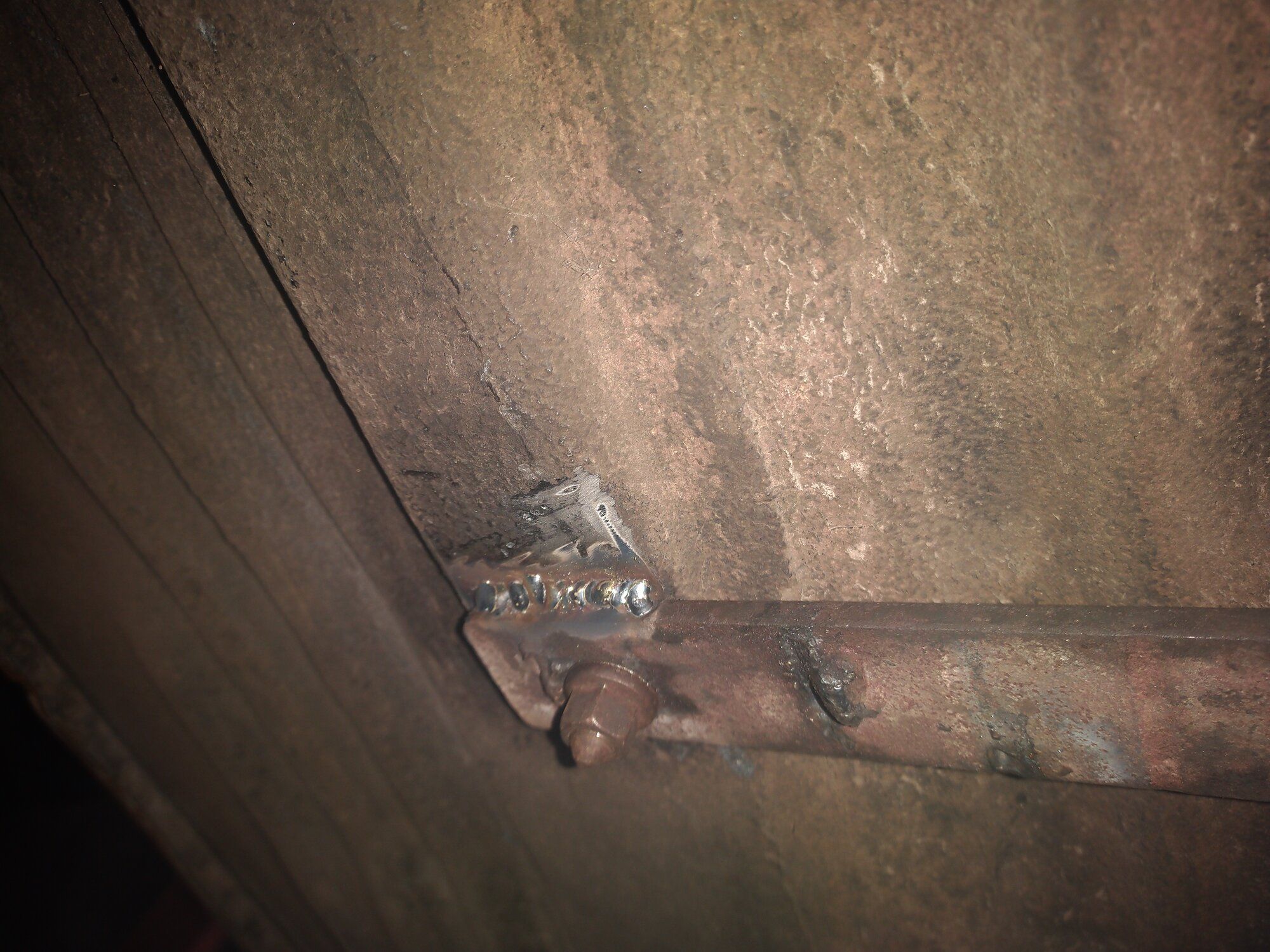

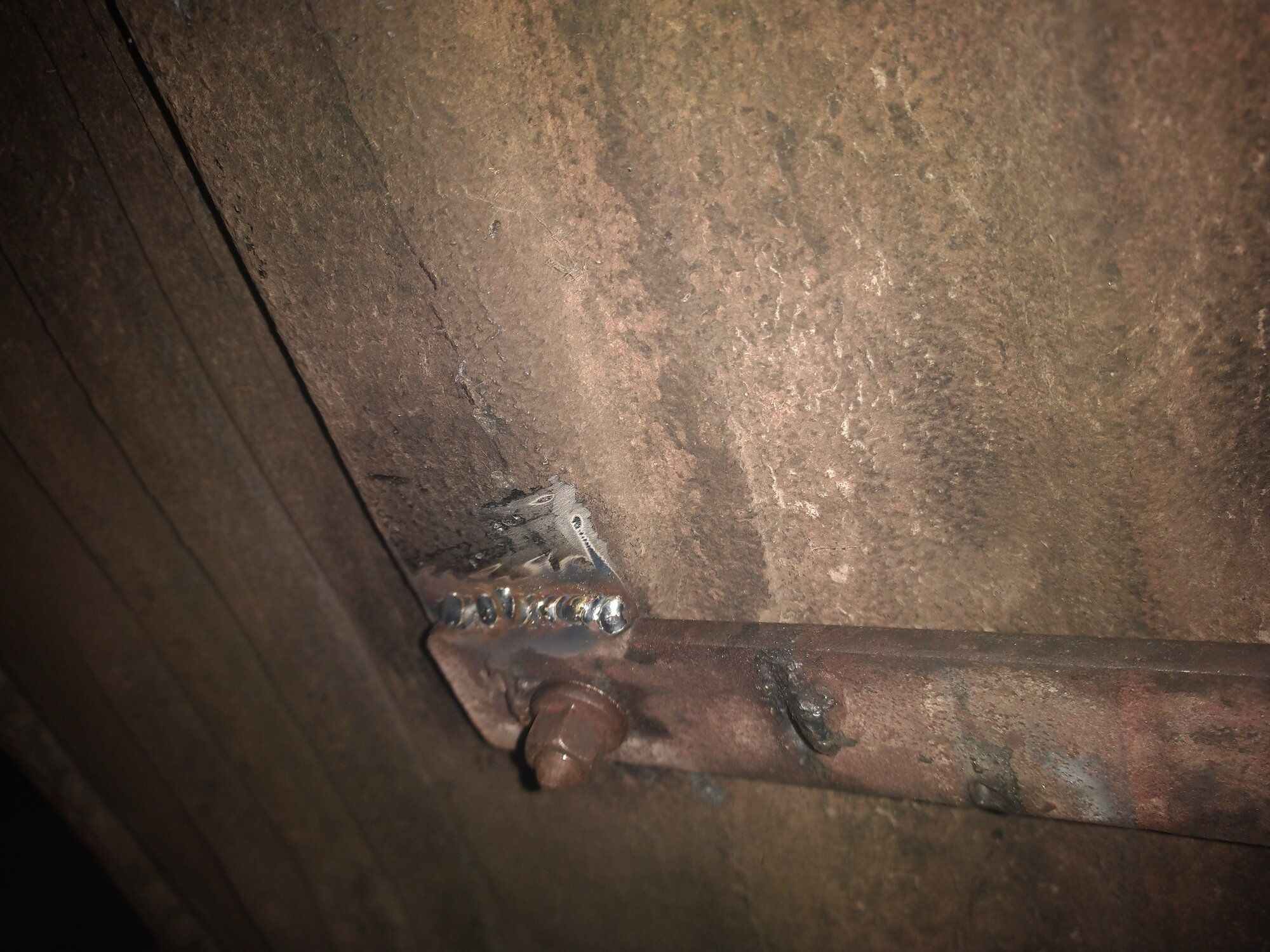

Working on drive shaft mounts.

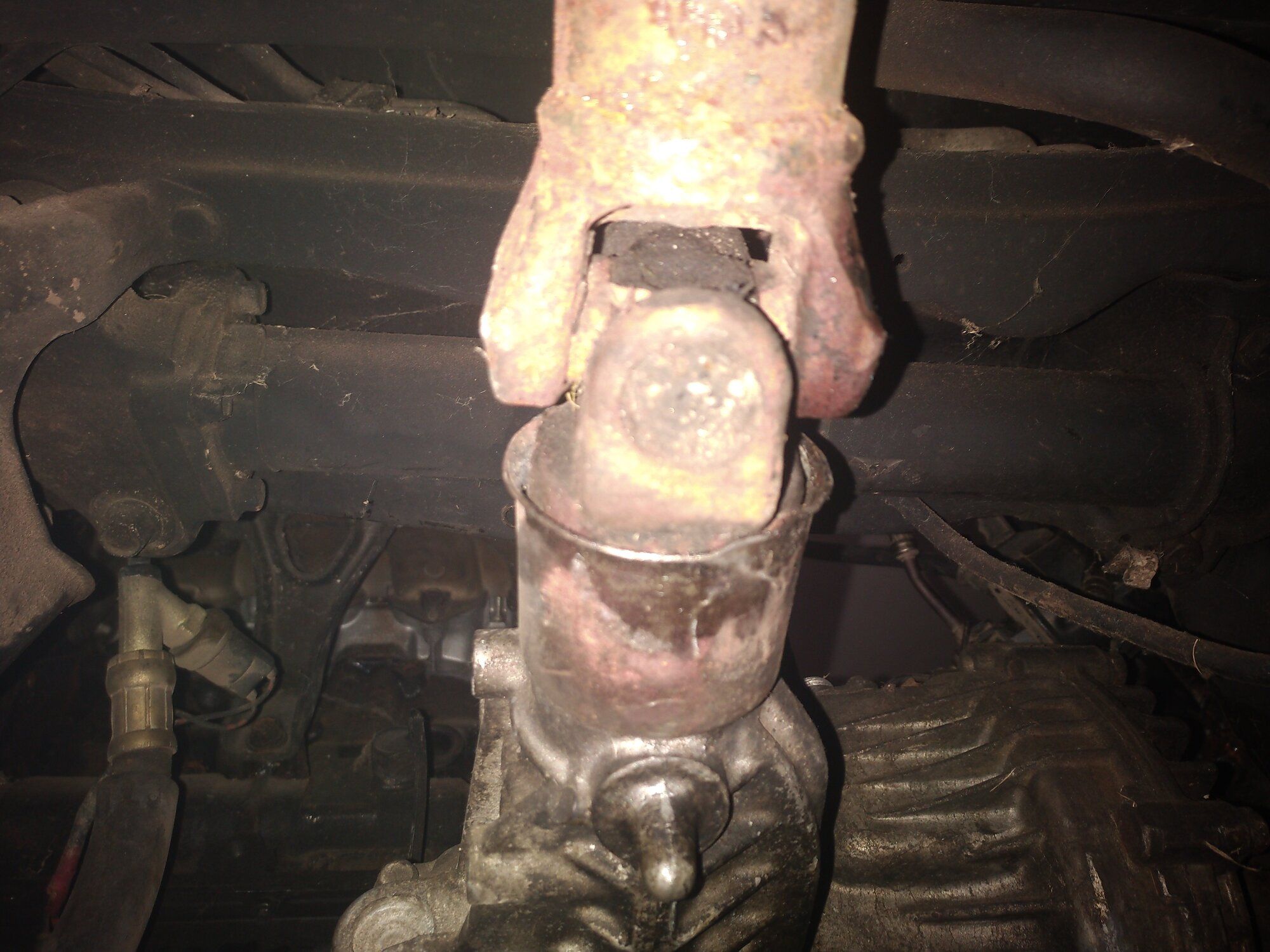

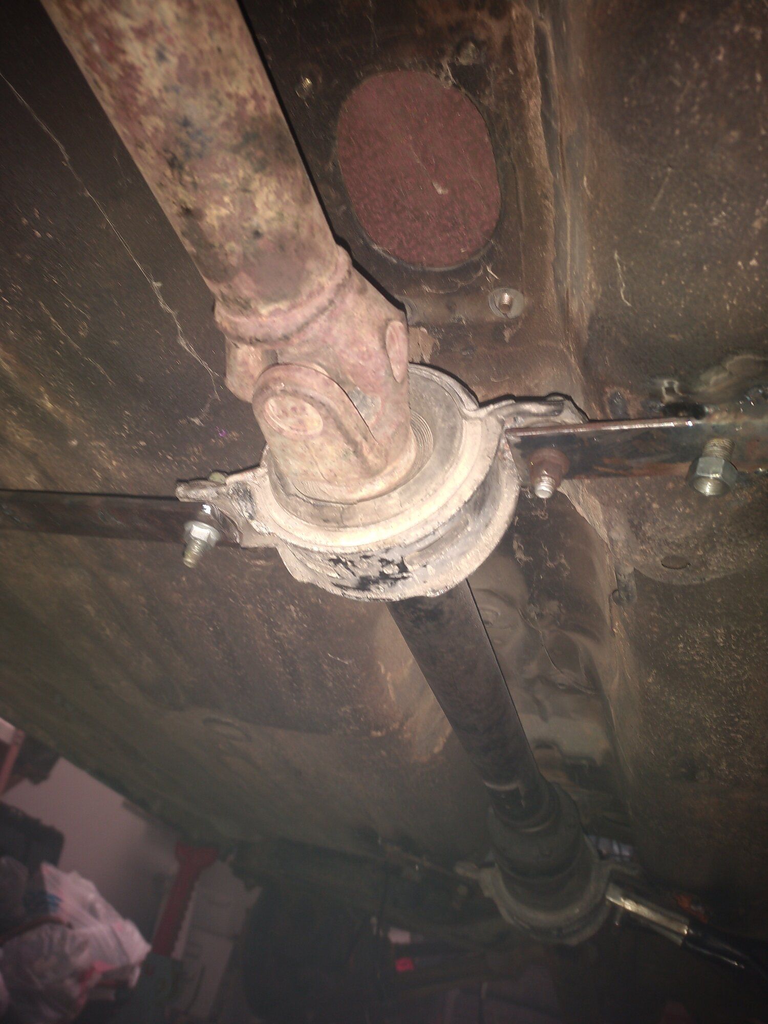

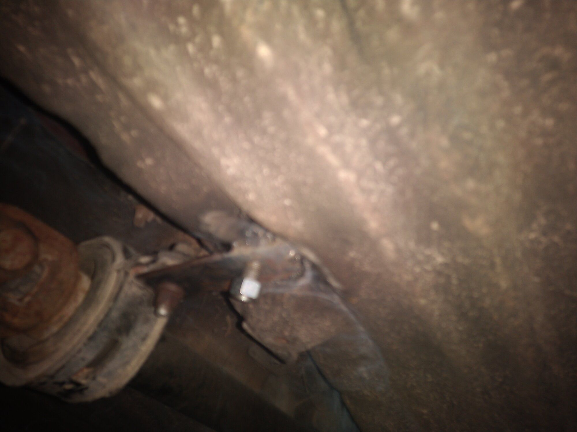

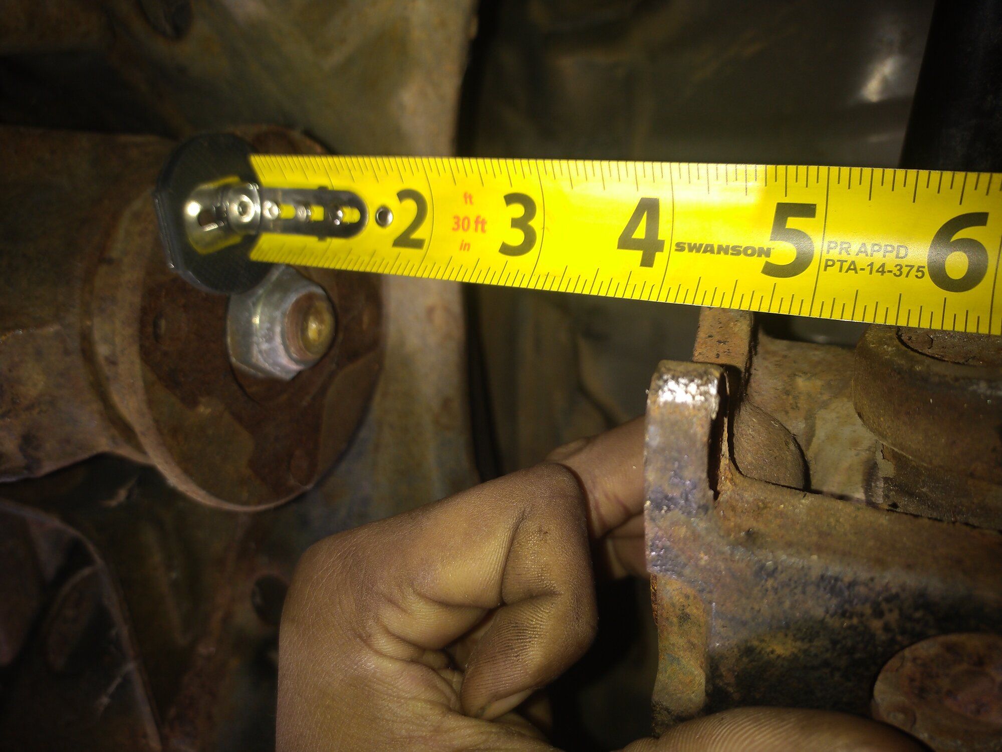

A little bit of weekend progress. Got the driveshaft mounted but I don't know if it's too far into the transfer case just need you guys input on that. I need to drop off the driveshaft n have it lengthened a few inches.

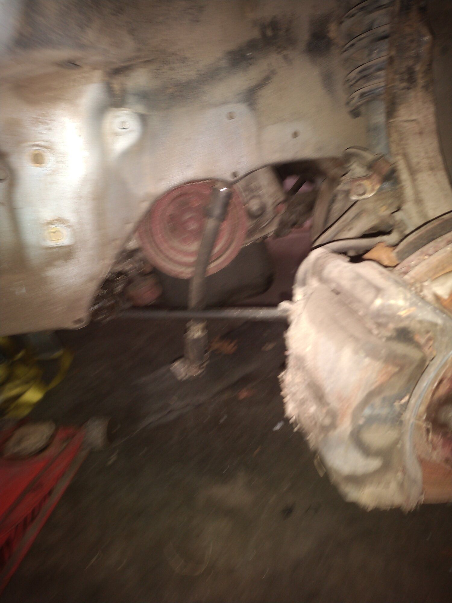

Now I need to figure out the front axle situation..

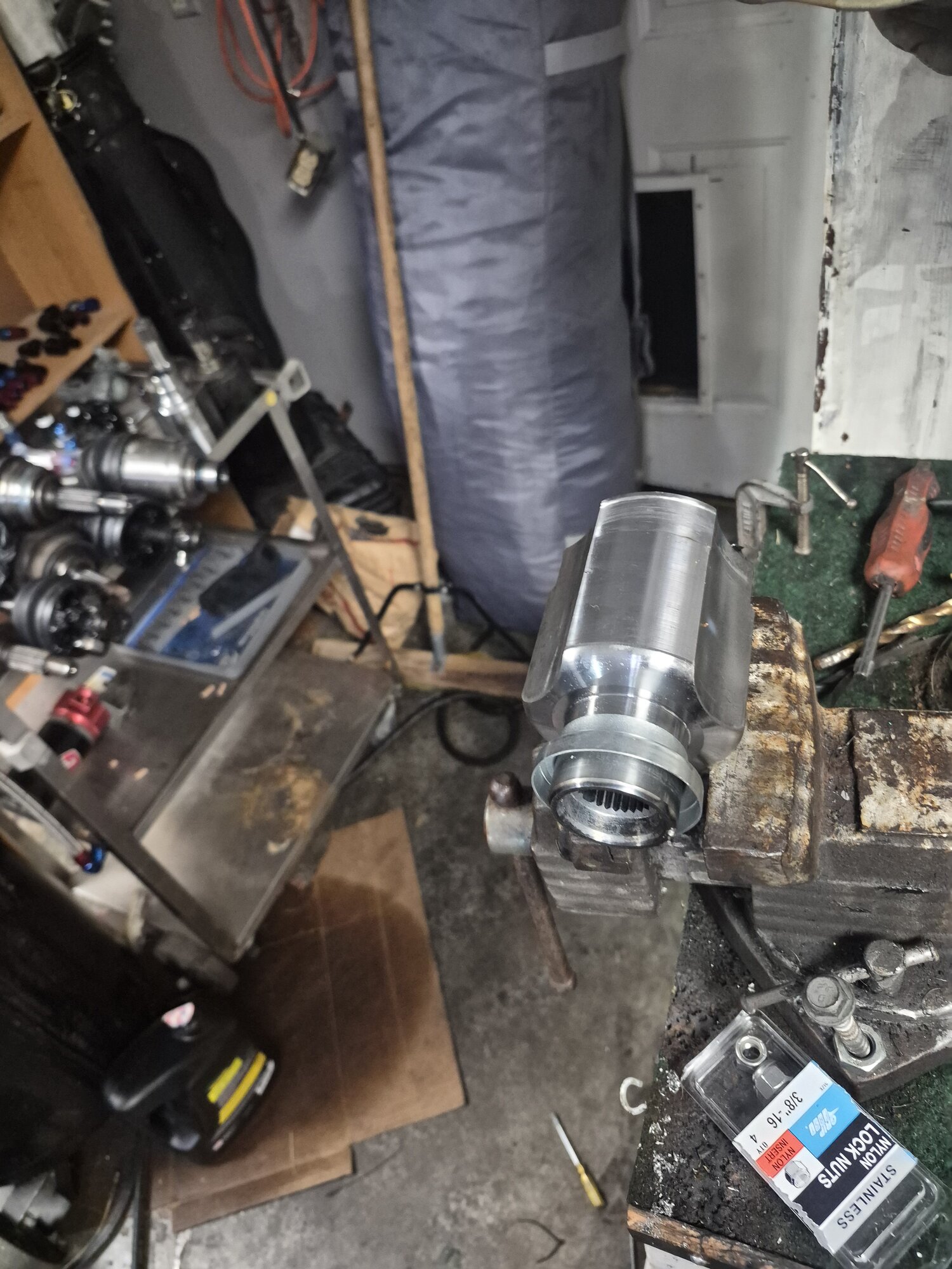

Working on axles

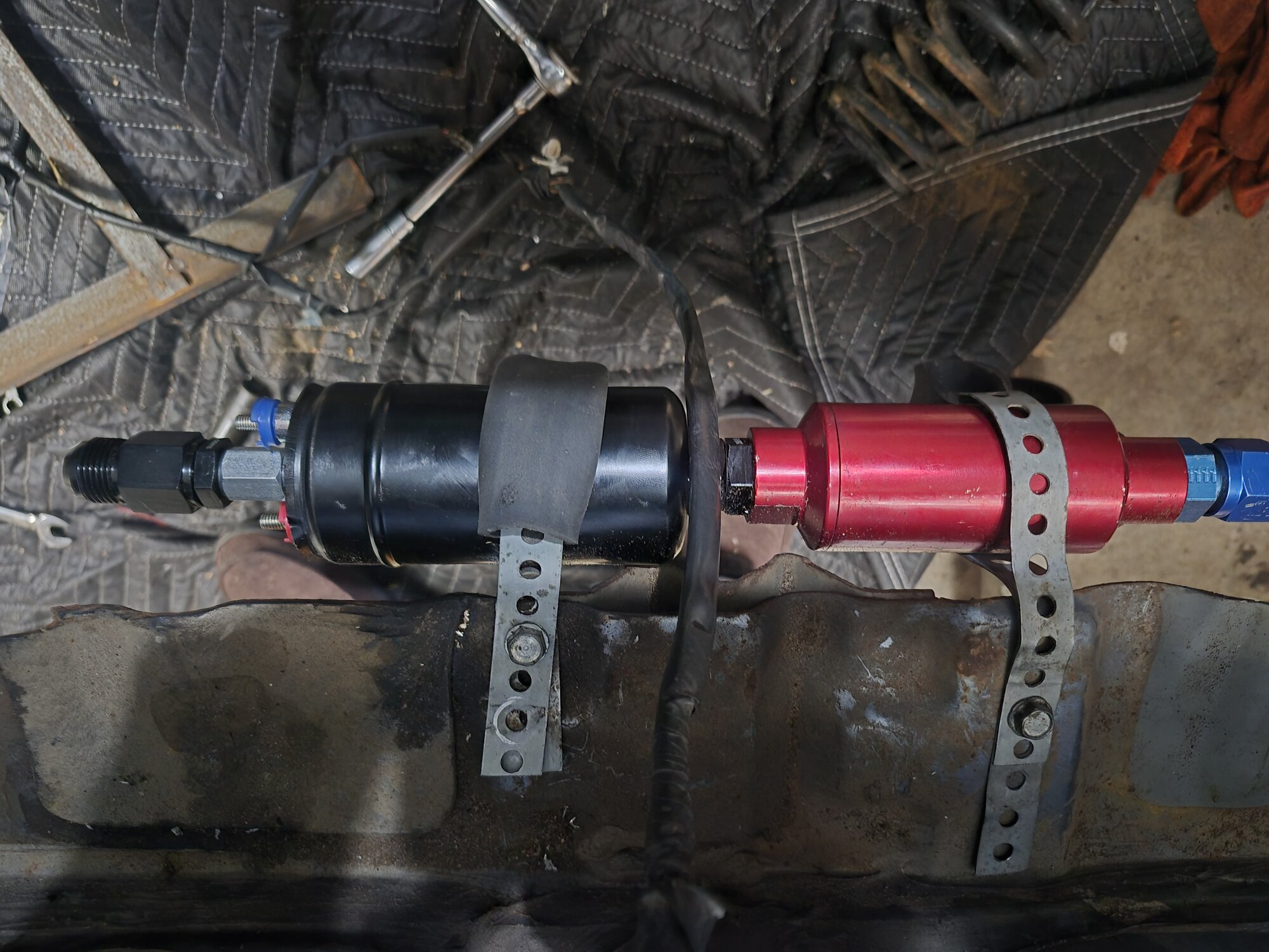

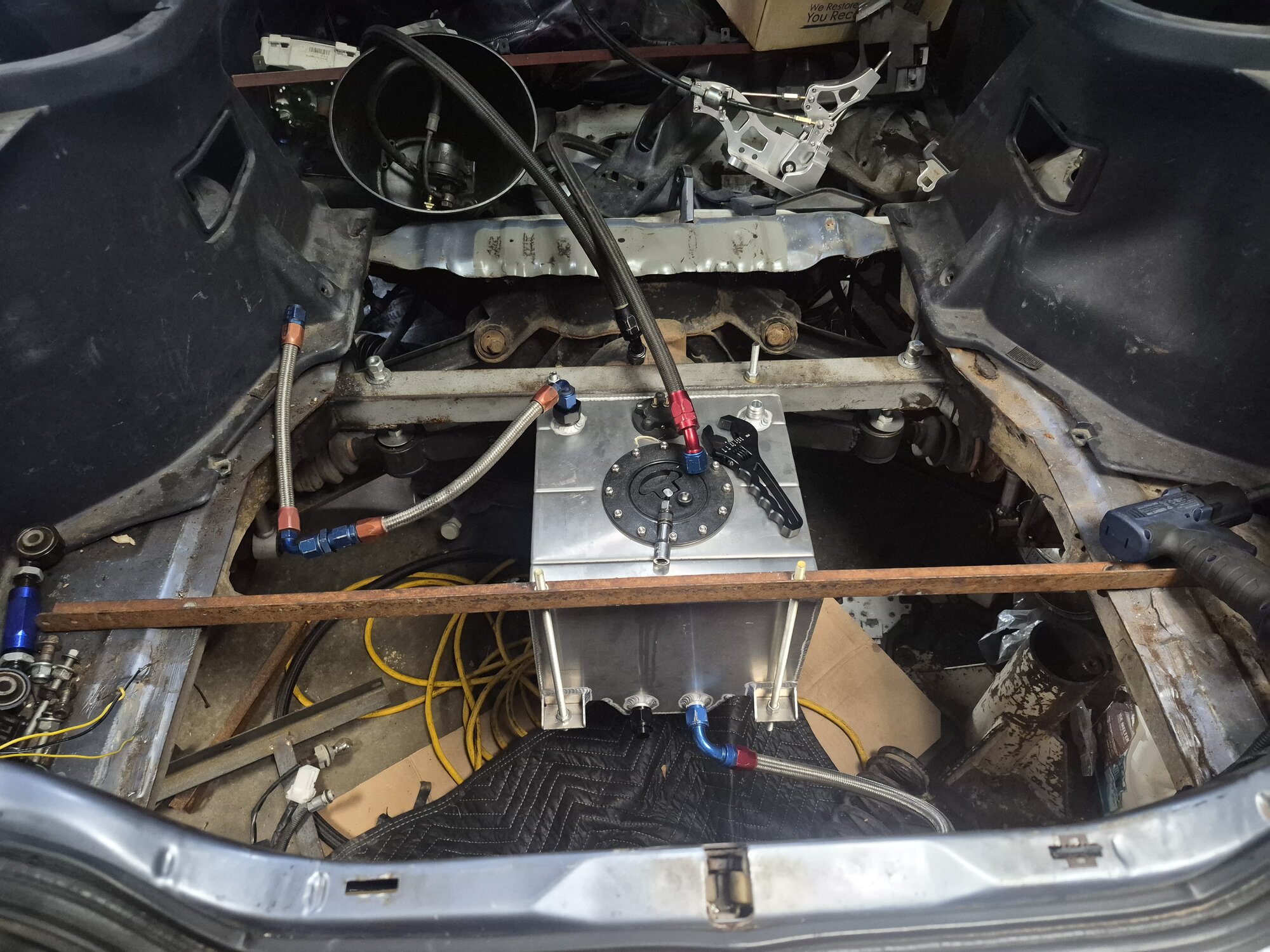

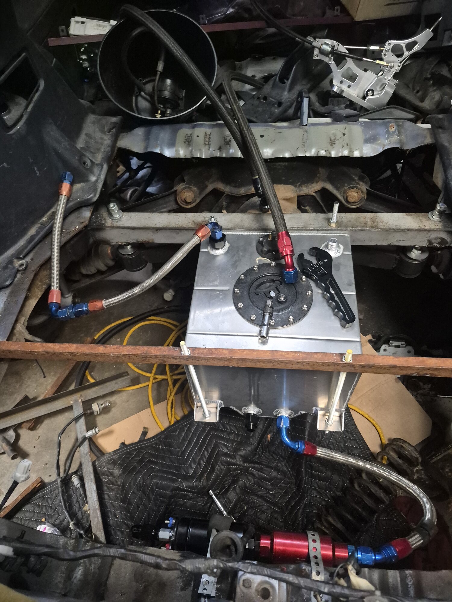

Been a while since i updated this put a fuel cell, fuel pump and fuel lines currently working on spliced axles and custom radius arms. I still need to figure out the clutch pedal and cylinder.

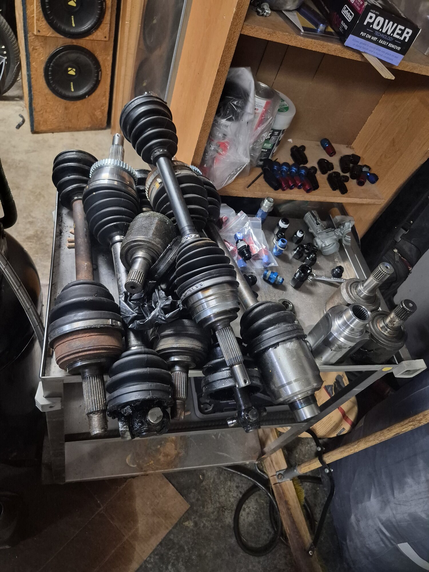

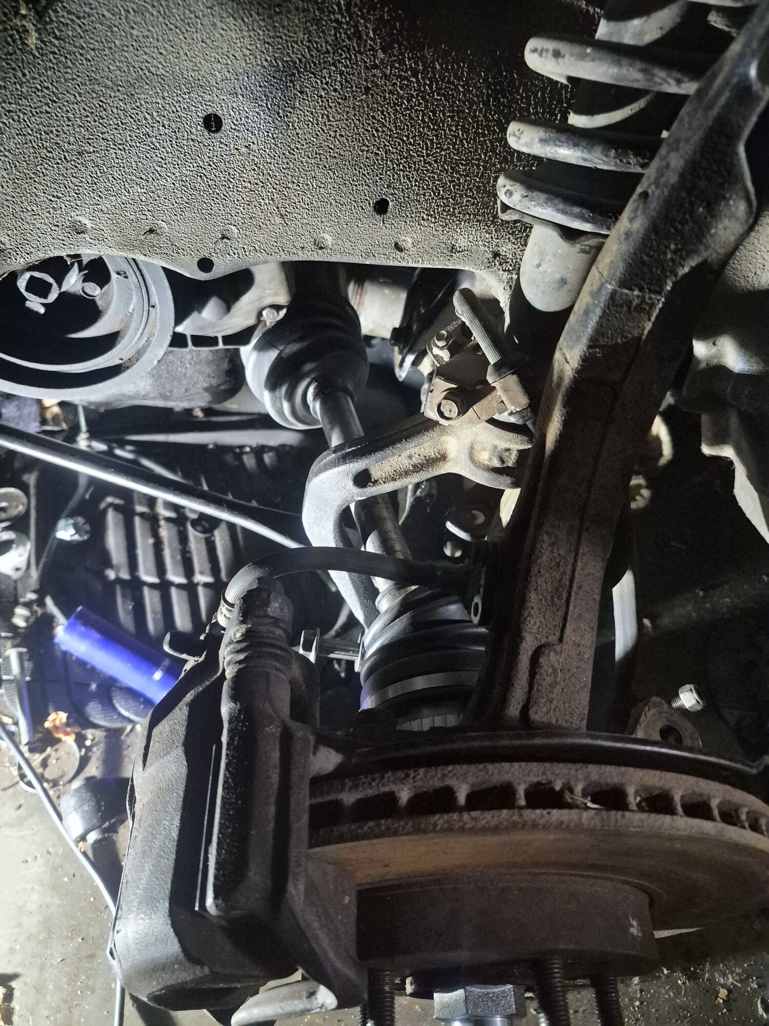

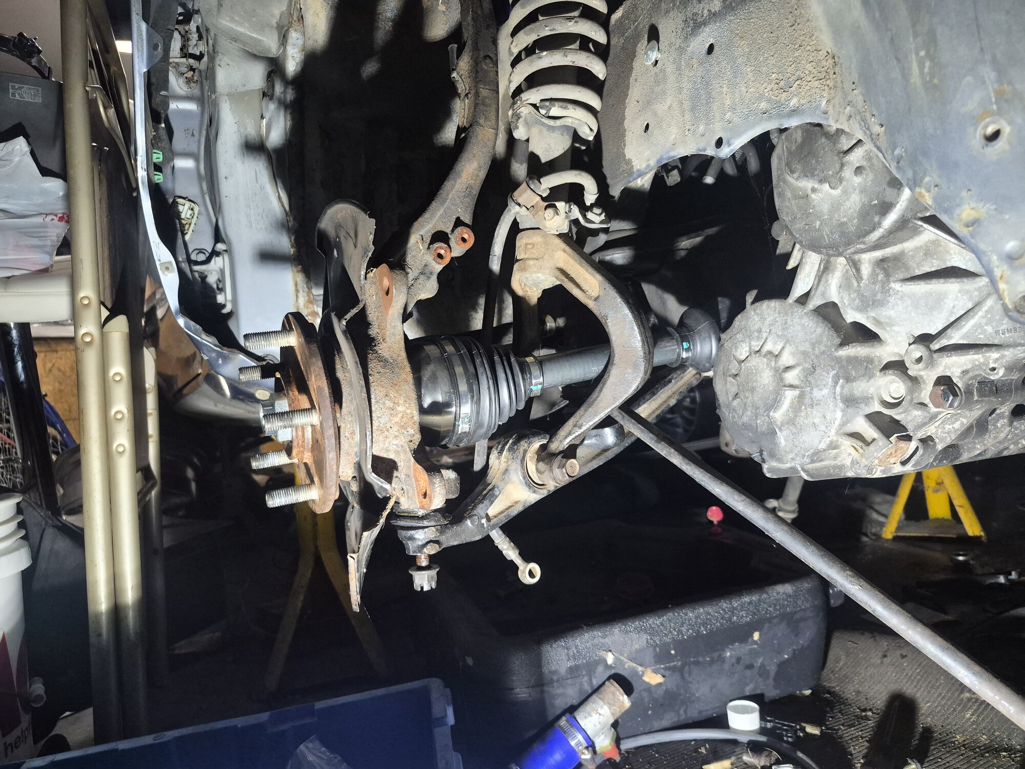

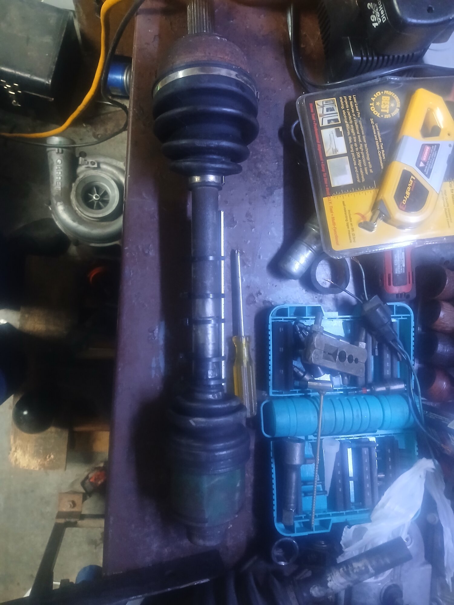

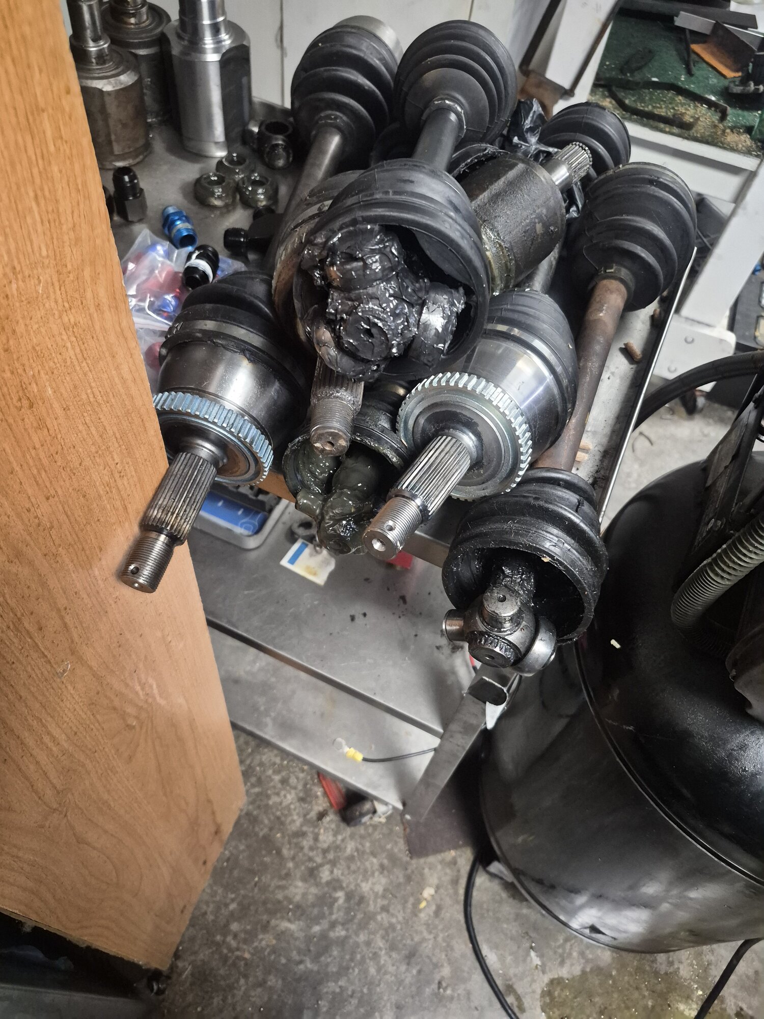

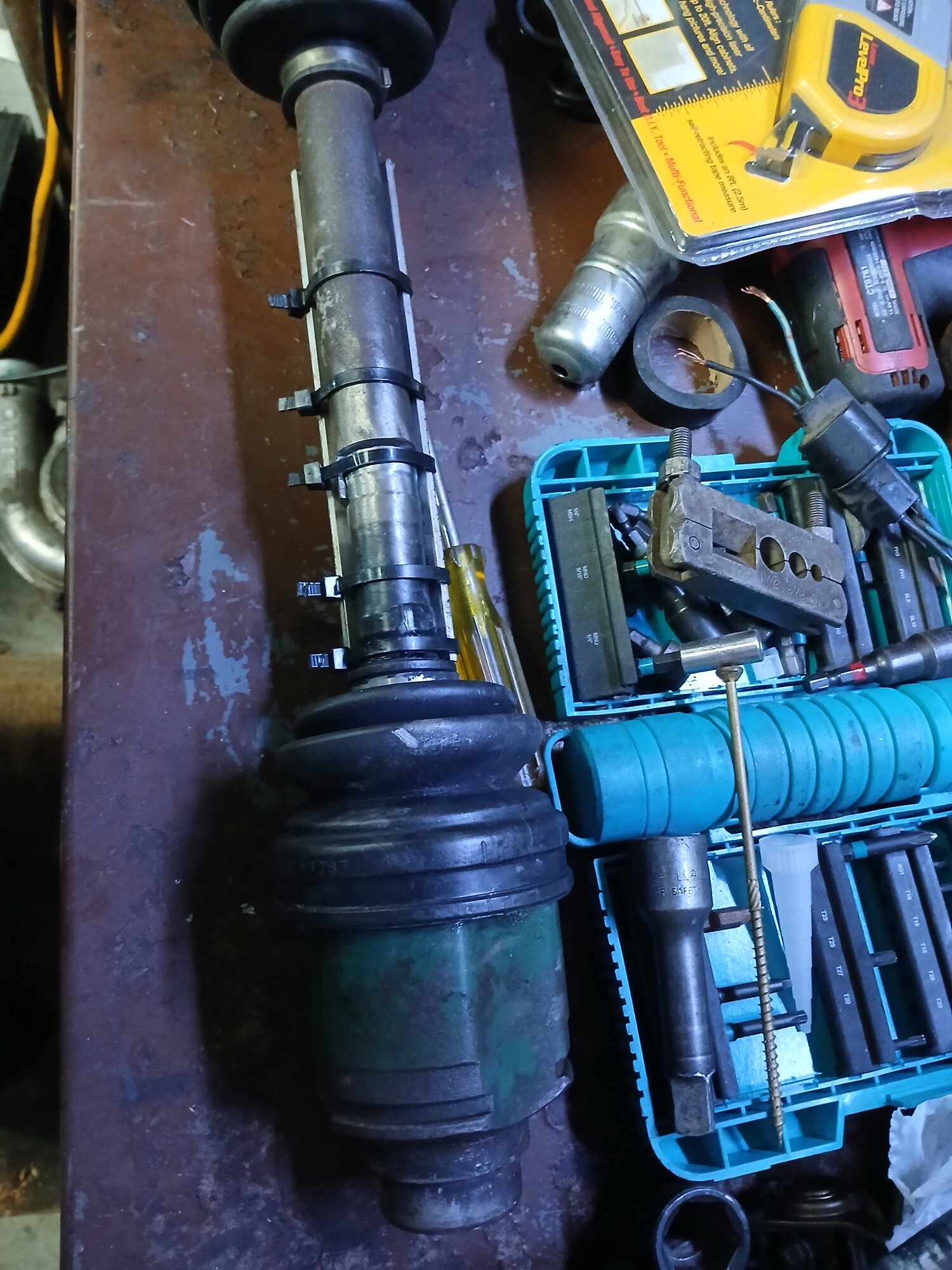

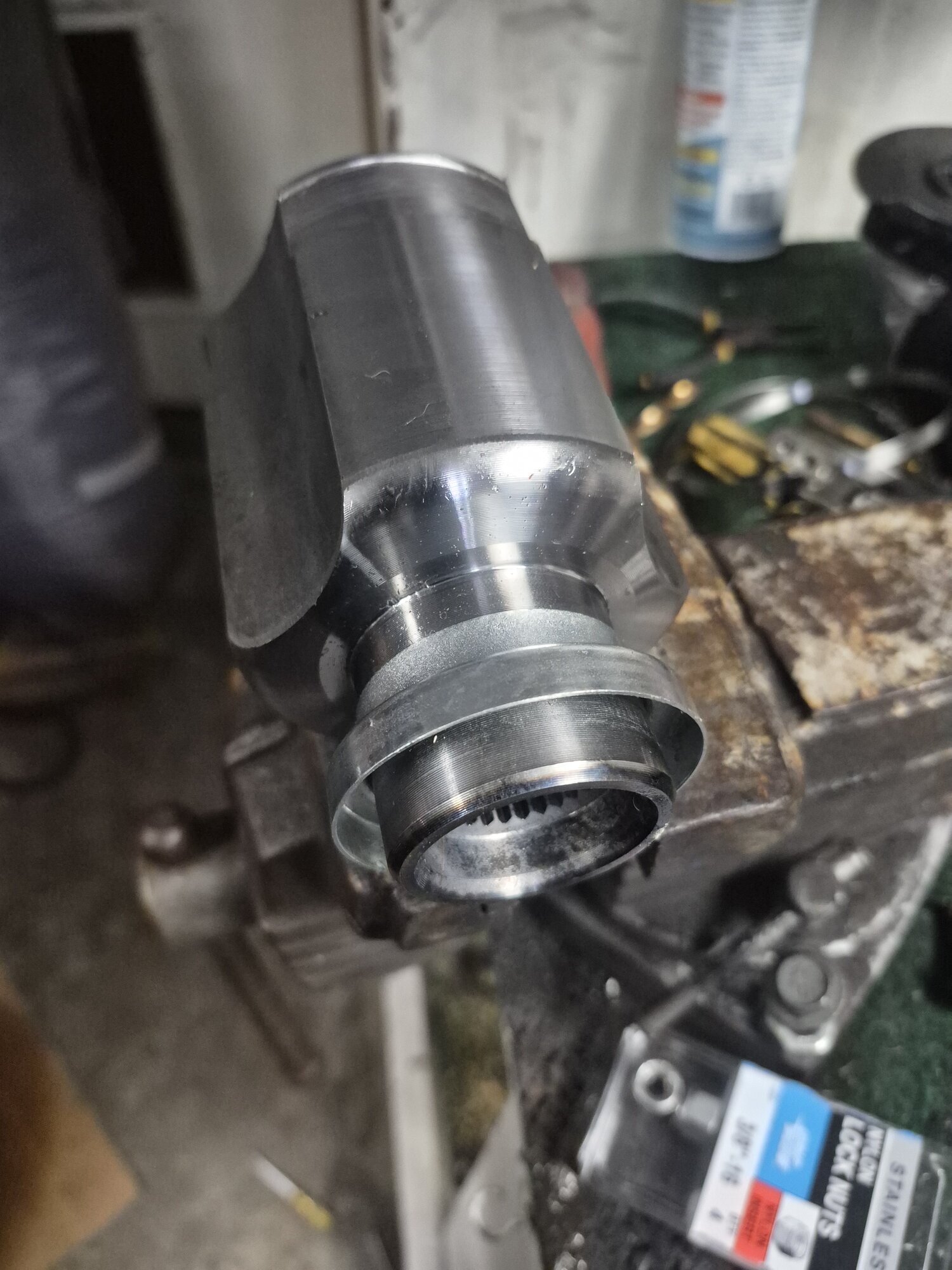

So finally got the axles sorted out lots of trial and error. 2yrs later didnt want welded axles in case I broke one and also vibration concerns.

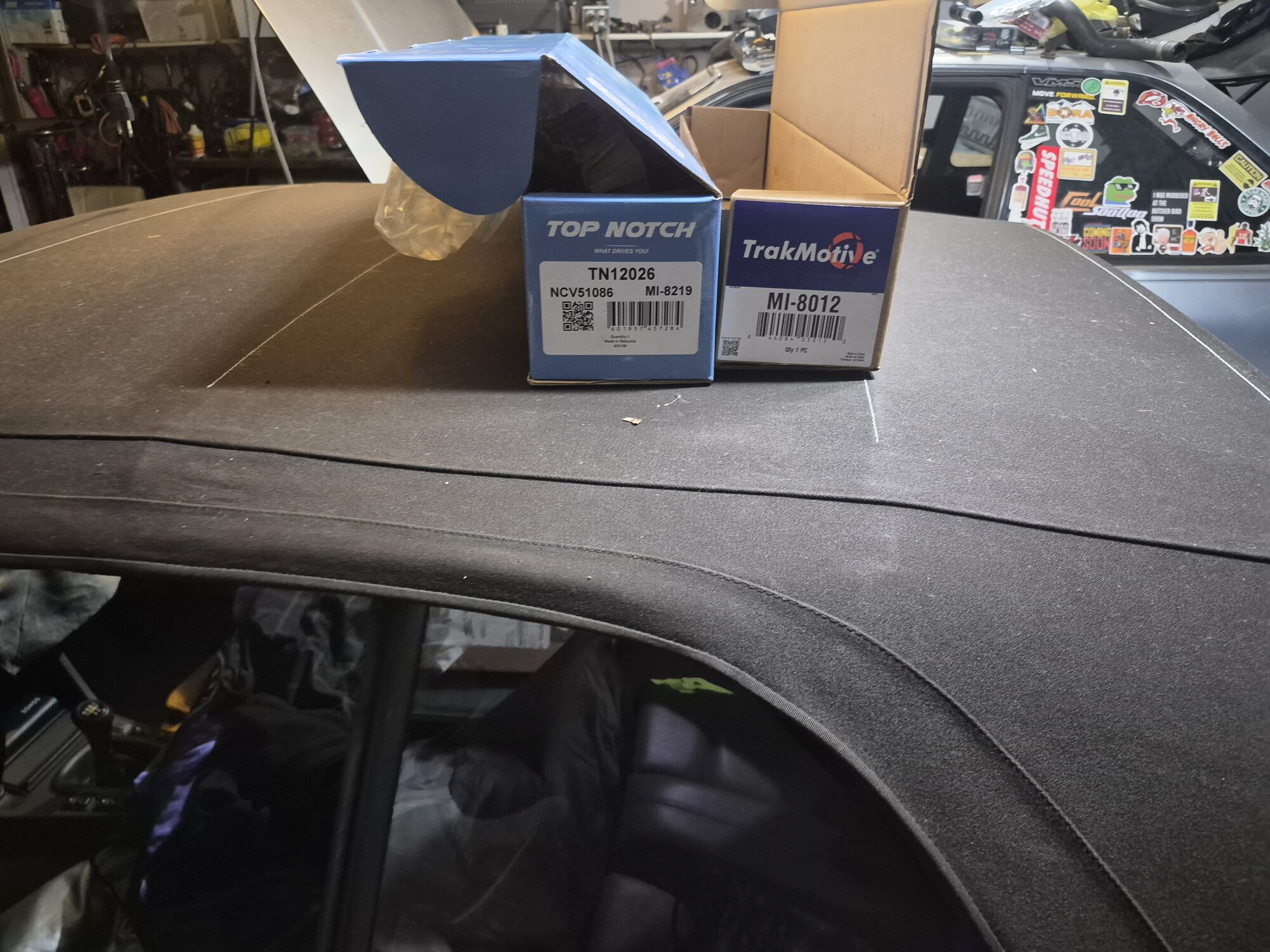

Part number in the Pic is what worked on the passenger side axle

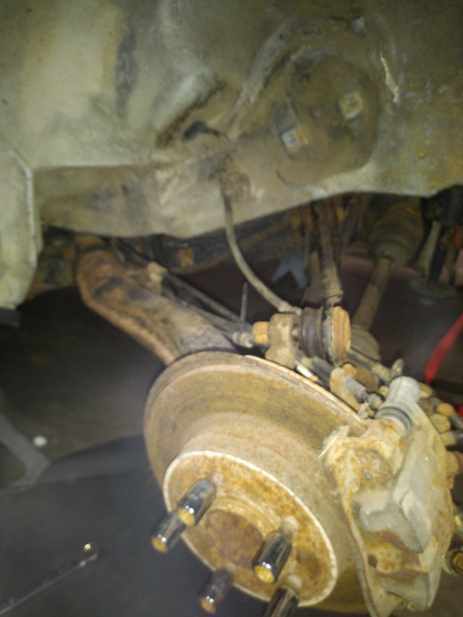

Hubs are 99 crv gives me bigger brakes, axles and 5 lug conversion
Passenger side axle is outer 28spline, 25 inner about 21in long
2006 mist evo gsr inner cup is 1g dsm
Driver side 28 spline outer 25-2 inner i think
99 prelude axle 3000 gt inner 21in I think
Am posting this info incase it helps anyone in the future.
