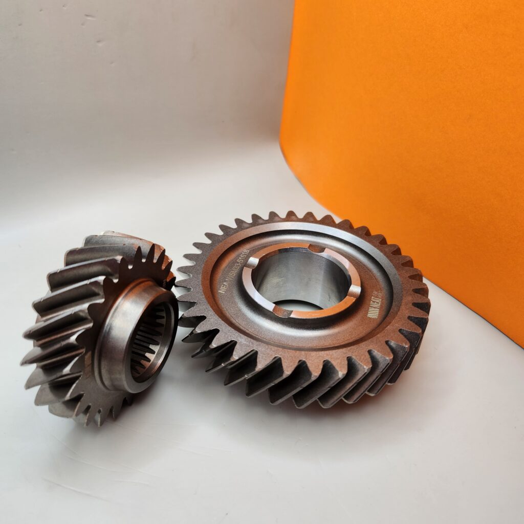

What’s required to throw one of those in your trans? Are you gonna need to do the solder thing and measure for new shims or can you just throw it in and go?
No shimming or solder needed for 5th gear. You only need to remove the end case to access 5th. Two stake nuts, remove the original gear set, replace with replacement gear set.
Freakin' awesome. I'm putting those gears on the list then. Would love a taller 5th!
