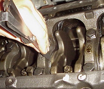

Oh man, that was happening to a local guy a long time ago in another group. I want to say it was loose or missing transmission bolts. Unfortunately I think it was actually a crankwalk symptom. I hope not for your sake, but it would be better to diagnose now.
I found this in an old 2005 archive:
Some early warning symptoms associated with crankwalk:
1. Clutch weirdness, improper pedal pressure, strange disengage and engage points
2. Ticking or strange noise from the pulley side of the engine when clutch is depressed.
3. Crank Angle Sensor errors ( check engine light )
4. Difficulty shifting
5. RPMS decreasing significantly when clutch pedal is depressed.
6. Clutch does not return or "sticks" to the floor after being depressed.
EDIT:
7. Clutch does not return or “sticks” to the floor during left hand turns
Reference:
Oh boy oh boy, i got a juicy one today.
Found this at the bottom of the pan
FYI - Jafros videos on crankwalk:
Interesting "often missing crankwalk bolt" at 12:02-15:02:
