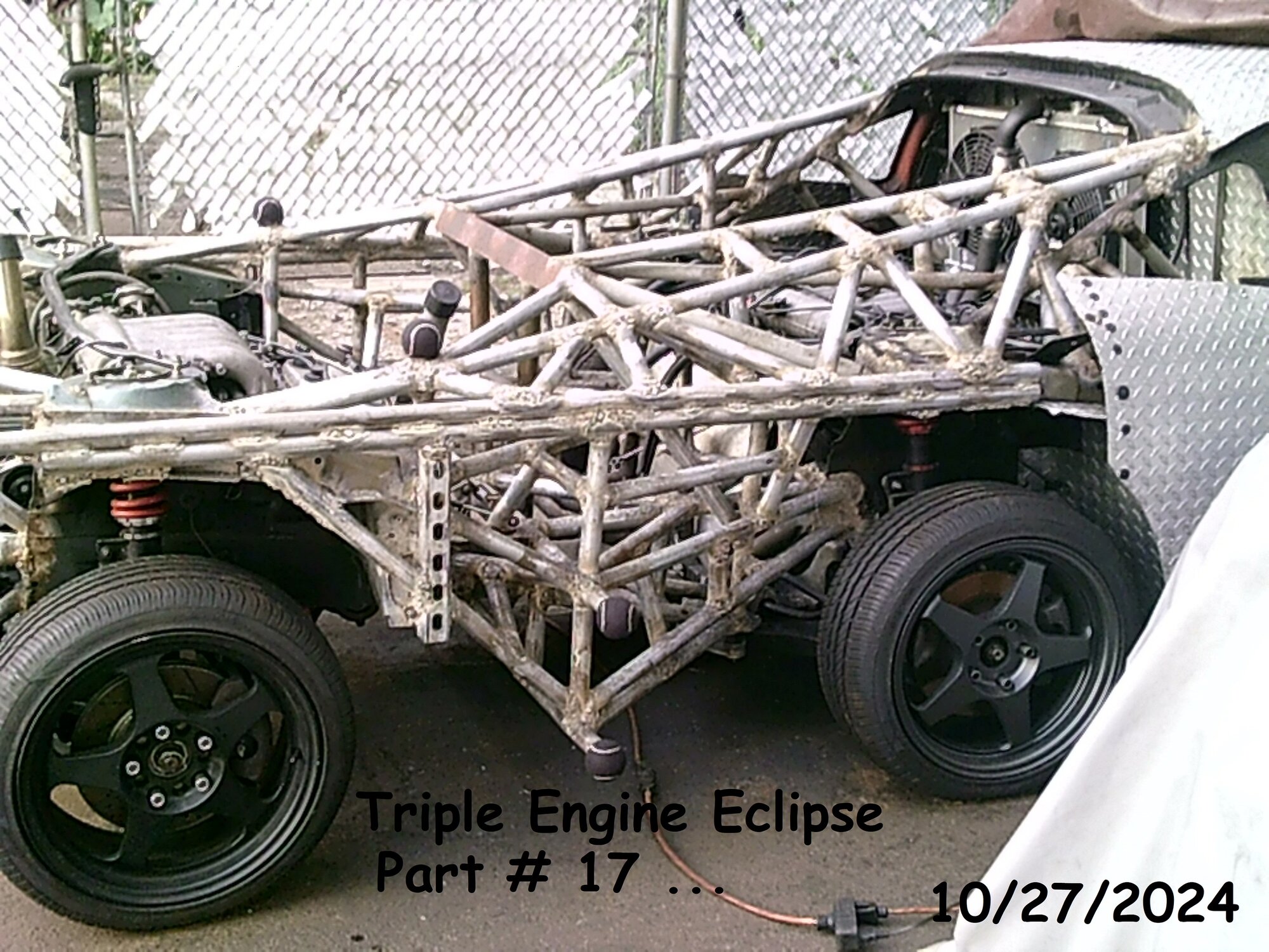

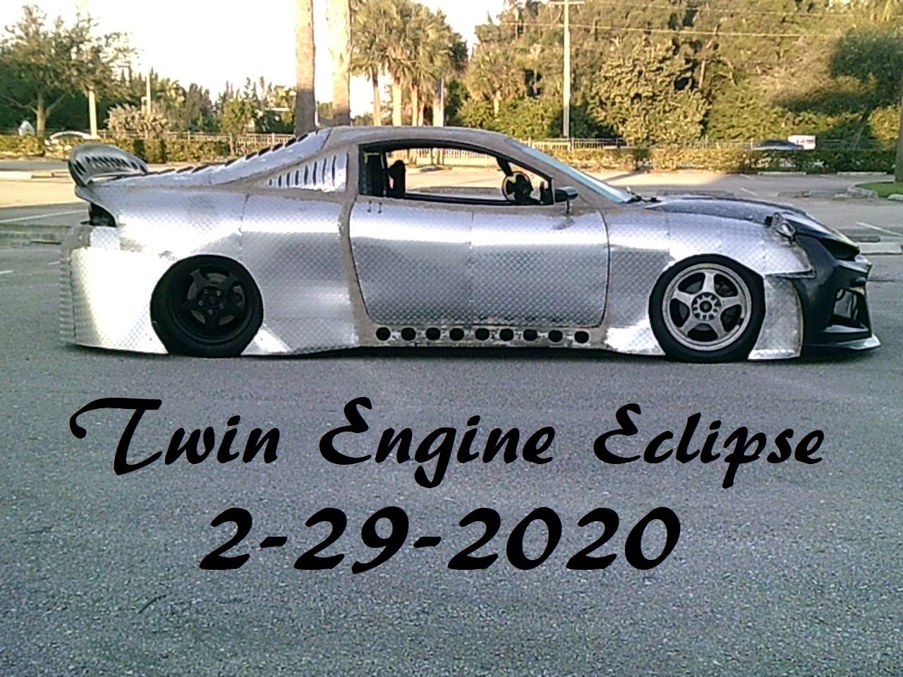

Twin Engine Eclipse - Two Engine Car / Spinalsign5357 . Now three engines ... Triple Engine Eclipse

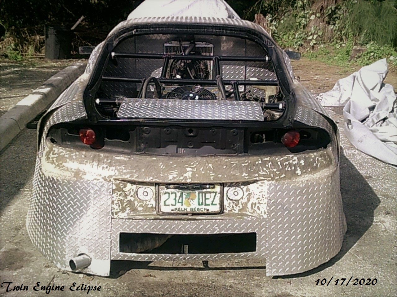

Twin engine 1995 Eclipse ... Now three engines .

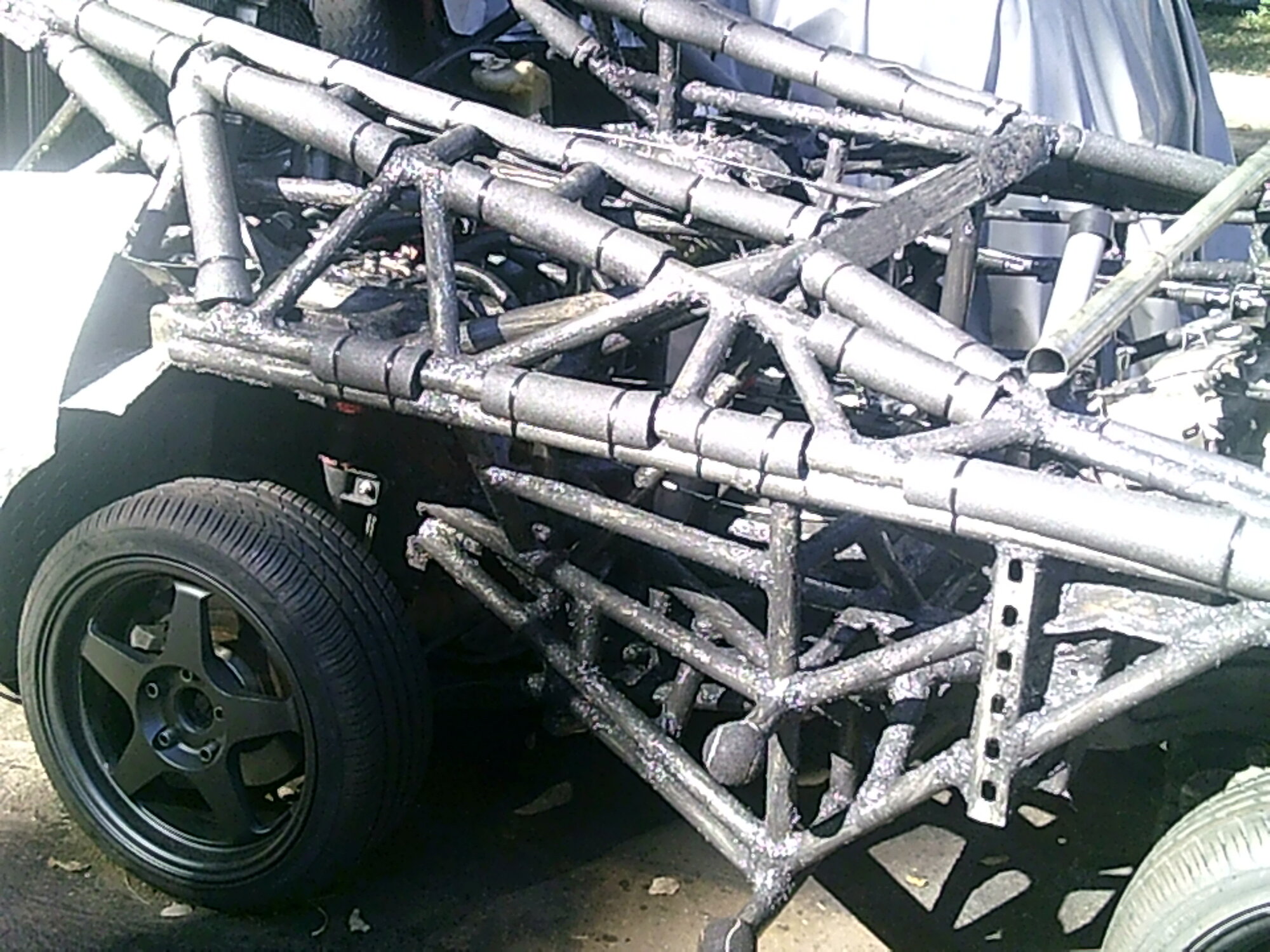

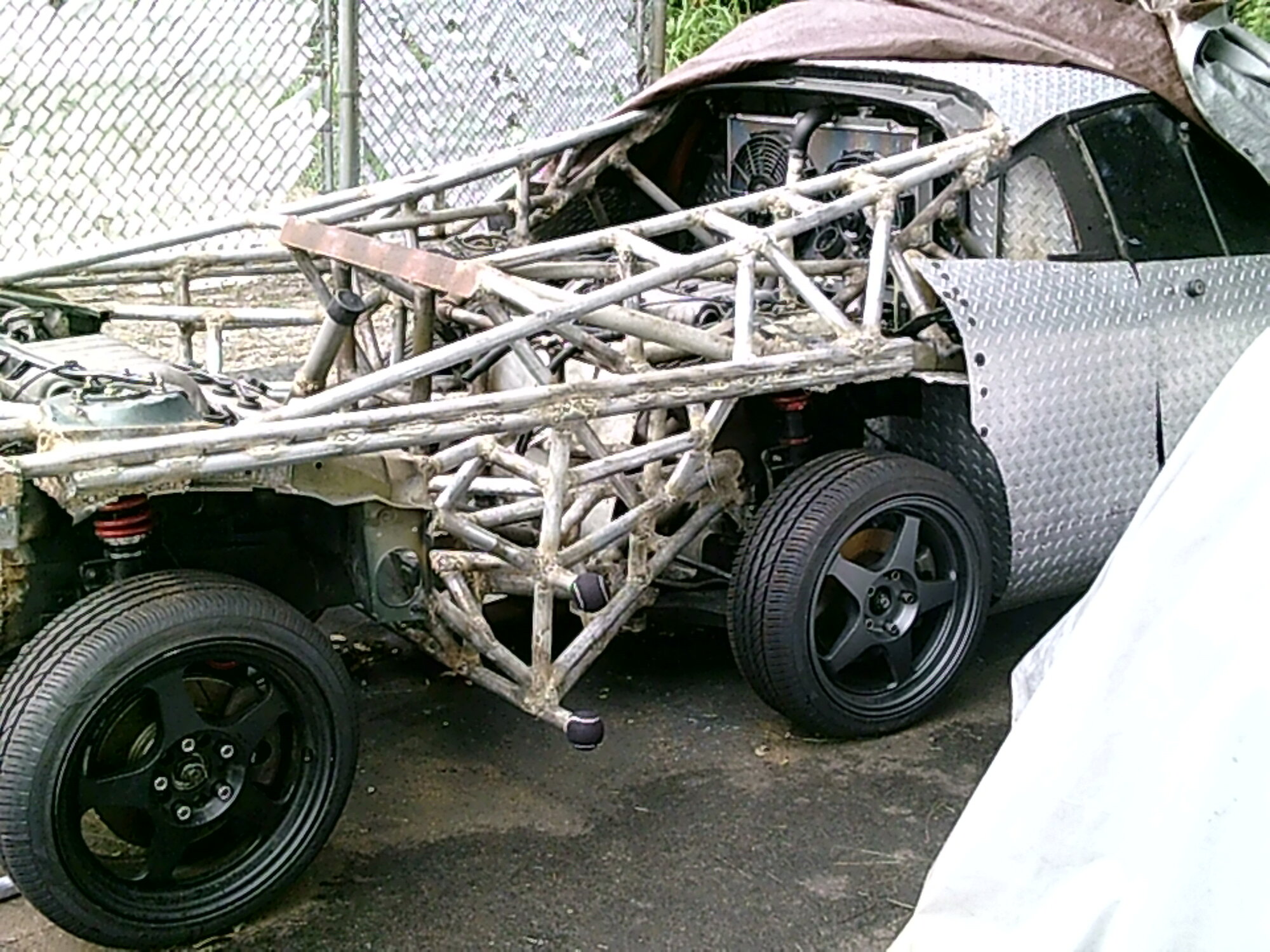

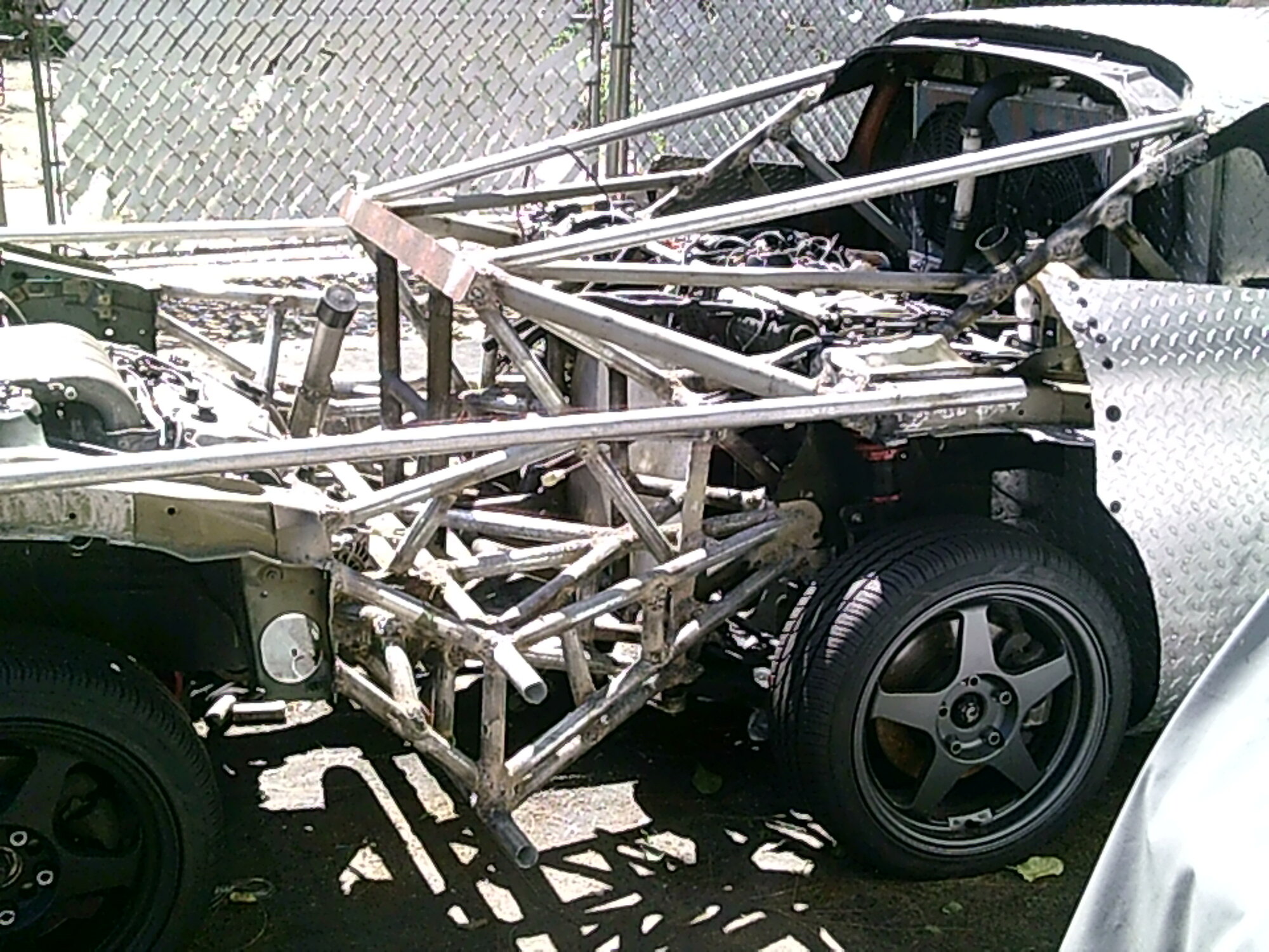

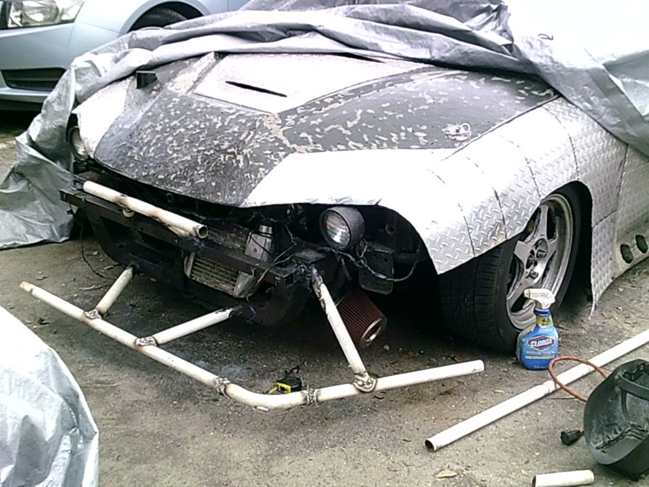

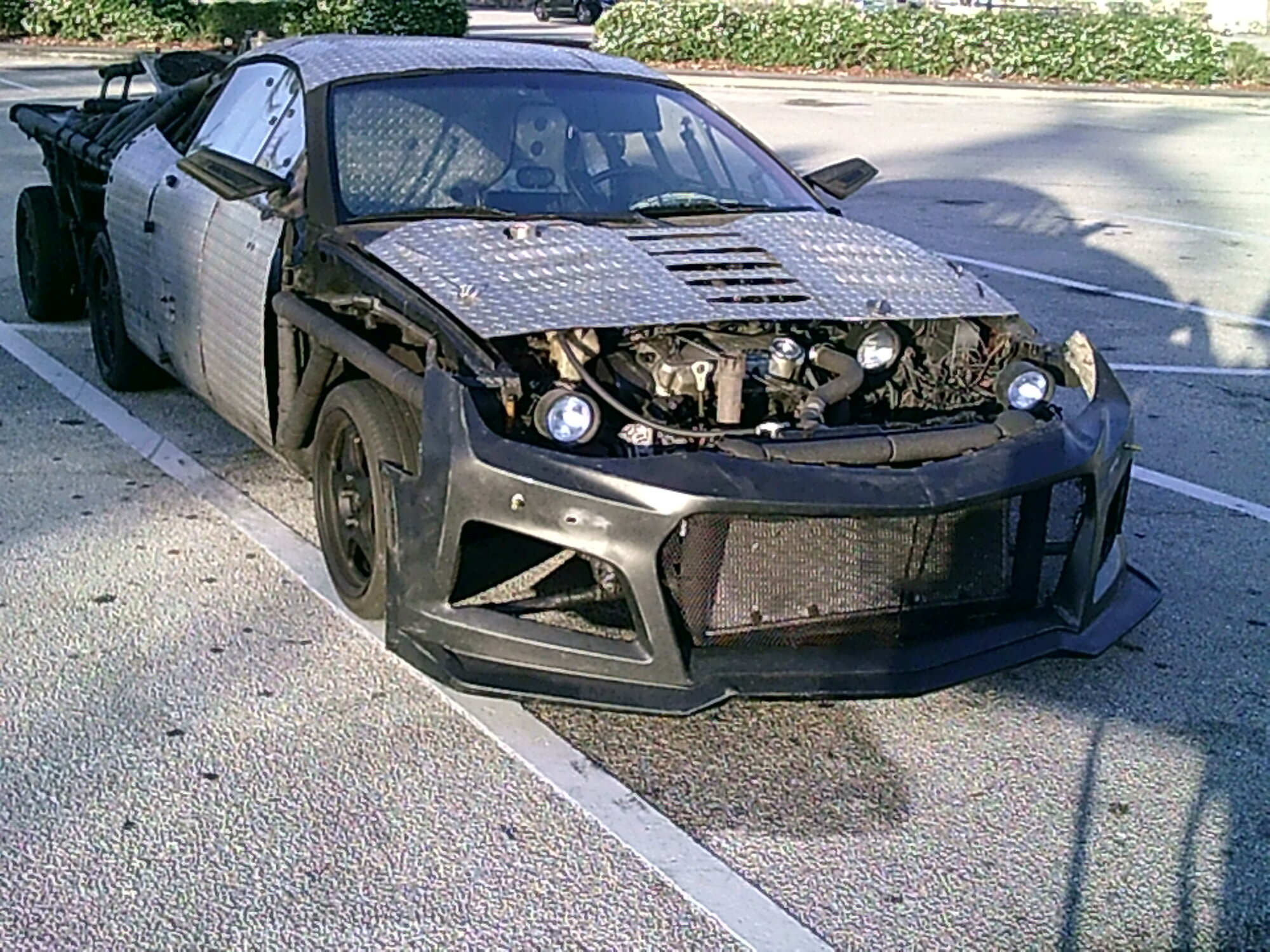

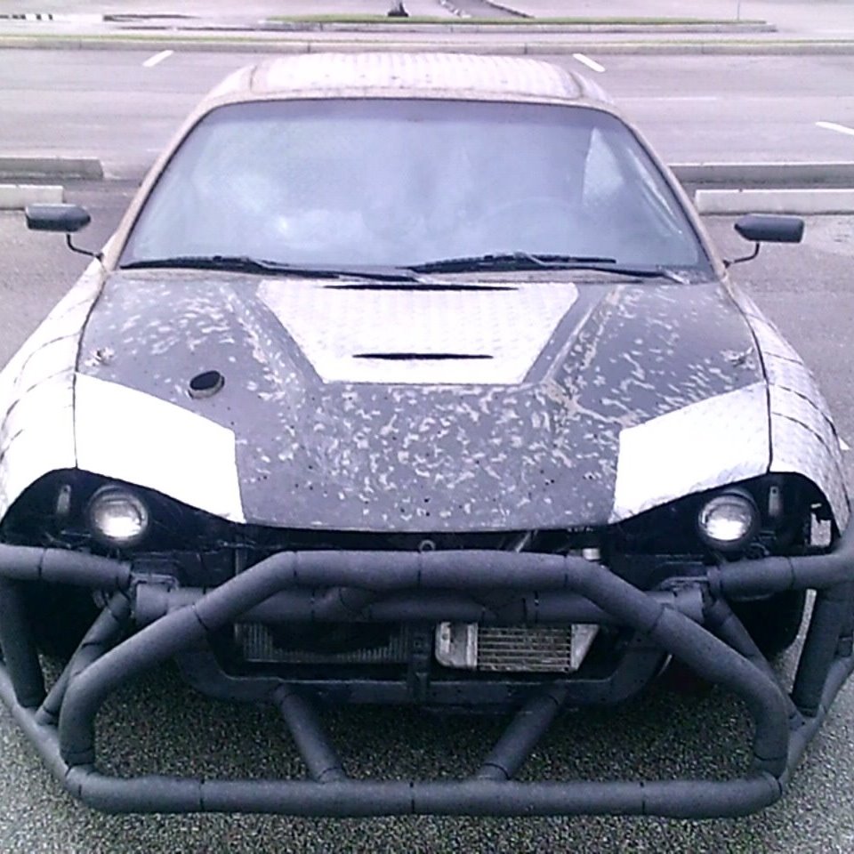

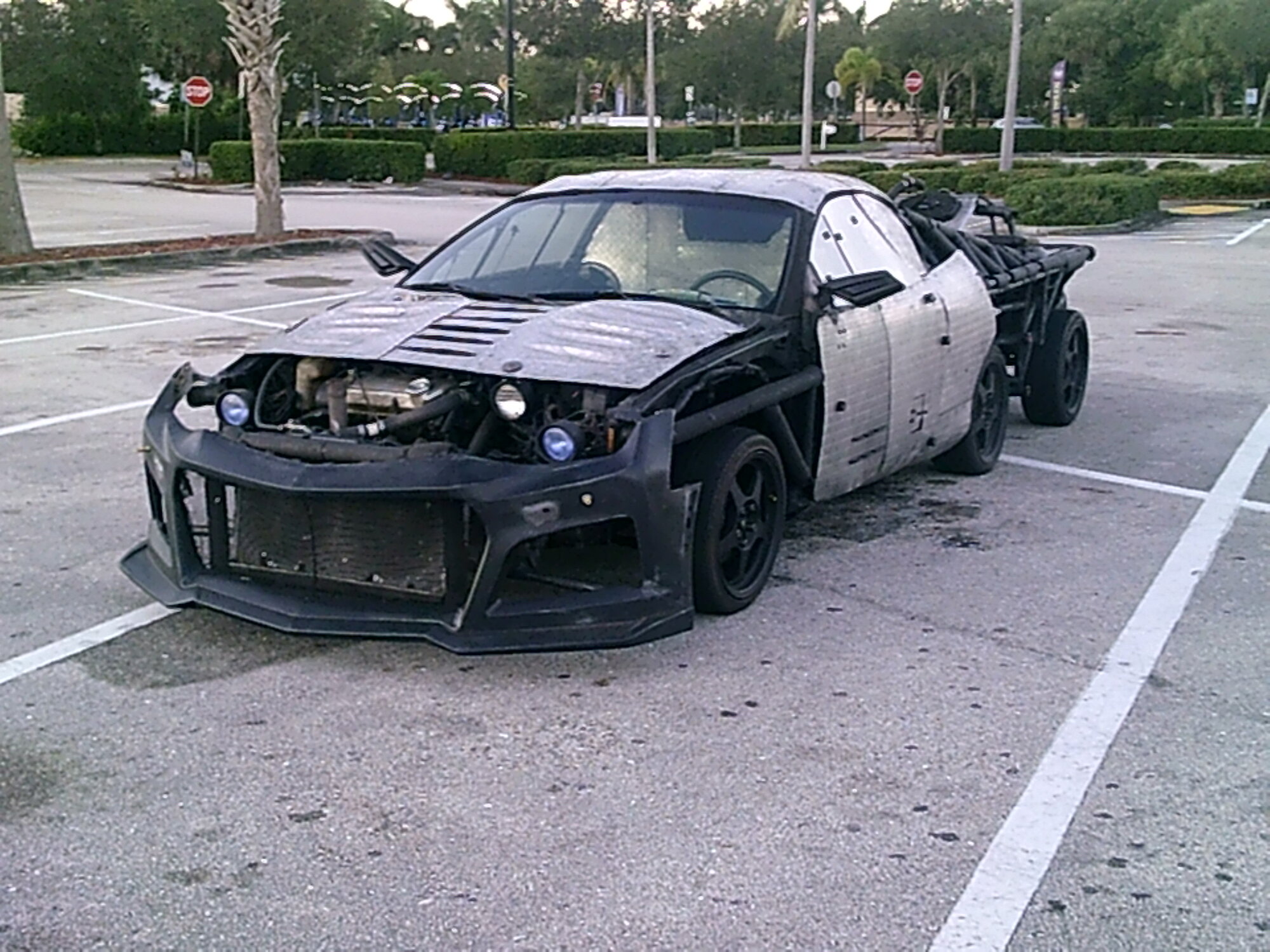

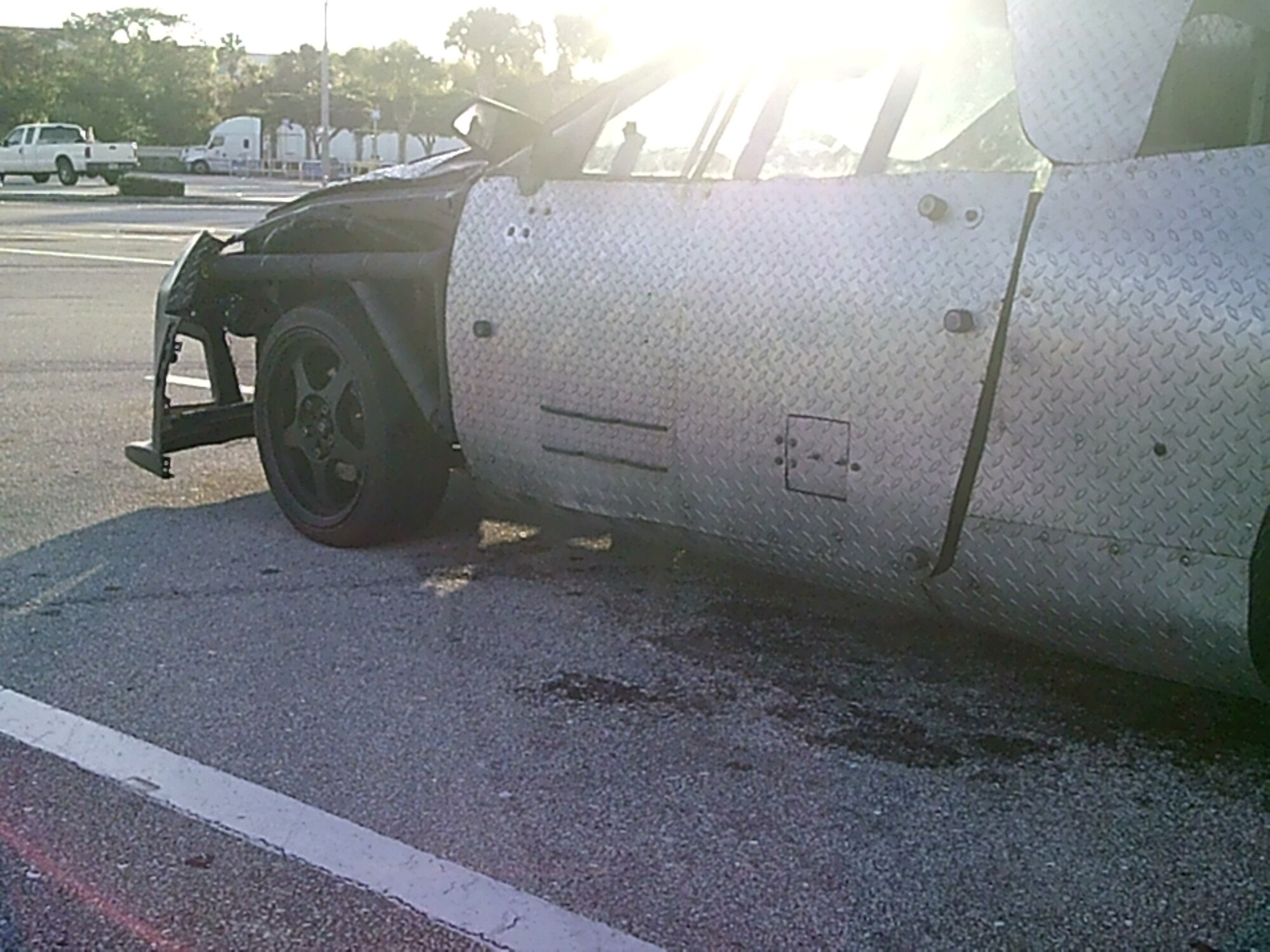

We get it. I think the issue is that what you are doing, while interesting, isn't being done in a way that sparks discussion or invites others in. I think you would experience warmer waters if your Frankenclipse was streetable. But everything looks very unprofessional - from the welds to the diamond plate panels to the tubes and wires and everything hanging and bolted every which way. It's very... Darryl and his other brother Darryl meatball mechanics. So I also get the responses coming from a group that spends time guiding others in how to correctly solve problems and get/keep these cars on the road instead of ending up in a bone yard.
Now, to be truthful, what you are doing isn't something that I could do. Nor is it something that I would attempt. It takes a mite bit of planning, ingenuity, and engineering to get all of this working in sync so it is balanced enough to drive. So props on that.

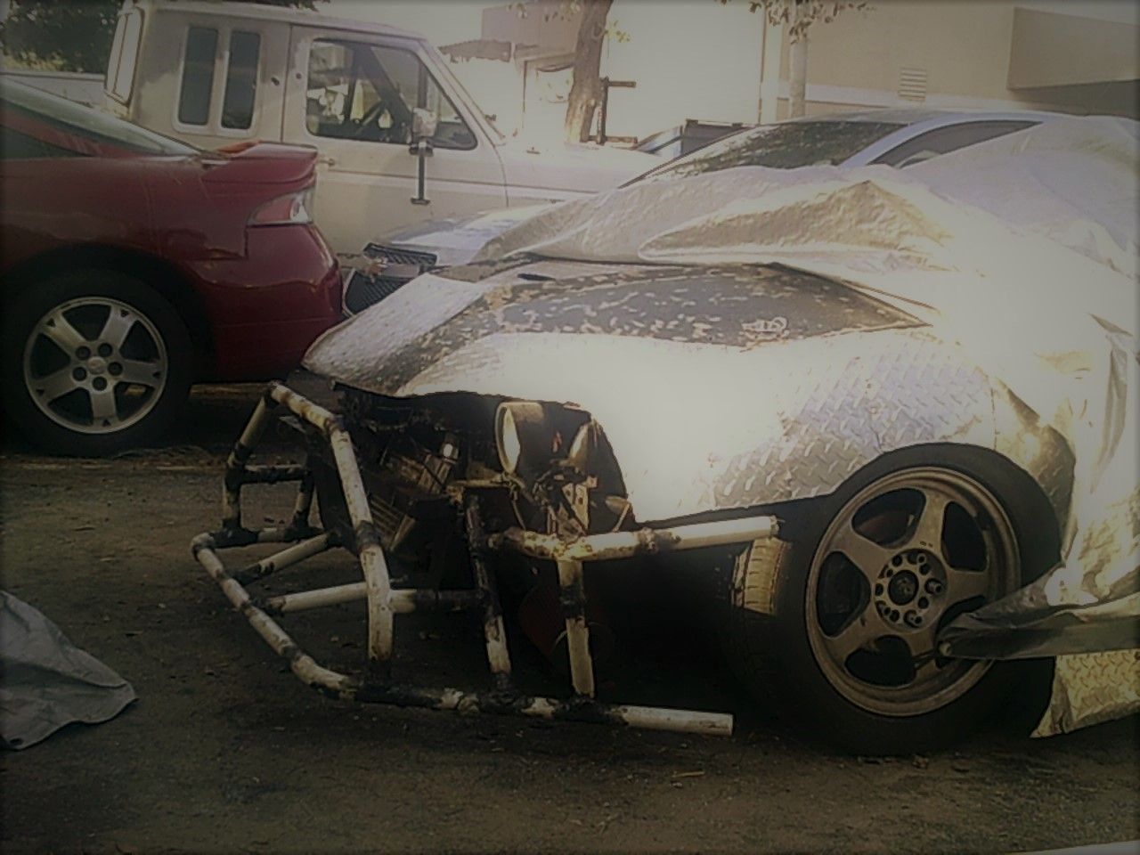

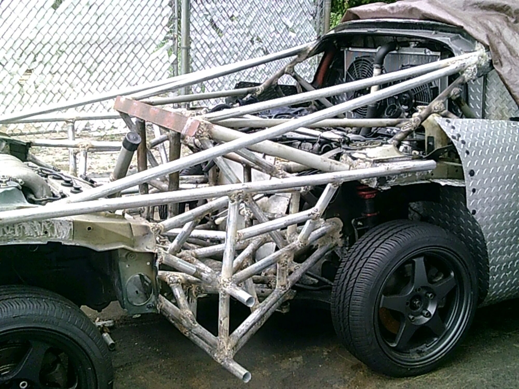

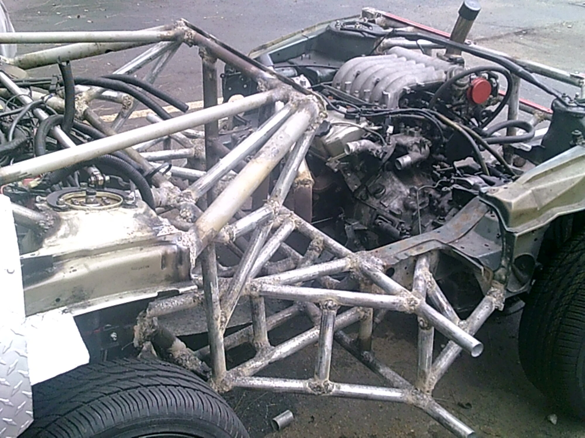

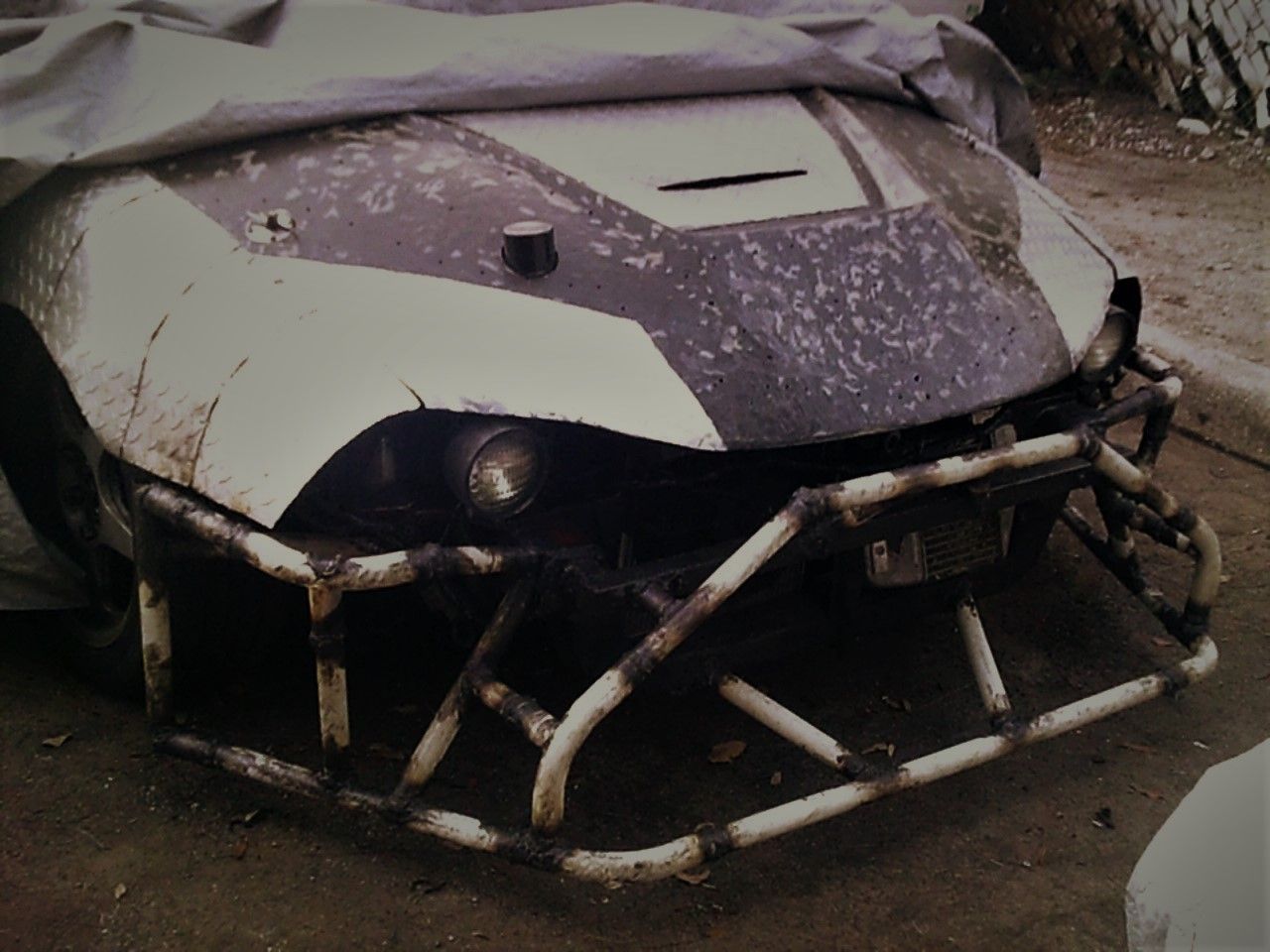

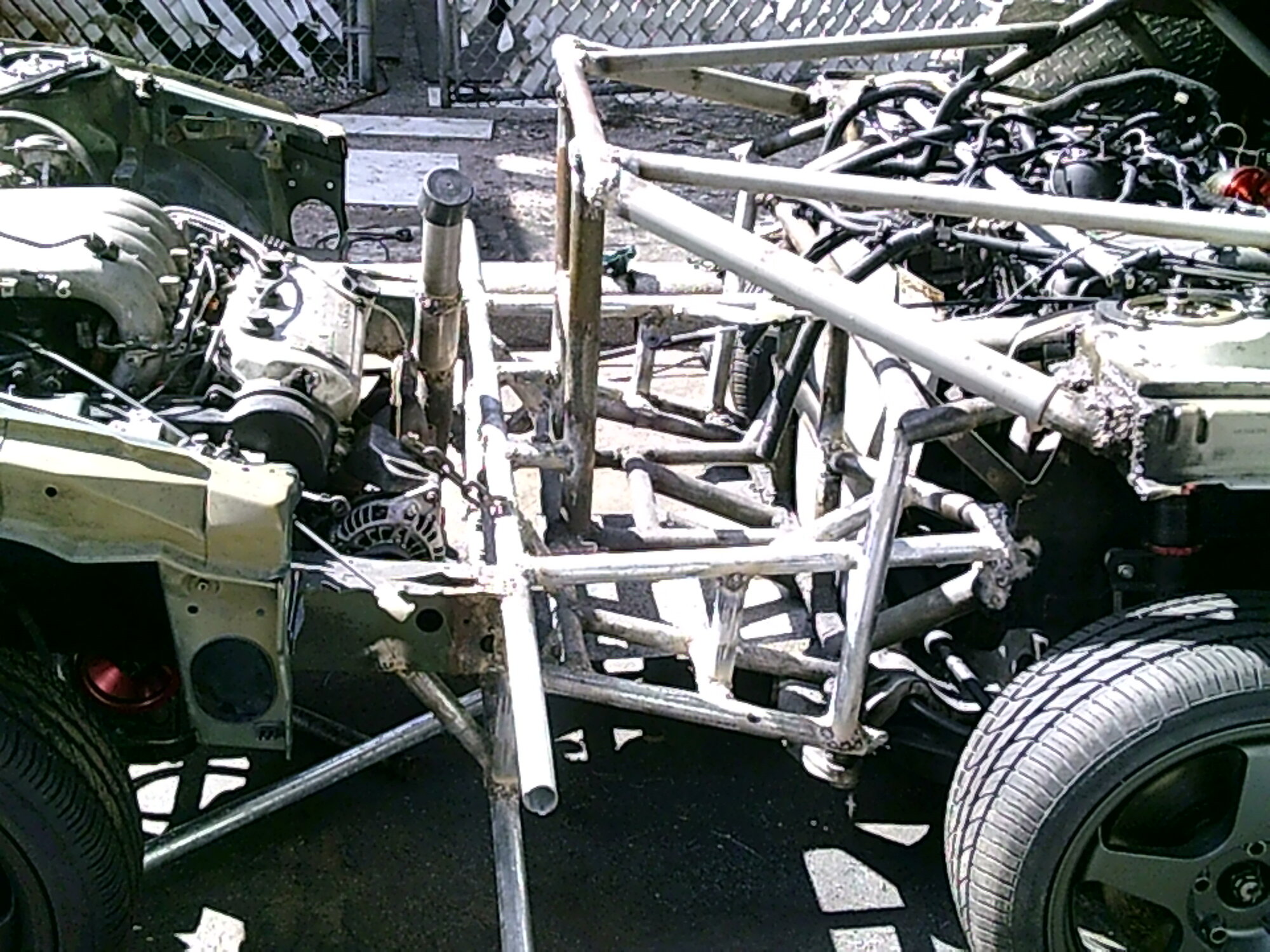

Triple engine content slightly above ...

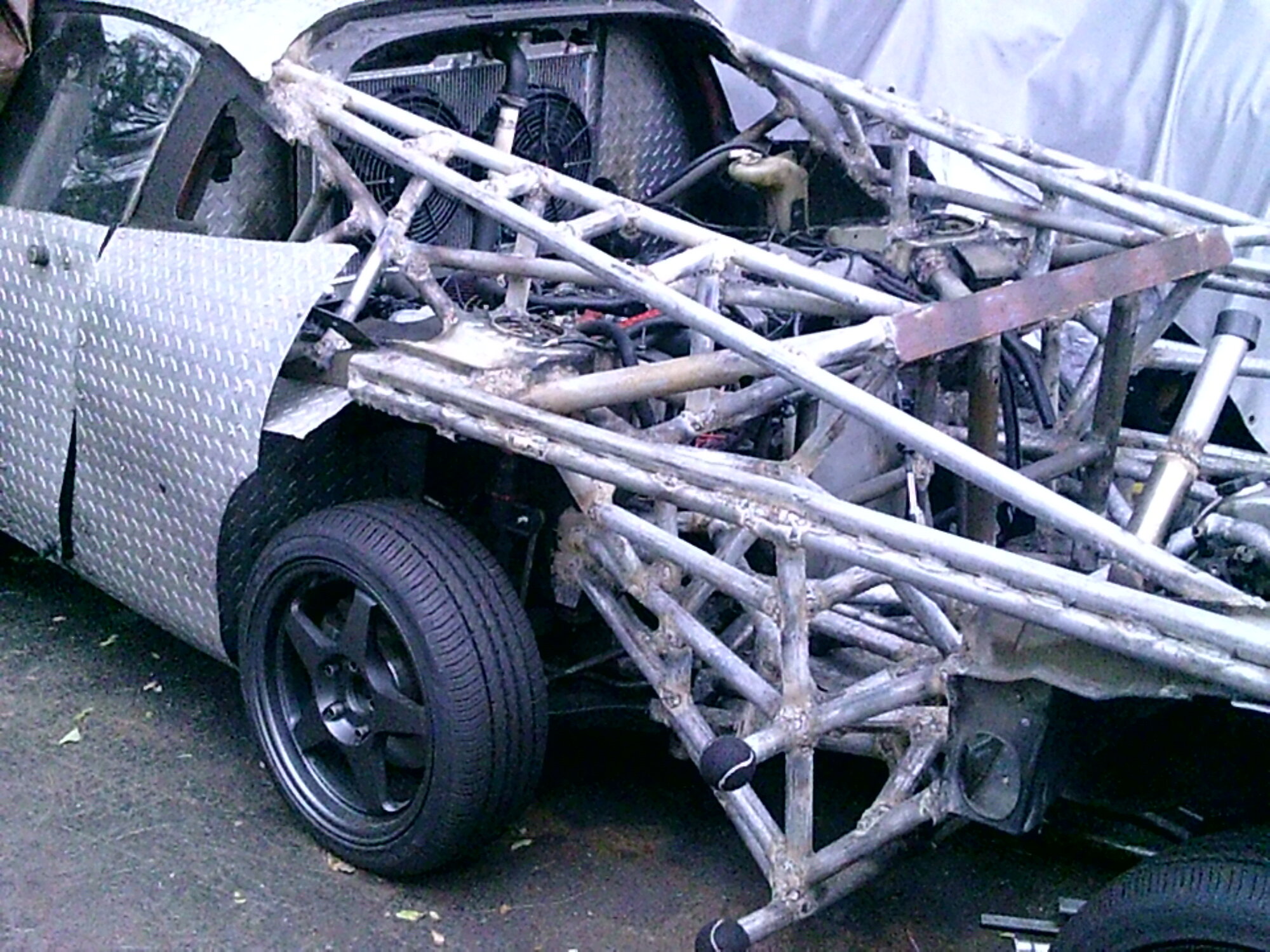

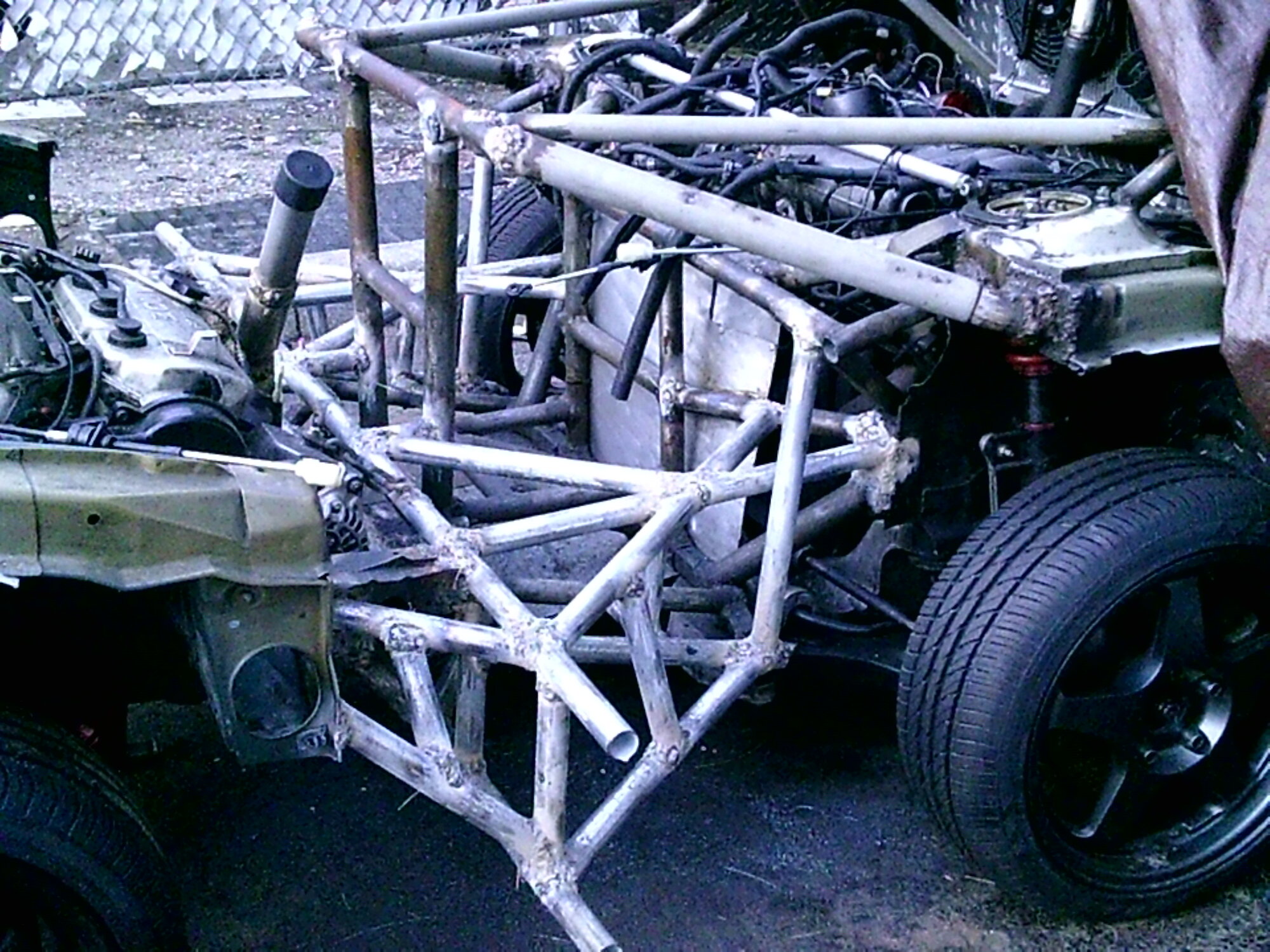

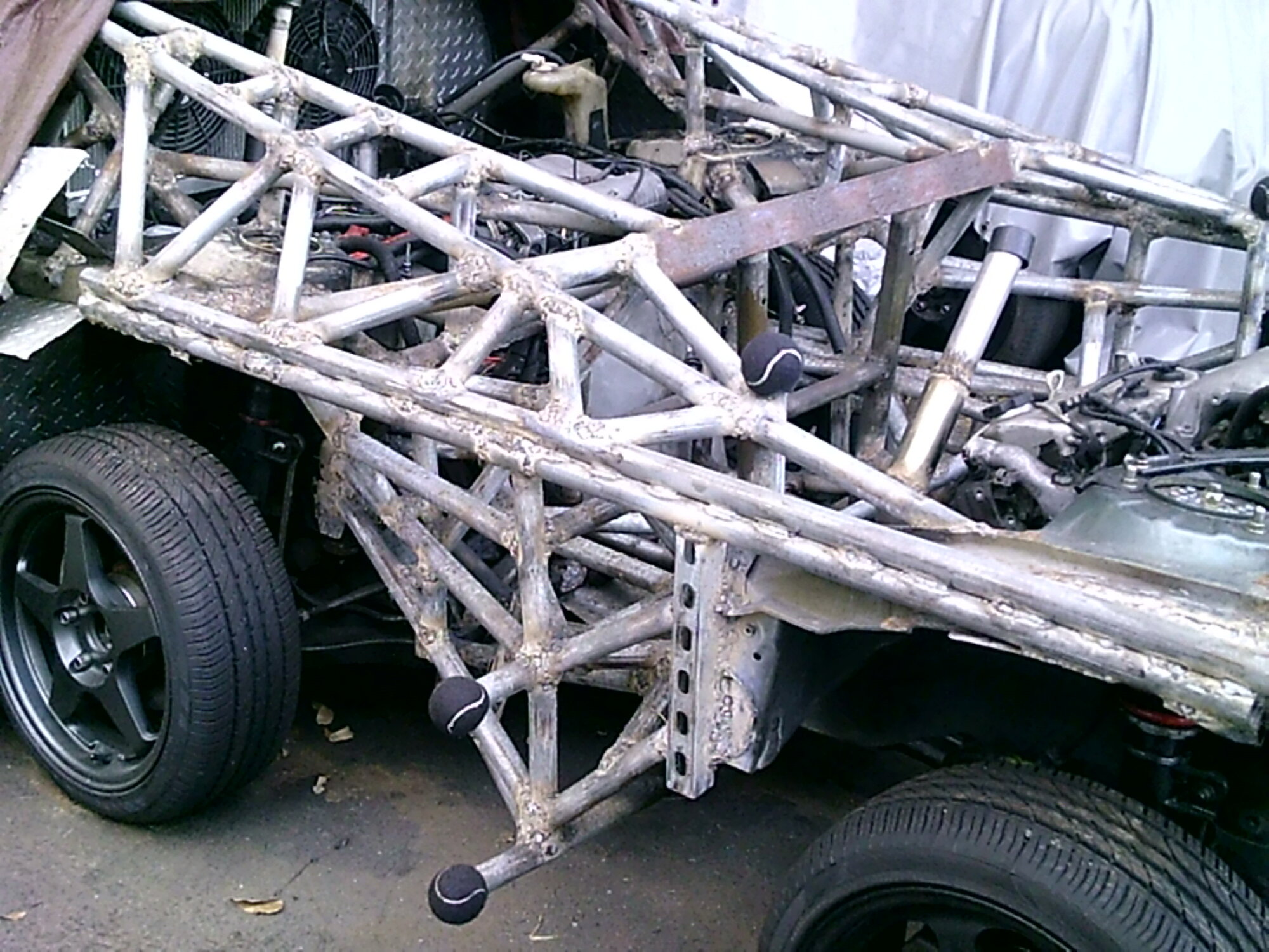

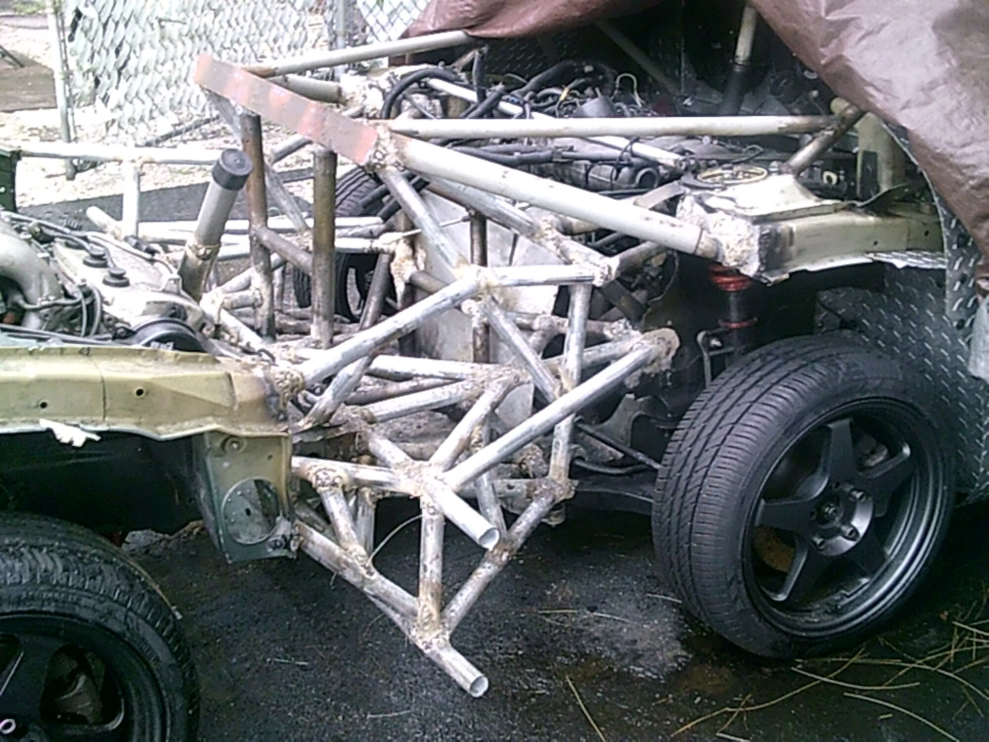

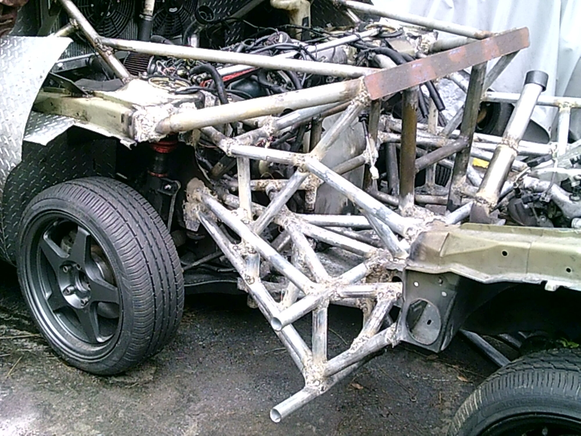

Additional info can be found in video descriptions or posts . I addressed welding in post here : https://www.youtube.com/post/UgkxB7iH3yBV1Lph4WlM9lWXmRYz1nowdQhb
Clip in reference same 125amp flux core welder 6 years ago :
Unless incentivized there's no reason worth my while for the additional effort , cost , time , and labor to do above average non structural work . Stepping up is nothing .

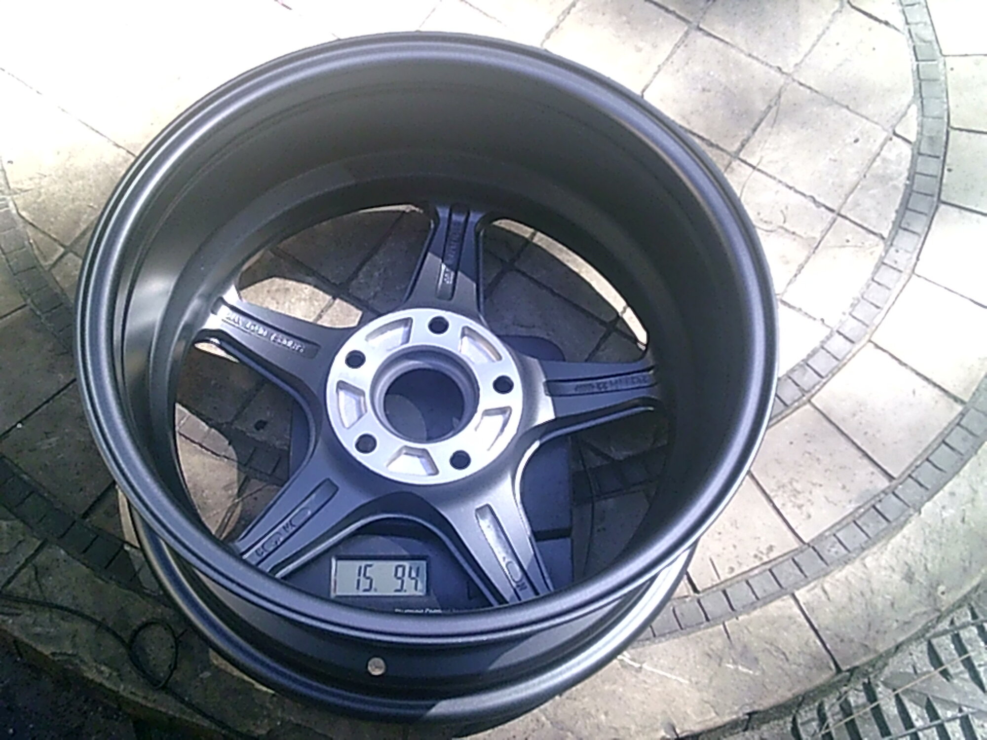

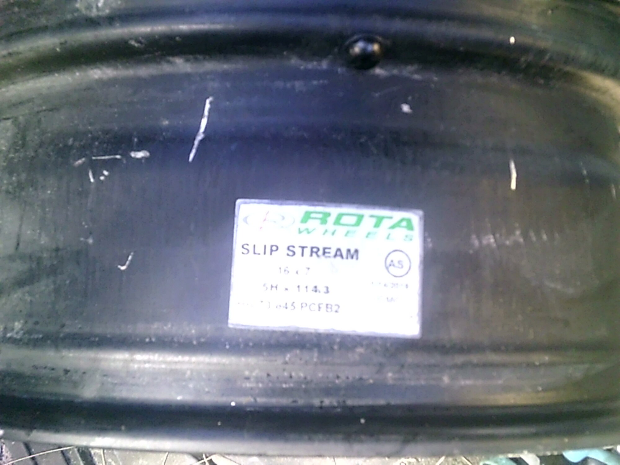

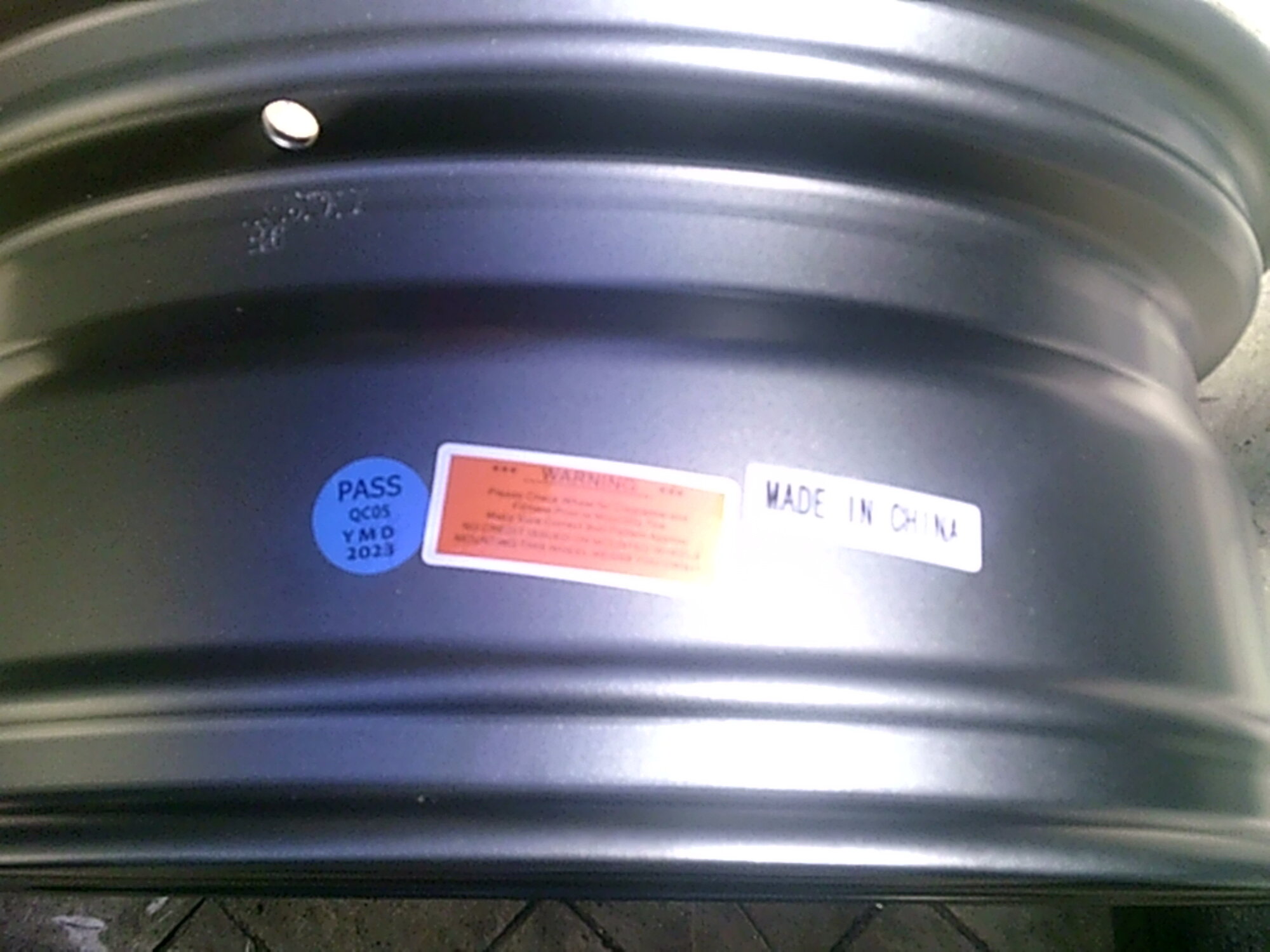

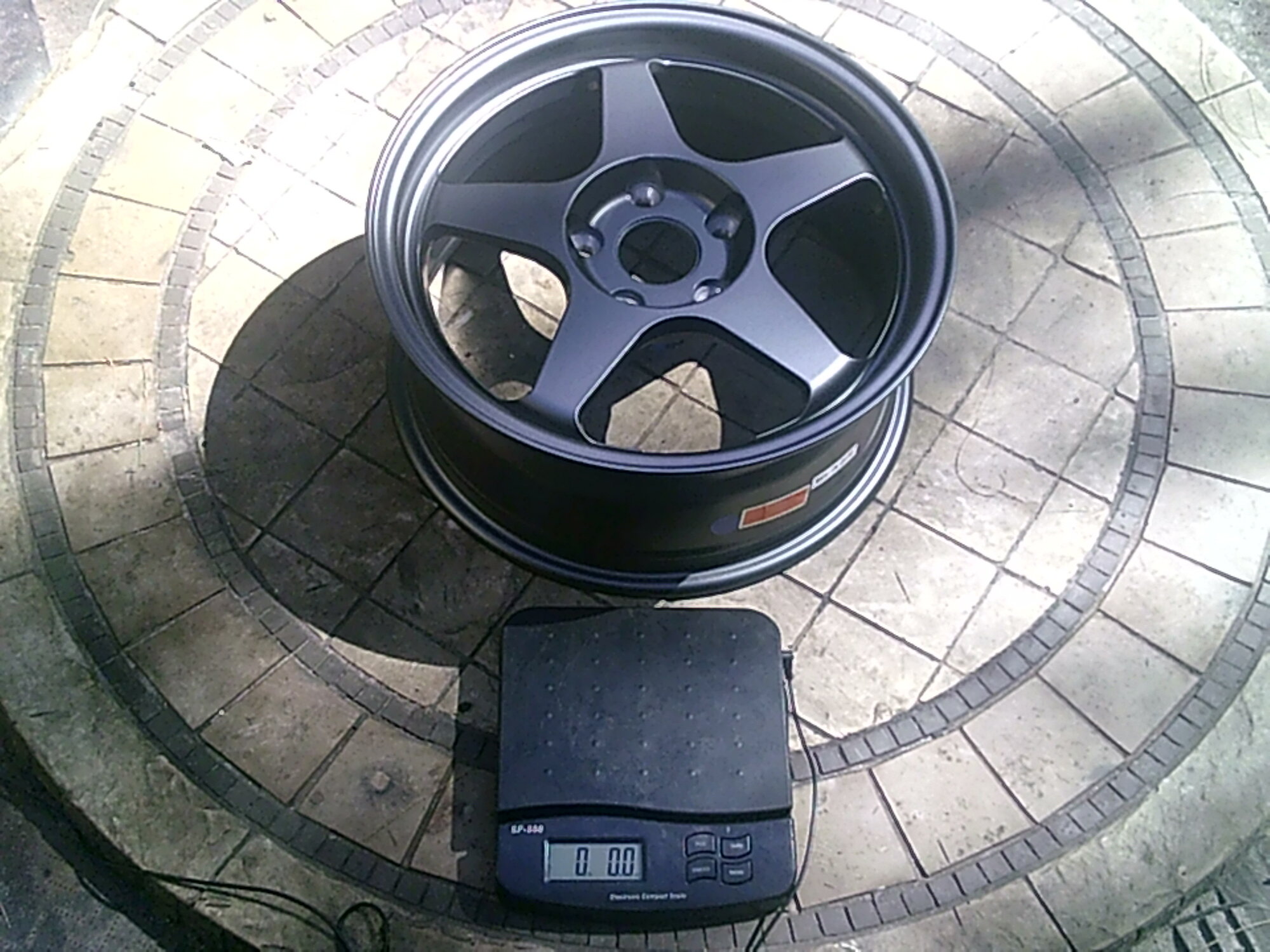

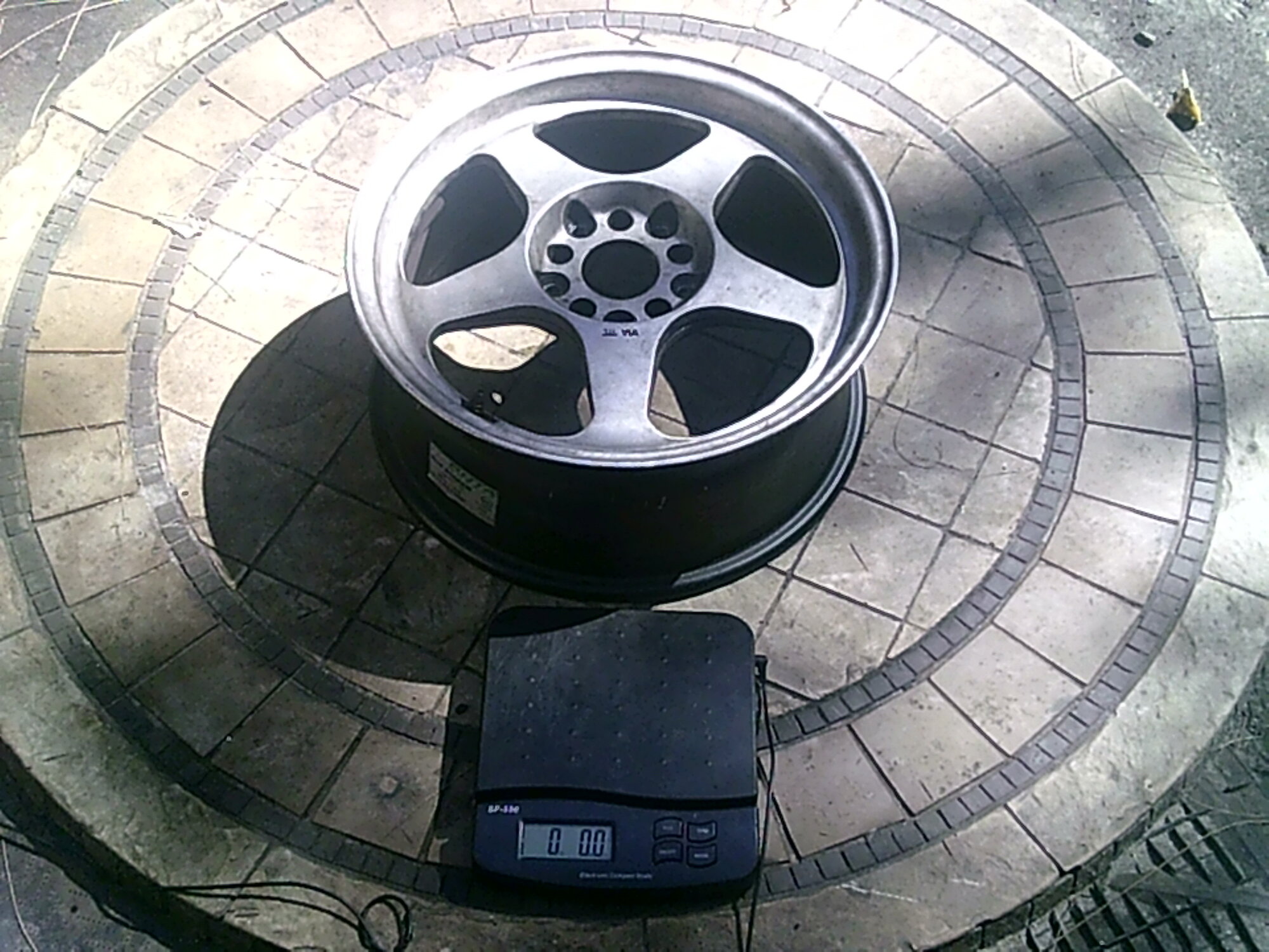

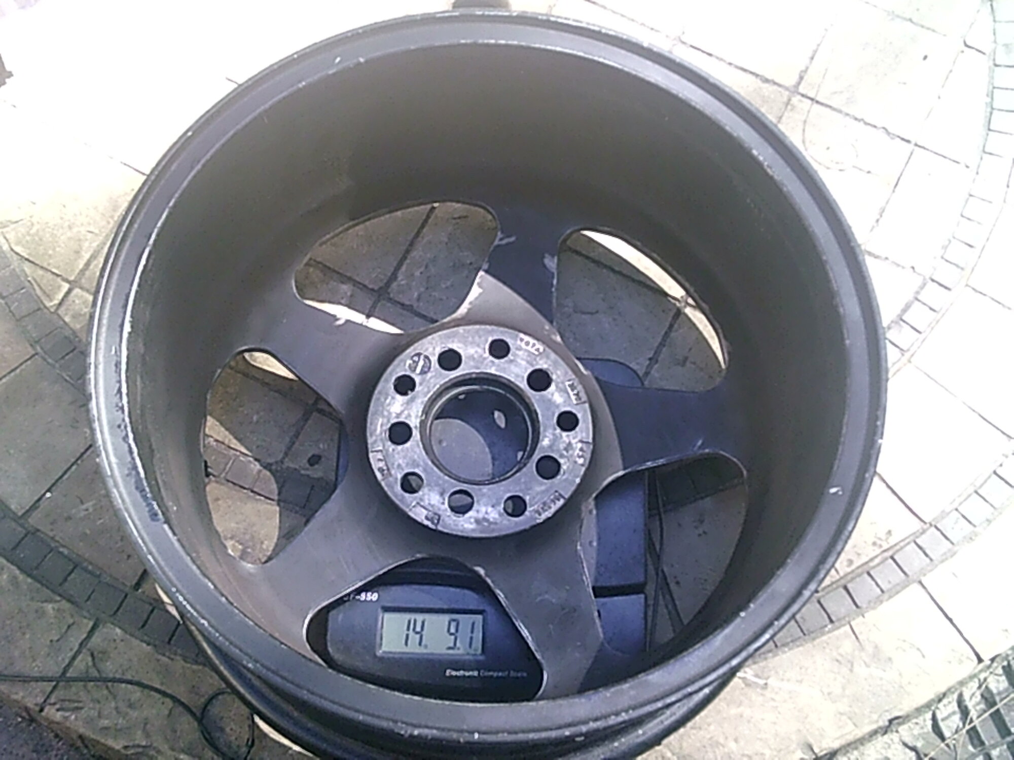

Rota Slipstream 16x7 weighs 14 pounds 9 ounces ...
Circuit Performance Model CP22 16x7 weighs 15 pounds 9 ounces ...
Triple Engine Eclipse is on Matching Slipstream . Twin Engine Geo Metro is on matching CP22 .

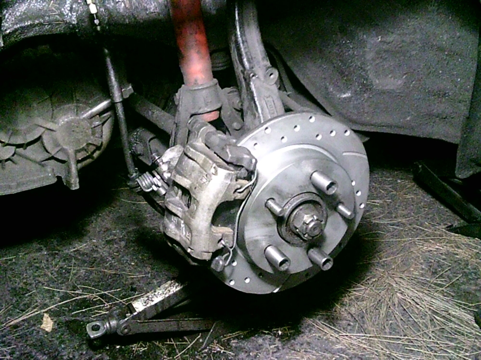

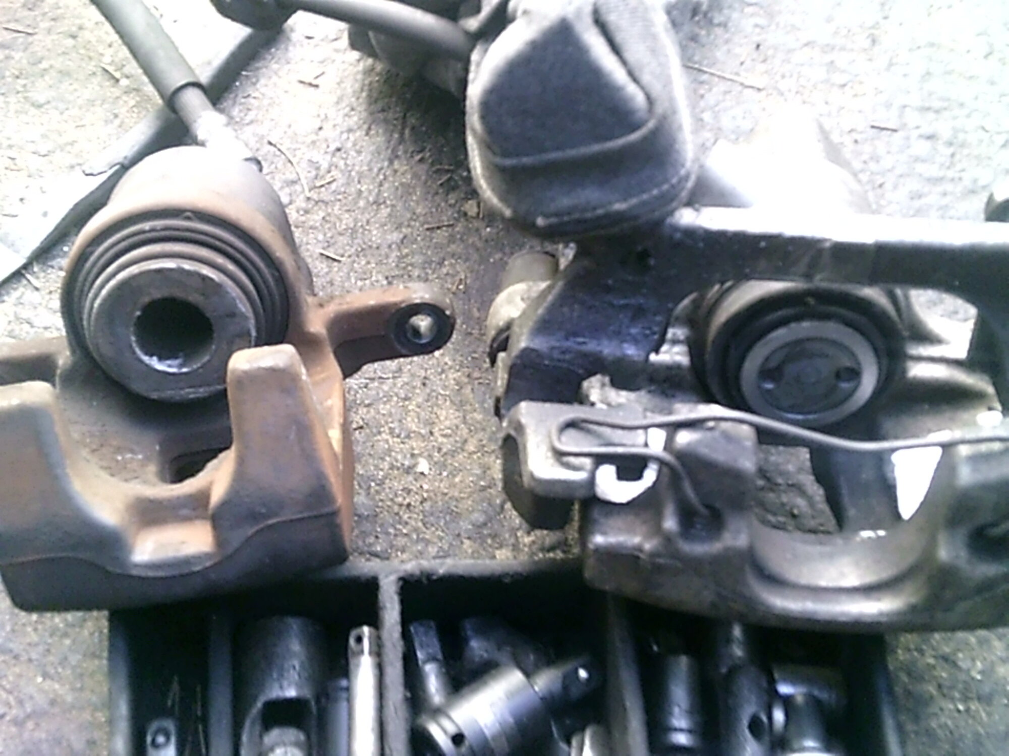

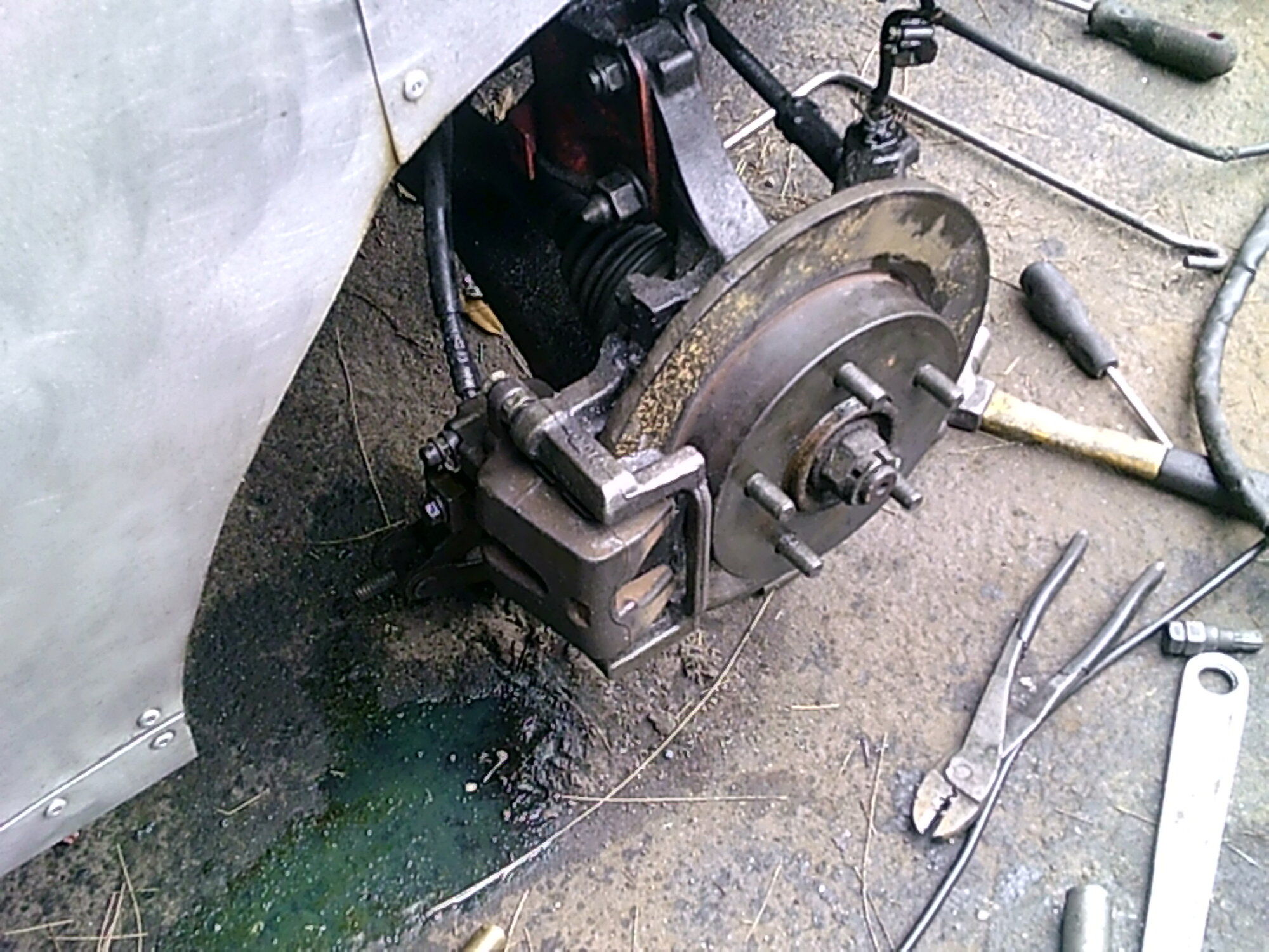

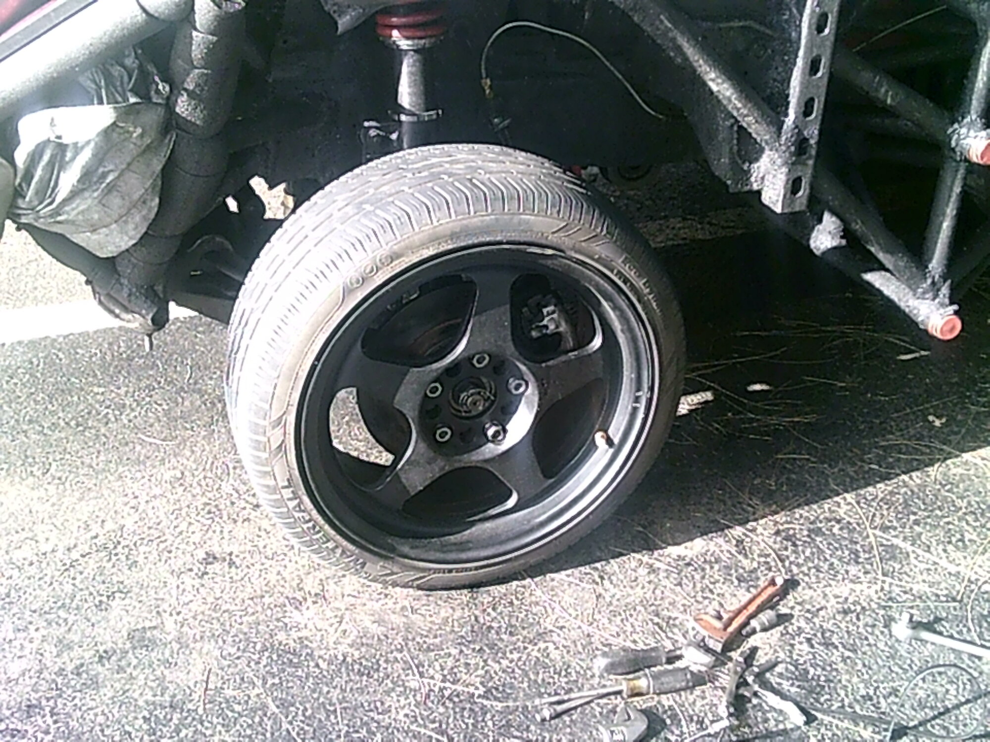

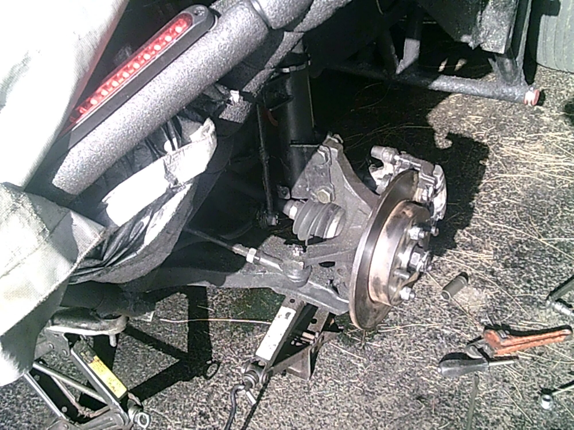

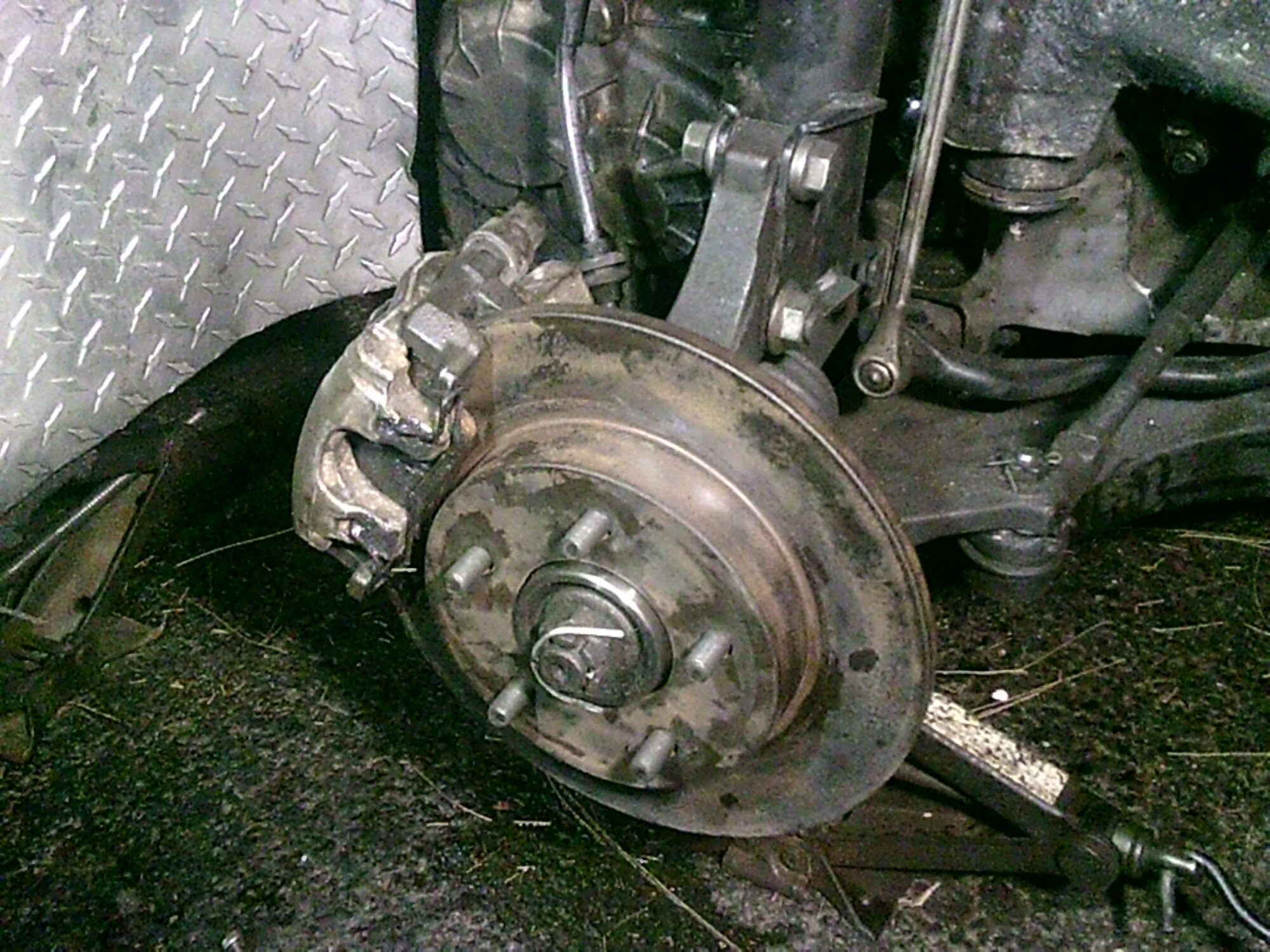

Triple Engine Eclipse build part 66 ... Lighter rear rotors and aluminum calipers than the previous in post here : https://www.youtube.com/post/Ugx9SSu3ynl_70TwDGl4AaABCQ
Previous pic :
New rear set up pics ...
Dropped 8 pounds rotational and 5 lbs static for a 13 pound total loss .

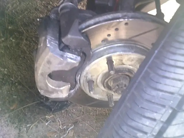

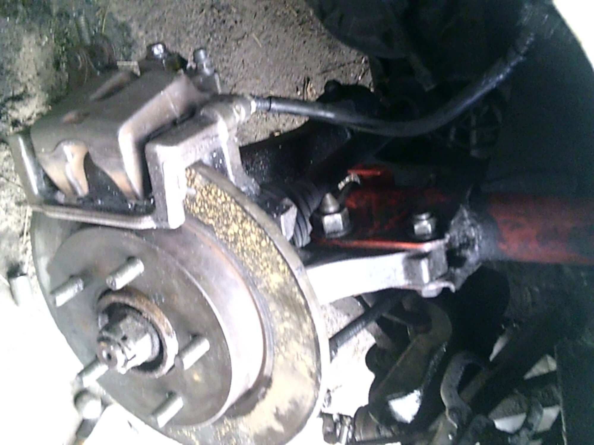

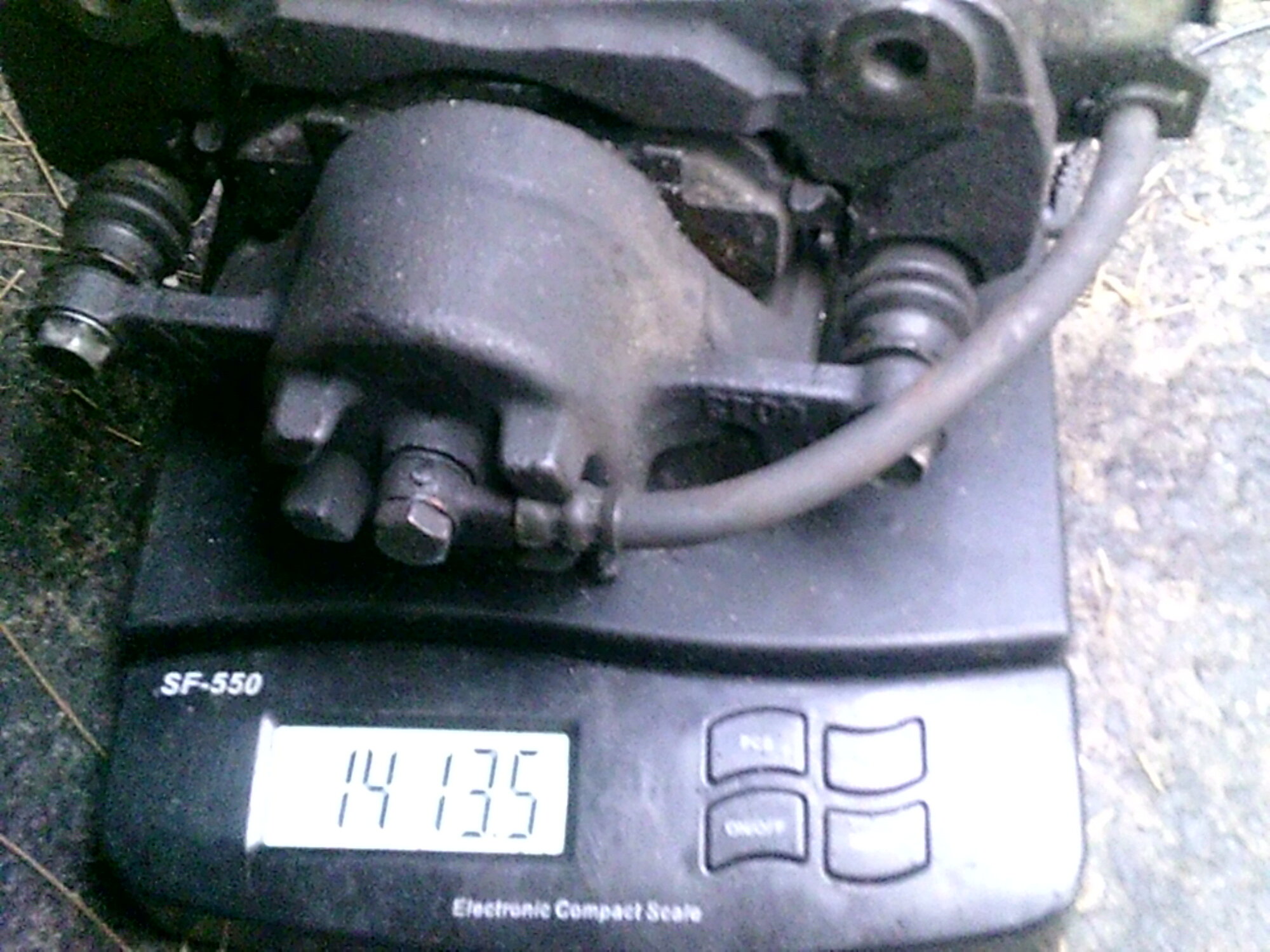

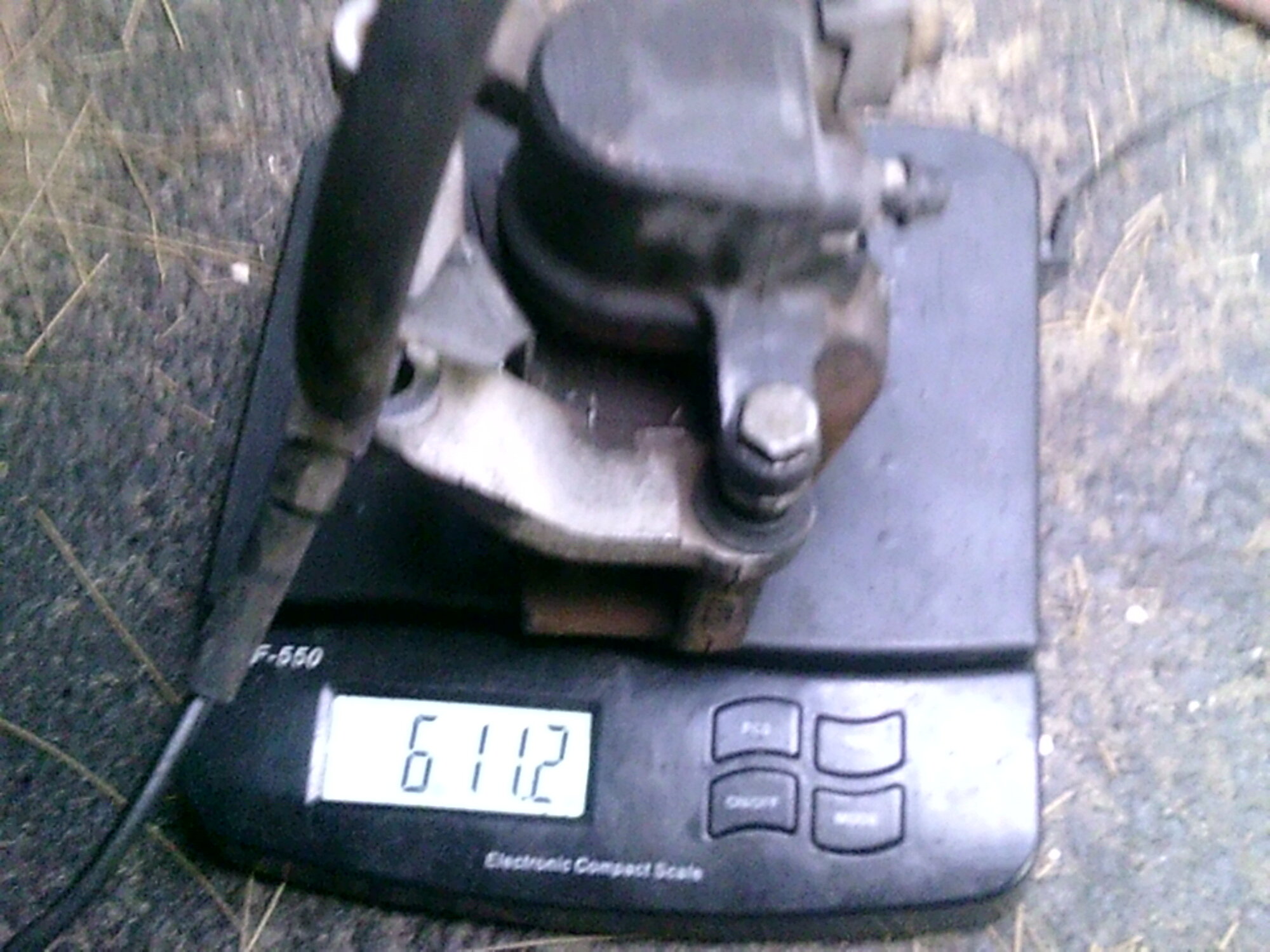

Triple Engine Eclipse build part 67 ... Fronts same deal , one side done . Dropped 1lb rotational & 2 pounds static x2 when finished for a 6lb total . Rotors weigh approx 8lb 10oz . Aluminum calipers with hose and pads 6lbs 13oz .

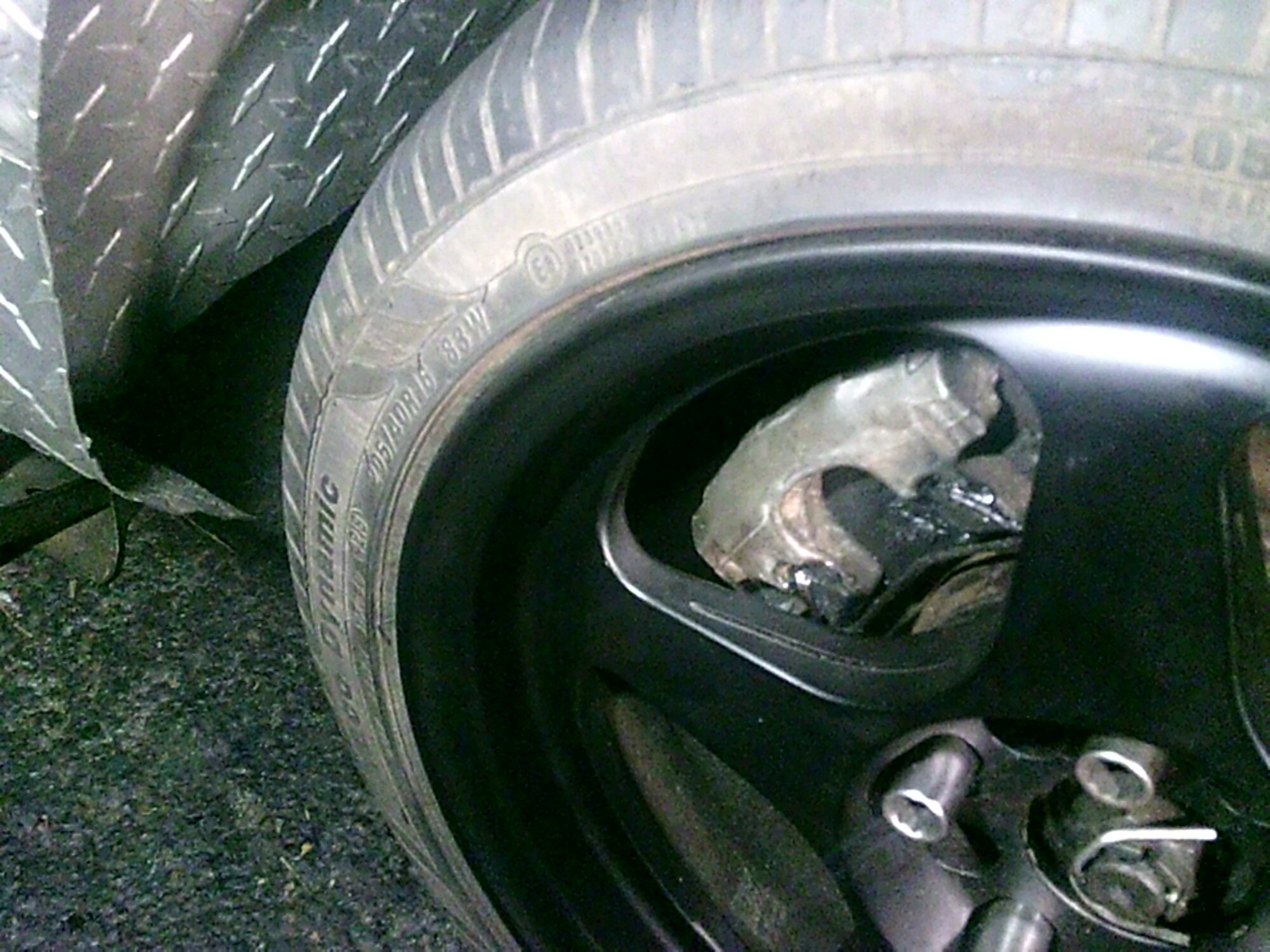

Update ... Long story short , lost too much stopping power after doing smaller lighter fronts . Rears are fine and stopped good before doing fronts . If the gains were the same I'd try some brembo rear calipers as front calipers . I have one more idea that doesn't cost or seem likely working , but may end up back to the heavier bigger aluminum prior set up for the fronts and swapping the drilled rotors on now to the rears .

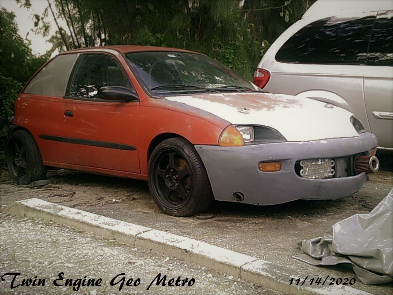

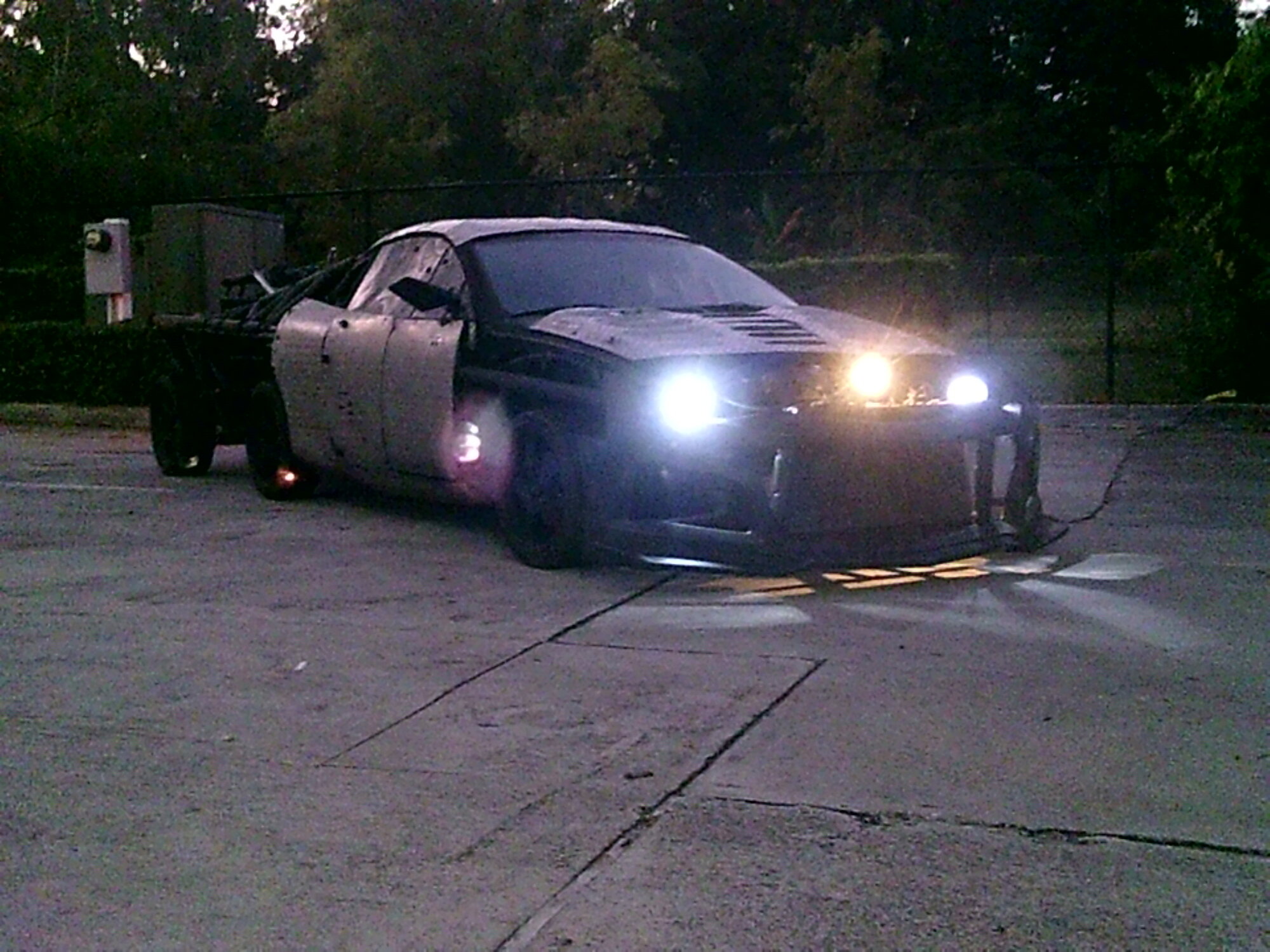

Update and response : The attention the Triple Engine Eclipse got would literally stop traffic just to see it move off . It is not "cool " to be a celebrity , the pressure and " eff what you got going on , stop and answer my questions on the spot " is something I had to learn and hand out a note to people telling them where to find information online . It was respectful to me and them , cause I took the time to prewrite notes , and it lets them know I get questioned alot so here's where most answers are . I'd still answer a few questions if they persisted , but most are cool and get the situation .

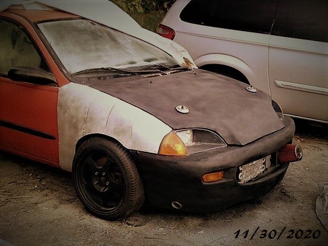

I'm speaking in present tense cause I took the Eclipse off the road and am now driving the Geo . The Geo prior and now isn't as big of a draw . I still have notes but blend in more . The Eclipse was to no surprise not the best on mpg . Even if I ran one engine only , I would be at a disadvantage weighing 4100lbs total . I miss the veracity of the Eclipse but the Geo's a beast too .

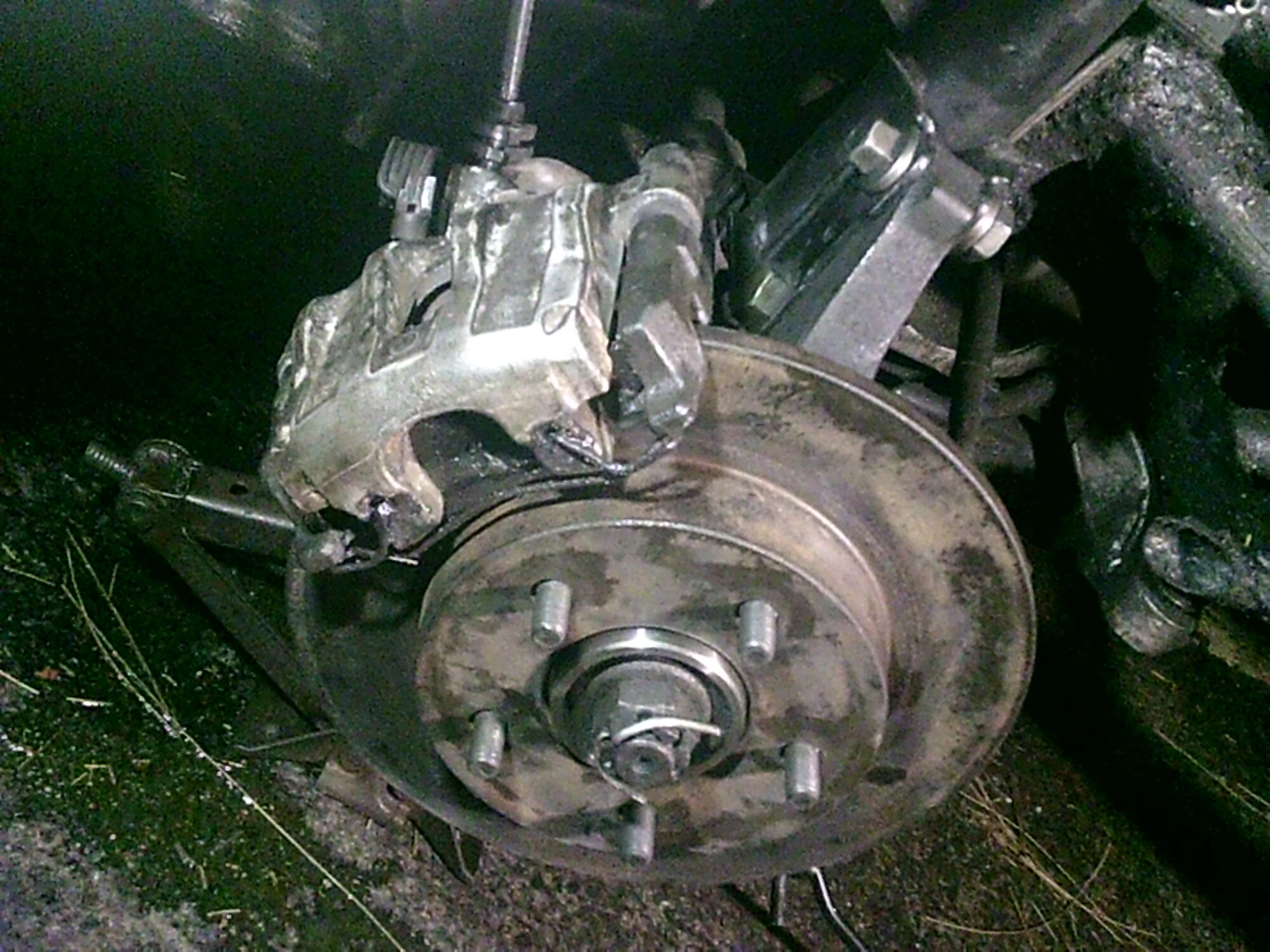

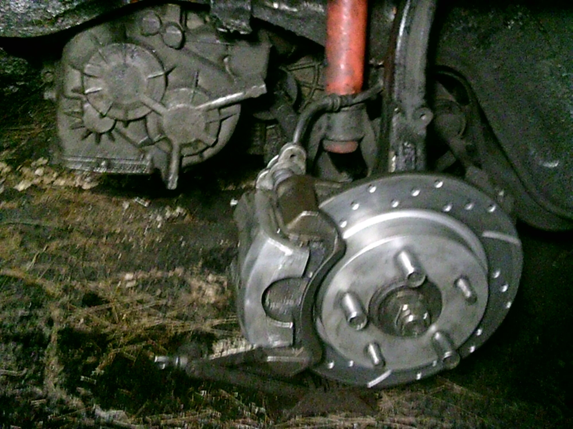

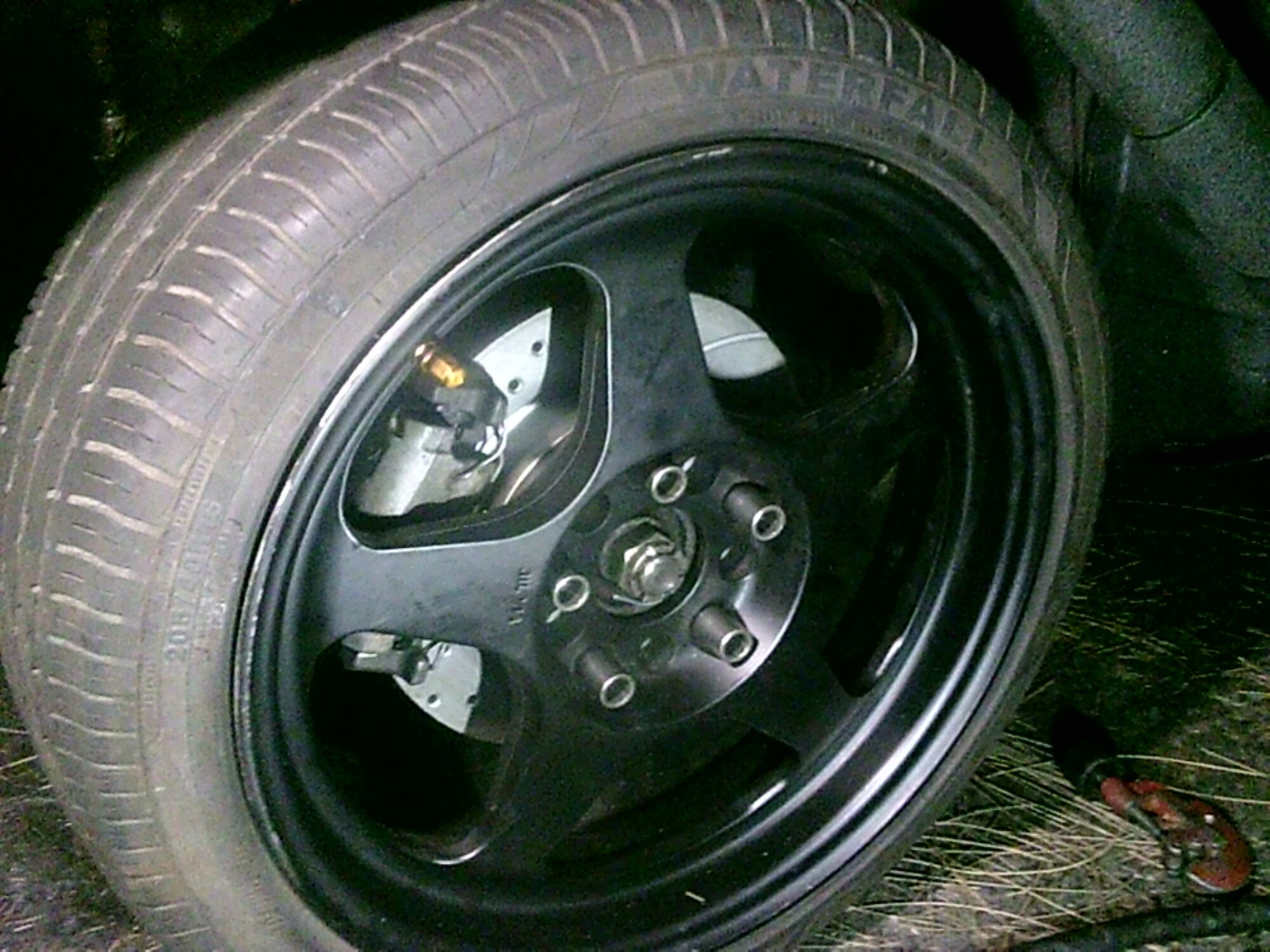

Brake Caliper fix update ... Prior I used smaller and lighter aluminum rear brake calipers on the Eclipse but lost alot of stopping power . That caliper type was a twist in / out style . Prior fix in the past was using bigger / heavier aluminum front calipers . That worked but now that I have more time I tried a set of push in / out style of aluminum rear calipers and that was a fix . I increased stopping power , though smaller , when using big front calipers with small solid rear rotors I need to make up a gap which reduces stopping power in itself . This mod is good for 7lbs each corner . Guessing the twist in / out type didn't work due to it possibly requiring more line pressure than what my current booster / master assembly provides . It wasn't a porportioning problem cause I tried twist type on all 4 corners . Going to install the remaining push in / out rears as fronts next , if no update all went well .
