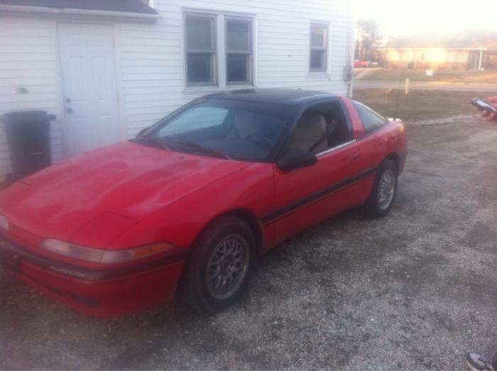

I'll start from the beginning. I bought this pretty little girl the day after Christmas last year, pulled her home on about a 3 hour drive, that ended in a dent on the drivers rear quarter panel right behind the door :( ImageUploadedByTapatalk1396027770.637056.jpg
