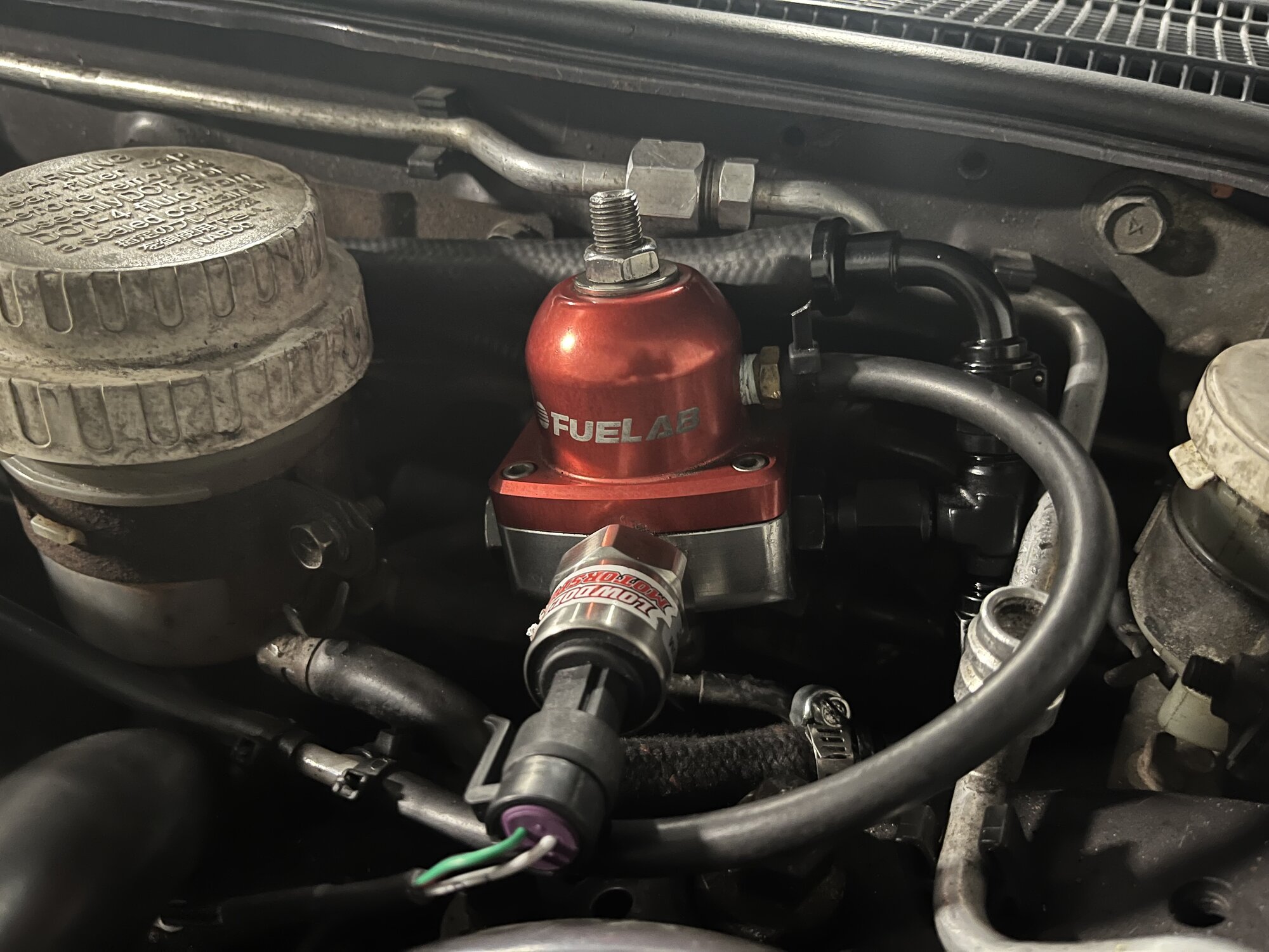

Swapped the fuel pump only to realize that it wasn’t actually what failed. It was really its output at the PMU16 (the PDM I use). It was the first device I wired in, so it could have been bad wiring, but it is also possible that I over-amped it with the hellcat pump. Probably couldn’t hurt to add a standalone fuse like one would do for your typical fuel pump rewire, so I intend to do that soon. On the bright side, I feel like I did a better job installing the new fuel pump. At least I got a video out of it, and it’ll be easier to service in the future.

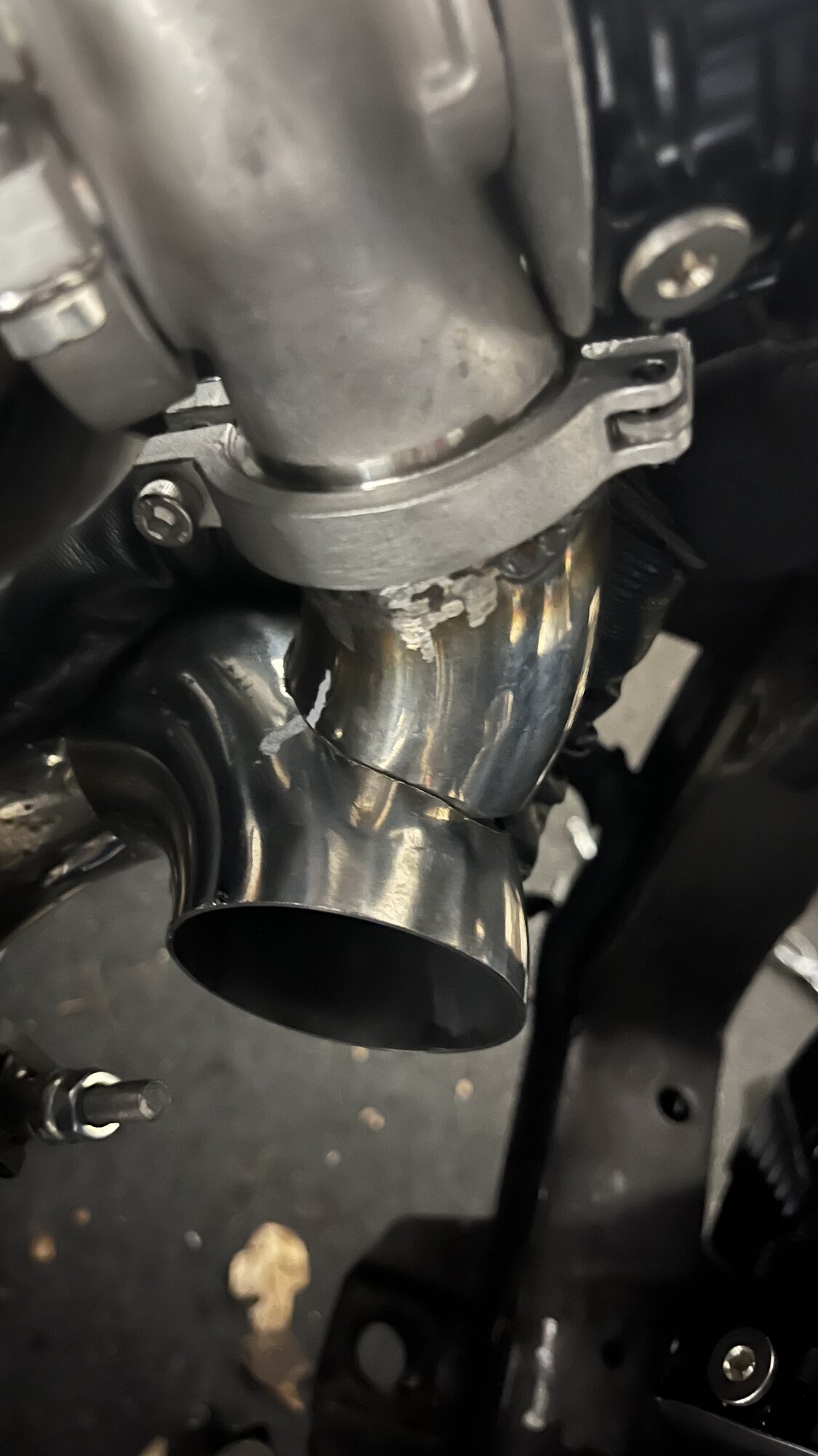

Not lucky enough though. I didn’t exactly have a clean launch, but I was going to catch the guy. Unfortunately, I popped a coupler halfway down the track, and it ruined what may have been a salvageable pass.
I quickly fixed it, made some adjustments, and got back out there only for my car to randomly die and refuse to start at all. I would’ve been chasing my tail much longer, but I remembered @jdxnc giving me the heads up a few months back that sometimes the 12-1 trigger setup with the 2G cam sensor may suffer from voltage issues if the battery was too low. I had charged my battery to max at home in the garage right beforehand, but I do run a lot from it, and I’ve been having issues lately. It is something I intend to upgrade.

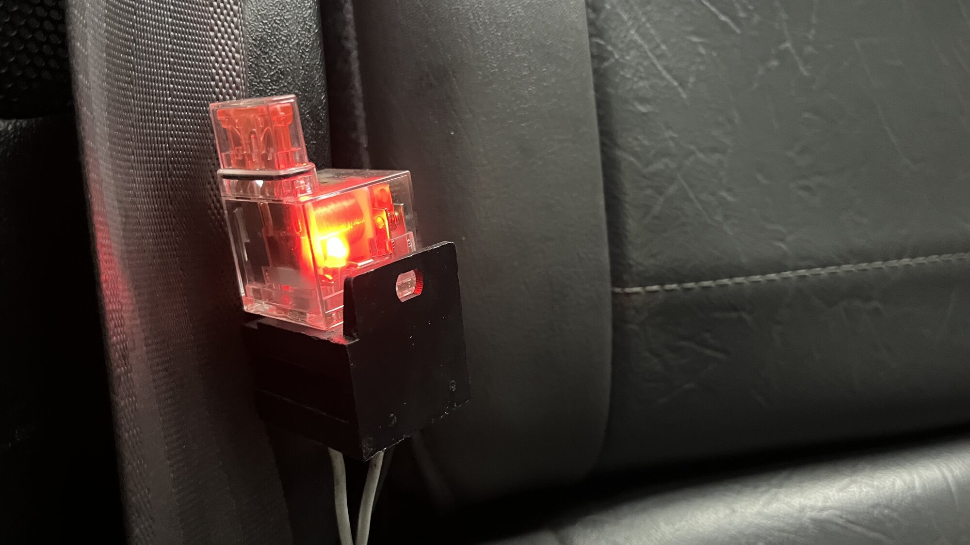

Yes if you have a standalone relay, fuse, and large gauge wire to take the ~22 amps to the pump, that yellow connector should be a lot happier!

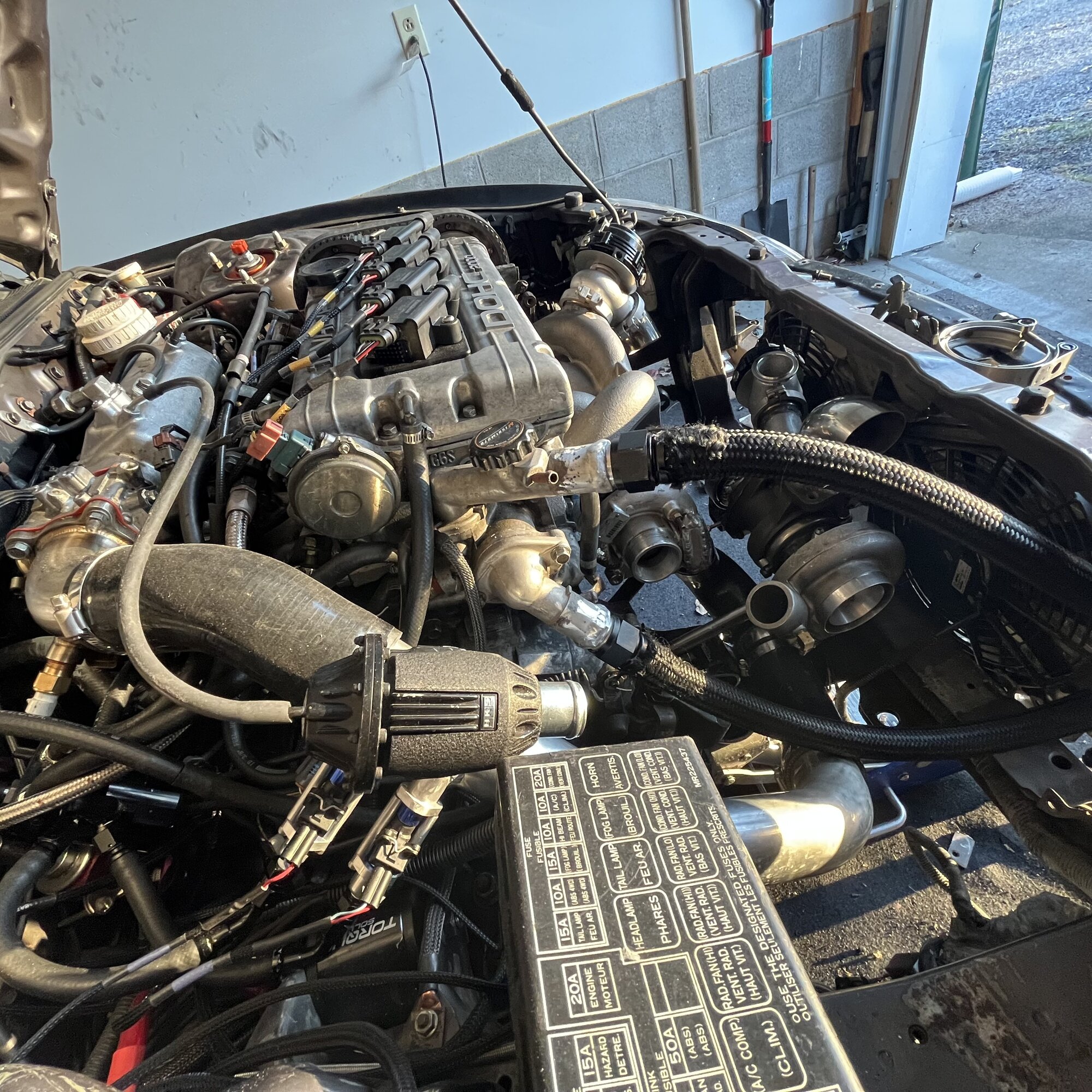

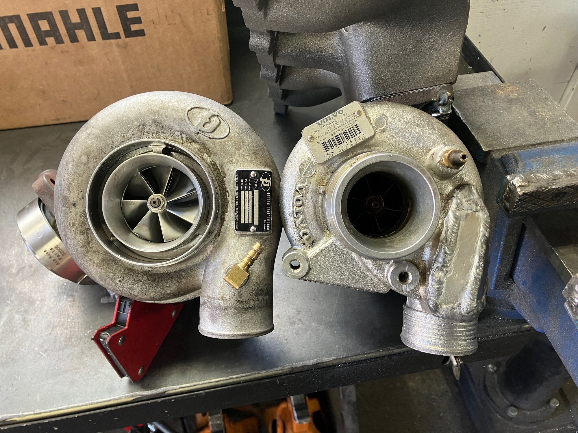

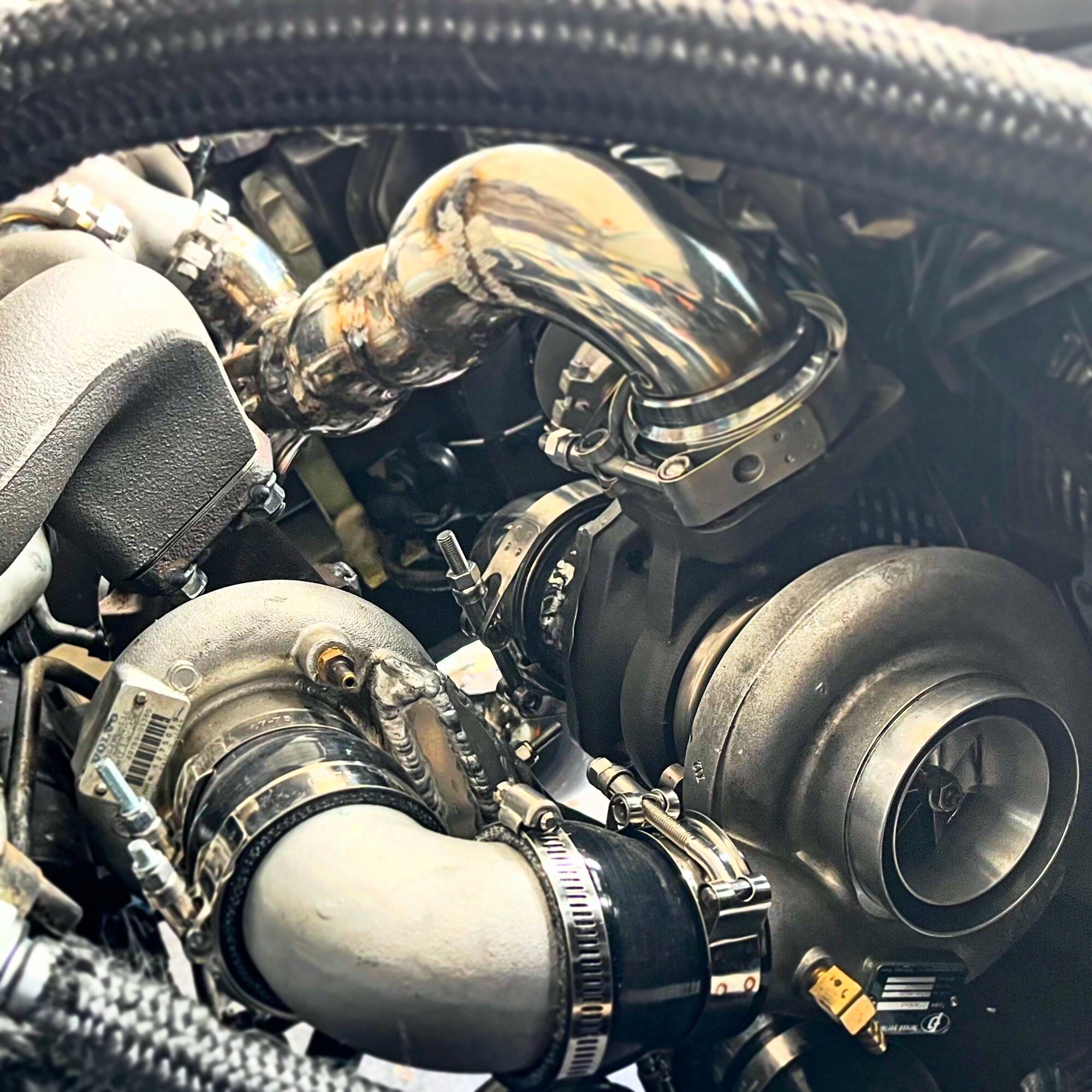

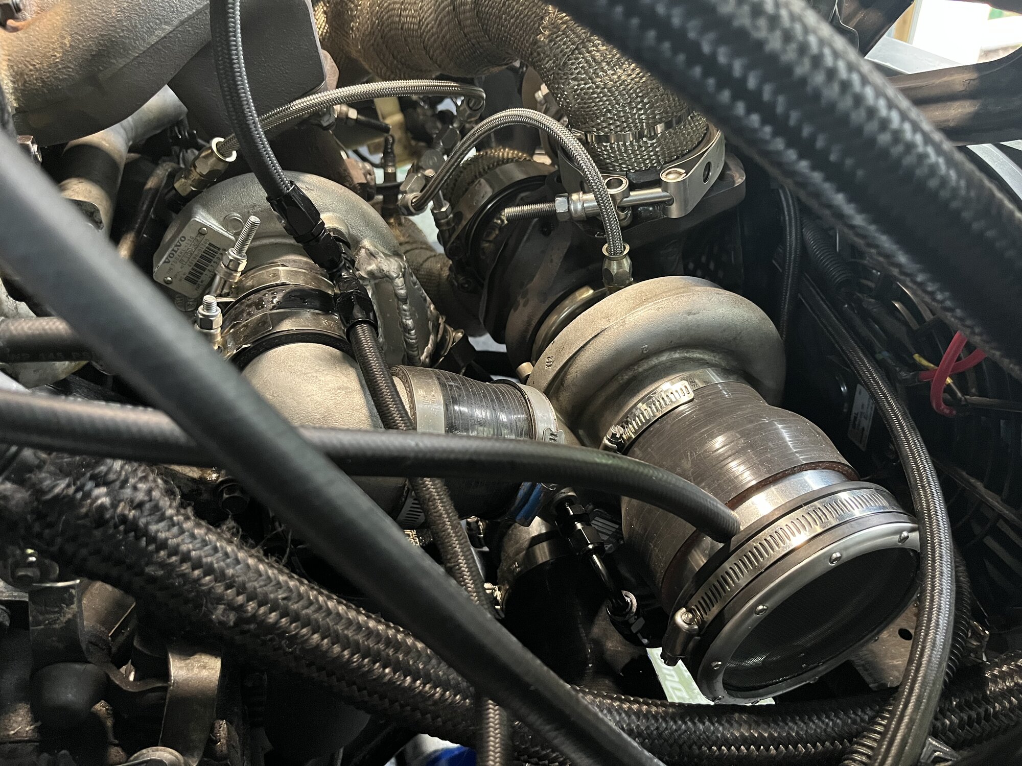

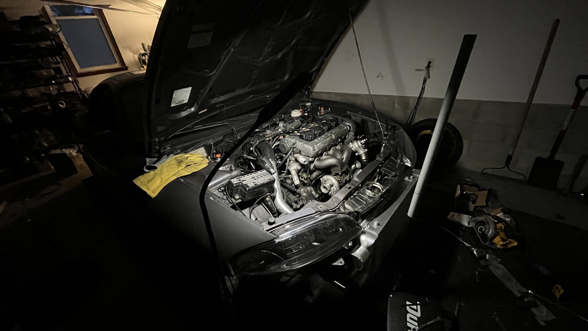

So we’re going compound turbo.
I wasn’t sure I could actually do this even after I committed to it, so I’ve been reluctant to broadcast that it’s what I’m working on, but now I’m in deep enough that I’m pretty sure I’m going to see it through 😂

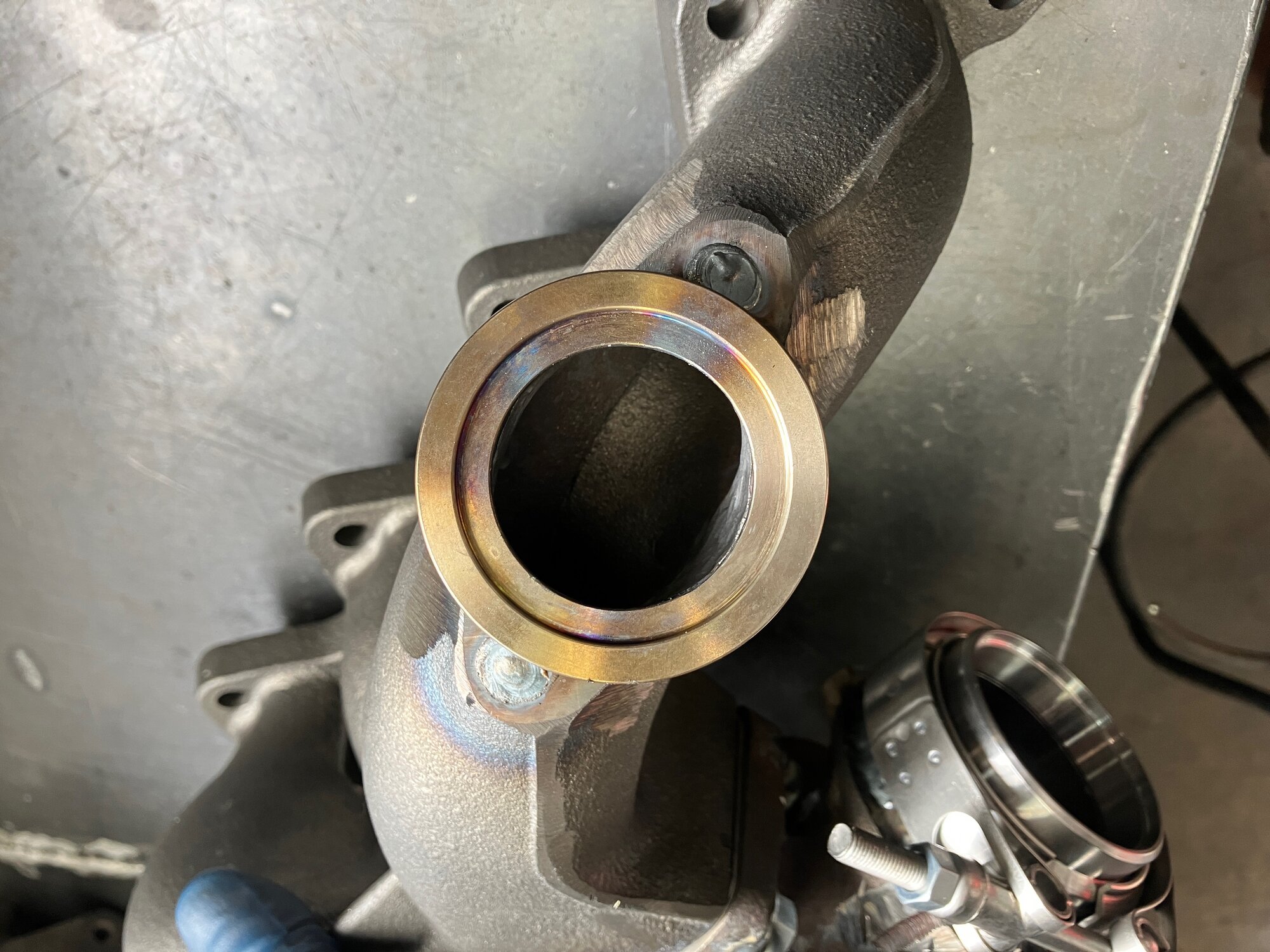

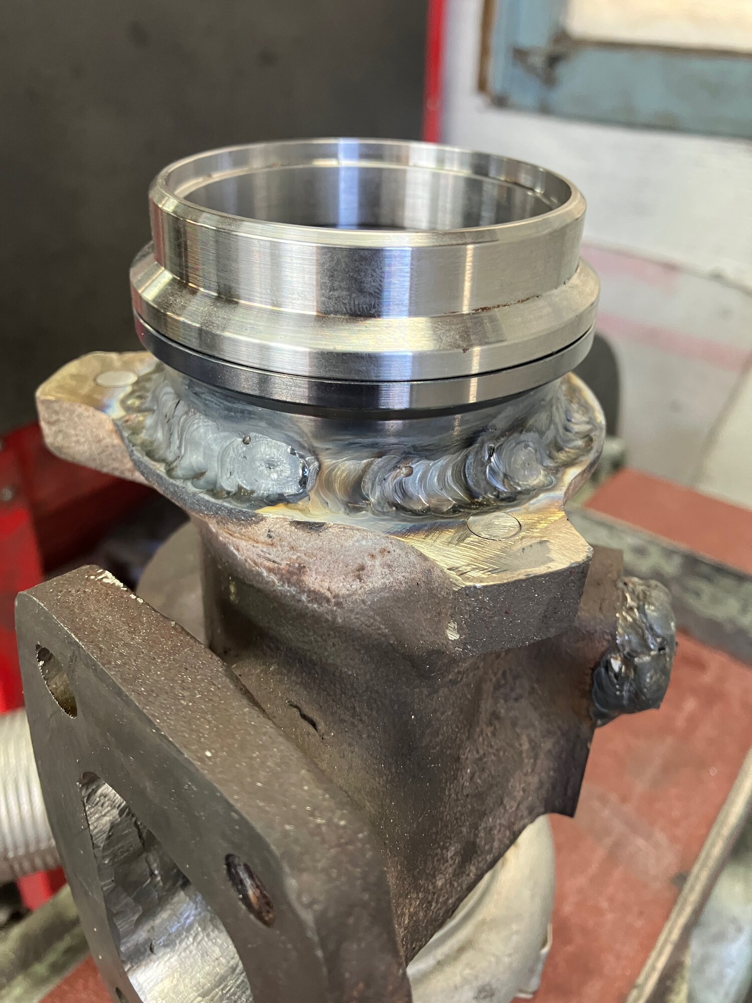

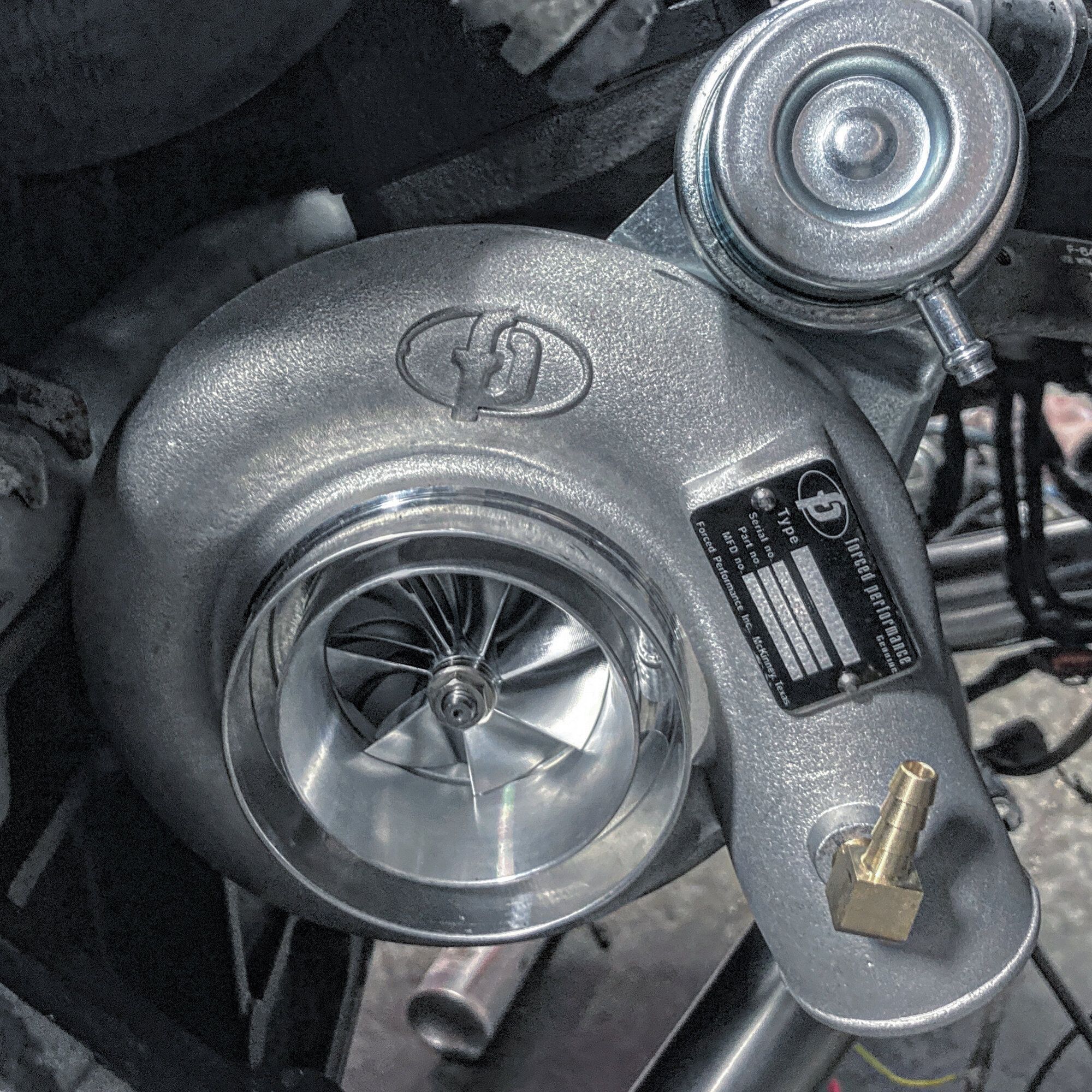

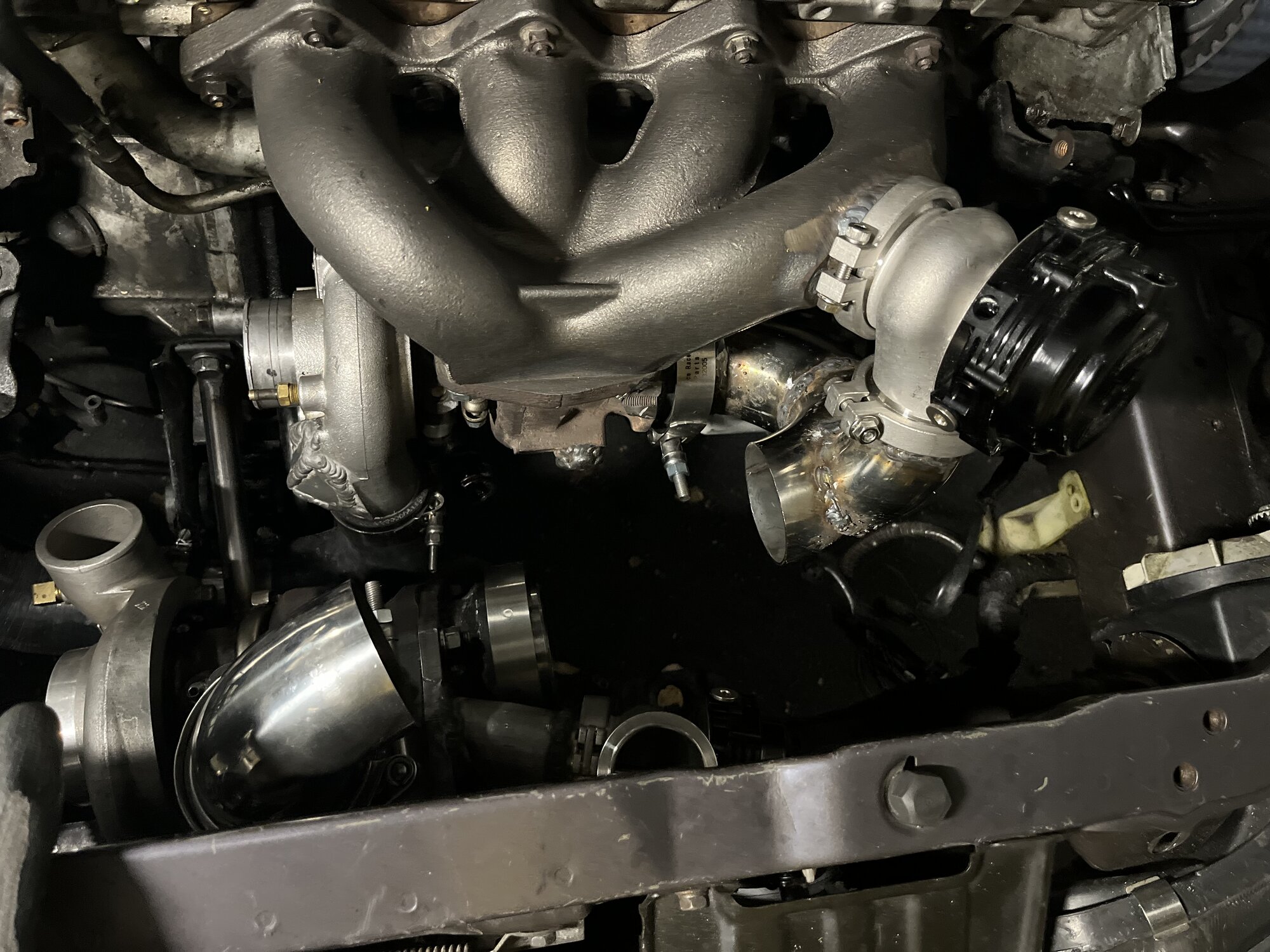

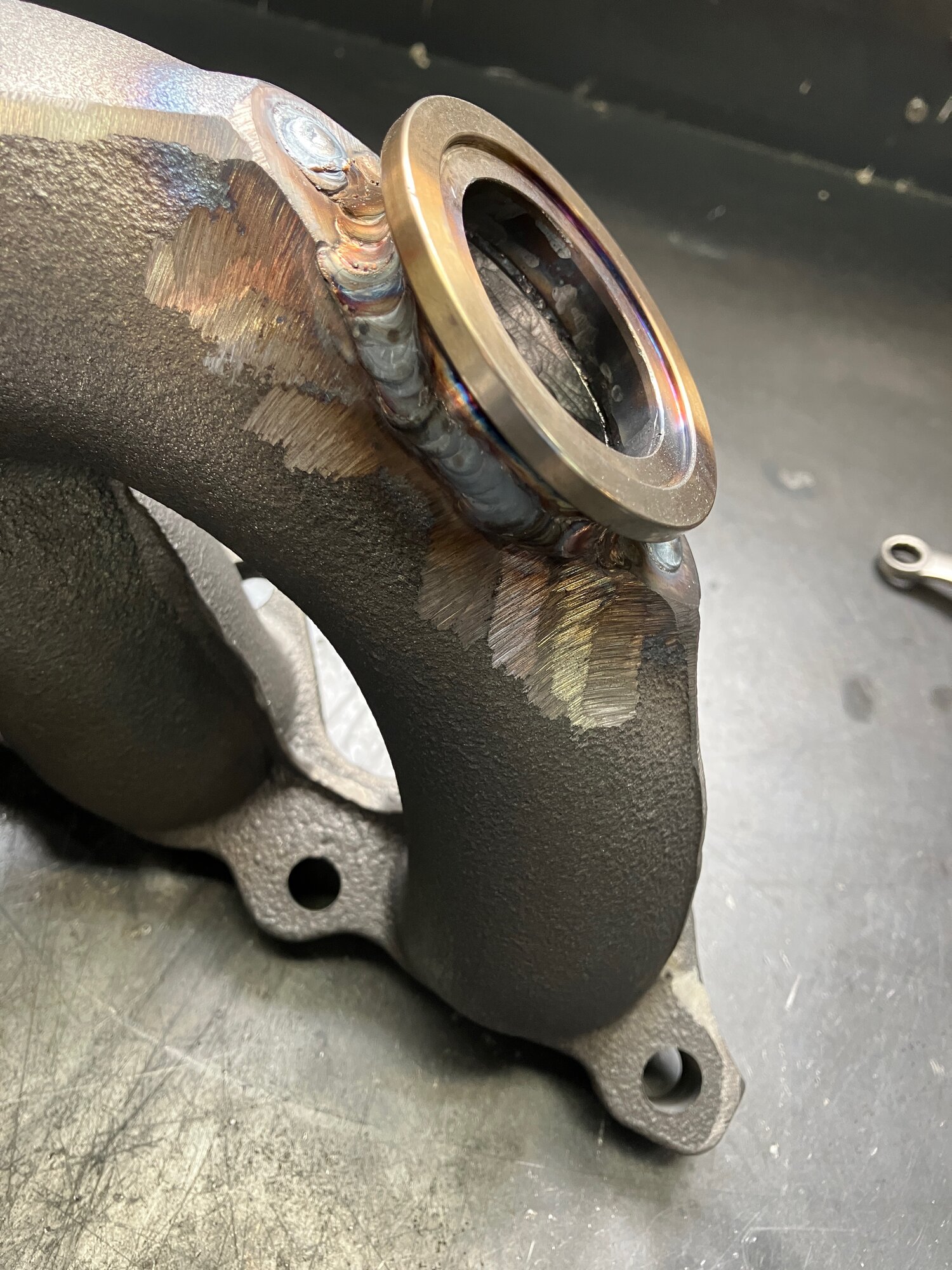

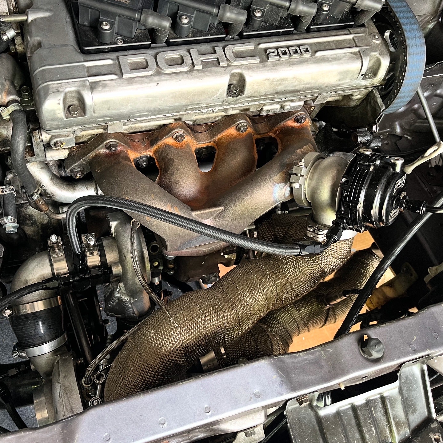

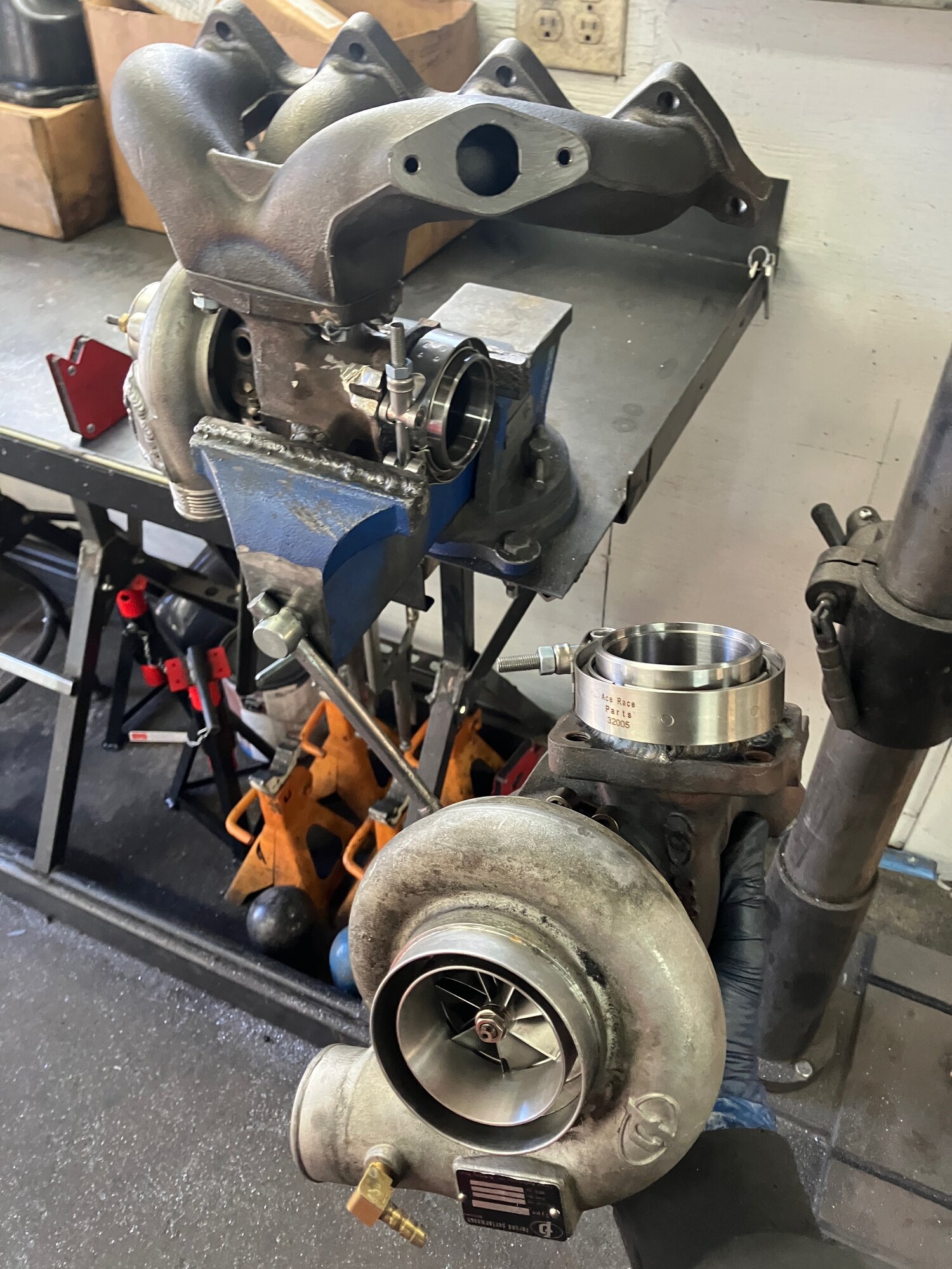

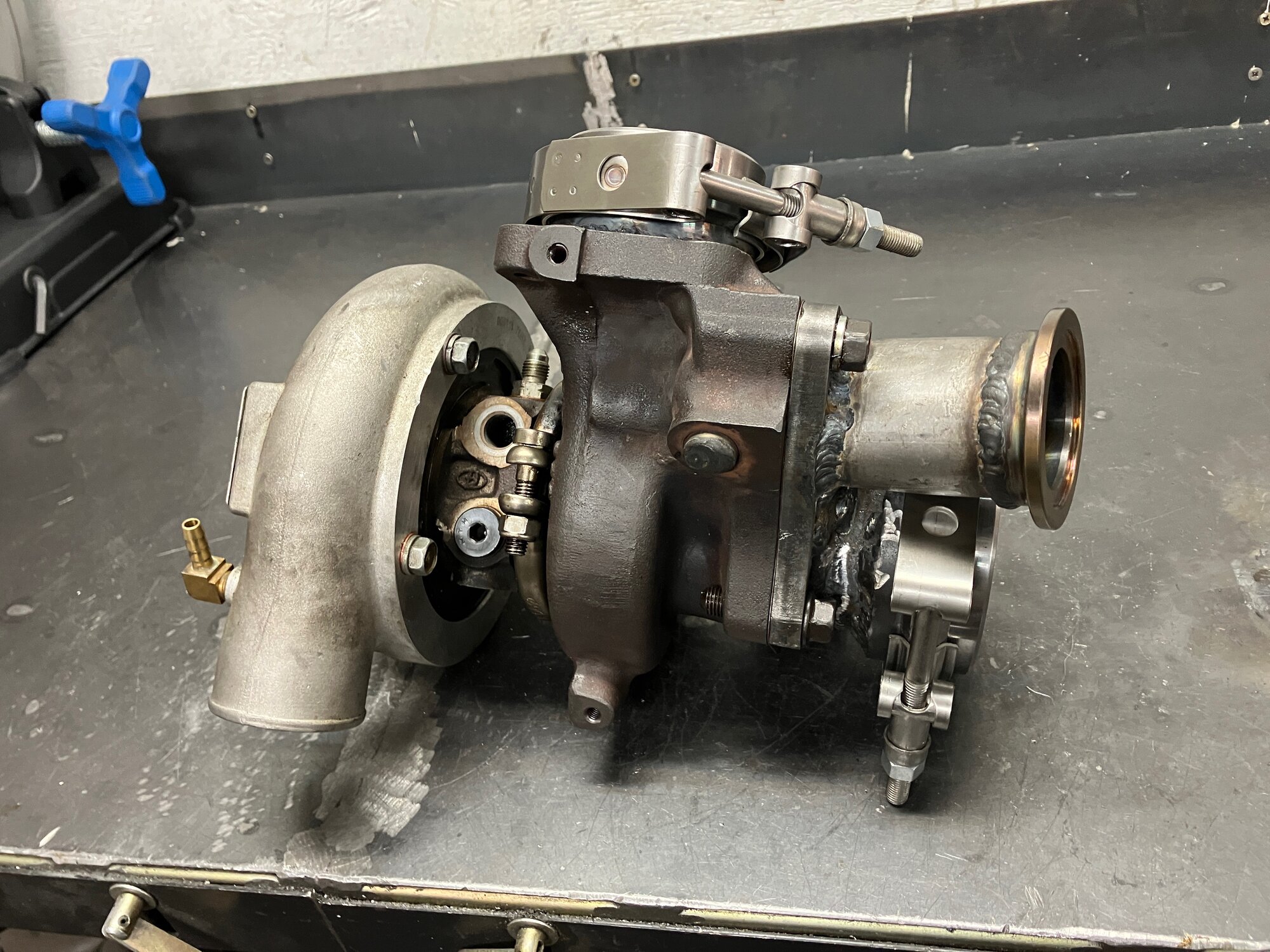

@biglady112 proposed the idea, and I decided I was down to give it a real shot. At first I was going to trade the FP Red UHF for a different combination of turbos, but @biglady112 actually proposed I keep the Red as the low pressure turbo, and he found a Volvo 13g in a Colorado junkyard for me to use as the high pressure turbo. I’m not actually seeking more horsepower, I just want it to hit sooner. I’m also aware that there are some more impressive turbos that would perform great, but frankly I just found this idea more entertaining 😂

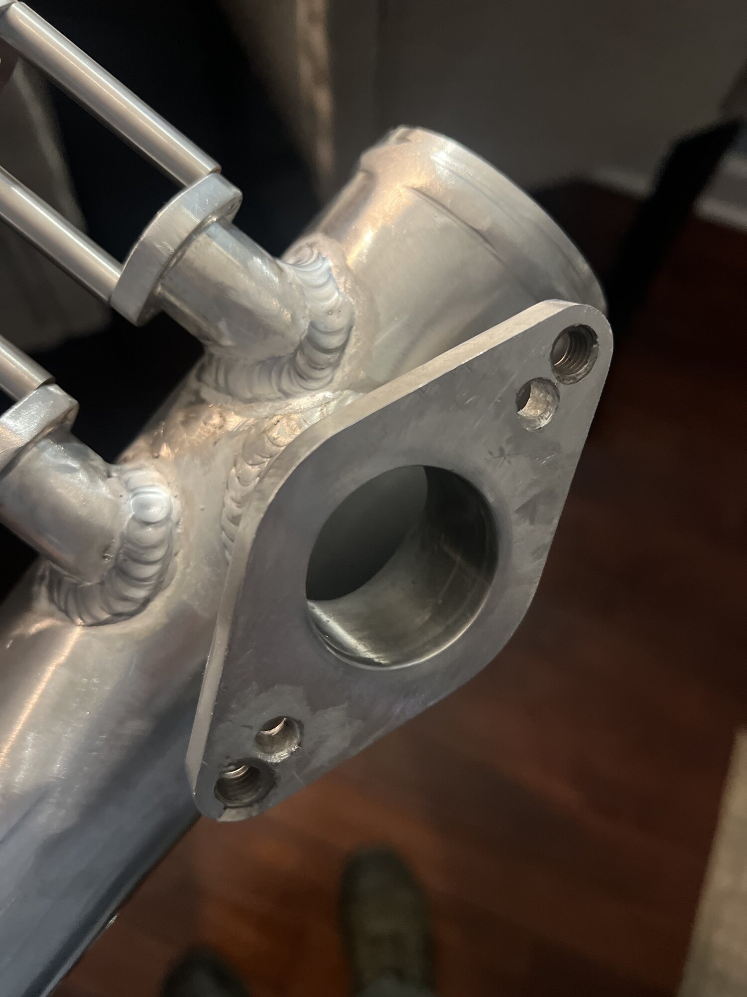

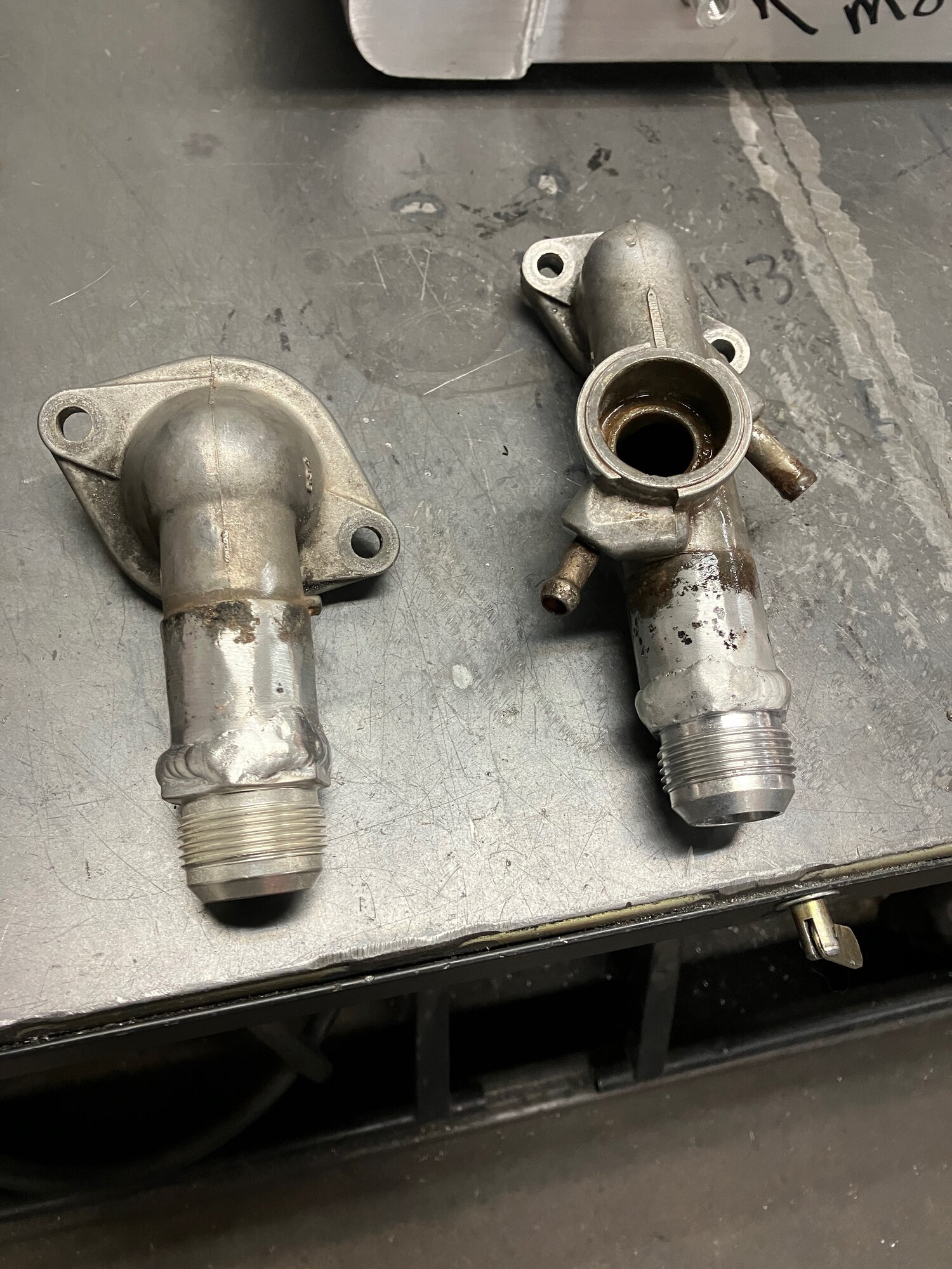

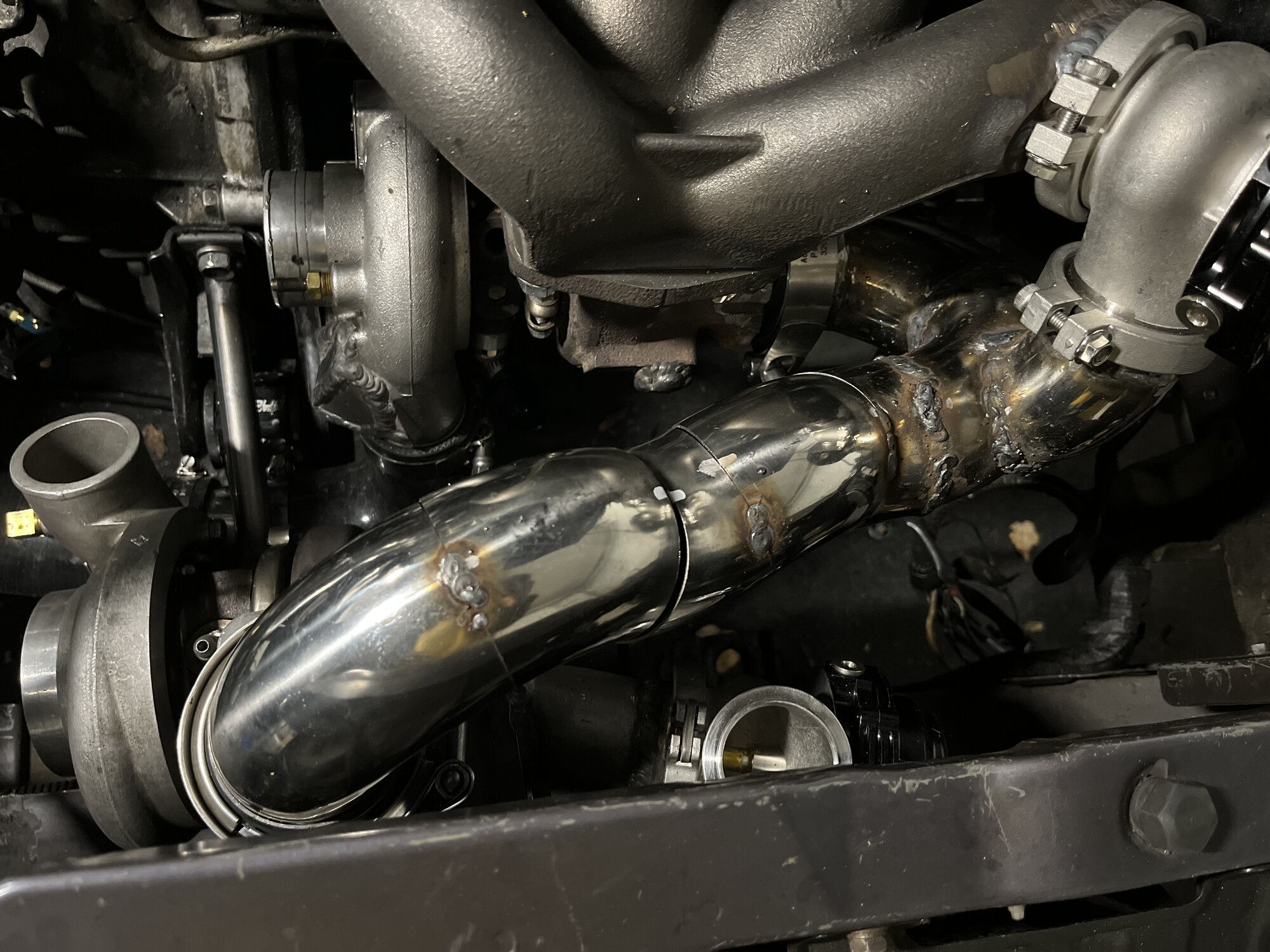

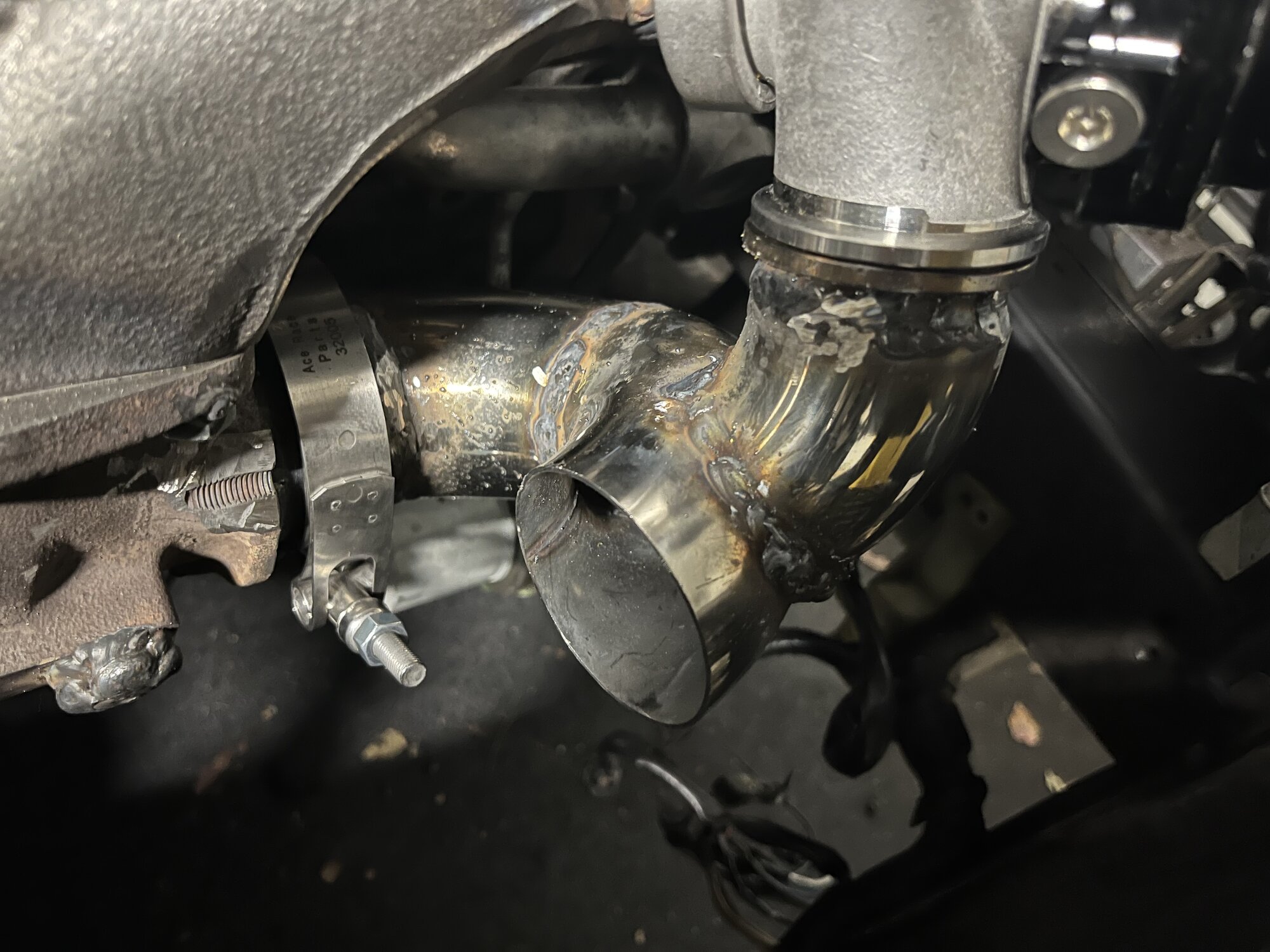

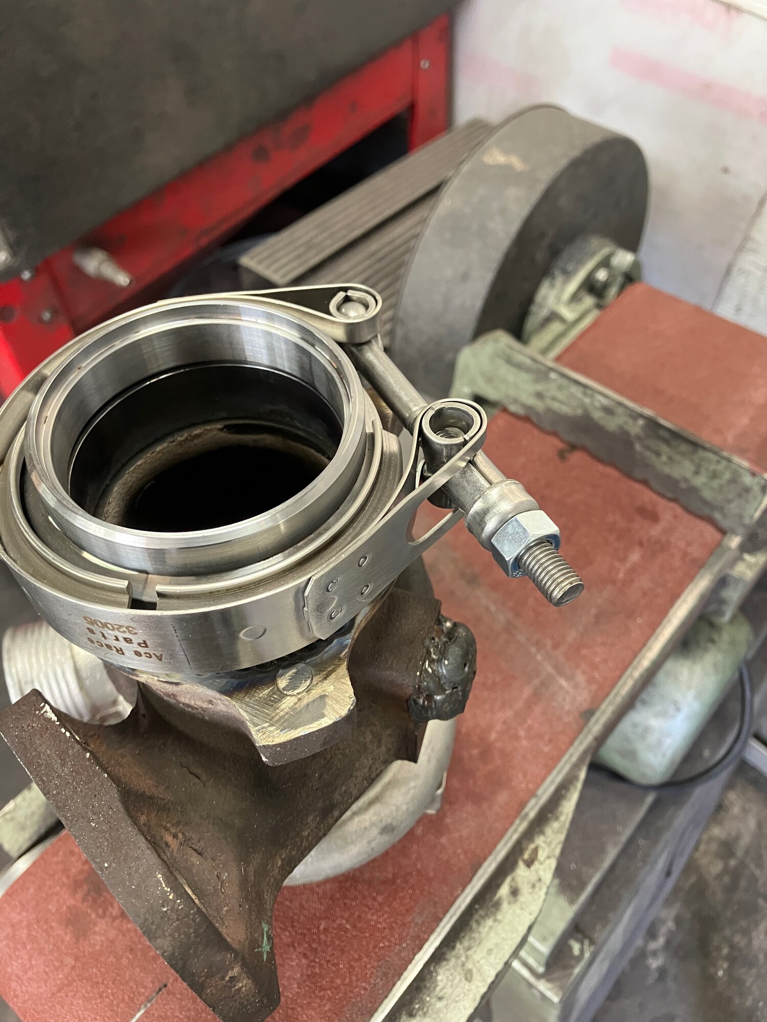

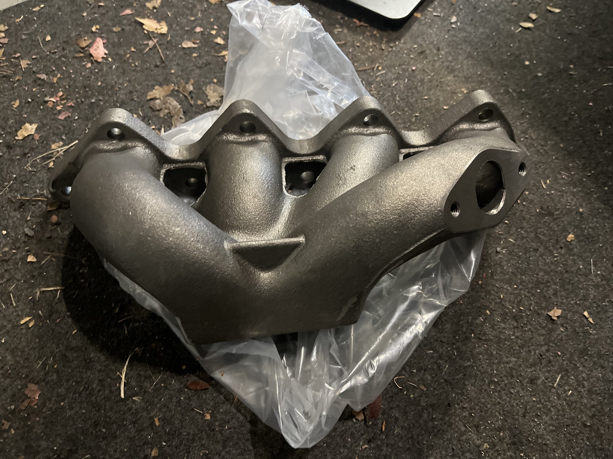

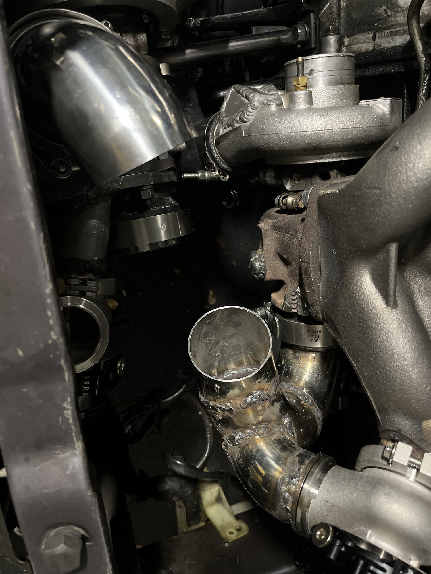

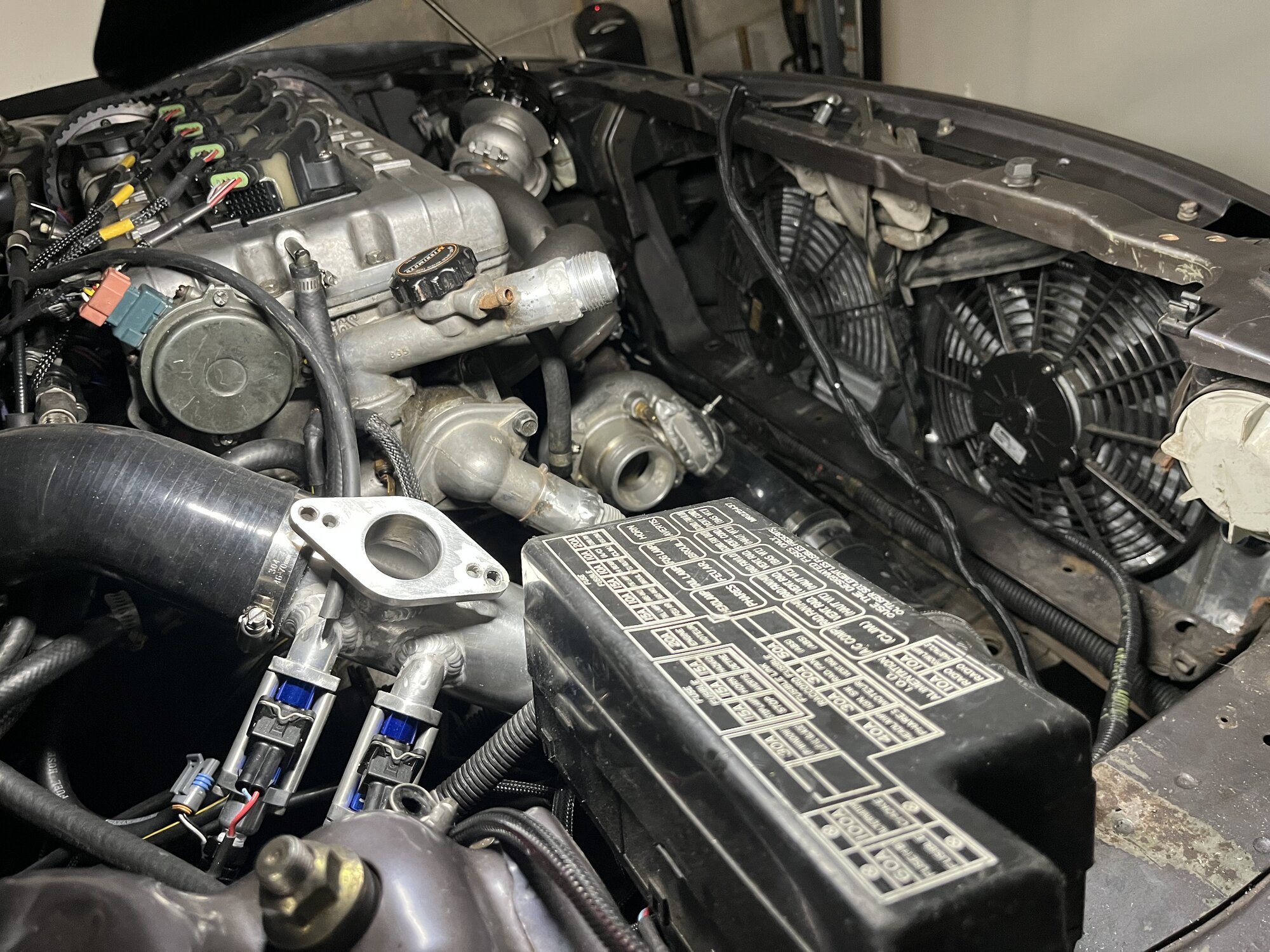

Anyway, he welded off the internal gate, and had me switch to a T3 manifold, which he welded a vband flange to for an external wastegate. He also welded vband flanges to the Red’s exhaust inlets and outlets to simplify things and give me a big head start.

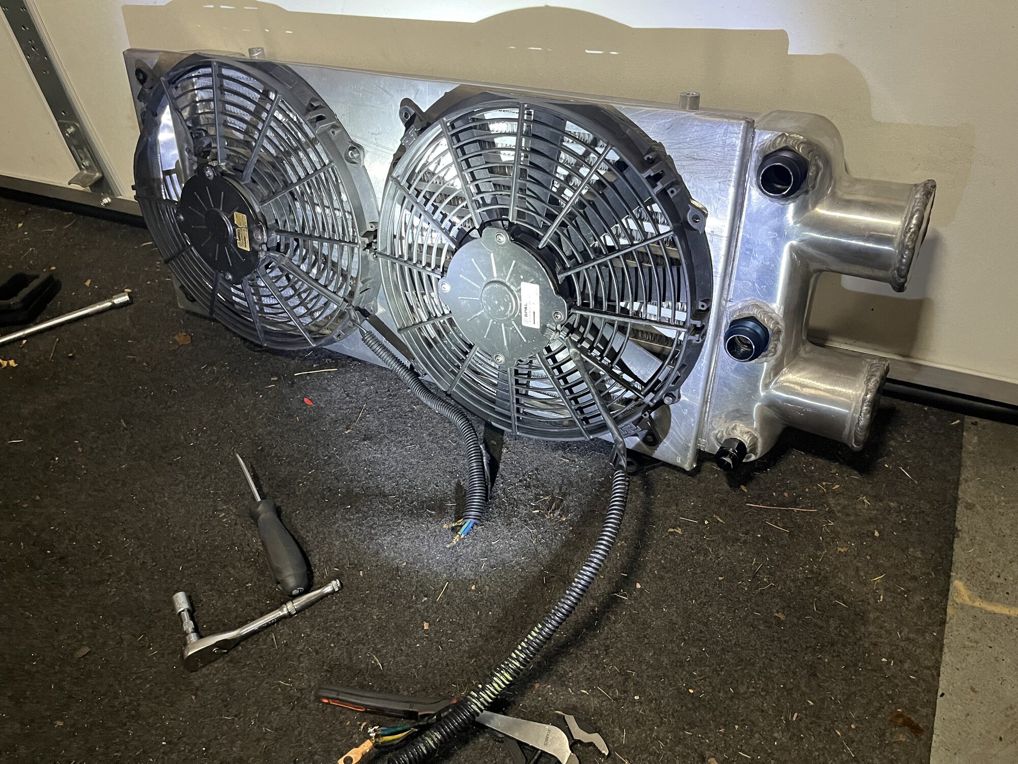

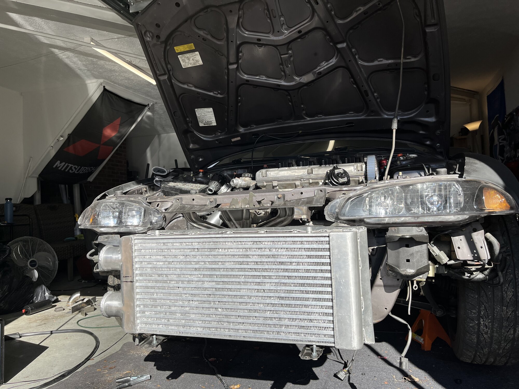

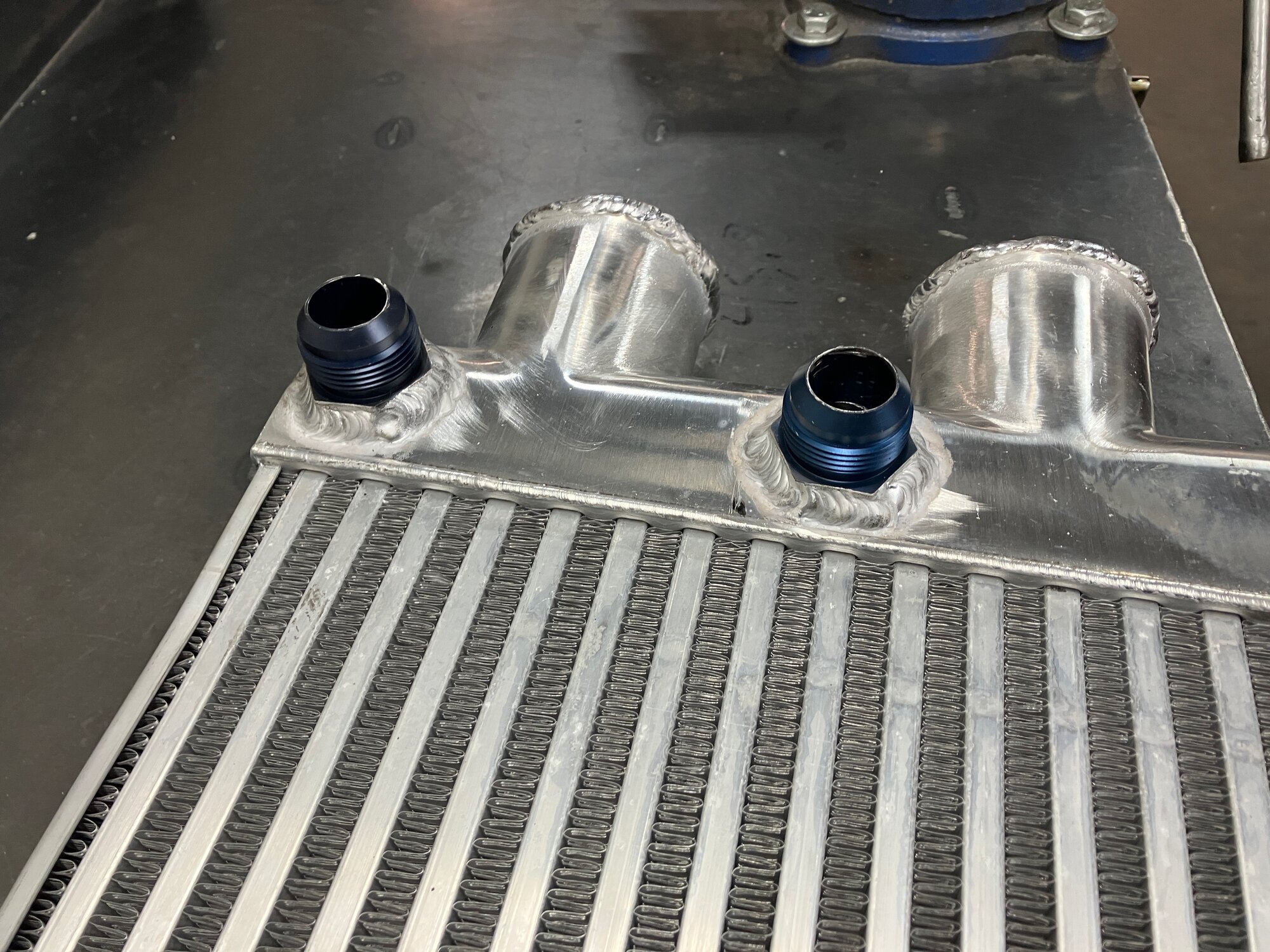

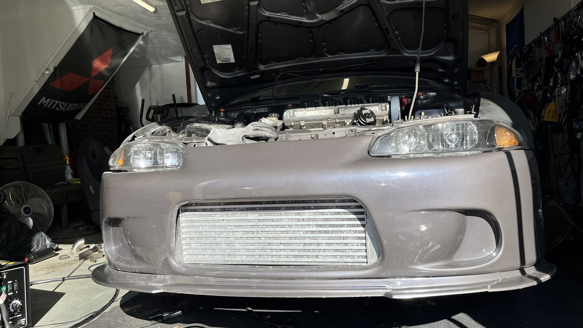

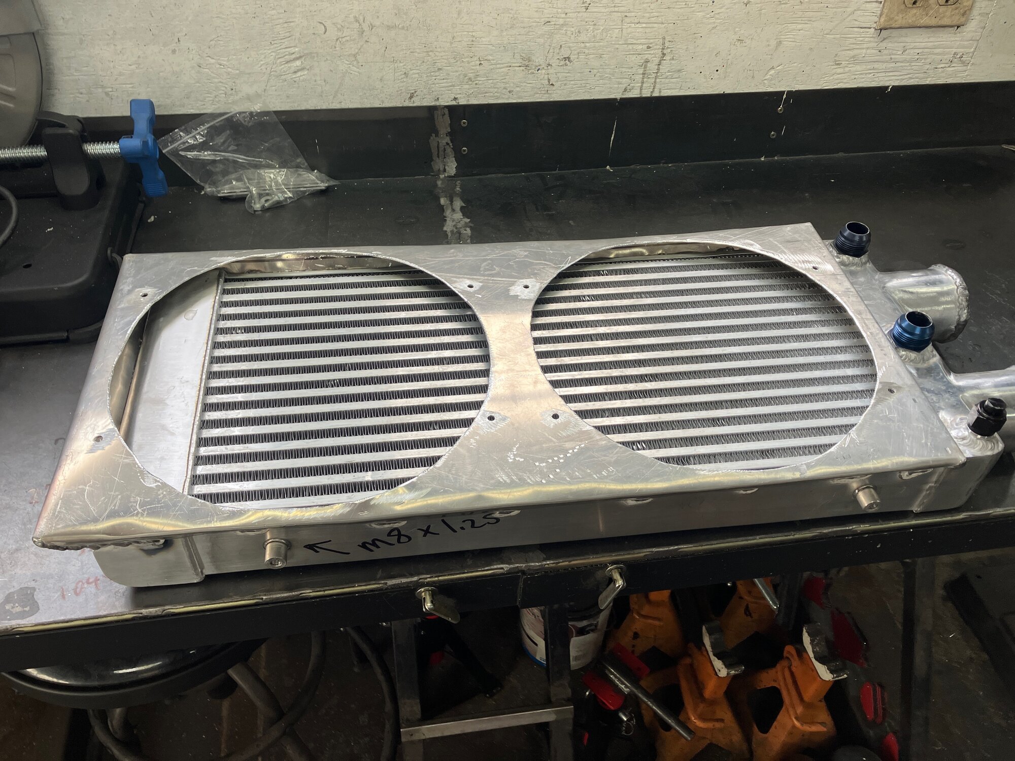

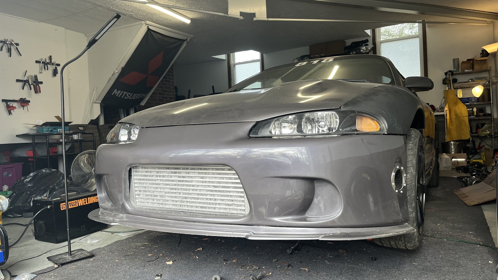

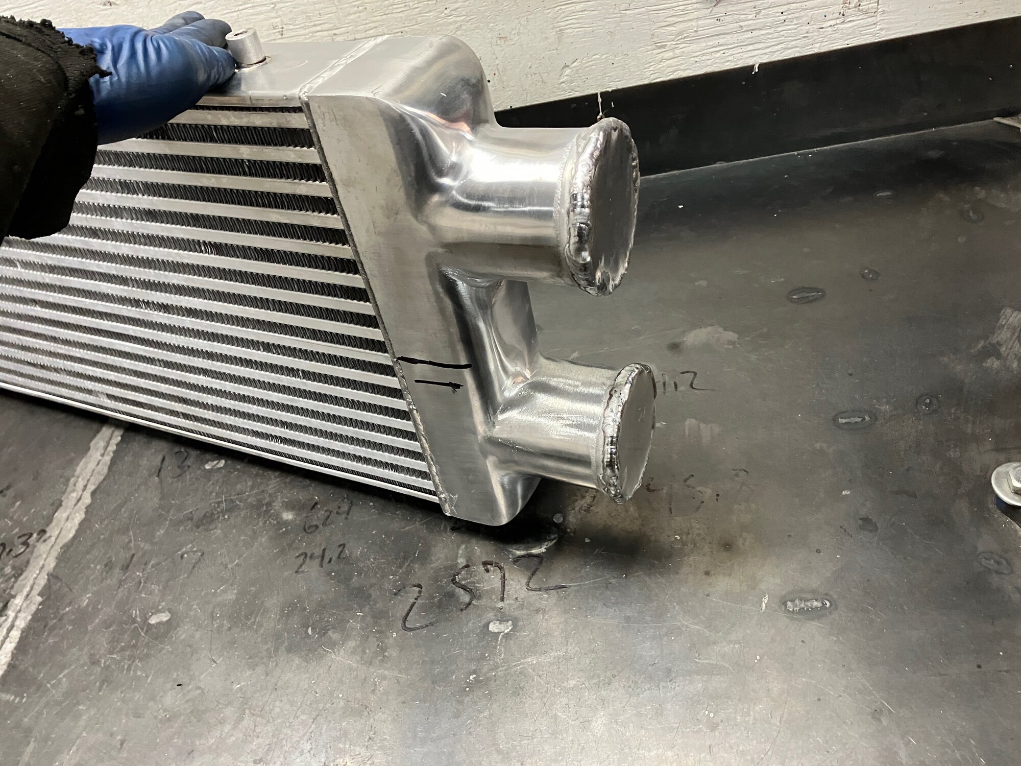

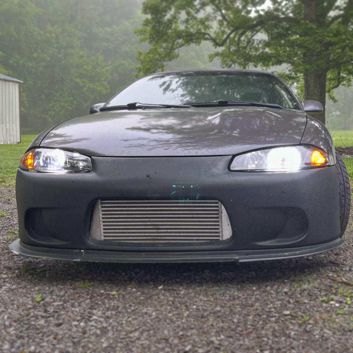

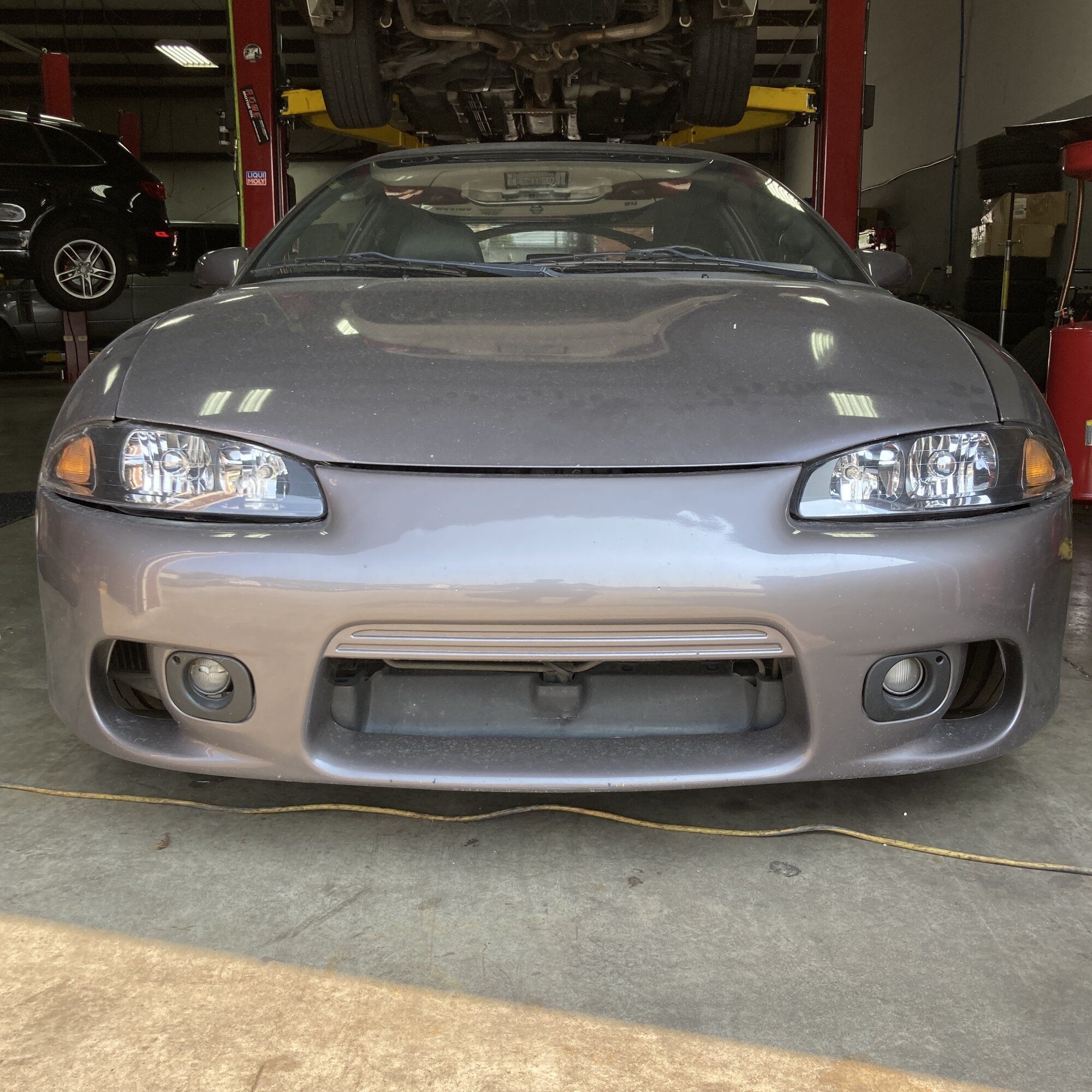

To make room for all this stuff, the radiator had to move. We discussed rear mounting it, but since I’m not running an Intercooler, I thought it would be cool if the radiator could fit further forward instead. He’s modified an Intercooler to perform as a radiator before, which he was graciously willing to do for me. I just had to figure out how to mount it, so that’s what we did.

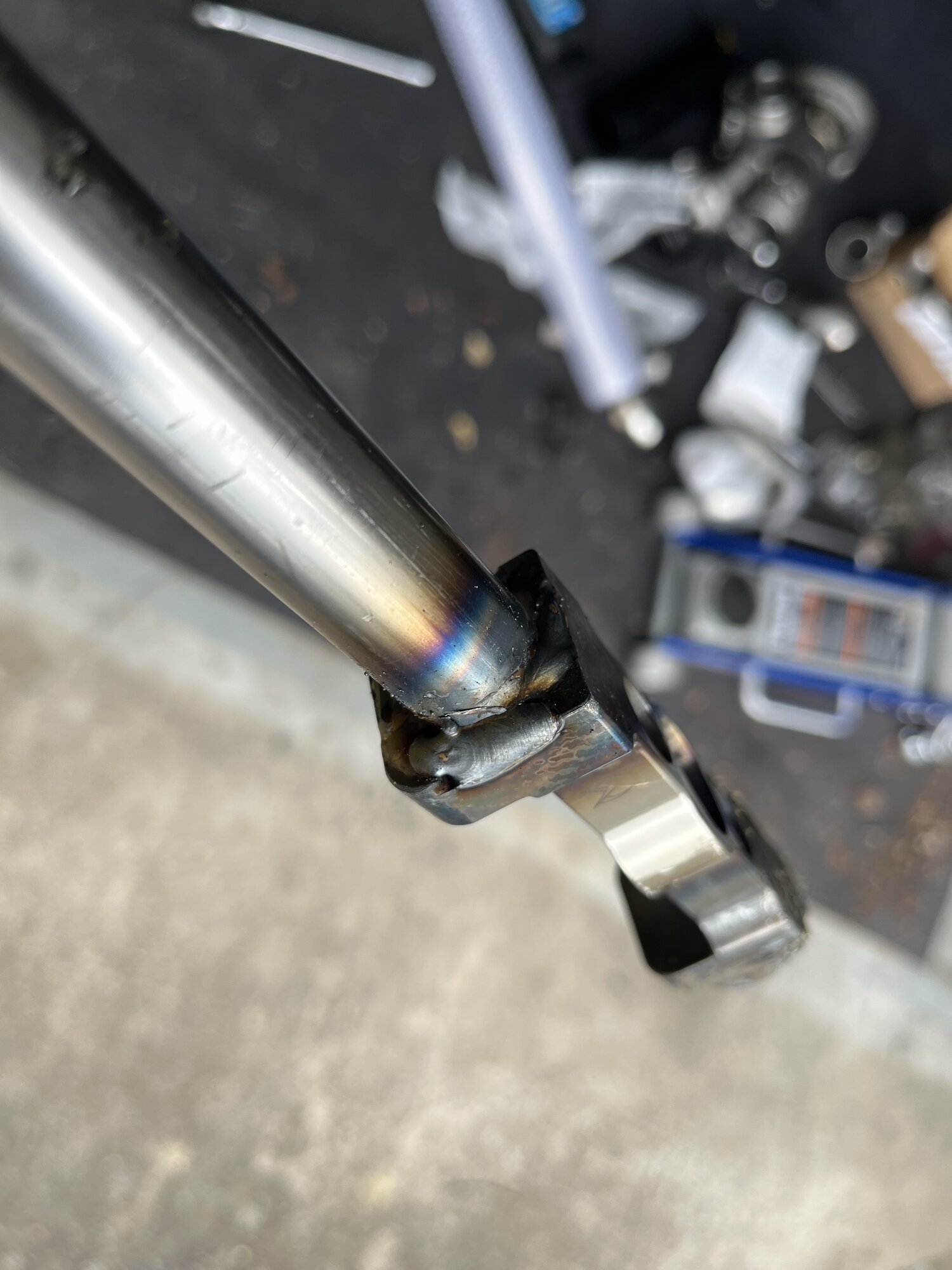

He sent all the stuff back, and I purchased a simple MIG welder. I had to learn to weld so I could build the piping, which felt super daunting at first, but it’s been a gamechanger for my mindset. I also had to weld a bracket for the FP Red to mount to, which I accomplished using a Maven mount. I think the spot I chose to mount it will make it easy to remove and service, easy for the 13g outlet to feed the Red inlet, and easy to build exhaust piping that utilizes the side exit cutout in my bumper.
I’ve still got a few more steps before it’s ready to fire up and test, but we’re getting close. I know I’m far from the first to do this, and chances are it’s going to have problems in its first iteration, but we’ll try and fix the weak points and get it dialed. Massive thanks to @biglady112 per usual for all his help. I wouldn’t be even attempting this without him.

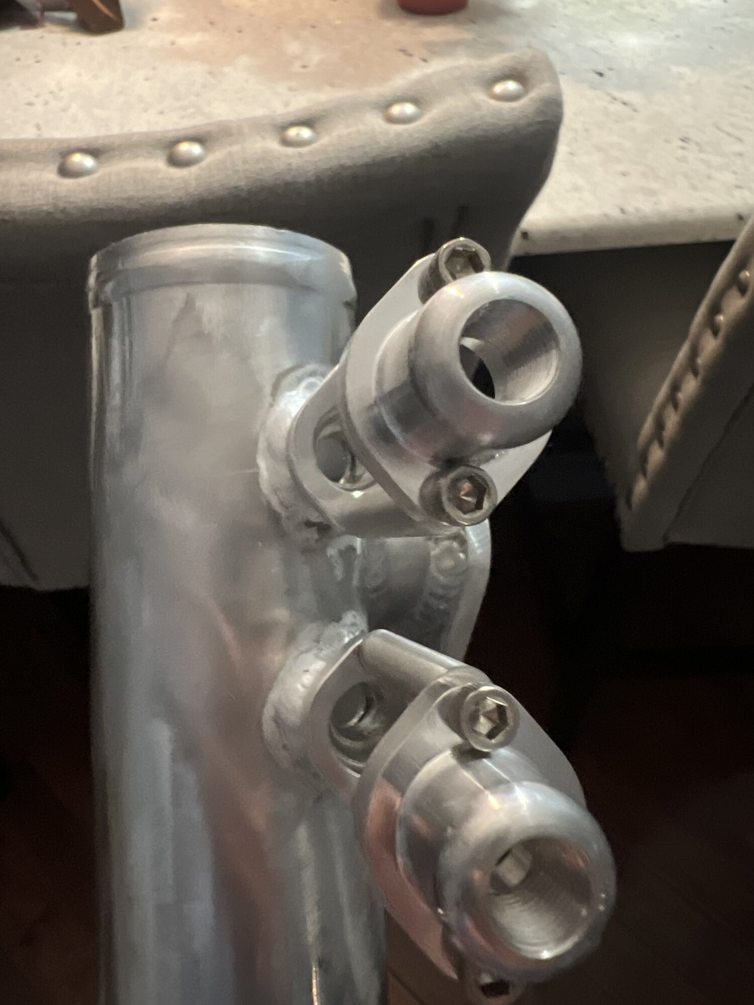

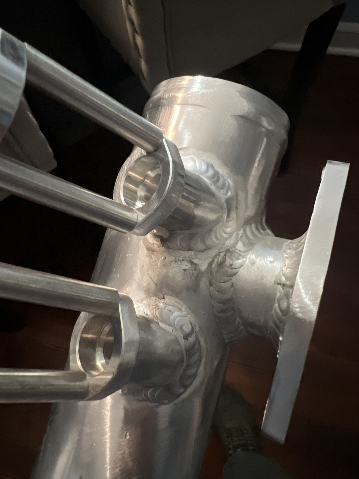

Alright… been nervous to share this one, as it may be a controversial modification, but it was a fun one.

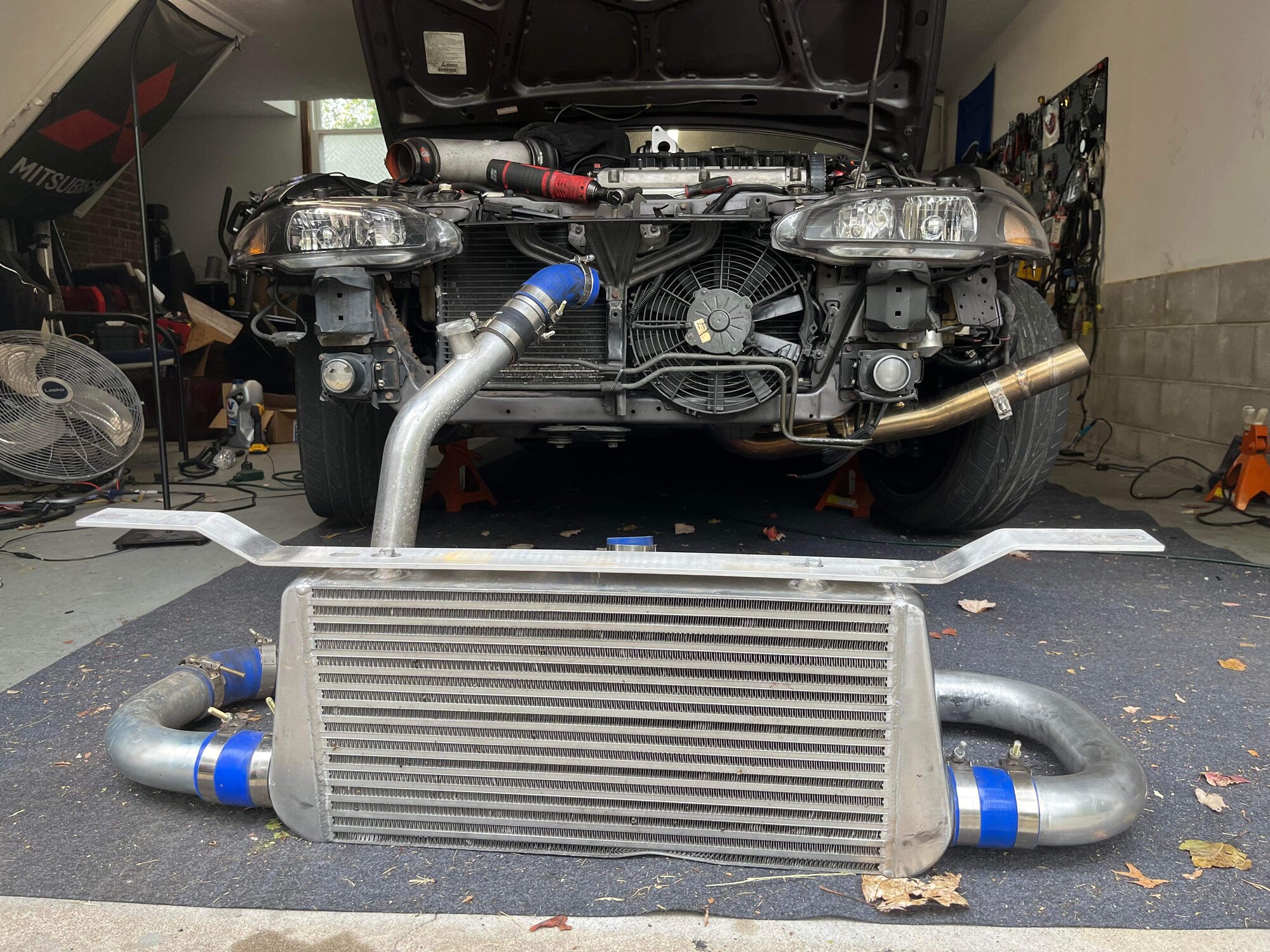

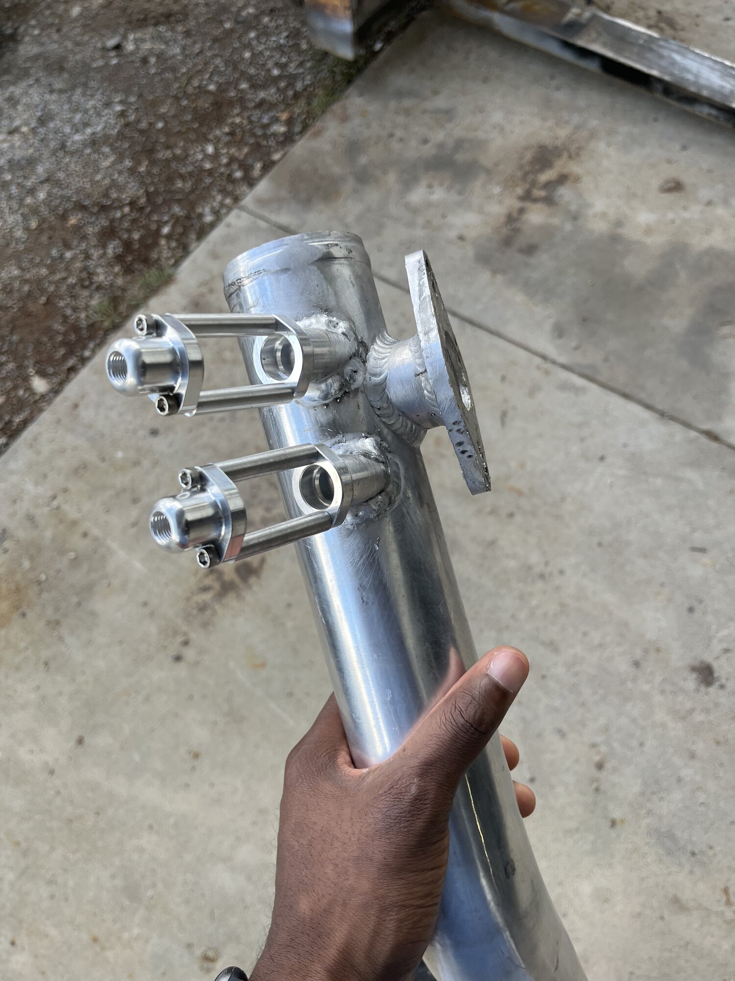

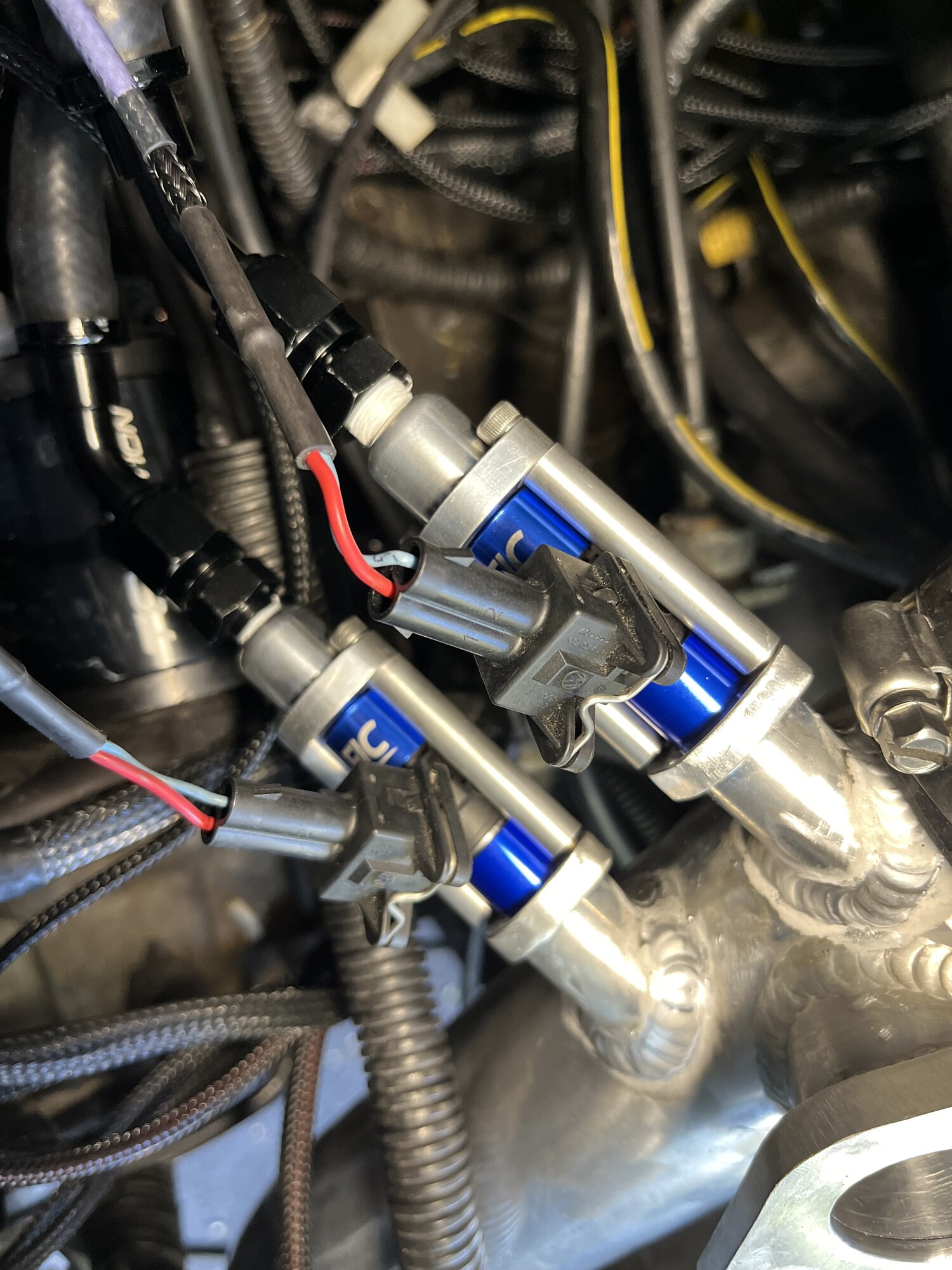

I deleted the intercooler, and I had a couple injector holders welded to the intake pipe. The FuelTech Universal B harness comes with extra outputs for secondary injectors, allowing a sort of plug and play deal, in my case for ethanol injection.
I hadn’t heard of this before, and was very skeptical about it at first, but I honestly love experimenting, so I was down. Water/methanol injection would probably be a viable alternative, but I already had a couple spare injectors from having to replace them in the past, and water/meth would involve adding another separate system to the setup. Unfortunately I can’t weld (yet), and the welding job I paid for wasn’t that great. Luckily, a friend of mine had me ship the piece to him. He got it cleaned up, then shipped it back to me. I expanded the fuel system with a T-fitting going off the FPR and splitting off into a couple extra AN lines.
I got everything put together, and I rigged the secondary injectors to start spraying when the car hits boost. It was a little weird tweaking two fuel maps to complement one another, but pretty cool. Still experimenting a bit with it, but so far so good. Still much more to update on.
VW fuel injector pig tails work on the DSM ?

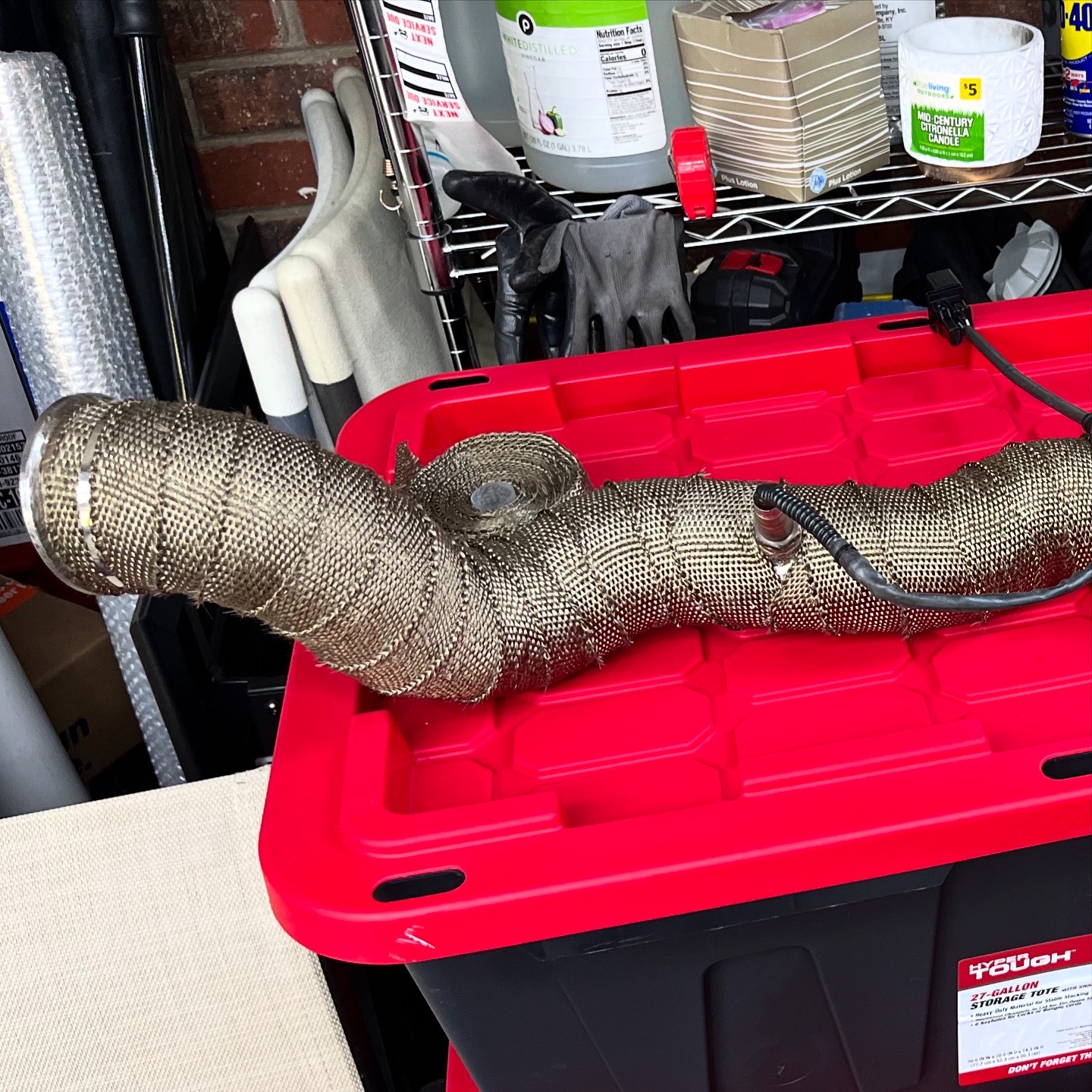

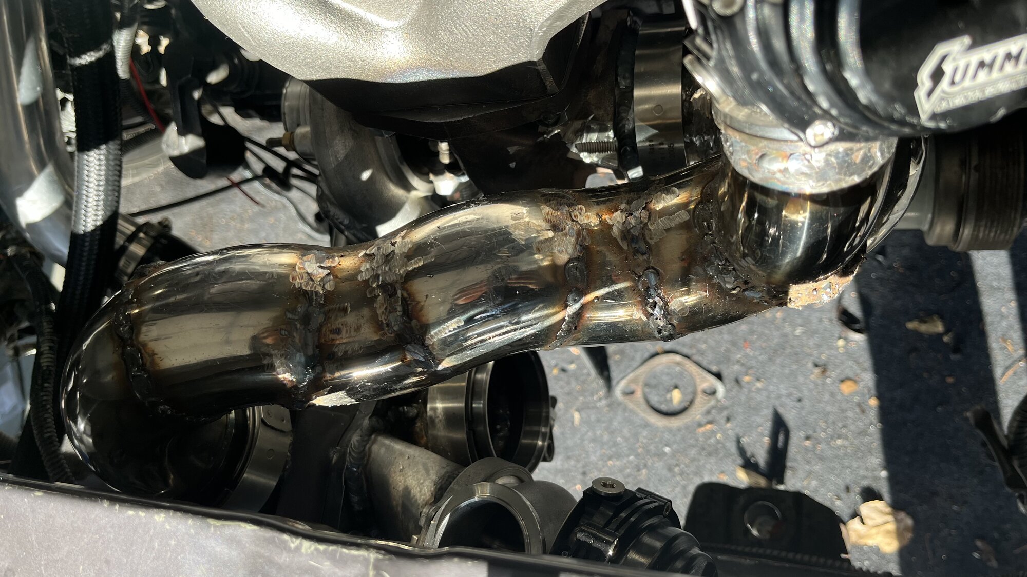

I've gotten pretty accommodated with my new MIG welder lately. Already wishing I just went for a TIG welder, but c’est la vie LOL

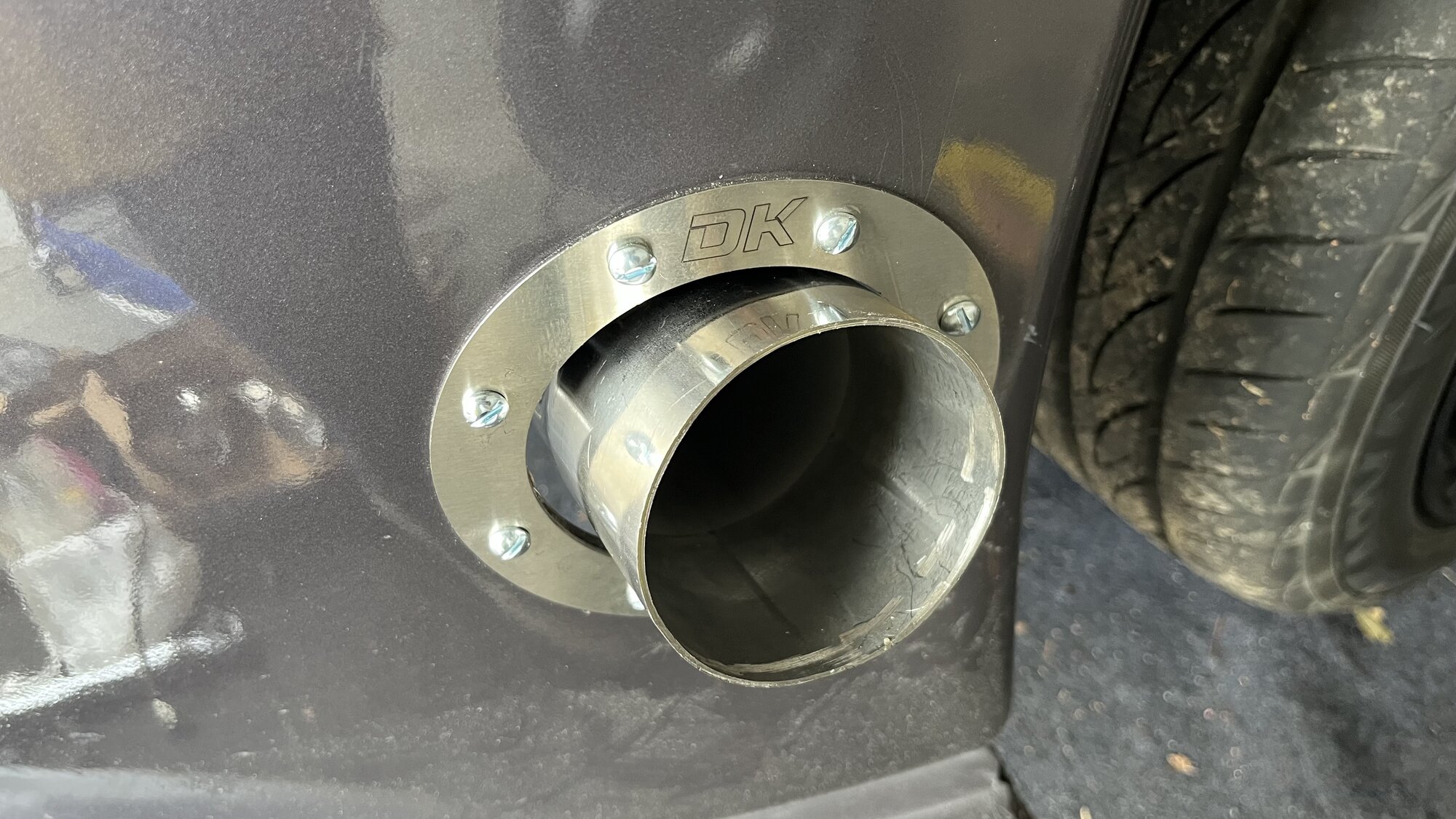

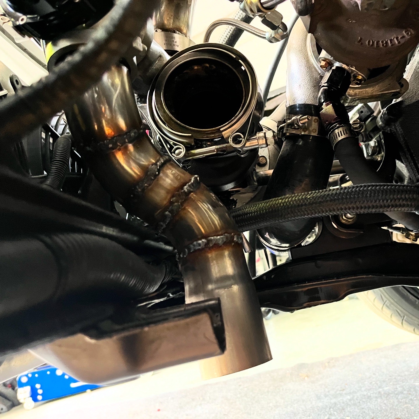

I’ve had to go back over most of my welds, but I think I’m getting the hang of it all. I was able to weld my new exhaust utilizing the side exit hole in the bumper that I already cut last year. Also handling all the little details that need to come together for the car to run again.

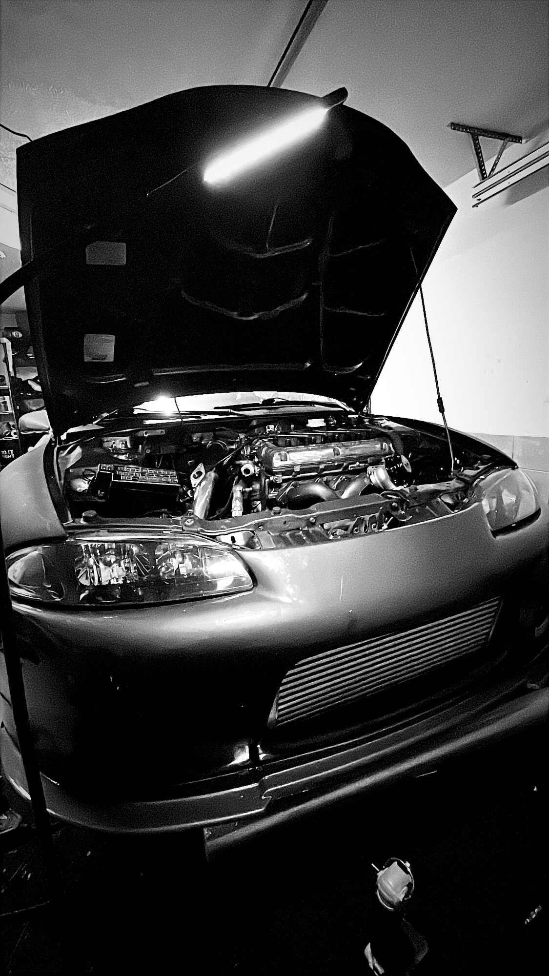

This thing is going to be far from perfect, but I’m getting pretty stoked about the first running iteration of this project.

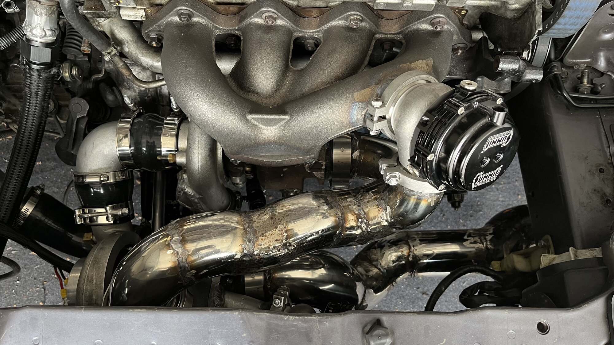

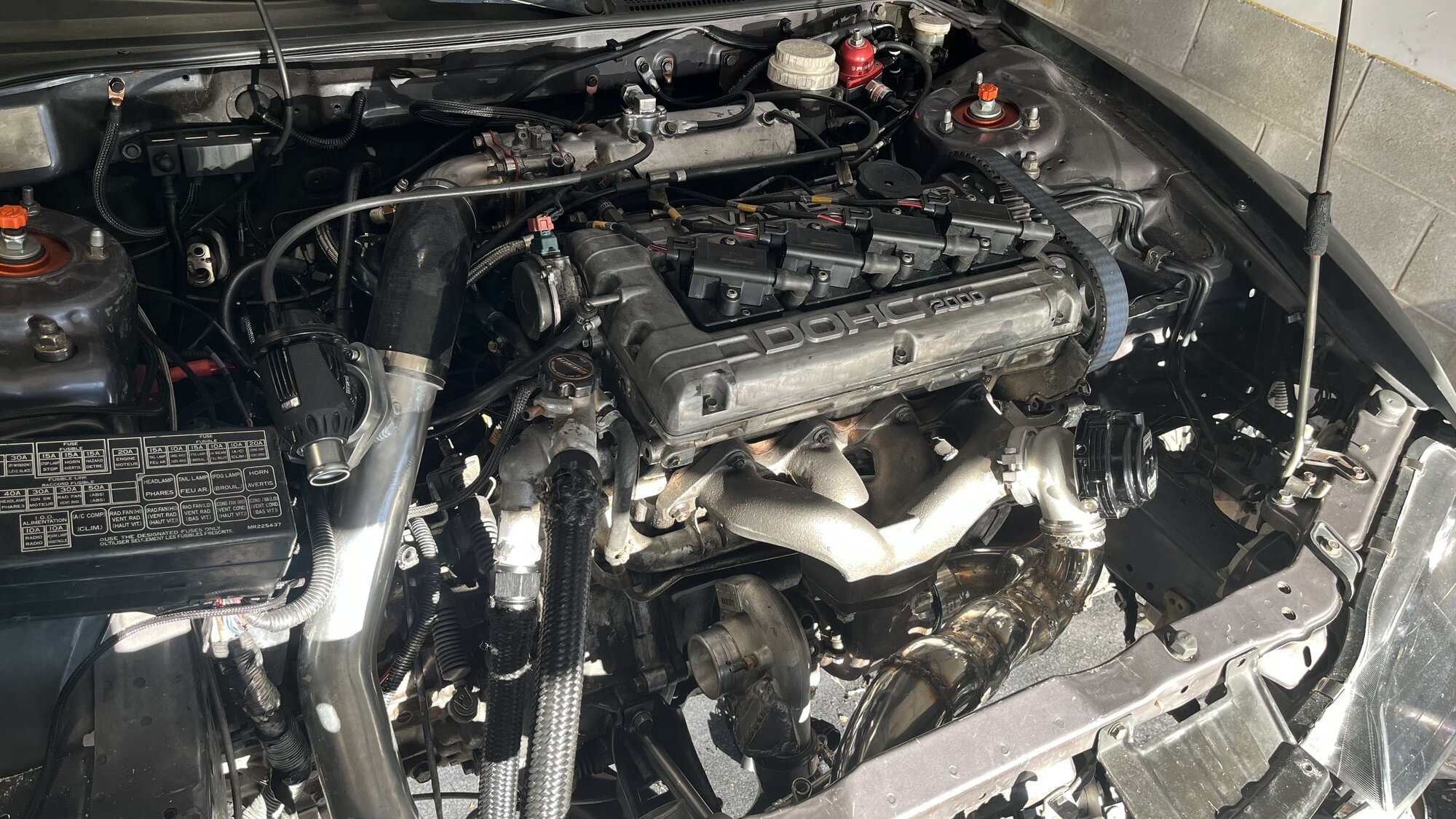

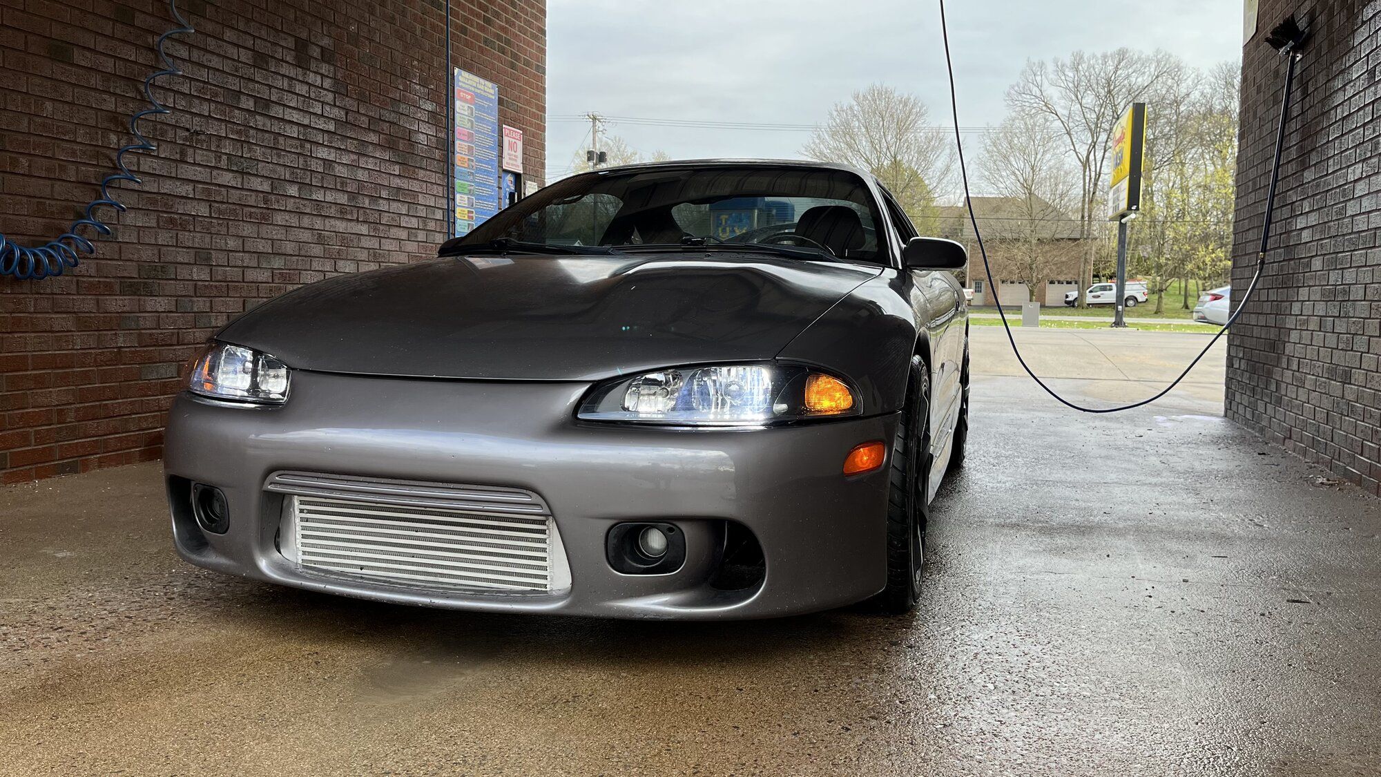

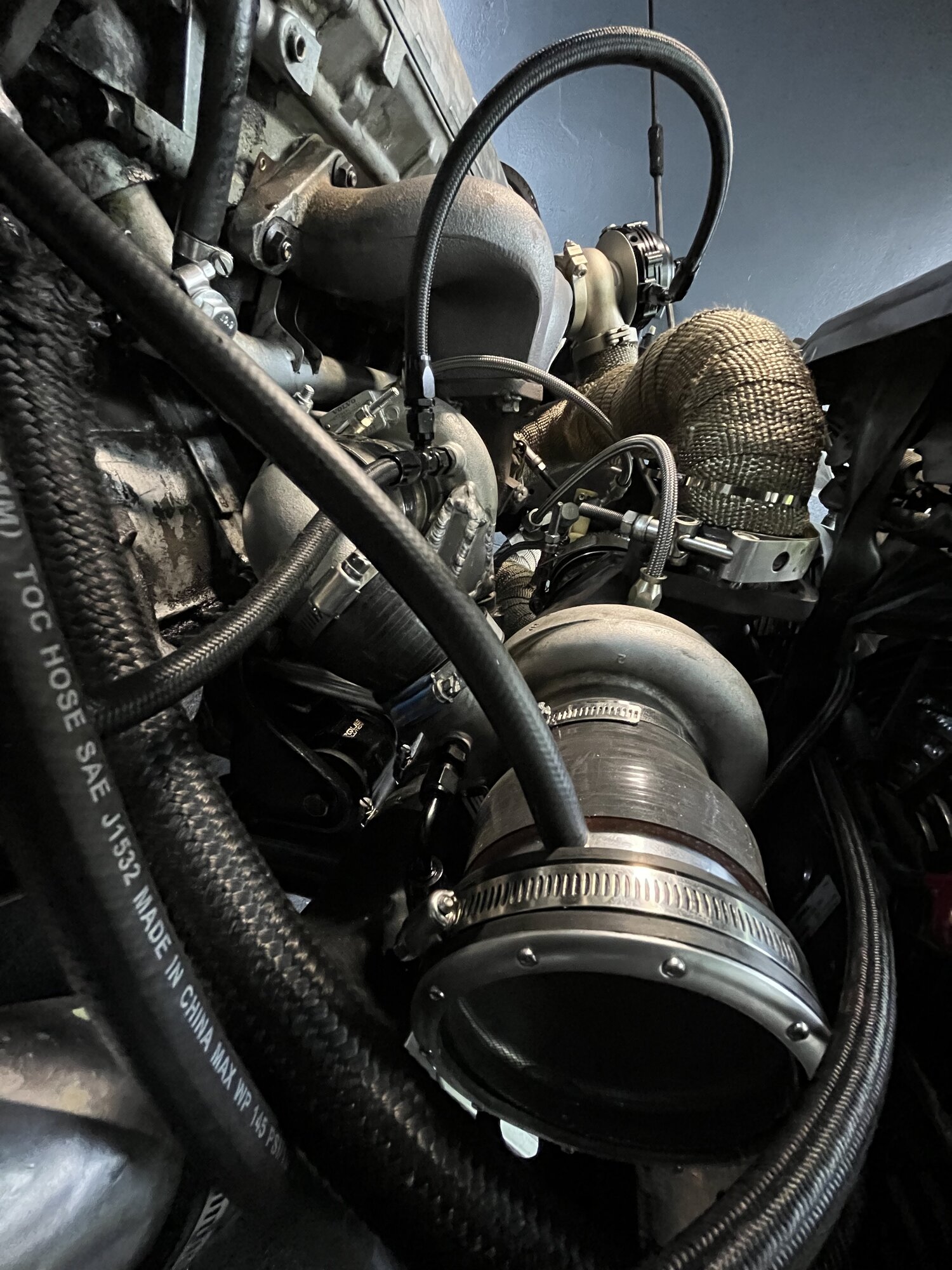

It's finally running! I seriously wasn't sure if I could actually get it to this point, so I'm stoked that we're here.

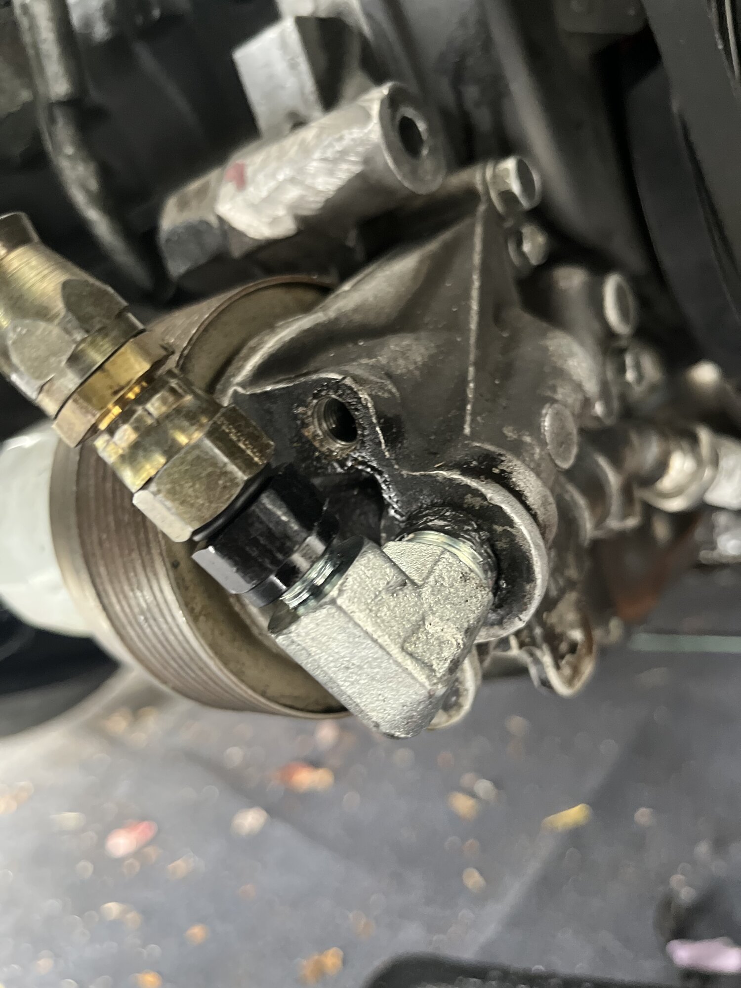

Plumbed the oil feed and return lines. Switched the oil feed from the head to the oil filter housing, where it should have been feeding from before anyway given that I was already running a journal bearing turbo, and now I’ll be running two.
I welded a dump tube for the second wastegate and a bung for the wideband’s O2 sensor.
It’s not ready to drive yet. Need to address a few leaks, rig up the boost controller, and make sure all the little things are in their rightful place before taking it to the streets. @biglady112 has been super responsive to all my questions about the quirky nuances of this setup. We’re very close to the really fun stuff, which seems to be right around the corner.
Finally got around to that fuel pump rewire. I also got the controller for the Volvo EPS working. It was just grounded improperly -_- Basically not grounded at all.

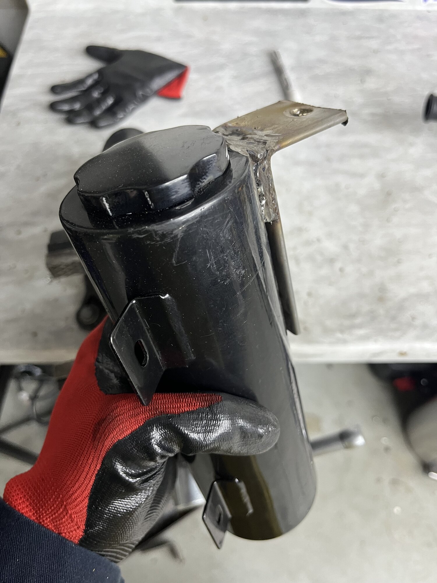

Anyway, @biglady112 found me a pretty neat coolant overflow reservoir that he sent back with the other stuff for me to figure out how to mount to the car, and I finally got that taken care of as well.
I also touched up the exhaust pipes, and modified the wastegate dump tube so it’s pointing straight down. I had to pull the wastegate housings to install the fire rings since I’d missed that step. I wrapped the exhaust pipes with titanium heat wrap. When doing a boost leak test, I sprayed what I was pretty sure at the time was soapy water on the turbo manifold to check for leaks, but now it's rusting a bit, so I'm afraid it was something else -_- Got to figure out how to clean that, 'cause it's kind of an eye-sore now.
Did a ton of assembling, disassembling, and reassembling to address leaks and to troubleshoot other fickle little issues. Extremely tiring work. But then finally, I was able to take it for a spin, and WOW, was it all worth it.
The sound of the turbos alone is incredible. They’re whistling before it even gets into boost. When it hits positive manifold pressure, it sounds like a jet. The responsiveness of the throttle input is pretty much instantaneous. On just the 15psi of wastegate pressure, I’m beyond satisfied. We are going to push it a bit, but I’m genuinely considering leaving the boost pretty low because it’s already just so sufficient in its performance.
The boost creep from last year is gone. The car now reaches full boost by 4500 RPM’s, and starts building it by 3k RPM’s.
The heat wrap on the exhaust pipes is smoking a bit, presumably because it’s new, and probably also because of some residual grime on the pipes and my gloves. Hopefully it will stop after a little while. I really want a vented hood, but I don’t see that happening soon, so I’m actually considering cutting up my stock hood a bit.
Nonetheless, the water temp is very controlled by that intercooler repurposed as the radiator. The setup is extremely efficient. I think with a bit more testing and experimentation, we can minimize the risks and optimize the benefits. It’s truly incredible.

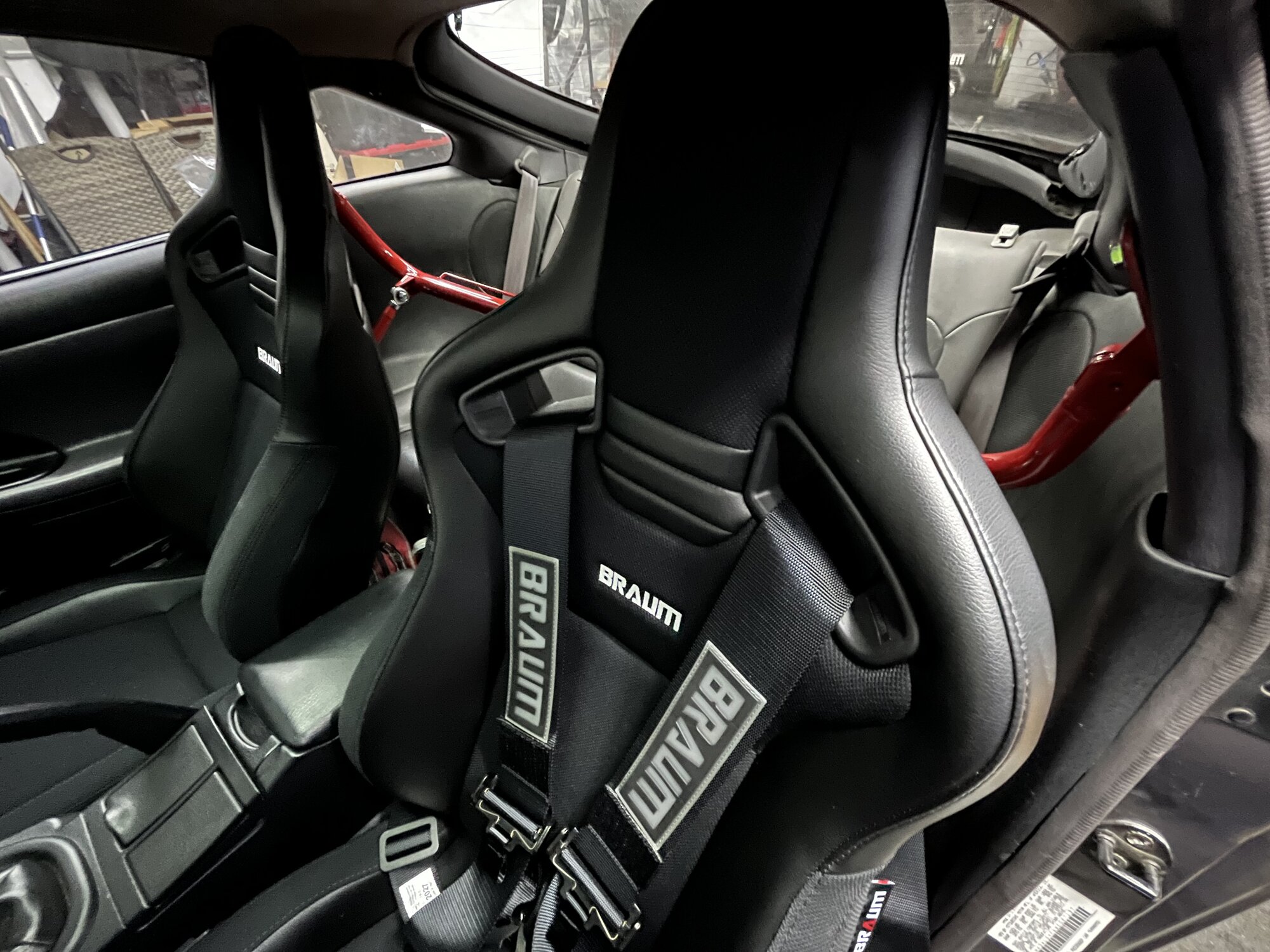

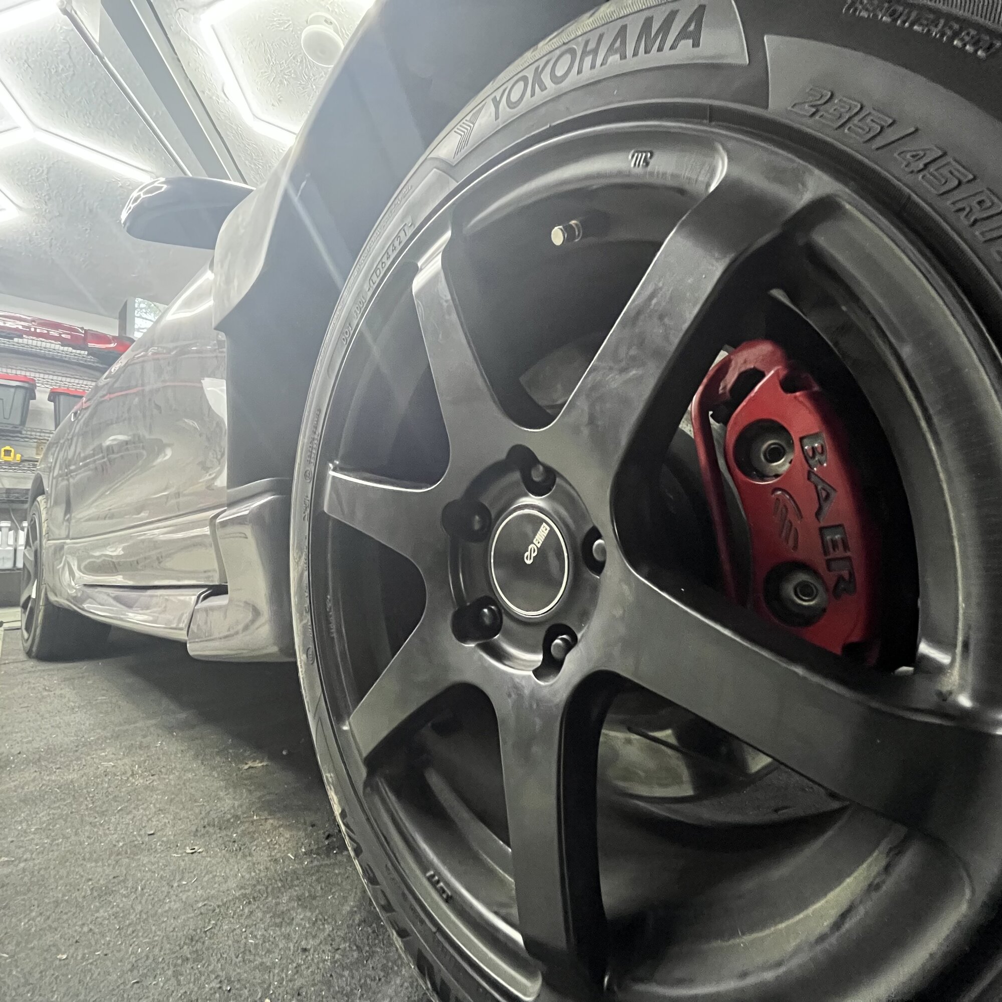

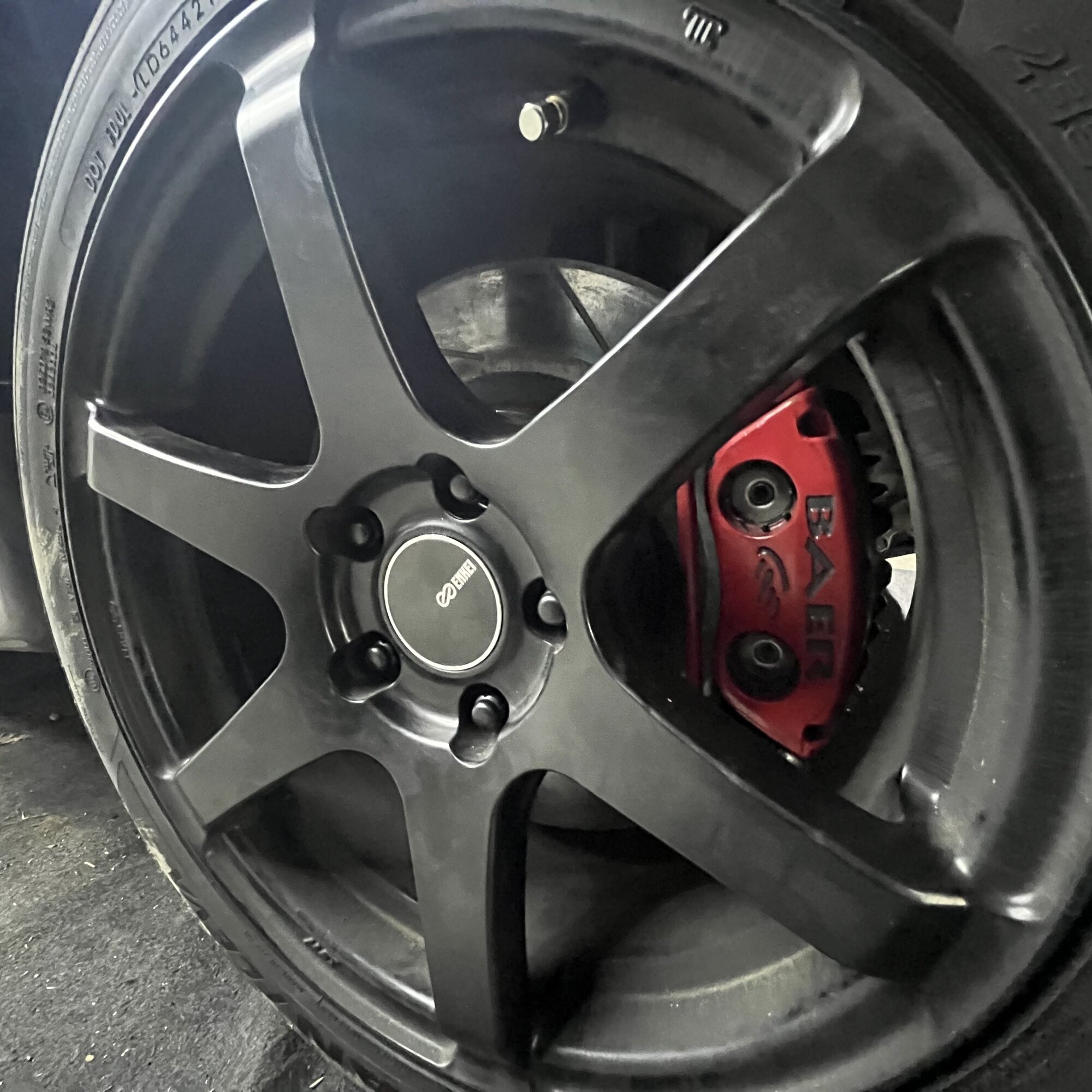

I got to installing the Baer BBK that @jdxnc used to run on his car, which was a great addition. Thanks again to him for selling me those.

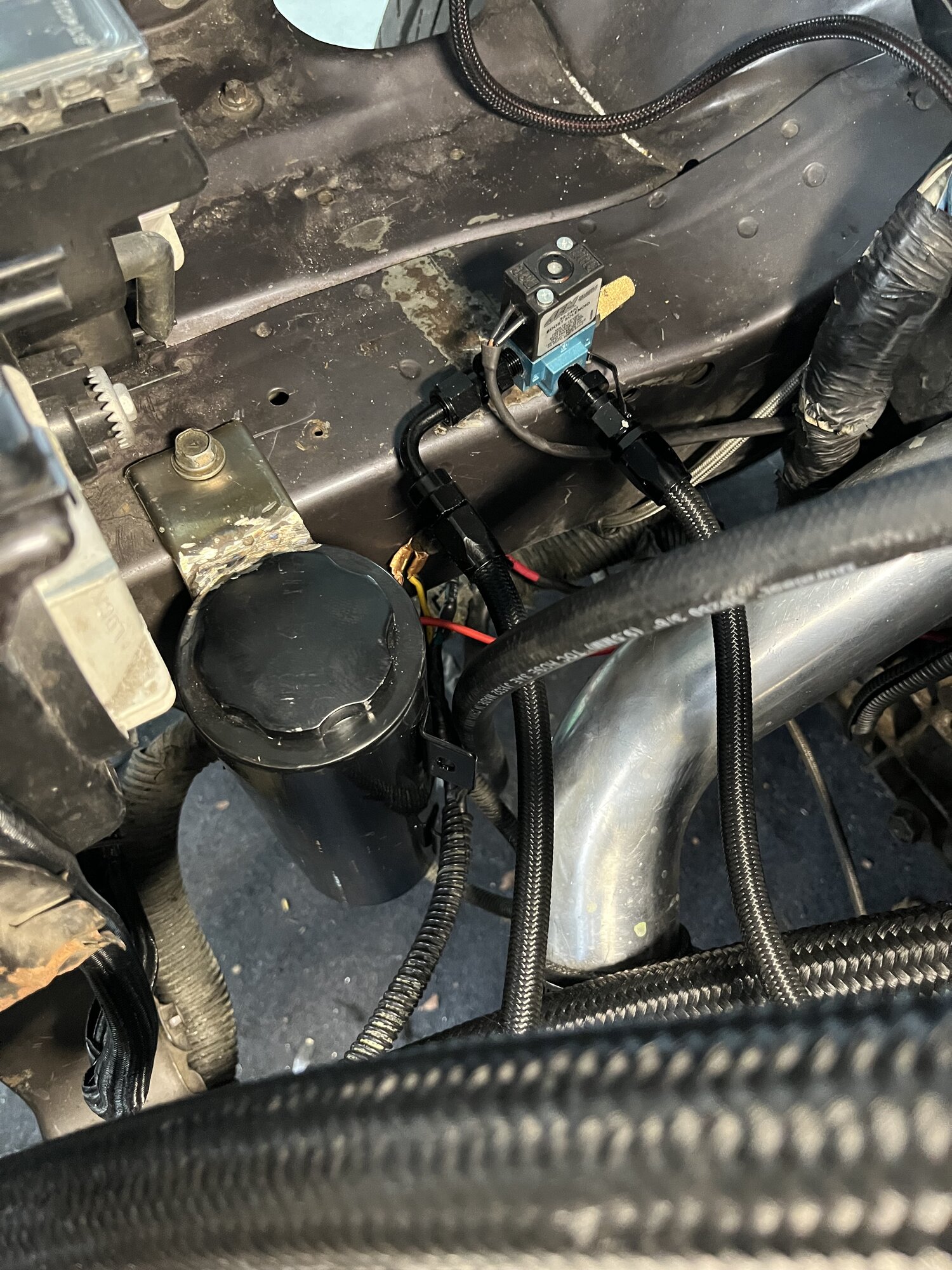

I also put together a little turbo filter setup, with a pipe tapped to provide suction for my sealed catch-can setup. Needs to be refined a bit, but the pics capture the idea.

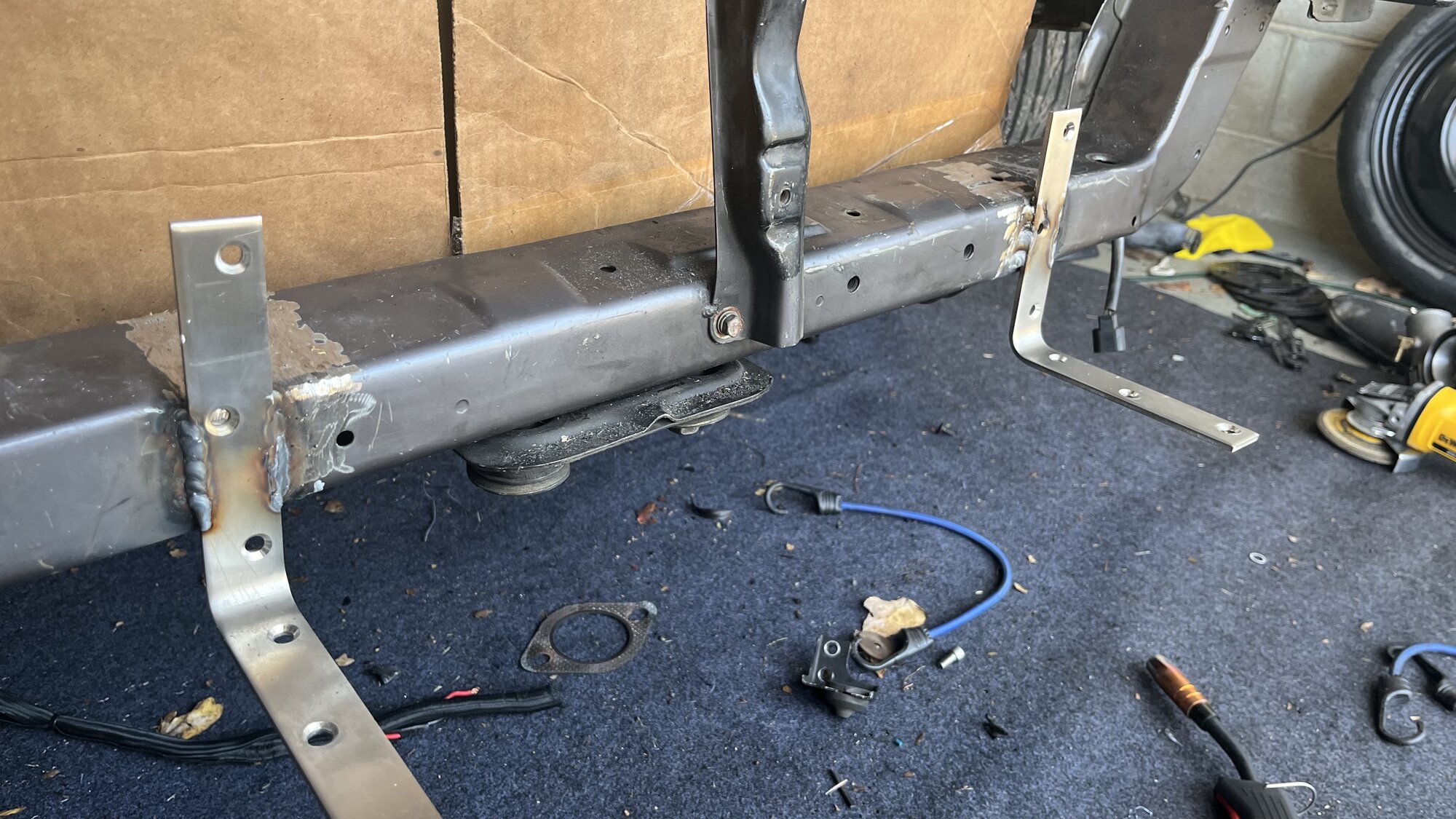

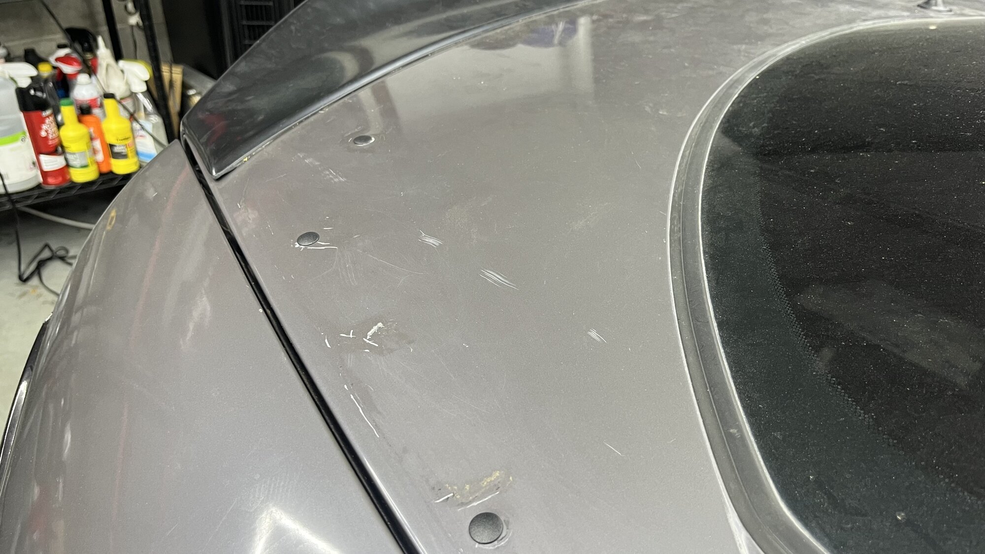

Installed a harness bar. Plugged the spoiler holes. Sorted out everything I could to get back to actually driving. Car feels incredible.

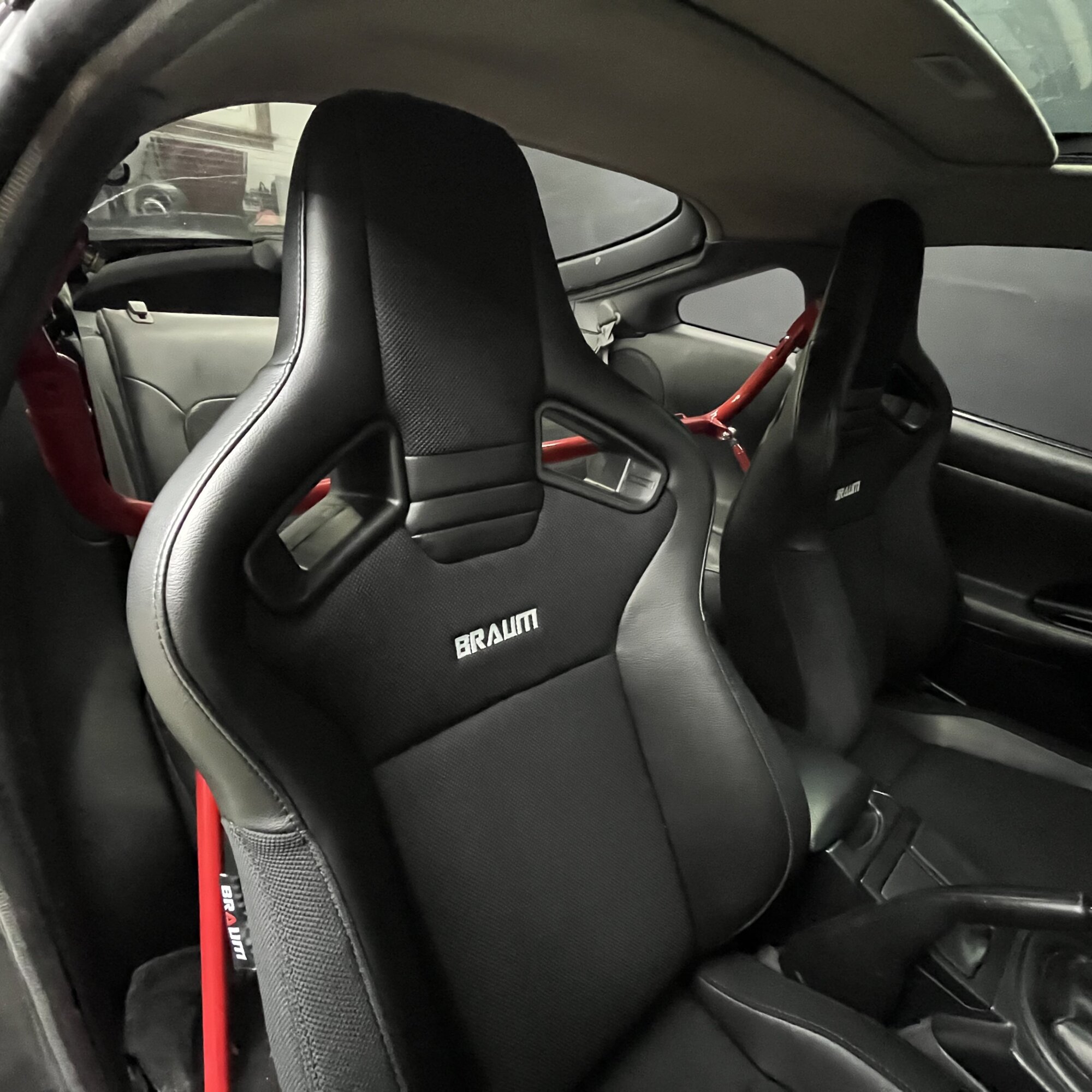

Been enjoying your videos and following your content for a little while. I too am wanting to put in Braum seats and harnesses. I have a quick question which could save me sending a part back, what kind of harness bar did you go with, I've seen 49" universal harness bars on amazon for $71 verses ones from Braum for $230
Thank you!
This is a link to the exact one I got. I chose red, but you can get it in other colors as well.
Thank you!
Perfect, thanks for the information!
