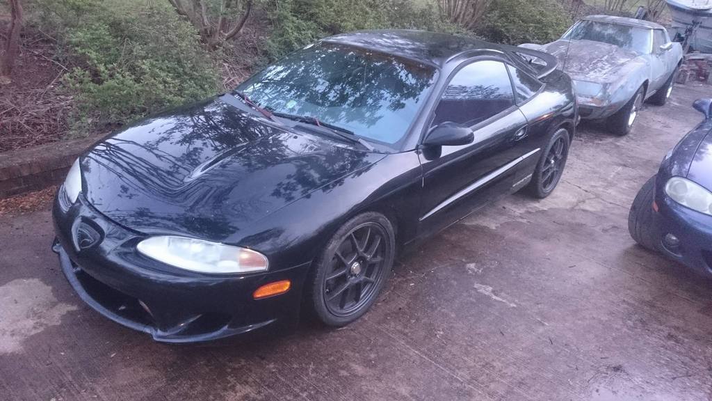

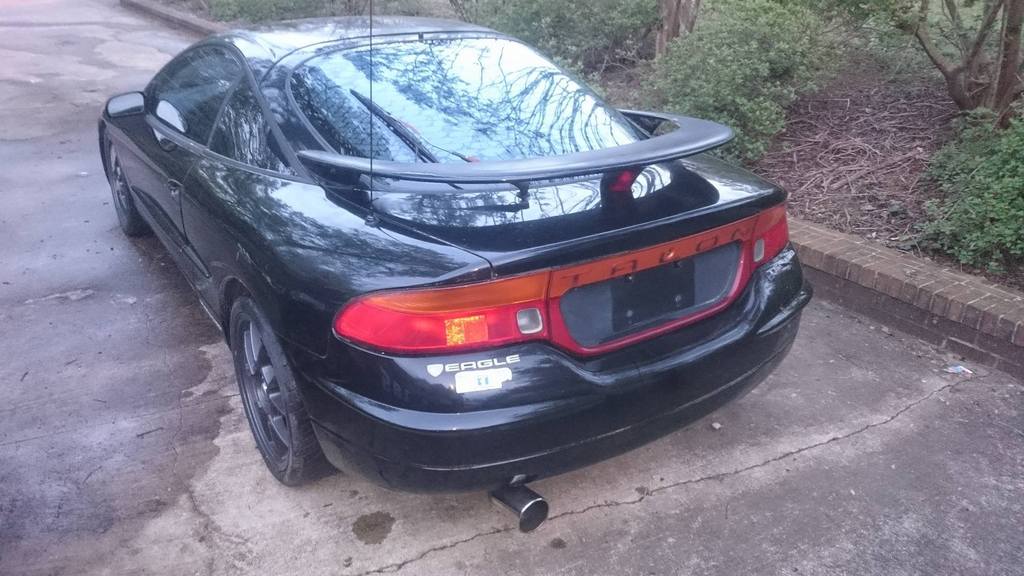

Figured I would make a build thread to the new car to the herd. I had a 91 GSX years ago and sold it off. Anyways a friend of mine messaged me on Saturday and asked if I knew anybody who would want a AWD Talon. It caught my interest as the 91 has been the only car I regretted selling. He sent some pictures of it and decided to take the extra 2 hour drive home from anyyok autocross and go take a look. He said the guy was ready to let it go to scrap. It has been sitting 7 years due to a blown head gasket. Will get into that later. Anyways I figured I would show up and since the car had a Michigan tag and was sitting in the dirt that the body was probably rust and the car was close to stock. After about 10 minutes of poking around the only offer on the car was $250 and that guy had no way to move it. I offered $400 and was able to pick it up on the Tuesday as the guy worked nights and was the first day that we could meet up.

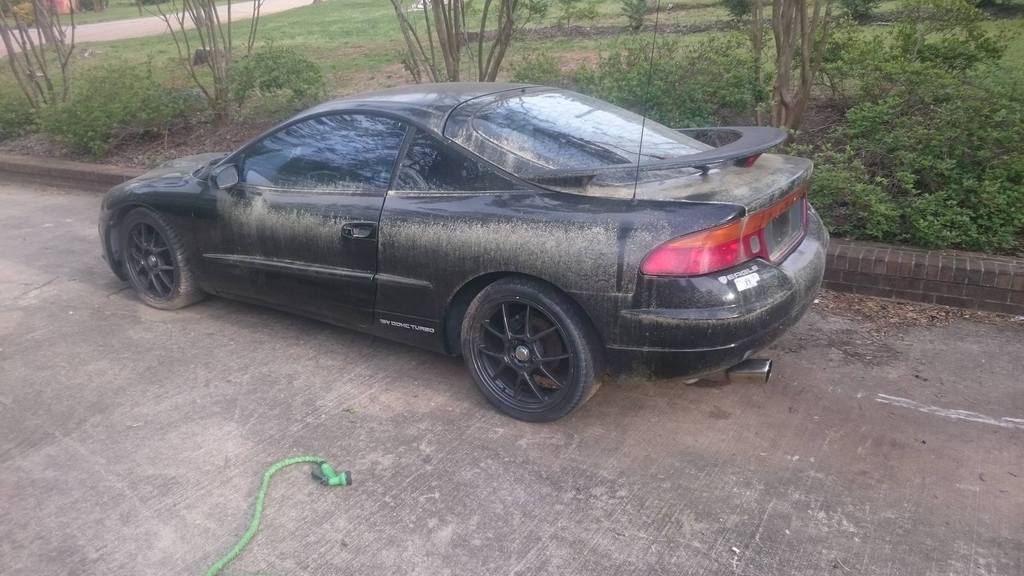

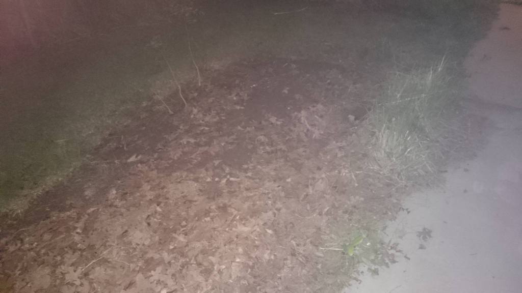

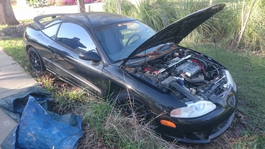

Here is the car where it had been sitting for a long time. It was in Columbia where they got the floods last year and the ground is still wet and the car was sinking into the ground.

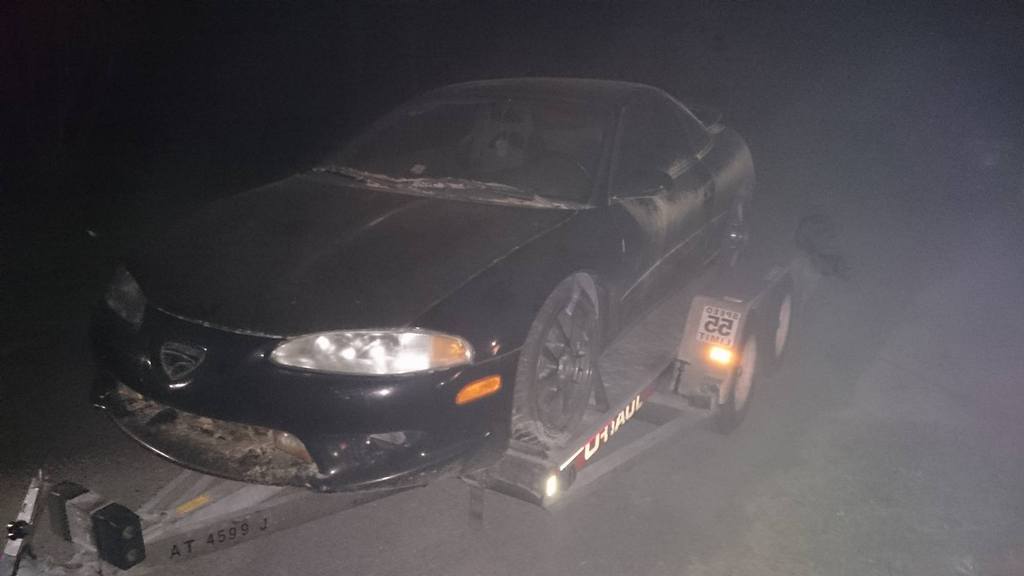

Fast forward to Tuesday. I hand over $400 and we start pulling the car out. The Suburban pulled the car out with zero issue. All we did was air the tires up. Brakes seem to be working. Handbrake was down which make it easy for it to stop. Hand to hand crank the car up onto the trailer. That was not fun. Would move a few feet at a time and be tired. Got the car onto the trailer and proceeded to lock the one and only key under the hood as I was removing the jumper cables. We did that so we could roll the drivers window down. The drivers door handle is broken. But the trailer would not let us open the passenger door far enough to reach in to open the drivers. Had to make a broom handle with a coat hanger taped on to loop on the inside door handle so we could open the door. This got us back in so I can get the key that was under the hood. Finished locking the car down and drove home. Was later than I thought but I was happy.
All loaded up.
Where it had been sitting all those years. Not anymore

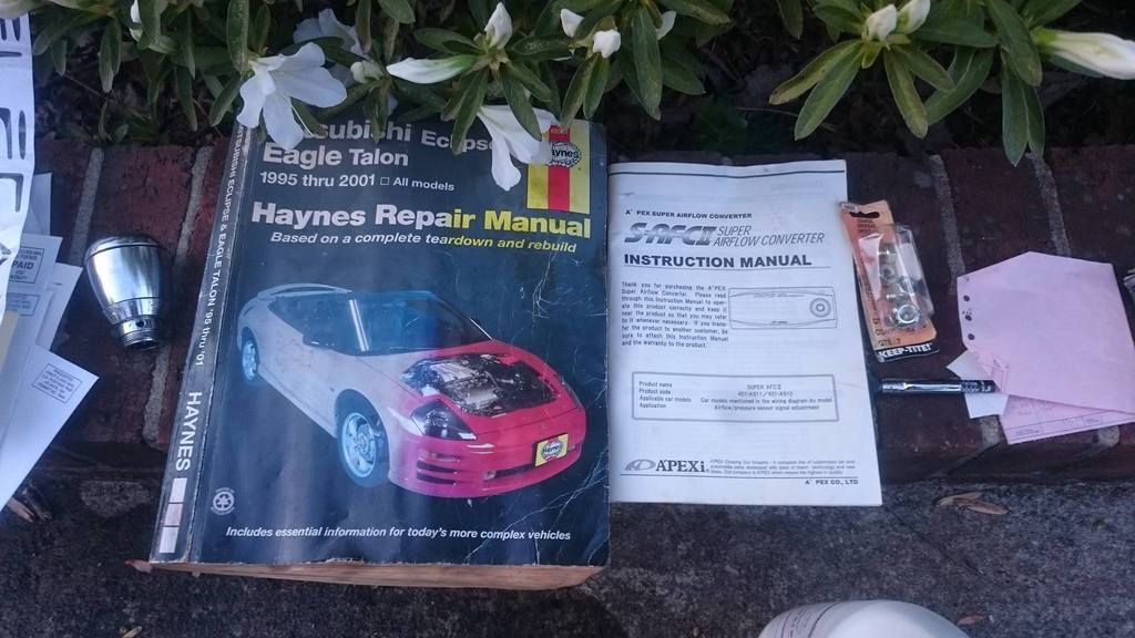

After a bath I decided to find all what was left in the car. Found some old mail from a time when Wachovia was around. Also found some goodies.

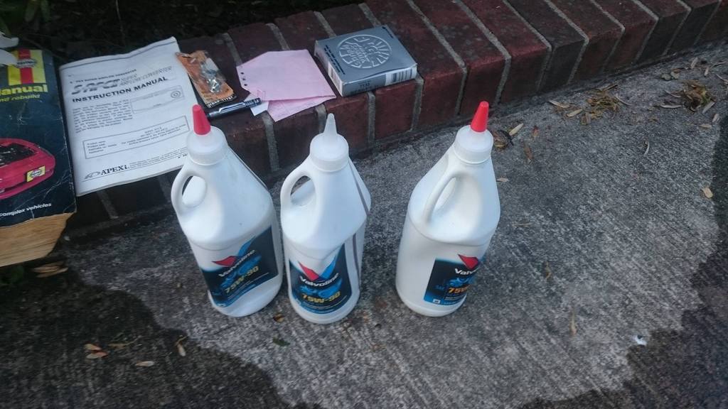

Can always use a Haynes manual and the safc manual. Plus a tire tread depth checker. Been needing one of those.
3 Bottles of gear oil as well as a full set of new spark plugs. A few less things to buy.

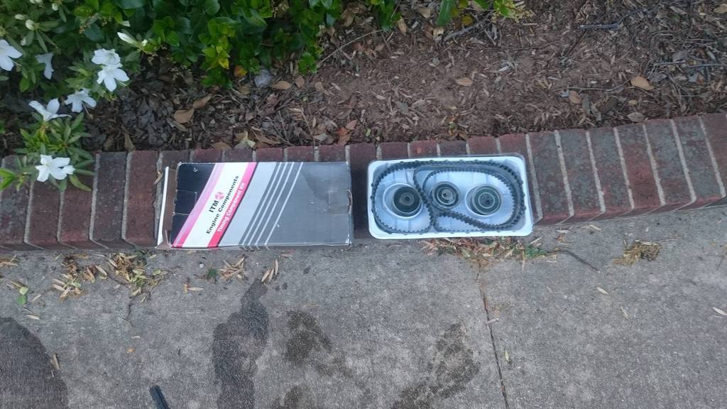

A brand new timing belt kit. Its been sitting a bit in a hot car. The belt is turning color so its not going on the car. But the idlers are good. So it will at least save a few bucks on the new kit.

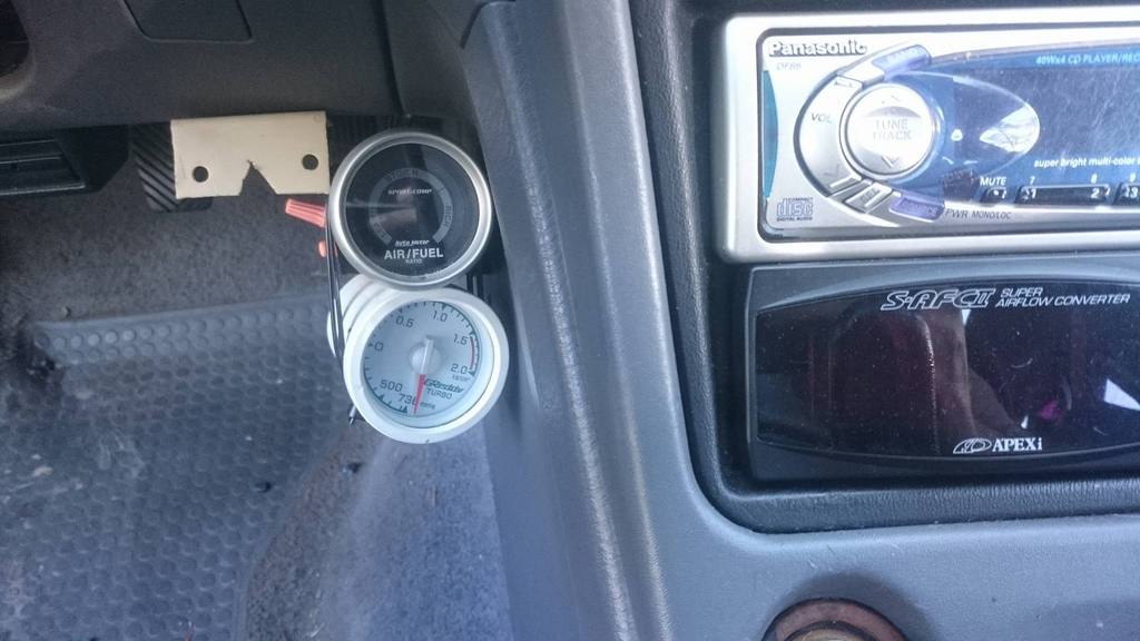

At the current moment it all looks to be there. As the car was sitting I doubt anything really got pulled. The only thing he said he did pull and that was years ago was the 16g. The car is back on the stock t-25 which needs a rebuild. I may swap on a 14b or 16g for now. Other goodies I have found in the car include.
- Safc tuner. Its someting but may get pulled for DSM link
- Autometer Air Fuel ratio gauge
- Greddy Boost Gauge.

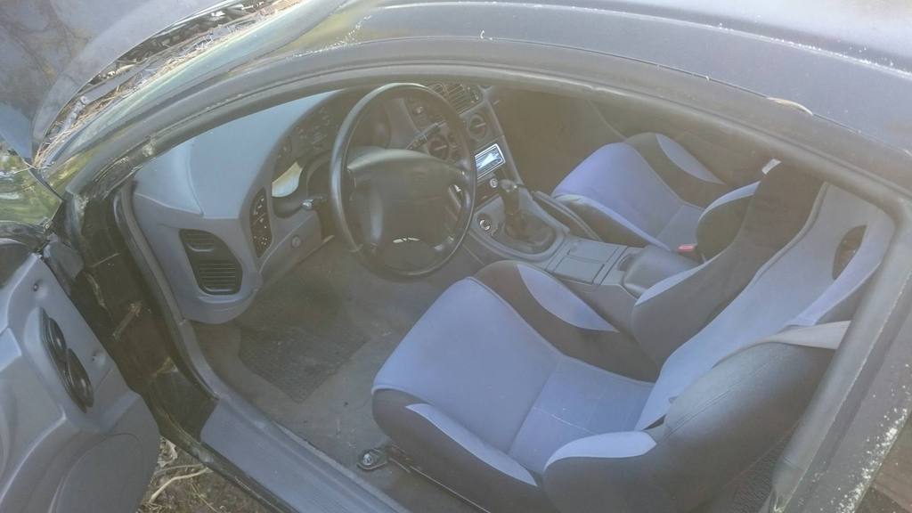

Interior

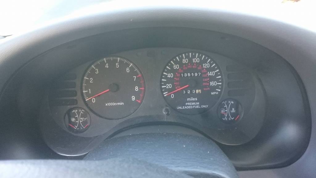

Only 135k

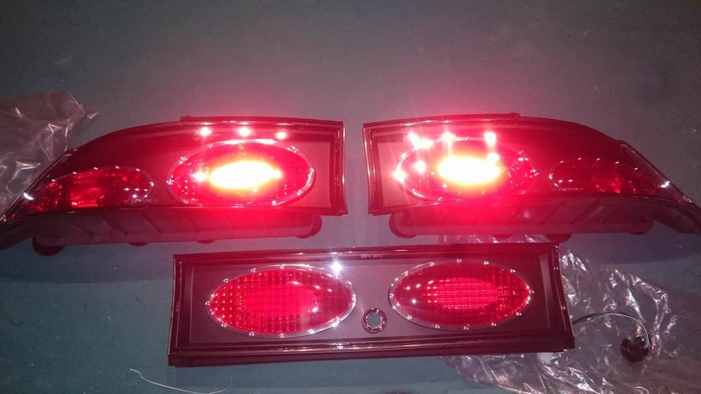

However this was the worst part. Anybody want some brand new TYC Altezza tail lights. Its going to hurt me to not throw them in the trash but will be going on craigslist for $50 to fund the rebuild. Good thing they are for an eclipse and not a talon. I like the stock taillight look.

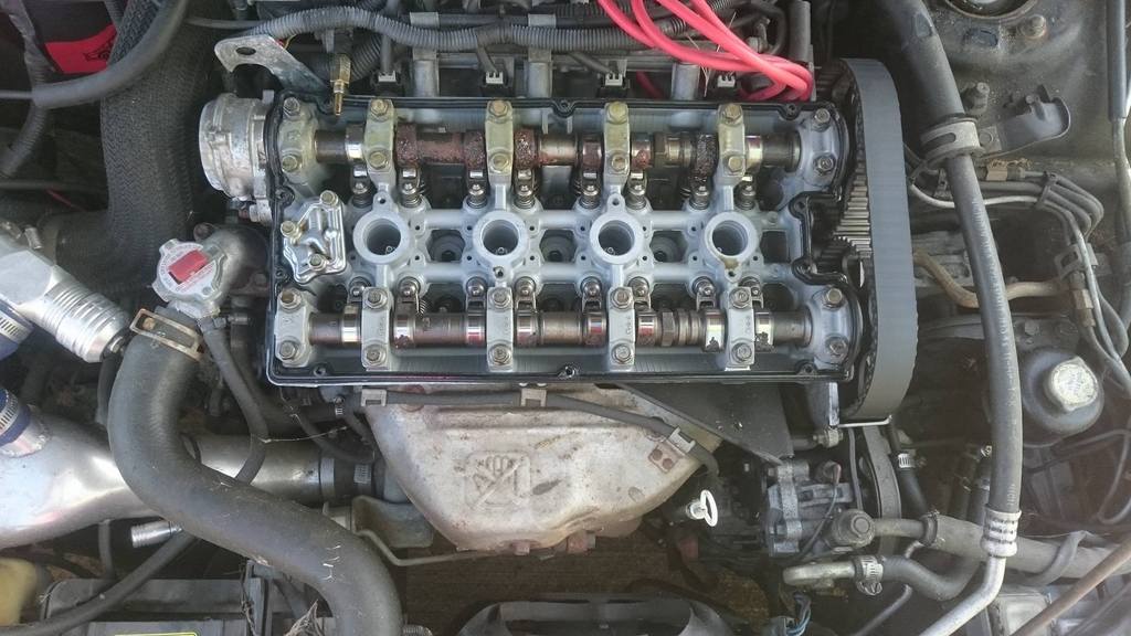

So today I did two things. First up was to check the condition of the cams. When buying it the intake cam looked rusty from the oil cap. The coolant is mixed so I am guessing the blown head gasket theory is correct. Well a picture is worth a thousand words so here it is.
I knew this one was coming. Looks like I will be shopping for a set of used cams. The look like stock units so no real loss. I will hit up the classifieds when I am ready. Good news the rockers, valve springs all look in great shape. So maybe a quick trim on the head and a gasket for the top end.

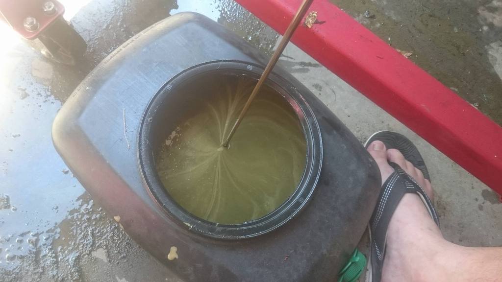

One a later note I tried to jump the pump to clean out the tank. I got a very weak flow and then it stopped. Gauge is showing 1/3 tank. So looks like a walboro 255 will be going in. Will be pulling the pump to confirm. But if the tank has gas in it then I will manually drain it. Man it smells BAD. Either way its just the one line under the car that I have not broke lose. So hopefully it plays nice like the one on the top did and I can remove the pump.
Pump came out. Pulled the other side sending unit. Also pulled about 7 gallons of very old 93 out. Sending units are in working shape so its just a matter of swapping in a new pump.

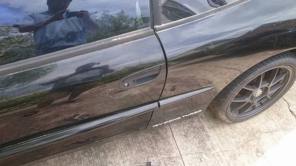

Also was able to raid this at the LKQ while in Savannah.
Yaye a drivers door handle. They had about 8 cars and 3 had handles. First one was a oem silver. The second was a aftermarket one. If felt horrible. This one felt good and was on a new car to hit the lot. After removal it has a Mitsubishi part number. So looks like I got an factory handle for $12. Will need paint but since I need some for the roof I may spray this one as well. For not being painted it looks ok.

Someone on here has a write for fixing the door handles so they are not so prone to breaking ... I cant find it for the life of me. i used it on my last 2g and it worked pretty good.
Great job so far on the car ....

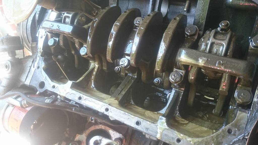

Onward to the engine. It turned over freely while I was trying to get the flywheel off. Was hoping not to do that till the rusted cams were out. Tho draining the oil found this.
Yep it 10000% blew a head gasket all those years ago. Good news it was still enough oil that it should clean up. No rust and the cylinder walls look brand new.
Anybody need a milkshake?
So I think I will be pulling the crank and cleaning it up. Then put some assembly lube on all the bearings. Need to checkup and make sure that bearings are ok to sit in this goo. Herd its not good for them.
Other things I noticed on the engine. The balance shaft has been deleted. Stock main bolts. Rods look stock but the pistons may be aftermarket. Pretty sure its just a stock bottom end. So should just be able to clean this up.

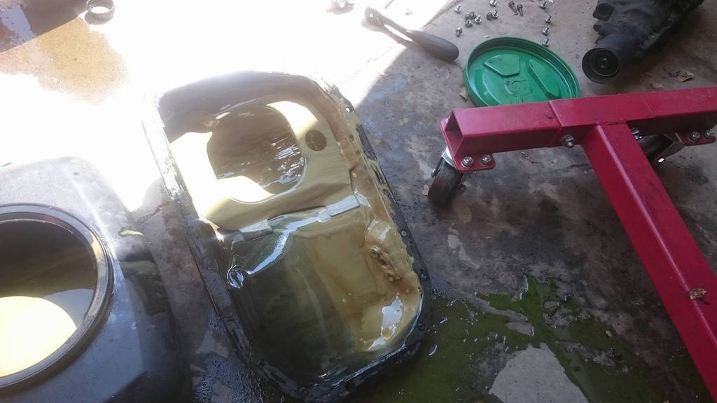

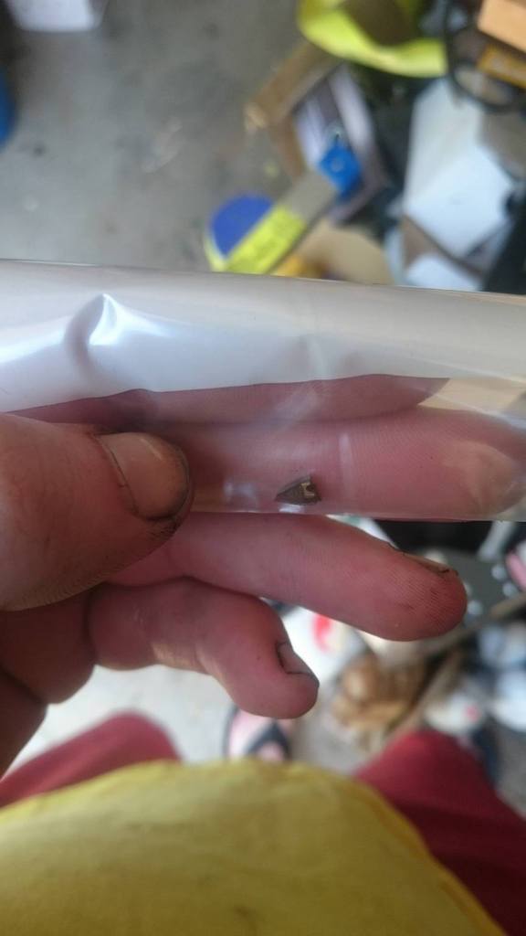

However this little guy was hiding in the oil pan....
Looks like maybe a piece of a camshaft. With them being rusty and they actually turned something could have broke off. However this is not rusty. It also looks like it has some oil journals in it. Going to have to clean everything up and search for where it came from. Feels like a cast piece.
Tomorrow the head comes off as well as the turbo and intake manifold. Should find out more tomorrow.
I wouldn't be surprised if that's a piece of a journal bearing from a previously installed/blown turbo. Is it brass?
Feels and looks like cast steel. Which has me worried some. I will be checking all the bearings as well as cleaning them off as well as inspecting, cleaning the oil pump.

Yeah I was thinking I was just going to pass on this car. Nope it was a keeper. Right now the plan is to pull the crankshaft. I did not get a chance to pull the head today. Hopefully tomorrow or worst case the weekend. Crankshaft should be good. If it has scoring then its going to the machine shop. If not then its clean, clean and clean. If the bearings are in spec then I will just reinstall everything. The pump will be take apart and cleaned. If it looks good then pack it with some grease for that first restart and install it. If anything looks out of spec it will get rebuilt. Hopefully I will just leave the pistons in the block. Going to check the lifters. The build was in 04/05 so I have a feeling they are the old style. This does have a 1g head. Heck the whole engine is 1g. As for an oil pump if its not OEM I don't trust it. I have had after market melling pumps fail in 137 miles. Buddy had a 420a with a melling that was reading low. He ended up swapping in a used neon pump and it fixed all the problems(we all gave him crap about it but after 60k miles its still going strong for being a $11 pump). I am going to clean the injectors I need to cut a pigtail for one. Since its pump is dead I drained the tank. So new filter is going in the system. As for the ecu I pulled it. I checked for eprom and its not. See anything wrong with it?
A quick test with a magnet would give you a better idea on the material.
