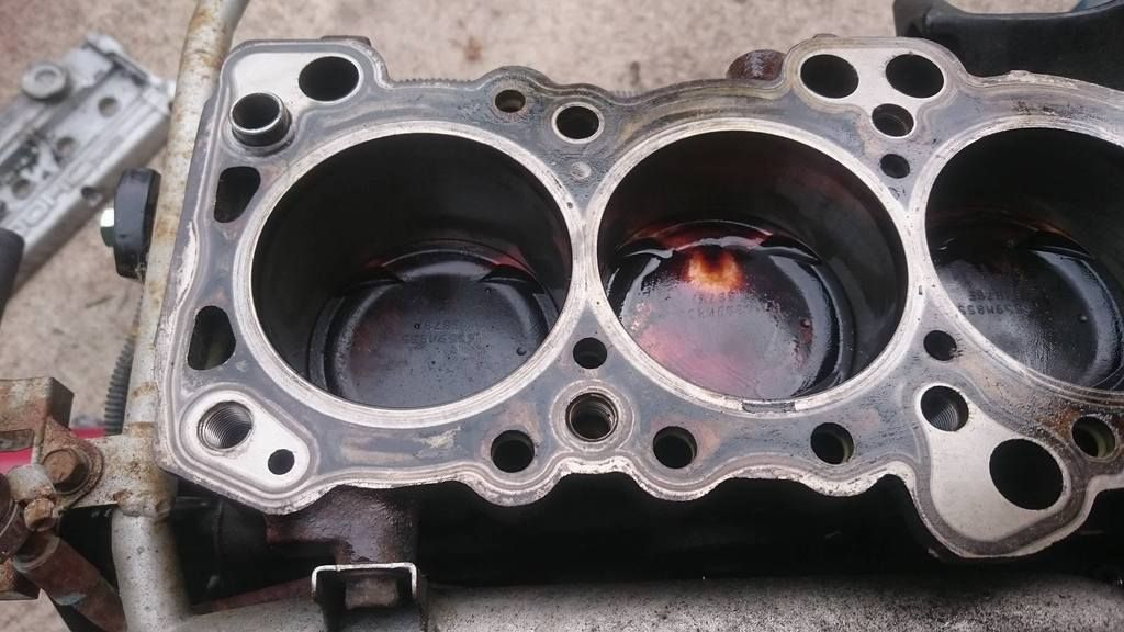

As for today I got the head off the engine. Really debating this t-25. Full of milkshake. Thinking that a used 14b will be better off in the end. It also has some up and down play as well as major side to side. The blades have made contact with the housing. So may tear into it but hopes are low for it.

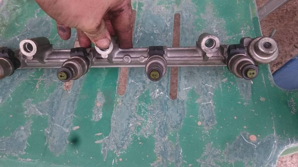

Next up was the injectors. I am pretty sure they are stock black 2g ones. Can anybody confirm?

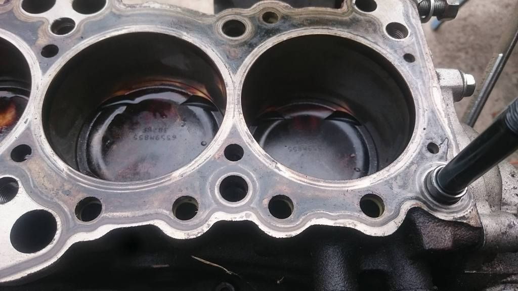

Onwards to the head. It looks and feels to have some port work. It is also a 1g cylinder head. Figured as much as the intake manifold was a 1g as well. Cams are going into the trash bin as they are rusted out. Rocker arms are also junk. A few have gotten some rust marks and the coating is gone off them. Lifters are the 3mm versions. So pretty much its to the machine shop. Going to check to make sure its flat and if so maybe some new valve guides as these have been sitting. Otherwise its ready to go. Now to find some cheap cams and maybe a set of rockers.
Bottom end looks good and turns over nicely. Just got to tear it down for a clean. Heck all of the timing belt stuff was in good shape. But going to replace the tensioner as its been sitting 7 years. Anyways looks good.
So as of now its a matter of cleaning up stuff. I need to replace every single soft line and clean all the hard lines. Its all full of a milkshake mix as well as they all are about to rip. Heck one was on the tb. Wonder if he was loosing coolant that way. So next up is parts and go from there.

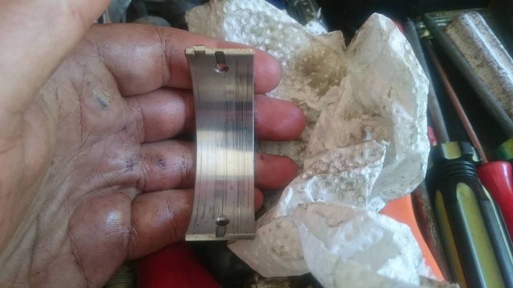

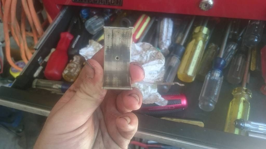

Onto the bottom end. Got some of the bearings off. New bearings will be going in. Some light trash has gone threw this motor. I can see it in the bearings and in the head journals. Its not bad in the head buy you can see it. Found out the crank has been turned. Was hoping it was std but its .25mm. Are these cranks still hardened at this level. ACL has race bearings in the .25mm. I know from Miata land they only make STD as the hardened coating is only on the top level.
Rod Bearing
Main
Good news the crank looks great. Not going to polish as it does not need it. So just got to actually order those parts.
