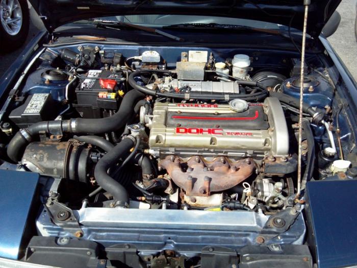

Update: I've finally been driving the car for some time now, but it is slow as sin. There is nothing wrong with it, it's just extremely slow compared to my other Talon. I bought another Slowboy Race core and a Tial 50mm from Keri (VTEC-THIS) on here, and with the rest of the supporting mods I am going to put my 3076r on the car in the next few weeks. So far here's what's been replaced.
Parts replaced/upgraded on the car:
Wiper blades
All Coolant hoses
All accessory belts
OEM Water Pump
New OEM knock sensor
New Denso o2 sensor
Timing components: Idler pulley, tensioner puller, balance shaft belt tensioner, hydraulic tensioner, tensioner arm, Mitsubishi timing belt, Continental balance shaft belt
Head: Milled, valves lapped, Ferrea valve seals, ARP SD Head Studs, Hyundai valve cover, ARP stainless exhaust manifold studs, new copper crush washers on turbo oil feed, New OEM cam seals
Gaskets: Felpro intake gasket (Red Tack), Mr Gasket Copper exhaust gasket, Mitsubishi stainless manifold-turbo gasket, thermostat housing, thermostat housing to head, valve cover gasket, throttle body gaskets, Felpro PermaTorque composite head gasket
Fluids replaced: Washer fluid, power steering fluid, brake fluid(Valv synthetic), clutch fluid (Valv synthetic), rear diff (Redline Shockproof), Transfercase (Redline Shockproof), Trans (Pennzoil Syncromesh),
Engine oil was changed w/ 10w-30 Valvoline and new Purolator filter, and flushed after 300mi since the car sat for so long, and replaced w/ 10w-30 Valvoline and new Purolator filter, coolant flushed, system flush, new 70/30 mix of coolant
Brakes: Replaced front and rear rotors w/ Wearever rotors, Wearever silver pads in rear, Hawk HPS pads in front. Both rear calipers are new units, I rebuilt the front calipers
Other Items: HD Aluminum radiator, New Stant radiator cap, New Stant thermostat, Hallman MBC (10psi), Re-Keyed car (car didn't come with working keys), Torque EGR delete plate, All emissions removed except catalytic converter & charcoal can, New front axle carrier bearing and seals (OEM), New passenger side & driver side front axles, new fuel filter, New DEKA battery, New power transistor, New Accel plug wires, New NGK BR6es plugs, recharged A/C with Freeze-12 (blows nice and cold), replaced upper and lower injector seals (OEM), new exhaust flex section, ARP Chromoly manifold-turbo bolts, shortened shifter, 2g Probe GT leather shift knob, K&N Filter, EPROM ECU
Suspension: Replaced front wheel bearings, seals, and snap rings (OEM parts), New Moog balljoints, New Moog outer tie rod ends, New Driveworks sway bar end links, KYB GR-2 shocks/struts, Eibach Pro-Kit springs, MB Motoring Weapon wheels (17x8 +40mm), New Dunlop Direzza 245-45-17's, Hubcentric rings, rear control arms cut and welded to clear the +40 wheels and wide tires
I also picked up a very clean set of 1g black leather front and rear seats for dirt cheap that I haven't put in yet.
I also deleted the ABS, and will be deleting the cruise unless I can find a working cruise motor at the junkyard.
The 3076r setup will consist of:
Link v3 full
PTE 680's
Walbro 255
Aeromotive regulator
Pacesetter manifold
3076r
Tial 40mm WG
Slowboy race core
Tial 50mm BOV
GM 3.5" MAF
NGK 7's
LC-1 Wideband
Automoeter Boost Gauge
ACT Streetlite flywheel
ACT 2900 Clutch
New master, slave, clutch fork & pivot ball
SS clutch line
4 Bolt rear swap
Thermal R&D 3" Turboback
Battery relocated to trunk
Poly motor mounts

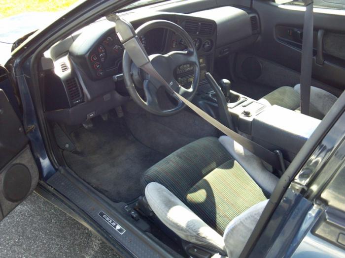

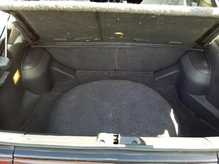

Pictures!!!

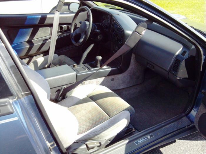

Looks great man! You got super lucky with the exterior being so nice and the motor being in good condition. My interior was destroyed when I got it too, the exterior is pretty bad too, but its getting there. I hope eventually it will be clean like yours on the inside and outside :D

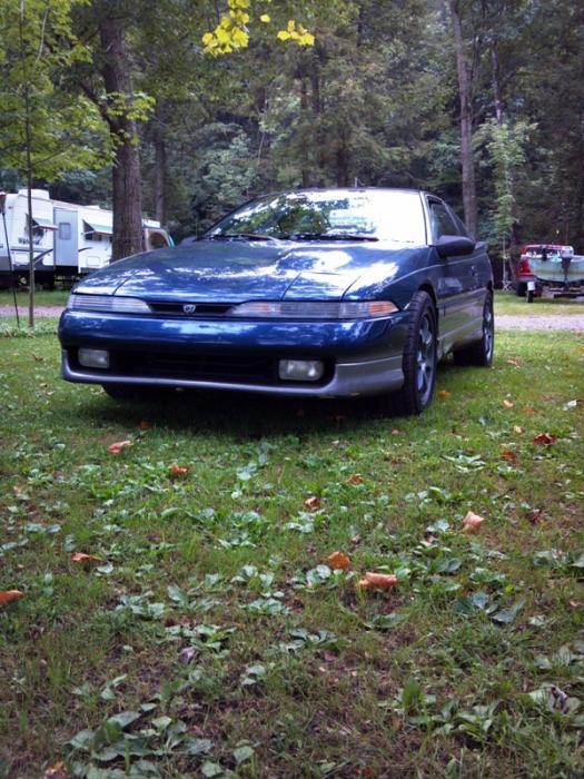

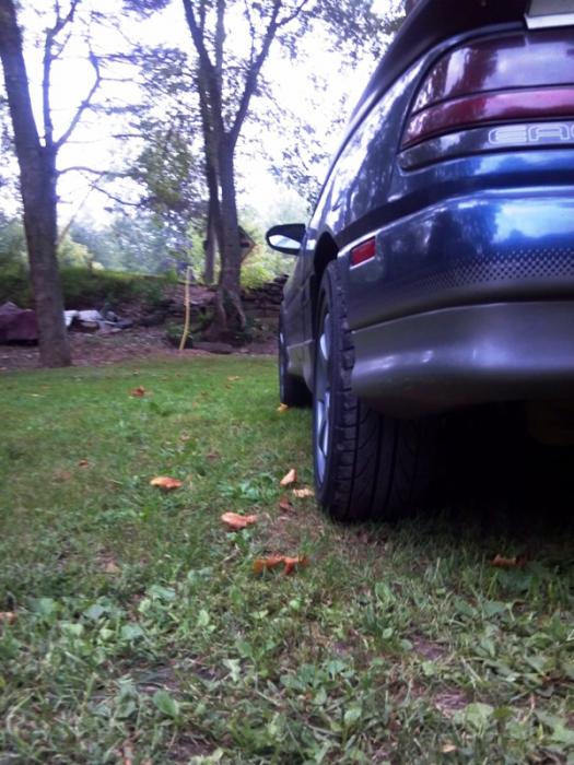

Car looks great!! What kind of wheels are those? Also, for the tcase warranty did you take it to a Chrysler or mitsu dealer? Why did they replace the seatbelts?
Thanks!! They Are MB Motoring Weapons, 17x8 +40mm. The tires are 245/45/17 Dunlop Direzza's. I took it to my local Chrysler Dealer, all Eagle's and Plymouth's go to the Chrysler dealer, Mitsu's go to the Mitsu dealer. Recently the rear seal started leaking since they messed with it so it will be going back. Eagle and Plymouth have lifetime coverage on the t-case, Mitsu was a once and done deal. There was a recall for the front seatbelt buttons that was never done, I guess they deteriorate with the sun and break when you push the button in. This is the portion aside of your hip i'm speaking about, this is the buckle only, not the belt assembly.

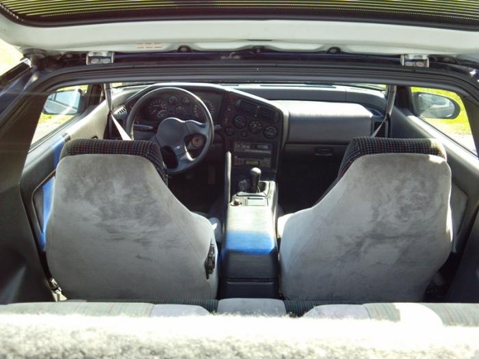

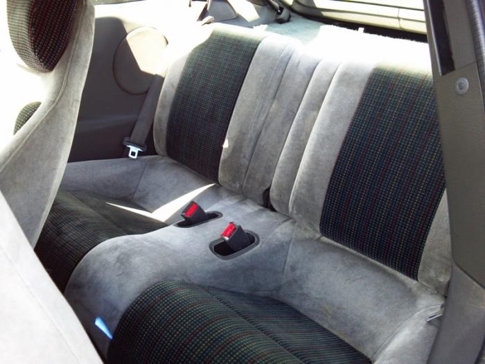

Dude 1g's came with black leather seats??? I must find some for my build.
Great job getting that old girl back on the road, did you say how many miles are on it or not?
Yes they did, they came in tan, light grey, and black. Any leather from a 1g will be hard to come by in decent shape. Thanks for the compliments! The car had 155k on it when I bought it. It has 157k on it now.
Well I got the tan one's but only one of them's in good shape, guess I'll be on the hunt for some black ones. Any progress lately?
I'm on the hunt now as well :p on another note, how hard was the carpet swap? seriously considering it, mine is straight up dirty and kinda nasty.
dude taking out the carpets a piece of cake, take out the seats, take out the bench seat in the rear and the lower rear panels, door kicks, center counsel, and lower kick panels on both ds and ps below the dash and its virtually a done deal. Sounds like a lot of work but it really isn't.
