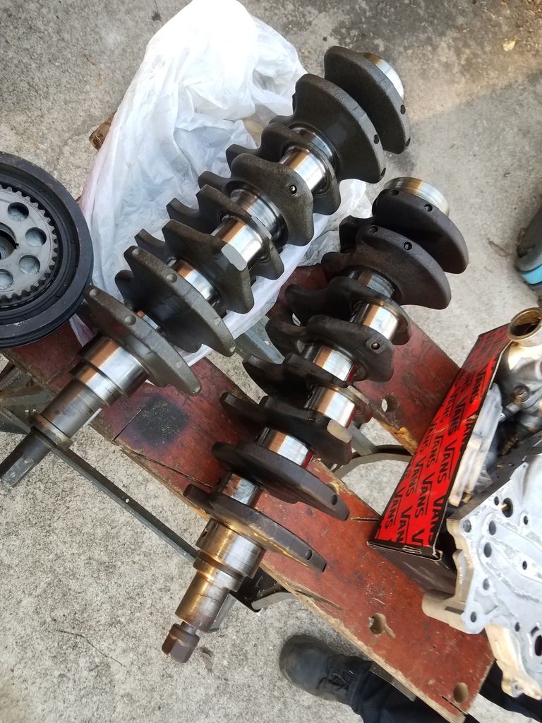

So onto some good news? After doing some research I found the Mighty Max trucks with the 2.0 should have the same crankshaft as the 4g63. Napa, Rock Auto, and Autozone use the same part number for the 6 bolt 4g63 and the g63b. Anyways two 2.0 trucks came into my pick and pull. Being I was having a hard time finding a crankshaft in budget I decided to make a trip. Got there and both trucks had engines. One had 137k but was missing a lot of stuff of the engine. It also had no body damage. Grill and headlight were missing but I think something was up with the engine. Red truck had 177k, but had a new cylinder head and was crashed in the front. Maybe someone was trying to make two trucks into one. Picture looked like they were on the same truck. Being they went on the yard the same day helps that theory. One was an auto and the other was a stick so the blocks were different. Anyways 4 hours later we had this. Was going fast but one starter bolt had to be a pain in the butt and took 30 mins to remove. Granted will say whoever worked on that truck never knew how to tighten a bolt. Lots of bolts started with no effort. Made sure to pay attention on the rod and main bearing caps. Those seemed to be torqued right.
Anyways result.

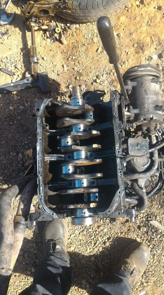

Got that out. Had standard bearings in it. Look to be originals. Some light light scoring. Figure it should clean up with a polish. Worst case I could have it turned since I already have .25mm under bearings for the other engine. Would make it nice and tight. Brought it home and side by side they look the same.
Can you tell a difference?
Bolts and pulleys go on just fine. Since both are internal balance no worry about that. Only need to steal the flywheel dowel pin as the might max did not have one. Bad crankshaft has one tho. Other than that I have a crankshaft. Not bad either was it was $68. Cheaper than anybody else wanted. So calling that good news? Need to get this project rolling again. Depending on bearings I will order a rack and pinion kit. Hope to have the crankshaft at the machine shop later this week. I am going to mic it best I can at the house. If its on the loose side I may take to Columbia and just have it cut. That way I can have a nice tight engine on the bearing side. Guess more to come in the next few weeks.

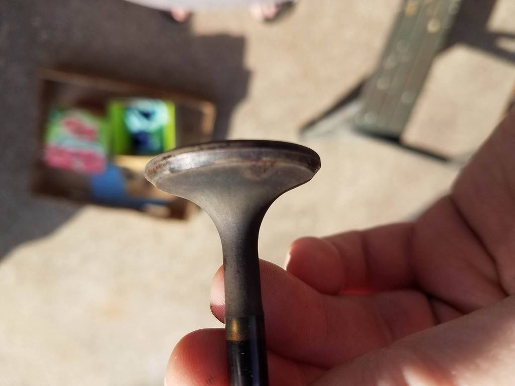

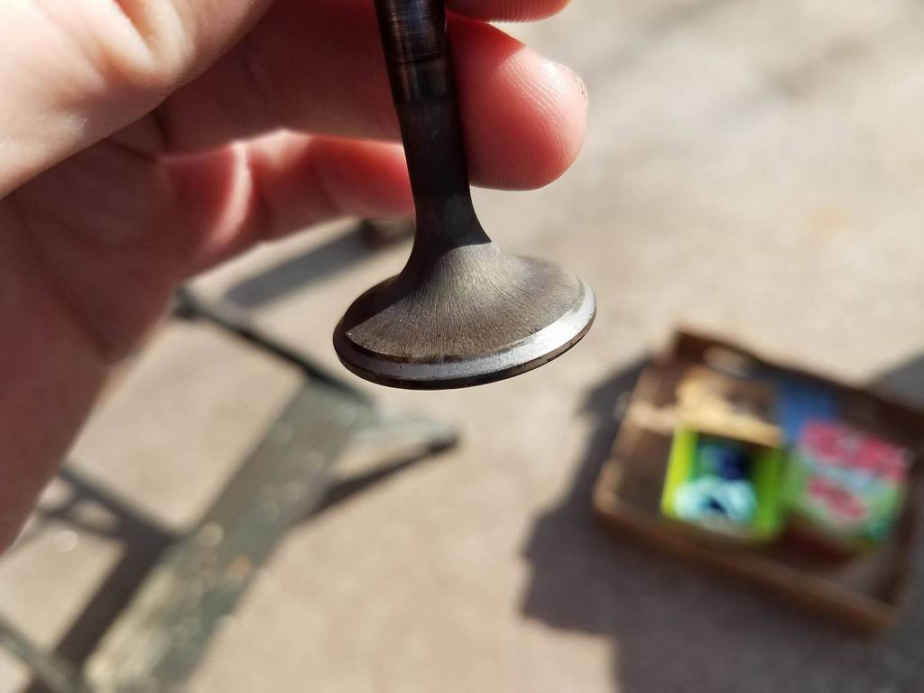

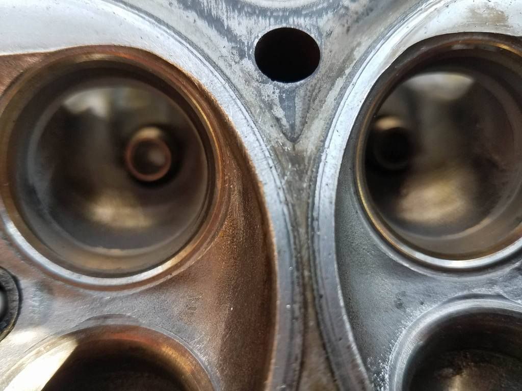

Well crankshaft needs to be turned. Will save a few bucks on bearings. Problem is finding a local machine shop that does it. Only one I have herd that can is 45 mins away and will not answer the phone. So may just take it to Columbia. Started lapping valves. Got 3 of the exhaust ones done before I had to do something else. Will say lapping valves SUCKS. Some grit got down into the third valve and it took forever to get it out. Only 13 more to go.....
Before
After

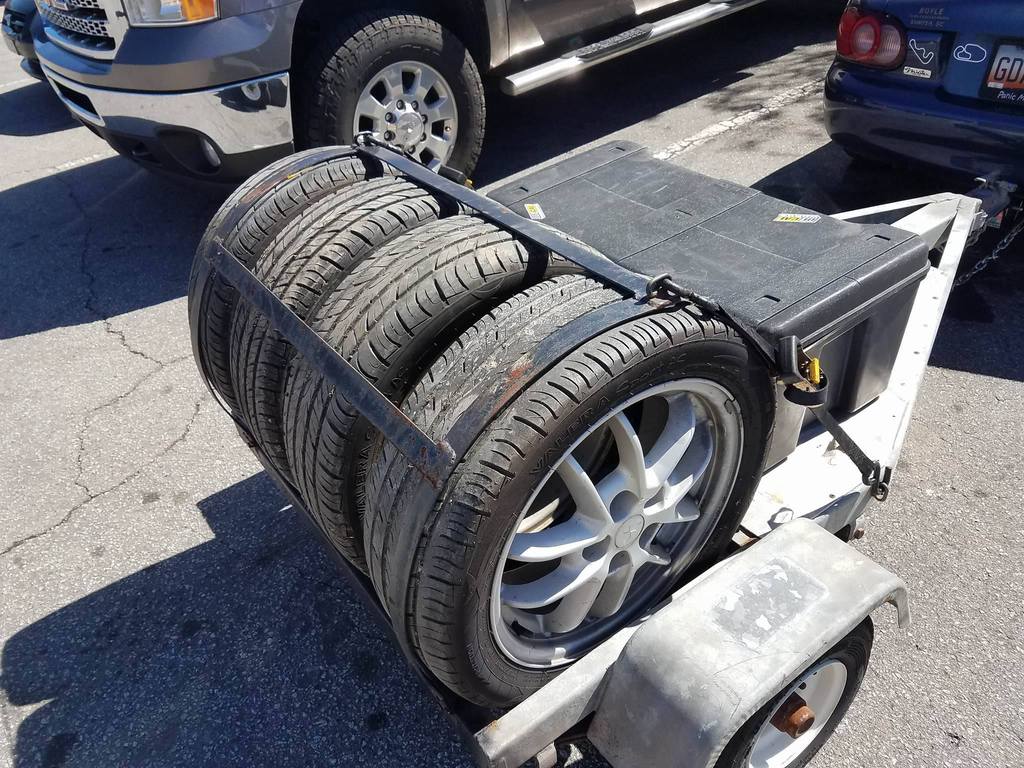

Well went up today and got some rims and tires. Came from a 2002 Eclipse Gt. Have almost new all seasons. But since its going to be a daily driver they will work. Got the factory lug nuts and the spare. I did not have a spare so this could be used. But progress. At least now I could put it back on the ground again.

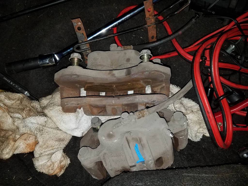

Raided a set of calipers and brackets from a 2006 Outlander. One of my calipers has a seized piston. Anyways for right now I can swap the calipers out. But then I have the brackets to move to the Outlander rotors. Got lucky there as the car had been on the yard since 10-29-16. 4.5 months and it was mostly complete. Also was able to pick up the top section of the battery tie down. Bolts were all gone but was at least able to get it from the one convertible car on the lot.

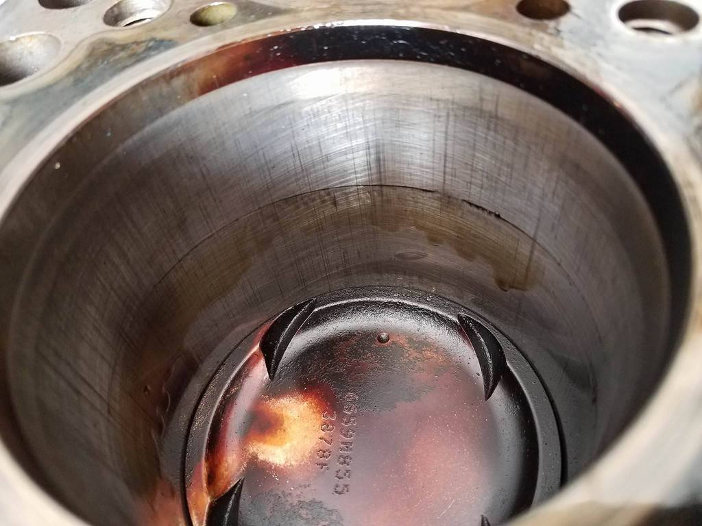

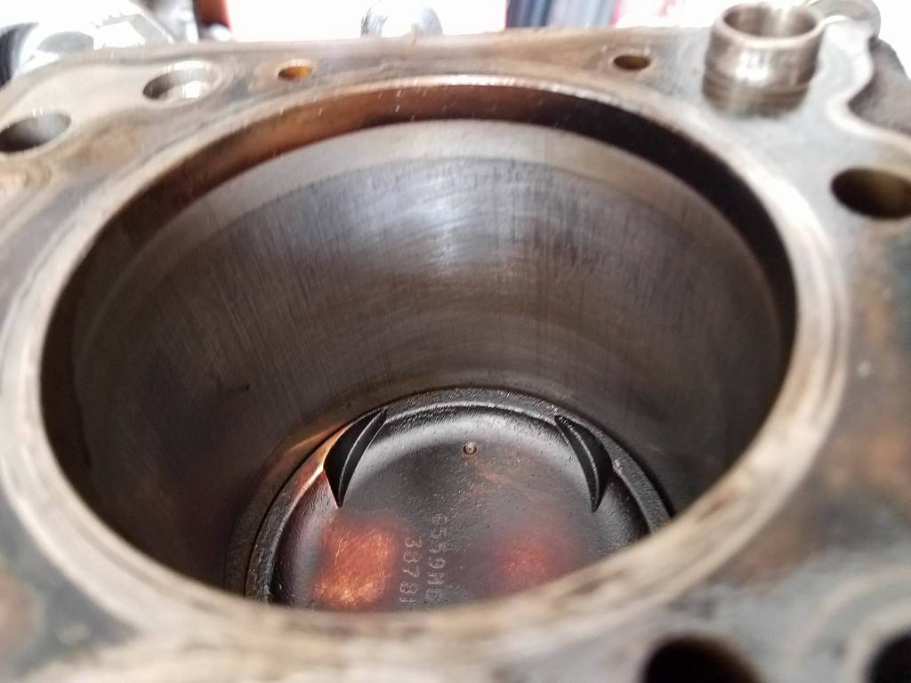

Well the crankshaft is at the machine shop. Guy said its been a long time since he had seen a 6 bolt 4g63 or any 4g63 crankshaft. Said crankshaft looked good. Found the right place as they only do crankshafts. $110 and it should be done next week. Next I went out and looked at the bores.
Bores look very tired. Especially for an engine with about 12k on it. Lots of up and down scratch marks. Granted the hatch marks are still good. So I was thinking about ordering rings. However if you look at those pistons they have 855 in the part number. Being a stock bore is 85 this caught my eye. If you copy that part number into google you come up with this.
https://www.summitracing.com/parts/wis-6559m855
Those are Wiseco pistons and are 85.5mm. Good news I have some nice pistons bad news they are crappy for compression. Probably going to be around 8:1. Yuck I forgot how low these engines are in compression. Would have been nice for some 9.5:1. Oh well since they are a surprise that is nice. Buddy who is a parts guy said that is 100% how Wiseco marks their pistons. The $400 car that keeps on giving. So now the question is to do a full rebuild or rock these as is.
Just to make an important note for you.... If you got that spare tire from a 3g eclipse, please make sure it's a full size or a donut spare that is tall enough. Since they didn't come awd, and if it's not the proper height, you'll damage your awd system.
I did its not going to work. Its about 2 inches to short or more. That and it does not even clear the brake calipers. So useless for me.

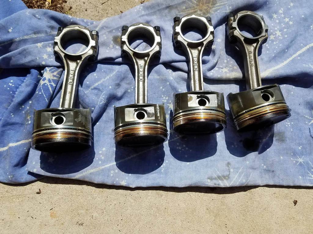

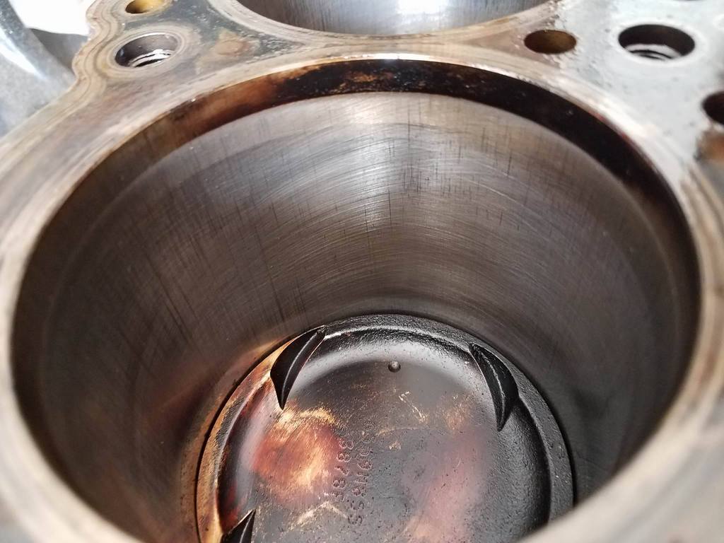

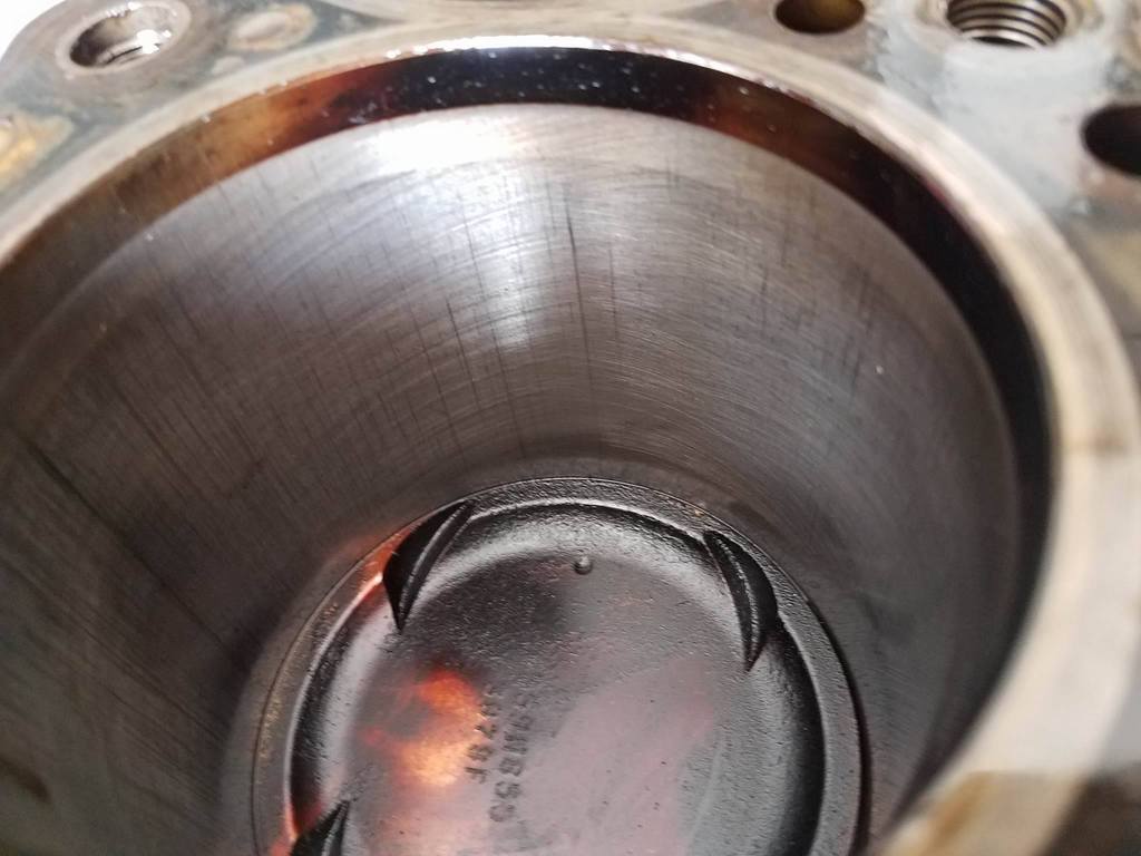

Well more bad news.....does this car ever have good news? Pistons are trash. Pulled them out after posting another thread about it. Piston bores are scored. Probably going to have to bore it to 86mm or more as its 85.5 now. Bleh never ending money pit this car. Still not even working on any suspension bits or driveline stuff that may need work later down the road. To not post all the pictures here are a few.

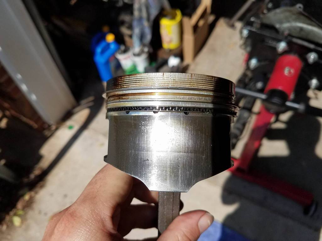

All four pistons out.

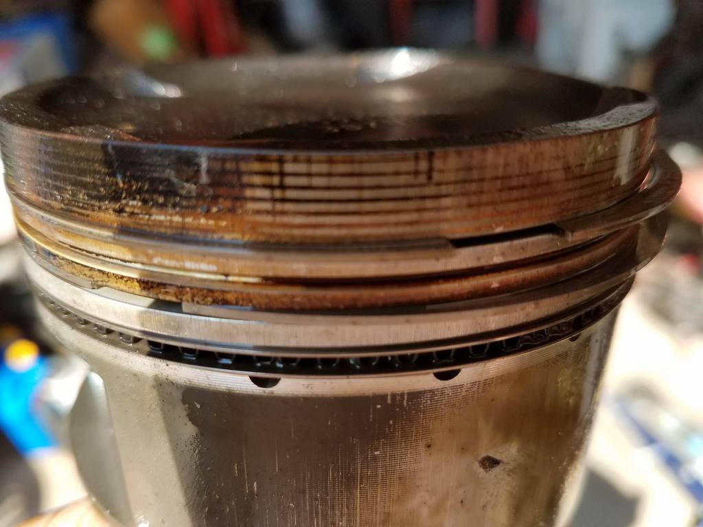

Mmm deep scratches. Also check out that ring gap. Should be 180 degrees from each other. Well they all came out like this. Was not a fluke thing.
Who needs piston skirt coatings anyways. Its all gone on this side. Can even see deep scratches to the top rings. Could understand on a high miles car or something with loads of boost. But this engine had 12k miles and a t-25.
