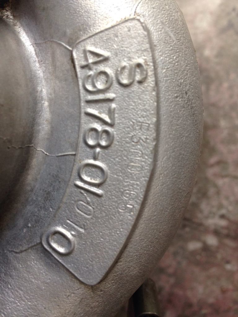

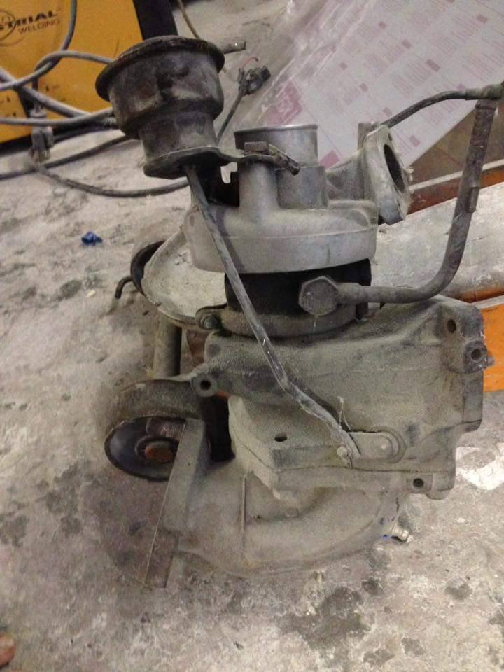

First up got a new turbo. No more fixing the busted T-25. Buddy got a 14b with a miata he bought and he does not need it. No j-pipe but say hello to the new turbo.
Its been on the shelf for a year and a half. So it will be getting a good clean up. Depending on shaft play it may also get a rebuild. But hey got my 14b.

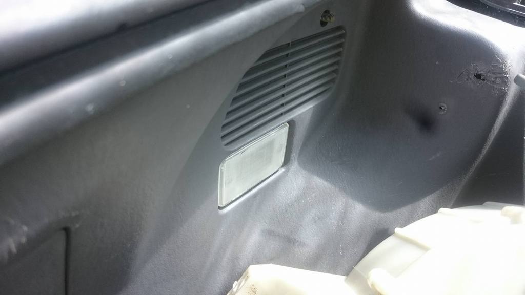

Second up and what has helped. Brother was able to pick up a back light in the junk yard. Everyone of these has been missing. Well now I got one and it even works. Its the little victories.

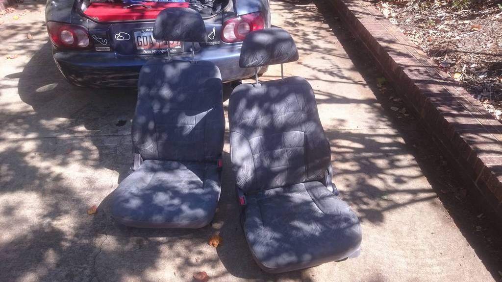

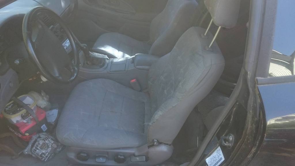

Look Seats
Saw a car on copart with some high miles and hit in the front. Well that car showed up in the local pick and pull. Seats have some light tears starting in the bolster but are full manual and actually bolt in. To bad they don't match the factory style for this car. Either way factory safe seats. More to come soon. Hopefully.

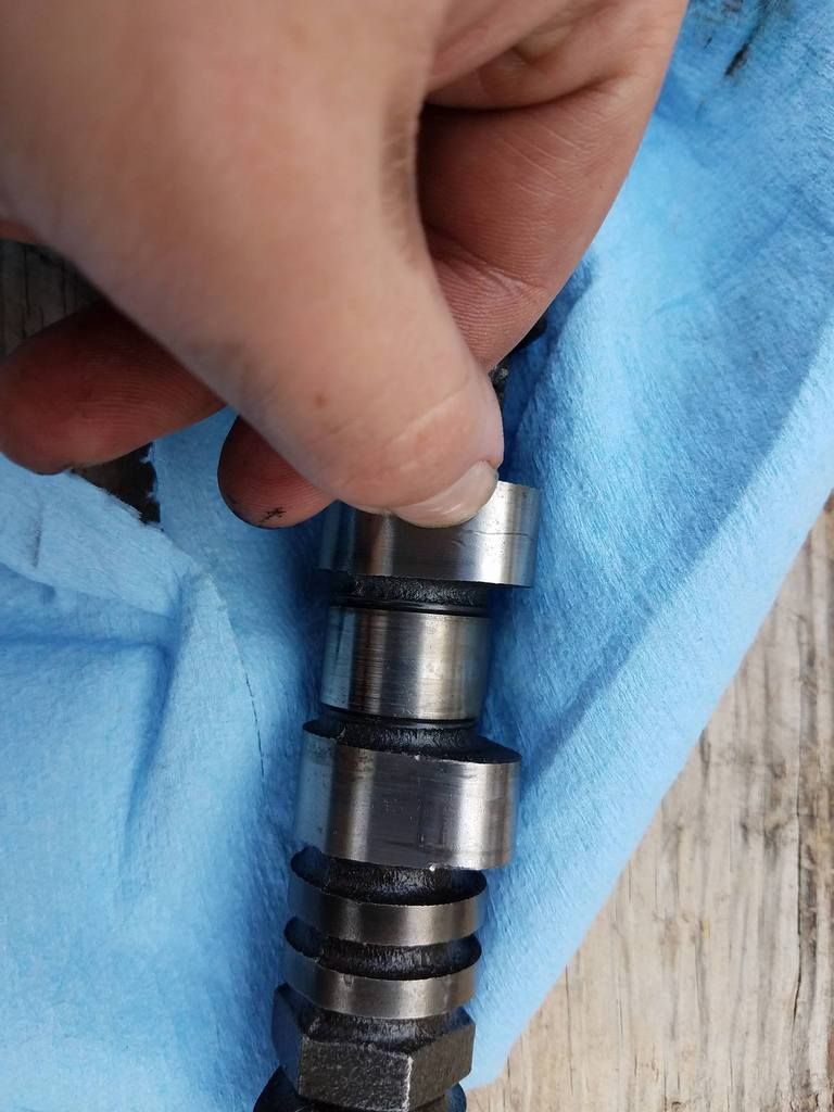

Well got some good news. Boxes are arriving. Rad and gaskets showed up as well as the clutch items. Also made a trip to Miller Import Parts and picked up a Rack and Pinion, 1g water pipe, 2g exhaust manifold, 1g turbo outlet. I also got a set of A cams. However under closer inspection the intake cam has some scoring on it. Looks like somthing went threw the intake side. Exhaust looks fine. Intake cam has three lobes with some marks. This is the worse one one. My finger nail catches this one.
It might polish out but it may not. I'll message Miller about it on Monday. They are open tomorrow but I will be busy with Family. What do you guys think?
Well more update. Miller sounds like he is digging up another set of cams. Should know tomorrow. Will have to make a trip Friday. Sucks but its not the end of the world. More interesting news. Found the ACL Race bearings in the size I need for the mains, however the rods are out of stock. Getting a refund then will be seeing if anybody has a set on the shelf. Otherwise this project is going nowhere till mid January.

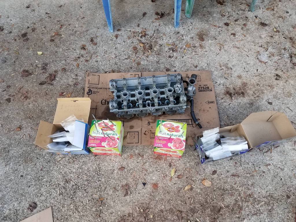

Well stuff is finally moving along. Now on to the fun stuff of cleaning everything. First up I have tools on the way to clean and lap the valves. Got them all out with the socket and hammer trick. Just going to have to wait for the install tool. New valve seals will be going in. Also this will allow me to clean all the crappy goo that is still in there. Dont want that going into the oil right away. Also checked the head and it passed the straight edge and feeler gauge test everywhere.
All nice and packaged up with labels. Valve seats cleaned up and the valves look good as well.

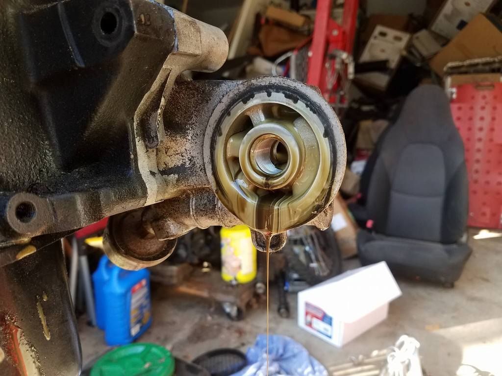

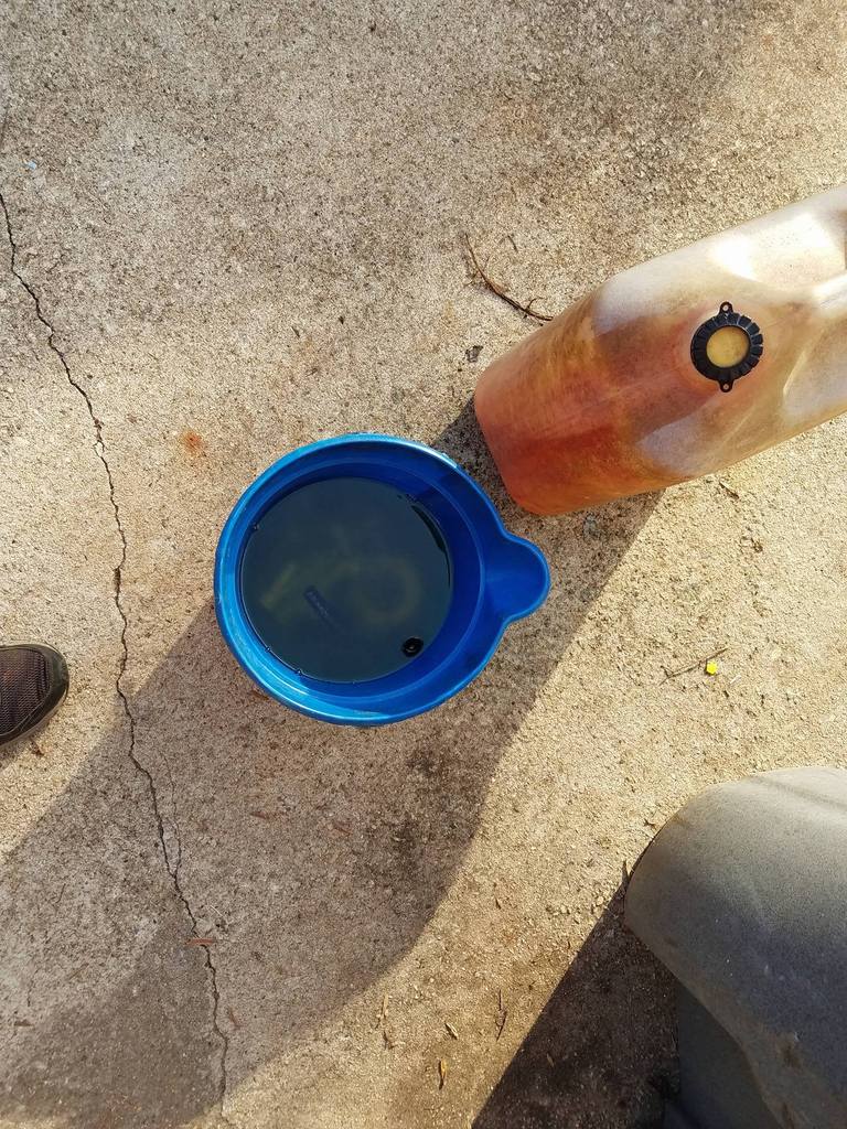

The rest of the parts are in minus an air filter and maybe some small things here and there I got moving onto cleaning the goo out of the bottom end. Lets just say this crap is nasty. Finally took the old Fram oil filter off. Had the fun of using a screw driver on that sucker. Anyways here is the nice good that came out.
Called a buddy of mine and asked what could help clean this stuff up. I was thinking of some mineral spirts but he said just get some gas. Well the 7 gallons from the tank of the talon will work as well. Ended up pouring some of that into a bucket and it did wonders.
Stuff that was full of goo went in and came out clean. The oil cooler is being a little stubborn. But the things like the oil squirters came out looking like new. As well as the oil filter housing. Even some of the clogged turbo lines washed out. So calling that a win. Still need to go threw with some compressed air. But for the most part this stuff cleaned up. Oil pump also cleaned up. needs a little more time with a razor blade. But since it tested well within specs and its clean I will be reusing it. Just got to remember to pack it with some grease.

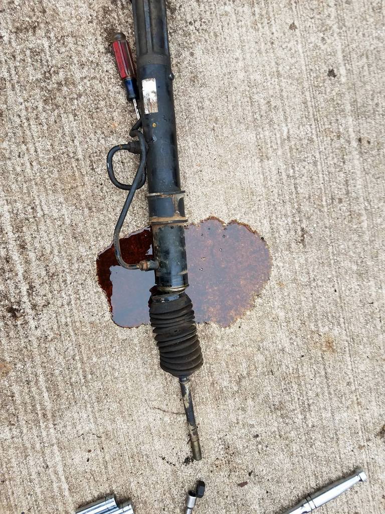

Yeah the new rack needs a rebuild as well. So buying one from miller was a bust. Figured $30 used rack vs $30 in a rebuild kit would make it easier. Well now I get to rebuild two racks. Debating taking the one that was supposed to go into the car and just deleting power steering for now. These setbacks are not helping my enthusiasm. Have not been wanting to work on the car at all. Kinda wishing I had just sold it for the $2000 and let it go. Guess its back to it. Was going to try to install the engine next weekend but who knows if that will happen now.

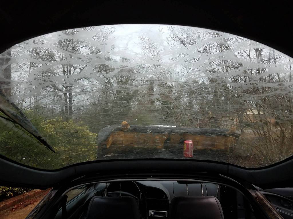

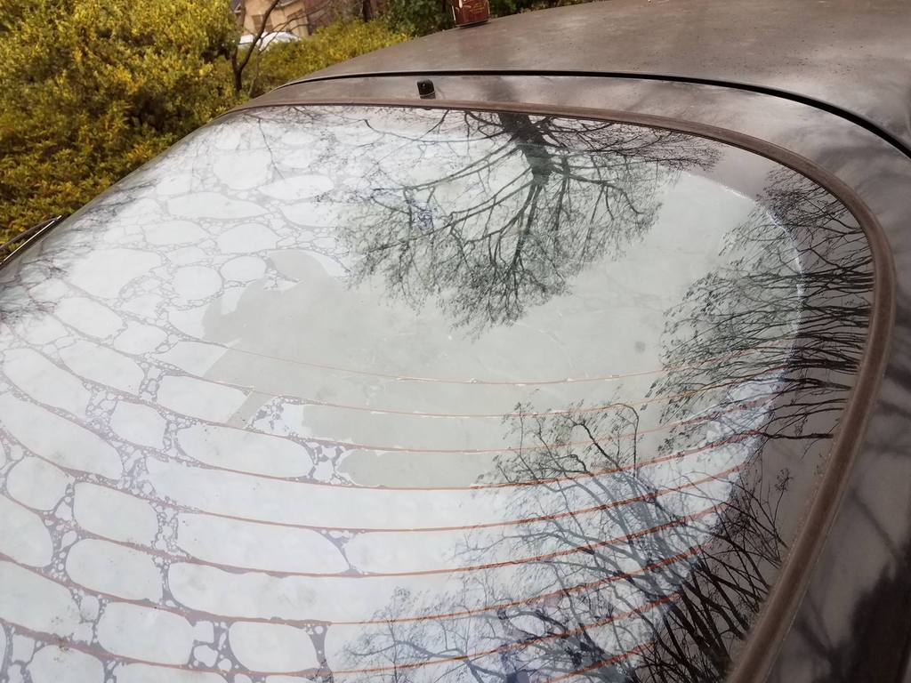

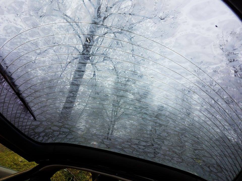

Well enthusiasm has come back a little bit. Since I am waiting on parts again I decided to tackle the horrible bubbled tint. Overall not to bad of a job the front windows came right off. The hatch took the longest time as it was wanting to flake into a million little pieces. But now I can see out of all the windows. The back hatch was so bad you could not see in.
This was the start. You can see how bad this stuff was.
After loads of heat gun I got it down to the glue. Only the drivers window came off clean. Everything else left the glue in place.

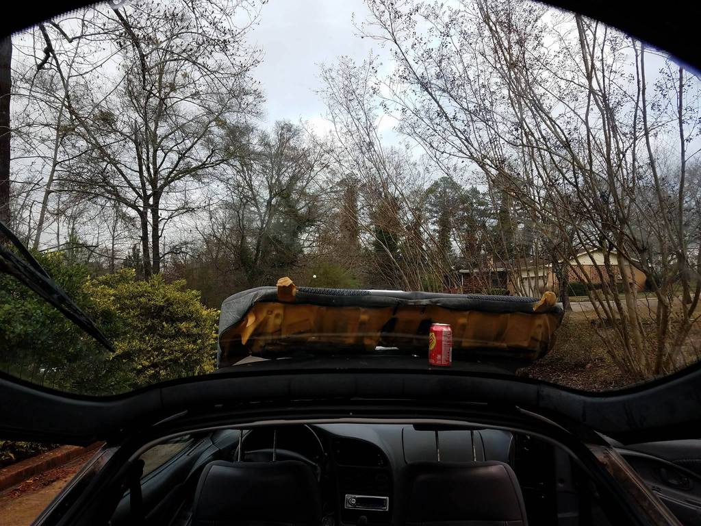

I find the good old Dollar Tree Awesome cleaner works well awesome. Use it on other things and as a degreaser. Anyways it pretty much ate the glue right up. A few coats of that and the back over with some invisible glass to get the cleaner off. There is still some work to do on the hatch around the edges. I figure a warmer day might help get it off. But this was the end product.
Now I can actually see out of the car. I don't know if I will get it tinted later down the road. But for now I am just happy this stuff came off. Tomorrow I hope to have a cylinder head back together. Just need to clean the valves, springs, retainers. Do a valve job on them. Then install the springs and then its move onto the bottom end. Hopefully have it built by the end of the week. With snow being possible Saturday I doubt I will be installing an engine. So got to find a day when I can get some help installing the stuff. Could probably do it solo but its always good to have an extra pair of hands.

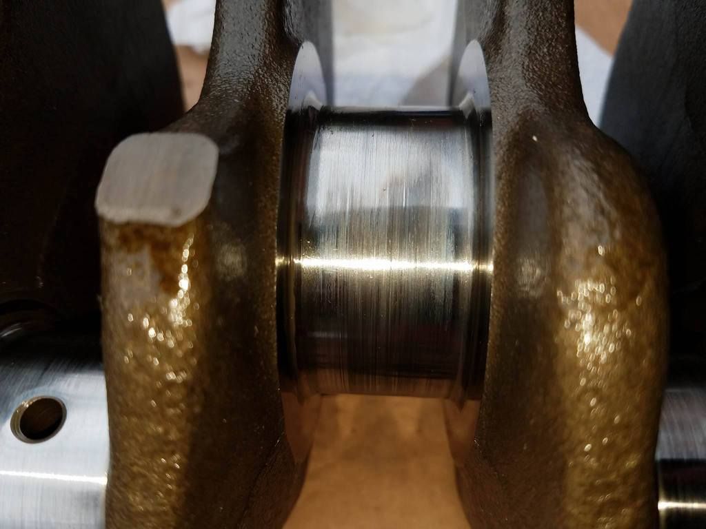

Well more bad news from the talon. Decided that today would be getting the bottom end back together. Went and grabbed the crankshaft to clean it and do a good visual check. When I removed it I took it out then bagged it as it was getting dark. When I had taken the number 3 main bearing out I had found some evidence of something going threw that bearing. Big scrape around the whole bearing. Anyways pulled the crank out of the bag. Start going threw the journals. Front sides all look good lets flip it over......oh no that is not good.
#3 Main
Found this sucker. Fails the finger nail test. Loads of color change. This journal was not happy. So at this point I am not sure what I am going to due. Crank is already turned .25mm. Not sure how deep Mitsubishi hardened their cranks. All I know is I do not like going to .50mm or .020. So I guess this crankshaft is trash. Budget is very low right now so I guess this car gets to sit around some more. Really wished I had taken that 2k offer. I guess I get to decide on what to do with the whole car. Debating doing a part out or just listing it back for sale.
Well no real updates. Been shopping for a crankshaft. However was able to go out today and put the fuel system back together. So that is just ready for some fresh gas. Hope to have a crankshaft soon. See how this car goes. If its like normal very very slow.
