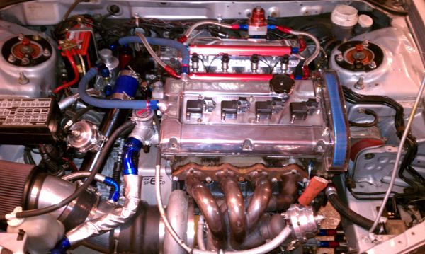

So with the 5 or 6 projects going on at the same time I thought I would post some interior teaser pics :)
Will you know the projects starting to get serious when the cooling system gets its own Turbo :)

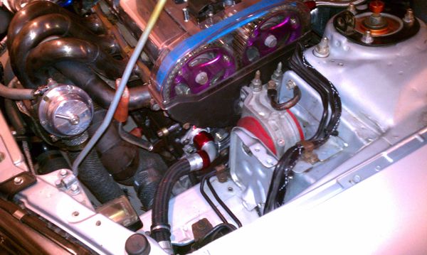

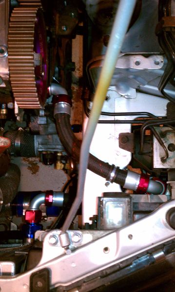

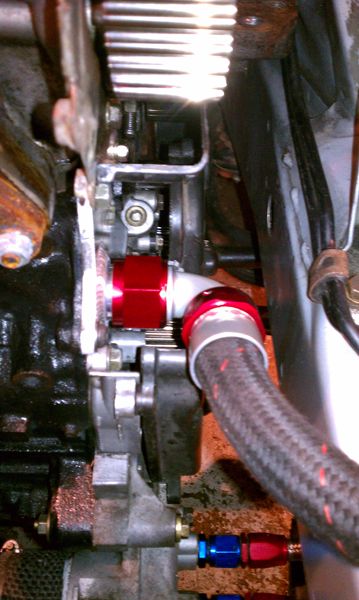

Here's some pics of my setup if you needed ideas for placement of the pump. Granted, I am running a side-flow one-off radiator, but you get the idea. It fits great next to the ABS box in the driver-side fender well and worked out for me since I deleted power steering and had plenty of space to work with!
Good luck!

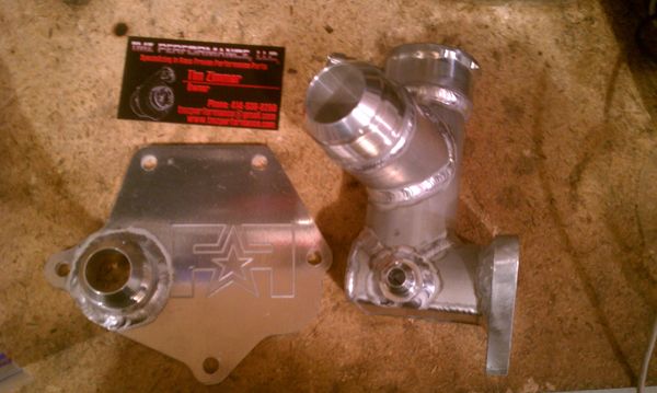

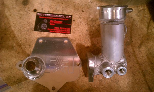

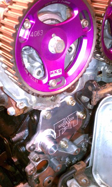

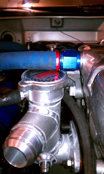

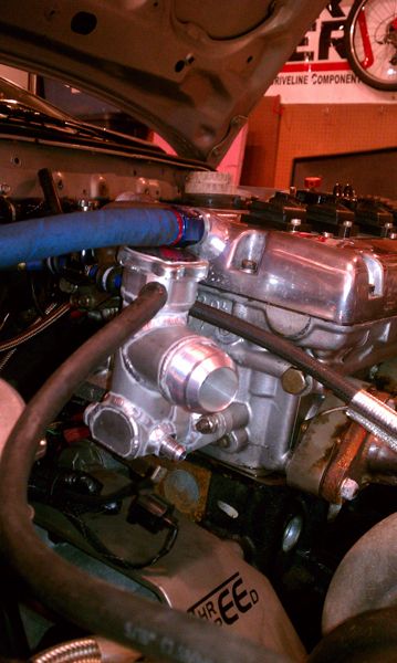

Some people have been asking what the fittings I made are for so here is some more info and pics to clarrify that.
I'm going to be running coolant directly to my head this year so instead of just welding some AN fittings on I decieded to make something that can not only be switched to a different head but also if the AN fitting is damaged that too can be switched out :)
This is the timing belt side fitting and is a tolorance pressed in fitting
This fitting replaces the stock thermosat housing
This is the timing belt side fitting once it was pressed in the head :)
Are you putting coolant into both ends of the head? Thats what I was going to do. The coolant holes in the head need to be made more symetrical and a bit smaller on the outsides and bigger towards the inside to promote more flow towards the center sence your not trying flow coolant a certain direction, but instead from top, outsides inward and down I'm thinking lower side block for exit maybe 2 places.
No I'm not putting coolant in both sides, in one side out the other :hellyeah:
