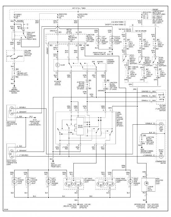

The turn signals work on a 2g by the turn signal column switch sending a ground to the flasher module. It uses a dedicated wire from turn signal switch to flasher module for left & right. The green/blue wire is a grounded in the left position. The green/red is a grounded in the right position.
If you look @ the diagram I posted it may help you understand what I'm saying...
http://www.dsmtuners.com/forums/153384465-post18.html
2gexteriorlamp-jpg.164252
In your case check the green/blue wire that goes into terminal 7 of the flasher module.
See if it has a constant ground. If it does find the short to ground. Disconnect the turn signal switch, check the column harness & main underdash harness to breakout behind the radio.
