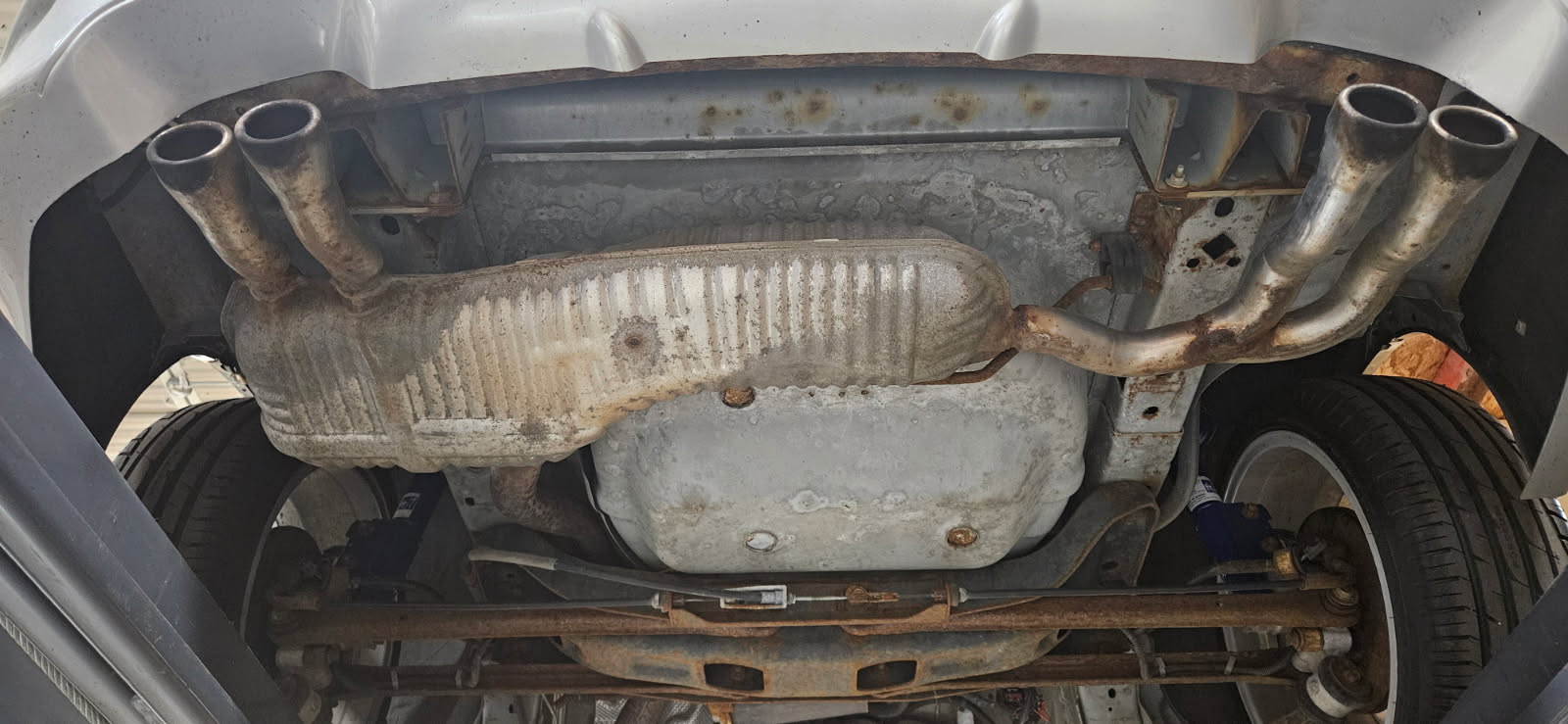

Forgot to show the end of the Grand Am exhaust. Very happy with this. It idles quieter than stock, cruises basically stock, and when I go WOT it sounds a hair more aggressive than stock.
Connecting the passenger-side tip to be functional would have been ridiculous plumbing, and having only the driver tip connected I think would have discoulored that tip and not the other. So I made the exhaust exit sleeper out of the center opening below the license plate, and the tips would the be dummies. This works out good actually as the tips never get dirty and I could really put them in exact placement with no thought of them ever moving. I put about 500 miles on this setup so far and no problem with the bumper as far as heat or carbon goes. I do run about 2 gallons of E85 per tank fill up, so I'm not sure if that aids with a cleaner burn.
Made a "frame" the size of the bumper outlet.
2" bend that I sliced up.
Assembled with a diy cone to go from the 2.5" exhaust piping and capped off the other end with some scrap metal so exhaust can only exit out the framed exit.
Installed.
And the final result. (stock)
Installed.
I'm surprised that you could even do 2 gallons of E85 in it
I figured factory the ECU is targeting rich like ours does so there was some room to mix it in. Always wanted to try it out on a stock car of this era to see if it would work - and it does. I just wish I could physically adjust for a couple more * timing up top to see a true benefit of doing it. I thought of physically modifying the sensor to clock it, but never pursued past the thought.
I do see HPTuners supports this car which is seriously amazing and maybe a good opportunity for me to learn a new language aside of dsmlink.
