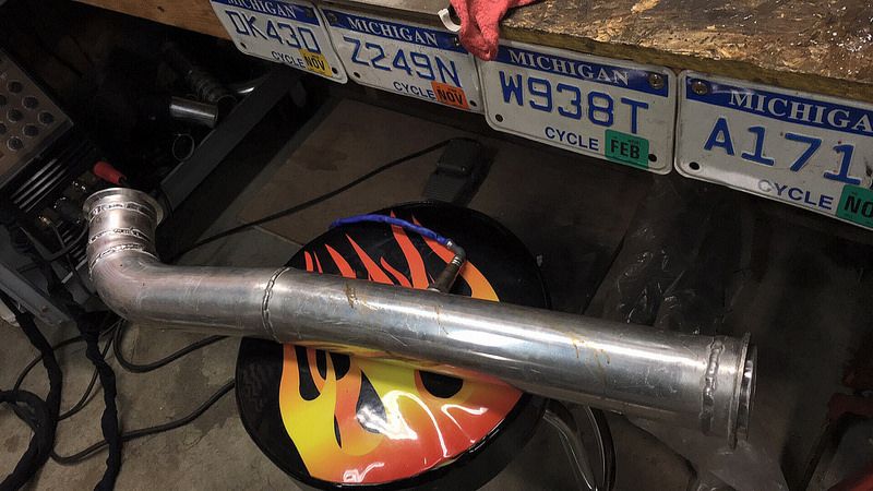

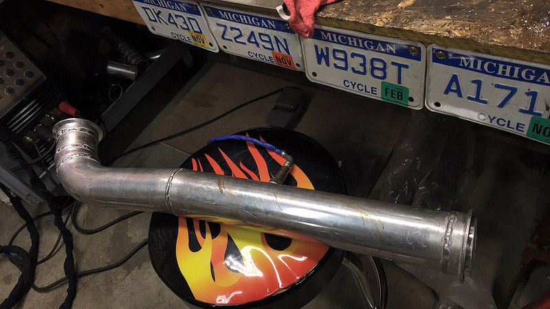

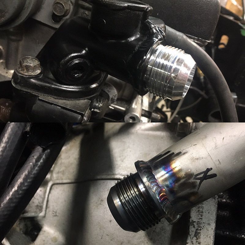

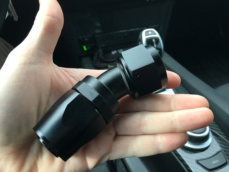

I saw somebody selling that upper pipe on the classifieds today and I was wondering how difficult that would be to weld. I actually don't like the look of AN lines but I'm sure yours will look great.
It shouldn't look too bad since all the lines and fittings are black.
Welding shouldn't be too bad. I just have to make sure everything is super clean.

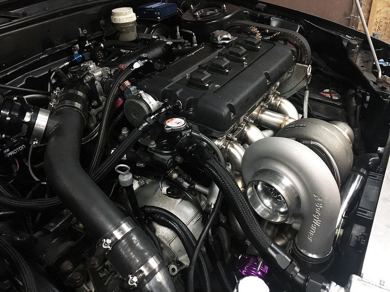

Fired it up last night and all is well!
Had to re-do the turbo outlet side of the downpipe as the angle was off a bit.

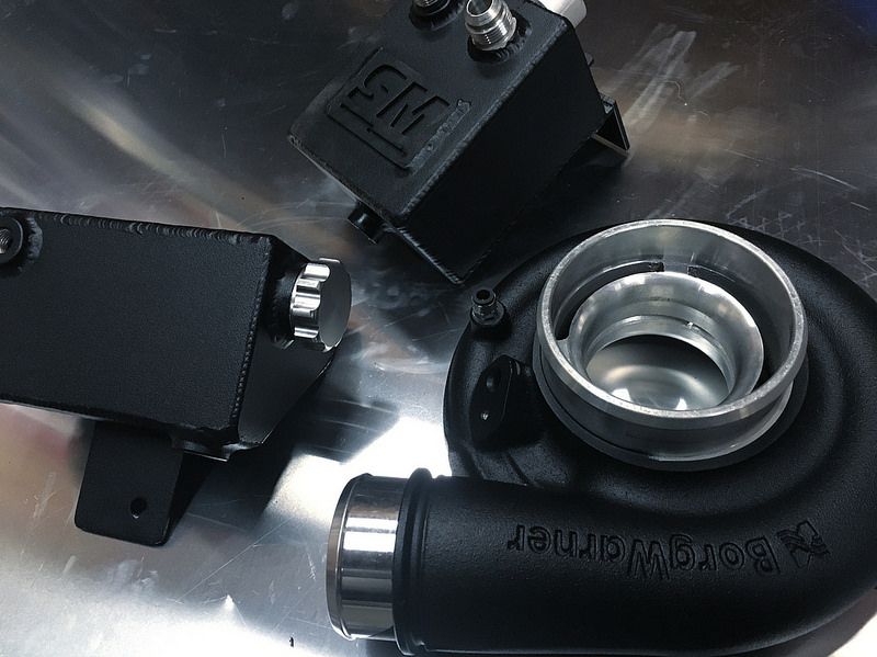

I am going to get the compressor cover, catch can and overflow bottle powdercoated wrinkle black and I think that'll do it for the engine bay.

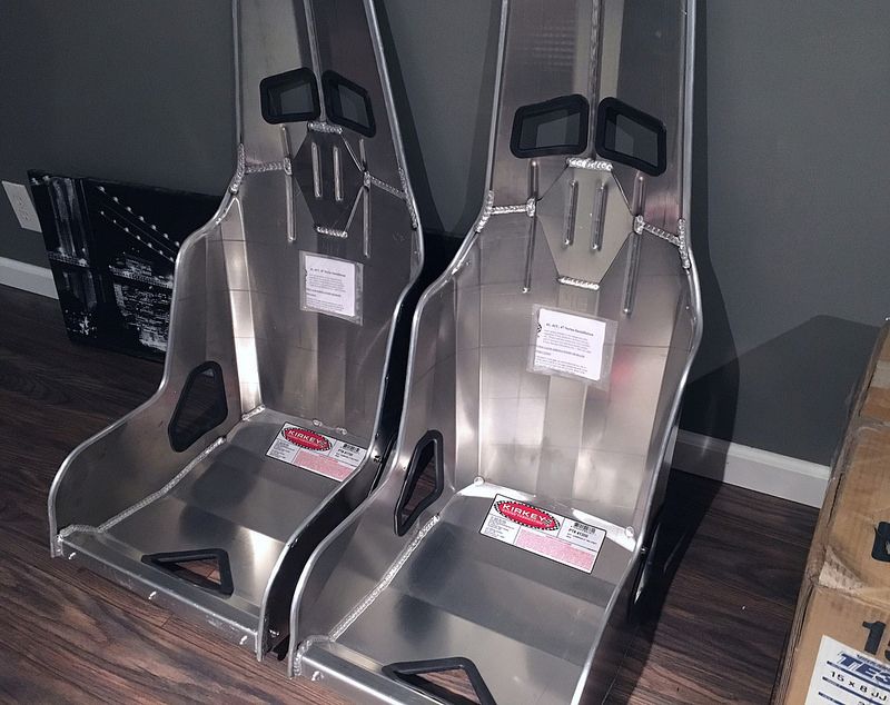

Next task is to work on getting some weight out of the car. I already ditched the leather front seats which were roughly 40lbs each. I am going to replace those with Kirkey's which weigh 11.5lbs each (15" width). Aluminum driveshaft is on the list as well.

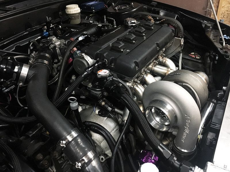

Powdercoated the compressor cover, catch can and overflow bottle.

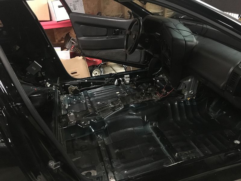

Kirkey seats arrived. Needed to get these before the car goes to the cage builder next month (getting an 8.50 certified 10pt).
Getting it ready for a cage.

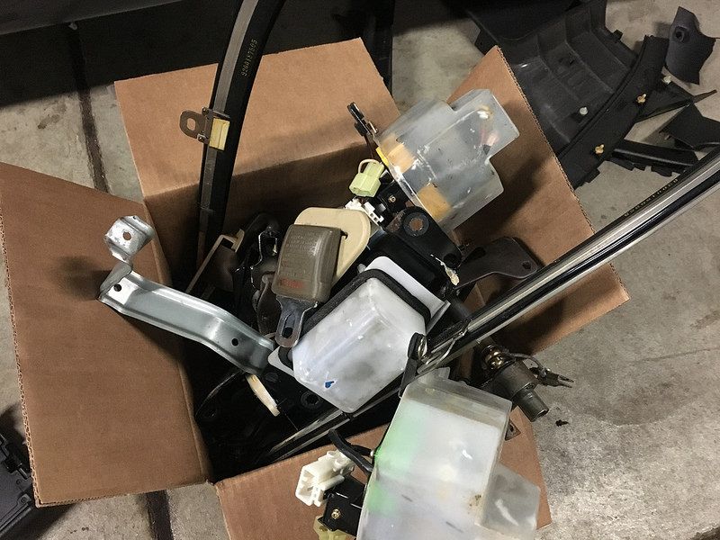

Factory front and rear seat belt systems removed. 40lbs total
Factory front leather seats were 48lbs each.
Going to be removing all the sound deadening with dry ice. Hoping for a good chunk of weight gone from that.
I didn't know you didn't have a cage in that car. Are you putting an 8.50 cage in or just a roll bar?

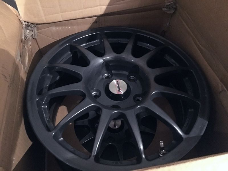

Nice score on those wheels! :thumb: The car is coming along nicely and looking good.
