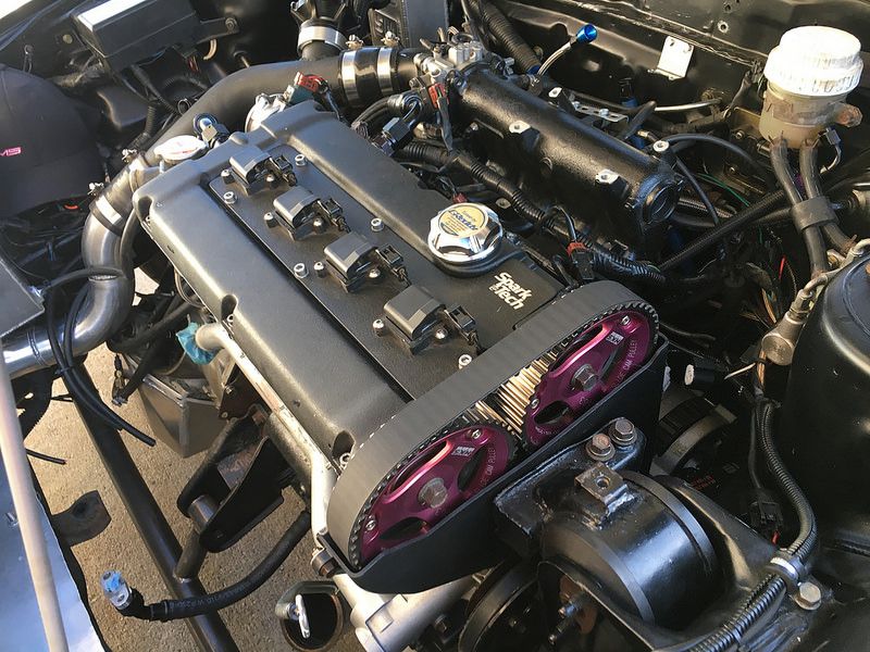

He drilled and tapped the valve cover to put the baffles back in.

Nice the new valve cover and fittings look good. Did you put the baffle back in? I'm thinking of leaving mine out.
The original valve cover I ran that I modified in this thread did have the baffles put back in. I drilled and tapped it.
I now have a different valve cover that is shaved without baffles which has two -10 fittings on it. I no longer run the HAL cap.

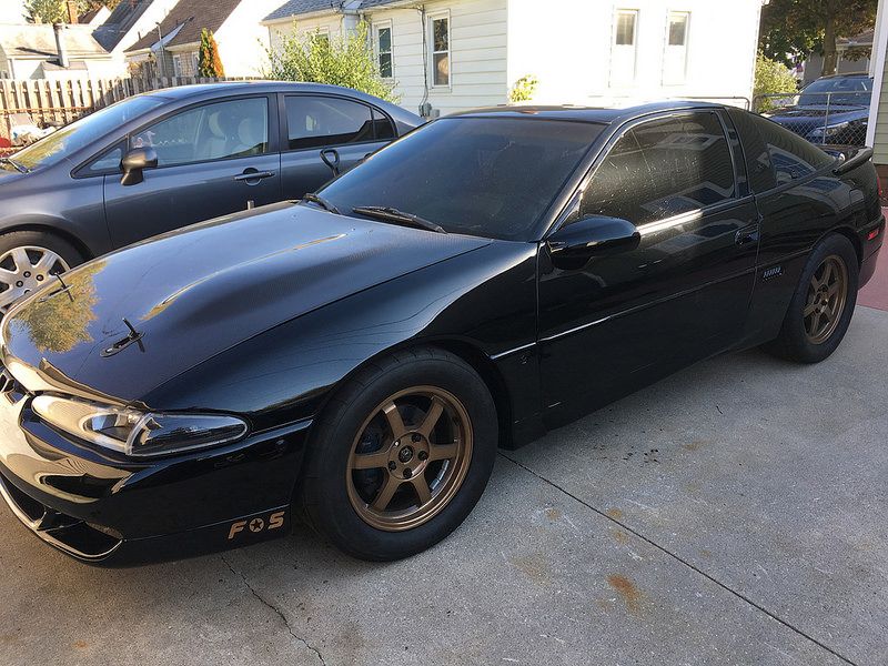

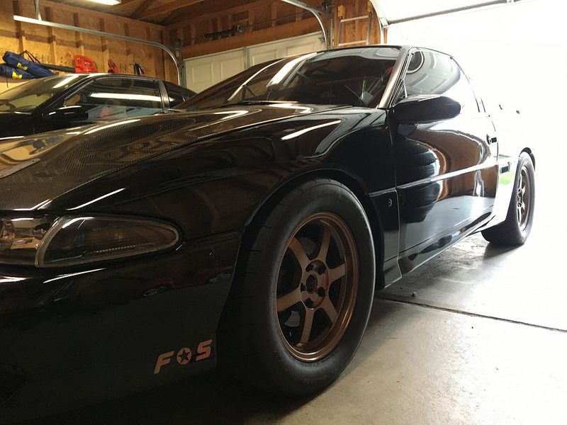

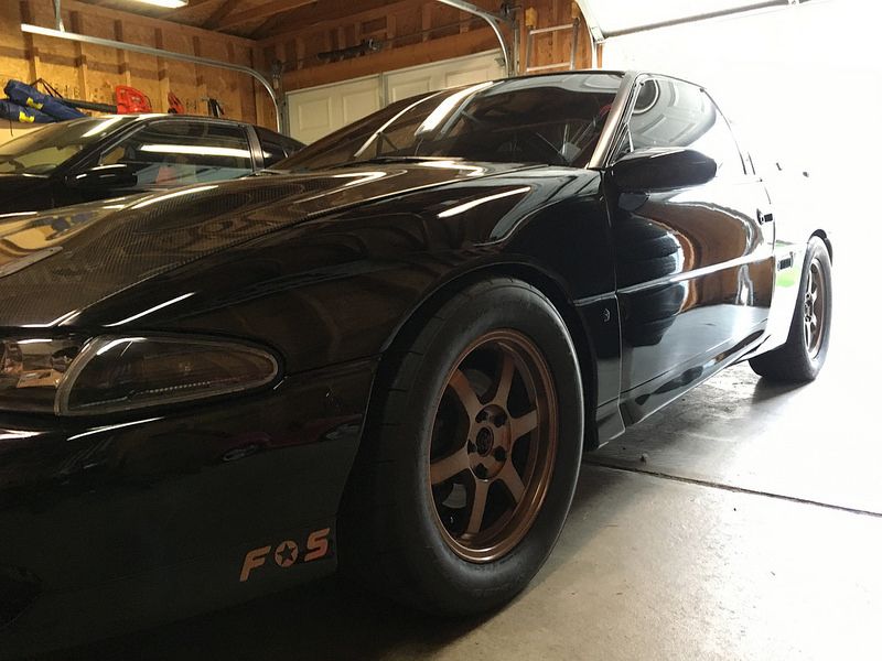

Decided to have a dedicated wheel/tire setup for the street.
16" Rota Grids with Nitto 555 tires. Fitment is perfect!
Here's the new valve cover I mentioned.

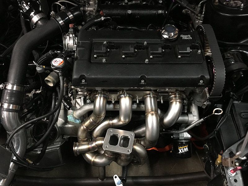

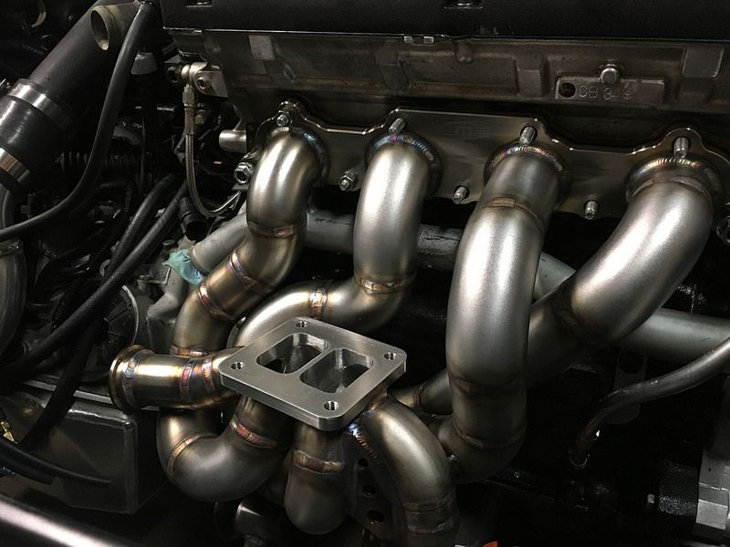

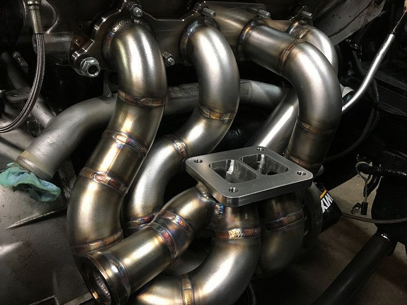

Exhaust manifold is on its way! I ended up going with a JM Fabrications T4 divided top mount.

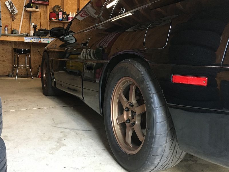

I was gonna throw a baffle back in mine. The guy that did the welding for me burnt it up pretty good so I'm gonna cut it out and probably leave it out. I also have -10 lines welded in the stock location. Keep posted on how fast the catch can fills up. I knew you'd keep those wheels they look great!
I'll be sure to let you know.
The car that the valve cover came off did not fill the catch can without the baffles after a few WOT pulls. We shall see how it is on mine.
Got the manifold on. This thing is perfect.
I probably wont be ordering the turbo and wastegates until early December, but its progress!

What offset are the grids? are they 16x7? I've been wanting to get on a 24/45/16. How wide do the tires measure?

The manifold looks great. JMFab is one of my favorite DSM venders. They make amazing stuff. Let us know what you think about the S90 when you get it in!

Love the tire wheel combo!!!
I agree they look great. I may change the color but i'll leave them for now.

I checked and verified they are 16x7 Grids with a +40mm offset. I'll have to measure the tire width as i'm not sure.
