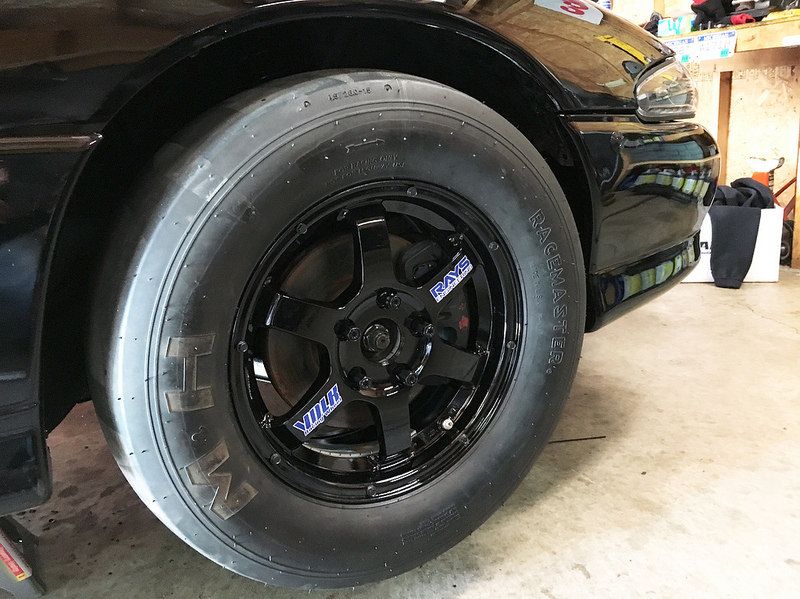

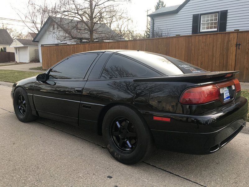

Found some wheels I've really wanted. 15x8 TE37's. They are currently wrapped in brand new M&H 26x8.5 slicks however i'm going to have to eventually swap these out for DOT's so the car is class legal (IFO & Shootout).
I need brakes next....

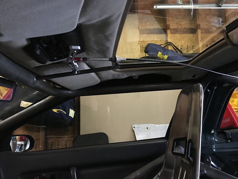

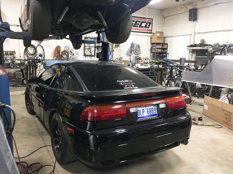

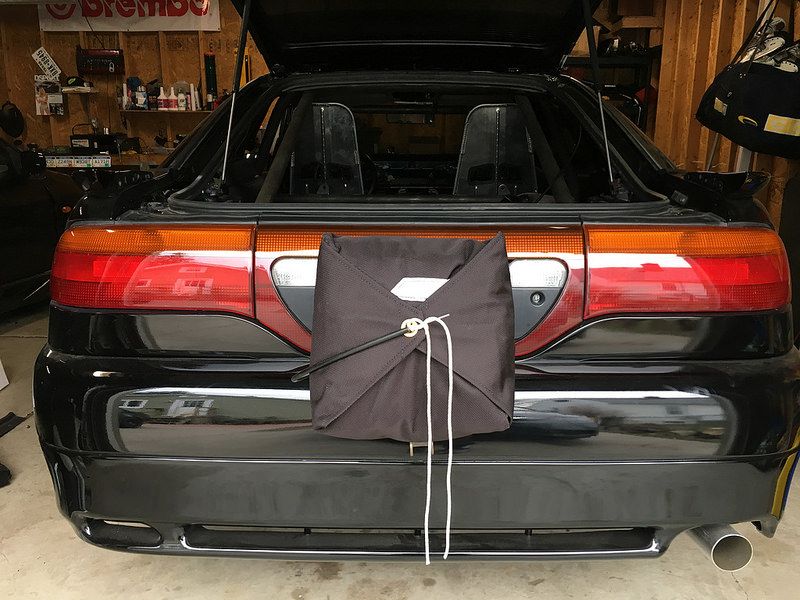

Also was able to drop it off last night at Diamond Race Cars in Ohio for the cage. 10pt 8.50 with kirkey's and parachute. The chute will be removable so it can still appear to be a stock body street car.
Dang didn't that have clean black leather? Are you going with carpet or just spraying the interior with the cage and leaving it race car?
Yeah, it had a super nice black leather interior. The car will still have a full interior with carpet and rear leather seats. Only difference this time around will be a cage and front kirkey seats. Factory front seats were close to 100lb for both, the kirkeys are 11lb each :)

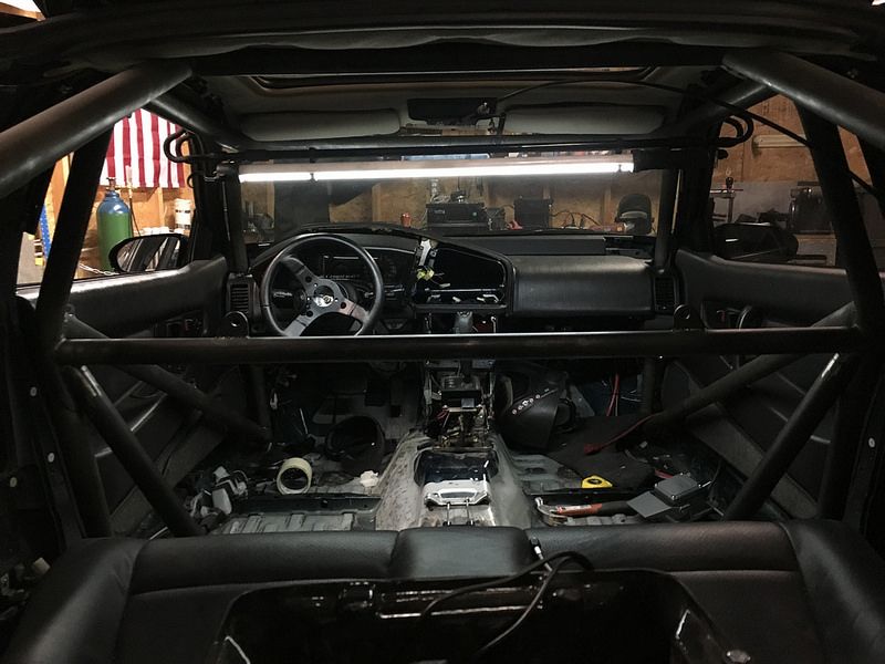

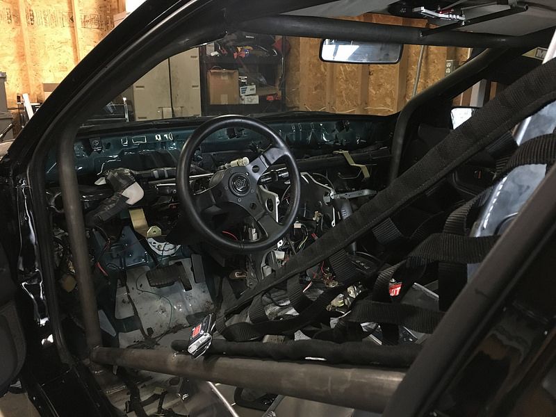

Picked up the car last week from the cage builder. It came out really good. Fitment is excellent and very tight to all the panels and roof. I'll get some photo's this week of it (it was dark and I left for TX2k as soon as I got it home).
Hoping to get some time by this weekend to paint the cage and get the interior back in.
I thought that too until the first time I had to go under the dash. Holy hell it was terrible, Mine comes out but it's not a normal swing out, it unbolts at the floor, and pulls out of the main hoop. I just have a 5pt 10.0 bar though.
Hopefully with an auto you won't need to be under there much.
Yeah, going under the dash is hell. I dealt with the same thing with my last car. If I have a big project i'll just pull a seat so I can lay down haha.

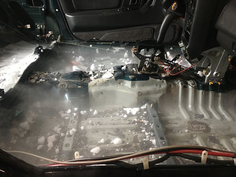

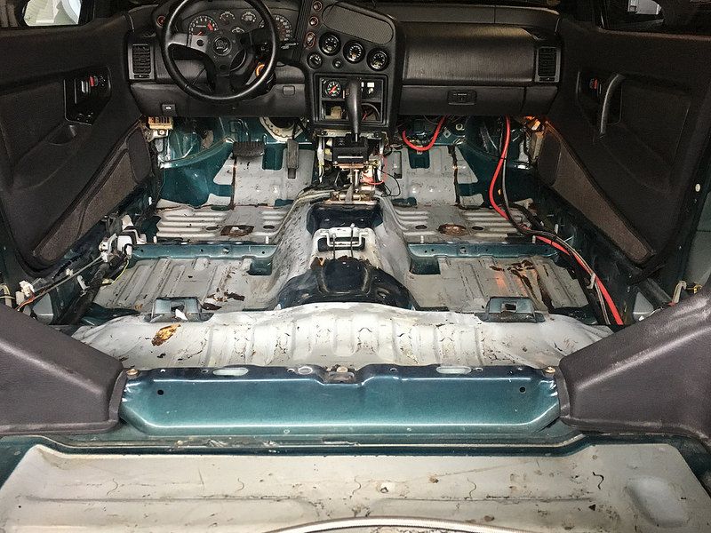

Looks great Scott. I just ripped apart my interior and stripped out all the deadening. Trying to figure out if "coating" the floor with a black bedliner is going to be much heavier then just spraying it a flat black.
Awesome man! Jealous of that paint and your cage!! Nice to see we are both still rocking with some progress! Keep it up!
Thanks man! Excited to see yours finished as well!
I'd just spray it black. Unless you plan to run carpet, then don't even bother like me. Lol

Thanks sir. I bought an aftermarket black molded carpet from Rock Auto (ACC is the brand) which I removed the padding from underneath. It only weighs a few lbs now.

Just wondering, why are you selling the TE37s?
I'm the worst when it comes to keeping wheels LOL. I need a DOT tire for the classes I plan to race with, so I figured i'd see if anyone wants the whole setup. I could use the money for a few other things like a better oil pan, driveshaft, etc.
