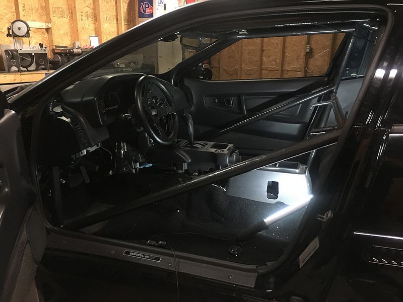

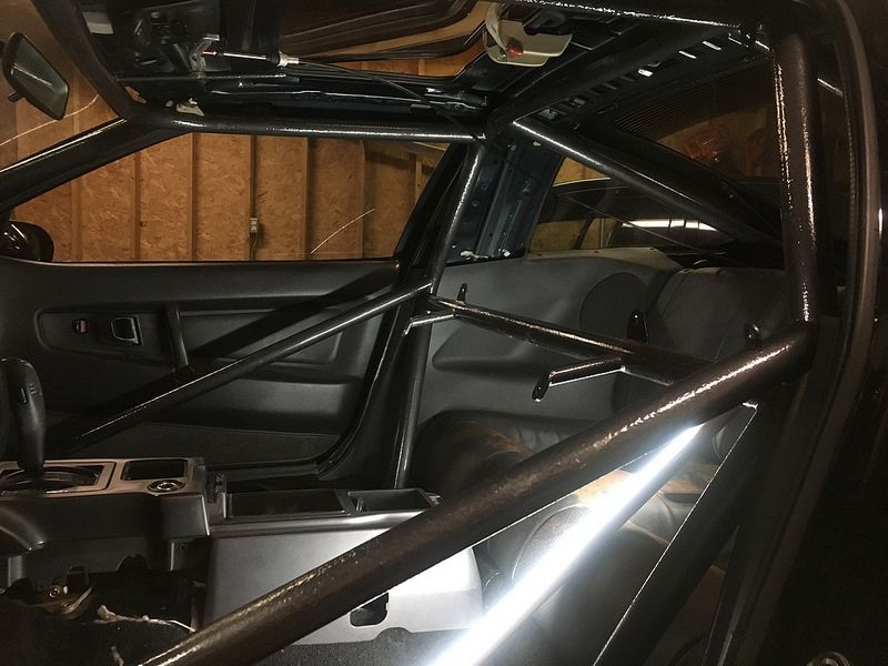

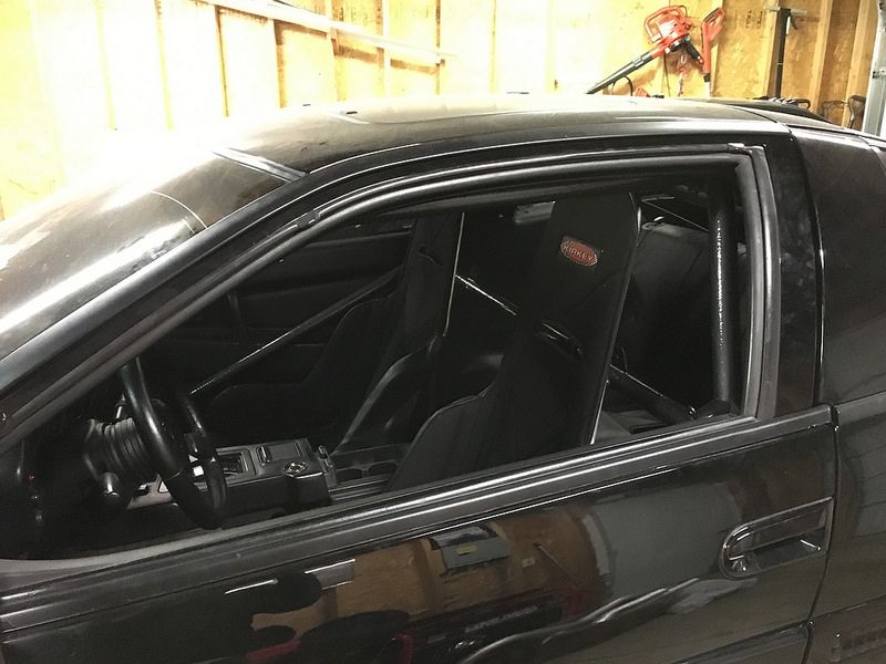

INTERIOR
Doors must open and close from inside and outside the vehicle. No center drive configurations. All seats (front and back), door panels, dash, and carpet (front and back) must remain inside vehicle.
No one really cars about the headliner.

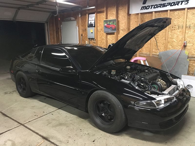

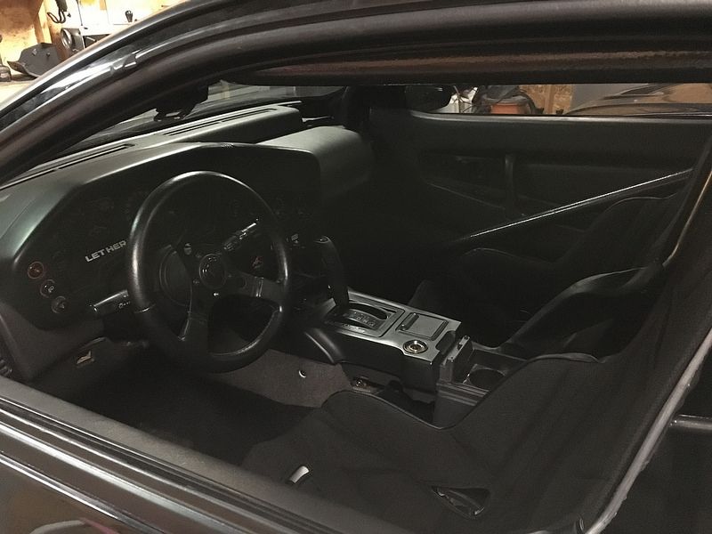

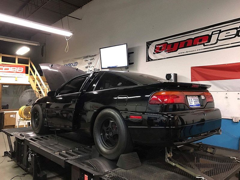

Buttoned of the rest of the car last night. Dyno is this evening.

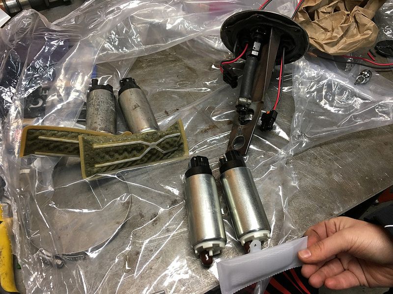

Found a completely dead full pump. Threw two new ones in to be safe.

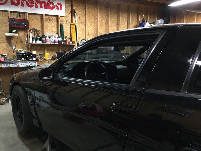

Interior all together. Feels much nicer.

Everything went well. The car is performing flawless as usual.
Car made 611 on the dyno. Left it at 40psi.

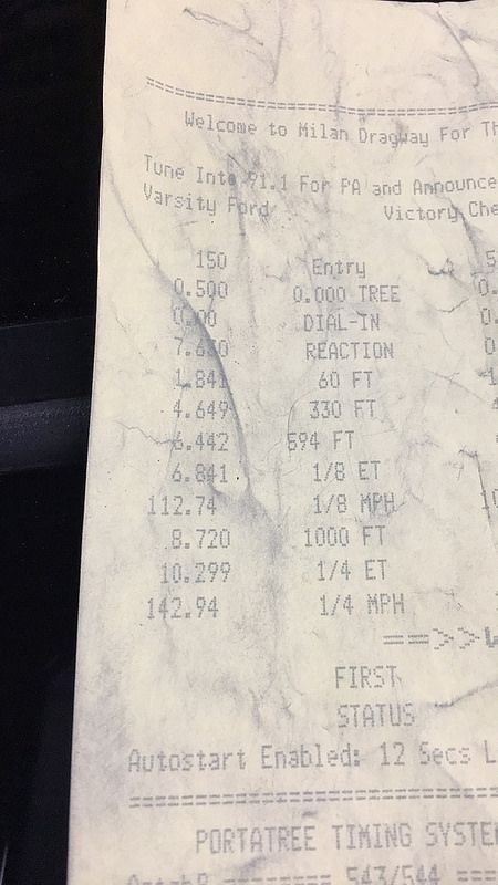

Track also went pretty well aside from it being packed for opening day and only being able to make 1 real pass and the slow stall. I was only able to leave at about 5lbs of boost. We are tuning the stall this week so I can leave at 15-20 lbs.
Based on how it did with a 1.84 60', i'm going to guess the car is going to pick up at least 6mph and .8 in the ET with a 1.4x 60'. Last year, my car would trap at 132/133 with a 1.8 60'. Car is way up in power and it feels incredible. Next track visit will be IFO Hebron in 2 weeks.
