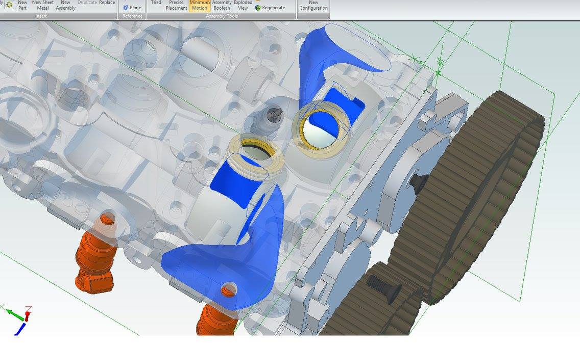

Here is a pic showing the valves and porting thru the rotary valves. The head is oriented upside down with the combustion chamber of cylinder one about center screen, the cam belt gears, fuel injectors, and spark plug should give reference to what is what. I have both valves half open to try to aid in visualizing the geometry. The intake and exhaust ports are highlighted in blue.

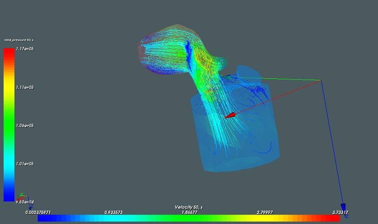

This is some CFD results I played around with. Its really nothing more than a cool looking picture. I would need to do a lot more work and study to get anything meaningful out of CFD.
