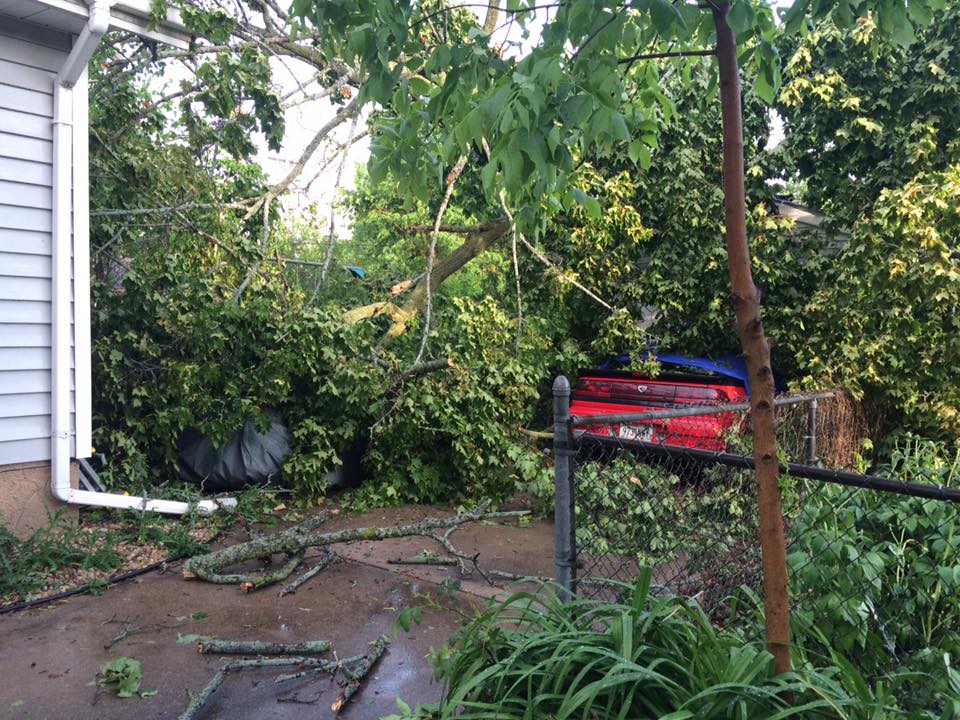

May 17, 2017. It was a Wednesday. My family had just sat down for dinner and I can distinctly remember looking outside of the window and seeing how strange the sky looked. I had been through a tornado before and there was a similar feeling in the way the air felt but I tried not to think about it – we lived in the city, after all… storms don’t come to the city, right?
We cleaned up and the sky continued to look worse. My husband, Matt (Mr Peepers), and I decided we should get the cars covered up – the weather app on my phone said hail was on the way. We had just gotten the fixtures from Ron Shearer (of Shearer Fabrications) for the DSM/Evo platforms and we had scattered them all over the garage so there was no room for our talons… We were in the middle of covering the cars with blankets, tarps, covers, and I said to Matt, “I’m going to go in and check on the girls quick,” since they were watching The Magic School Bus on Netflix. I heard a strange crack but thought it was nothing more than a goofy bit of lightning and was going to get a drink of water before checking on the status of the car covering party. Not seconds later, Matt was running into the house and looked petrified.
I remember asking, “What’s wrong?!?!” and he just looked at me. It was almost like he was at a loss of words and I sort of thought perhaps the lightning strike was just too close for comfort. Then he said it. Three words I’ll never forget:
“The tree fell.”
^you can barely tell, but the garage is destroyed and there are two talons in that photo – mine was just heavily covered with branches and hard to see (left under car cover, Matt's is on the right)
I remember asking if the cars were okay even though I knew they wouldn’t be. The only tree that would’ve fallen was old and massive. Falling to the ground and sobbing, the initial feelings of loss took mere seconds to kick in. However, the loss of the cars was nothing in comparison to how close I was to losing my husband – it sounds tacky but he legitimately did have to run for his life while the tree came crashing down at him. Our garage was destroyed and there was also damage to our home. The whole devastating ordeal felt like losing a member of our immediate family.
^If I had to pick a 2017 recap photo, it would be this one. Months of cleaning up and trying to rebuild our lives; throughout the entire devastating ordeal, we smiled because we had each other and our family was safe.

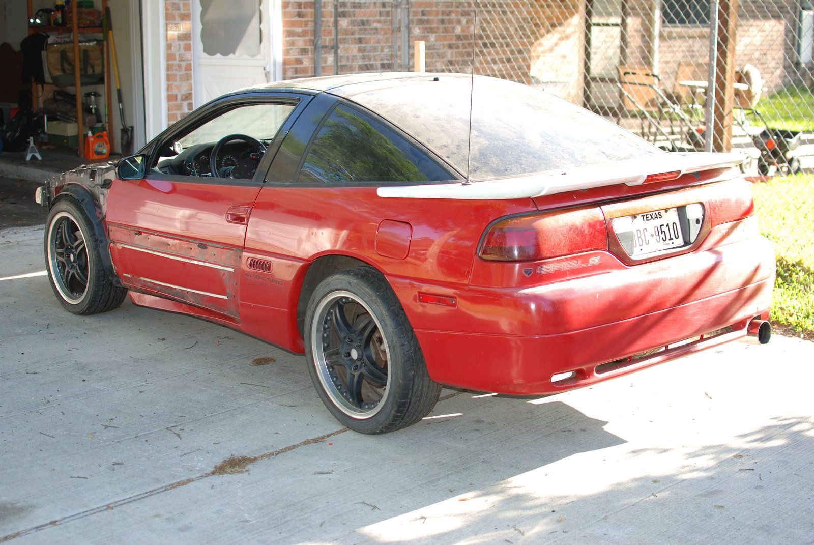

On July 8, 2015, I had made a Facebook post asking the universe to find me a clean red 1ga because I had been missing my first DSM (owned it from like 2002/03ish to 2012). It was almost mockery because I knew how difficult it would be to find one in a similar condition as my first but a friend of mine, Cong (fenixtx717), tagged Matt in the post saying if I was lucky, Matt might sell me his extra shell.

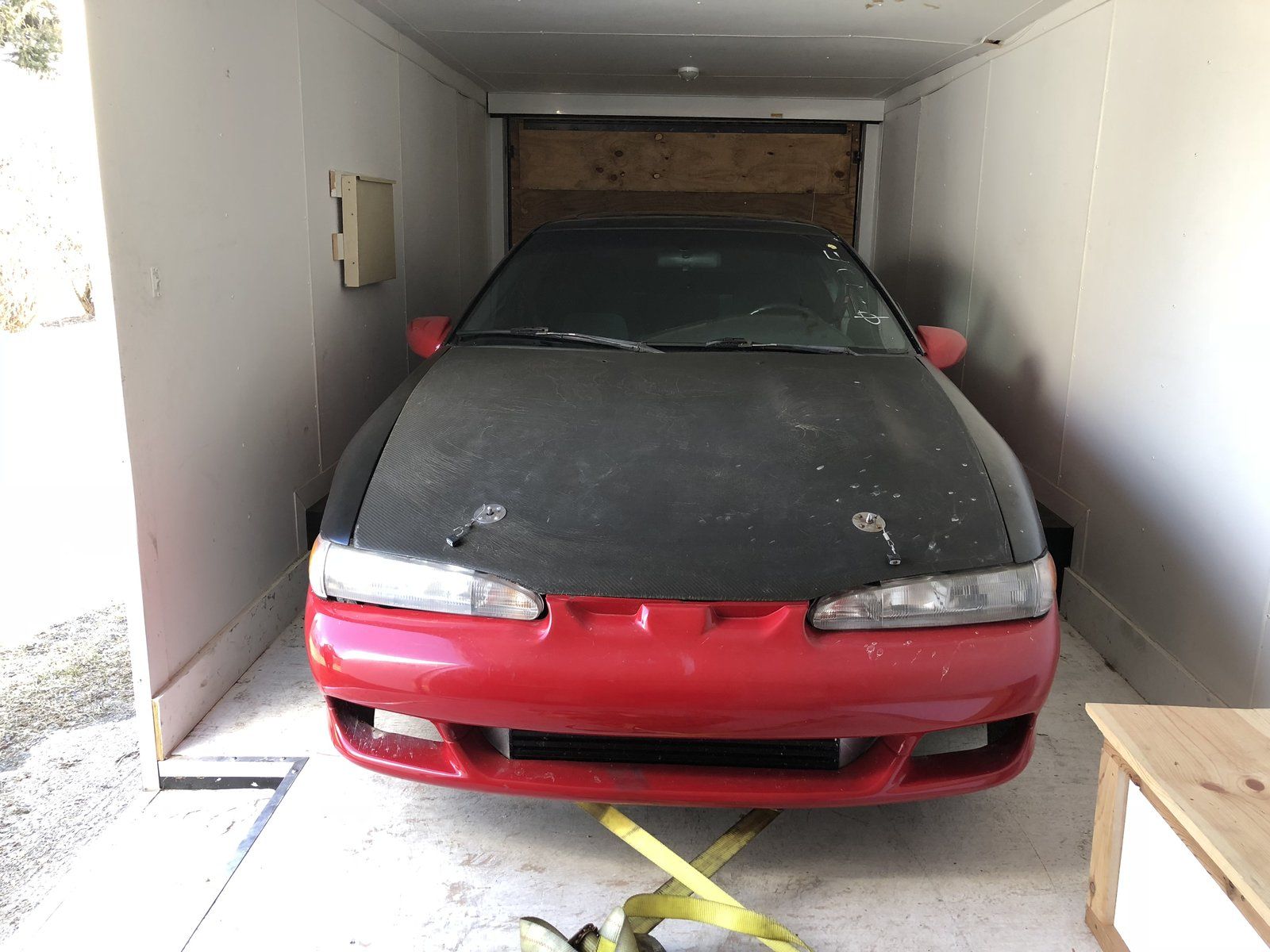

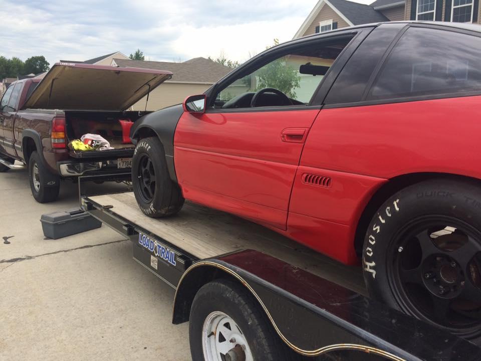

After driving for what felt like decades (even if it was only like 9 hours), we arrived to JP’s beautiful home in Ohio. He was legitimately one of the nicest sellers we had ever dealt with. We loaded up the car – with our Hoosiers and all – and were ready to head on out. We bought the custom intercooler setup that Ron had made for it too: A super great inclusion! We even got Ron’s original license plate from when he named the car Prototype (we since sent it back to him).
After chatting for a while, we decided it was getting late and we needed to hit the road. A police officer stopped us before we could get into the truck and asked us what was under the car cover. So we told him and it turned out he was an avid DSM enthusiast who used to run them streets at one time too. It was a pretty neat chat!

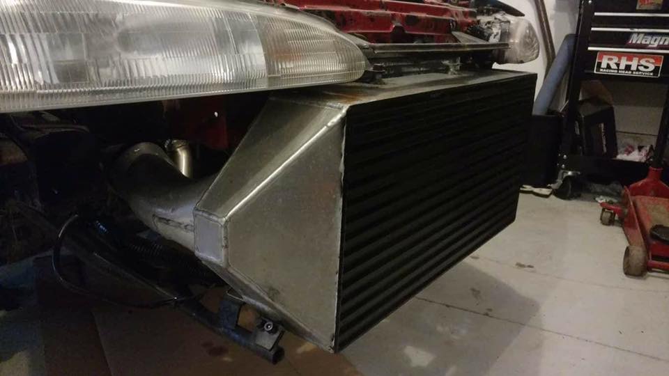

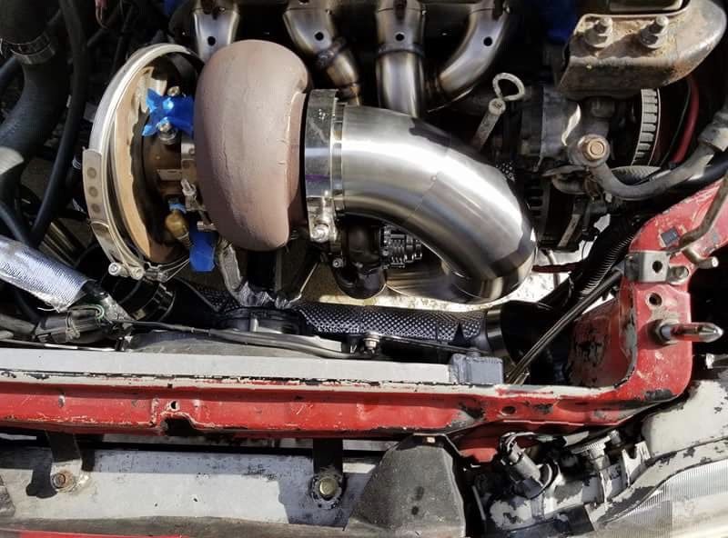

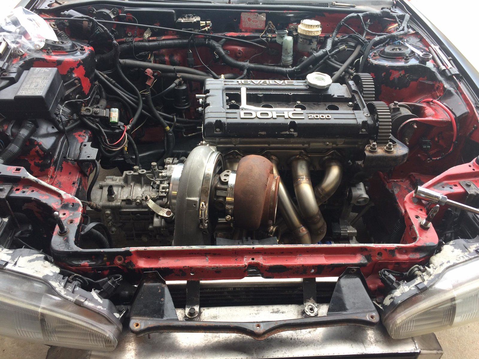

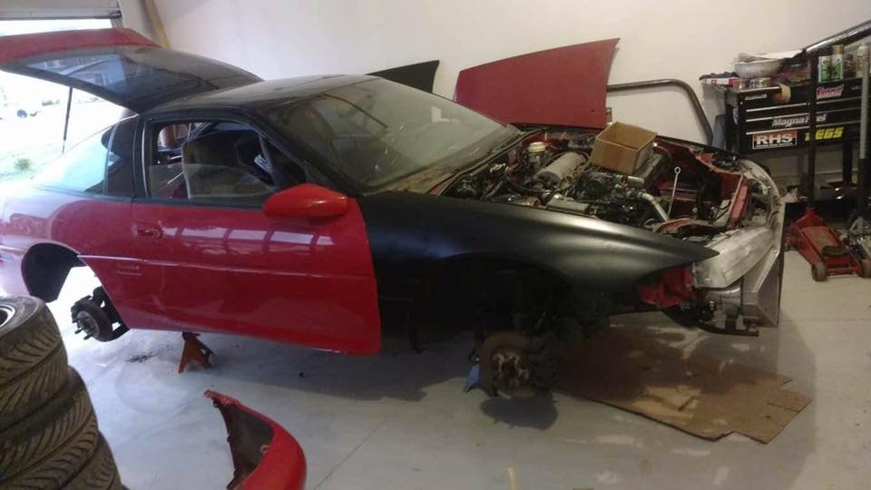

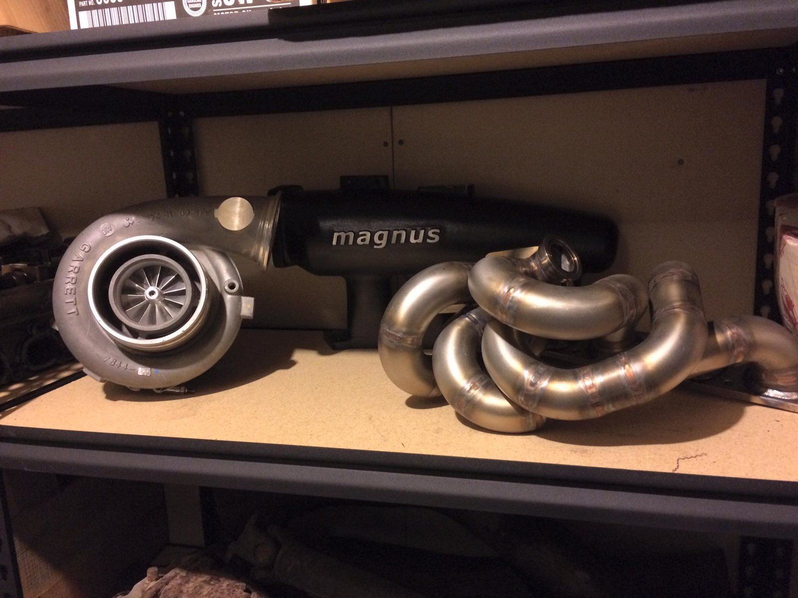

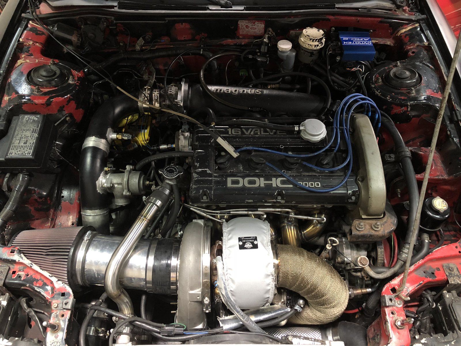

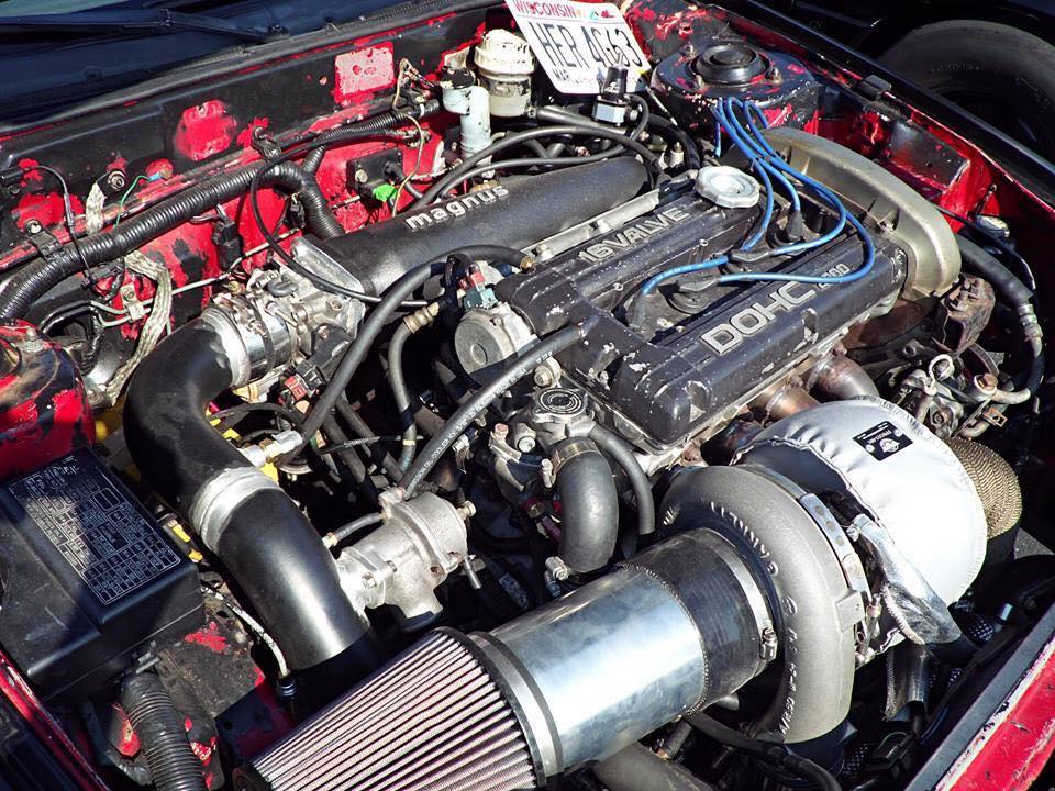

We knew we needed to get a car running and ready to get fitment and testing done. The plans that I had for the 5-speed turned into plans for Prototype. I had the turbo, Shep trans, intercooler setup, intake and exhaust manifolds, cams (and quite a bit of everything else, ha!) and we were ready to get this thing back on the road.
My goal for the car was to be able to get down on the street and the track, yet also something capable of daily driving. It was a tough decision between finally going auto or staying a stick car. Ultimately, I’m the kind of person who really loves – yet hate with a strong passion at the same time – the inconsistencies so I kept the car as a manual (and continuing to have both an auto and a 5-speed sounded nice to my husband). Still, some days, I contemplate converting...but I know I won’t.

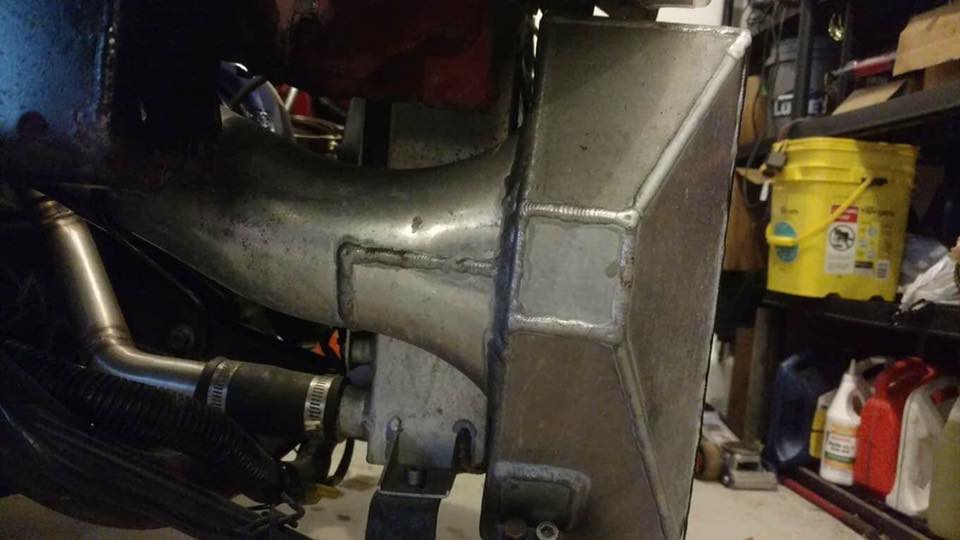

Two weeks after purchase, a pretty badass car was running. This car had turned into everything I had ever wanted it to be (well, outside of the shell not being my now wrecked 1ga). All fabrication was done in-house –outside of the exhaust manifold – with my and my husband’s business, Morrison Fabrications. I wanted to avoid a side/hood exit at all costs and that took a bit of magic but that goal was accomplished. Overall, everything went [fairly] smoothly without many hiccups. There were some small things that didn’t get done right away but because it was just super exciting to get it running so the whole, “it’ll get done later” mentality kicked in (we all do this…right?).

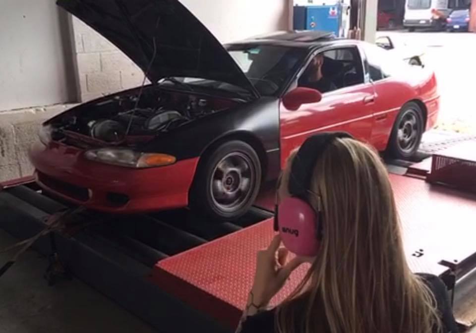

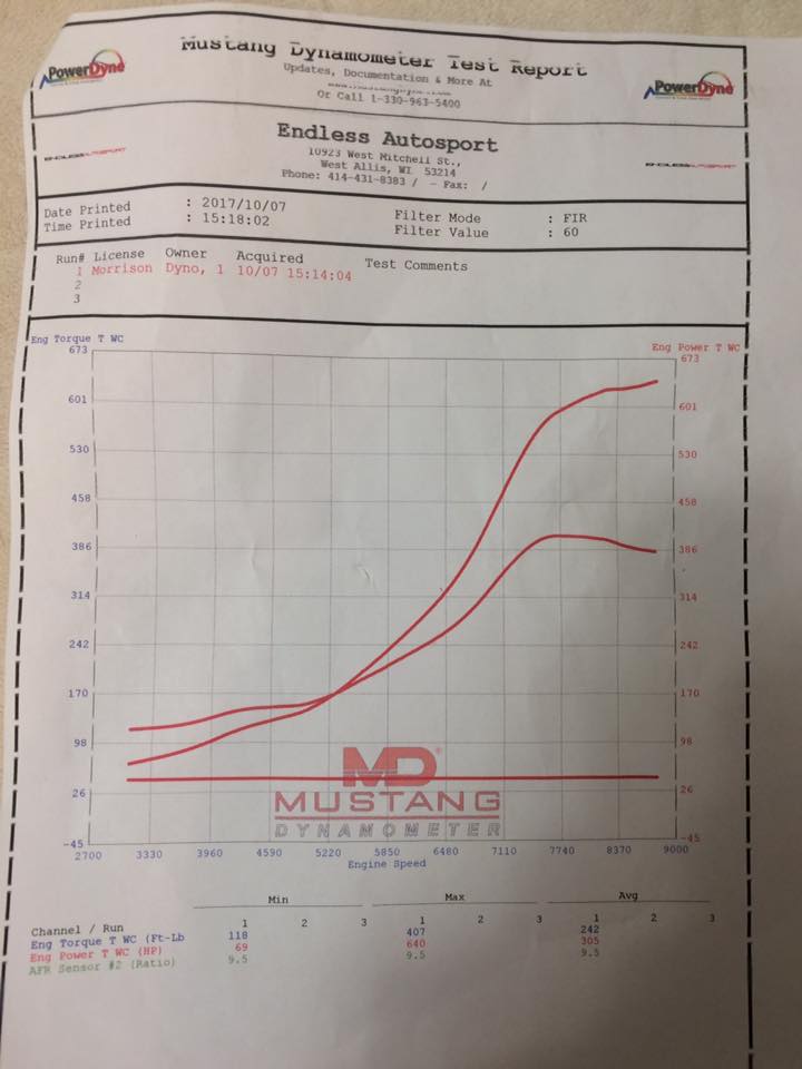

In October of 2017, I took the car to a friend’s dyno event at Endless Autosport in Milwaukee. The car still wasn’t 100% complete – it was missing the secondary injectors and dynatek, and only on a 3-bar map. Knowing that it wasn’t 100% done, I couldn’t turn it up beyond 30psi but it did everything I hoped it would: 640awhp (647 corrected)/407tq on a mustang dyno. The power curve was healthy and right where I wanted it. And my friends laughed at me for wearing pink earmuffs at the event (pfft, we will see who is laughin’ when I can hear at 60 years old and they can’t though - that car is just...loud).

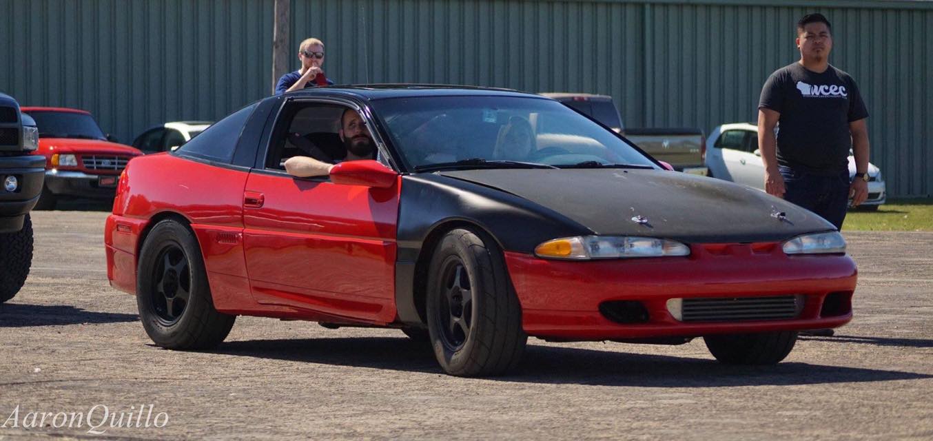

Noticed that (them never being done), as well, throughout the years! It’s always a process and even when the car is “done,” there’s still a next chapter in the story. On the several I’ve owned throughout the years, this one is the only one that I’m content with staying in the current pages of its book :)

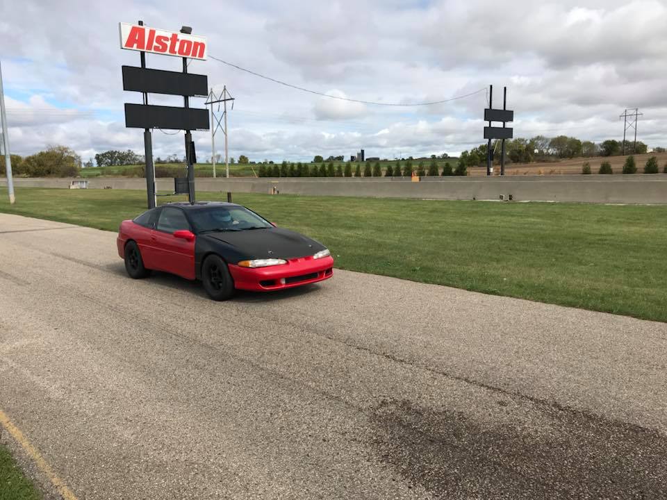

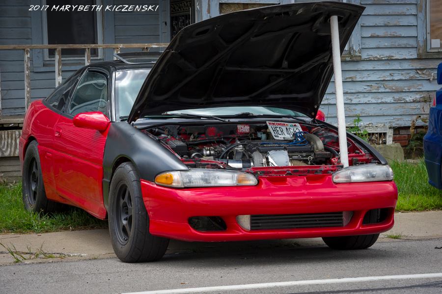

Funny story on the terrible fenders – Ron was snow drifting and crashed which is how these black ones came to be. They help my hustle so they’ll probably stay; nobody expects a car that is two different colors to do anything cool around here. I enjoy the way they underestimate it ;)

I love how the car sits.
what tires are you running? and whats your suspension setup?
Thank you! Pretty happy with it, as well :)
KYB AGX
Eibach Prokit
Rota Slipstream Wheels 15X8 with M/T ET Streets

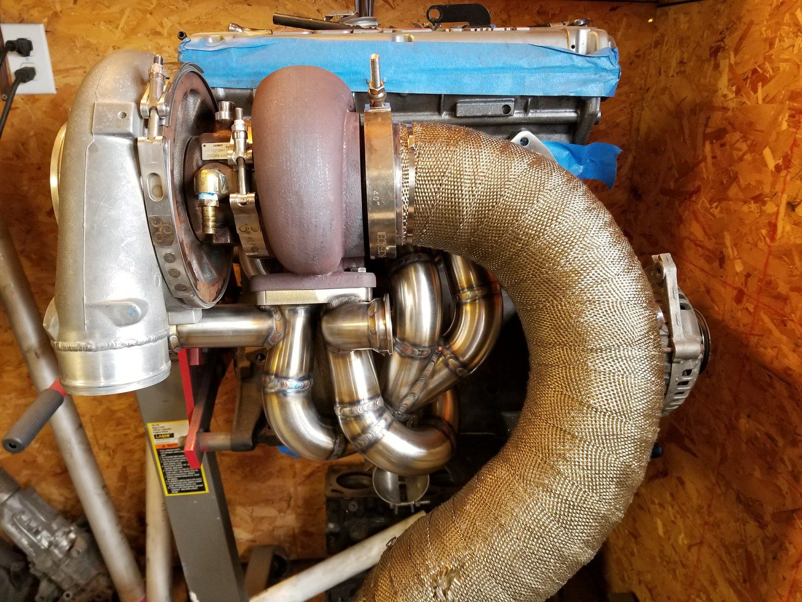

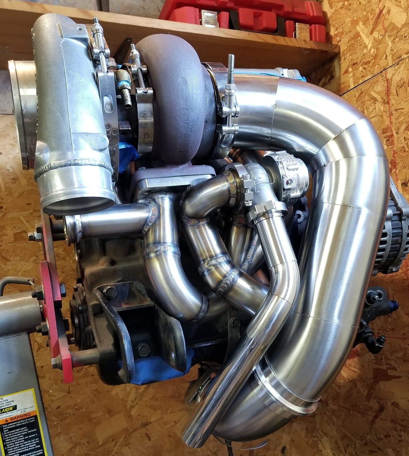

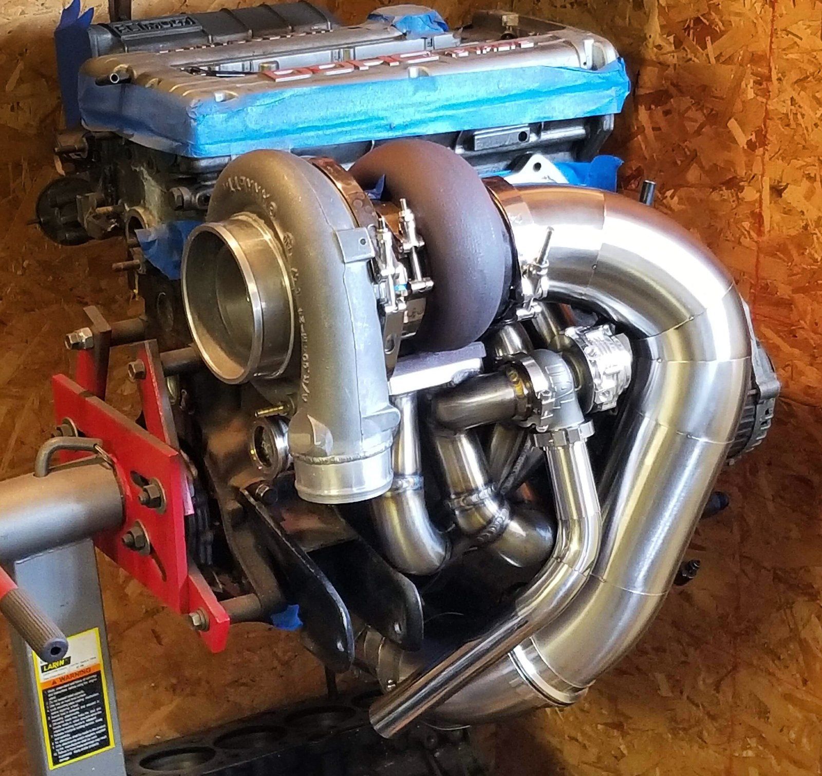

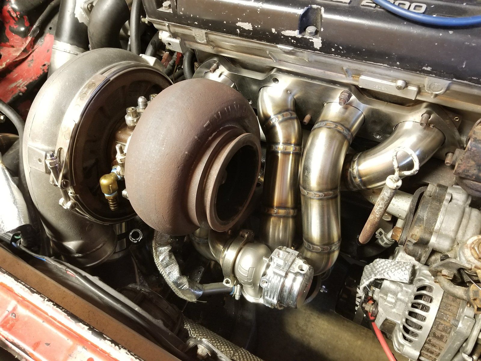

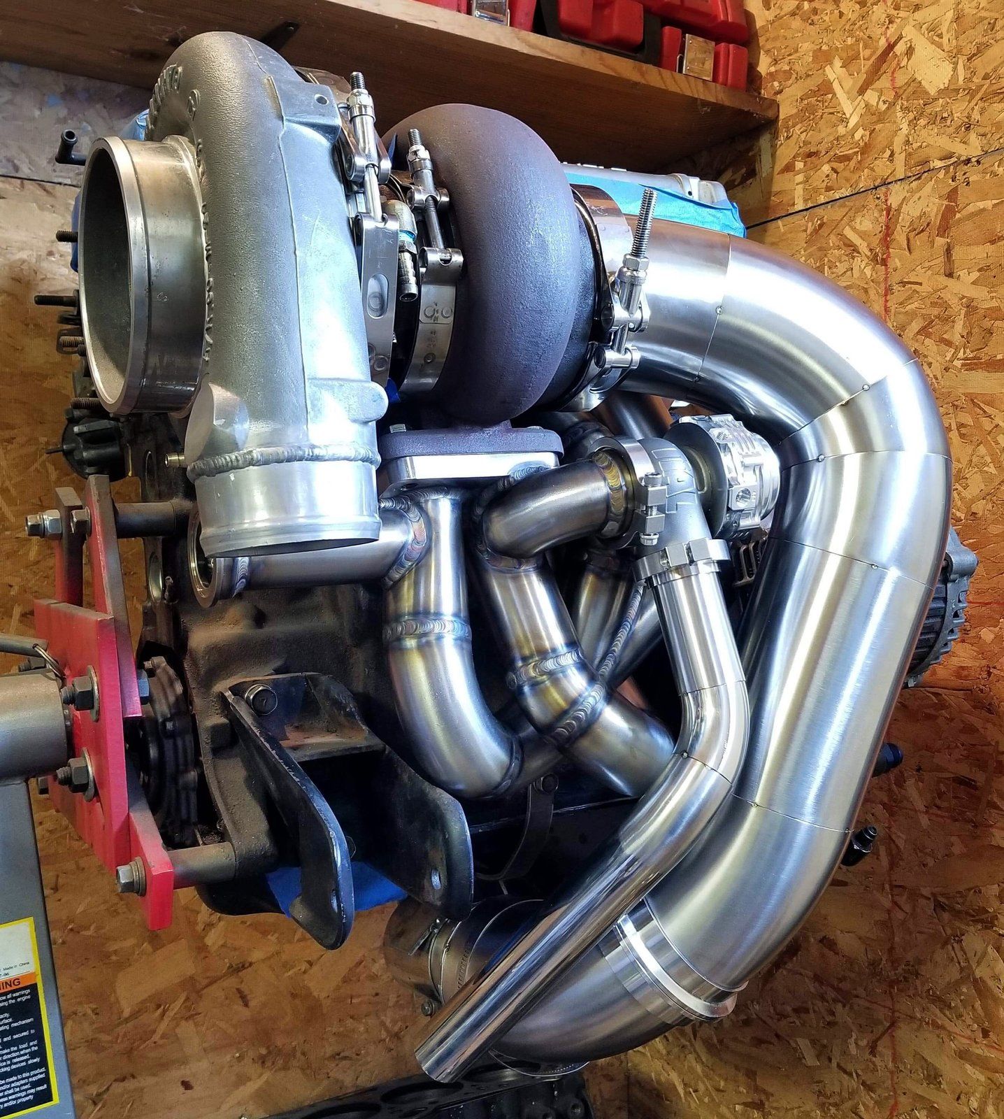

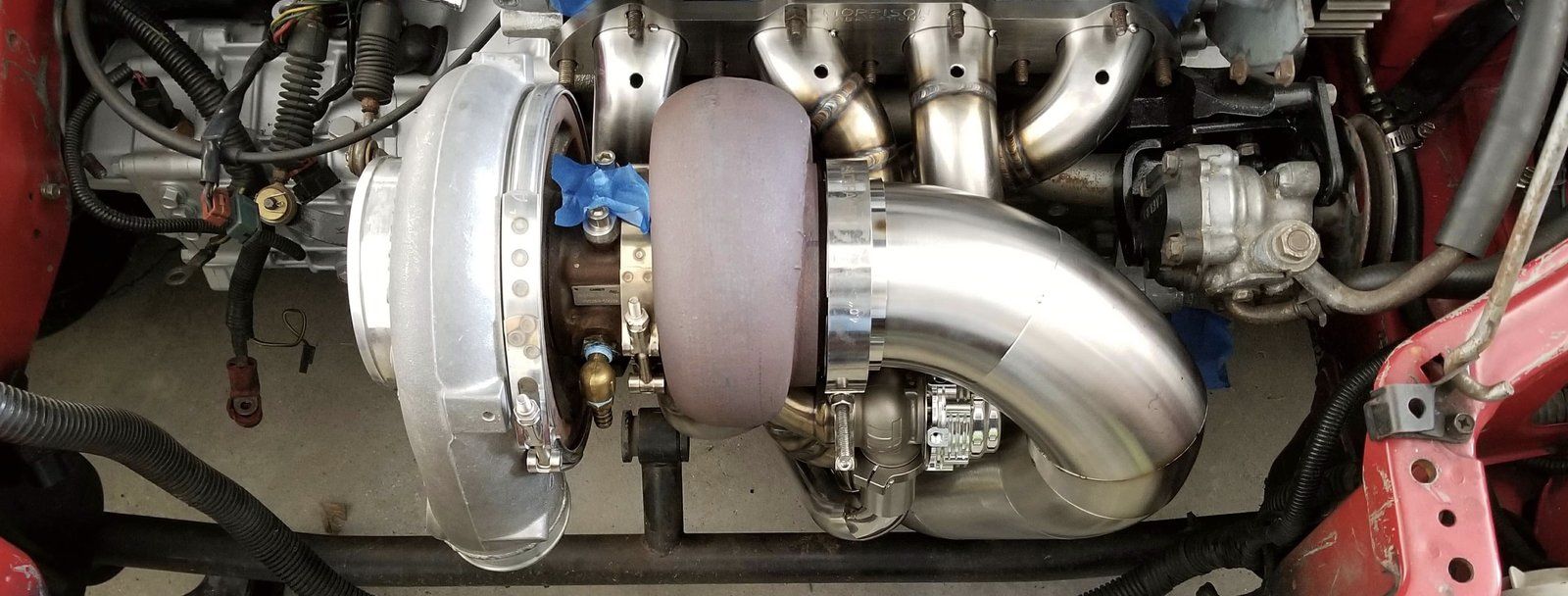

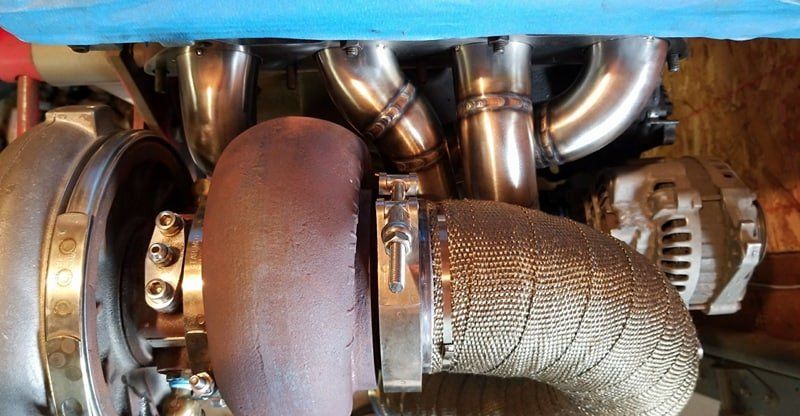

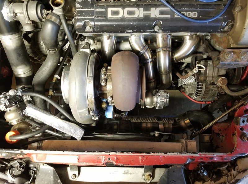

Got the DSM Consolidated Runner Twin Scroll T4 mocked up on my car with the GTX4202. Looks pretty dang-o good! Love this piece and my manifold (Top Mount Twin Scroll T4) - it's going to be hard putting mine back on! Just need another car so we can have one of each (ha!).

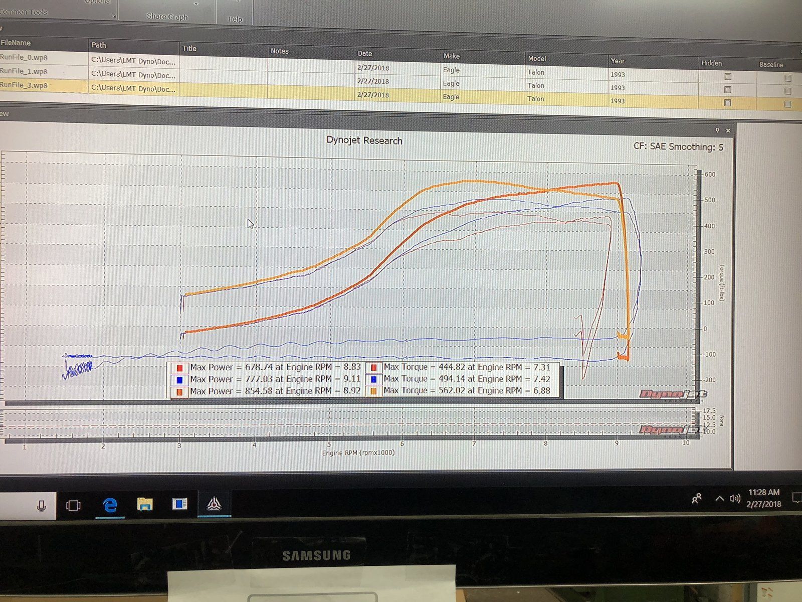

Prototype's 6 month dyno check-up is on February 27 - hoping to have most of the little things that were neglected to be done (because o m g it's running!). We decided not to rush it and put the secondary injectors on and tune the car all over again for just this appointment so we plan to max out what's on there.
Looking forward to seeing another healthy power curve (just with higher numbers than previously as it's gonna get turned up just a bit more ;)).

I like the fab work but it seems a little much for such a small turbo.

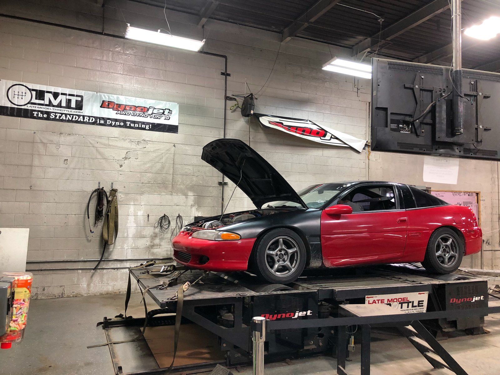

The appointment was for 9:30 a.m. at Late Model Throttle in Waukesha, WI. They let us take over the dyno for the day and gave us free reign to do what we had to do. It was pretty incredible. We did a few pulls with the Consolidated Runner first, then tore it apart for the standard setup, and then did some more pulls.
We are currently doing a massive write-up on the whole endeavor and sharing out the results from both. We were incredibly pleased with what we gathered and cannot wait to share it with you within the next few days! The HP numbers were interesting, of course - but much of the other data collected was vastly more intriguing. "Best" numbers: 860whp @38psi (the only graph I snapped a photo of is the 850 pull though - but we will share all graphs in the full novel - ha!).
