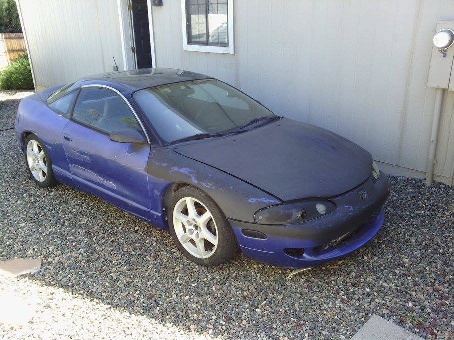

So I bought a talon for an engine to use for this project. The guy I got it from was fed up with it because it had so many problems. The guy he got it from had really screwed it up. His words were "it was like he took scissors to it". So it had a new turbo on it but unfortunately it probably never seen any oil. The oil feed line going to the turbo (an-4 fitting) was stripped out. I went a bought brake line to make a new line for it only to find out the turbo does not have an-4 fitting rather a plain M12-1.25 hole. I just got done disassembling the turbo so I could clean up all the debris after chasing the screwed up threads. No crush washers on the bottom side of the coolant banjo bolt either smh...

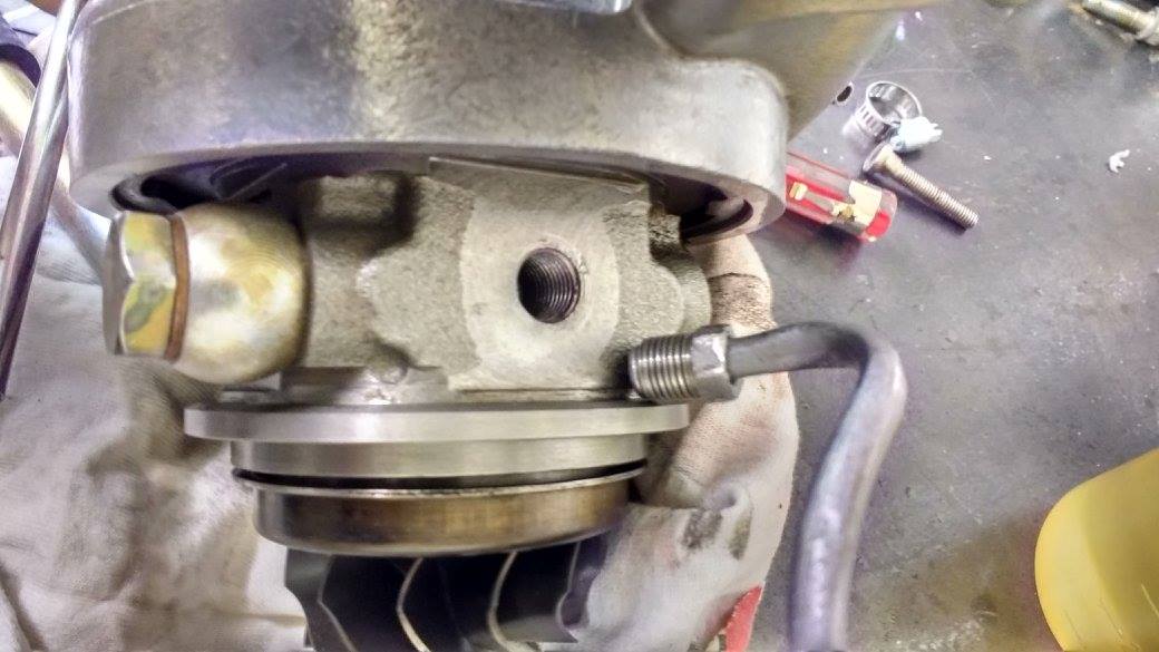

What is the usual connection for the oil feed line to the turbo? I'm not seeing any M12-1.25 (male) to an-4 (female) adapters.
Here is the car. Notice the super awesome headlights ;)
You'll be hard pressed to find an m12x1.25 to -4an female. I would get the banjo adapter to male -4, or the direct male fitting. the banjo would allow you to drill/tap a set screw into the piece easier for restrictors (what I did).
the factory oil feed for a 2g should be from the OFH, which you can put a BSPT to -4an male fitting in and run a straight -4an feed line to the turbo.

Thanks for the ideas on the oil line. Mine had a 1/4" brake line which the ends have a 7/16-24 threads which I thought was an-4 but an-4 has 7/16-20 threads. And I think the angles of the flair might be slightly different too. Anyways I got some adapters yesterday that I think will sort it out...

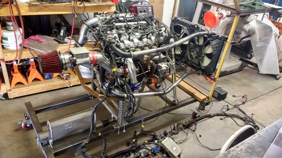

Status as of today:
-I got the high pressure oil line to the turbo sorted out and finished.
-Head is torqued down, all belts and pulleys are installed and the valves are timed.
-Exhaust, intake, and cooling plumbing is finished.
-I have a 2.5 gal fuel cell on order.

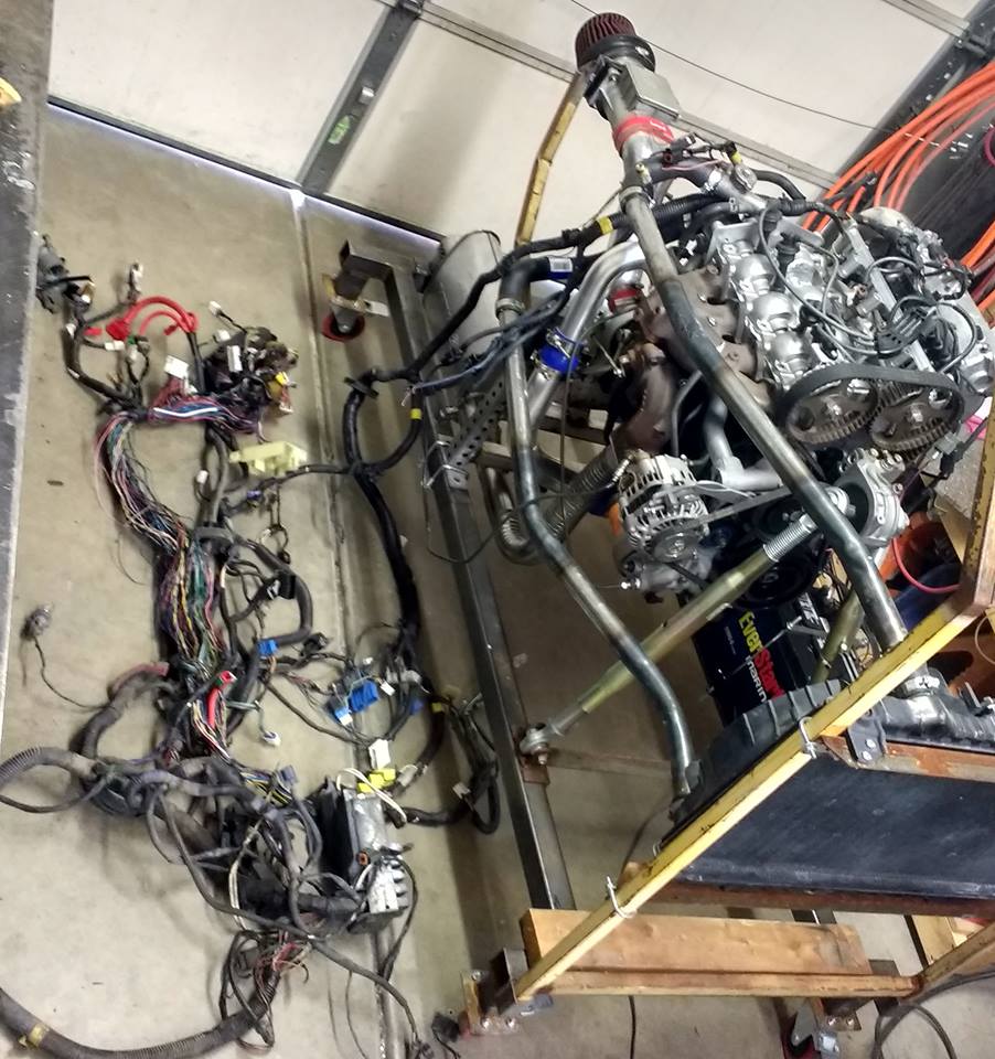

Today I am working on the wiring. I stripped all the relevant wiring harness out of the car and am salvaging what I need to make the engine run.
The way things are now, all the oil going to the head is blocked off. Does anyone know if this is going to be an issues (resulting to overflow to other bearings)?
I have a VCDS scanner (my daily driver is a VW). So I'll be using it for initial troubleshooting and parameter monitoring for generic OBD2 stuff. I have been looking into ECU tuning solutions for the stock ECU (E2T61674). Else I am considering using a megasquirt II I have laying around. If anyone knows of any options I should consider please share.

If anyone knows of a write-up for taking a stock wiring harness and stripping it down the the bare engine control essentials please share. I know I can buy a harnesses for this but I'm looking to use what I have since the car this all came out of is being parted out. I found the ecu pin schematics so I'm just going to work it from that as I go.
Unfortunately wiring the ECU is really taking a lot if time. ECU pins 13, 26, 92 are all connected to ground. I have ECU pin 80 wired to constant power (+12V) via a 5 amp fuse. The two black and red MPI wires are getting fed constant +12V power via a 20 amp fuse. I have ECU pin 82 getting switched +12V power which also energises the MPI relay which in turn gives ECU Pins 12, 25 (+12V) power. I'm thinking with the above done the ECU should boot up and turn on the check engine light and communicate with my OBD2 scanner. Instead the CEL (ECU pin 36) has no voltage and the OBD2 port is not talking with my scan tool. I'm all ears if anyone has any pointers. Here is a video I made describing the problem.
Good news is the fuel cell came in today but the bad is I could not find any -10 AN fittings in town. I ordered some online that should be here Monday. Amazon prime to the rescue! I also need a new CAS and knock sensor that also were not in stock but should be here next week.
