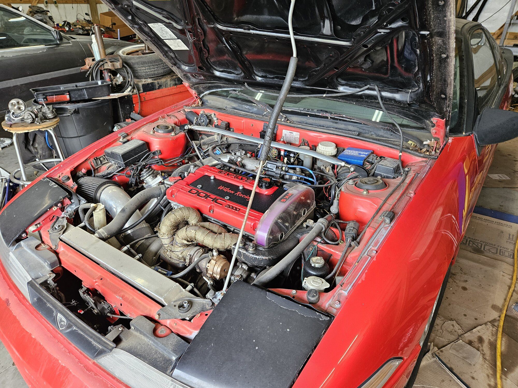

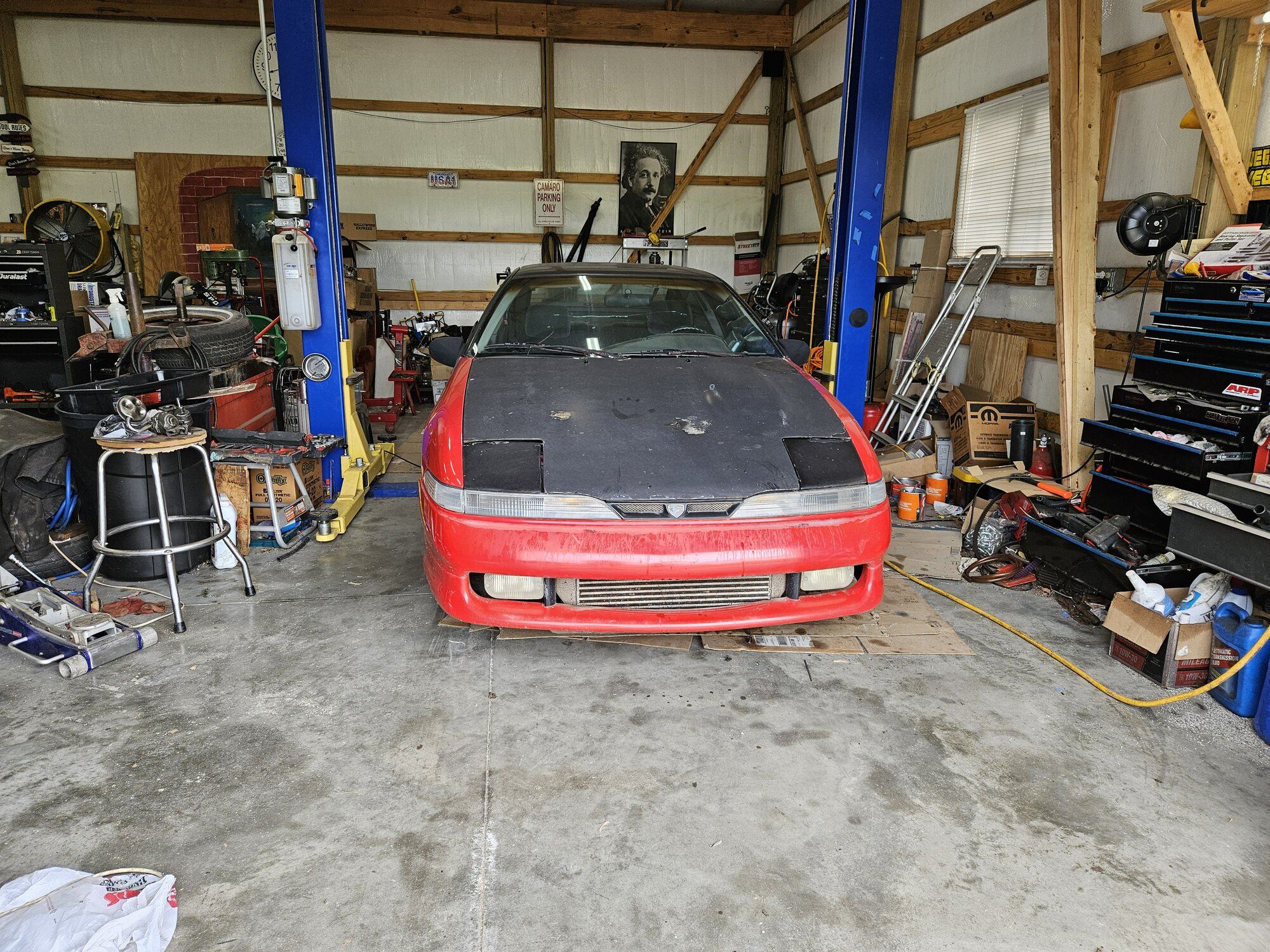

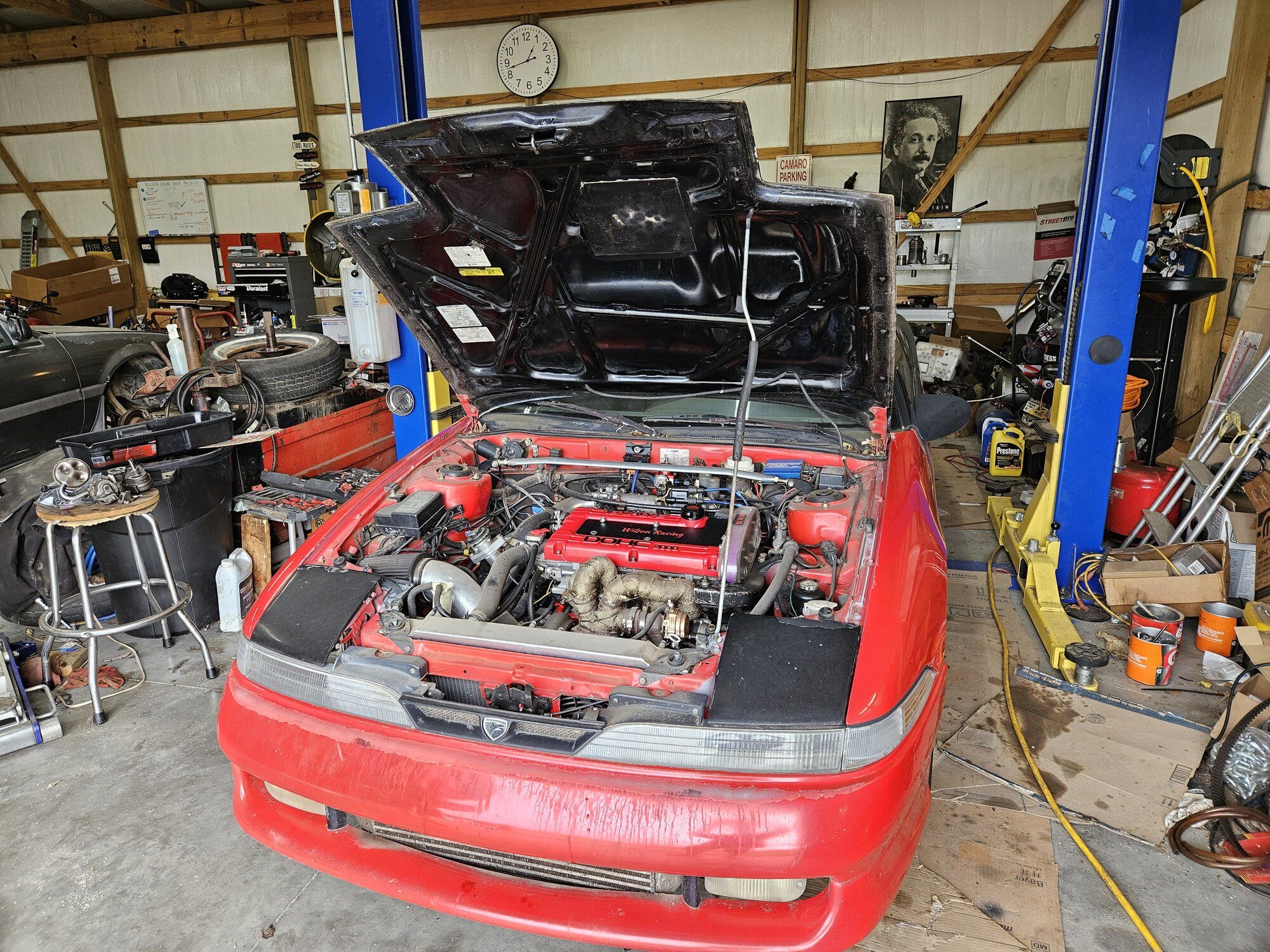

1990 Eagle Talon TSI trying to save her life from the previous owner and its alot of work but a nice base car. My youngest son, who also races this car has nicknamed her "The Red Baron".
Ya know, I've had more people want that than any. If her oil pressure light didn't flicker at idle, I'd drive her everyday, but I don't want to ruin a crank, so she is waiting HER TURN in the bay. I have a ready to go, fresh 6 bolt, with some little cams waiting to go in. She is, in some ways, alot more fun than the 2 hotrods are. The man that had it didn't know how to work on them so he asked me to buy it. :thumb:

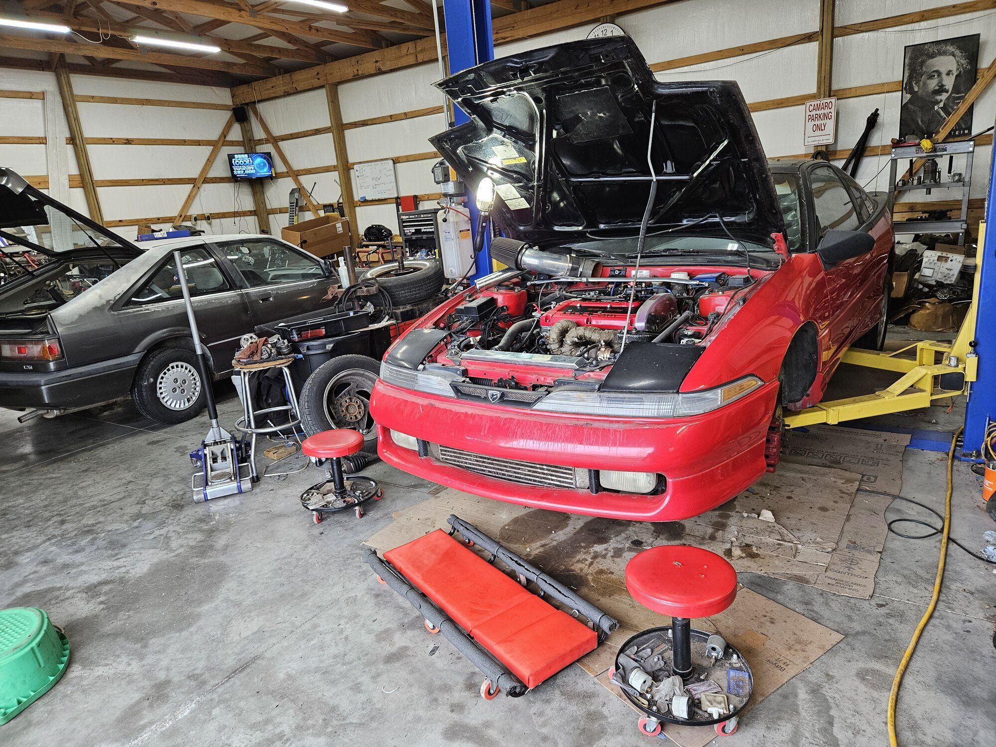

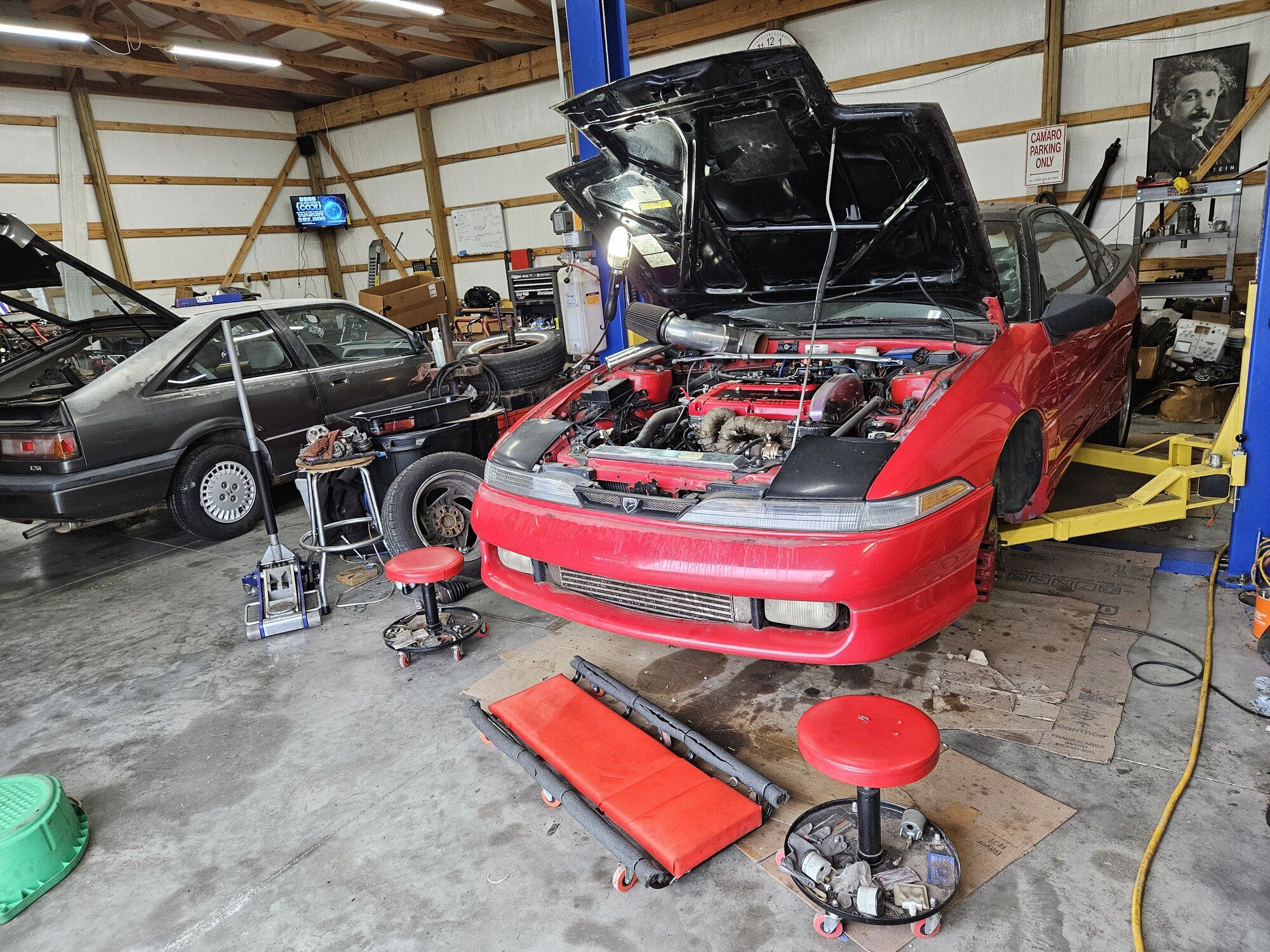

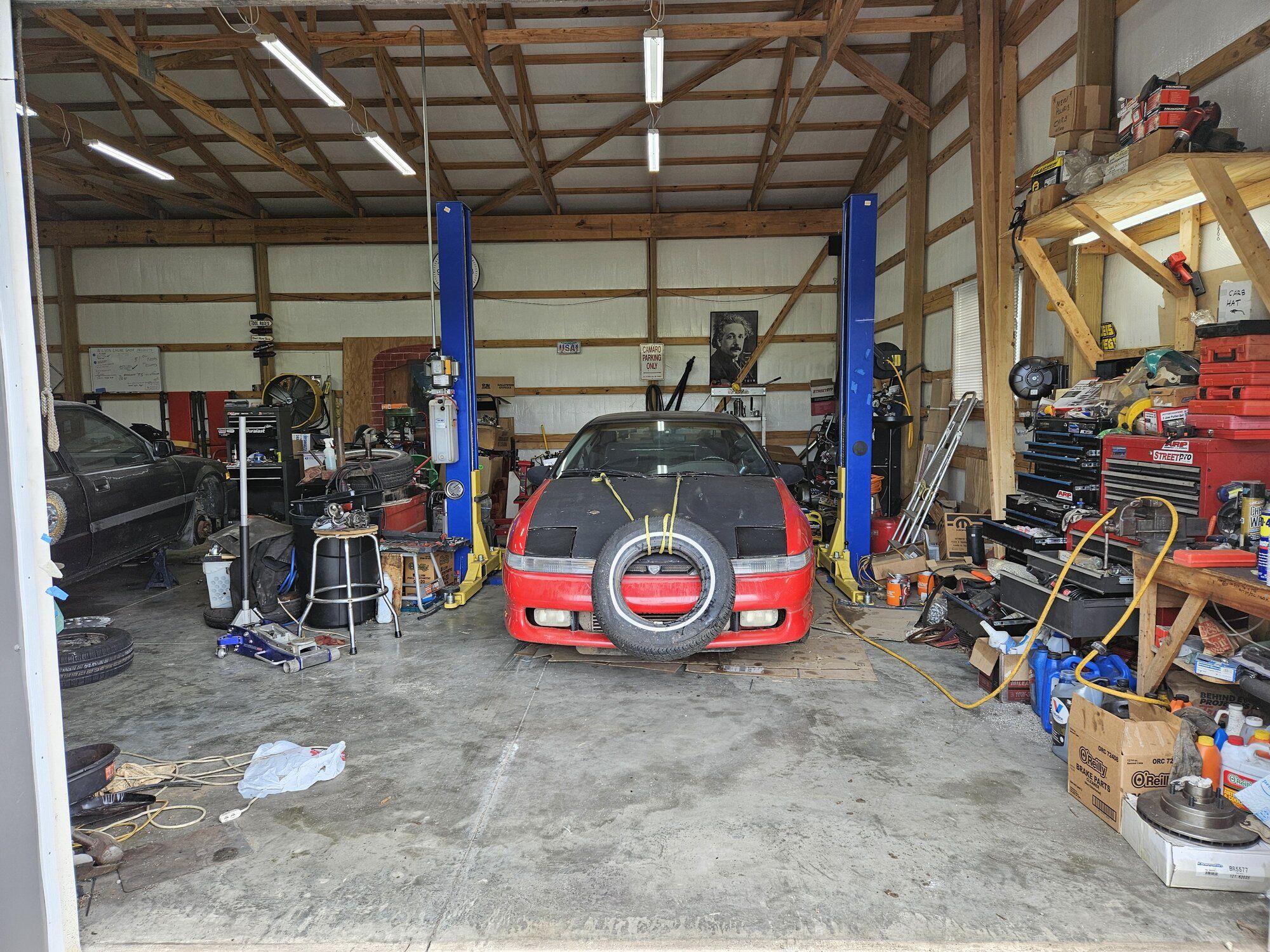

My son came home for lunch and I had a spare tire strapped to the front, ready to go, so all that was needed was a small push into the shop with my Toyota Wagon (the mule).
Hurray!!!!:D
I need to put cement in front of my shop.
Marty

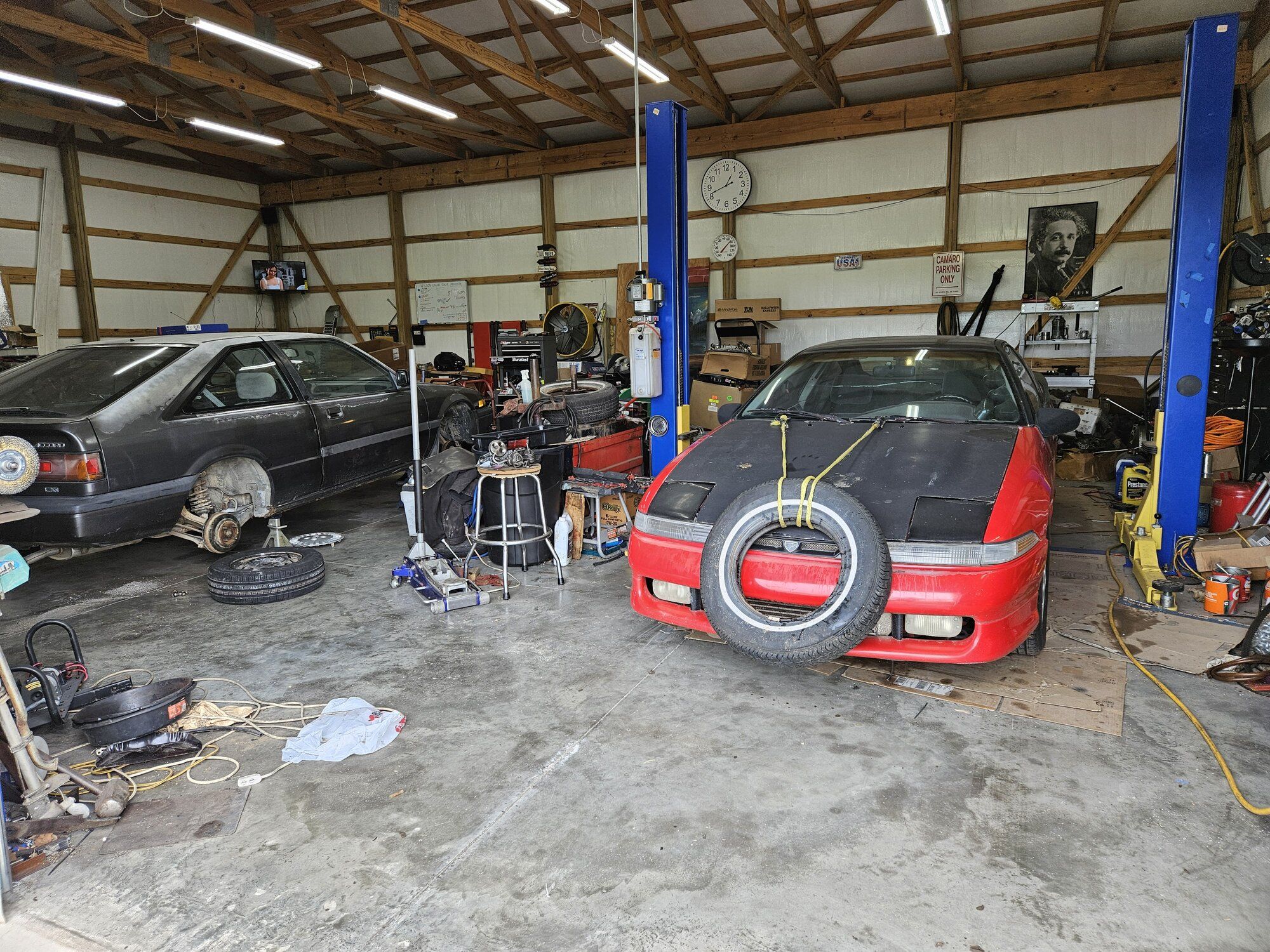

Tear down time, readying for a fresh motor Jeremy. It will take me forever but it will get done.
Chad, money talks....... :cool:

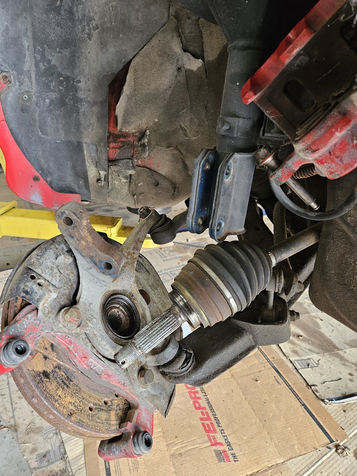

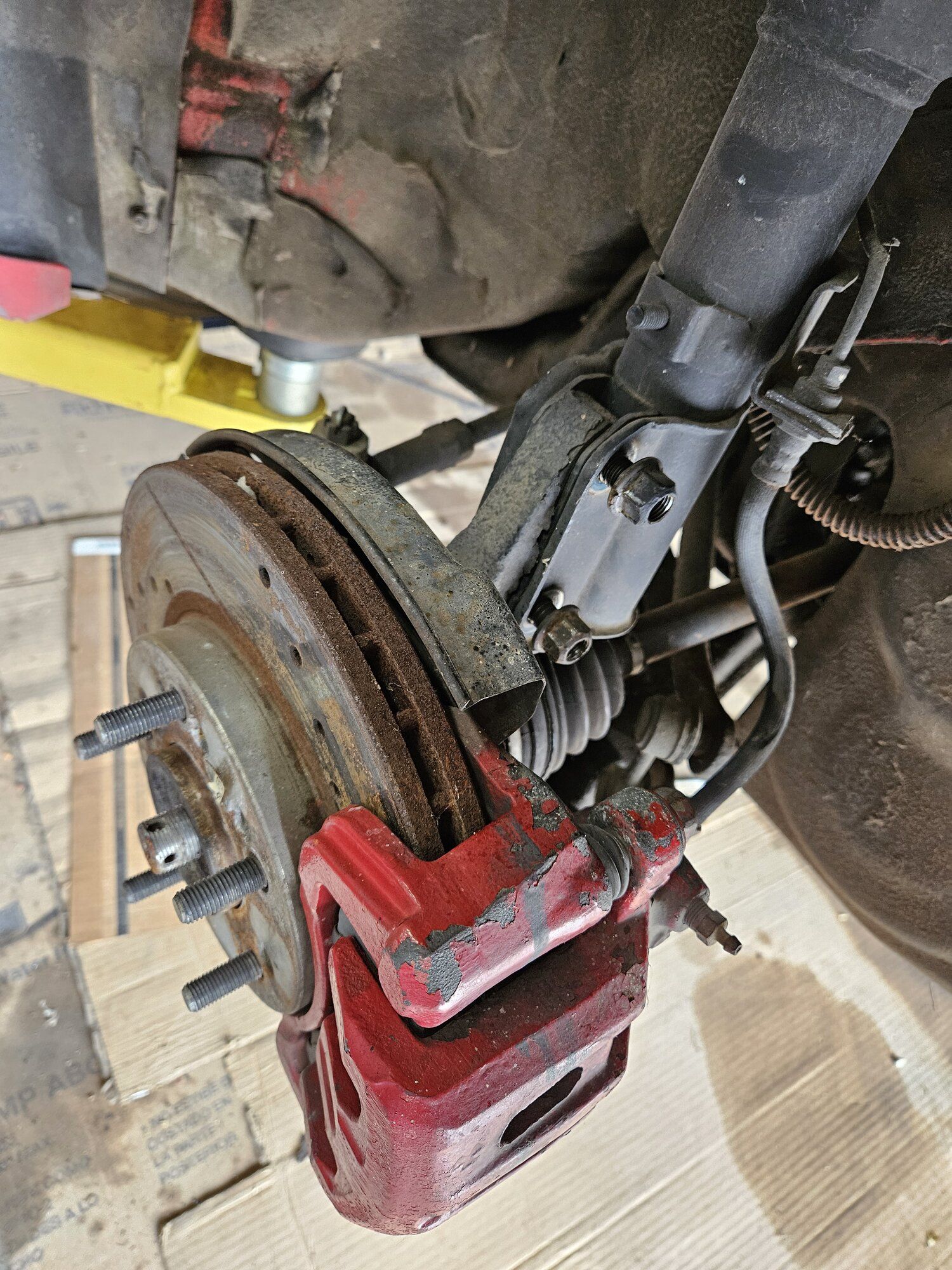

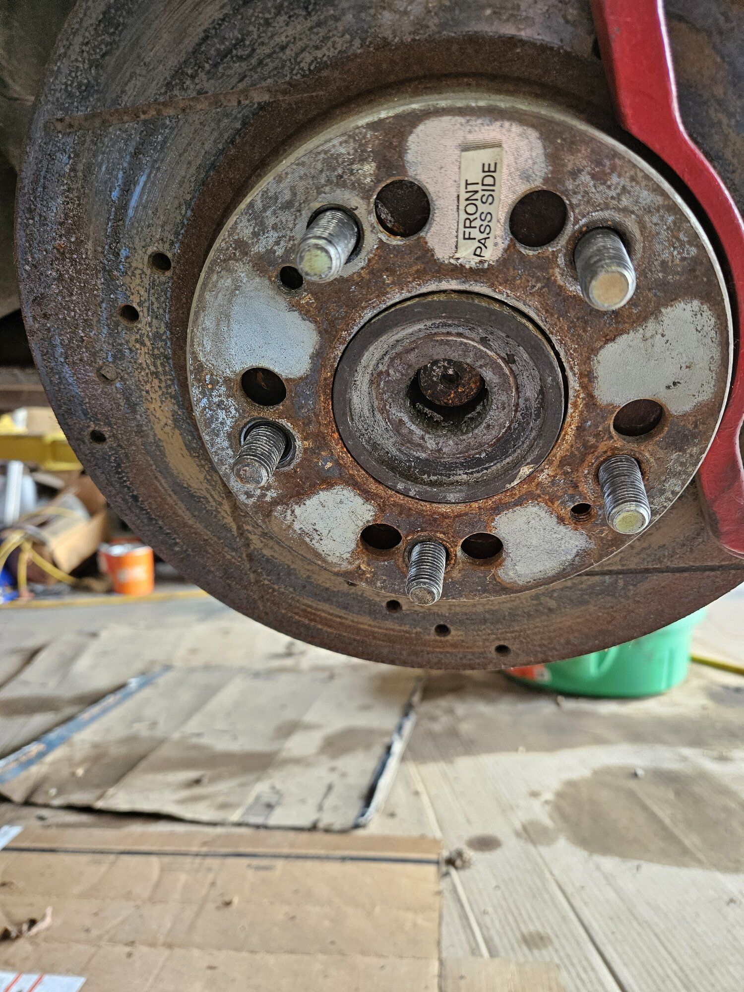

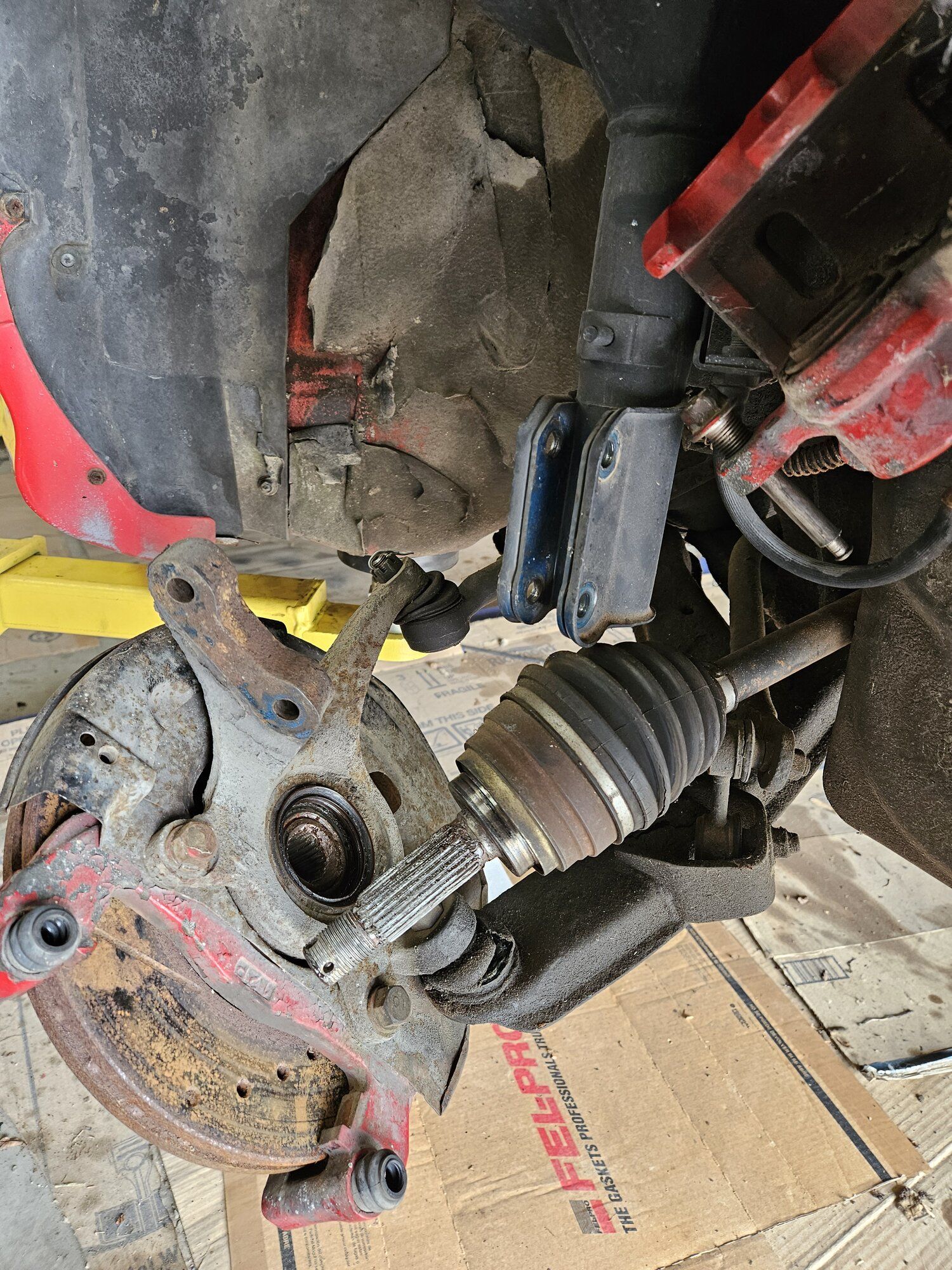

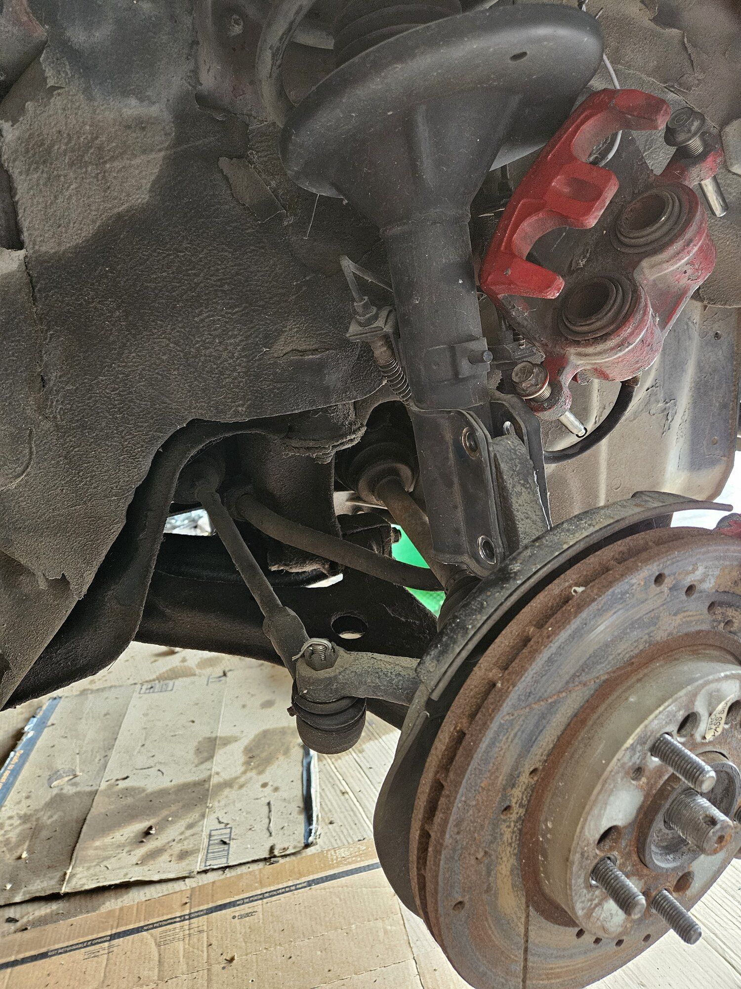

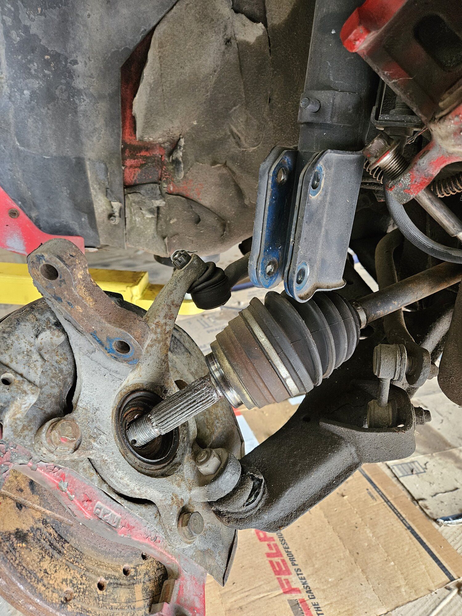

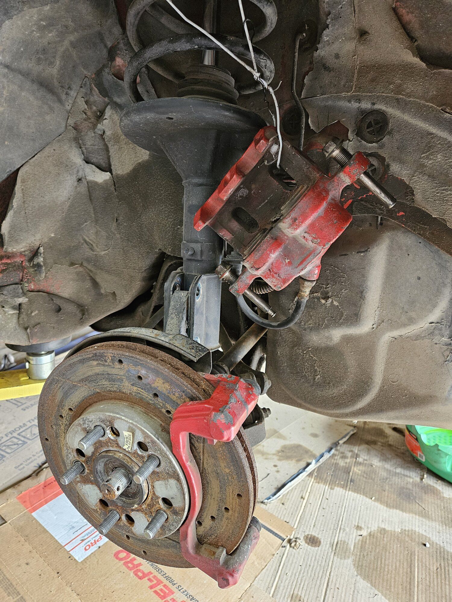

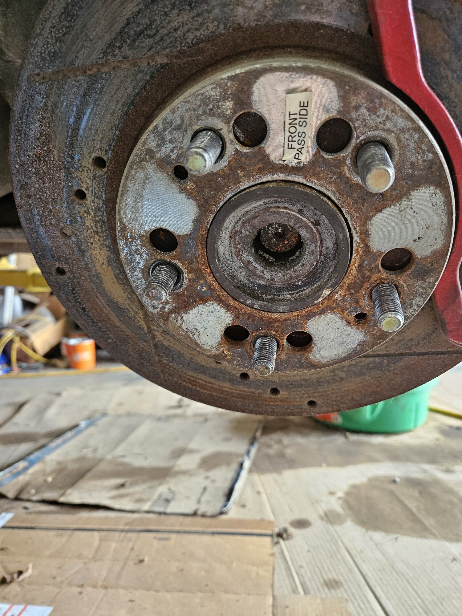

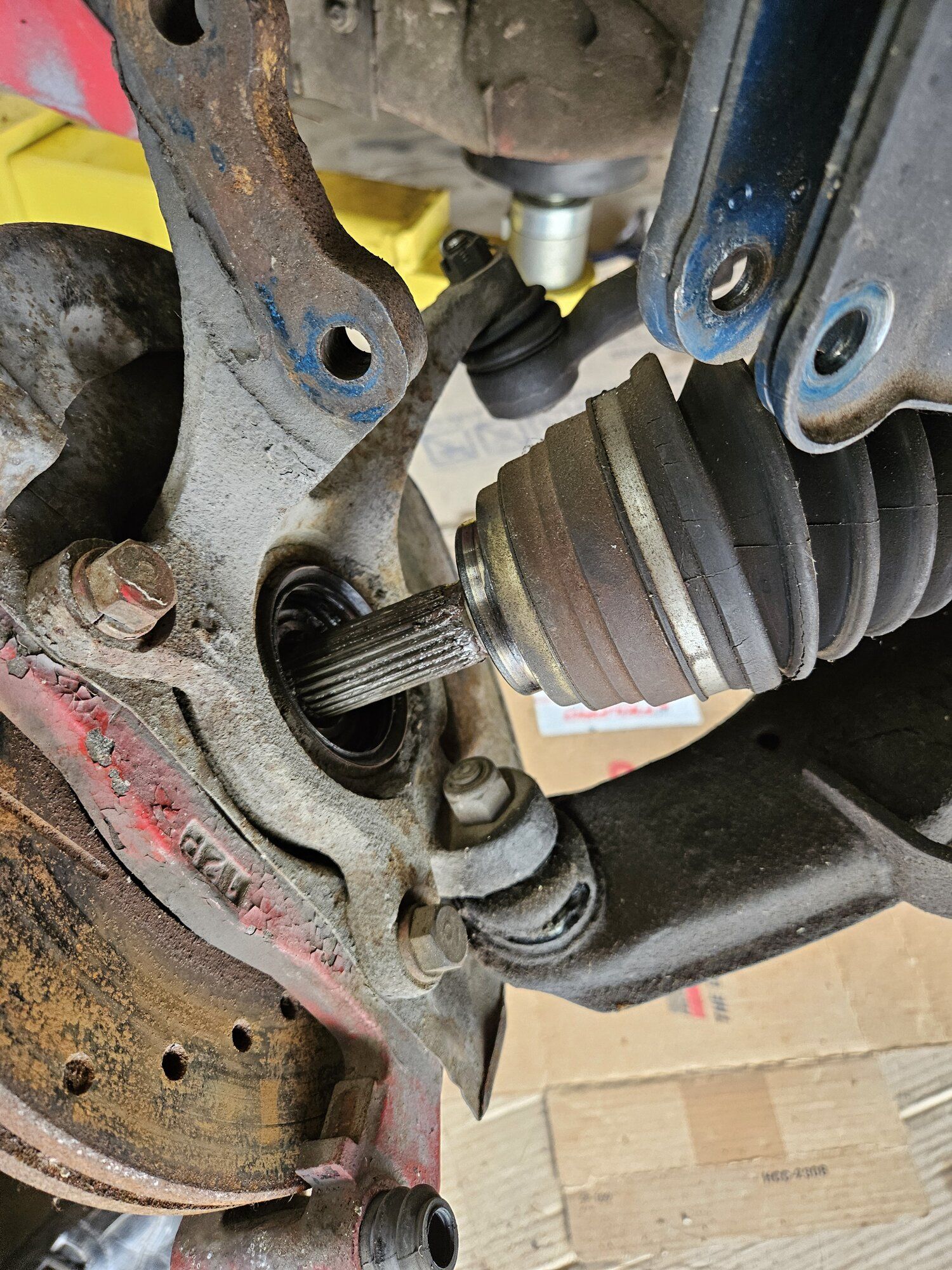

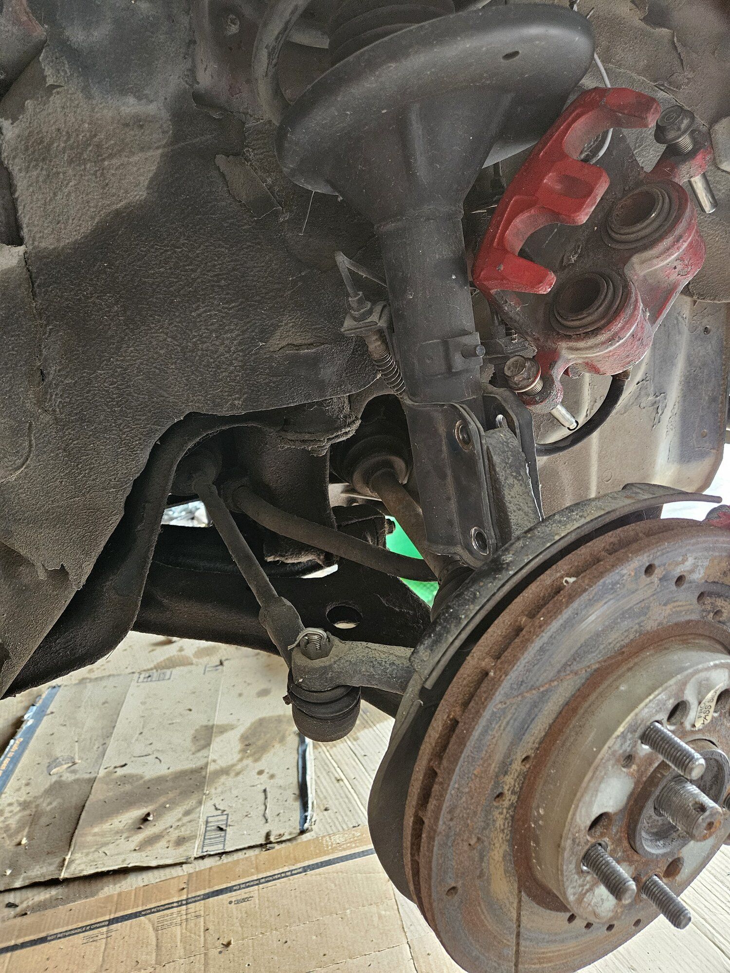

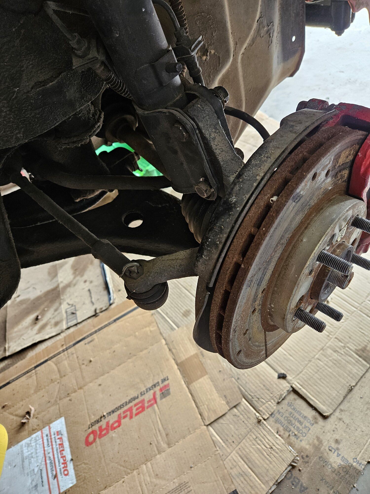

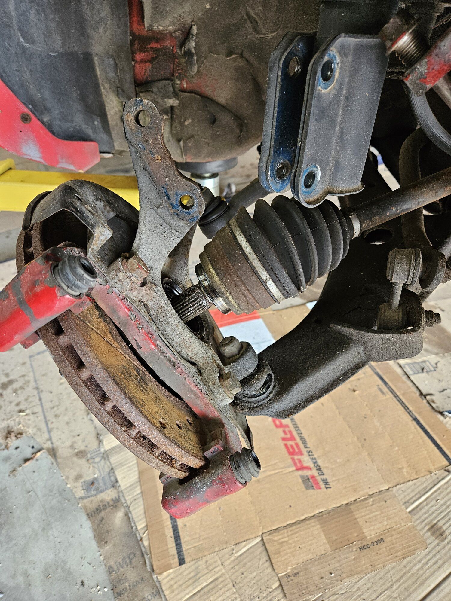

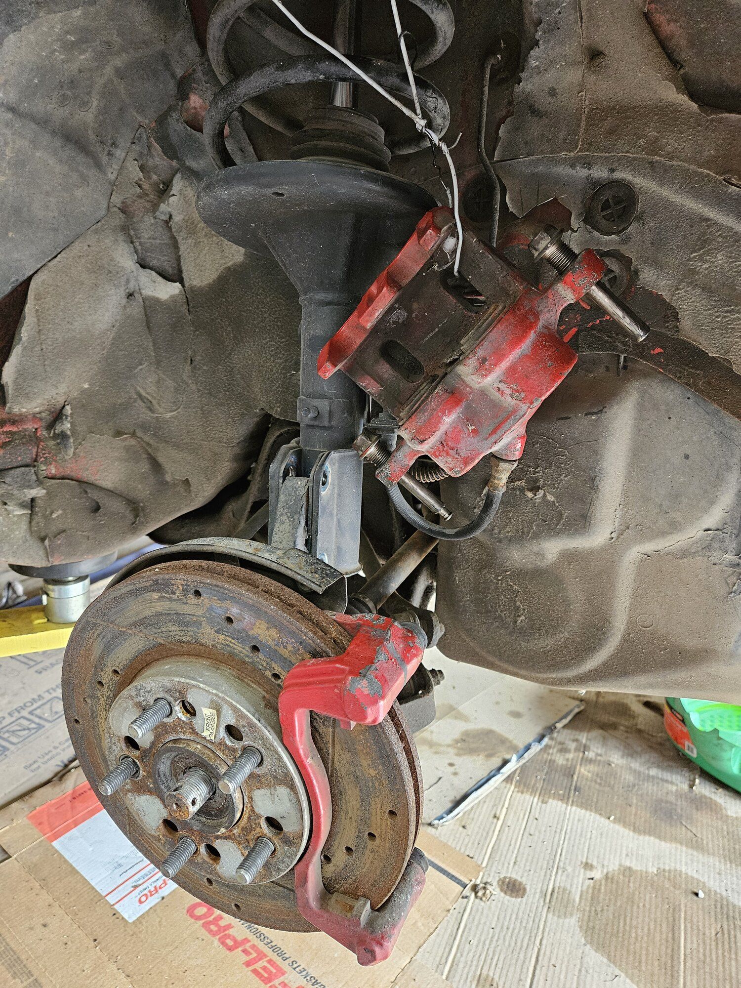

I made some progress today. Wheels off, axles out, UICP off, battery ready to come out, all fluids drained.....just a LITTLE more......

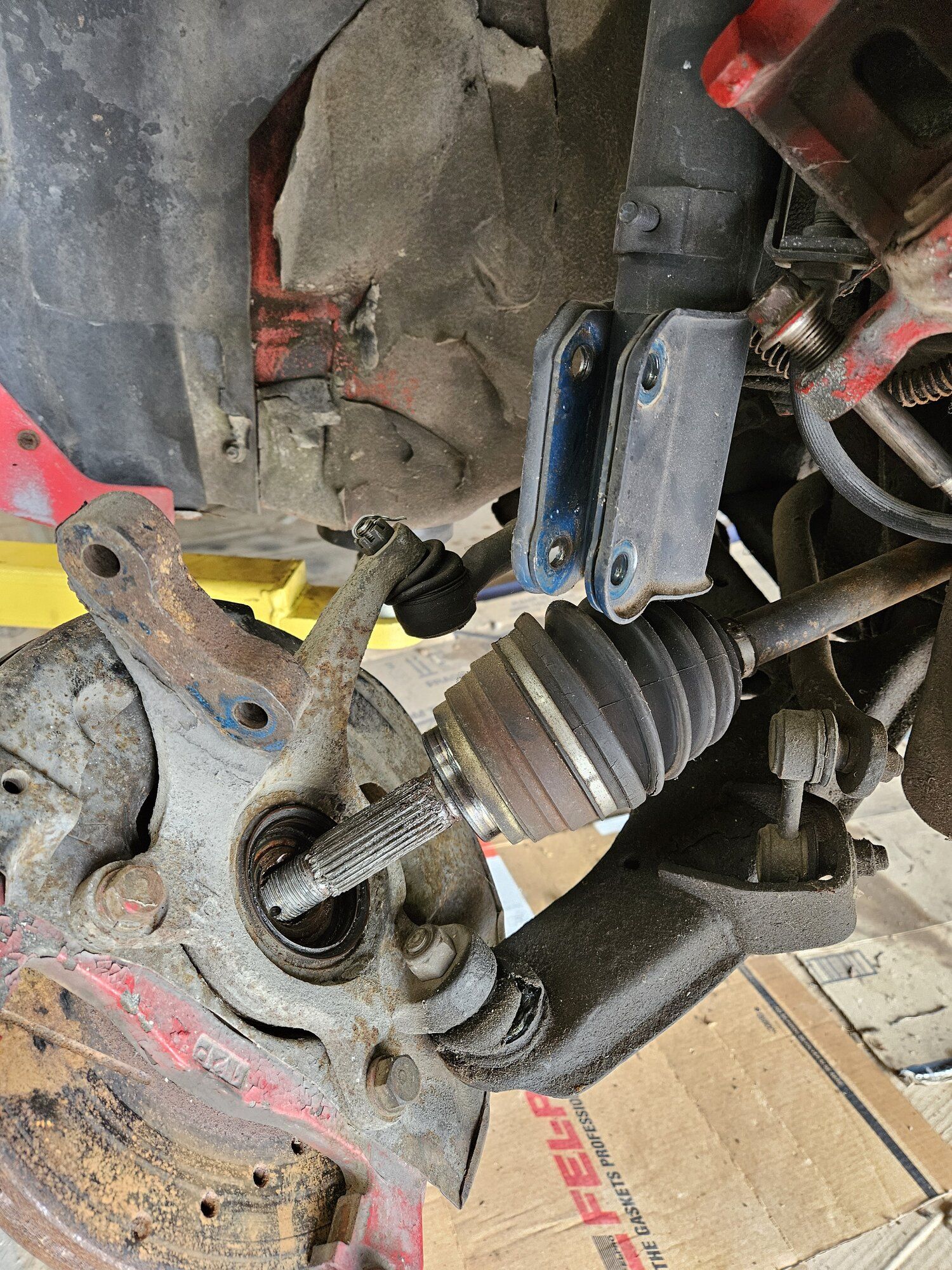

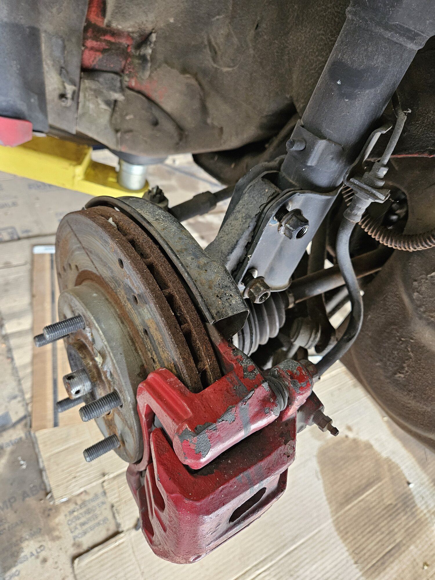

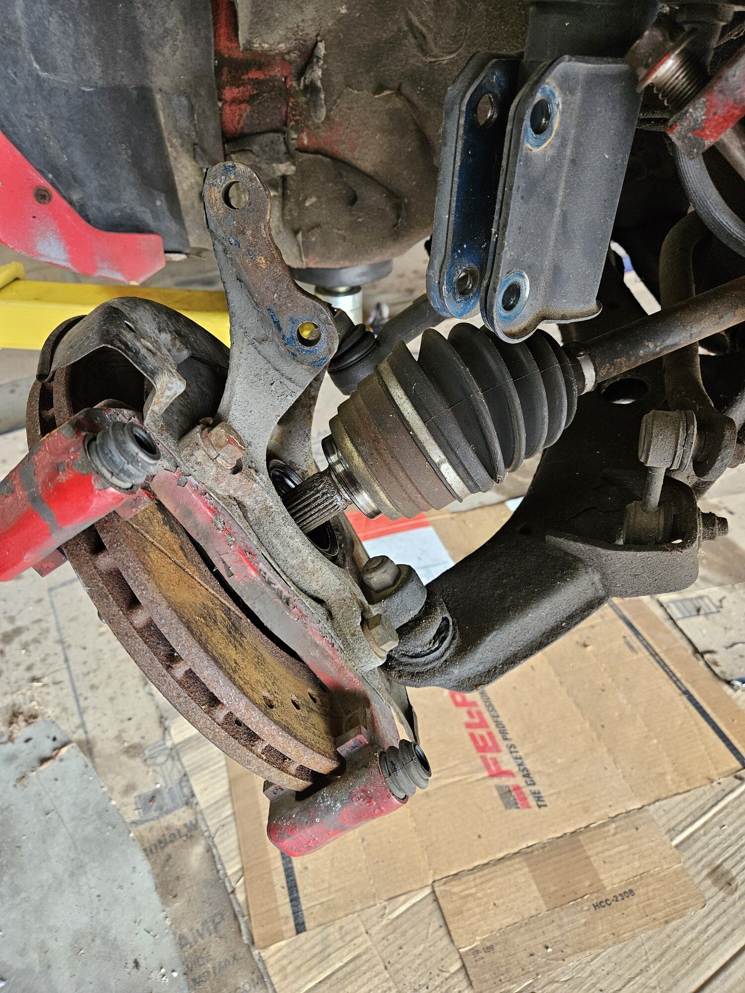

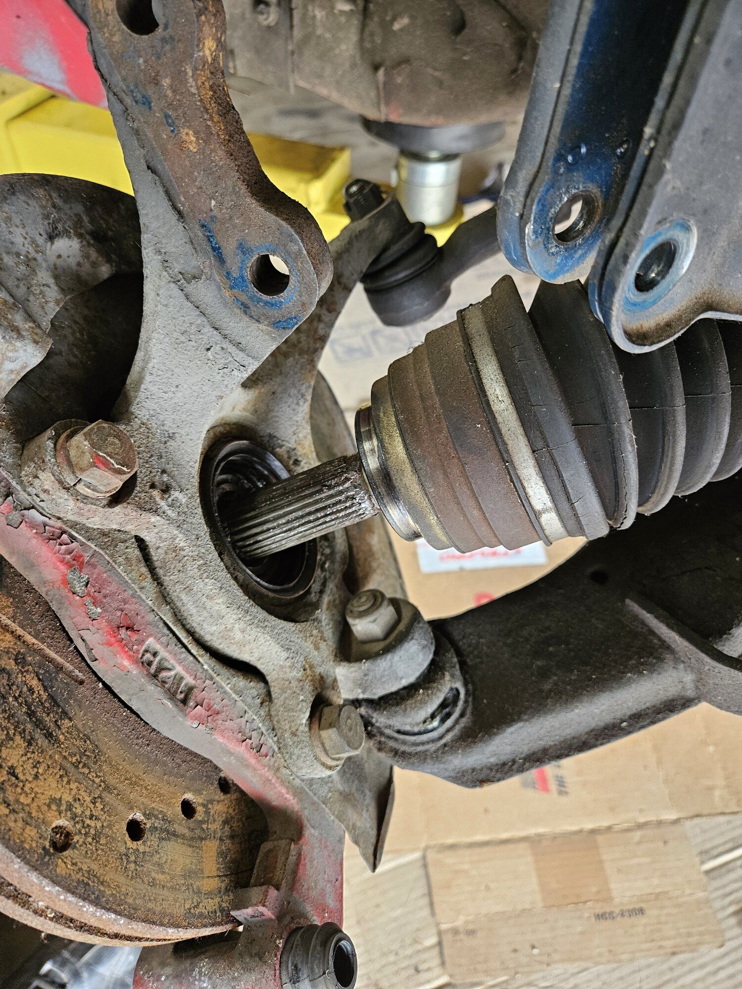

I did the axles the "Marty" Way (as little as possible). Hopefully the pictures will show the steps for everyone. Its just so easy. 2 strut bolts and the brake caliper then the axles slide out the back, with a little luck :)
Marty

Great minds! That's how I always pull my axles!
It's kinda iffy on the brake hose so just to be safe, I hang it up then put it back. It's brakes, so I want them to be safe and ready to go but if you can leave them on, even better. With an air rachet, it takes an extra 3 or 4 minites so its just second nature as you already have the 17mm there. So easy :thumb:

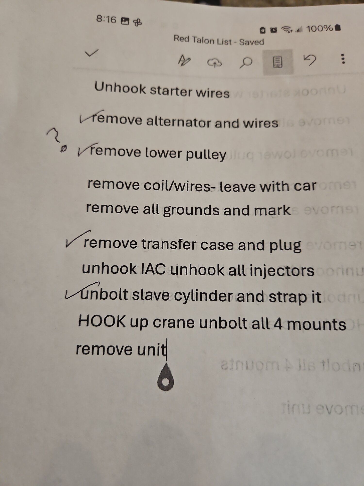

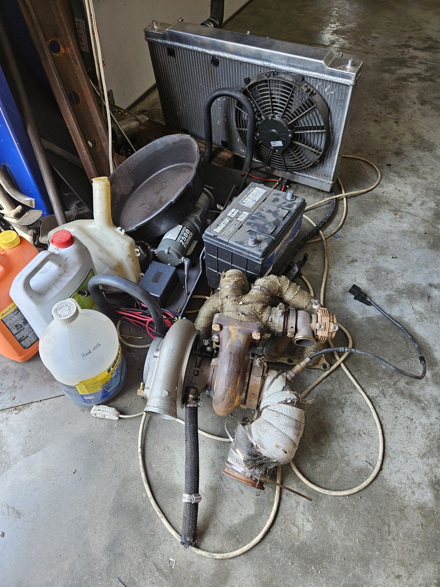

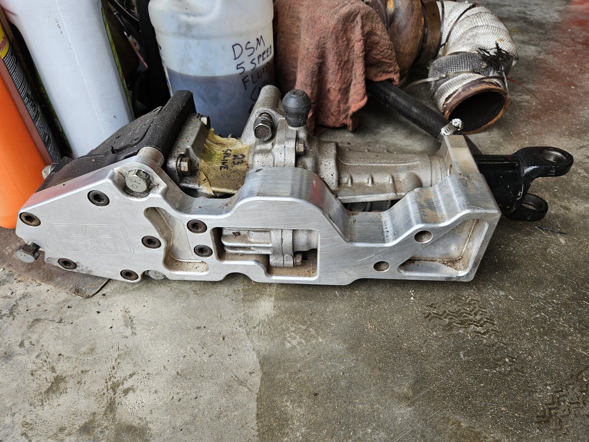

And a PILE of parts. Transfer case should come out tomorrow. All wires, cables and hoses are unplugged (forgot to do the injectors, shit. Well its just 4 clips). PS pump is off so maybe I can get the alternator off tomorrow too which would leave 2 motor mounts and 2 roll stops. That's enough for my back today but I got shit done!
Stay "tuned" ROFL

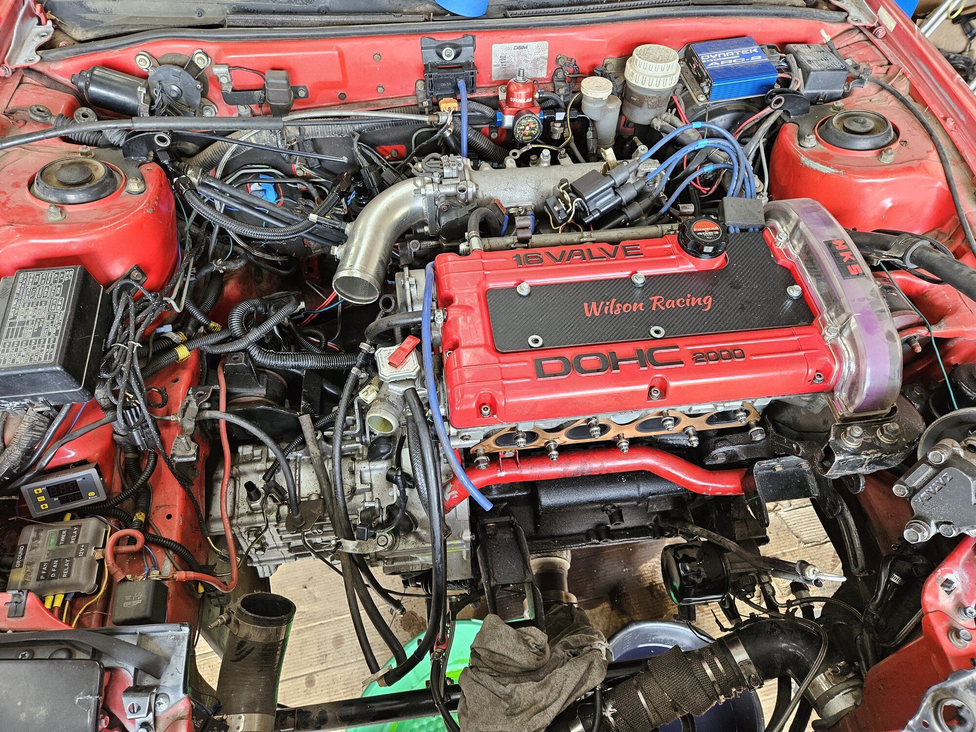

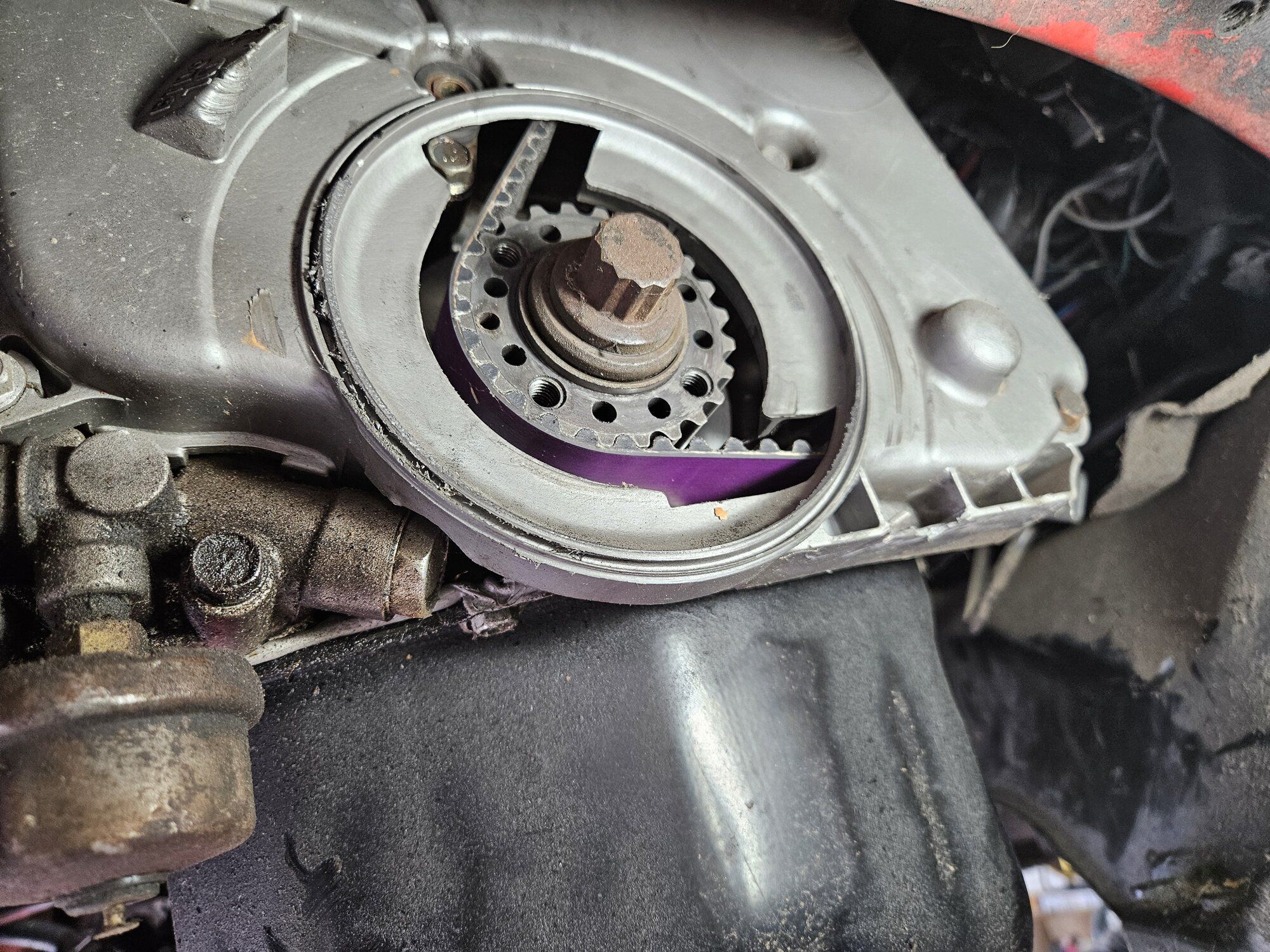

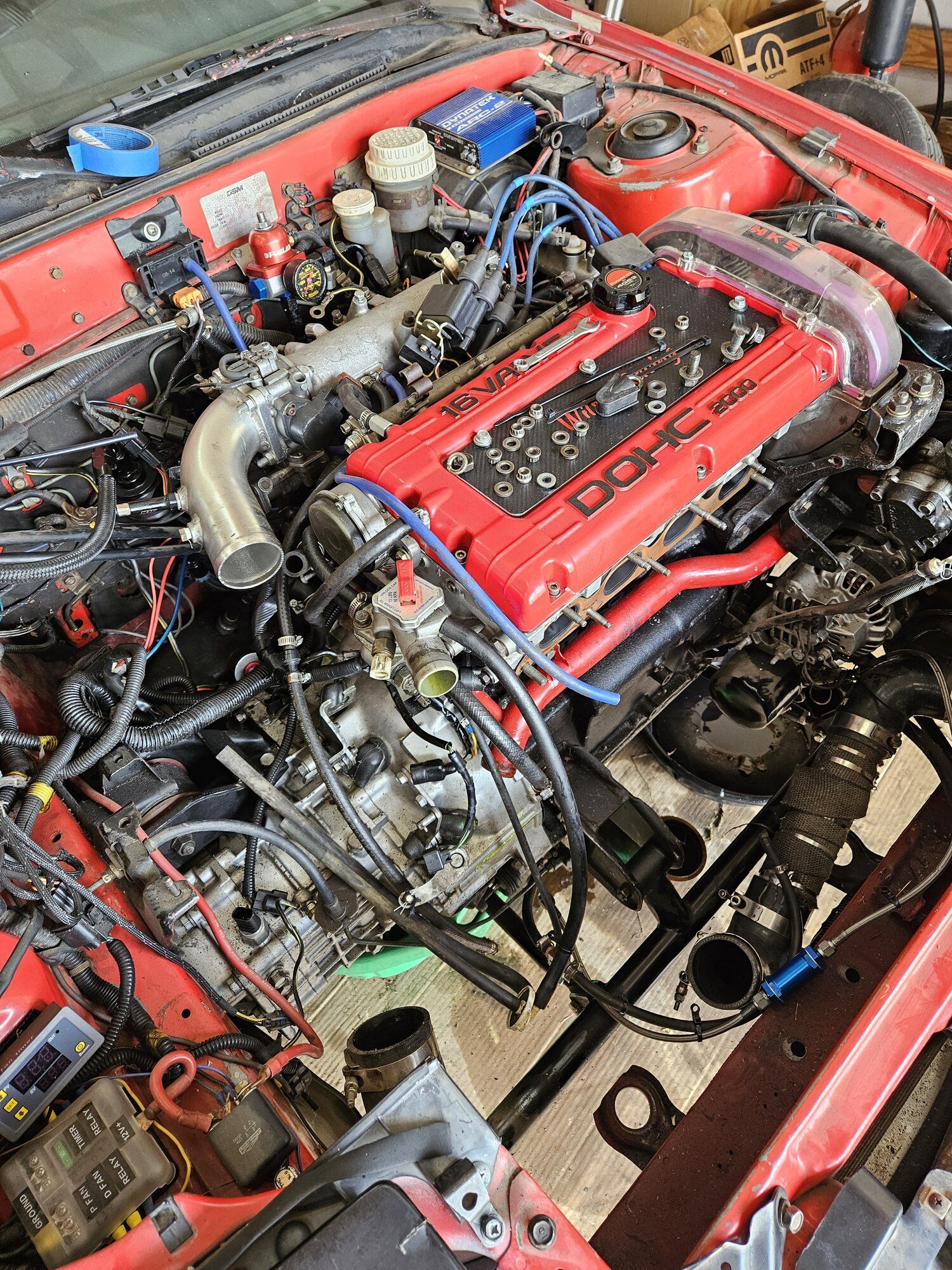

Well I got a few more things checked off the list (see below) and am closer to getting one out and another one in. Hell, while I am at it, I should do the White 90 GSX also.....:banghead:;):thumb:
The 4 bolts holding the balancer on were just tight enough to have to use a wrench slightly, which is the ONLY SUS THING so far. Everything else looks NEW.
We will all see soon. Thanks for following along!
Marty
This is one of the many things I love about just leaving the nose off all the time. It's so easy to go under there and check those bolts whenever. Mine have never loosened up though.
