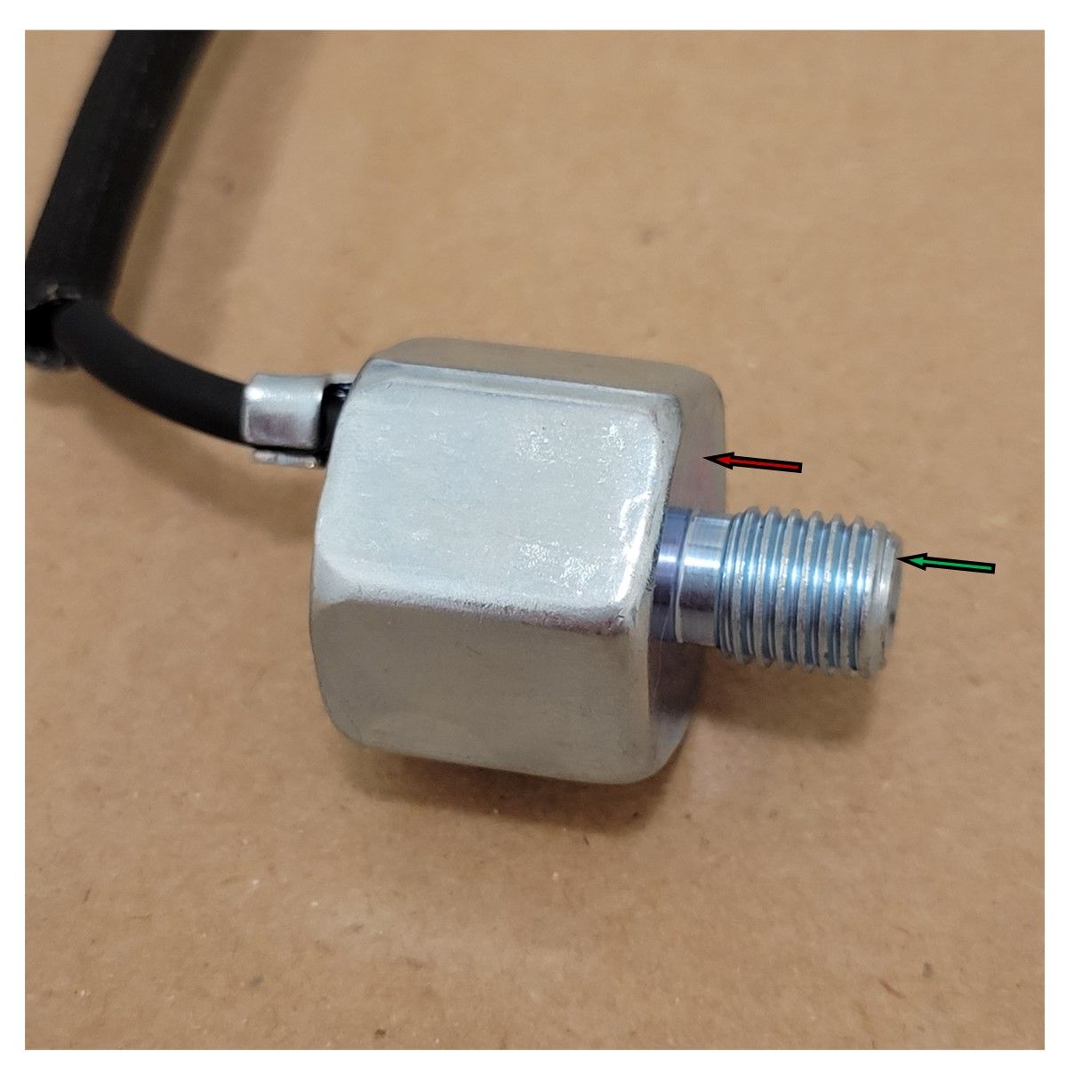

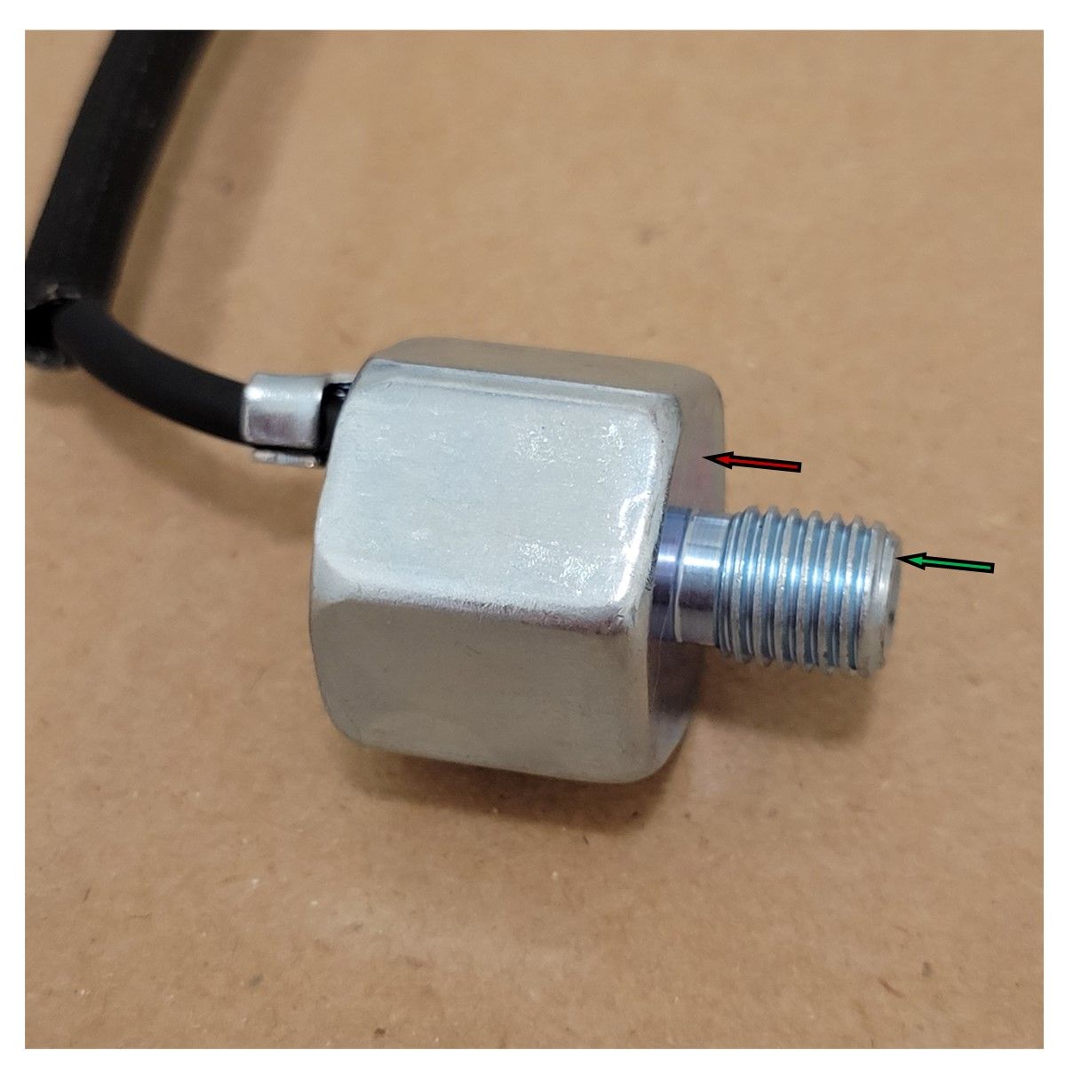

Marty, on a 6-bolt, where does the knock sensor bottom out when you tighten it down in the block?
Red arrow or green arrow?

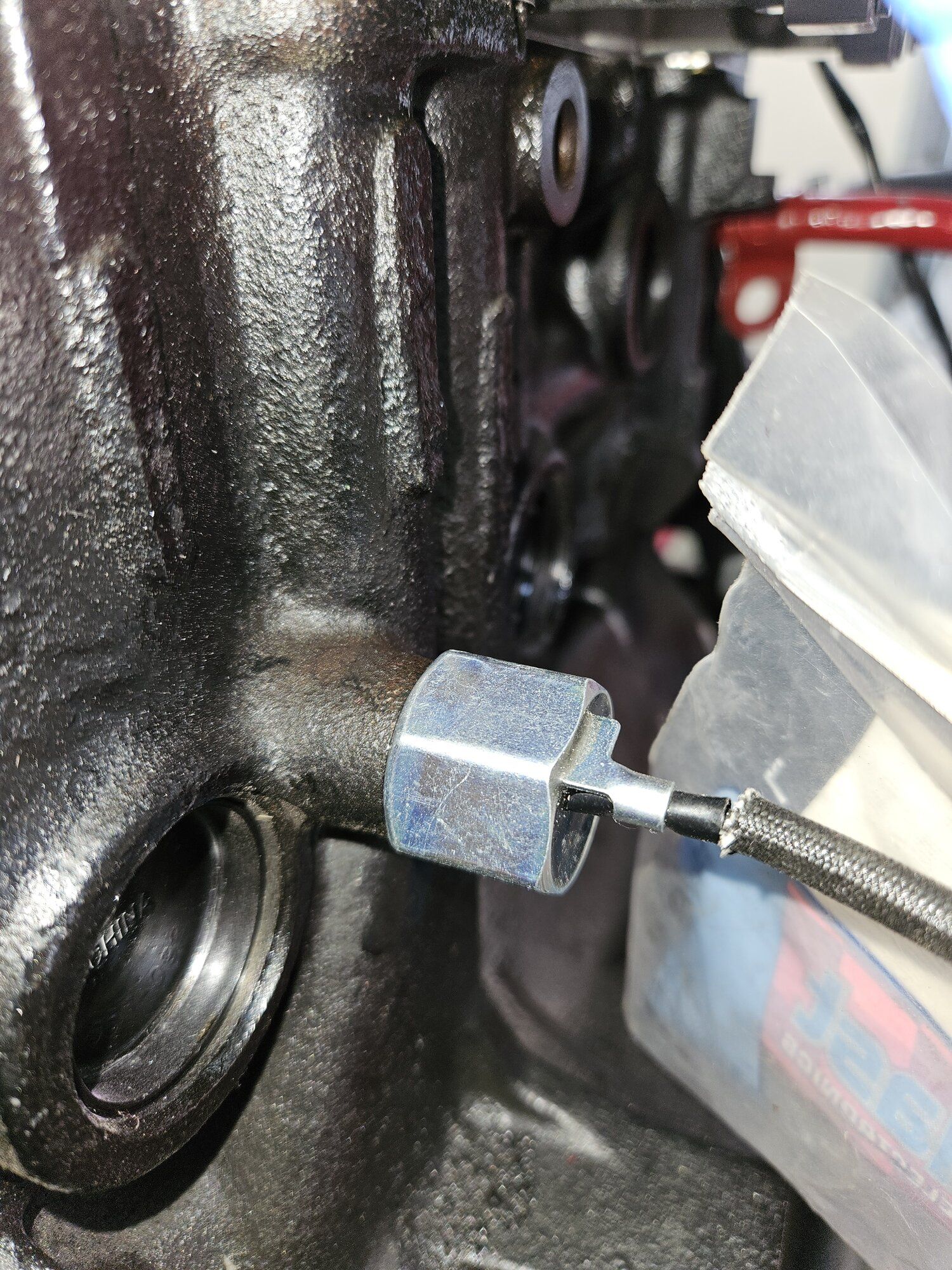

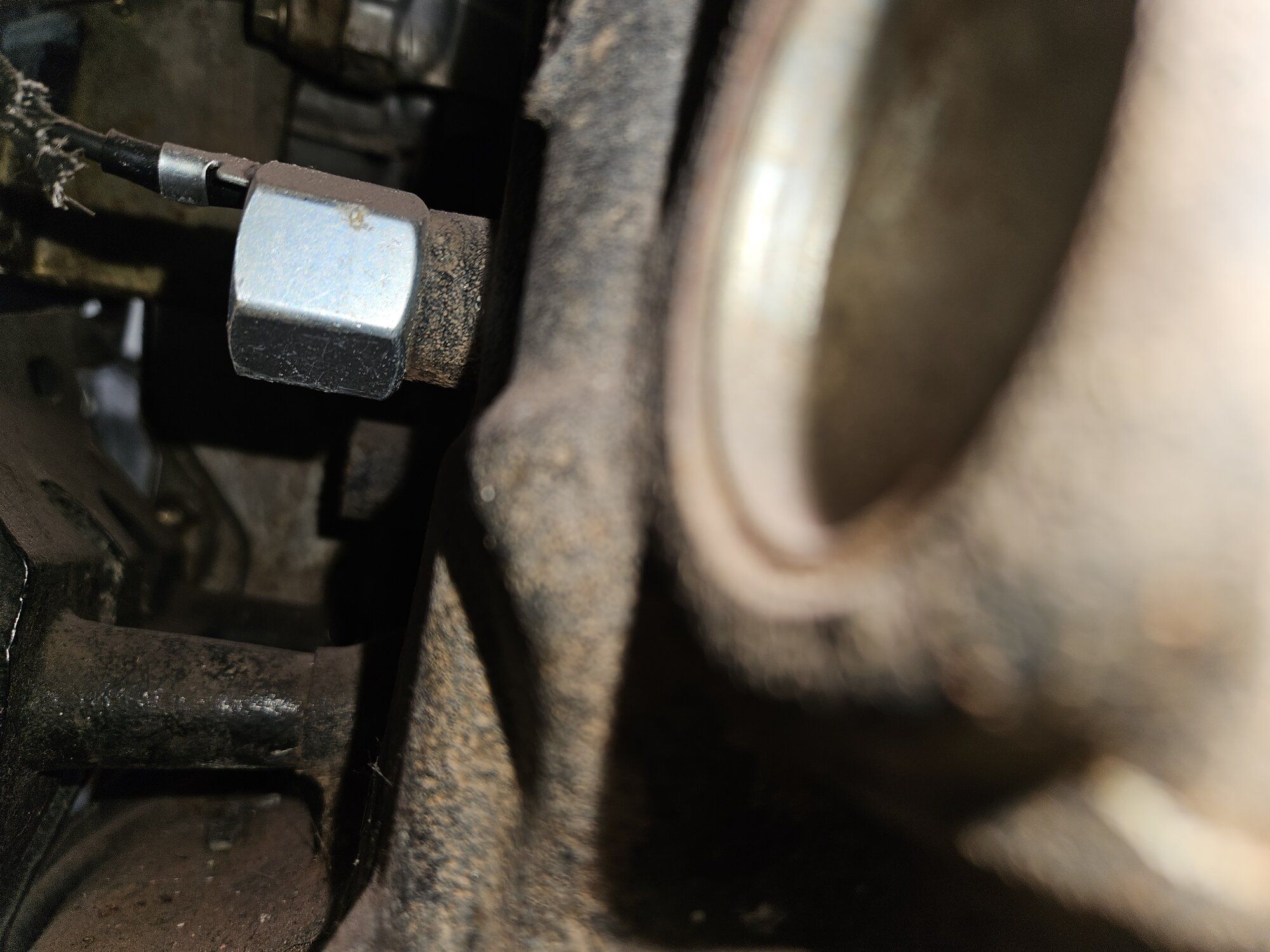

Mine is touching the knock sensor body it appears. I could try different sensors but the threads aren't tapered threads so if it doesn't bottom out in the hole, it would be the same.

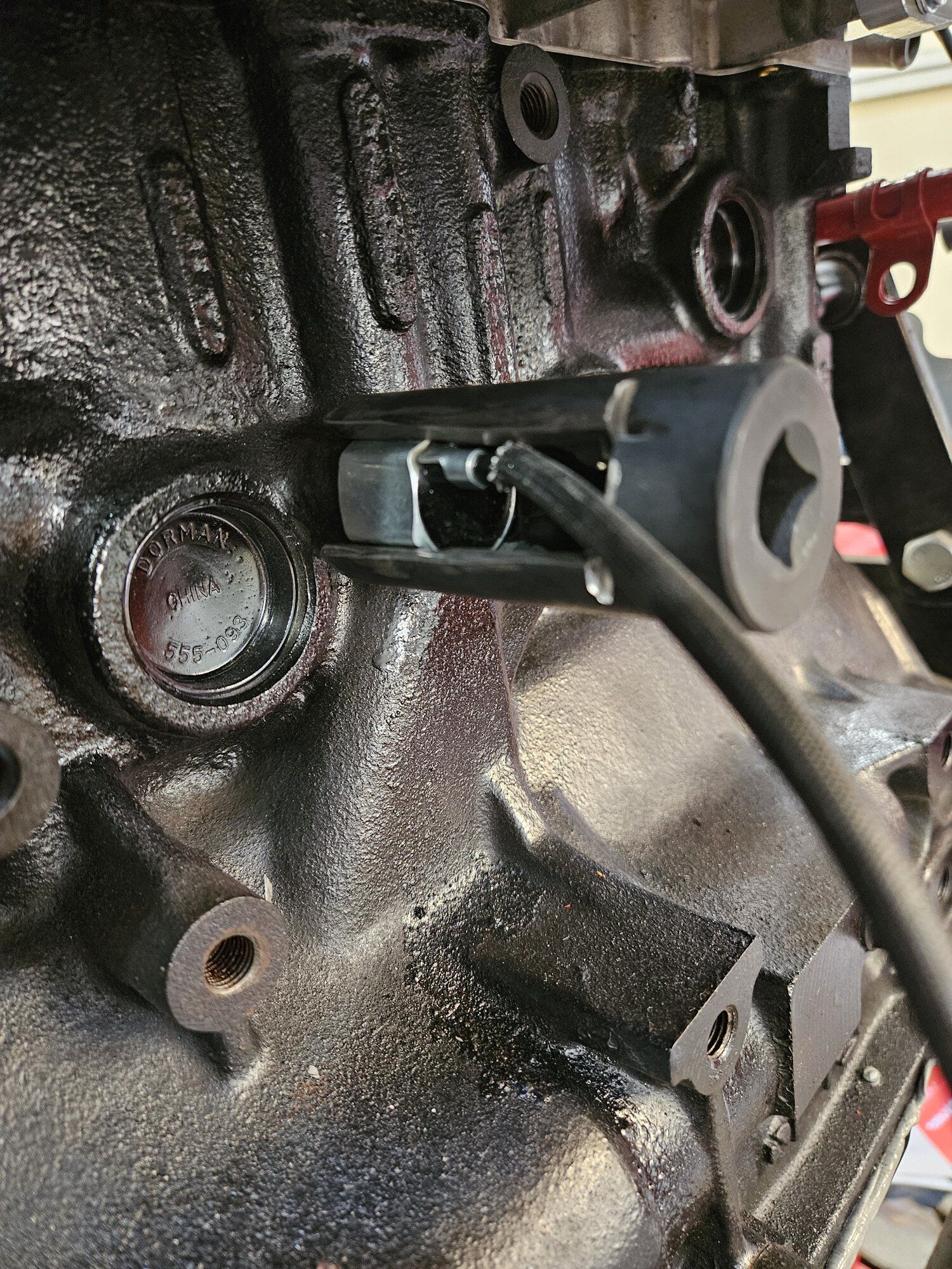

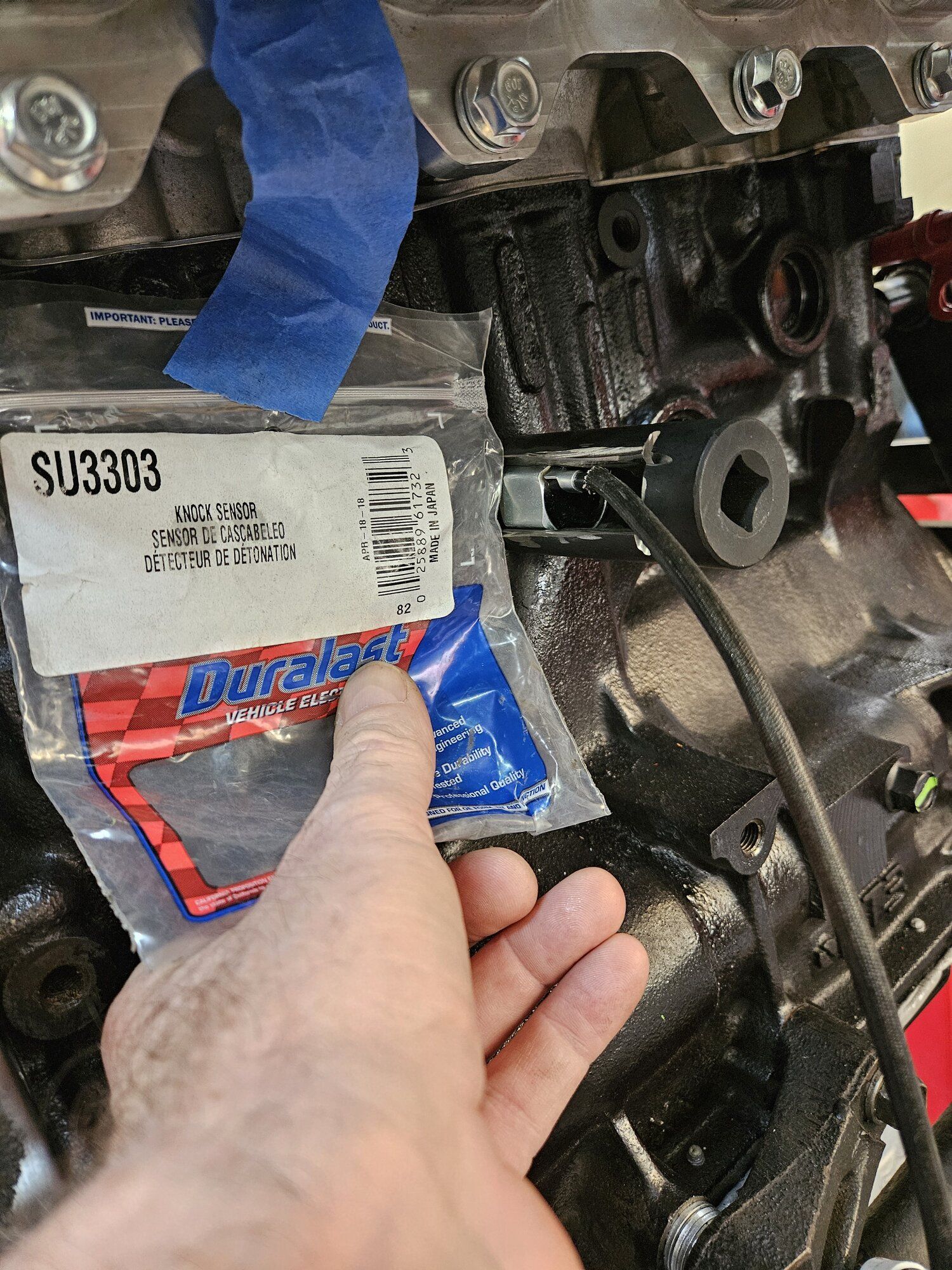

Pictures. This sensor is 15-20 ft lbs tight (not very tight at all but can't budge it by hand)
I am interested in the proper torque value so I am buying a 15/16 deep socket to cut a side out of, like a O2 sensor socket, and then be able to ACCURATELY install it to whatever its value is supposed to be (haven't looked it up yet). My Harbor Freight store has a socket for $3.99.

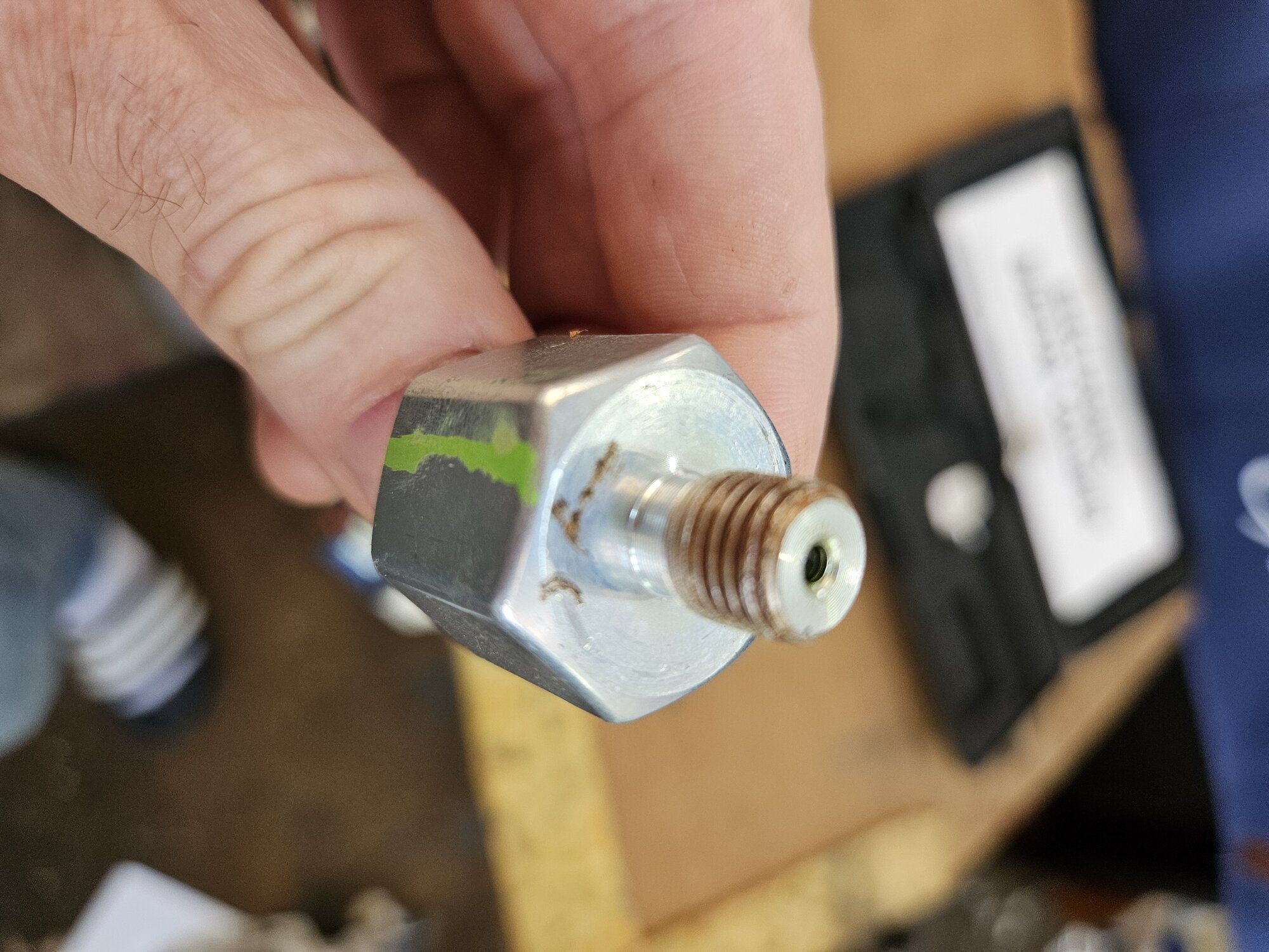

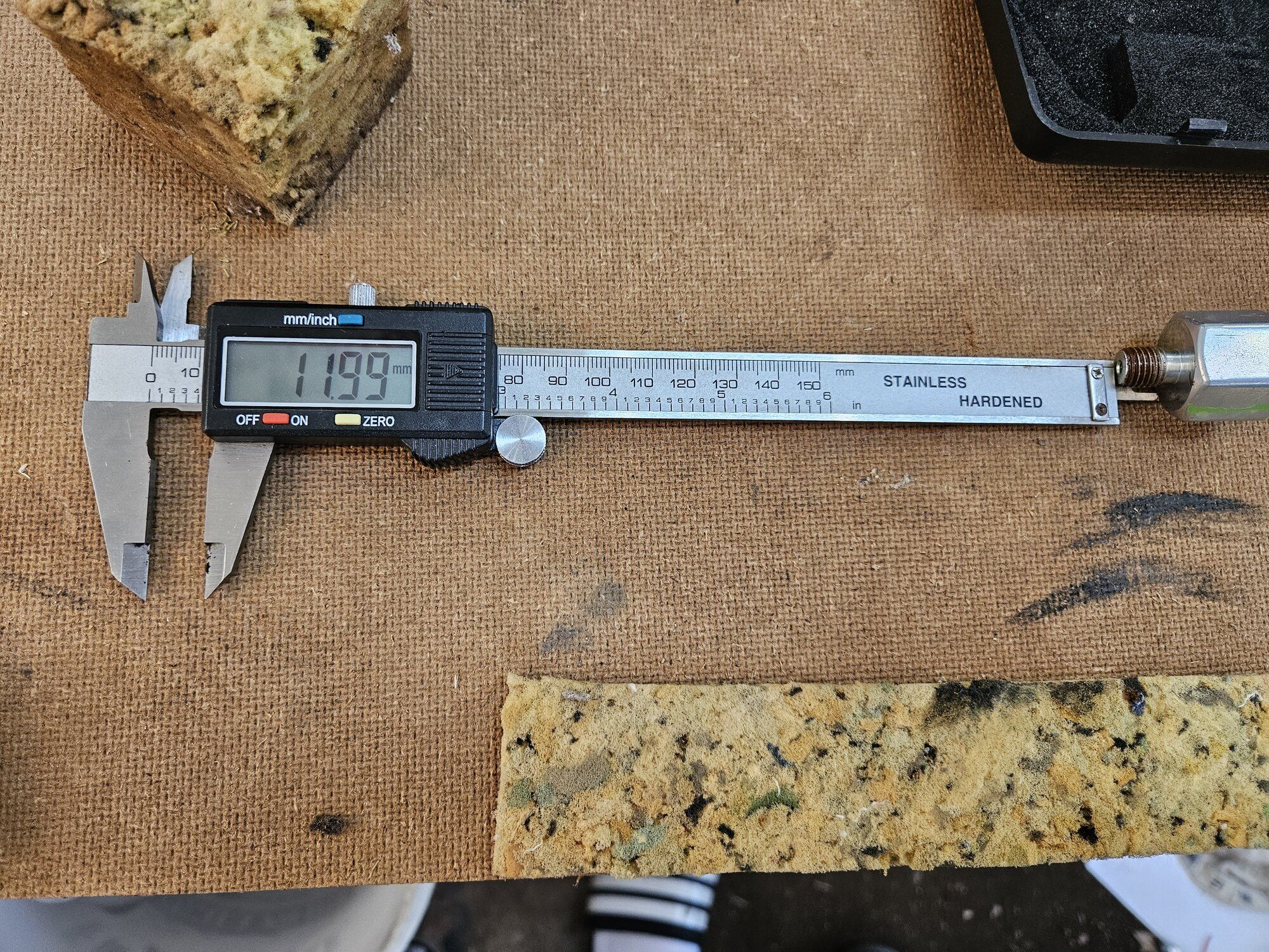

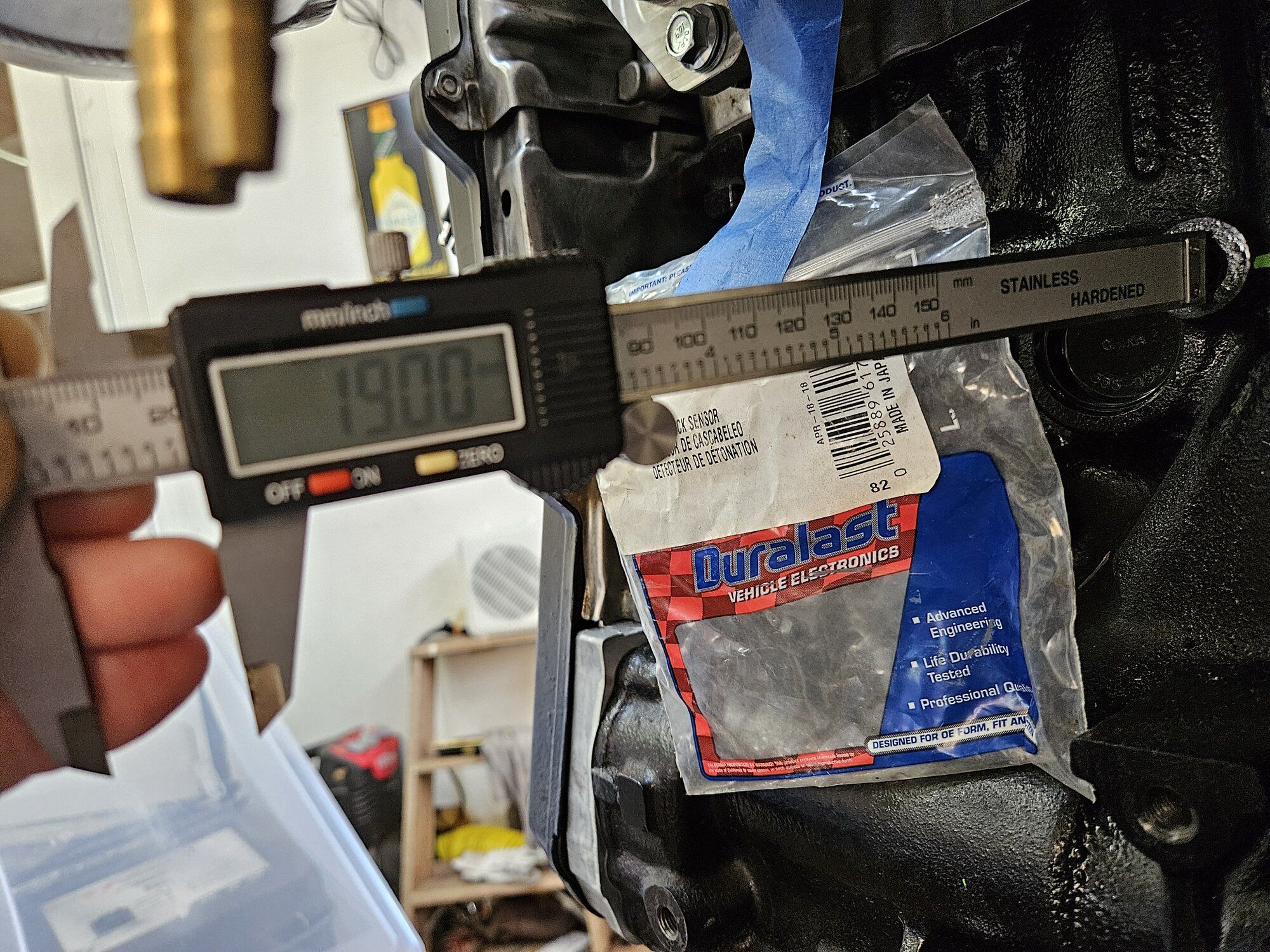

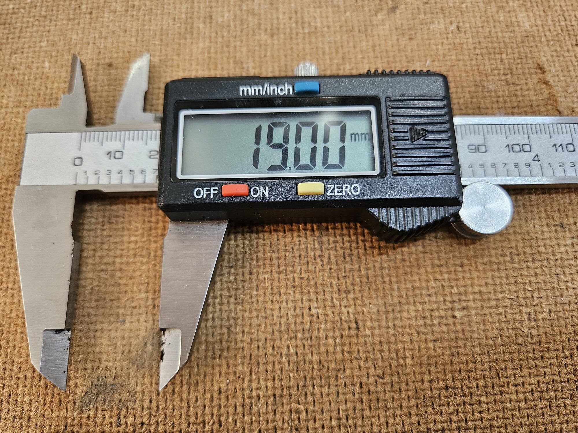

Soooo......I took my sensor out and measured the depth of the hole at 19mm. Sorry it's a bit fuzzy. Hard to do one handed.
Then I measured the length of the sensors threads. 11.99mm, so it bottoms out on my sensor body for all to know. There are also "witness" marks on the body of the sensor, which is in the last picture.
Marty
The Chenho sensor is also 12mm there.
Is the sensor in your pics a Mitsu OEM?
Sorry I've never seen this in the flesh with engine out of the car, but the face around that hole doesn't look right. It looks like as-cast. Rough as heck. It's not the kind of surface you would have something seat on. Unless that's just gunk and junk laying on the surface.
So the other possibility is that the threads in the hole start to run out just before 12mm depth. Since it's a blind hole right ? the threads won't go all the way to the bottom at 19mm, they'll end before. Could you put an M10 x 1.25 bolt in there, turned in just finger tight, and see how deep it goes in there to finger tight?
Okay for everyone's enjoyment (and head scratching).

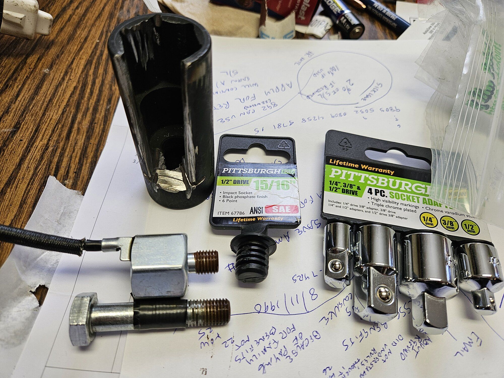

Knock sensor hole is threaded all the way. I grabbed a bolt, ran it all the way in and wrapped tape around at the block level.
Here are the results, and also, I hack jobbed a $4 HF Impact Socket, just for ease of installation from now on as I seem to build a few of these.
I also tested the Chenho sensor, it's the exact same size and length.
Enjoy!

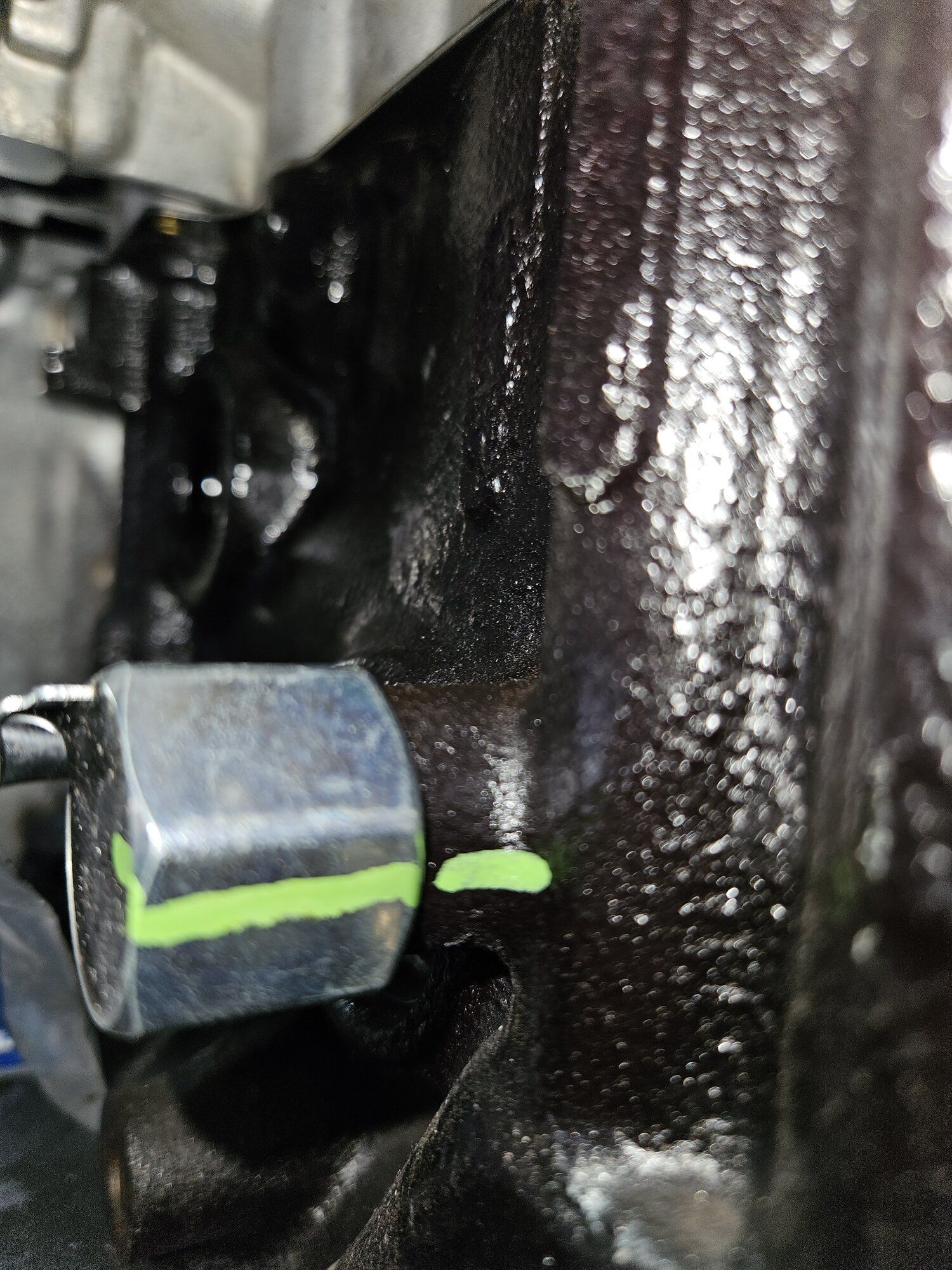

Pure stock 1990 motor and how the knock sensor sits on it. Just like my other blocks.

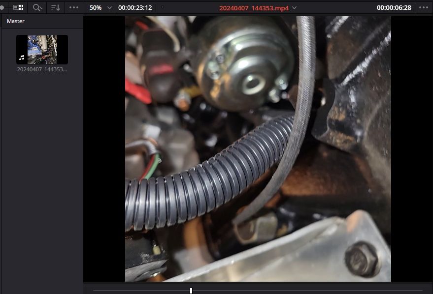

I've just now found my knock sensor. It's at 6:28 🤣
Still haven't seen it in the flesh. Just in this video.
It's hiding behind the coil pack bracket.
I shot this yesterday and today I downloaded and installed DaVinci Resolve (free version) just so I could go through it frame by frame hoping to find one good frame showing the sensor. This is it. The best frame out of 701 frames.
This is kind of like when @19Eclipse90 was helping me find my tach filter. 🙂
Left is Up in this shot.
my knock sensor hiding behind the coil pack bracket - screen shot from phone video.jpg
I see it :D
701 frames.......whew ROFL

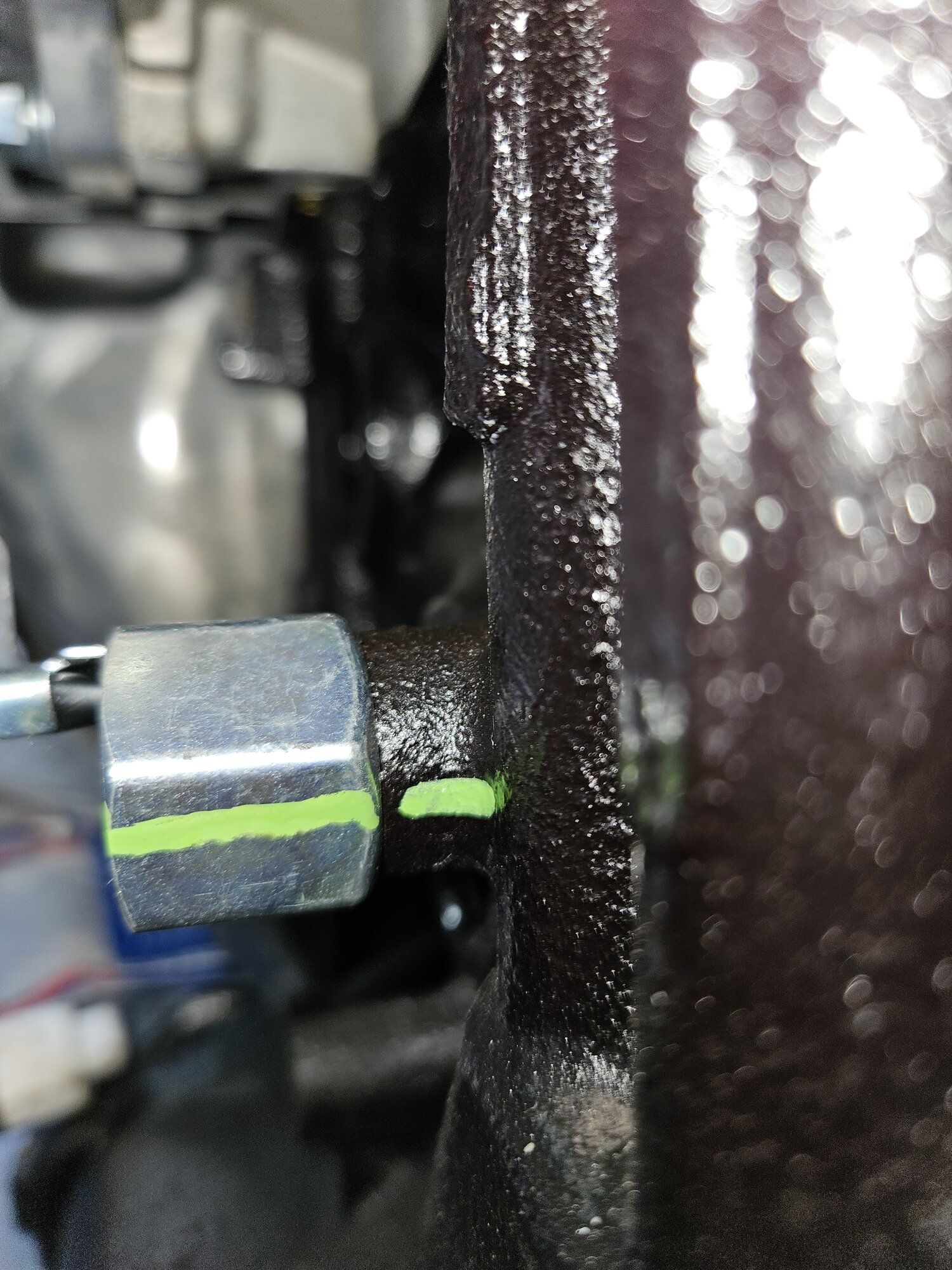

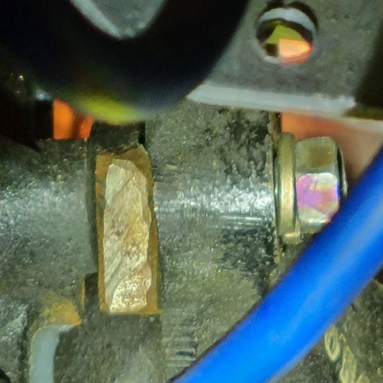

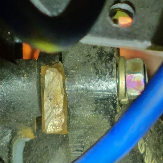

@CrackedDSM If Marty doesn't want that spacer, I wouldn't mind having it. The spacer I have in there looks like it was sawed off of the ac bracket. I checked the faces for parallel and it's not very good. Going around the bolt hole with a micrometer, the thickness ranges from 0.317" to 0.321".
The bolt through that foot was broken. That's the only reason I even took a look. The bolt was hanging on by a whisker which went with a little "tink" when I started turning it out. Not blaming it on the bad spacer necessarily but besides not being parallel it's not even 8mm anywhere. 8mm would be 0.315".
This is how it looked in there before I turned it at all. I just put a sharpie mark on one flat and took the pic.

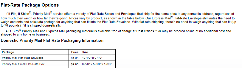

Hmm, Ground Advantage. When I look at that, it looks like you either have to take it to a PO for them to weigh and label it. Or you can use Click-n-Ship to do all that stuff at home and then take it to a PO and drop it into the packages hopper? Either way you gotta go to a PO right?
Isn't that still going to cost $5?
The smallest Priority Mail Flat Rate Box also costs $5:
Yes you would. Click N Ship should allow a label to be printed. Guess the weight at under 8 oz and send it. It should have a tracking number also.
You can also put in for a package pickup by your mail carrier. I get them and our carrier picks them up on her route.
Priority Mail starts at $9.85 for a envelope, $10.40 for the Small FR Box.
I gave you guys the best rate you can get, just like I do my customers. :thumb:
If you do it from home, I believe you get a discount but I've never used it myself. Just the services I offer all of my people at my window.
Ok I see $10.40 when I start from here and then pick "View Flat Rate Boxes". Phew.
What's that other page I found where it shows $4.95? Is that for some kind of business accounts or something?
I don't use the public side so I can't honestly say. Sorry. Maybe media mail rate, but that can only be a book or some form of media only. Just trying to be helpful :)

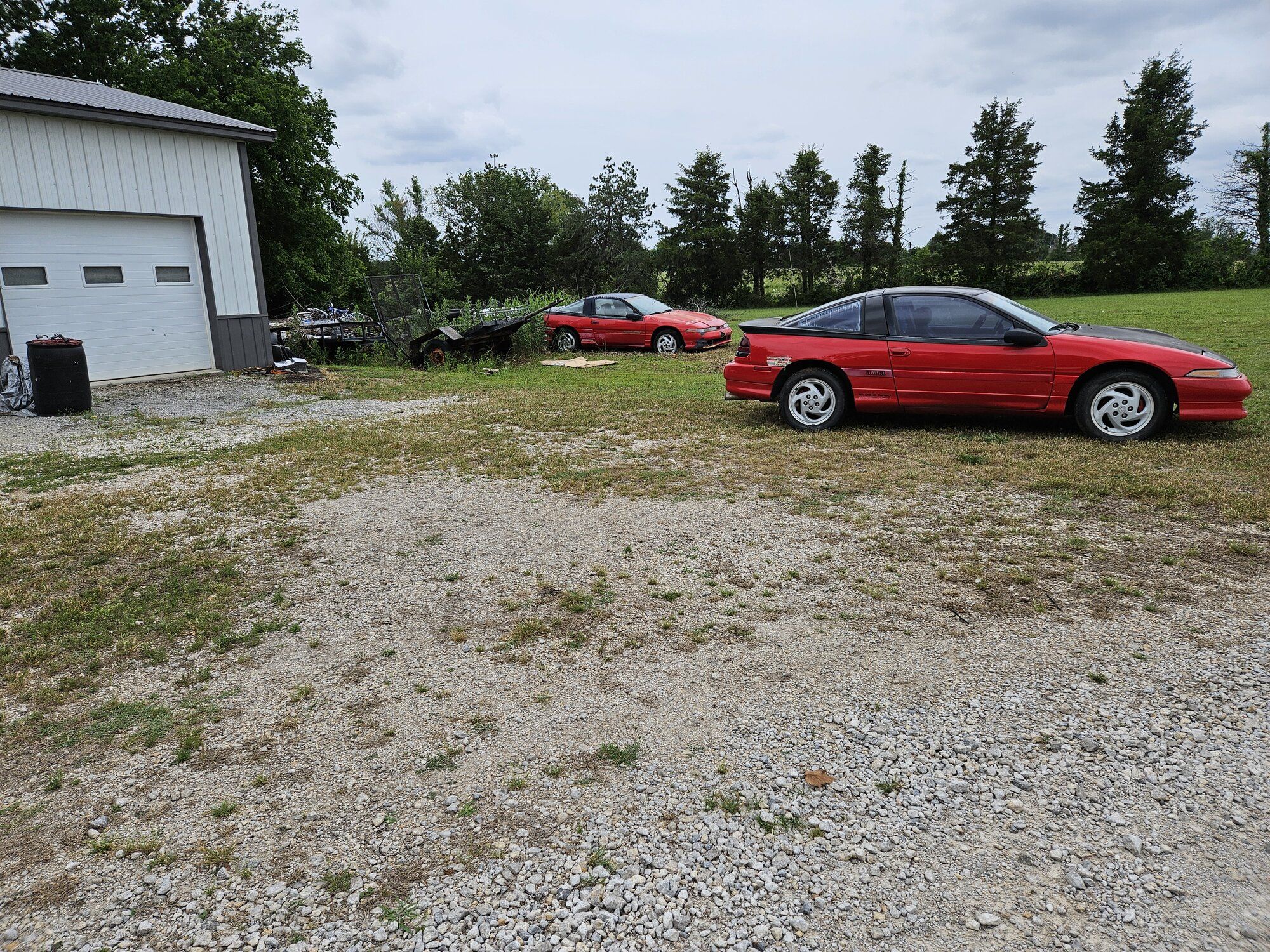

I got the Red 90 Talon moved over to in front of my shop with the help of my 8 year old Grandson Ayden. He is a BIG HELP all the time. I will push it in the lift bay when my son gets home from work.
Just an update to show that I am making a LITTLE PROGRESS. Any is better than none! :thumb:
