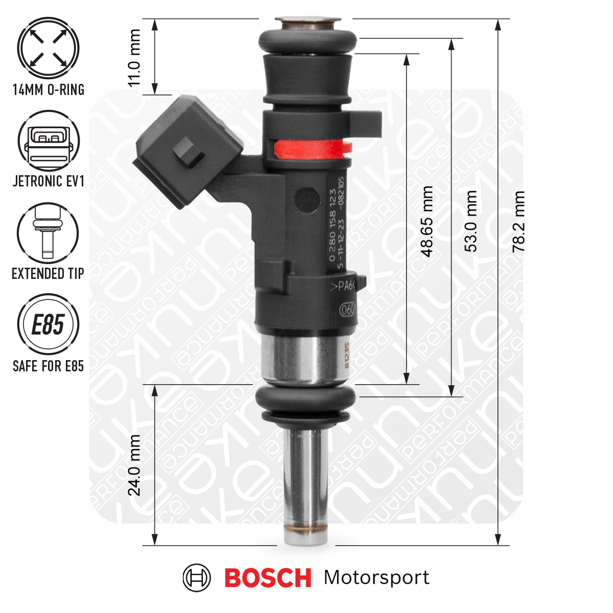

I do have a wideband, as I mentioned its running around 14.7 in the short test drive. the wide band is pretty much the only way I have ever been able to tune this engine. the injectors are the best fit for this engine (from a porsche 997 turbo)
heres the injectors im using
and yes I did delete the resistor pack
one says 630cc the other 600cc
