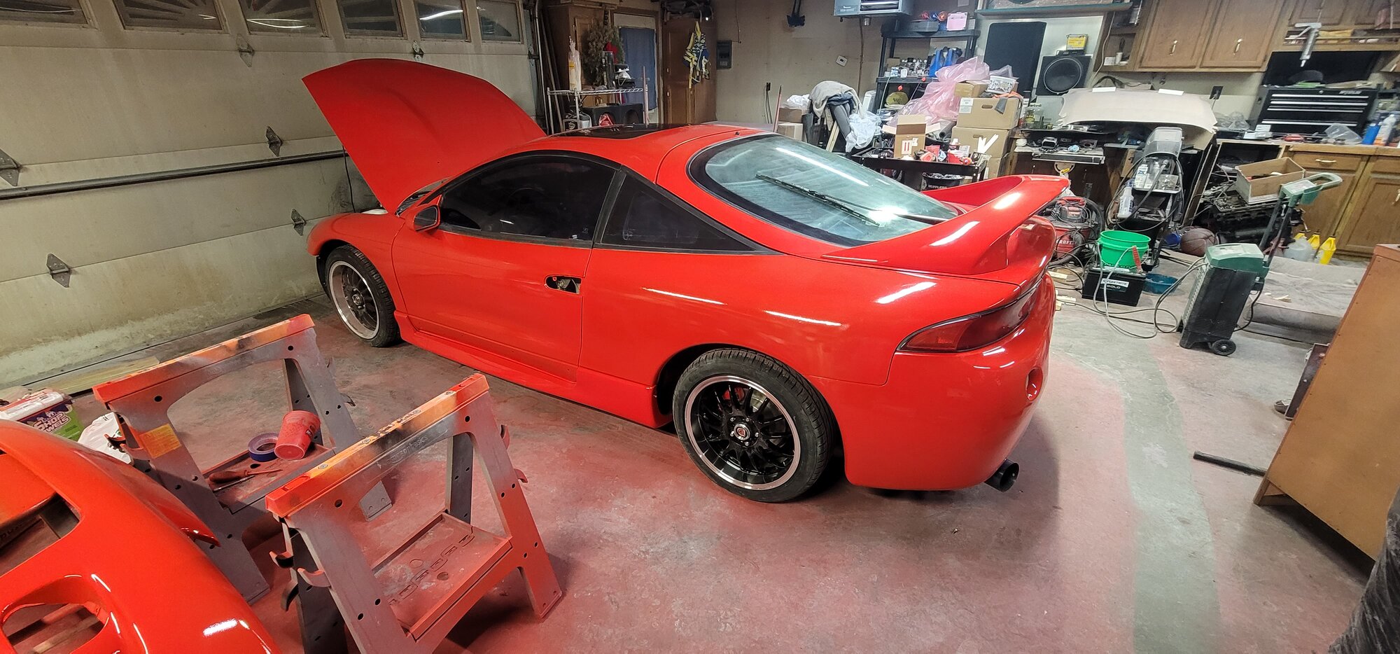

Neglected 95 Eclipse GSX nostalgia build
Cleaning up a 95 eclipse gsx after being neglected for some years.

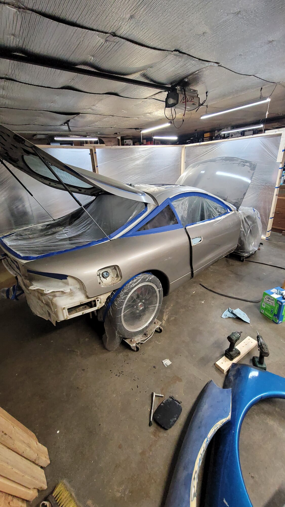

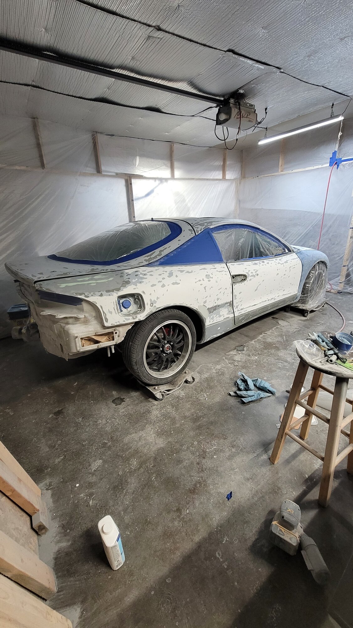

Tonight I got some of the roof and door sanded. The windshield is getting replaced so I ripped the moulding out which didn't take much effort. After it's all completely sanded and ready for primer I'll blow all the dust and re wrap everything just to keep it all as clean as possible. I'm trying to keep the dust at a minimum.

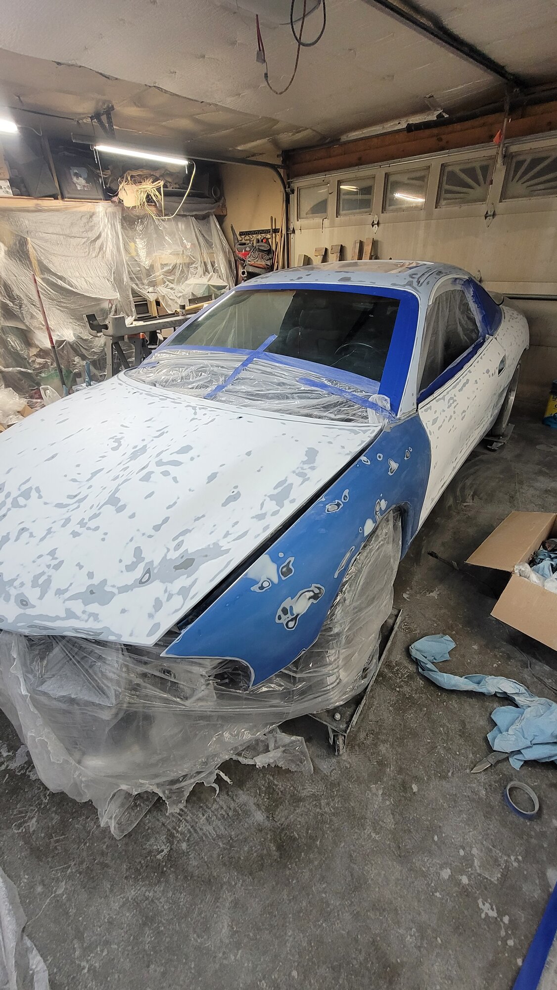

Alright so I need some advice, I got the car completely sanded to near perfection. That said it took many many hours to get through 3 layers of paint since the car was repainted. I'm not rich by any means so wasting paint is not what i want to do. I can always try to practice painting spare parts or I have my dads buddy that does this for a living to do it with what I have. I'm not afraid of trying, I just do not want to mess up because my hand and arm are literally dead from sanding and getting it perfect, started with 60 then 220 and final 600. There's not a single scratch you can see on this car, but I don't want to have to do it again. I spent my whole week off getting it this good and honestly I don't want to do it again, maybe I just need some opinions to see what you guys would do. I've been reading and watching videos but that means nothing to me without hands on experience. I could go by what everyone says and then still mess up so I'm just being very cautious.
I still don't get flash times on the primer and or when I need to to put base on. I'd like to put a couple coats on but it says on the primer will go on smooth so does that mean I don't have to wet sand it? When I put the base coat on what are the usual flash times to put another coat on 5 to 7 minutes? I'm just trying to do this right the first time. Thanks for the reply.

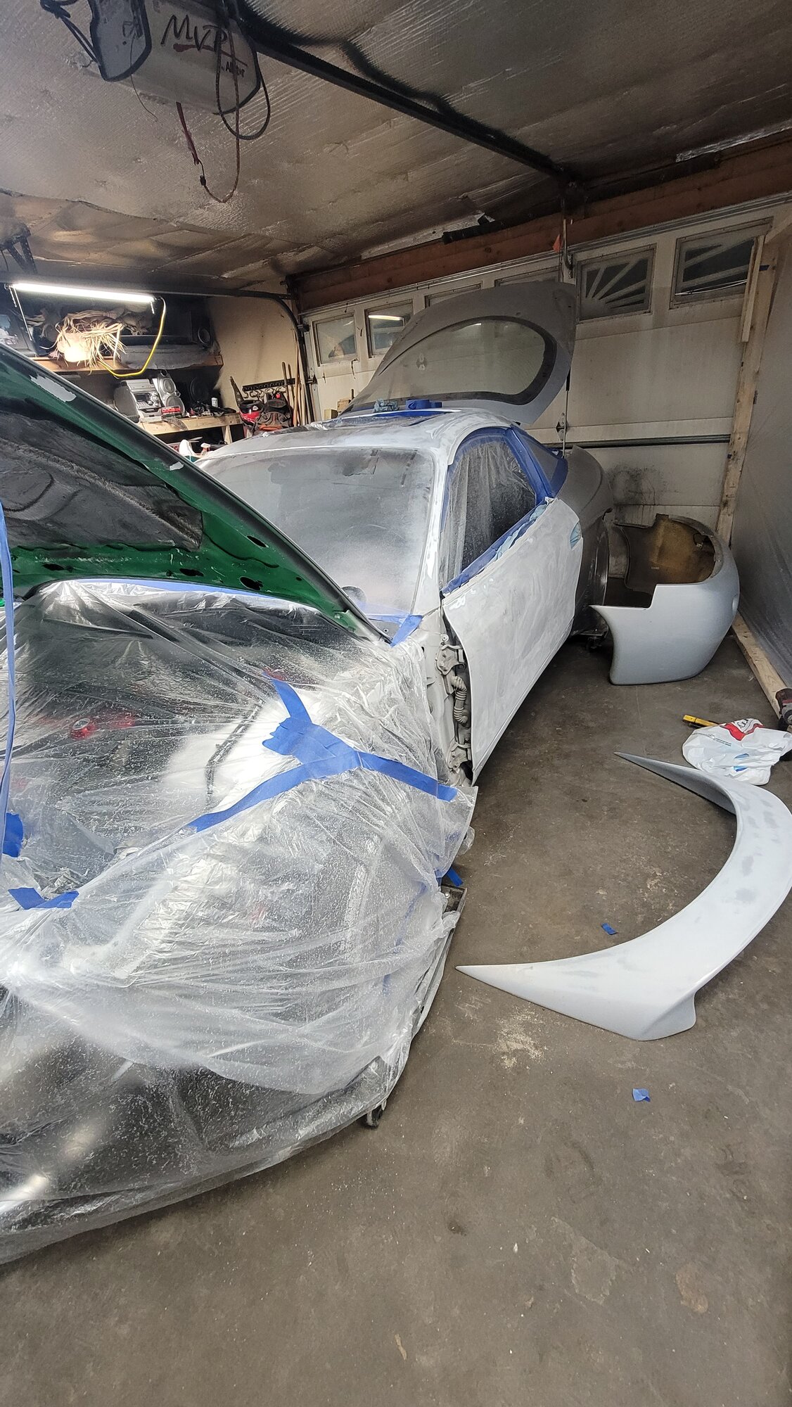

A little update on the car it's been completely sanded and taped up ready for primer. My dads buddy said he would come over and spray it for me. He's going to shoot the body and I'll probably do the bumpers and sideskirts. I just absolutely do not want to sand the body again. As fun as it was to sand through 4 layers, I do not want to do it again, I went through 1 whole layer alone with 220 which took forever. It's not going to be show quality but I'm hoping for the best.

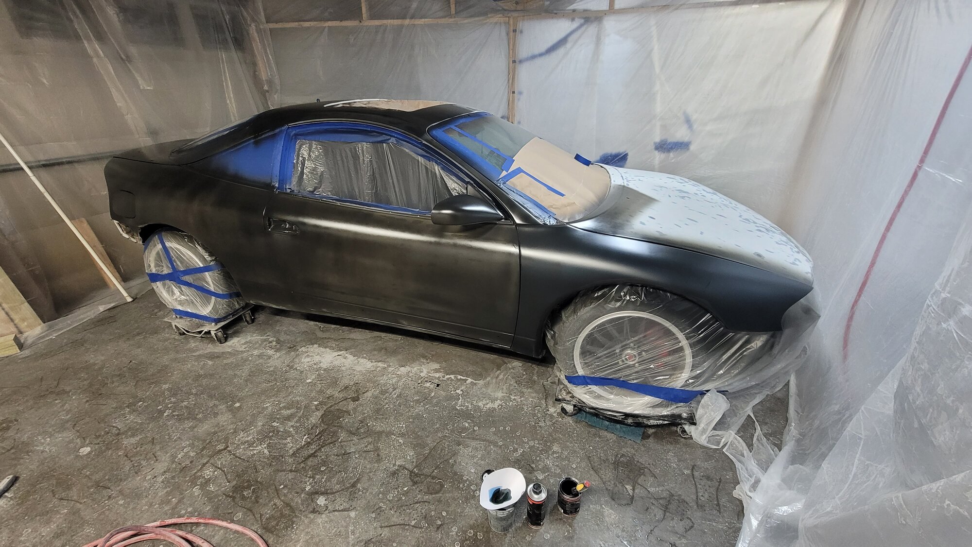

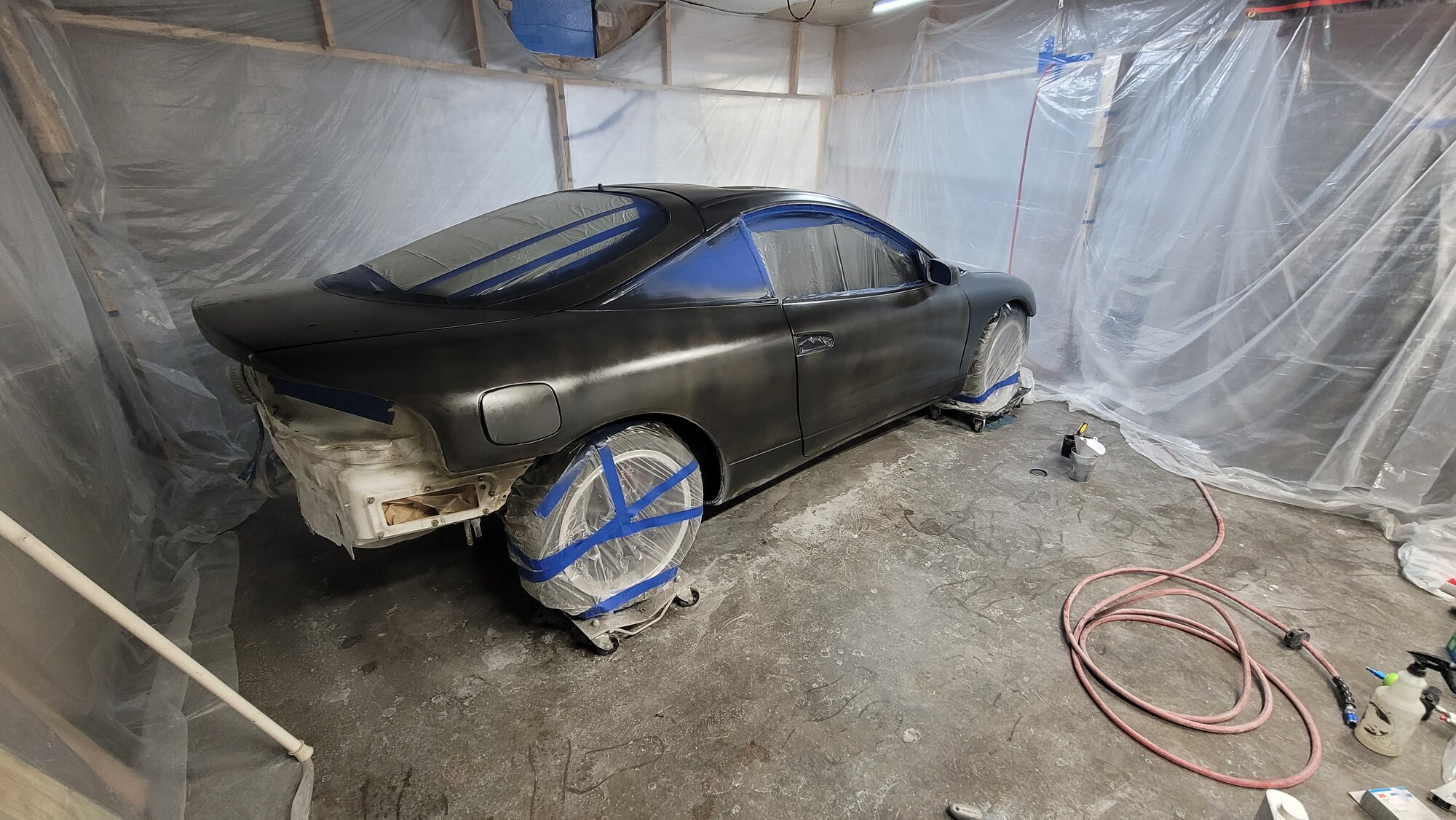

I finally got tired and bored of waiting so i decided to give it a shot myself. I fully expected to sand some of this primer down from imperfections, but I think I got my gun dialed in. There are some runs from me just hammering it in one spot because it doesn't go on thick, and I'm still learning. I ran out of primer so this was a test run and I'm not real scared anymore, I just have to learn to keep my hand moving and to make one straight full pass before letting off. Now I just wait for the right amount of primer and I'll do some light sanding on the car in the mean time.
Wow you guys picked a great color. I'm just hoping to have the car in one color that looks decent by this weekend. I already sanded the runs and whatever junk got in the primer. I just need to hit the rest with primer and then paint and then it's done finally.

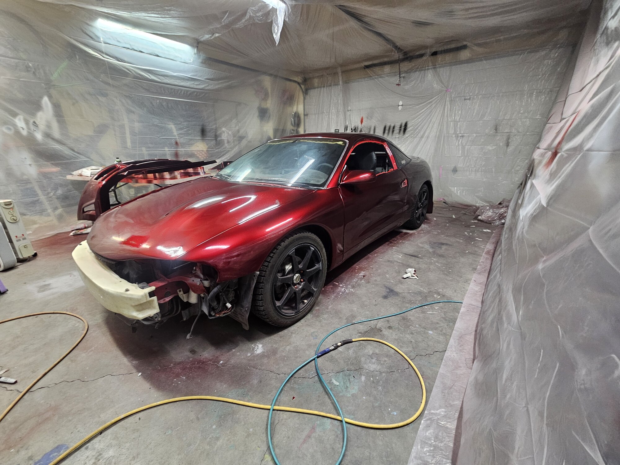

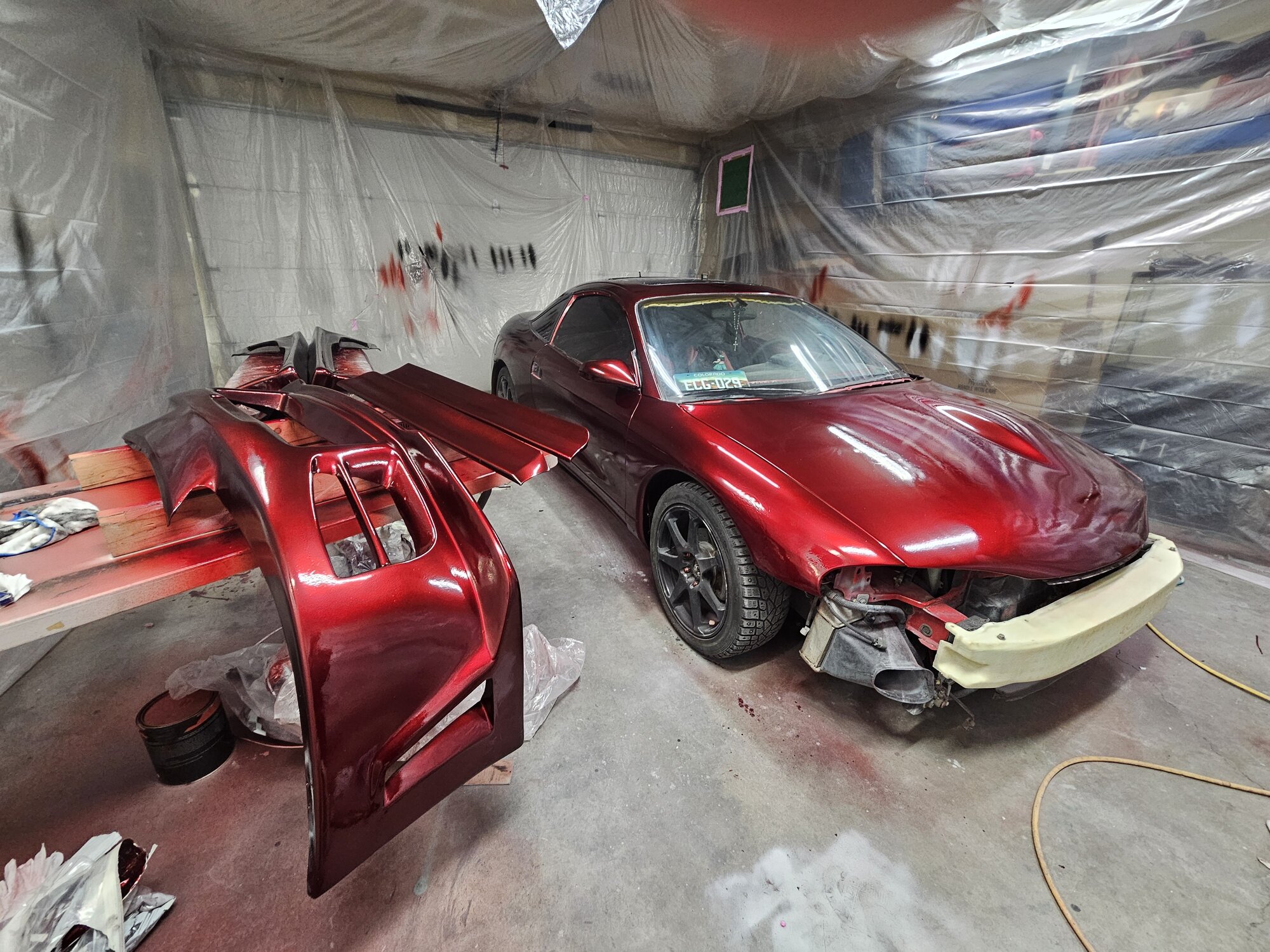

Thanks it was quite a process to get all the coats done. Took about a week and it was cold here so keeping the garage the right temp for the reducers and activators was a pain. Are you going to clear coat it or are you using a single stage paint?
For some reason at 70 degrees in my garage it took like a full solid 2 days for the primer to fully dry. I didn't use reducer though which my paint didn't require, it was pretty thin as is. I'm trying to keep it simple with a single stage so it probably won't come out as shiny as yours did. I'm also trying to keep my expectations pretty low since it's my first time and I know for a fact it won't be perfect.

I agree! I sprayed primer last night and my biggest issues were either holding the gun to far or to close, and then stopping at an absolute dumb spot that I shouldn't have stopped at in the first place. I'll just have to sand down a few more runs and then lay a few coats on and be patient that's my biggest problem. I'm just trying to lay it on thick the first time just to be done. Another huge problem is there's just way to much crap floating in the air, I've got 2 puller fans with filters and one pushing in front of my furnace also with a filter. I also swept and put water on the floor multiple times. It doesnt help my saint bernard sheds crazy amounts of hair just to add that to the mix. So I think for the base coat I may end up bringing it to my buddies place for that. I'd just like the primer to come out decent at the very least. It definitely frustrated me last night. I just decided to let it dry because worst case scenario, I sand down the imperfections.
