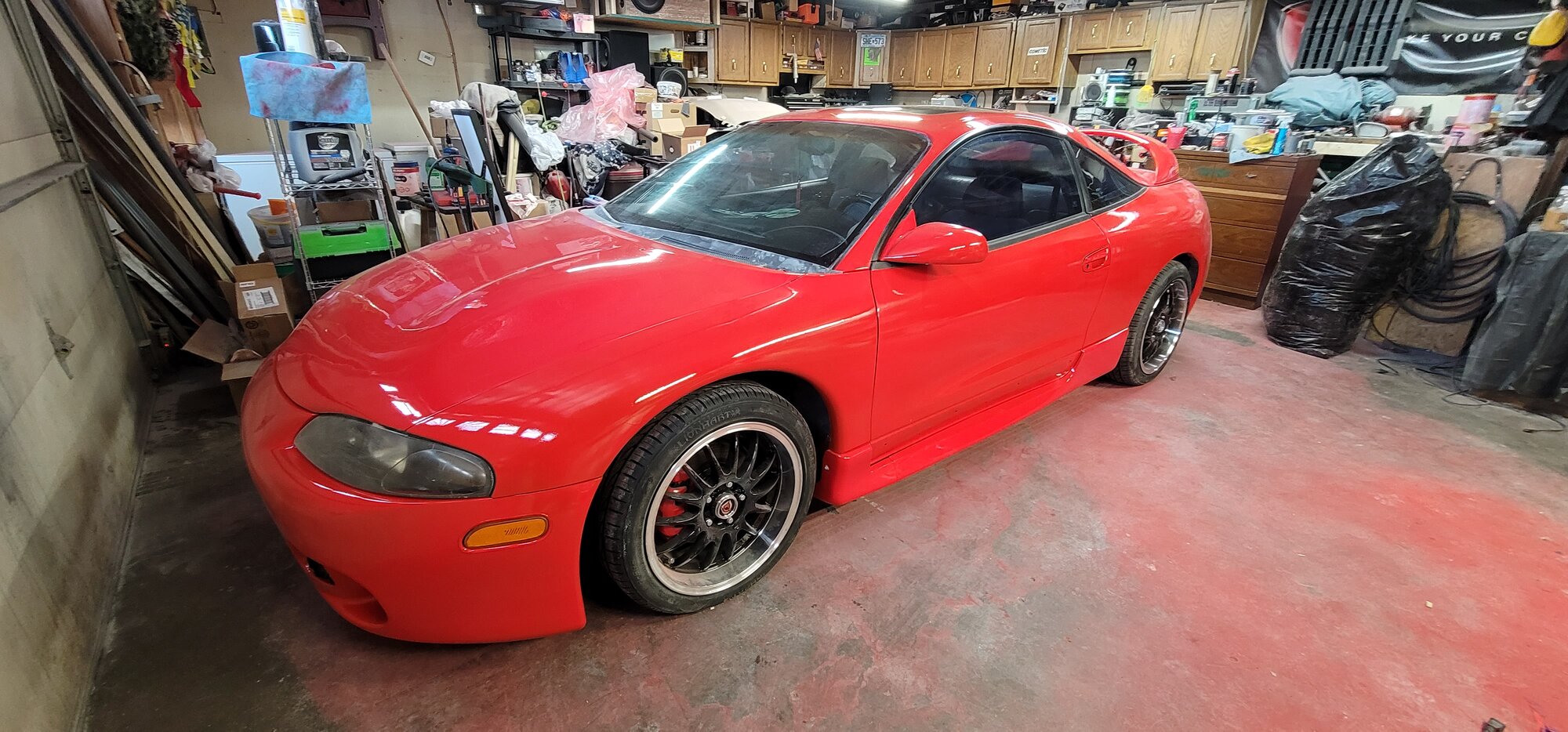

Neglected 95 Eclipse GSX nostalgia build
Cleaning up a 95 eclipse gsx after being neglected for some years.

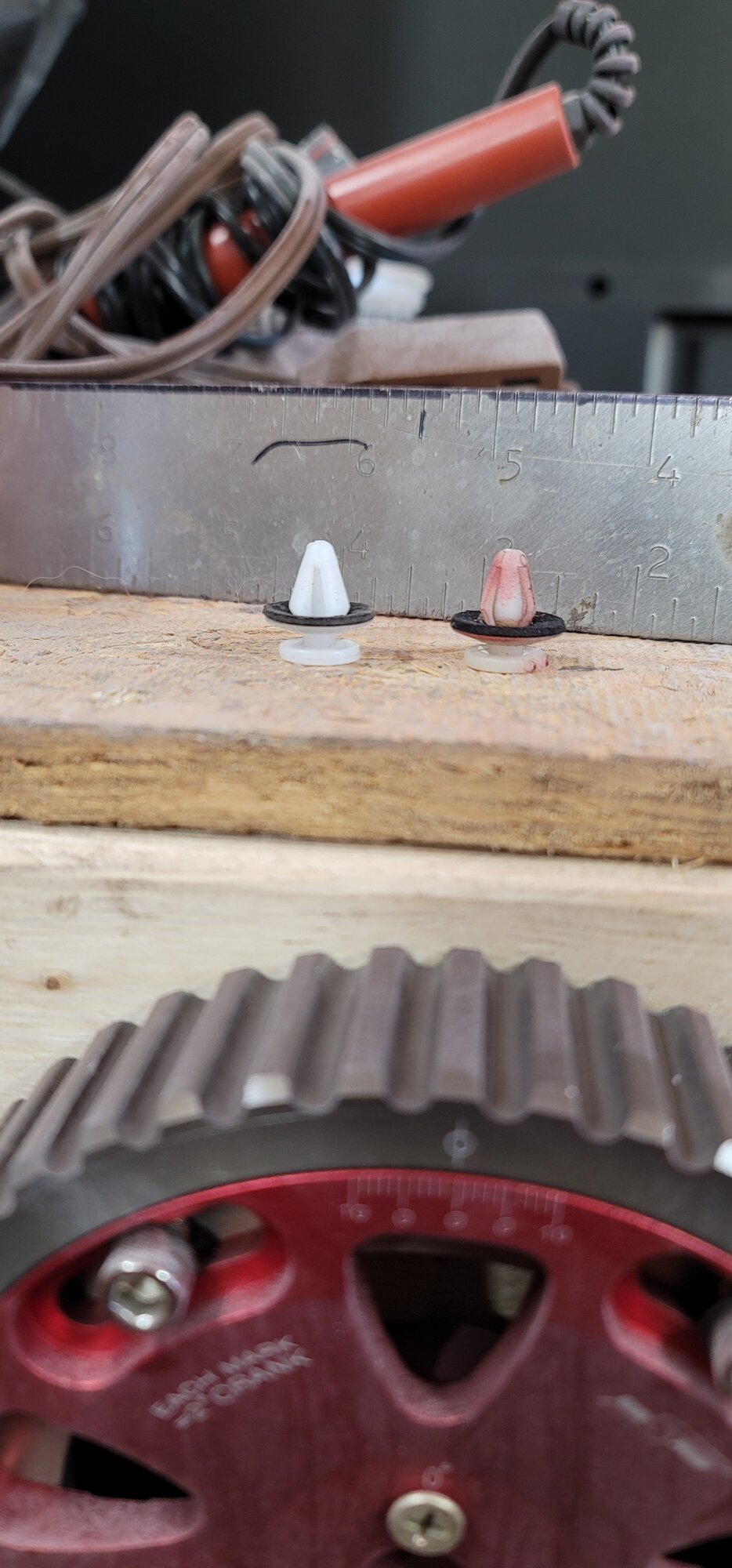

I've ordered 3 bags of so called "oem" clips for the door caps and they just are not right. The actual one on the right fits in the holes but the left one is not even close. They all break. I'm actually kind of annoyed paying over 20 bucks for "oem". I don't get it.
