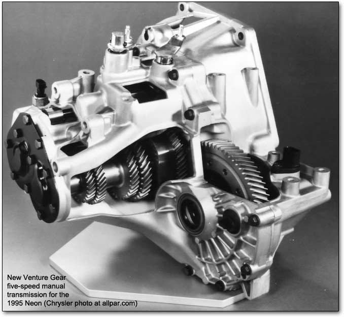

For reference, these transmissions are loosely interchangeable:
- 1995-1999 Dodge Avenger M/T (direct swap)
- 1995-1998 Eagle Talon ESI M/T (direct swap)
- 1995-2005 Dodge Neon M/T (Gearing changes occurred for each generation and later generations require shifter arms being swapped to use in your car).
- 1996-2001 Plymouth Breeze M/T
- 1995-1999 Chrysler Sebring 4 cyl M/T (direct swap)
- 1995-1999 Dodge Stratus 4 cyl M/T
- Some early model PT Cruiser transmissions can be used with slight modification. I'm not sure exactly when but they switched to the G288 around late 2005 to early 2006. Which will bolt up but has many internal and external differences.
Some of these cars used cable clutches so the belhousing is different, but your belhousing can be swapped very easily so that shouldn't sway you from getting one.
Here's a great write up on the basic specs and history of the NV-T350. I haven't fully studied this myself but probably will soon.
