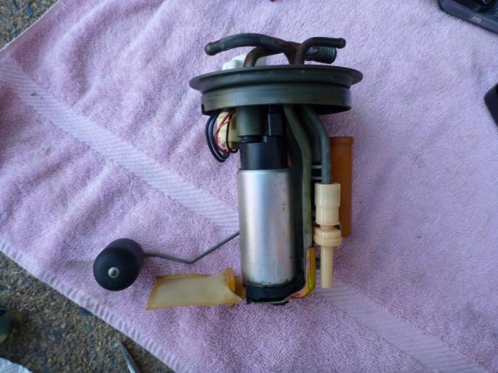

(4/2013) Evo 9 fuel pump
After installing the fuel pressure sender, I noticed my fuel pressure would drop at WOT as the rpm's increased even though it could still (barely) maintain a 12:1 afr. Surprise, surprise, the stock fuel pump can't keep up with E85 even on the t25. $20 and a lot of time trying not to break the fuel feed line off the sender, an Evo 9 pump made its way in. I also drilled out the siphon while I was at it, I think to 7/64".

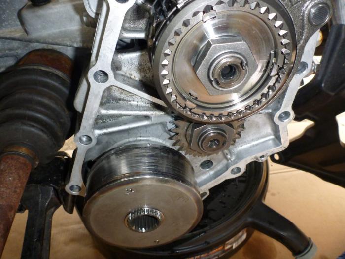

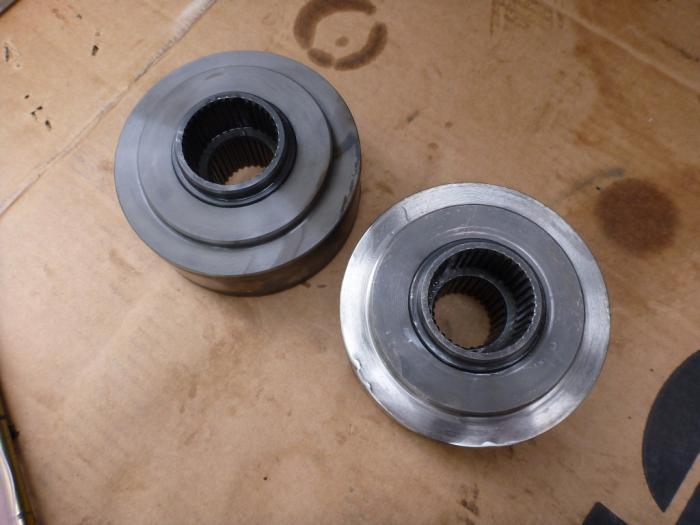

(8/2013) Viscous coupler swap
My friend noticed at the Carlisle autox that on launch my front tires spun and the rears did nothing. I wasn't up for pulling the rear end of the car apart for inspection, so I took a stab at just replacing the viscous coupler with a used one from TMZ. The old one didn't look bad, but slow-mo videos after the swap show that the VC is doing what it should be, although the fronts do still spin considerably more.

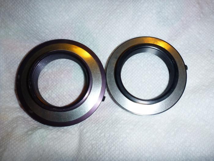

Original on left, replacement on right:

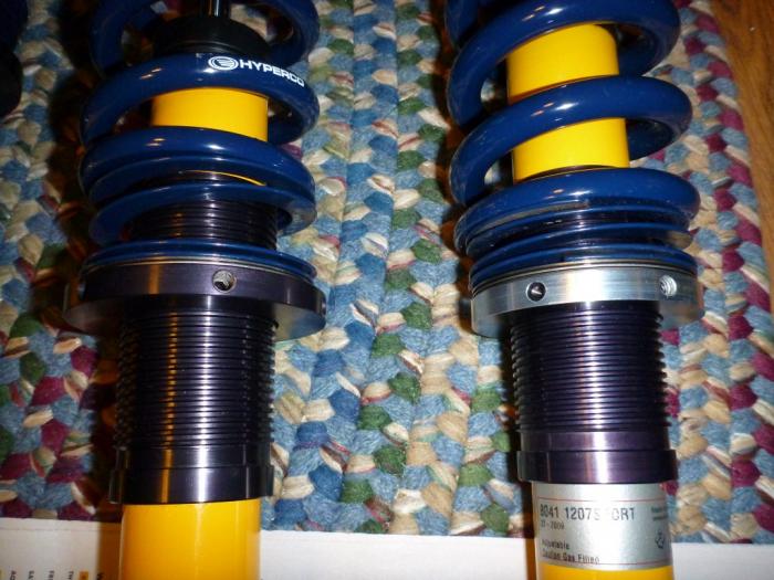

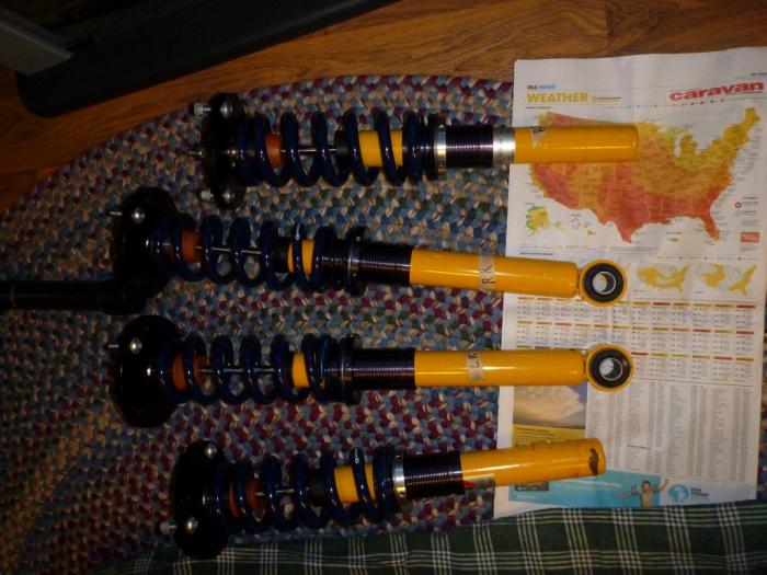

(8/2013) DG Coilover changes
Tore down the coilovers for a good cleaning. Replaced the Torrington bearings. My front tires were rubbing on the lower spring perches at full lock (made a nice squeaking sound), so I got a new set of perches and had them machined down to just a hair bigger than the Torrington bearing races. (This eliminated the rubbing on the passenger side but still rubs just a tiny bit on the driver side, not a big issue). It's nice to be able to turn full lock again without everyone hearing it. Switched the springs from 650/350 to 800/400 and re-corner balanced and aligned the car. I cut my inner tie rods to fix my front toe adjustment issue:
http://www.dsmtuners.com/forums/han...-toe-adjustment-problem-tie-rod-too-long.html

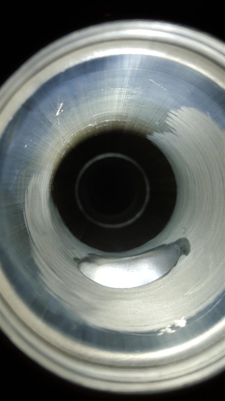

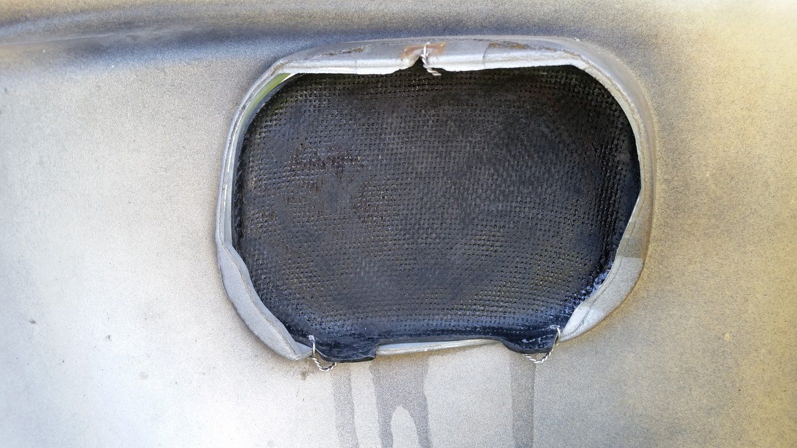

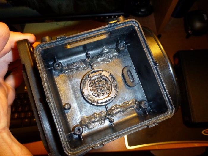

(8/2013) Gutted 2g maf

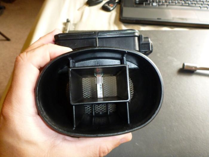

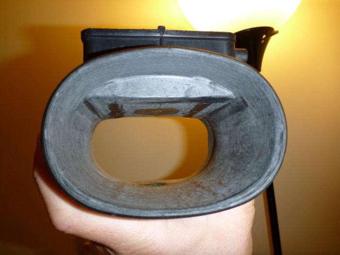

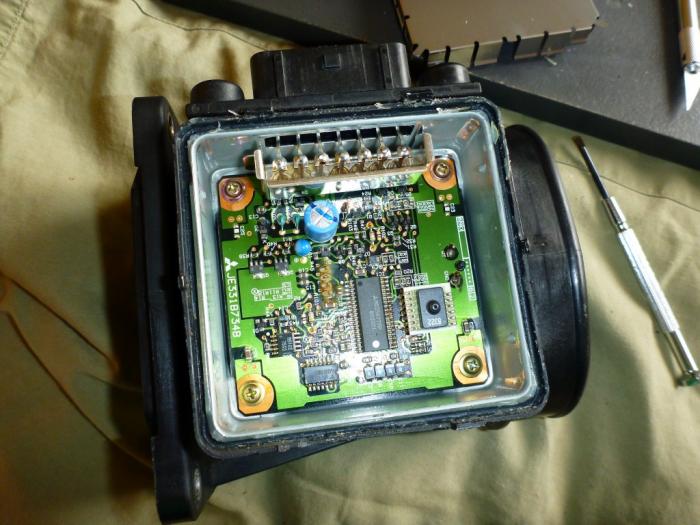

It's been a long time since I switched to speed density, so my stock maf is just holding my filter. I finally got around to gutting/porting it. This actually took a LOT of work, but it turned out nice. Beside the increased flow I'll gain, it actually cut the weight of the maf in half.
Before:
After:

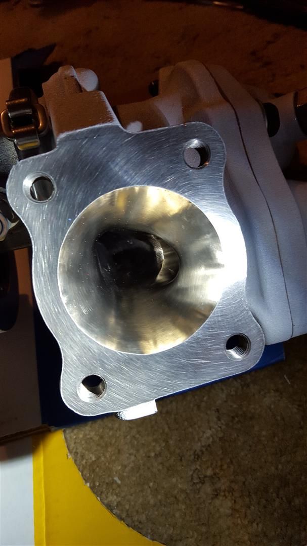

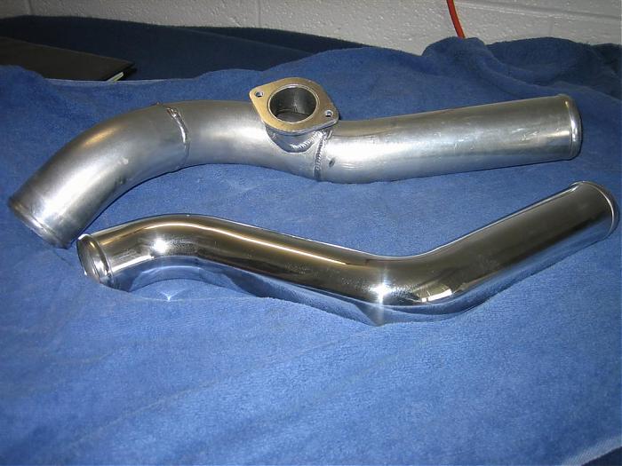

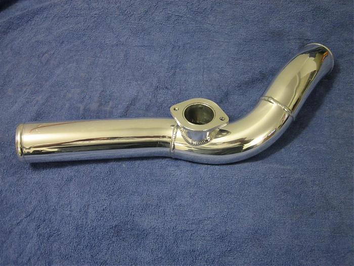

Awhile ago I polished my Greddy intercooler pipes (got them used from a friend). Here is a before and after type shot.

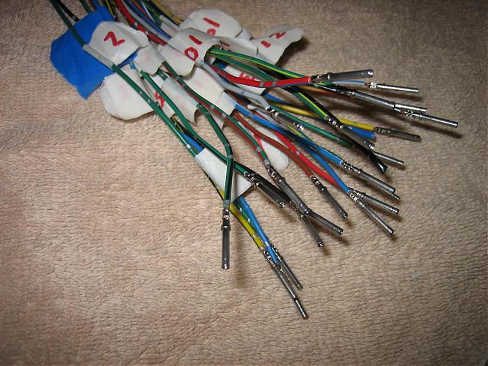

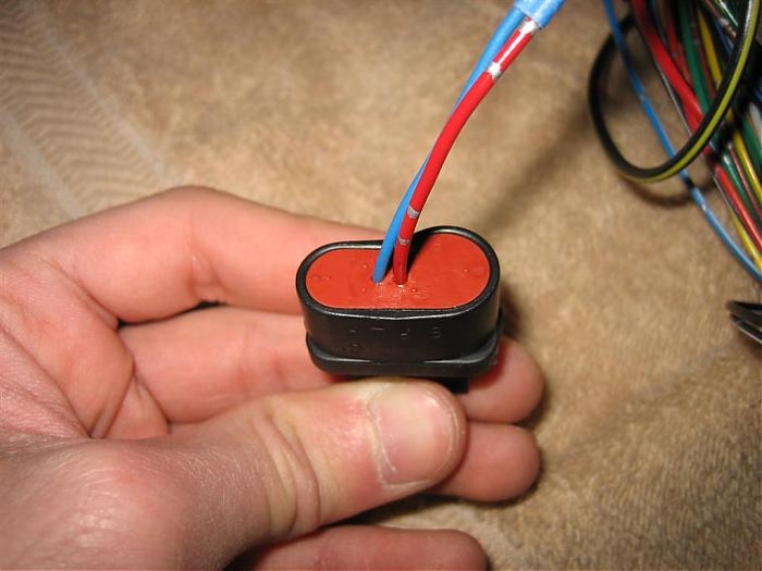

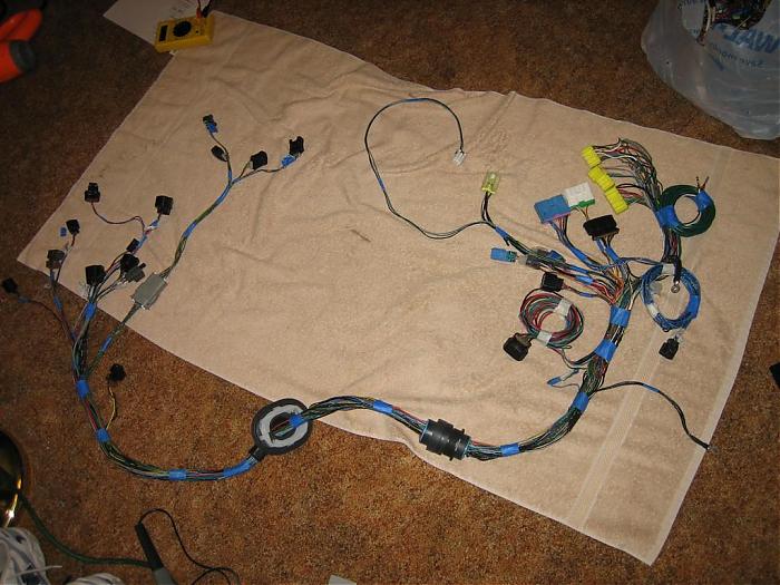

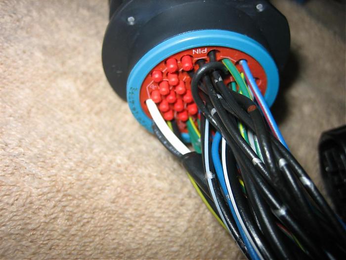

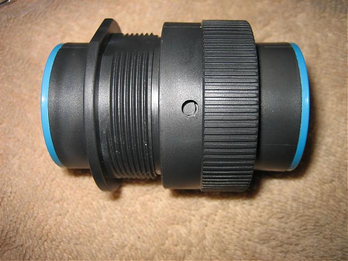

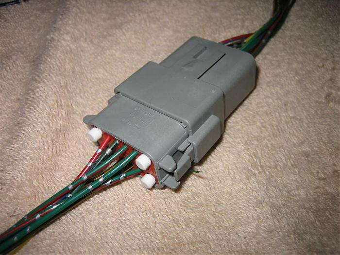

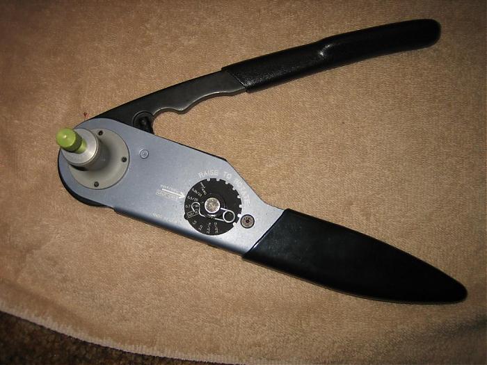

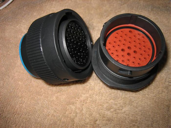

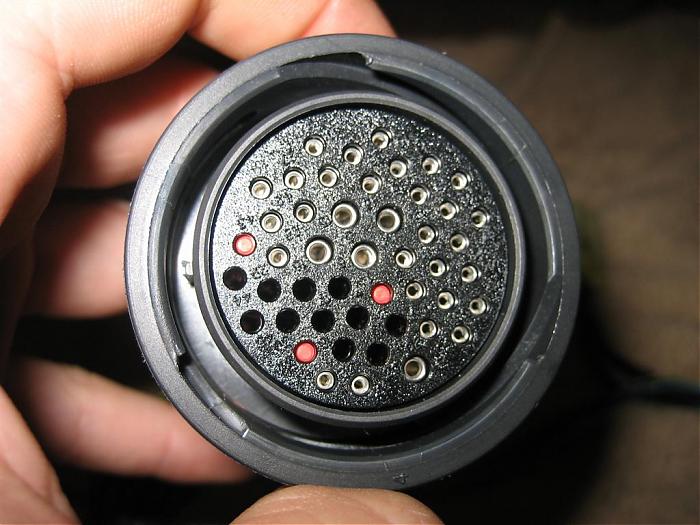

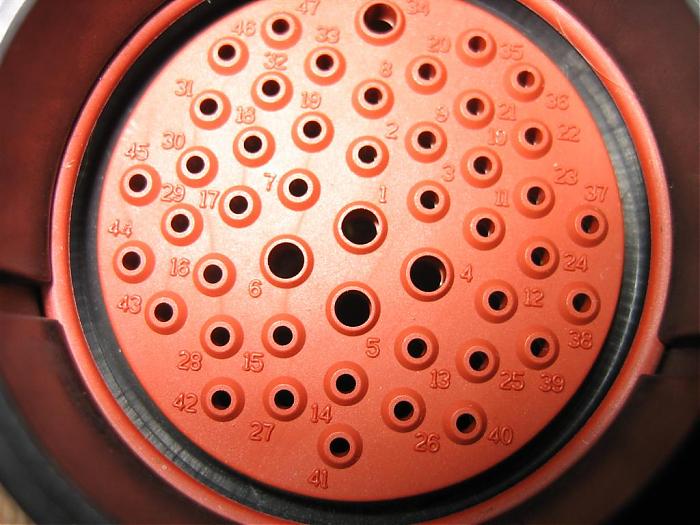

My ECU harness is now 95% done, the other 5% will be done at the same time as the fuse box harness. The connectors I'm using are Deutsch connectors from laddinc.com. I use a special crimper to crimp all the terminals. Any empty spots in the connectors are filled with plugs to environmentally seal the connectors. Every position in the connectors is numbered so I made a chart of which wire goes where, making maintenance easy in the future. I think there were only 2 wires that needed lengthened, the rest were shortened by at least 2 feet, sometimes up to 4 feet. By using the connector I was able to keep soldering to a bare minimum, mostly just on the power and ground wires (grounds were all moved inside cabin). The injector clips all go into one big connector so I can remove the harness without unplugging the individual clips. The injector connector mounts to the bottom of the intake manifold with a bracket from laddinc. If anybody is really interested in the connectors I can give more info on them, but they are really nice. I threw in a picture of my alternator plug from Ballenger Motorsports, great prices and service there and the crimper I got from there is really nice. Also in the pictures is where I mounted the power transistor and injector box, underneath the relays near the ecu. I liked this spot because it kept all the electronics in the same general area. I'll post pictures of the harness installed next time I put it in.
A lot of hours went into that harness and each wire was placed precisely. I went through and checked every wire in the harness to verify it went to the right place; it was a good feeling when they all were right LOL I'm now working on the fuse box harness. First I need to mount the fuse box. I found a good place for it so I'll show that once I make mounting brackets for it. Then on to redoing the wiring on the harness.

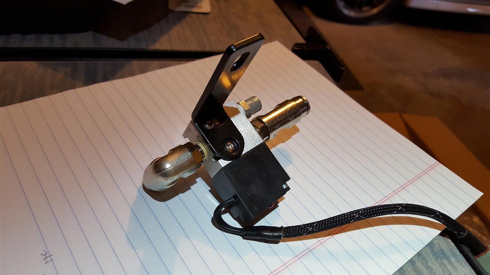

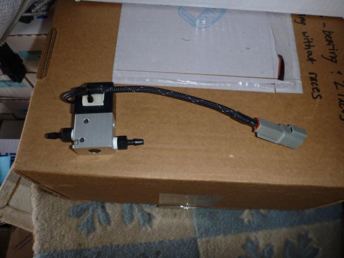

Swapped from a mbc to ebc using ECMLink. The solenoid is mounted to a bolt that was drilled and tapped, then installed in the scatter shield.
Where did you find that connector for the EBCS? I have been looking all over!
Thanks for the help BTW. I hope to get my battery relocation done as soon as the Knukonceptz parts arrive! Both you and your brother are an invaluable source to this community. :thumb:
You beat me before I could edit my post haha. Found the catalog, DTP series?

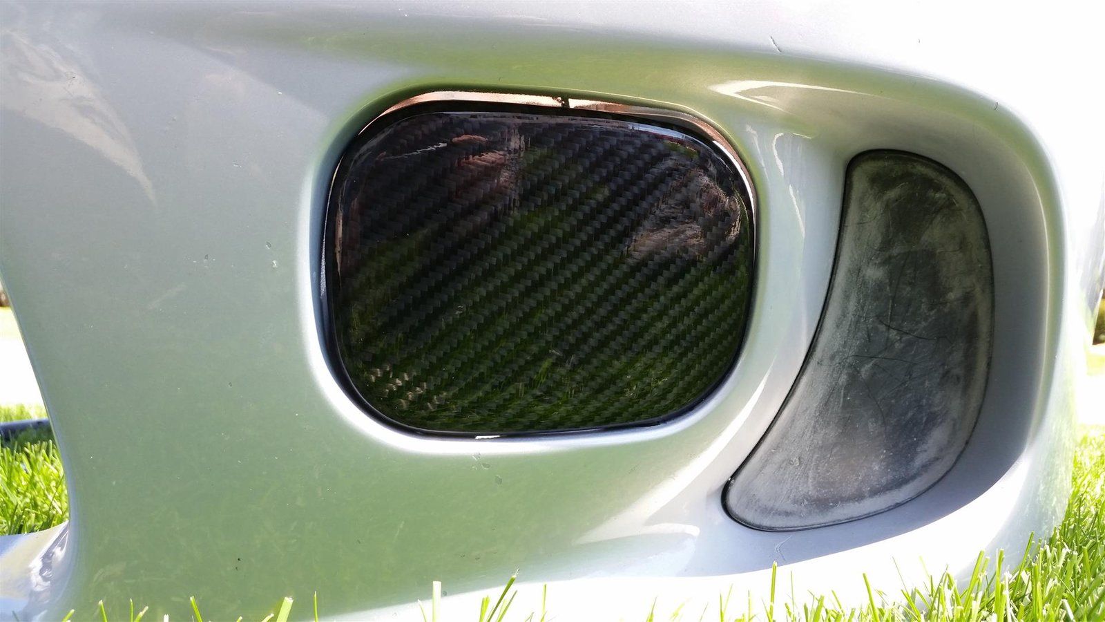

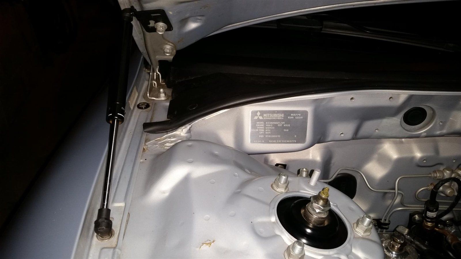

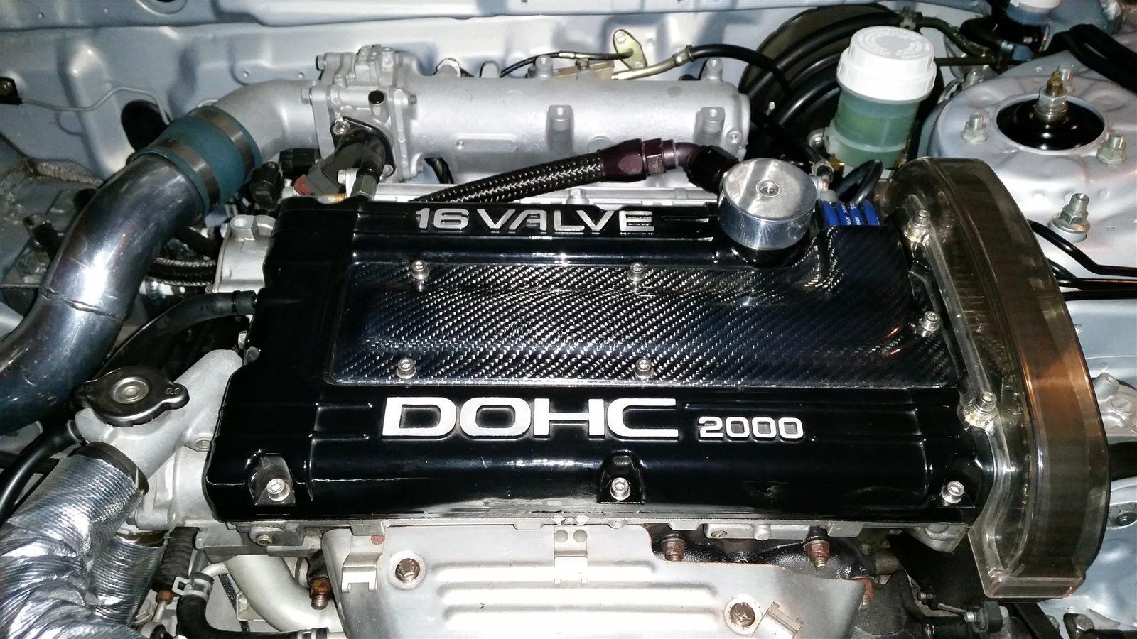

CF fog light covers (held on with safety wire), CF spark plug cover, hood struts, engraved VIN tag:

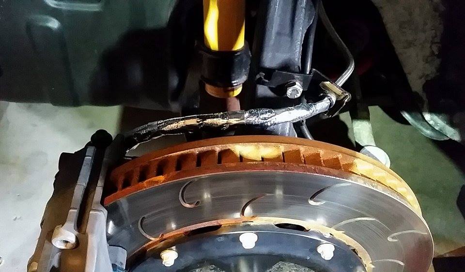

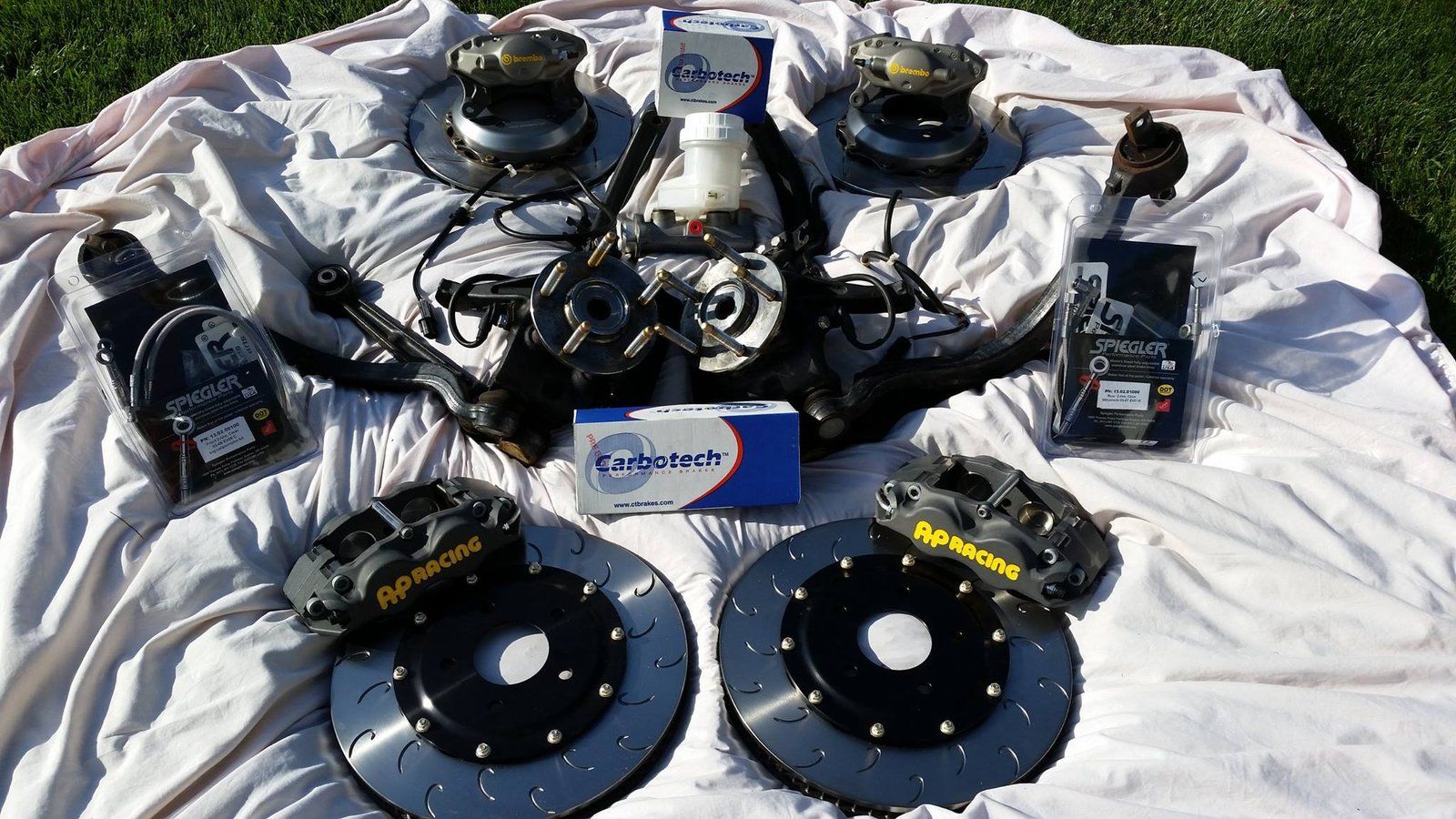

And the big one, brakes! This new setup is absolutely fantastic, besides a nasty squeal. I really can't say enough about how well they work.
Front:
JDM Galant knuckles with ABS sensors
Essex AP Racing Competition Brake kit for an Evo
Carbotech XP 12 for road race and AX6 for autox/street
Spiegler brake lines
ARP wheel studs
Rear:
Girodisc 2 piece rotors
Stock Brembo Evo Caliper with Racing Brake SS pistons, high temp dust boots, and coated by Detective Coating
Carbotech XP 10 for road race and AX6 for autox/street
3g master cylinder
2x Male M10 x 1 Bubble, Female M10 x 1 Inverted adapters (from seller goodbrakes on eBay)
ThermoTec heat shield on front lines

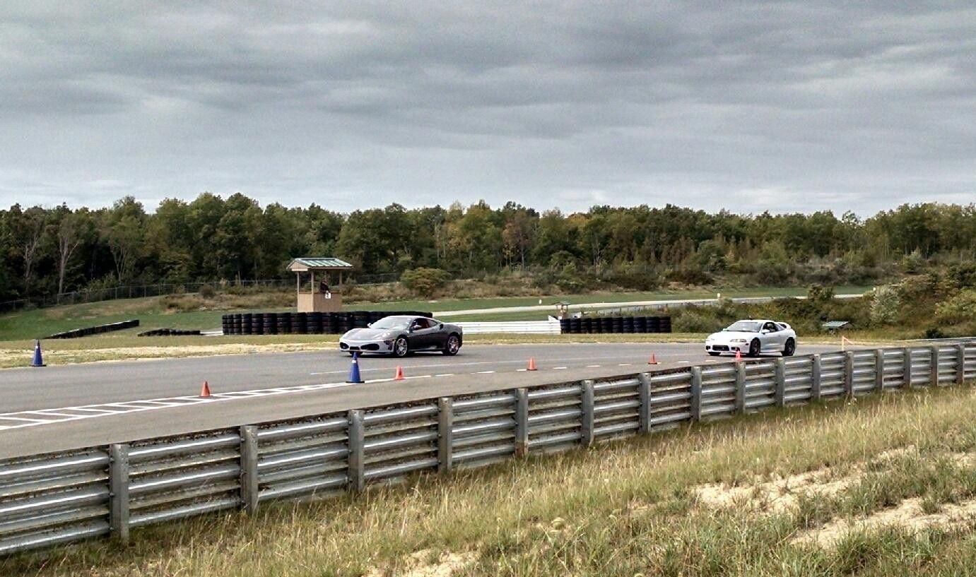

This F430 was in the Novice group with me. I couldn't pass him, but I maintained distance behind him for a few laps once we passed that slow red Porsche. He'd pull away easily on the straights, then I'd make up the distance in the corners. Really nice car! I'll post videos from the event later.

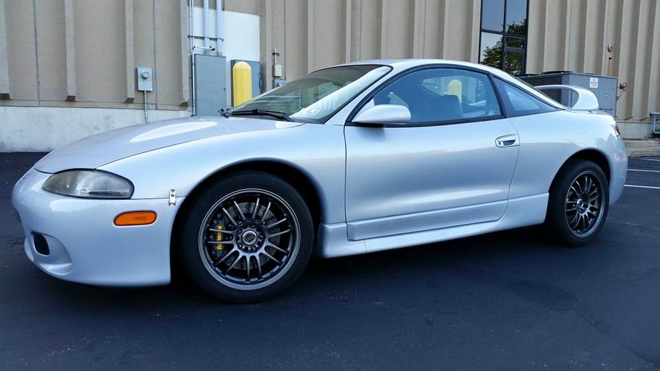

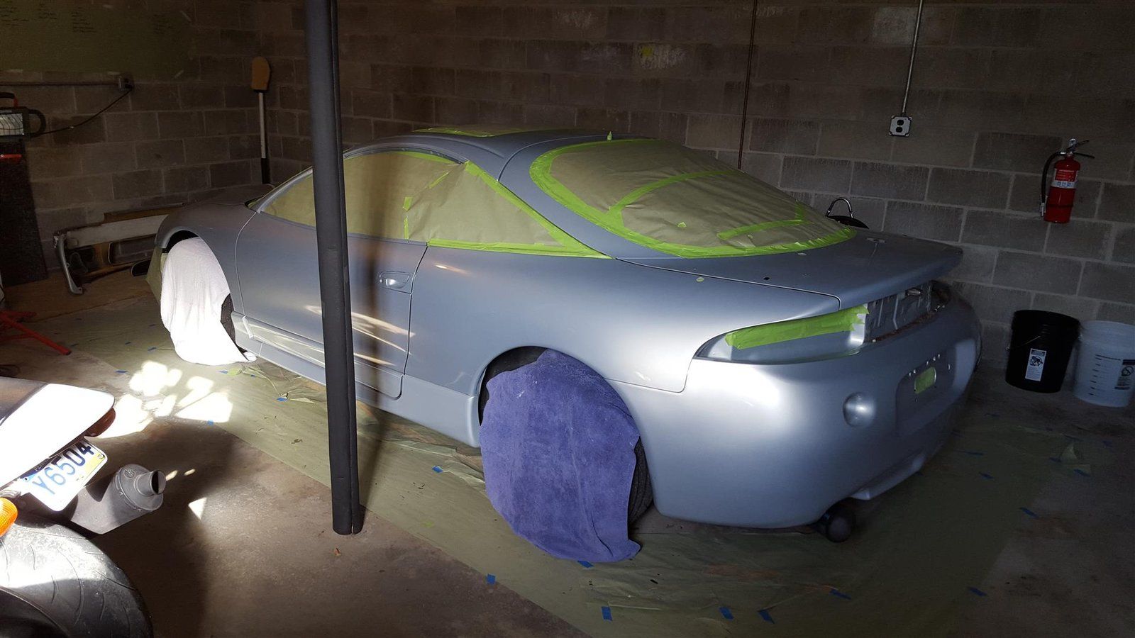

I took the car down after the HPDE in September to start my winter project. I decided to fully detail the car before it got too cold. I also replaced the lower and upper window trim with brand new ones. The detailing involved clay barring, full paint correction with the Flex buffer, touched up all of the rock chips with a Dr. Colorchip kit, Klasse All-In-One, two coats of Klasse High Gloss Sealant Glaze, and two coats of Pinnacle Souverän Paste Wax. I repolished the headlights as well since they weren’t looking so good anymore. I attempted twice to cover them in VentureShield but couldn’t get satisfactory results, so I put that off for the moment. This whole process took about five weeks since I work very slowly.

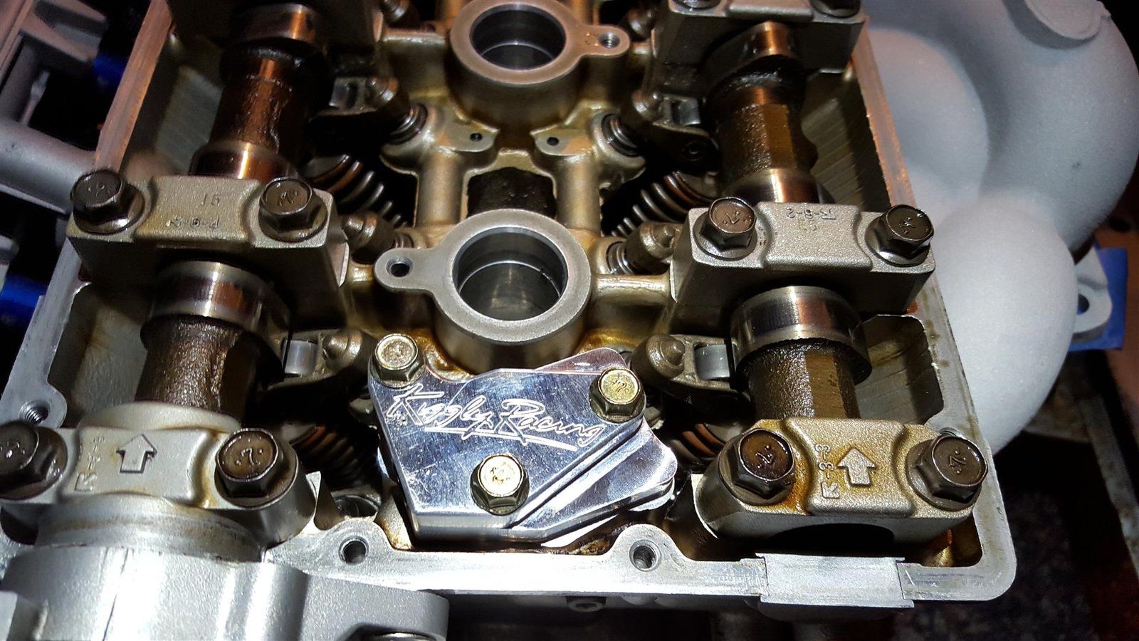

I installed my Kiggly HLA pressure regulator.

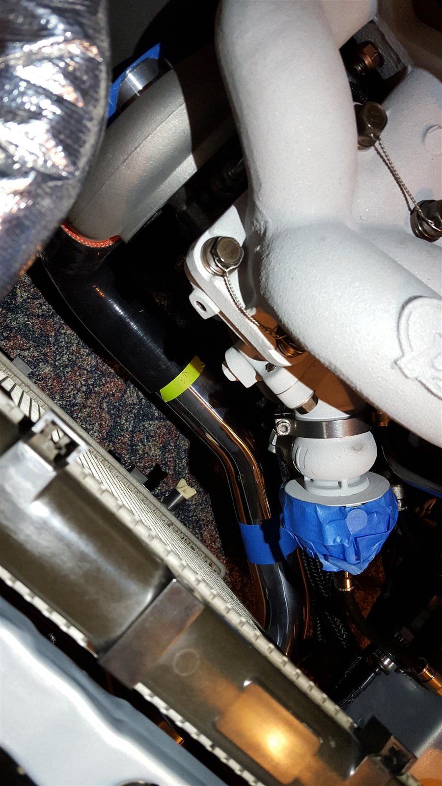

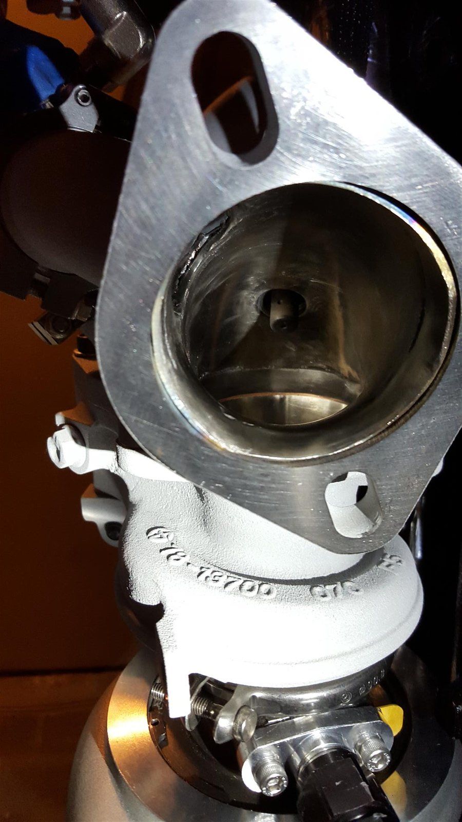

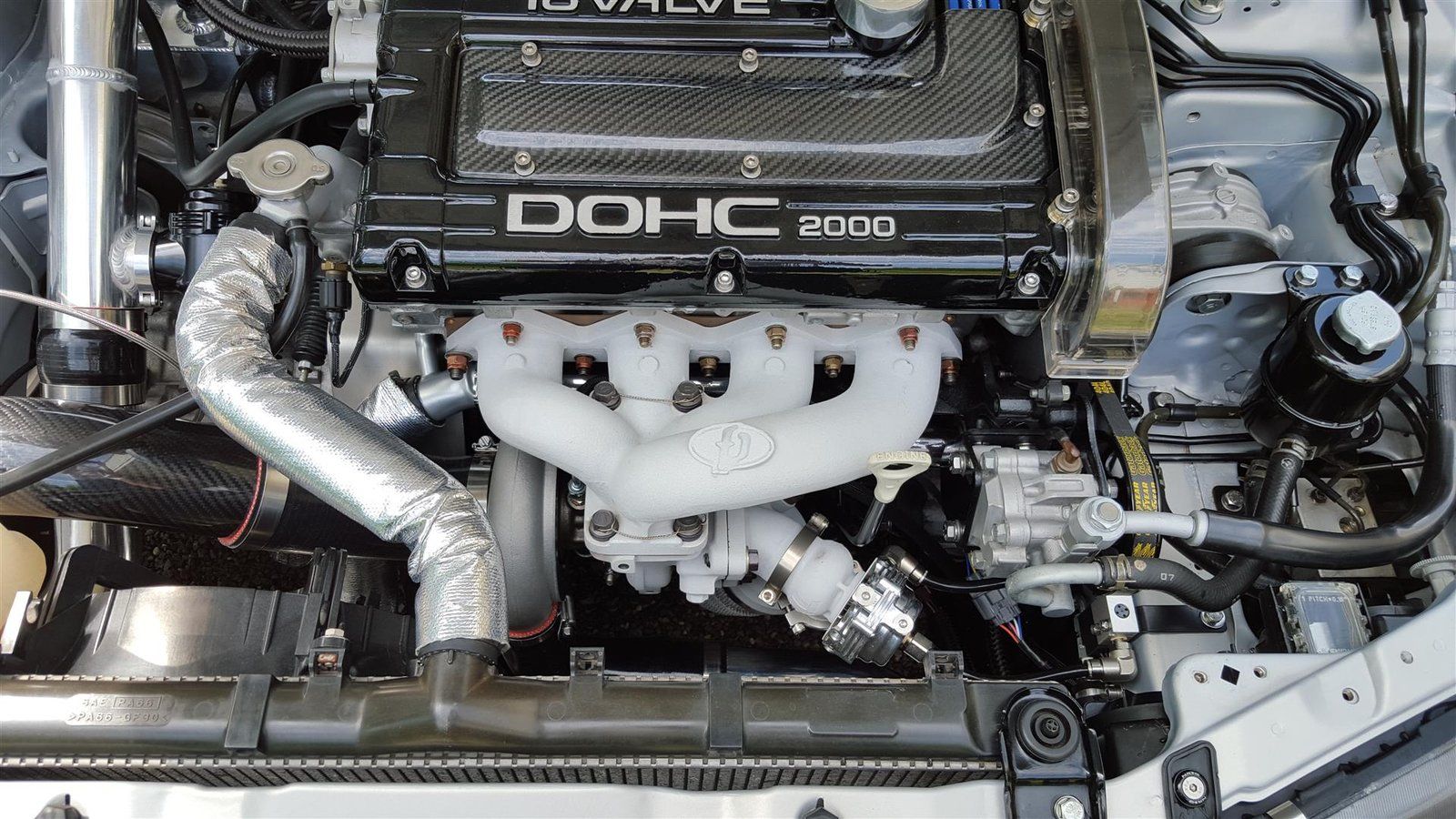

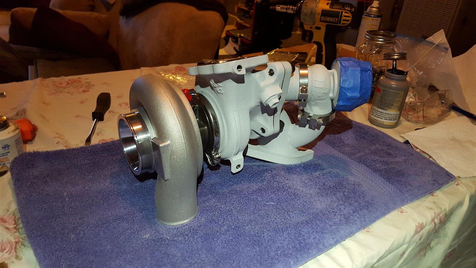

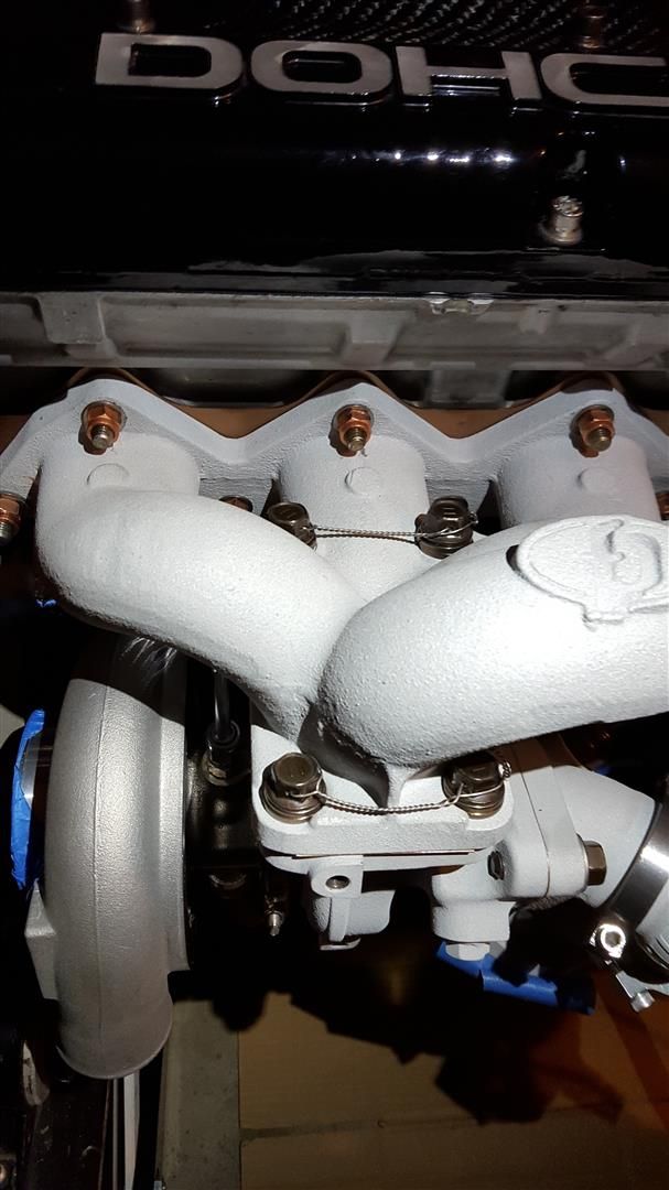

Then, let the turbo swap finally begin!

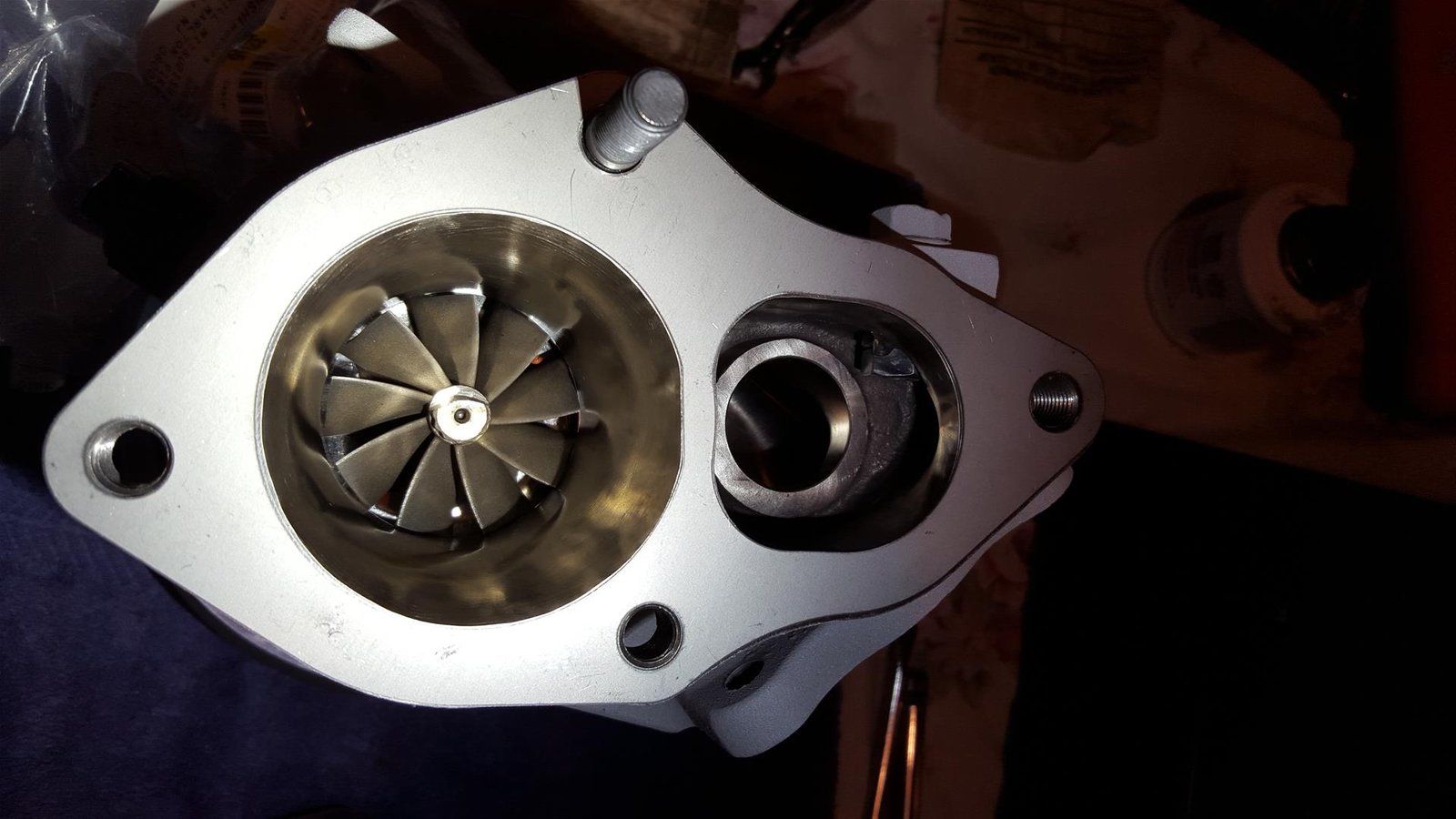

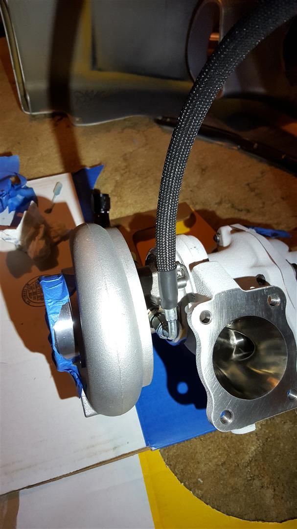

I first got an FP 68HTA, but later changed my mind and had Justin build me a non-water-cooled 20g. I paired this with an FP exhaust manifold and Punishment Racing MVS o2 housing. All of these were ported, polished, and flanges trued by me. The PR o2 housing required the most work by far to get everything acceptable. Swain Tech coating went on next. PR advised me not to take the wastegate off to get it coated, but I did anyway. It was a huge pain to get back on and I should have heeded their advice, but it did turn out nice.

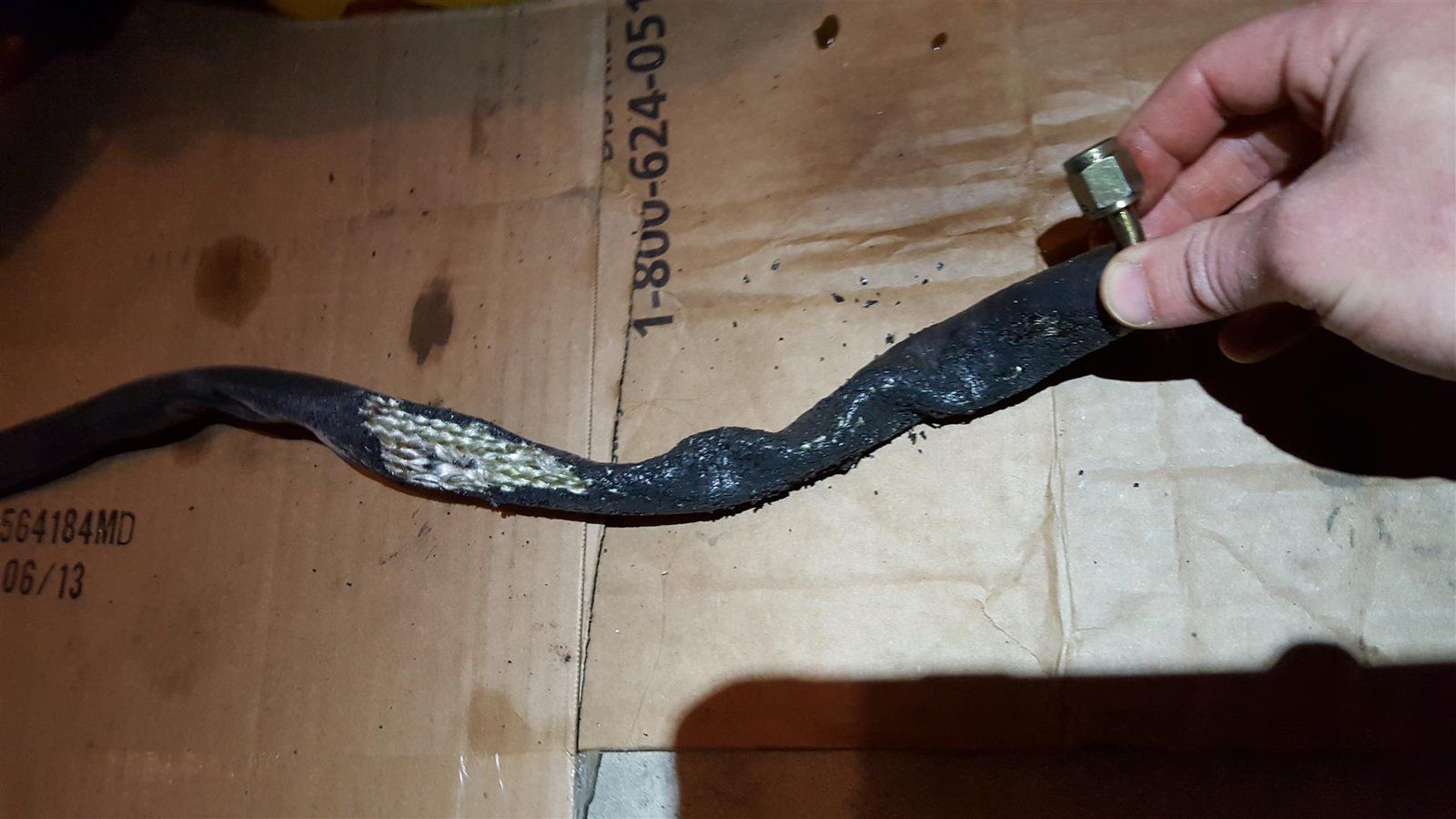

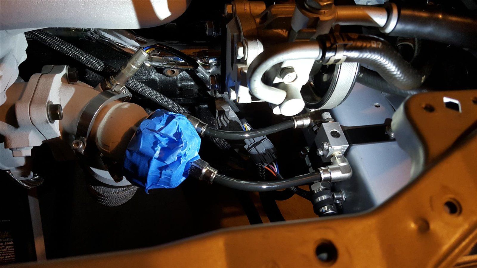

On my previous turbo oil feed line, I used DEI heat sleeve and it turns out it wasn’t quite up to the task. I’m going to try Techflex Insultherm this time around and if that doesn’t work I’ll give DEI titanium sleeving a shot. The turbo to manifold bolts were drilled and safety wired for assurance.

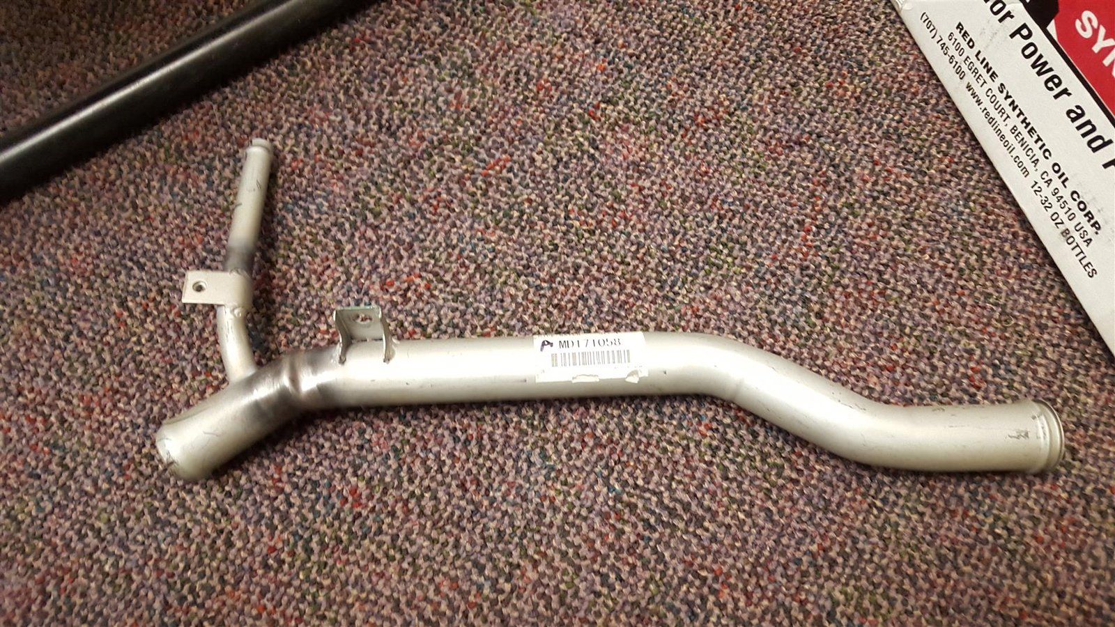

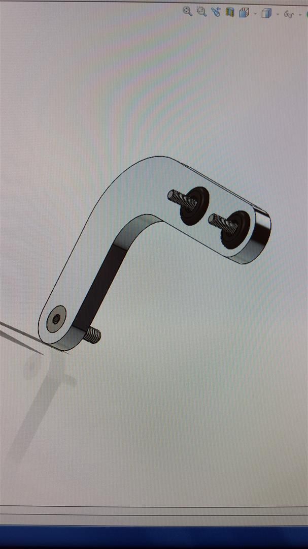

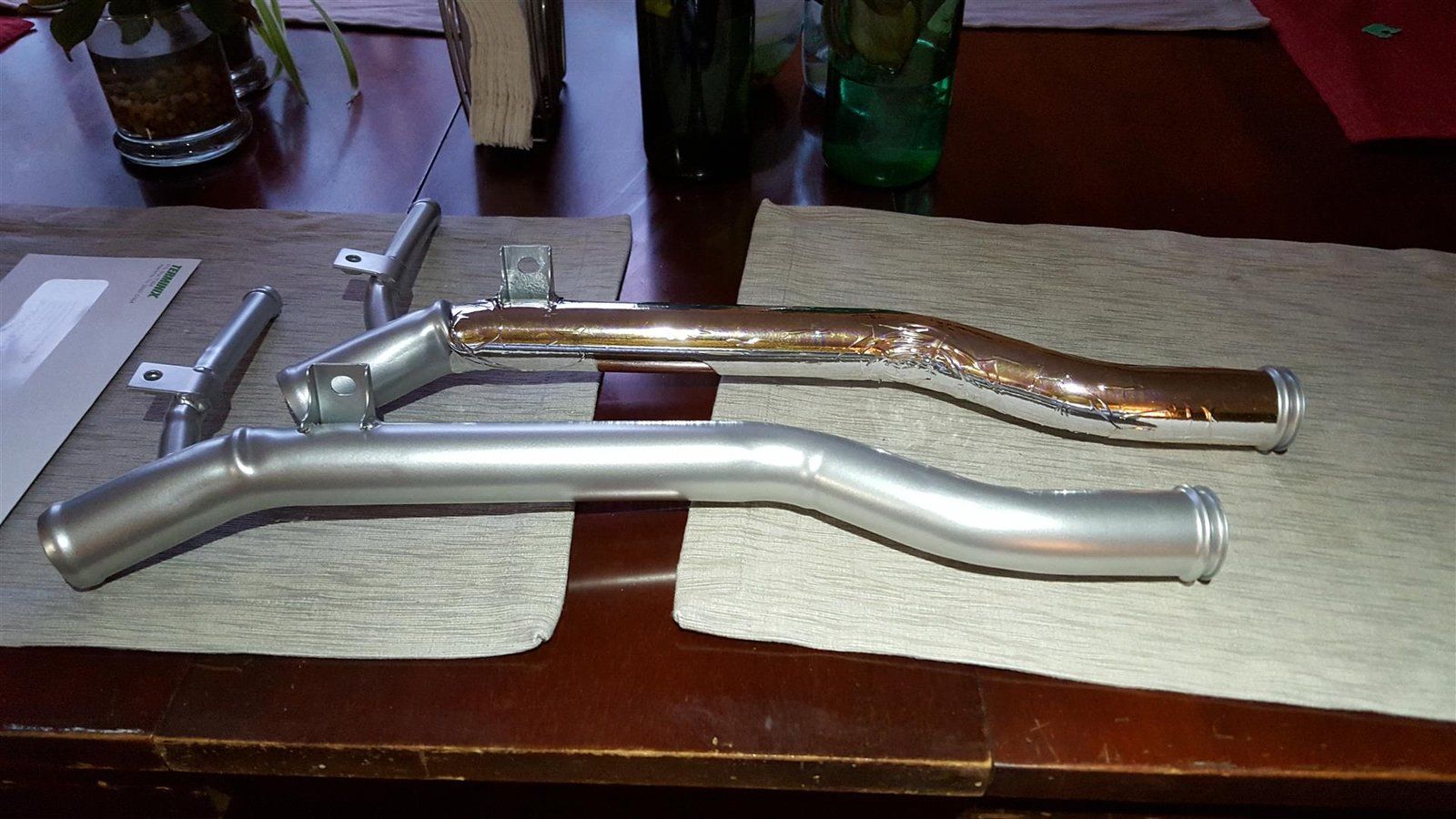

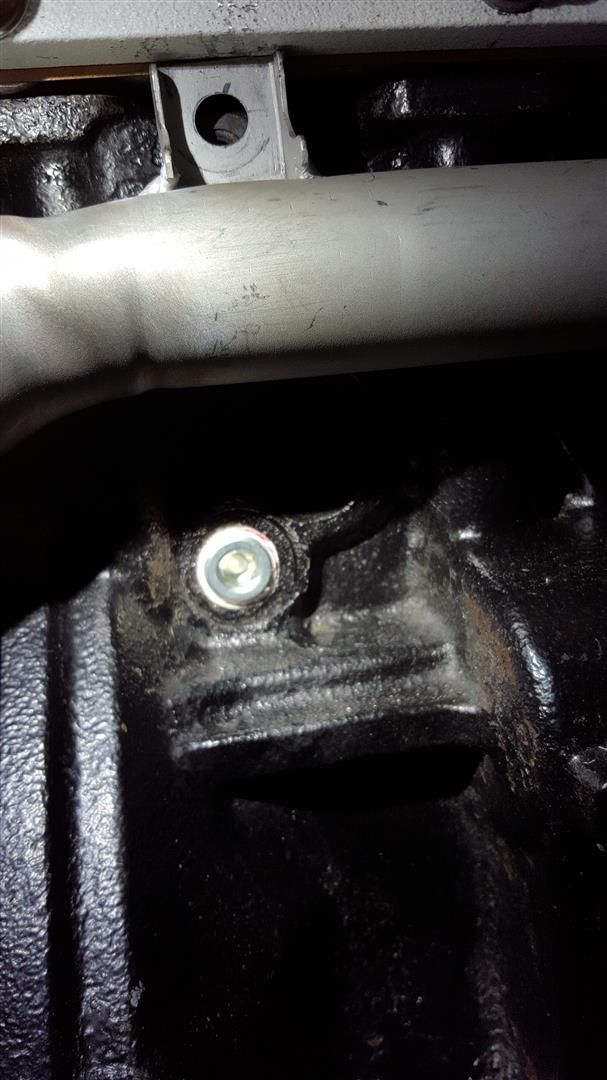

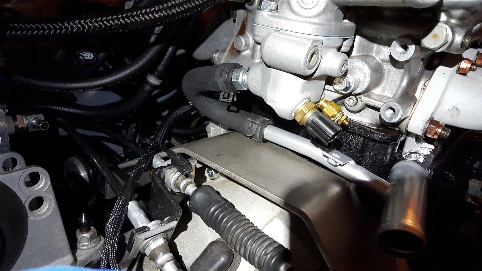

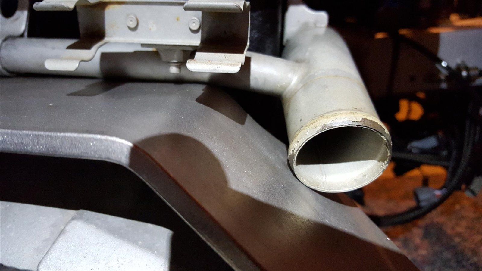

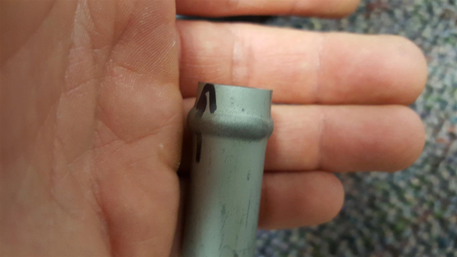

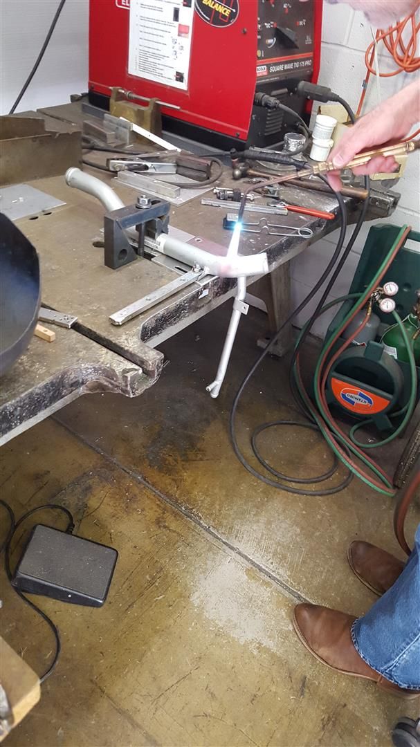

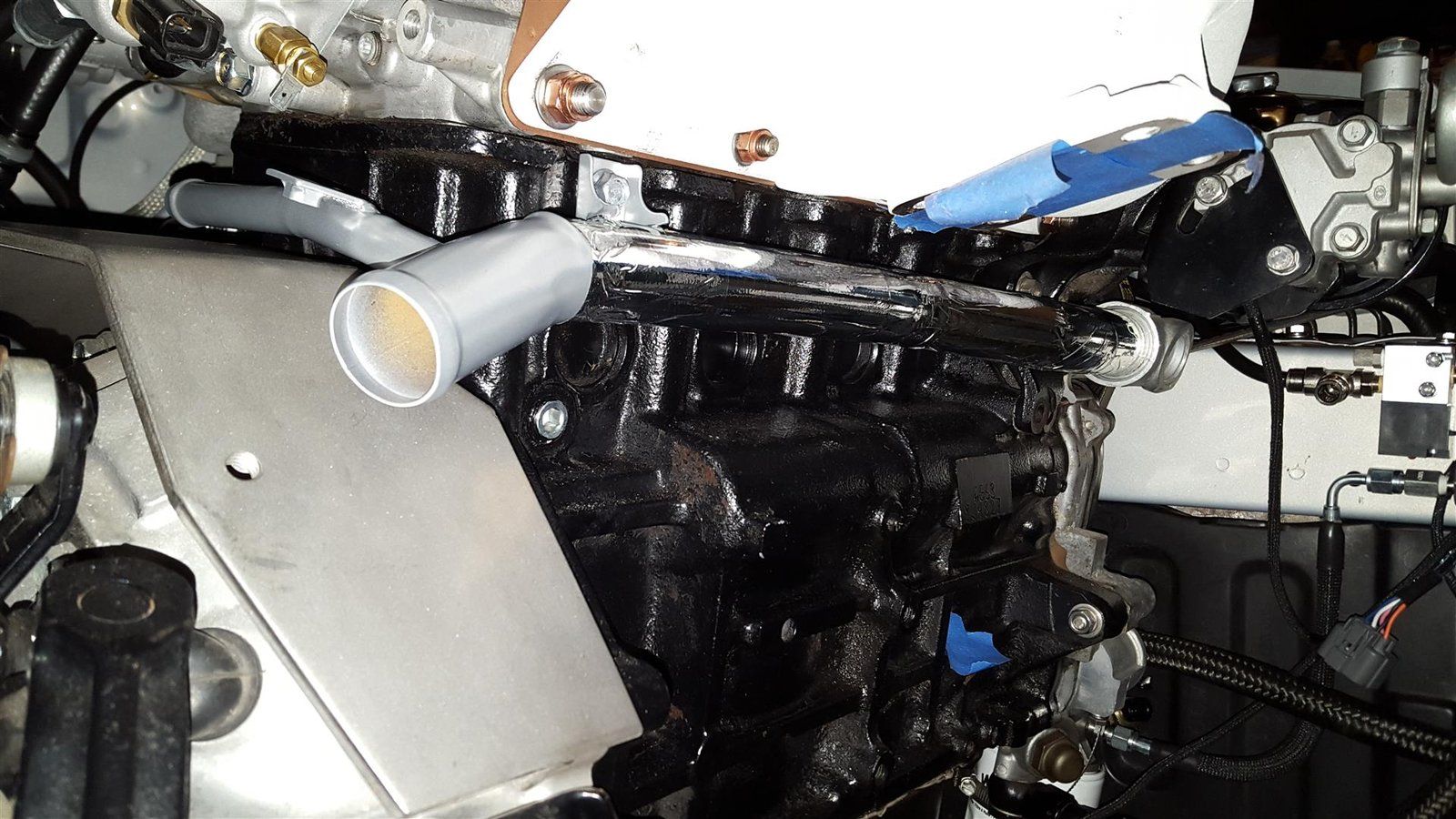

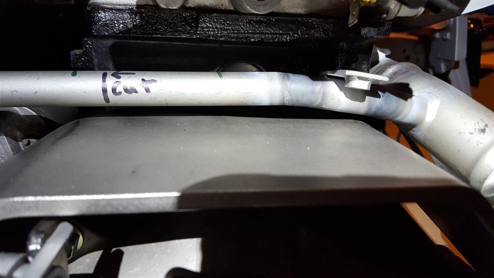

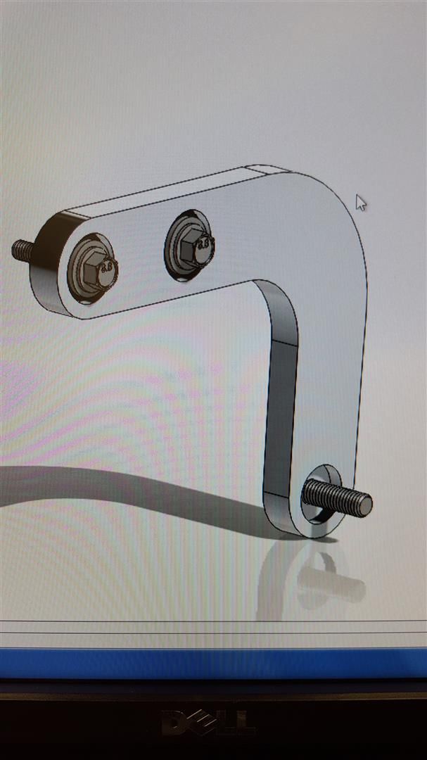

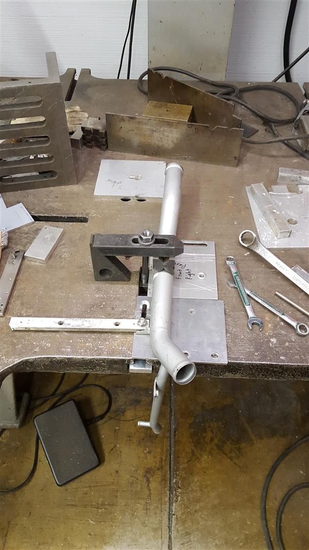

To use the new turbo, I decided to swap to a 1g thermostat housing and non-turbo water pipe. Unfortunately, the waterpipe didn’t fit with the scatter shield, so I heated and bent the water pipe until it fit properly. Then, I cut the end of the heater hose off and used a bypass rubber hose (Dayco 87653) since this is my only thermostat bypass loop now. I re-beaded the end using an Earl’s tube beader. (The tube beader was terrible out of the box and got stuck in my first test piece since the balls didn’t retract when done and the bead was very shallow. I had to drill out the holes and use oversized balls, and shave down the center bolt to accommodate the larger balls.) Finally, the water pipe was powdercoated and reflective heat wrapped. The thermostat housing was glass bead blasted, then I installed the ECU temp sender, aftermarket gauge temp sender, and a 4psi pressure switch for my warning light. I tapped the unused holes to NPT threads and installed SS plugs. A new 180* OEM thermostat was used. The feed hole from the block to turbo was plugged with an OEM BSPT plug. I used a 1g lower radiator hose and did not have to cut the shifter counterweight due to how I bent the water pipe.

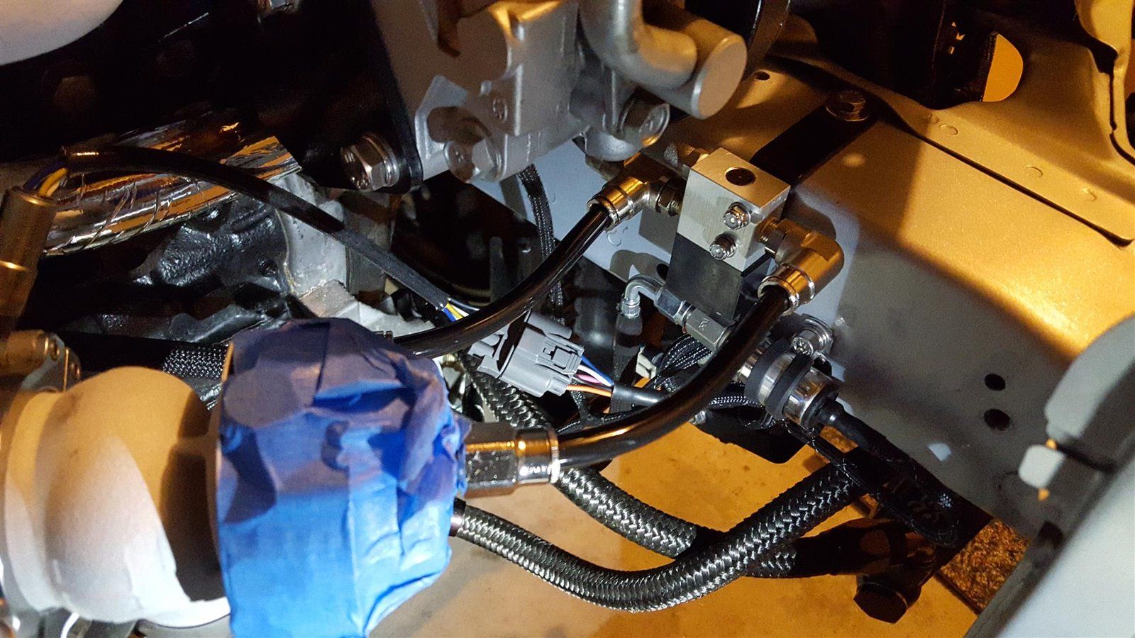

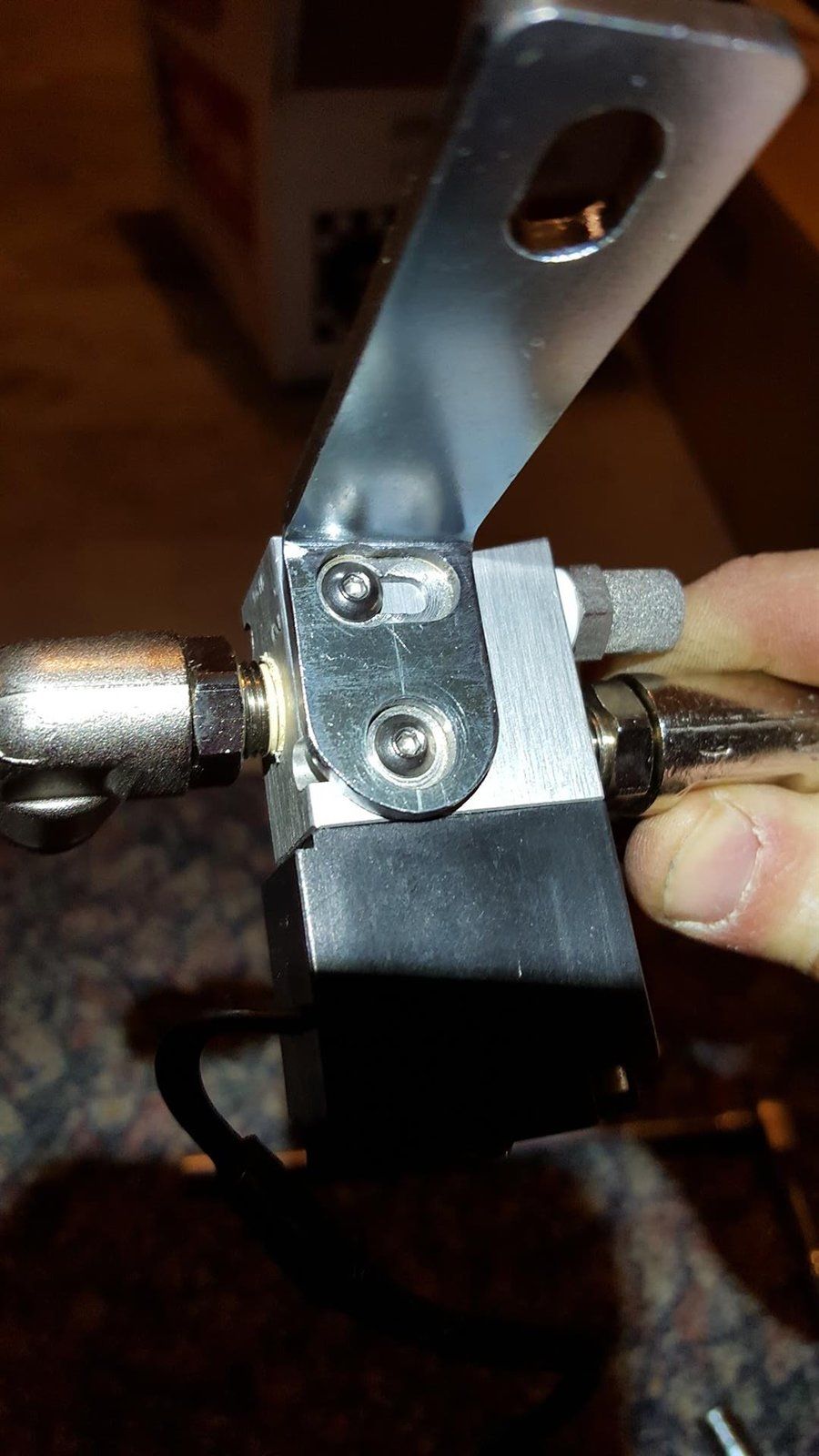

I had to relocate my BCS to make the plumbing shorter and safer. Since there was lack of mounting holes, I used an L bracket to mount the BCS flush with the frame. The backside was counterbored to sink the bolts in, and the top hole was slotted so I can flip the BCS 180* if I ever need to change up the plumbing. I used push-to-connect swivel fittings and 0.245" ID polyurethane tubing from McMaster since the wastegate and BOV specify minimum 6mm (0.24”) ID tubing. I had to get a little creative routing the hose from the BCS back to the vacuum block under the intake manifold, but I think it will be OK. I also put a ⅛” NPT bung on the lower intercooler pipe in case I ever need to switch the boost source. The swivel fittings are extremely convenient!

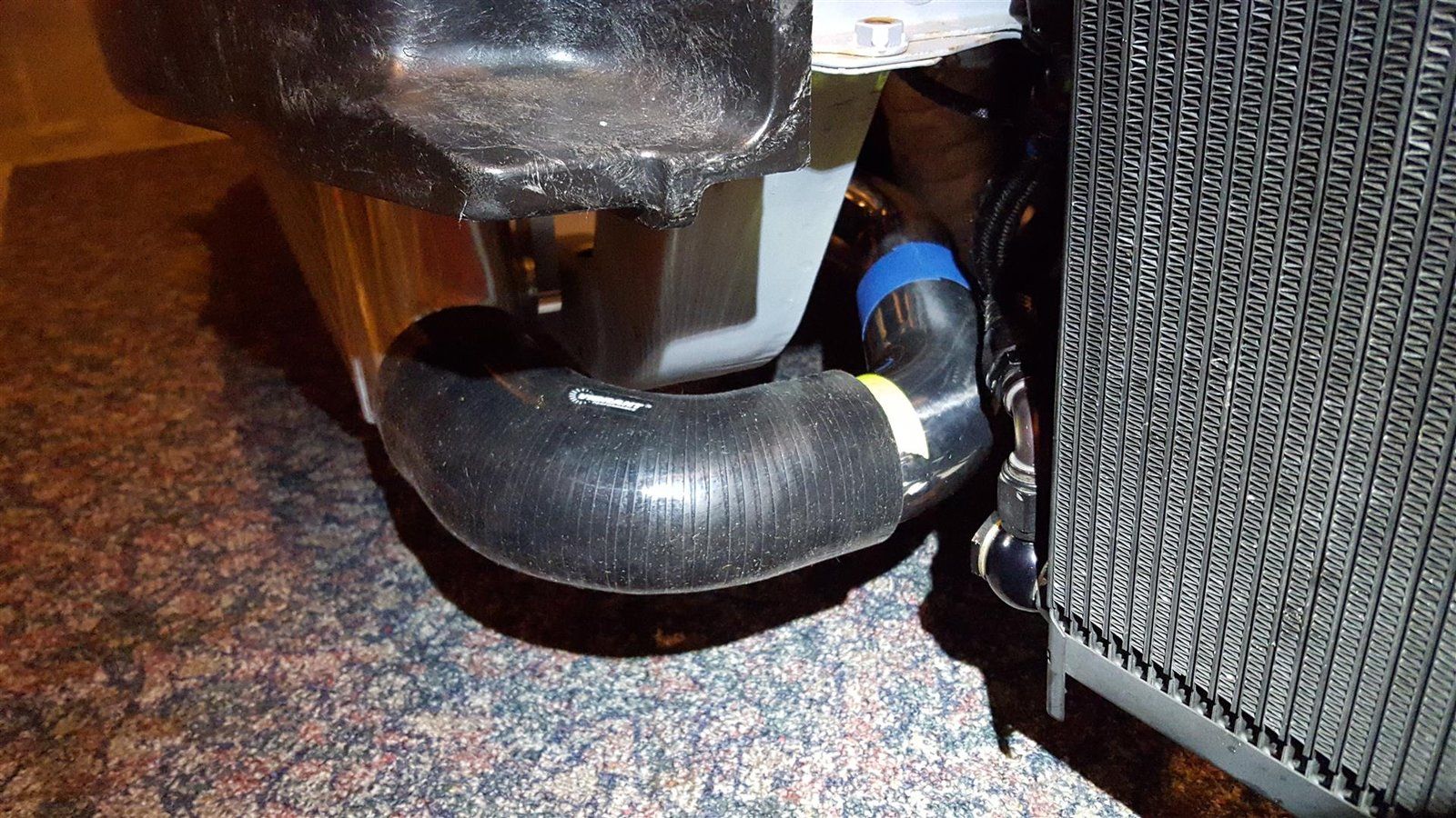

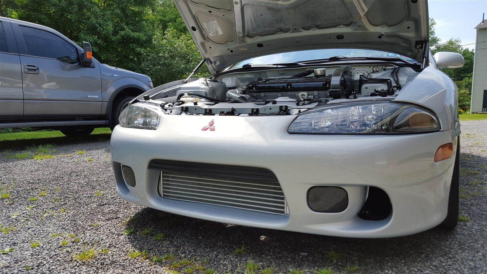

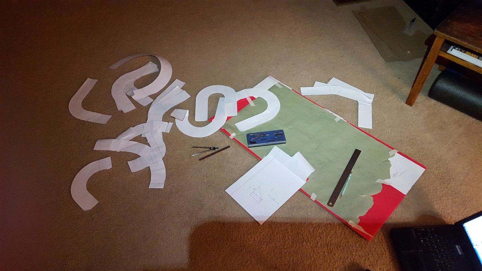

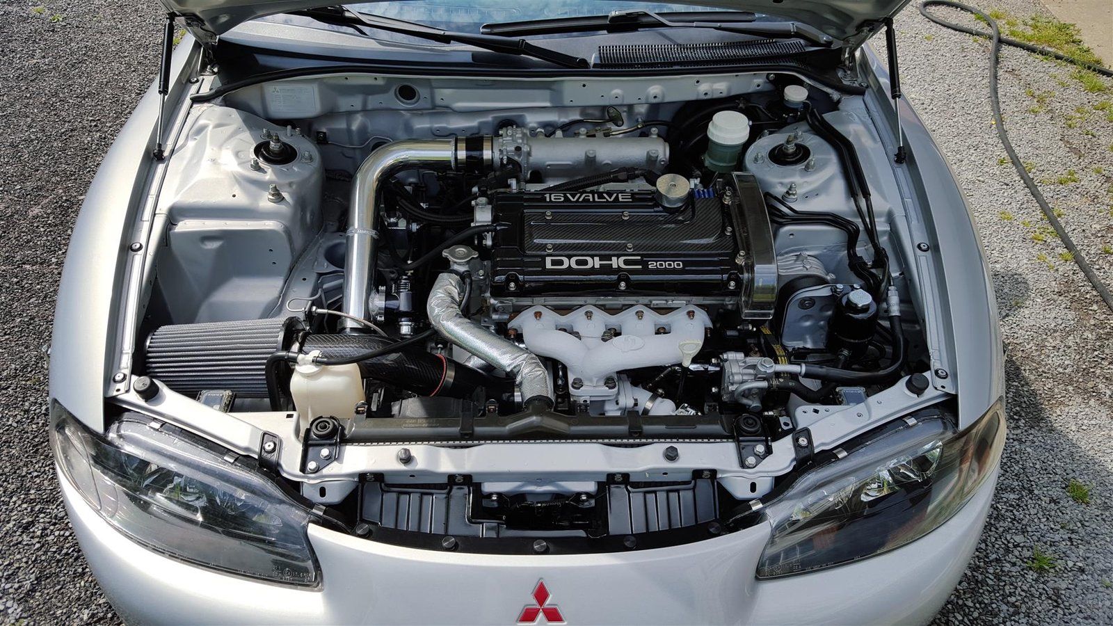

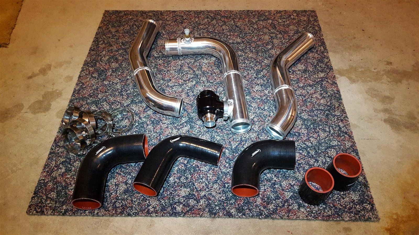

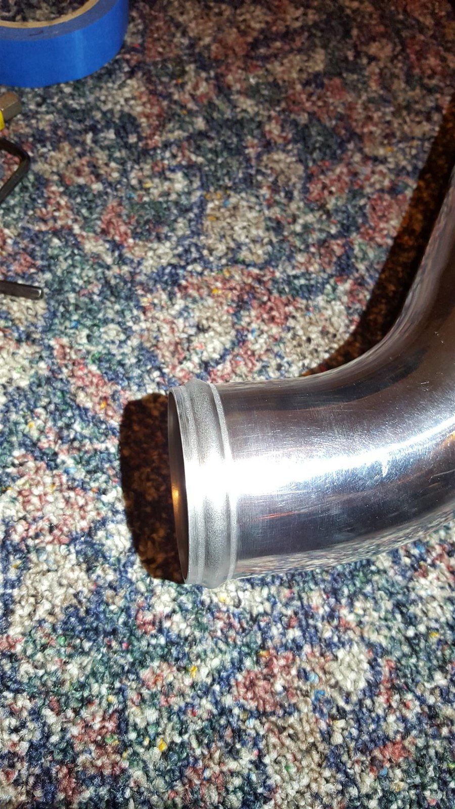

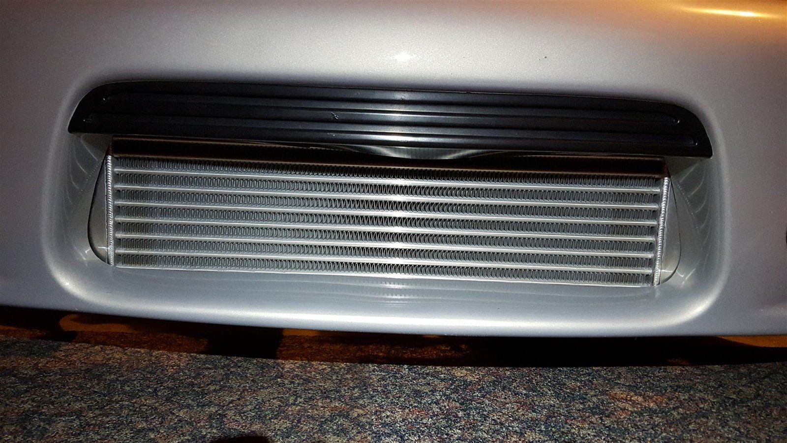

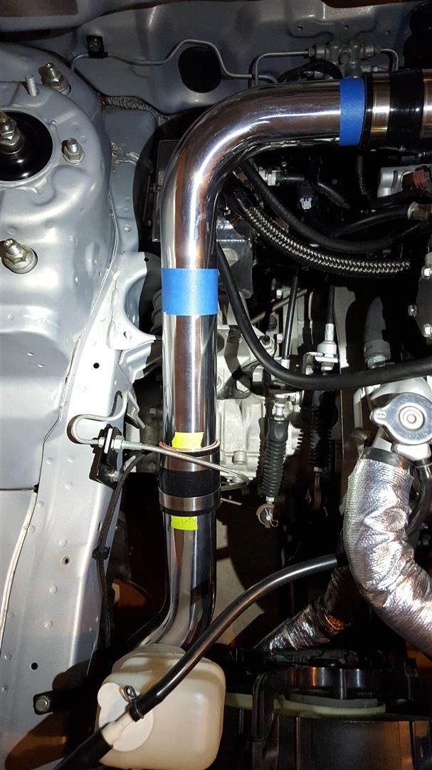

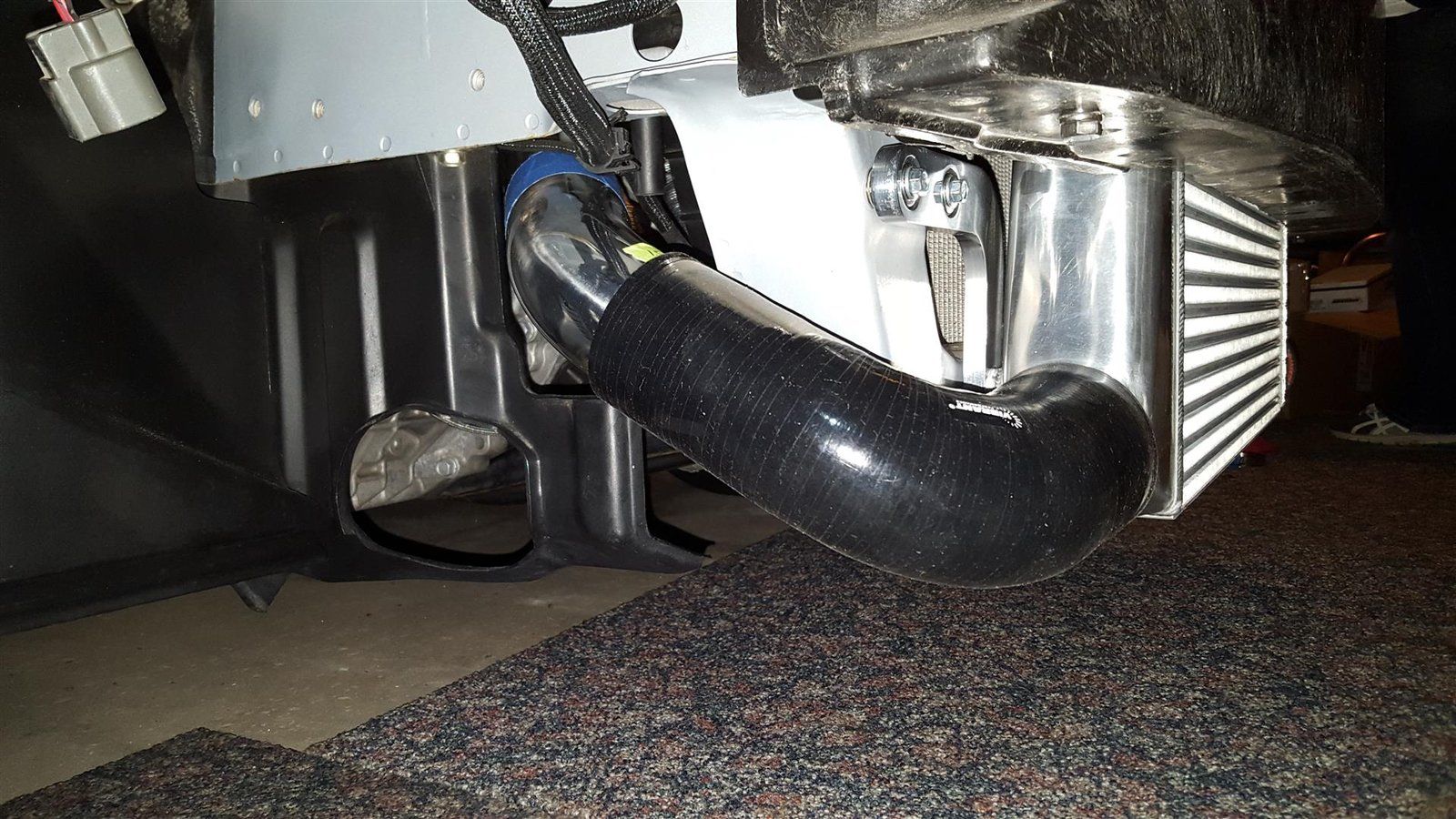

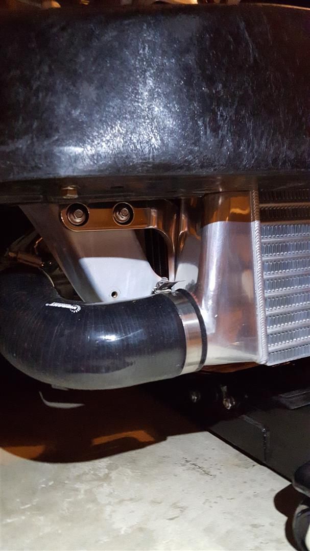

It took me a long time to choose, but I finally decided on a Blitz 23102 intercooler meant for a Nissan S13 due to it’s size, construction, and design. I modeled some brackets in SolidWorks and made them at work from 7/16” 6061 aluminum. The FMIC is rubber grommet mounted on the sides using the stock fog light holes and solid mounted on the top. The side brackets were a several-week project since they involved machining, bending, and polishing to match the endtanks. I’m really proud with how these turned out but I forgot to take more pictures! The bumper cover was trimmed to fit but I kept the mustache portion and as much plastic as I could so no air can go around the FMIC. I’m going to investigate using the stock (modified) ducting later on, or make my own if I have to.

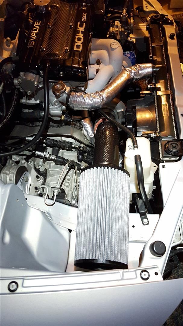

After much measuring, I decided on Vibrant 2.5” aluminum tubing and couplers, and Breeze Hi-torque liner worm drive clamps. I also switched to an Evo III throttle body and a Tial QRJ BOV. I had to trim the 90* couplers coming off the FMIC. I had PRL Motorsports weld them up and bead the ends - they did a great job and I was especially impressed with how well they blended the Tial flange on the inside. I’m extremely happy with how well the tubing routing turned out while managing to keep the pipes simple. It comes really close in quite a few places. I spent a lot of time modeling bends in SolidWorks and printing them out to test fit different pipes from different manufacturers before deciding on the bends I needed to make it work the best. The picture below is just a fraction of the paper templates I had!

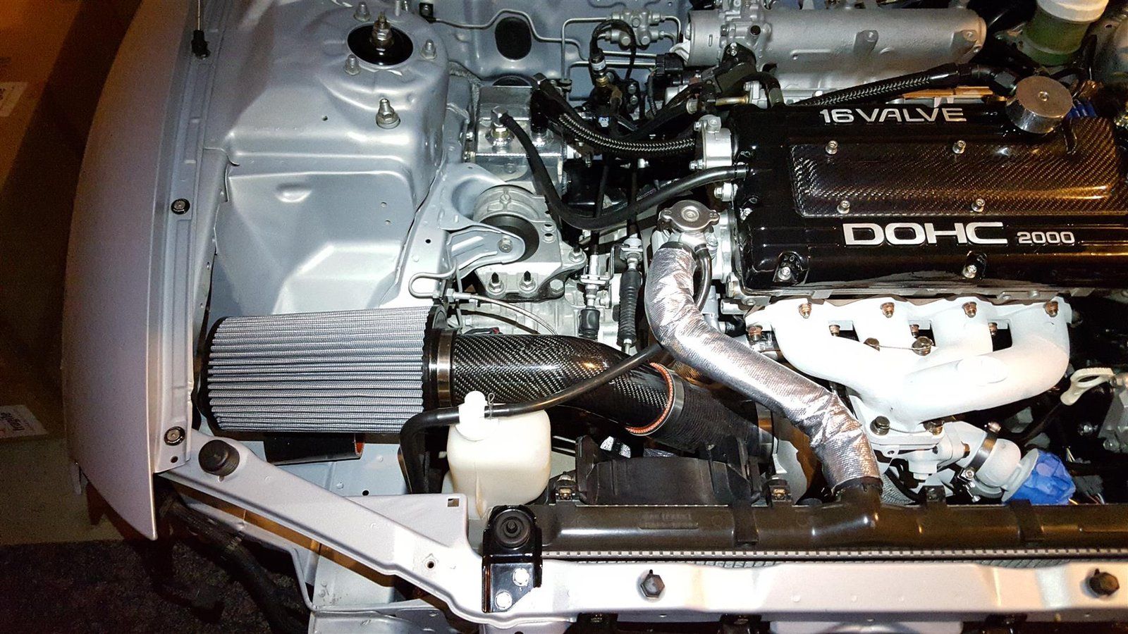

The intake pipe was made from a carbon fiber bend and a Green Filter.
These pictures were taken yesterday.
