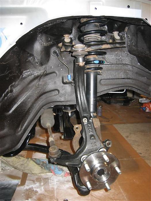

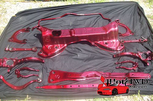

I made an executive decision to skip painting the front subframe and suspension pieces for now for the sake of money, and more importantly, time. I plan on "overhauling" the rear suspension in the future so I'll just paint the front at the same time. I can remove the front subframe with the engine in the car so it's not a huge deal. I just really want to drive my car again!
I purchased new OEM knuckles and all 4 lower control arms today and am getting used ABS sensors so that is taken care of.

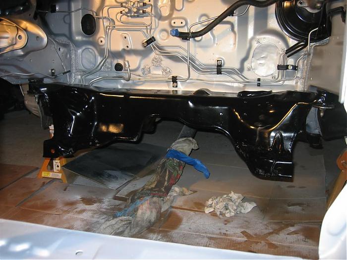

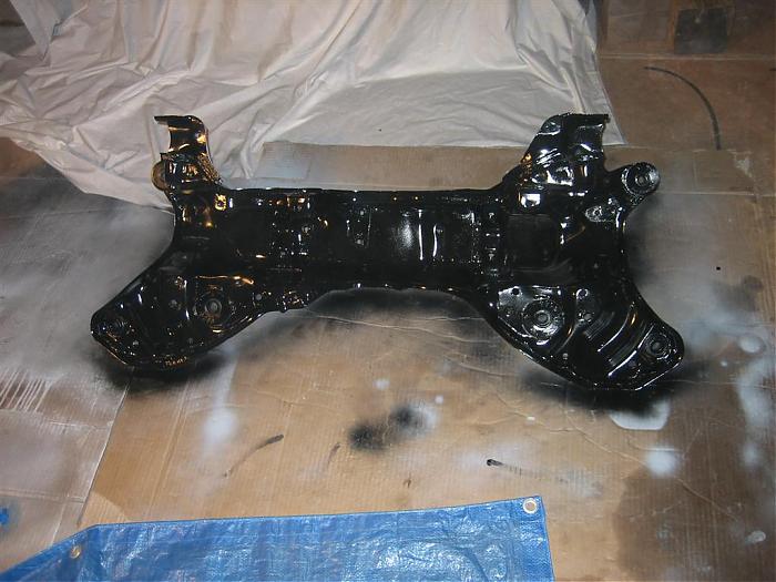

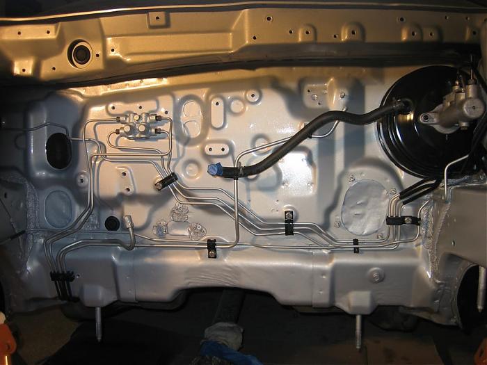

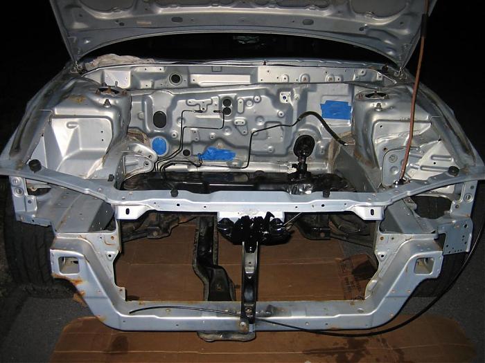

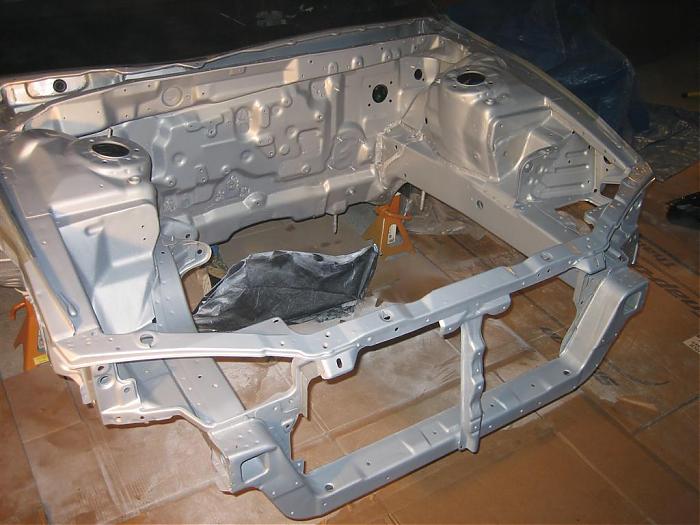

I don't have any time to make a proper update (and there is a lot to update) so I'll have to make this quick. The reason I haven't updated in awhile is because I've been hustling my a$$ off trying to finish this car for the tri-state meet. As it looks right now my car won't be there, just too much left to do. I tried to drop the engine in tonight but it started raining so I'm pulling an all nighter trying to get it in if the rain lets up before I leave for vacation for a week in 6 hours or so.
The major step is that the engine bay is now painted and the engine is ready to drop in, although it's missing a few minor parts for now, bunch of new suspension pieces up front, still waiting on a few more, still need to finish up battery relocation and wiring. Here are some pictures, sorry I don't have time to write anything.

Looking really good, I'm in the same boat right now. Car is fully stripped and working on one area at a time. Did you powder coat your sub frames or paint them? Cant wait to see it when she is all done. Good luck to you.
Too clean to be real. I wish it could make it. Im sorda in the same boat. I got hustled for parts and my car won't make it either.
James :dsm::talon::laser:
The subframe was just painted quickly with Rustoleum. I would have liked to powdercoat it but there are a few complications with that. I use a kitchen oven to powdercoat so it wouldn't fit in there, it would have taken many hours to media blast that to have it ready for a shop to coat and I'm short on time, paint is cheaper, and the biggest thing is I would have had to remove all the rubber bushings to have it powdercoated, then reinstall them all again. I eventually plan to paint it with a heavier duty paint to protect against rock chips etc. but this will do in the meantime.

Ya, small oven makes for a pain with large parts. I had mine powdered, now I'm in the process of making new sub frame bushings. It will all be worth it in the end though.

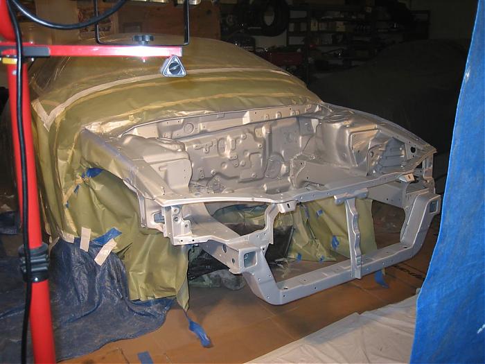

God, the engine bay looks so good with fresh paint! How did you prepare the surface for primer/paint?
How is the DeVilbiss working out?
Thanks! I hate bodywork. I started out by removing all the rust from the bay using anything I could - sandpaper, scrothbrite pads, dremel in some cases, wire wheel, etc. The lower rad support was really hard to get to so I did as much rust removal as I could then brushed on rust treatment (which I don't like btw). Then all those areas of bare metal, plus the lower rad support, got primered with a rattlecan. Then I feathered the edges of the primer in with red/gray scrotchbrite pads and scuffed the rest of the engine bay with the pads. This all took about a week. Did I mention I hate bodywork? After I spent way too many hours being OCD, I vacuumed up all the dust, blew it off with air, wiped the bay with wax and grease remover, spent like 4 hours taping and masking off everything and covering the car with tarps, then wax and grease remover again, the blew it off with air again, then wiped it down with special DeVilbiss wipes, then blew it off with air once more, then laid down 3 coats paint and 3 coats clear (no primer or sealer was used for the whole bay per the paint shop's recommendation). I might have forgot a few steps but that's the basics. So nobody can say I didn't put effort into the prep work. I hate bodywork.

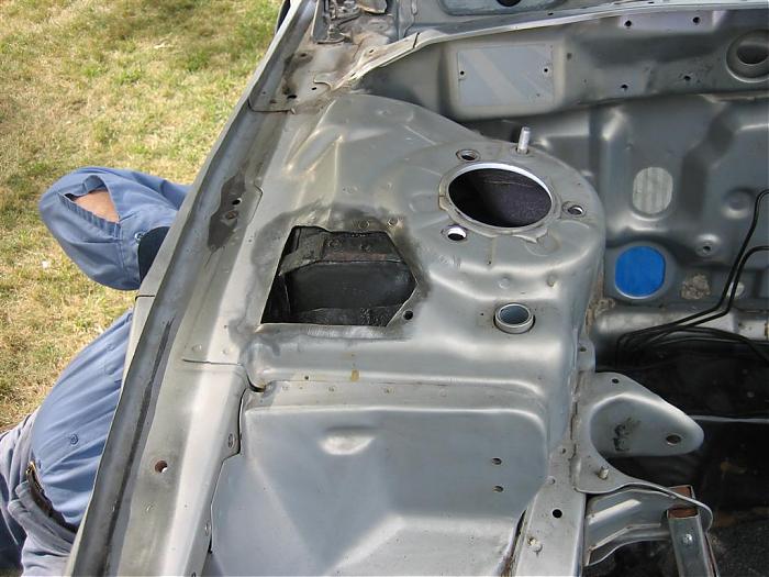

Oh ya, almost forgot. In the midst of all that I had to deal with this (the lower plate was being welded in in this shot): :cry::cry::cry:
I put a crap-ton of work into this too, I have a lot of info to share at another time. But suffice it to say I was DEVASTATED when I found the rust hiding :cry:
