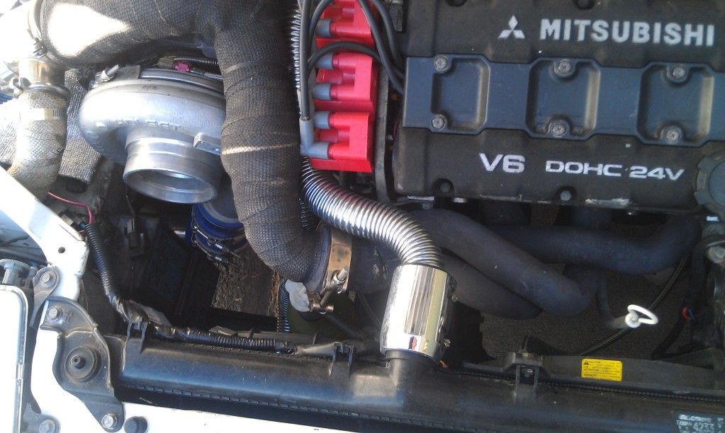

-Turbo is an Hx52, just like BigLady's- thanks for the great data btw, I've been following your threads, and the Holset FAQ thread, and anything else I can find on this thing as users are scarce
-fuel is 1250 cc's - about the equivelant to 14-1500's on a dsm, twin walbro 400's

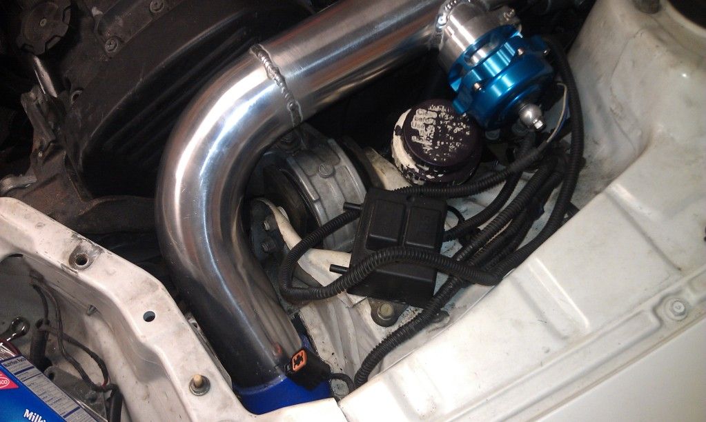

- 32x12x4 custom ETS fmic with 3" piping and Tial 50mm bov
-spec 4+ solid hub, welded and balanced until the twin disc next year,

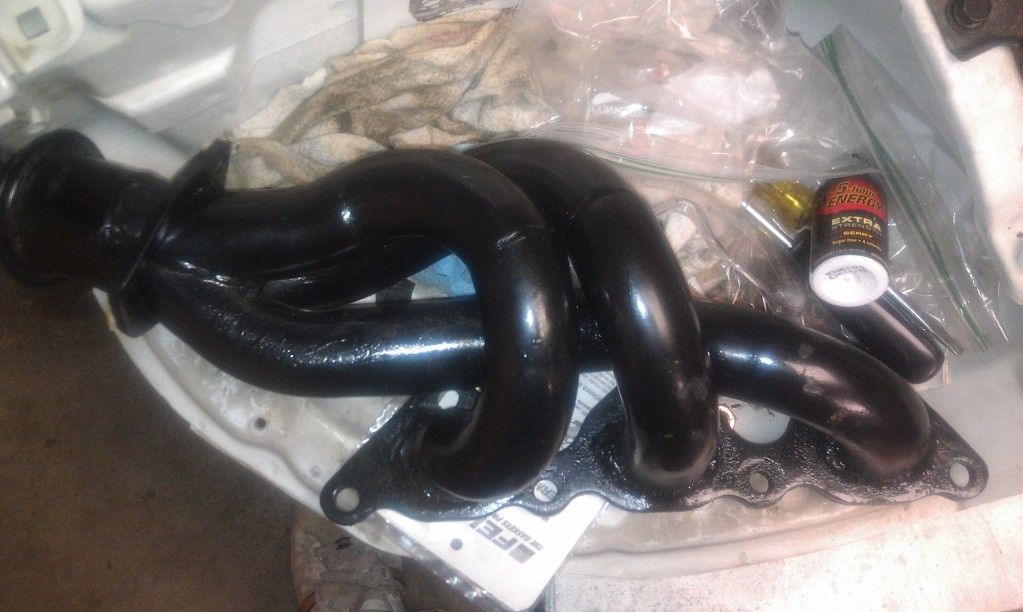

-Custom 3" dp and 350z header setup (matches right up to 3000gt manifold flange and works like a charm!) with divided 60mm wg dump.

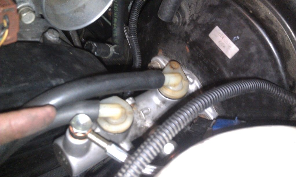

DSM remote mount brake resevior- to make room for the 3" IC piping :sneaky:

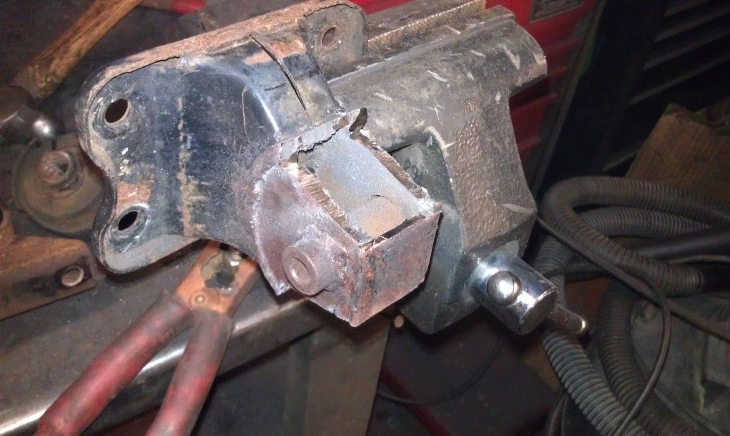

-Billet aluminum bracing tig welded in for the tranny.

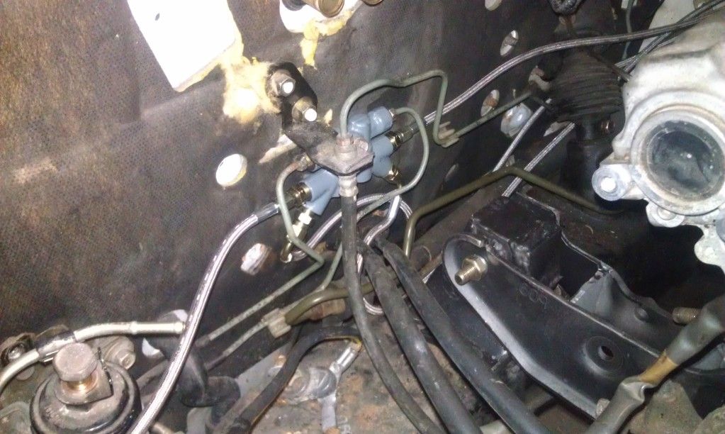

- ABS delete with braided lines- faulty system on the 3000gt's under load/extreme braking conditions such as roadcourse and high trap drag racing.

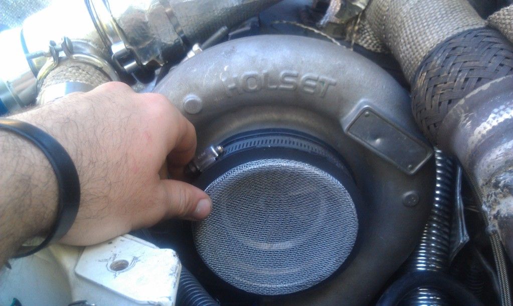

Thread update- holset hx52 setup RUNS! Just took it out for a quick spin only to bring it back as it got hot from my rad fans didnt kick on, one bug to address........but not before i got a wastegate pull in when starting to log the flash tune. The turbo kicks in at around 4500 on a stock 3.0 with 8.1 compression, no headwork, no timing advance or leanspool (yet) massive intercooler, on e85. When it does, the whistle is loud enough to drown my open dump wastegate, and the power delivery is pretty violent, one of those "nothing........ nothing..... nothi-#7@&@*@)!!8'-'-37@)@73%4!!!!" type turbos.
On a 2.0/2.4, i wouldnt expect spool sooner than 5 with antilag or a quick spool valve. Ill have some dyno data and logs posted once i work out the bugs from sitting for a year and getting heavily changed from stock

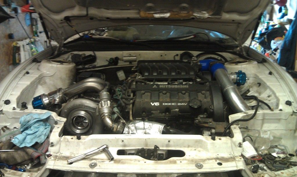

THREAD UPDATE AND REVIVE! Sorry for the delay, but I've been juggling school, this and sourcing a nice daily I don't need to worry about in the winter.
So update on the car: SHE RUNS BEAUTIFULLY! Pulls hard for just 14psi.
-The Spool/behavior
On 3.0L with ****ONLY INJECTOR SCALING AND OPEN SOURCE BASEMAP**** (so far) and no tune or timing to play with the spool, boost starts around 3800 and hit full boost by 4500rpms on e85, suggesting the 16cm is roughly in the ballpark of 1.2-1.4 A/R in universal exhaust housing terms- fairly big for 4g63 2.0 use. The turbo comes on fast and violently, there's no gradual surge. First you hear the whistle begin quietly and build louder (it actually does sound like a jet engine due to no pipe on the coldside muffling it- i found it kind of comical)
-The Fitting question
I actually just ordered the garret oil fitting for the gt42, its unrestricted so far, and not blowing any smoke, but 3000gt operating oil pressure is considerably lower than the 4g63 so it might not be a problem, but after the work, I'm still getting a restrictor to install for cold starts when the oil is thick
the feed is a -4 and the drain is a -12
-The results
According to Virtual dyno, on just the injector scaling, its showing 393hp at 14 psi, I'd post the logs, but we actually did them on a friends laptop. When I go in for a real tunning session, I'll make sure to request the data for posting
Heres a quickie pull video on the night the injectors were scaled, and so far thats the farthest its gotten, I havent had time to take it back in to start tunning appointments on the dyno, not to mention to repair the tranny and swap in my heavy clutch yet- all on this winter's docket.
Skip to 26 sec as I didn't realize at the time he wanted me to do a pull
HX52 Single Turbo Mitsubishi 3000GT VR4 - A quick pull on first base tune - YouTube

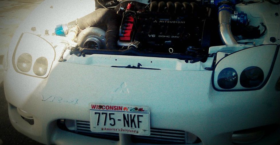

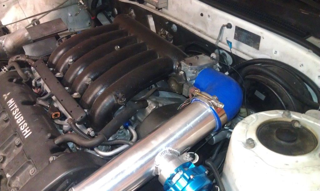

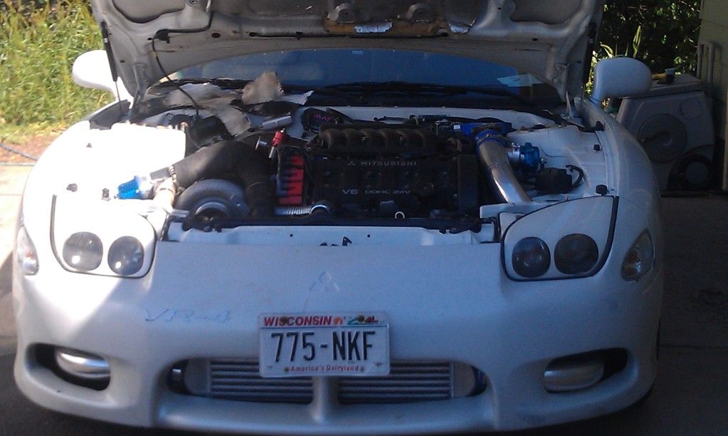

Pics of the finished project (don't mind the heat material, was working on a new, better looking shield for the firewall when I snapped the pic:
---Proof that with enough crap removed you can see the ground through a 3000gt engine bay!

Any pictures of the collector at the flange where it meets the turbo?
